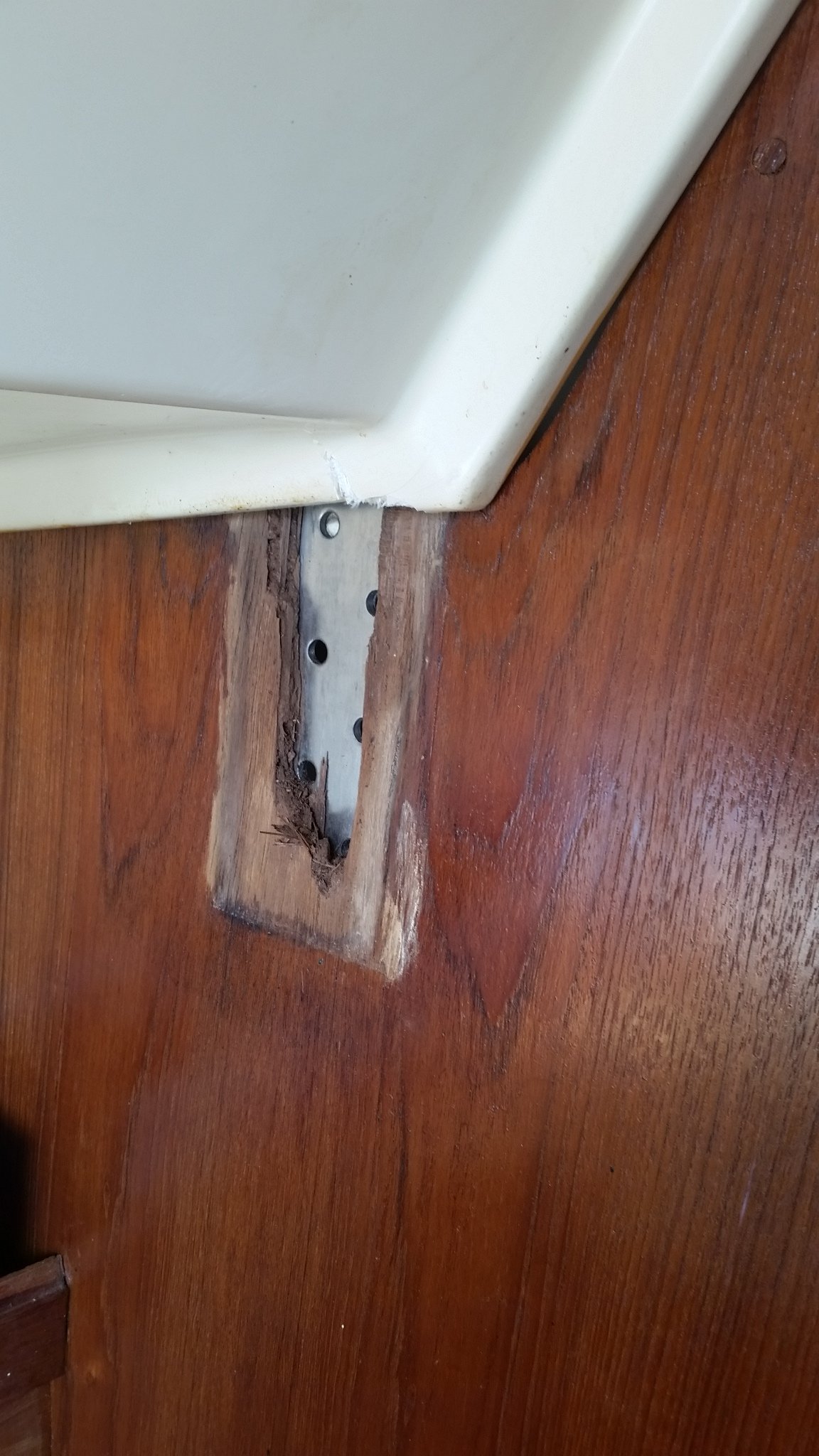

Thanks for the input. At the dock with no sails set, the boat is solid. No soft spots and the rigging is true and straight. Also judging by the damage and any visible staining, the issue seems to be confined to the port side plate.

Dutchman,
I'd wager that the crack on the inside has nothing to do with the crack on the outside. The inside appears to be in the molded edge of the cabin liner which is only a "trim valance" feature to hide un-finished areas. If by your inspection you agree this to be true, you could cut off the valance section at the chain plate to provide more inspection access to see what the condition is of structure above it.
2nd, The crack on the outside is likely only in the gelcoat caused by flexing at that area. You could carefully grind or gouge out a small section of it and see if the crack goes into the laminate. If it goes deeper than the chopped strand outer layer then it will need to be repaired. Either way the surface gel coat crack can be opened by grinding out a broader channel and refilling with gel coat and sanding and polishing smooth.
Your real problem is that leaking chain plate which is rotting your woodwork and corroding your metals. That plate is pitted on the visible side and surely looks worse on the opposite side. Repair your woodwork as needed, replace the chain plates and re-bed.

Dennis,
what makes me wonder is the noted gel coat on top of the nut inside and possible movement of the chain plate noting the difference of color on the wood as if it had moved. That chain plate needs to be insepected at the least.

Dave,
Its hard to tell if that's gel coat or sealant. It does look like gel coat and it would be no surprise as it looks like someone tried to seal the whole assy. on top with gel coat. I had some of that on my 23.5 when I bought it; that is. gel coat covering cracks in laminate which had not been repaired.
In any case I think Dutchman's problem is probably a lack of sealant and of course since there has been water intrusion, rotted deck core could also be an issue which will require repair.

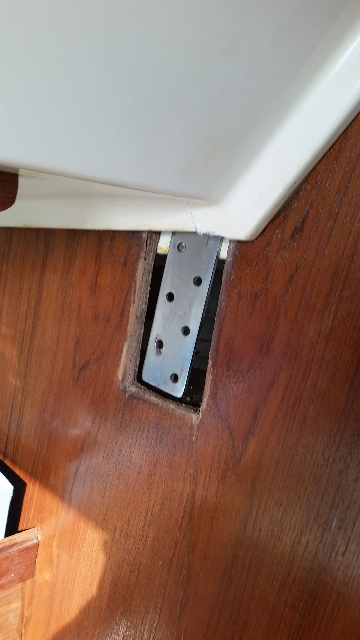

Until the mast is either secured or down with the bolts/chain plate removed, it would be hard to suggest what to do. It is an investigation and until you know the full extent, then and only then I can comment. If you do look again at the top edge of the nut in the one photo, it is gel coat that was broken off to suggest the movement. If all ok then it will be a simple fix but first what does the bulkhead look like with the chain plate inside removed.

I'm heading out later this week with a second hand in tow to take a good look under the block and chain plate. The good news from a quick look the other day is that the starboard side and compression post are solid with absolutely no signs of water damage or movement. Also what looked like a cracked on the plate outside on the deck was extra silicone on the plate. The cracks outside on the deck are minute and do not penetrate the gelcoat. The plate on the port has moved but it is still solid as far as the deck is concerned. I'll update once I get a look under the bolts. Thanks again

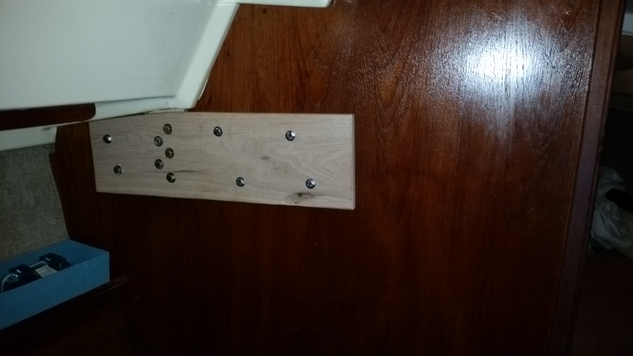

So, here's a little update. I finally got a chance to take an in depth look at the chain plate and bulkhead. As suspected previous water damage had done localized damage around the plate and bulkhead. Luckily it looks to be very localized and the remaining bulkhead is as solid as the day it was installed.
I decided to go ahead and place a bandage on the situation. I removed the damaged wood and replaced with oak and epoxy the anchored it with solid wood bracing bolted to the bulkhead which I will eventually have to replace unless anyone has a better idea.
I reseated the chain plate and sealed it on the deck which shows no sign of damage after the plate moved.
It ain't pretty but it's functional for now.
Any thoughts / suggestions going forward ?????
