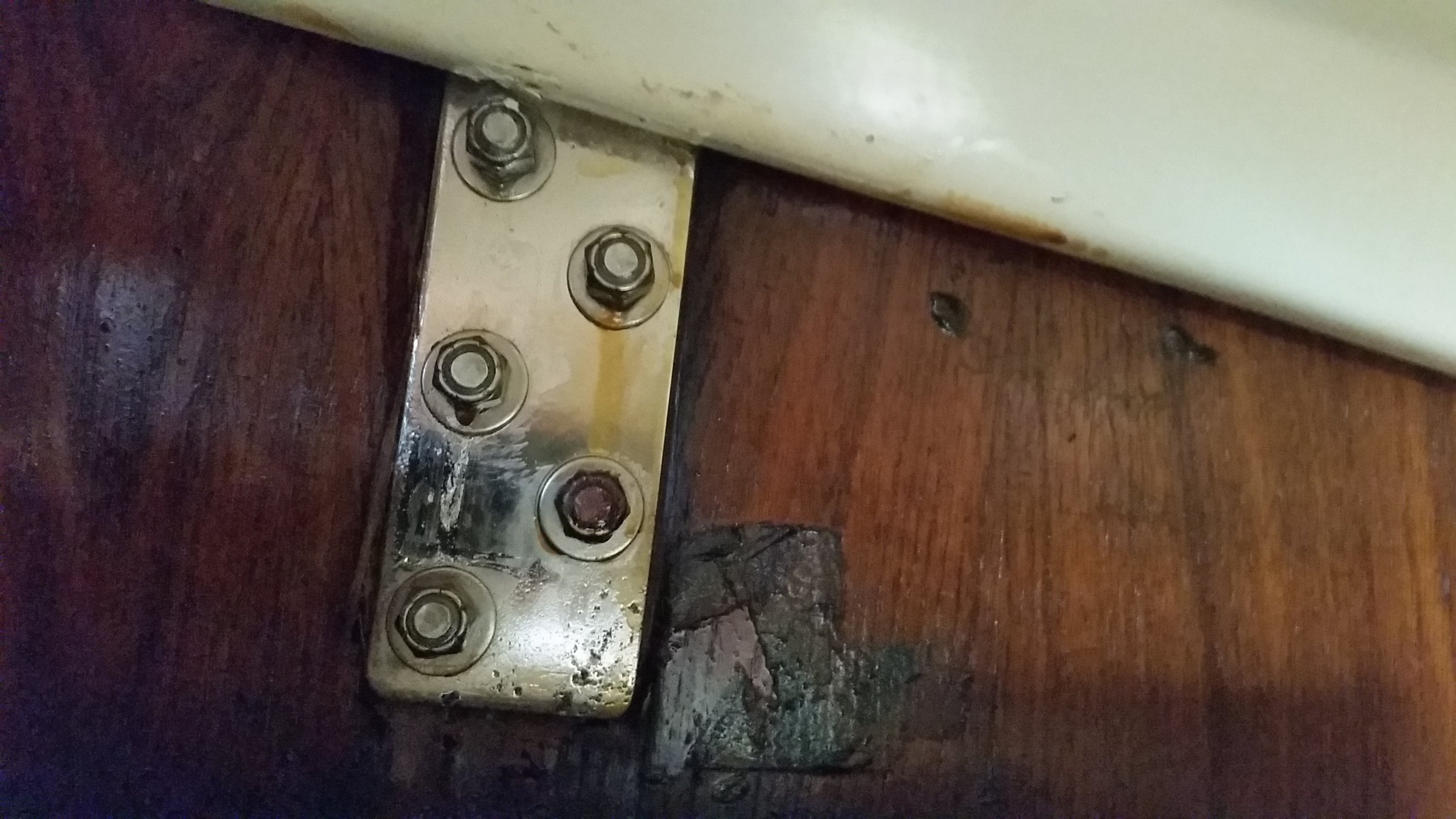

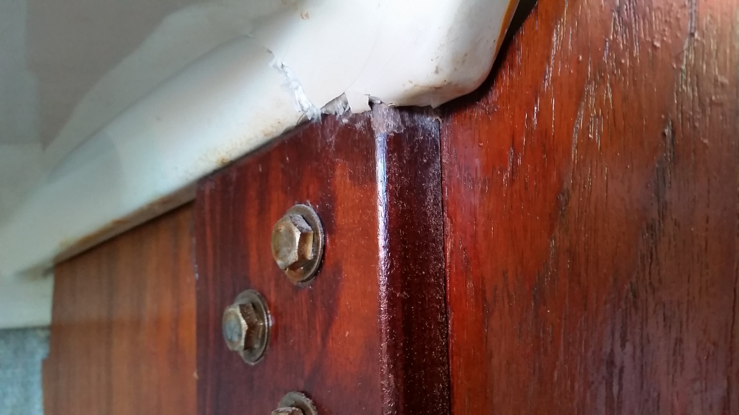

So I spent the other day at a steady 30-45 degree angle with a big 155 and full main spread. Very fun and lost rudder effectiveness on a few occasions but this was the unwelcome result. Port side stay anchor on my Hunter 25.5.

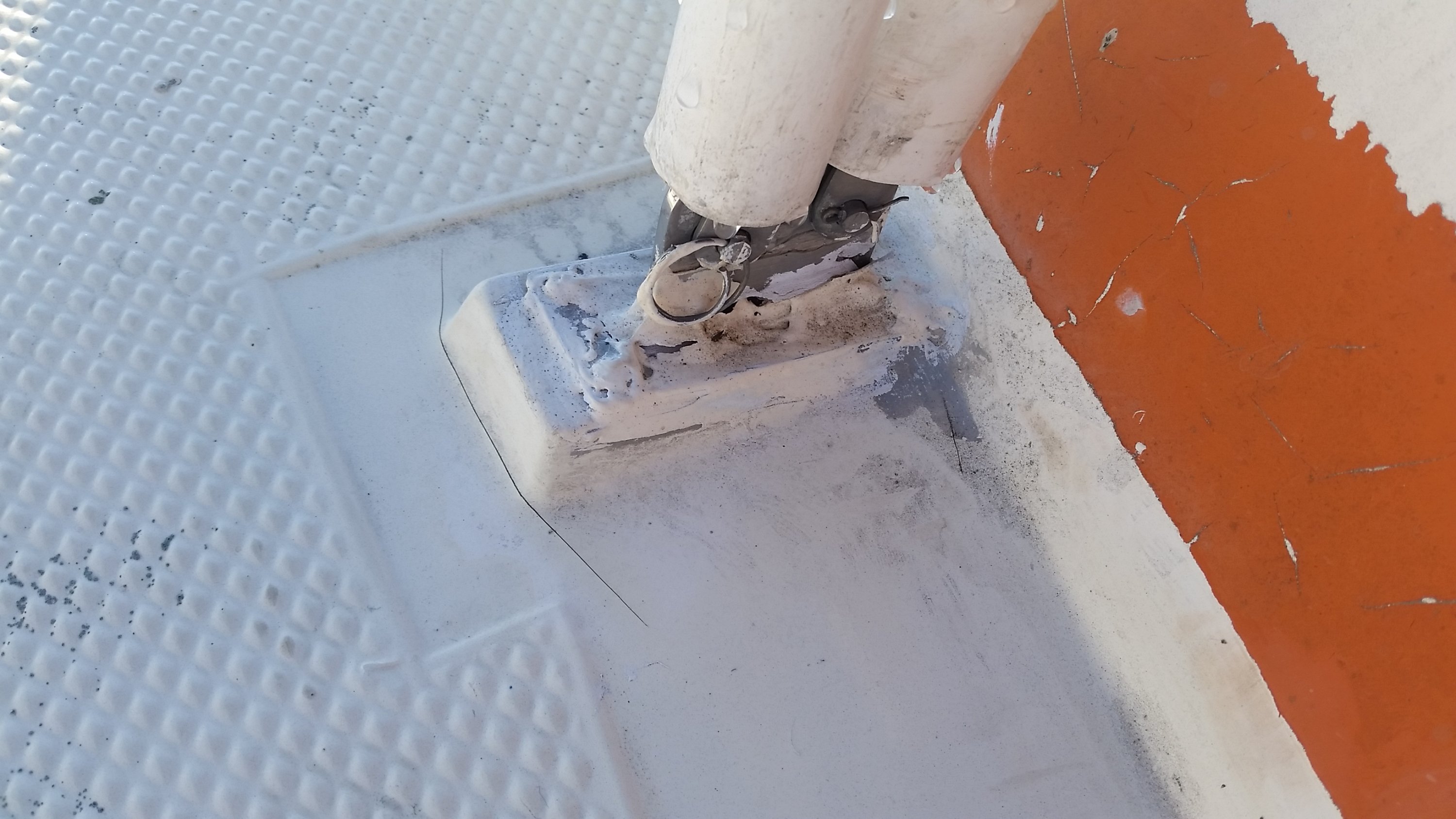

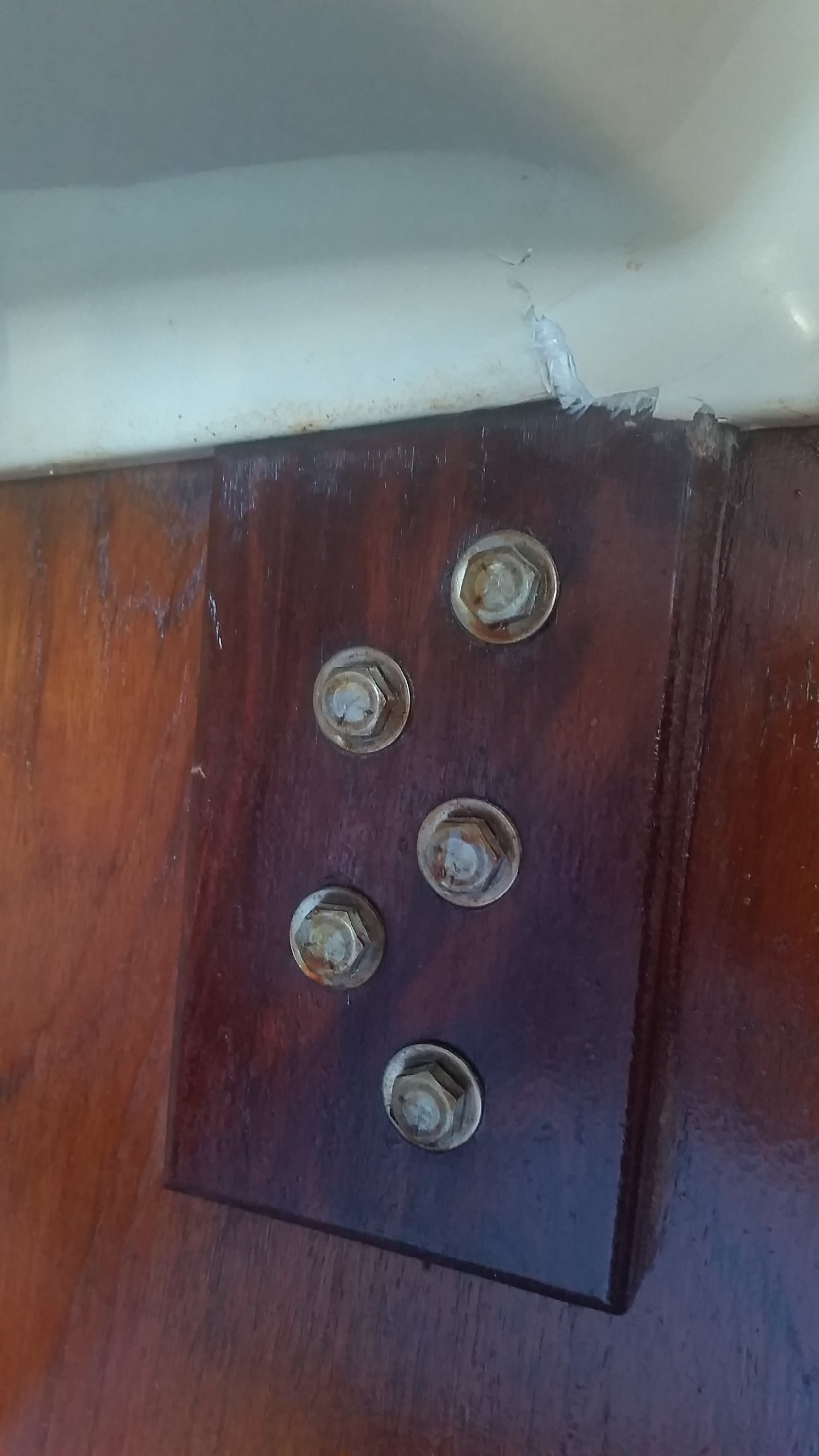

Outside deck has a slight cracking that doesn't look to bad but inside a decent sized crack in the fiberglass aft and other issues forward. Pictures show the damage. Looks like at some point had water damage on the bow side but appears
to be an older issue that was corrected (probably poorly )
Anyone have advice on repair? Cost estimates? Is it a DIY or professional fix sort of thing? Similar issues?

First of all... those are called "chain plates". If you use the terms "sailboat chain plate repair" you will most likely get some google/YouTube hits giving you a lot of visuals to help you determine the extent of damage and how to maker repairs.
Your bulk head appears to have water damage and it was repaired with the 1x4 shim on the other side. It butts up against the deck stringer.... It actually looks like it will hold... but the optimal solution is to replace the entire bulkhead to spread the load. There are videos on how to do that. You'll find out that removing the old bulkhead intact so you can use it to pattern the new one is the key to making it relatively easy. On deck, it looks like a previous owner painted right over the chain plate cover.. you should be able to lift it up to inject a flexible sealant... 4200 would work. Those deck cracks are a result of the chain plates flexing, I've seen worse though, Anyway, it's important that you be able to check the caulking easily in the future so don't paint over it..
If you have water damage to the DECK along with the bulkhead... you may have a more serious repair.... you can still do it your self, though. So... now that you know the terminology it will be easier to find articles and videos that will address your concern.... I think that's your safest path.
Oh, btw... if you sail your boat flatter... say less than 15 deg... it will go faster and handle better. Just sayin' a broach will not only stress the rig.... it will stress out your guests.

I think Joe is right on here.. Looks to me that the bulkhead itself, which is supposed to be the load bearing part, has been water damaged so that the shim is now taking the load and bearing on the under deck cross beam which has broken as a result of it not being designed to be a load bearing piece. the area can be temporarily reinforced with a much bigger shim to spread the load, and/ or another shim on the chainplate side of the bulkhead to better spread the load. The shrouds will have to be disconnected and the chainplate removed to properly do that repair. The rig will have to be loosened a bit to do that and a halyard will have to be used temporarily to hold the mast up while the work is done.. Again, as Joe says, if you search on this site for chainplate repair, you will find some helpful info.

As for the chain plates, there does look to be water damage on the forward bulkhead but it looks to be old and like I said, probably poorly addressed by the PO.
I'll have to check on the Web for videos assessing bulkhead removal but from the sounds of it, a professional will probably have to be contacted.
Does anyone have a diagram to how the bulkhead and plates are assembled? Finding info on this model is a difficult task as all there seems to be is basic information.

Leaks caused at the chain plate. If you will look under all that silicon and hopefully not added gel coat are four screws generally Phillips head. Take the screws off, lift up as far as you can that plate, remove all caulk and reseal with new caulk allowing it to ooze out. Wipe off access and let dry. This will be a maintenance item from time to time. Can you take a better photo of the underside of the deck where the chain plate is? I am trying to determine if that crack on top in the gel is only in the gel coat. Better yet, determine with something very thin how thick that crack is and if not far, then gel coat only. The structural item is the bulkhead and advise if it is soft and or wet around the interior chain plate. Also post another photo of the other side of the bulk head showing the nuts with close shot of the left side as I am thinking I saw something there. Not those nuts the squirrel is putting away for winter. Ha Ha had to throw that in.

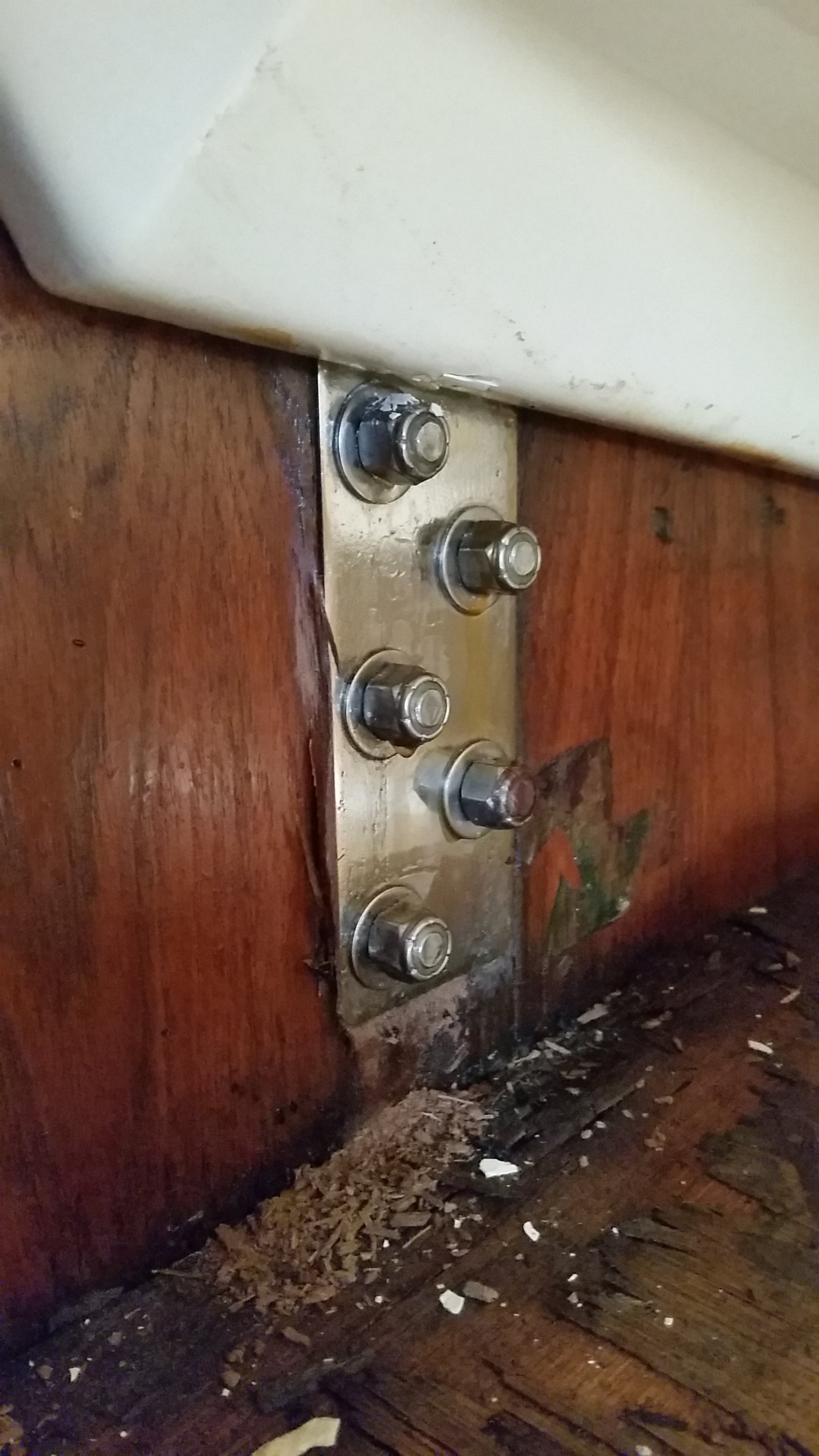

Here's a few more pics of the damage. There is no other visible damage other than those pics. The chain plate is facing forward of the bulkhead while the wooden part (it's the same setup on the starboard side) is aft of bulkhead and has lifted into the fiberglass ceiling causing the cracked fiberglass. Outside it appears to be no more than a gel coat cracking. And yes, the PO has done a poor job sealing and painting over stuff I would not have done.

All seem solid around the chain plate - no soft spots. I paid special attention to this when looking at the situation which is why I thought the issue was superficial.

Look at the chain plate on the side showing the nuts at the bottom of that plate. Am I seeing correctly that the plate or ss backing plate moved as I see gel coat fragments on top of the nut with possible movement as I see discoloration on the bottom and to the left as if that plate moved? There is a Hunter or former Hunter dealer still in the area who would know what to do. First, lets get a little more information.
One of the chain plate is a solid piece going up to the tangs that is bolted on the other side with a backing plate only without protruding outside. If your mast is up, you could take your jib and main halyards securing them to the side affected in order to remove those to see what is going on. If you want to talk with me, then send a private email with your name and phone advisising Lanier and shroud chain plate issue which then I know what it is about. Your information is very private.

John, good call on that chain plate. I wondered about that but going back and rethinking, now that chain plate needs to come off. I suspect serious damage may be hidden. What I am not sure if the bulkhead where glassed to the hull is firm and holding. It may appear that the chain plate has also shifted sideways as well. If I remember correctly and I may be wrong, that marine ply fits up into ceiling line pan flange for it. Could be wrong but suggest stop sailing until that is looked at. Dutchman, have that checked out before you go back sailing. ;I do not feel good about that. Please understand that I err on the side of safety and you cannot replace yourself sir.
Ed was gracious to make some suggestions of others for you. Take a photo of where the bulkhead flange would be tied into the hull for us.
