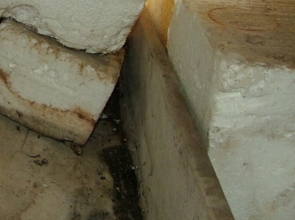

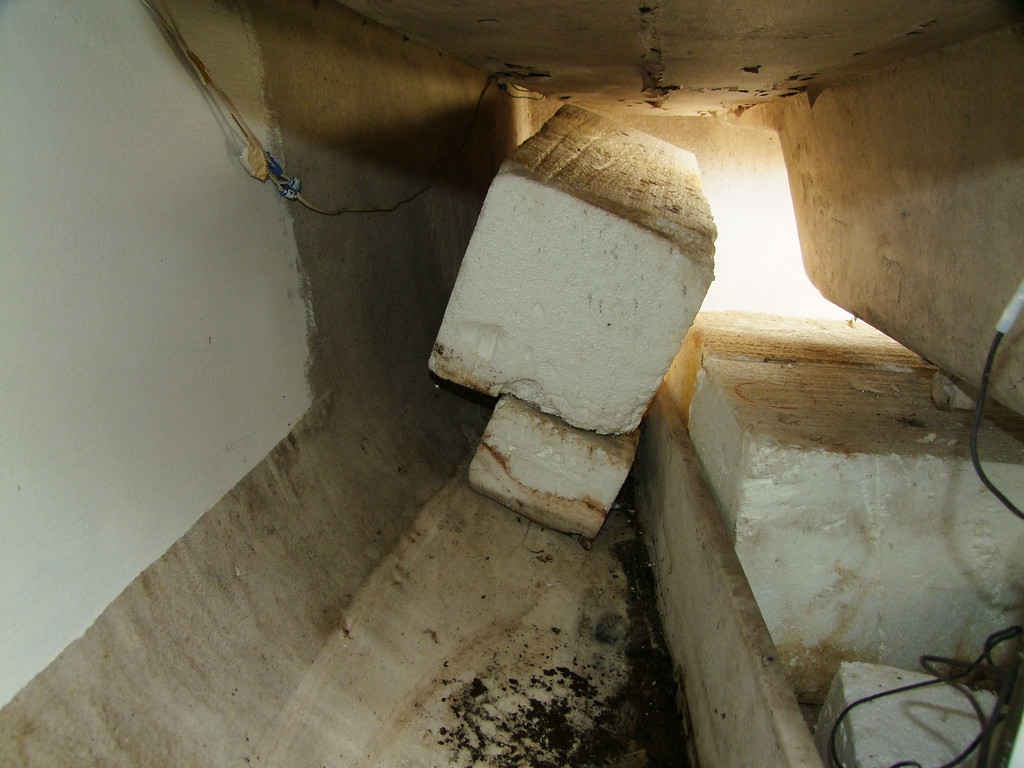

OK , can you tel me what you looked for on the hull id "holes" and exactly where you looked, I still have not found mine.
Apr 23, 2010
136
Venture 2-22 Oneida Lake
On the V222/22, the ID numbers(holes) are located on the starboard side stringer, under the cockpit. You should be able to see the numbers from the dinette; they're not very far back at all on the stringer.
Smithy
Dec 13, 2010
162
Macgregor 22 Alexandria, VA
Chock is right - but mine are a ways back there. I didn't get a good pic of it at all.
Tucked down next to my foam... just holes drilled in the stringer, in the shape of numbers...
Good luck.

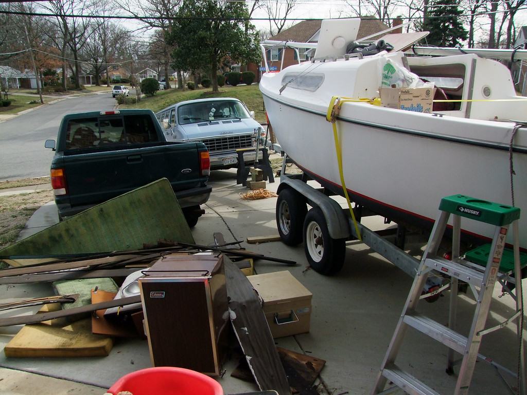

You might want to remove the pressure on that yellow strap and be sure that the keel is resting on the trailer and not the winch to avoid hull damage.
Smithy
Dec 13, 2010
162
The strap is taut, but not tight, at the moment, and yes, the keel is on the trailer, not suspended. Thanks for pointing it out, though.

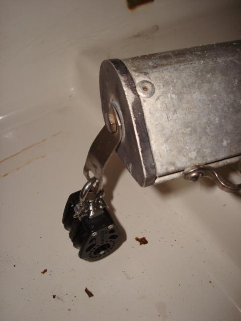

Sep 4, 2010
115
MacGregor Venture 25 Ocean Grove, Swansea MA
I was able to get on my boat today to look at the boom and blocks, and it doesn't look quite as loose as yours. I took a picture for reference...Copy of DSC07784.jpg
Smithy
Dec 13, 2010
162
That is exactly what I would have expected - enough room so that the block tang can rotate freely, but without excessive play in the system. Time to drill rivets, I guess.
13,020
I have a rivet gun. Alexandria is a bit of a drive but if you ever plan a sail at Smith Mountain Lake, I could put the rivet gun in my boat and meet you. Or you could put a through bolt, or machine screws.

Aug 15, 2010
376
MacGregor 22 Hilo
Pink 3" foam boards at Home Depot.:)
Yeah. Whatever kinda foam those boards are. :laugh::laugh::laugh:
(Inside joke recalling an old thread. :) )
Seriously though, the pink boards will work really well as floatation.
BTW, SML has an xlnt camp ground and camping site 31 has a finger of water that buts up to the back side of the camp site. Been there with my boat. Would make a great place for a scout trip.
I have a pop riveter, but I think it's a little undersized for this job. I don't have a problem using screws, I'll just blue locktite them into place to prevent any backing out too easily.
