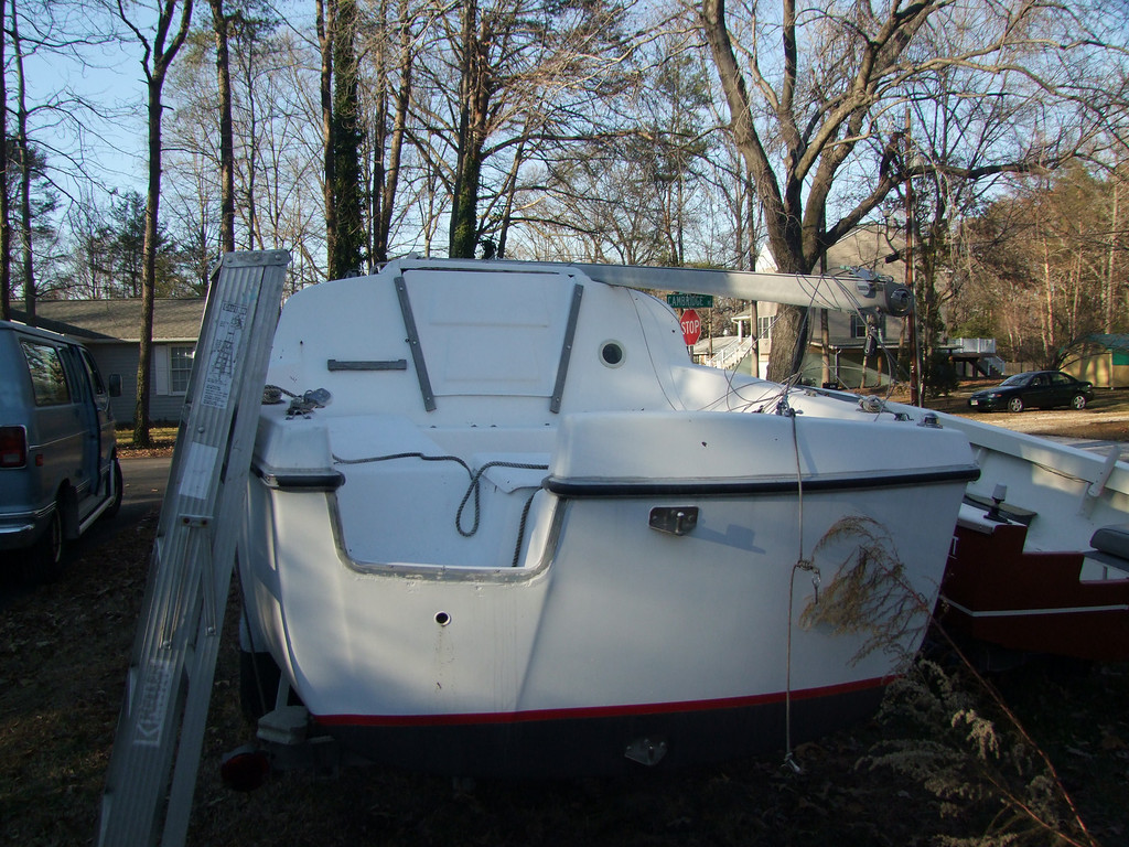

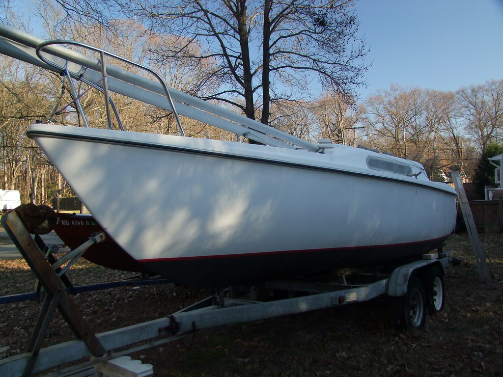

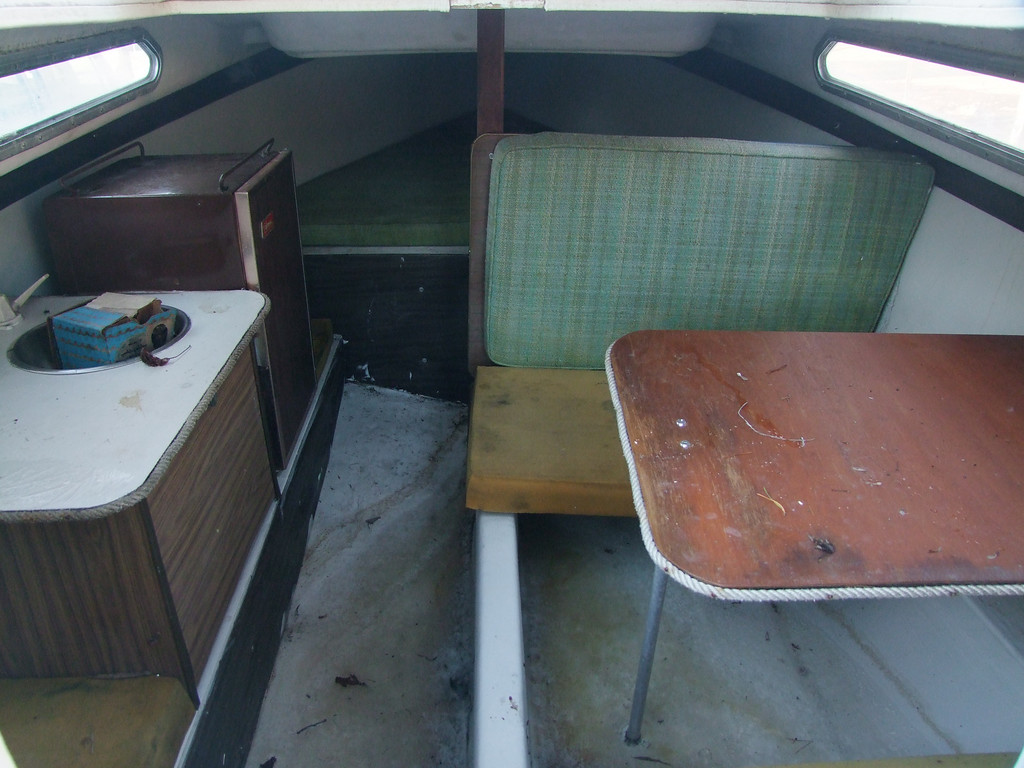

Brought home a boat today, a Macgregor 22' swing keel. Price paid, $300, includes boat, trailer, standing rigging, 2 sails, and a whole hell of a lot of work ahead of us.
The interior will need a complete stripping, cleaning, and rebuilding.
Yeah, that's ice down there.
In my defense, it's mainly for use by the Scouts I work with, and they'll be providing a considerable amount of the labor in this project. As the only guy in our unit who actually knows how to sail, though, I'll be on it quite a bit this year.
Wish us luck.
WOW!!!! 300.00 YOU DID GOOD!
I gave better then 3 times that for mine (1971 V 22) and your interior looks like a 5 star hotel in comparison!!!

Looks like mine
Well, you've certainly found the right place! Like you, I'm restoring a Mac 22 (78 model) and I've found the folks at this website to be extremely knowledgeable and willing to help new owners get their project into the water. Couldn't be doing what I'm doing without them. :dance:
Congratulations on your most excellent acquisition! Isn't this the same year / model as in the book FIX IT AND SAIL? (My copy's down in the car, it's night, raining, and I'm not going to go check right this moment.) If not, it's almost the same. If you don't have the book, and nobody's recommended it yet, you might want to get a copy for reference. I found it very informative, and a lot of fun to read at work when the boss isn't looking. :)
Good luck with your project, and to echo what's already been said: TAKE LOTS OF PICTURES!
It's getting near Christmas and I'm working straight through, so if I don't get back here before then, we wish you all a happy and safe Holiday Season.
VBR,
Pat
This one looks identical to mine except for some interior mods. Its a Venture 22. That model has the dropped down stern for the motor was what I was told. I at first thought it was for a swim ladder. LOL Mine is a 1971. They changed the company name to Macgregor later.
