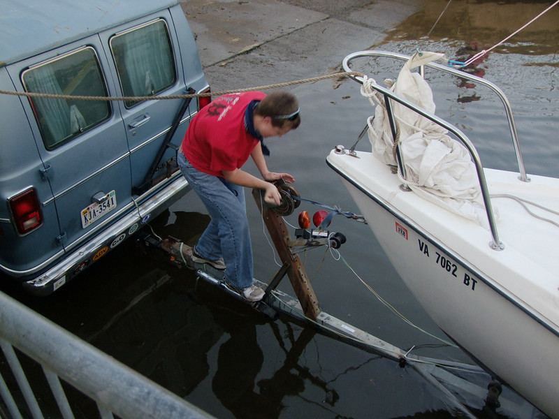

So far, while trailering, my mast is tied down hard to the pulpit and at the hatch/companionway interface... nothing supports it further back than that, and I've not seen a problem yet. I should look into a masthead support for use on the road, I suppose.
I'm happy to report that the crutch worked great for getting the base locked down far easier than last week's attempt. Turned a 20 minute exercise in frustration into a 2 minute exercise in satisfaction.

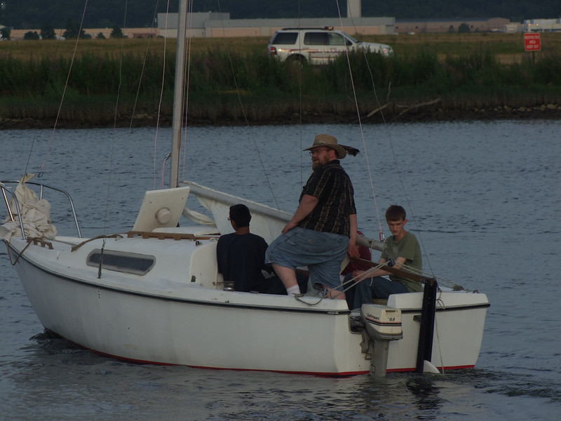

Out in the river, trying to get the keel down (another story):
It's good to have minions at hook-up time:

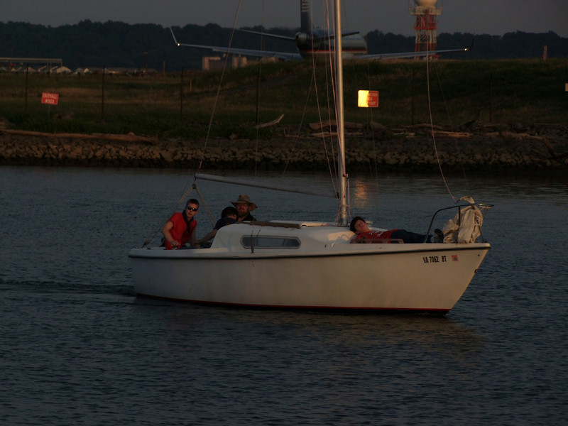

Returning by sunset:
I didn't raise sail, because we couldn't get the keel locked down. Our first attempt ended with a grounding, because Gravely Point is a rather shallow inlet, and we weren't out far enough in the river. The second attempt failed, because of the headway I was making with the engine... I think it was keeping the keel from fully dropping, so my first mate couldn't get the hole lined up. Since we were short on time and I hadn't put 2 and 2 together yet on the boat speed being the cause of the problem, we satisfied ourselves with the gentle evening cruise by motor.
