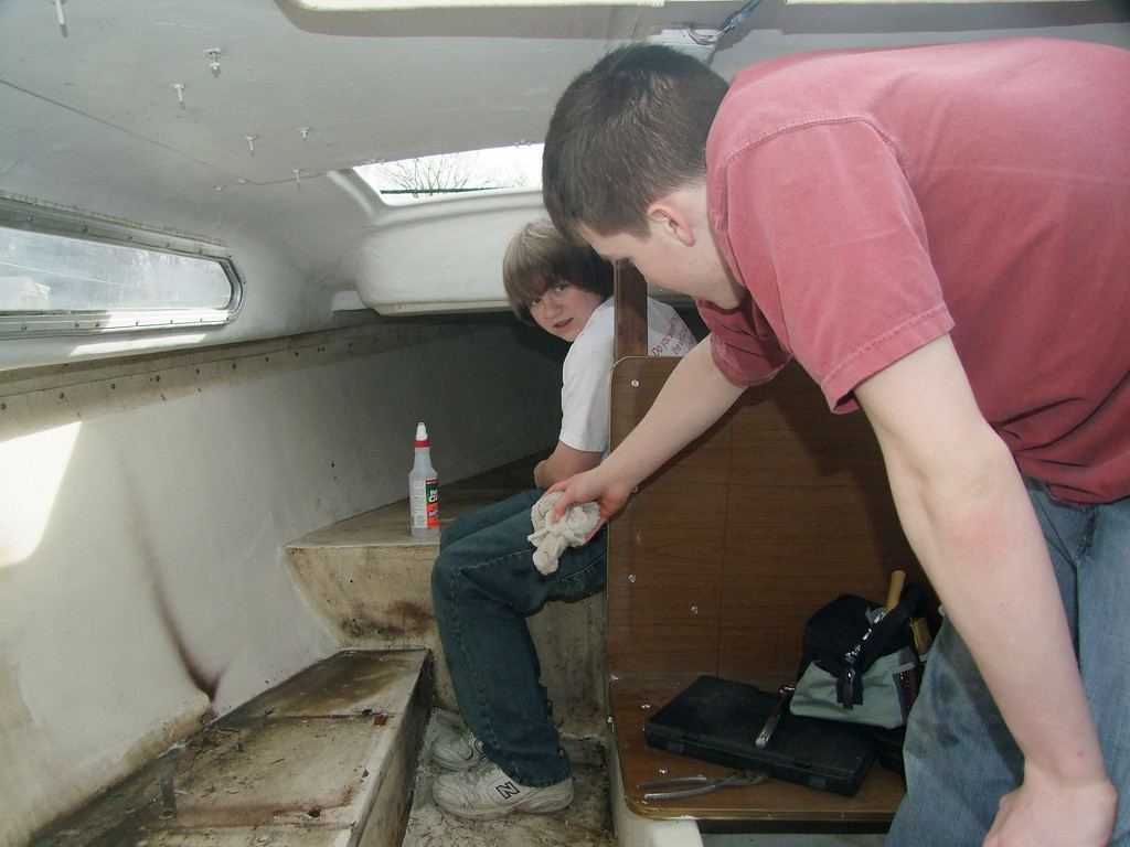

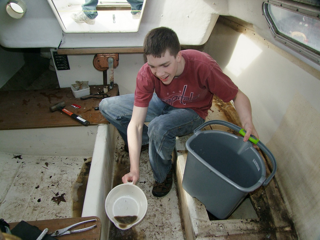

It's been so cold most of the time, I hesitated to send boys down into a frozen bilge. With a couple weeks of favorable weather now, and a forecast of a clear cool day, I sent out a call for volunteers to work on our little craft.
Here's what we pulled out, for the dump:
Pulled all the old cushions, rotted out trim, the "galley" and upright cooler, old tilt-bowl porta-pot, and some random lumber that was tucked away in the starboard quarter... and what was left of the rusted out battery mount. Full pickup load.
A lot of scrubbing was involved, to get the funk of nearly forty years out of there:

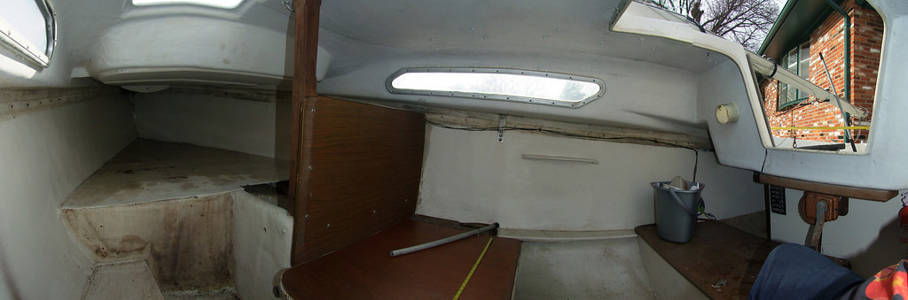

Here's an interior panorama in its current state:

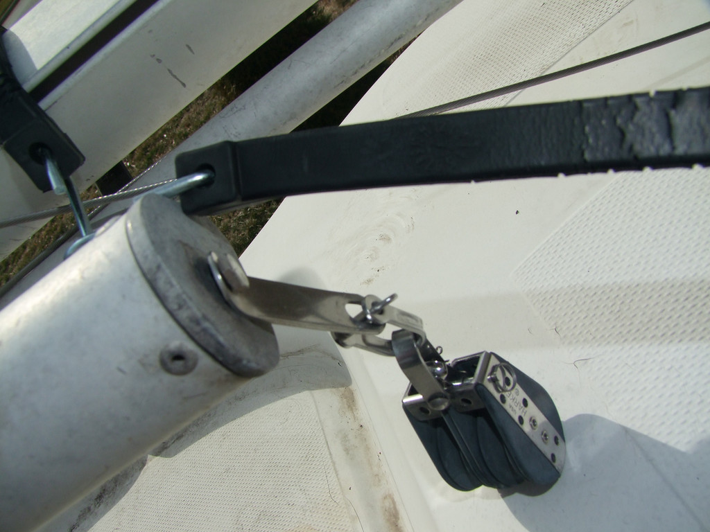

One thing I noticed today, that bothered me, was this:
The boom-end. The bolt holding the hardware on is neither holding it flush with the end, nor is it fixed - it rotates freely, but without getting tighter or looser, as if there's a nylock inside, but not fixed down at the proper tension.
I'm unsure if this is safe and proper, or within my power to fix... has anyone else experienced this?

The tab on the end of the boom is identical to my '76 V25. I also thought it was a bit loose, but it needs to be able to swivel around freely in order to work properly. So... I think that's how it's supposed to be (but I could be wrong - I've never noticed this on anyone else's Mac (I've never looked)).

I get the "needs to swivel freely" part, but the fact that there's -so- much play in that bolt still concerns me. It's not rigid to the axis of the boom, either - there's about 10-20* of off-center play on that bolt as well as the free spinning issue. I would think in a part that can experience such shock loads, this would be a bad idea.
But barring perfect knowledge of the design, it's impossible for me to say.
And btw, it's a '72 V22, non-poptop, hull number 637 I think, if I read the holes right yesterday. It was an awkward stretch.

If ya just gotta then drill out the rivits and pull the plug and tighten the nut a little but only after you have sailed the boat for a bit to be sure you need to.

I'm happy to leave it alone if I can get a good sense that this is normal, I just wanted to make sure first.

My '72 V222 doesn't have quite that much play at the end cap tangs. Also, mine has two (one for the mainsheet block, one for hanging the boom on the backstay) tangs.
Drilling out the rivets is easy, and you can use stainless steel self-tapping screws from any hardware store to reattach the cap. If you leave it just the way it is, though, you'll probably be fine.
