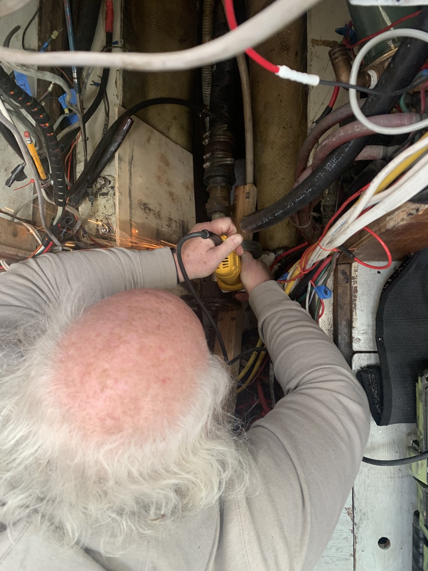

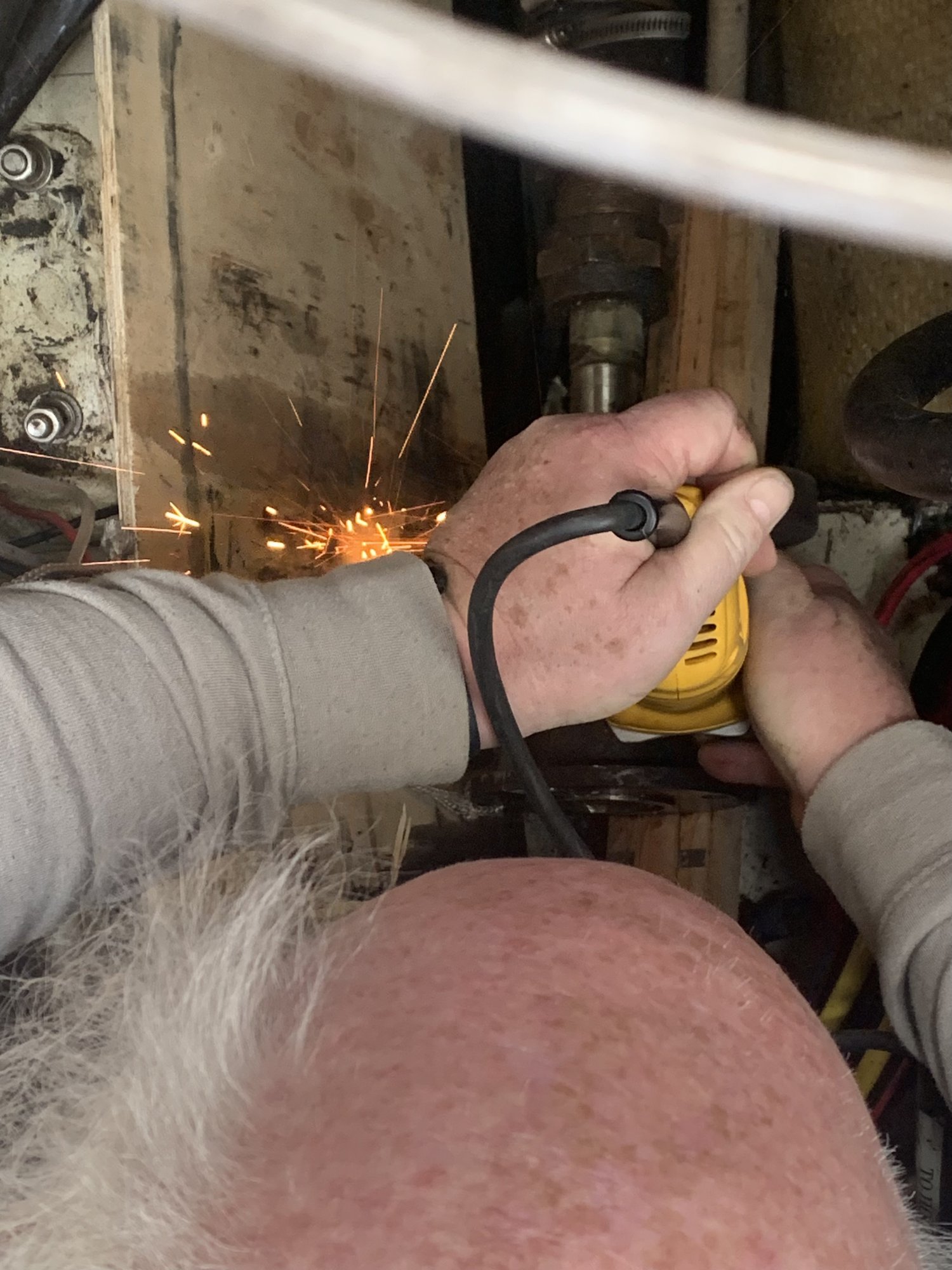

After I had arranged a board to lessen the sparks from starting a bilge fire, and managed to cut through about of third of the shaft, Les wanted a turn.
Here he is rotating the shaft to get some fresh meat to attack
And then the sparks really begin to fly.

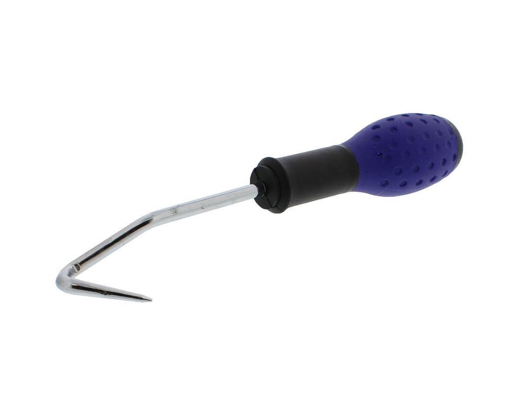

In short order we had sliced the shaft into two pieces. This permitted removal of the shaft sliding it out and past the rudder. The Shaft log hose and stuffing box were easy to remove. My efforts were aided by the use of a hose puller.
A great tool to loosen the vice like grip of a hose on the shaft log after being secured by hose clamps for who knows how many years. Should be in every boaters tool box.

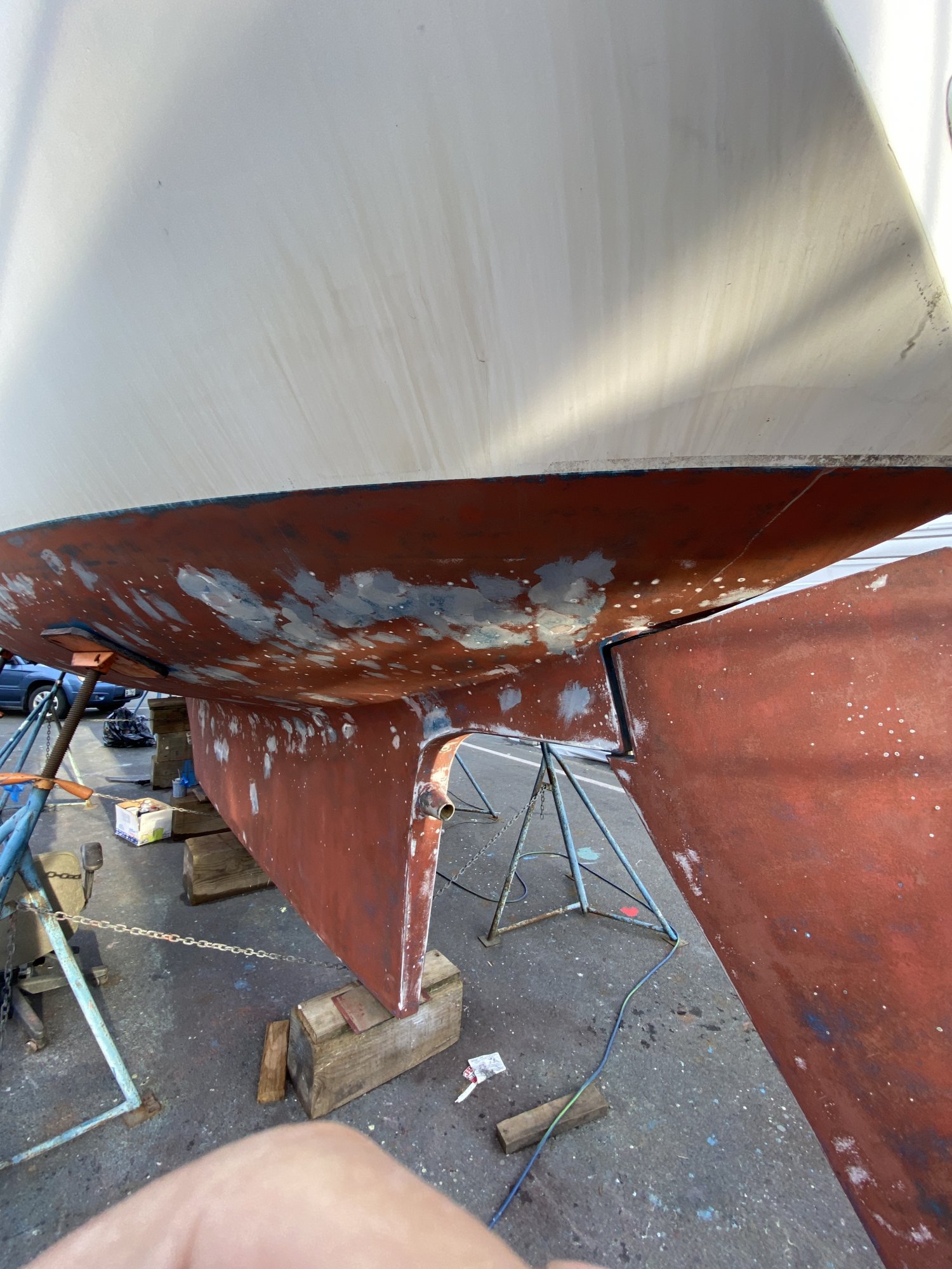

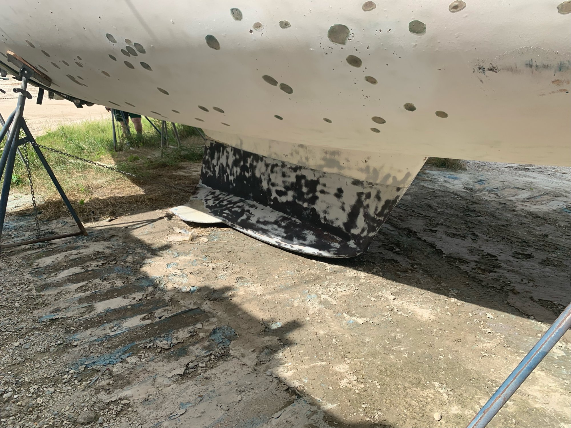

On a good note, the sanding of the old bottom paint is finished. Next up are the blister repairs, some thickened epoxy, sanding fair, a coat of barrier coat, then the bottom paint.

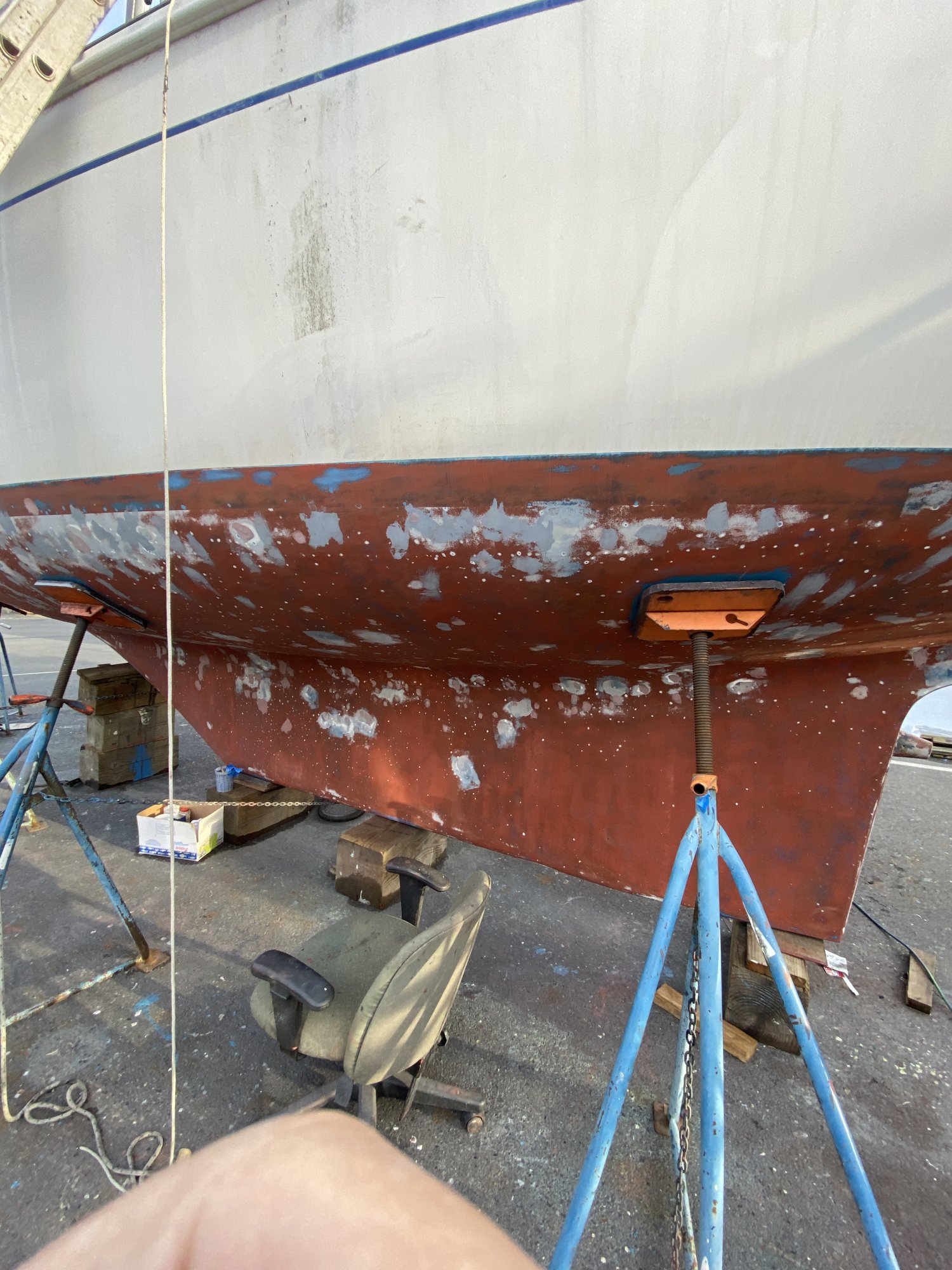

The work on the bottom is progressing. The blisters on the Starboard side have been ground, filled and sanded.
They are awaiting a couple coats of barrier paint.

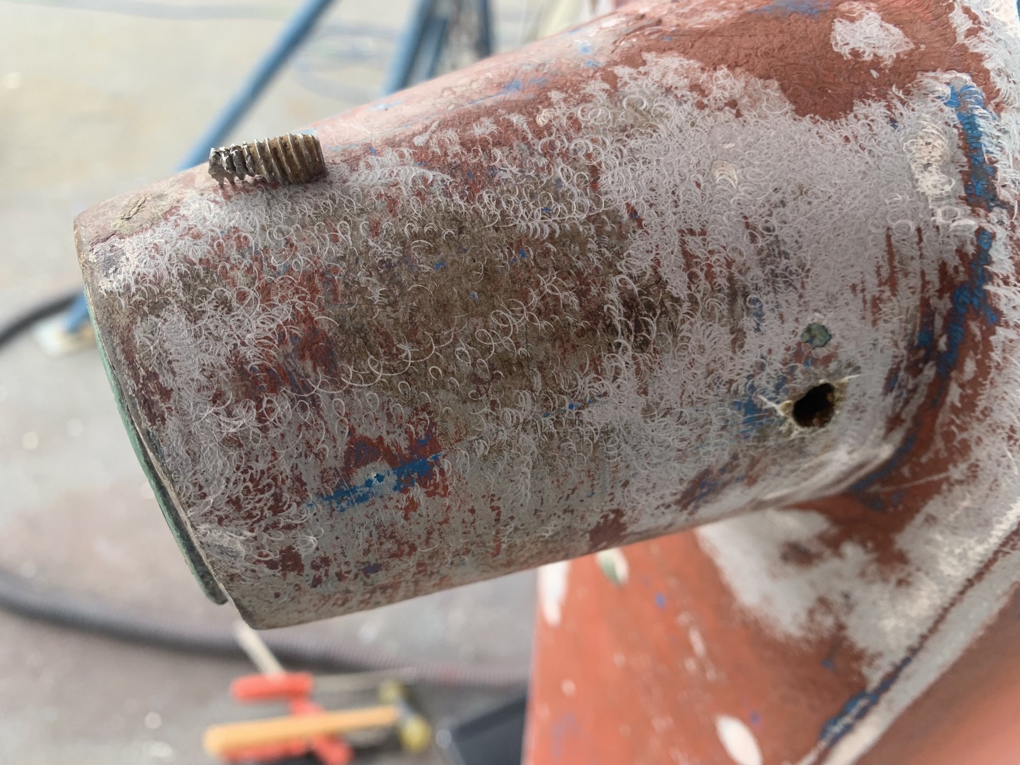

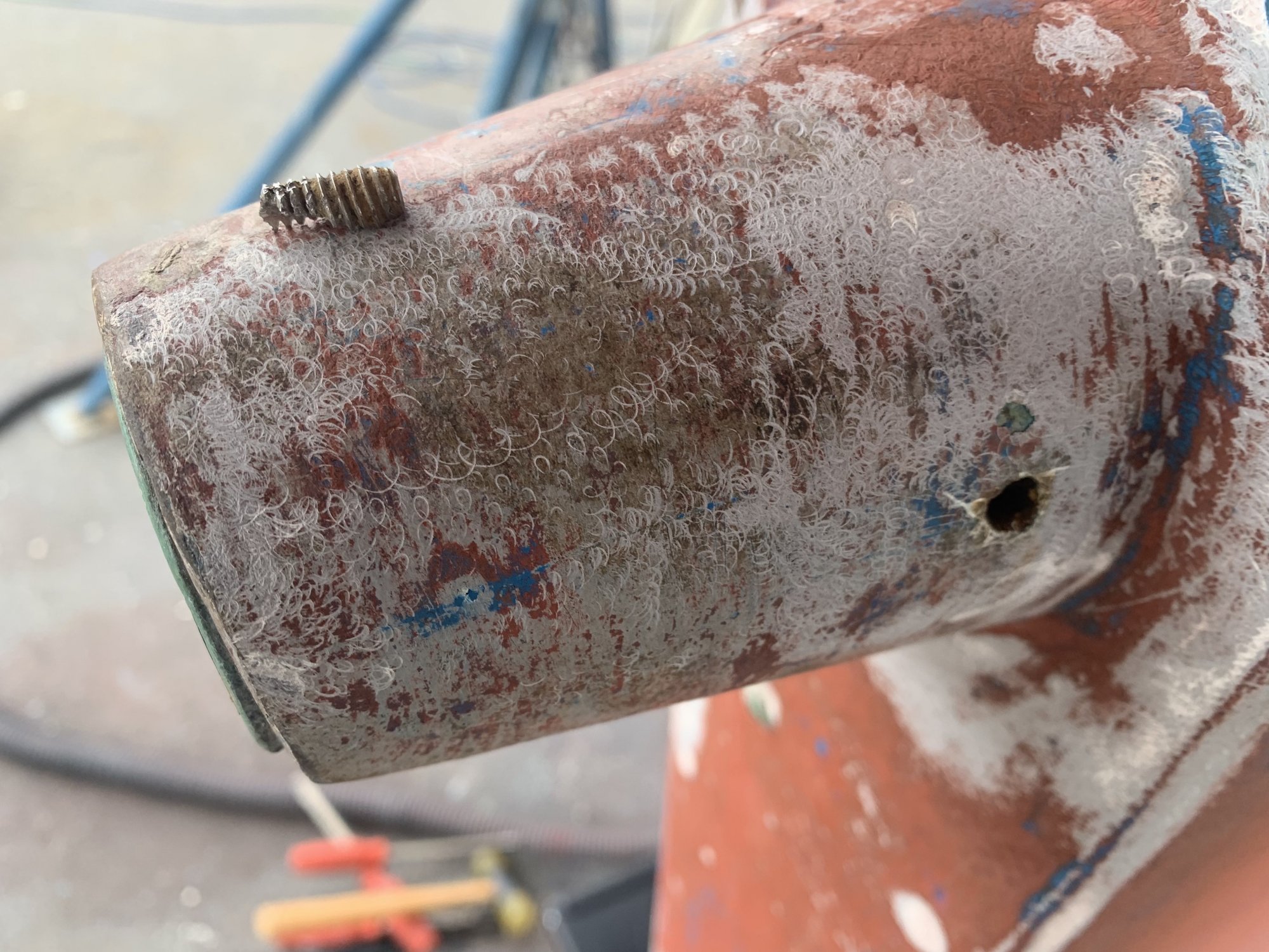

Next project. Extraction of the cutless bearing. My set up is different from the strut cutless's on so many Hunter's and Catalinas. It is a Stern tube mount. This means no cutless bearing remover. We have to resort to a more brutal method.
This cone of fiberglass holds a 5.5" long cutless bearing. The bearing is 2" OD and supports a 1.375" shaft, bearing ID . There were 2 set screws that could not to be simply extracted. One looked to be made of cold steel and corrosion dissolved, the other was stainless, with the allen key head destroyed. We were able to drill it out. This gave us the thread size and screw diameter.
We rebuilt the holes with JB Weld and tried to create threaded holes to use for the new set screws. The ones we removed were just in the fiberglass cone holding the cutlass bearing.
I'll be heading up to the boat later today to check on the repair and pick up the new cutless bearing (CB).
Removal of the CB was accomplished by using a sawsall and a 9" metal blade to slice through the CB rubber and brass shell. Once cut the shell can be folded inward reducing contact with the shaft log tube. I then used the old shaft from inside the boat to push out the CB. A few hefty wacks using the shaft like a slide hammer dislodged the CB

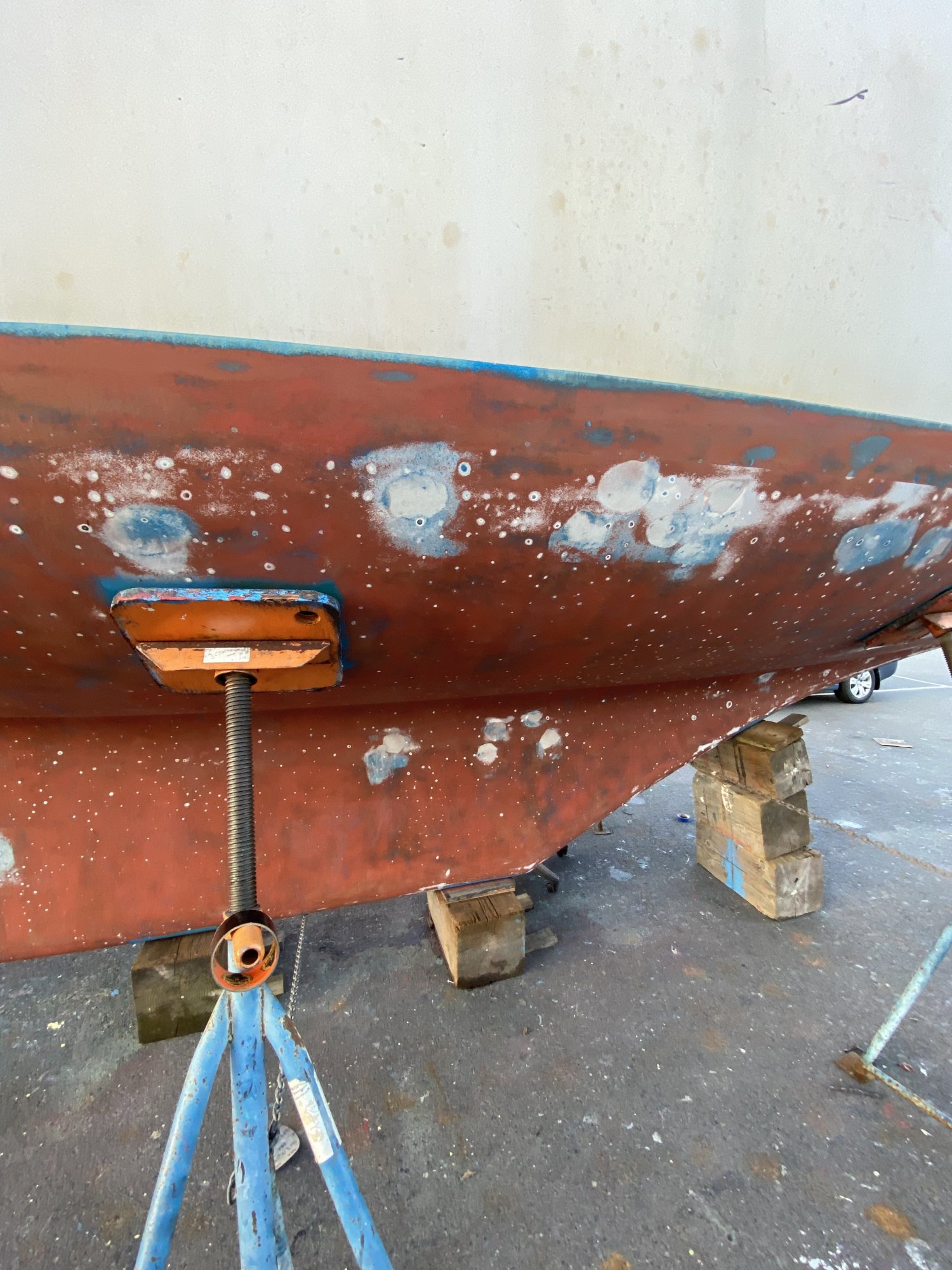

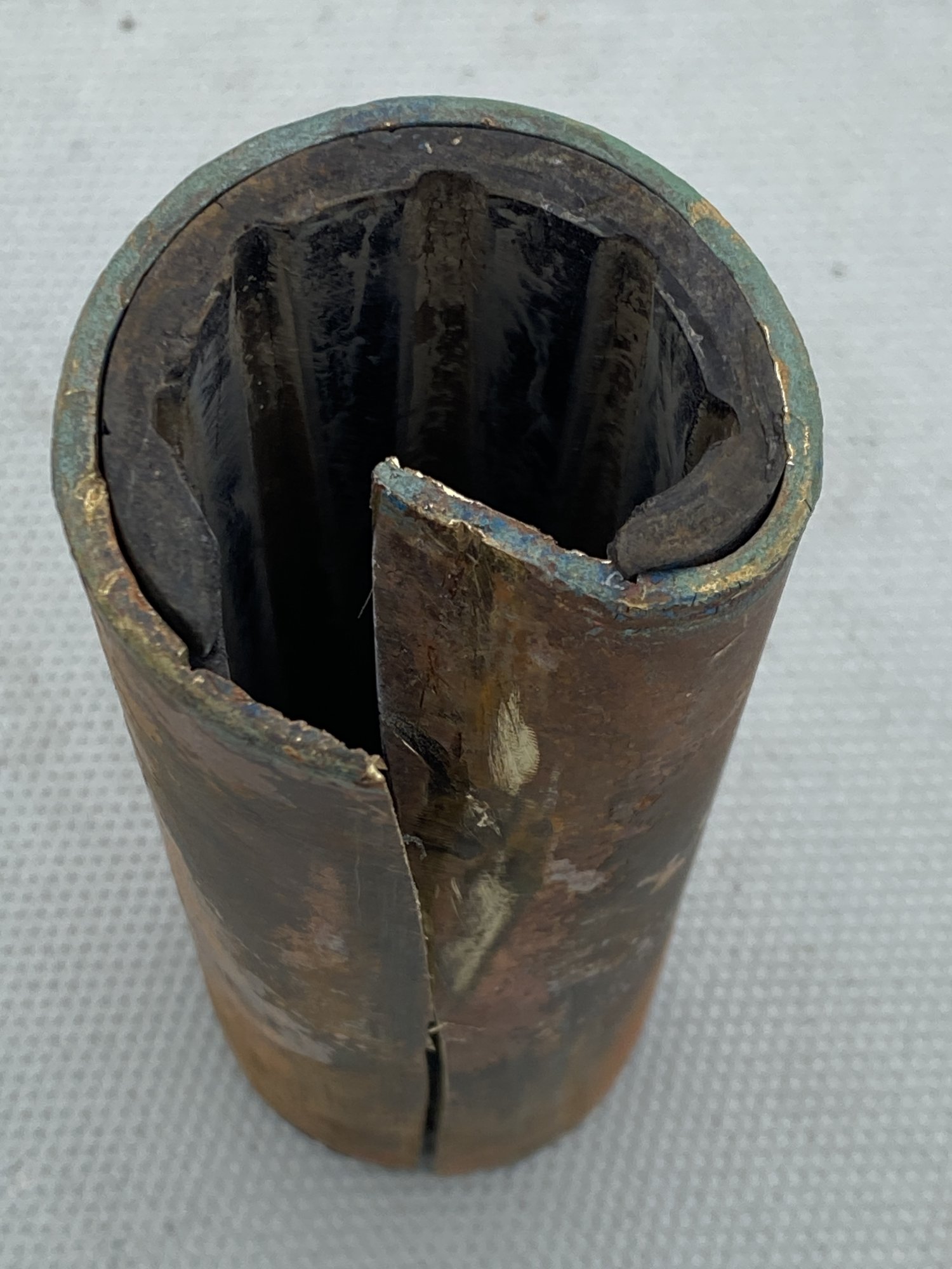

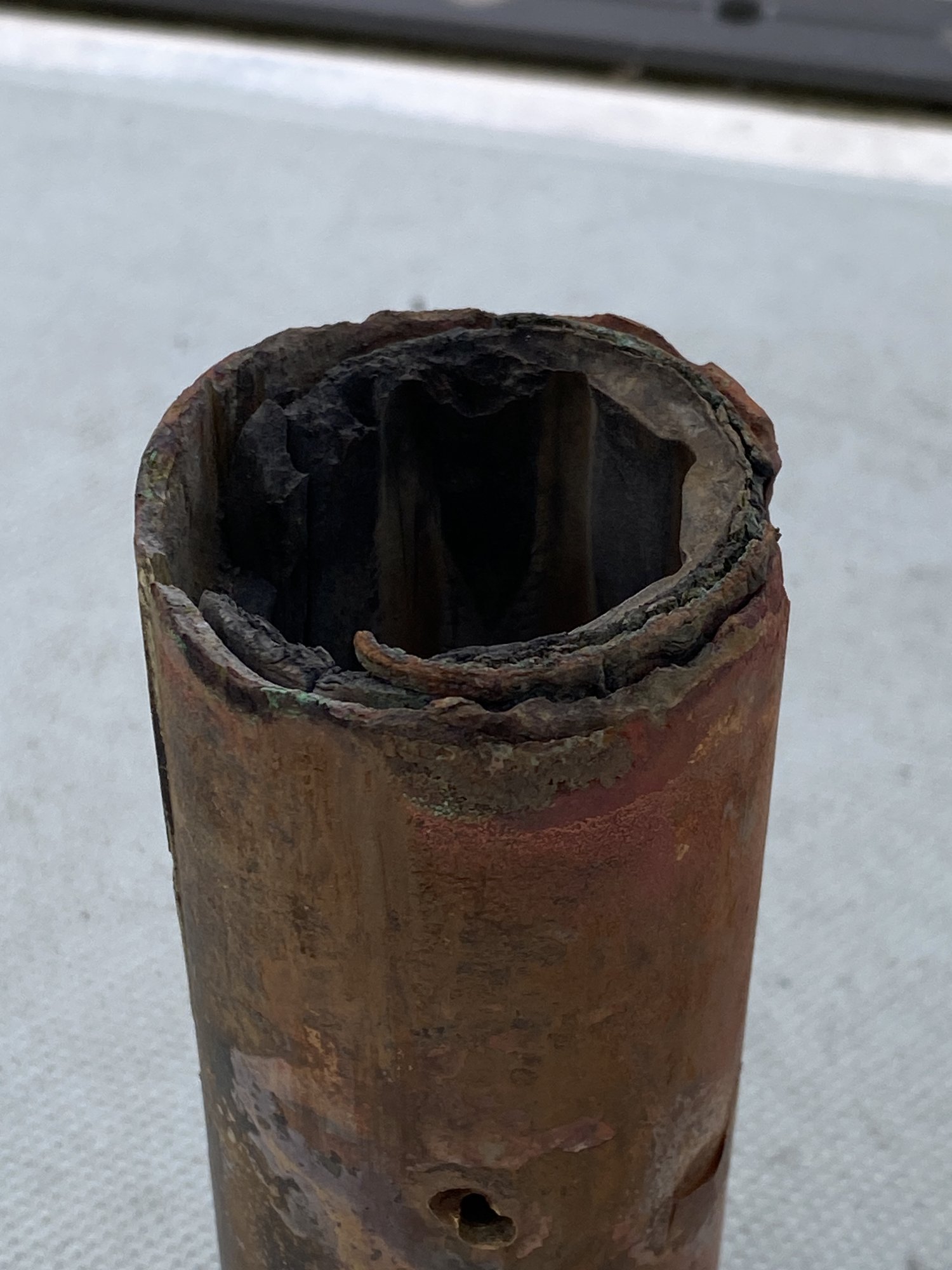

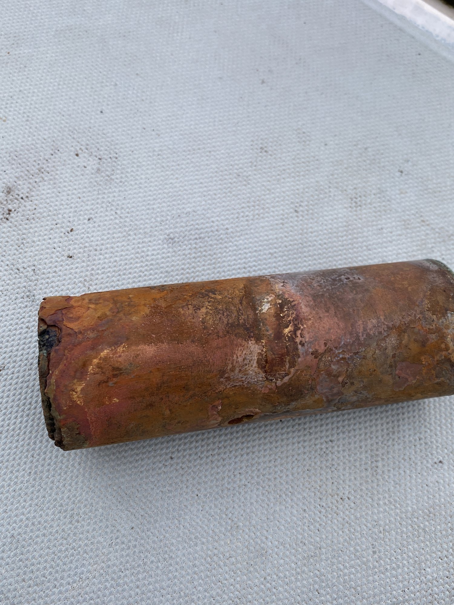

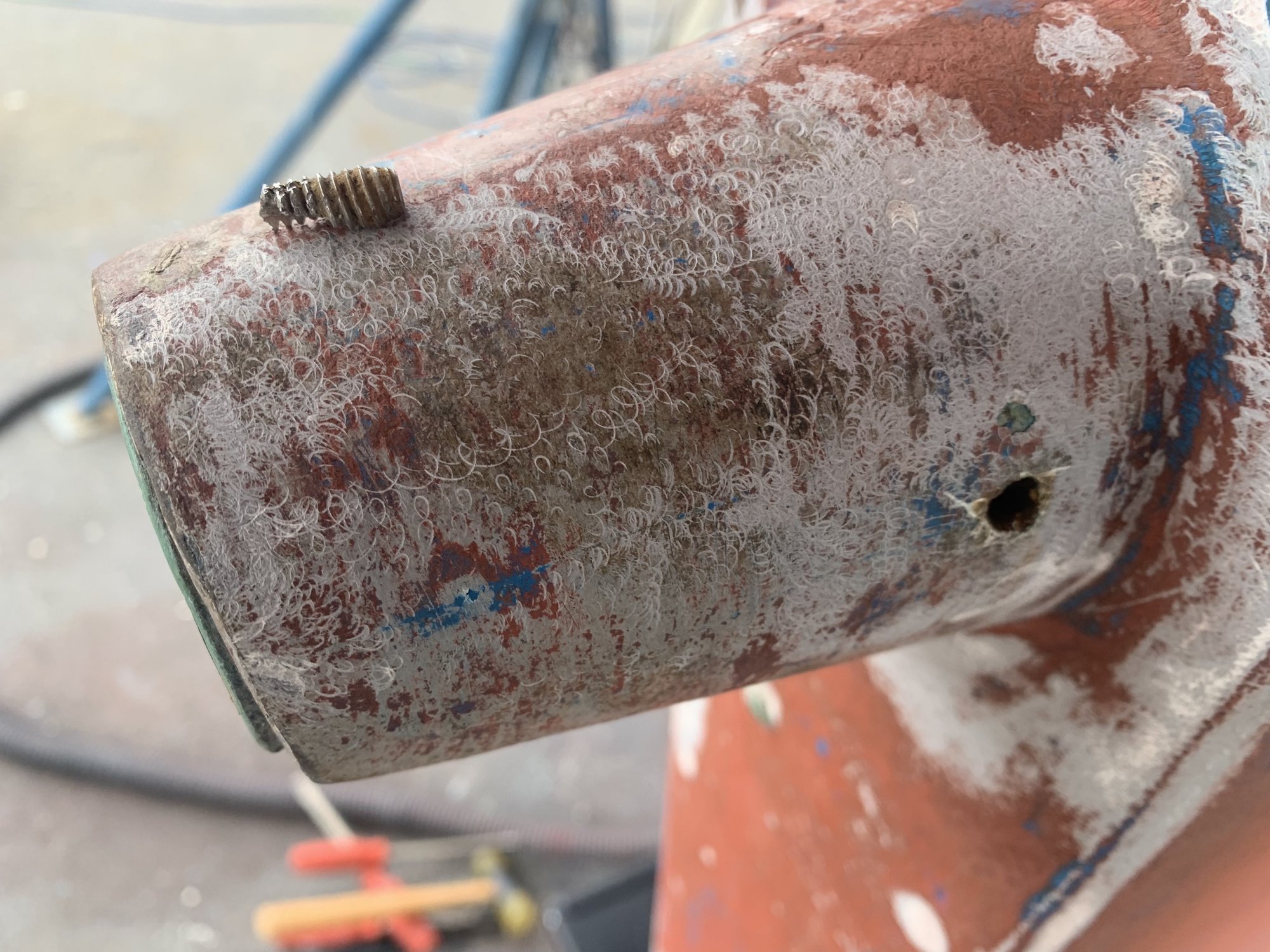

The mangled 5.5” cutless bearing was no match for a Harbor Freight $59 sawsall and 9” metal blade.
A slice through rubber and metal and screwdriver tapped in to ease the brass from the shaft log. We then used the old shaft as a slide hammer and banged the CB loose and it slid out the shaft log.
It was definitely time for replacement. The pink patina and missing metal is an indication of corrosion activity at some point during its life.
389B3234-B159-49A3-A6E5-3D2616DA6455.jpeg DC25FFFC-FEB8-43E5-B513-931DC0DDE239.jpeg
External inspection did not indicate this deterioration. The shaft felt solid in the shaft log. No signs of lateral or vertical movement when testing the prop and shaft.

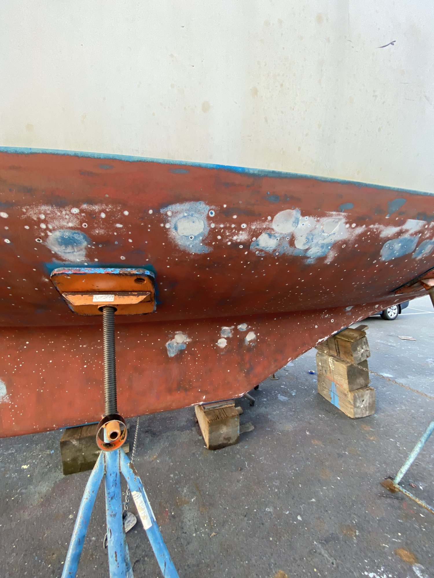

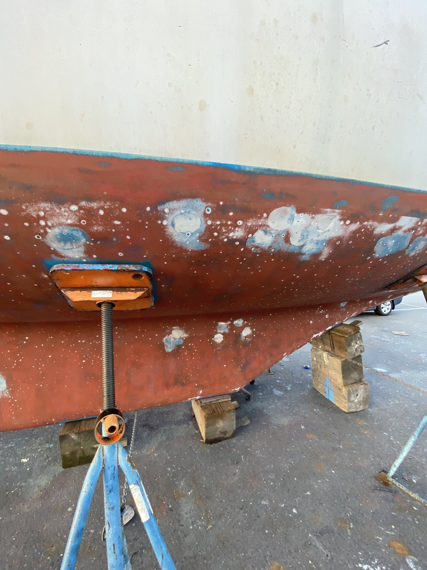

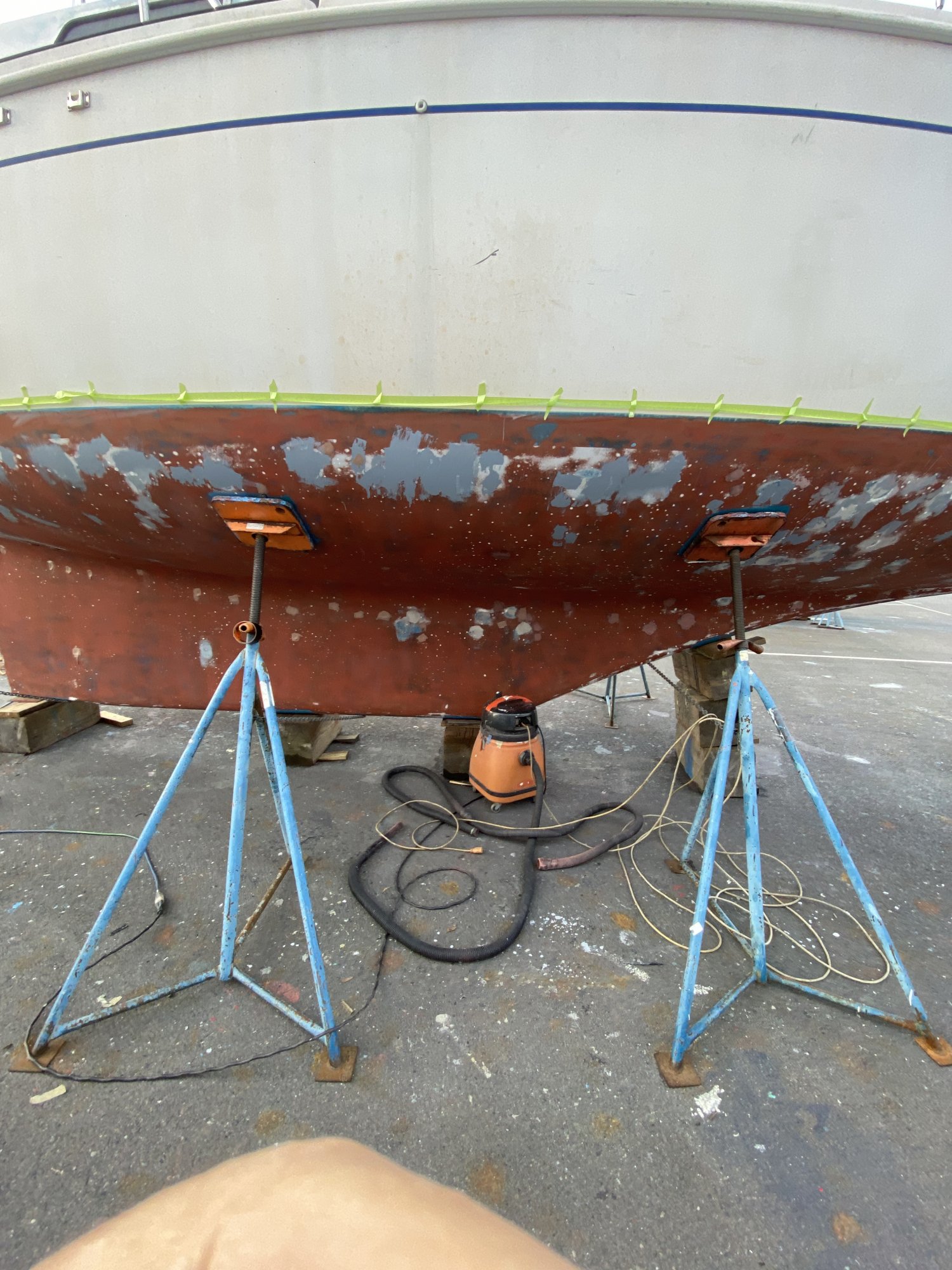

I am back at the boat this week. After waiting out 2 snow storms... Nasty wet cold ice/rain for several weeks. I consumed the month of February with little to show. Today was 52 degrees and mostly sunny. The patches of the blisters has been completed. The have been filled, and sanded smooth. The paint guy was at the boat today prepping to have the braces reset so the paint can be applied in the next two days.

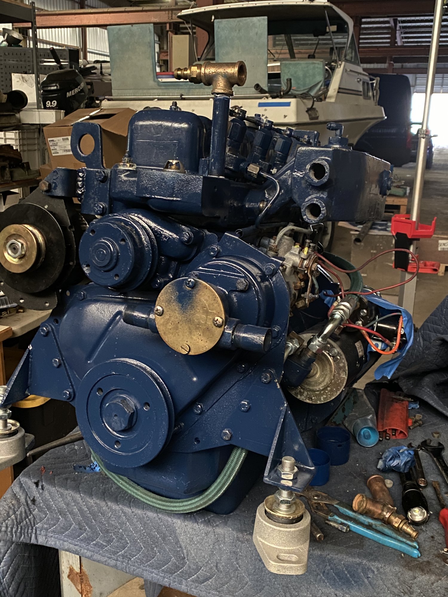

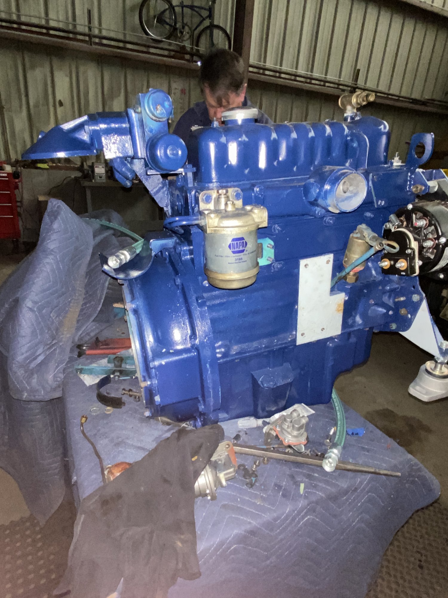

I spent part of the day with the mechanic. Addressing parts and resolving questions like: How does that fuel pump work? Have you seen the fuel line that connects the pump to the filter?
So many parts so many challenges.
The engine is begining to look more of what I remember.

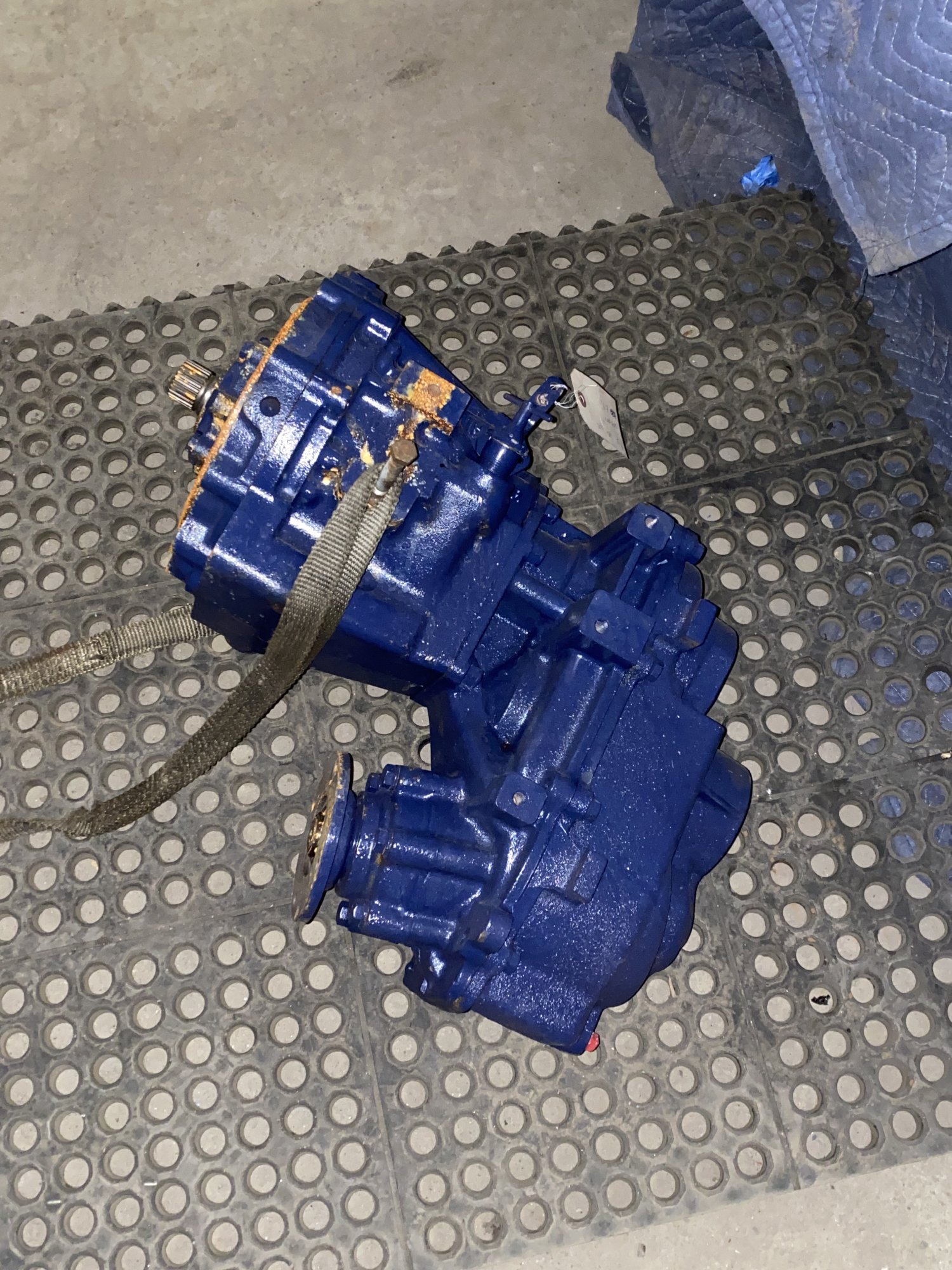

The Transmission

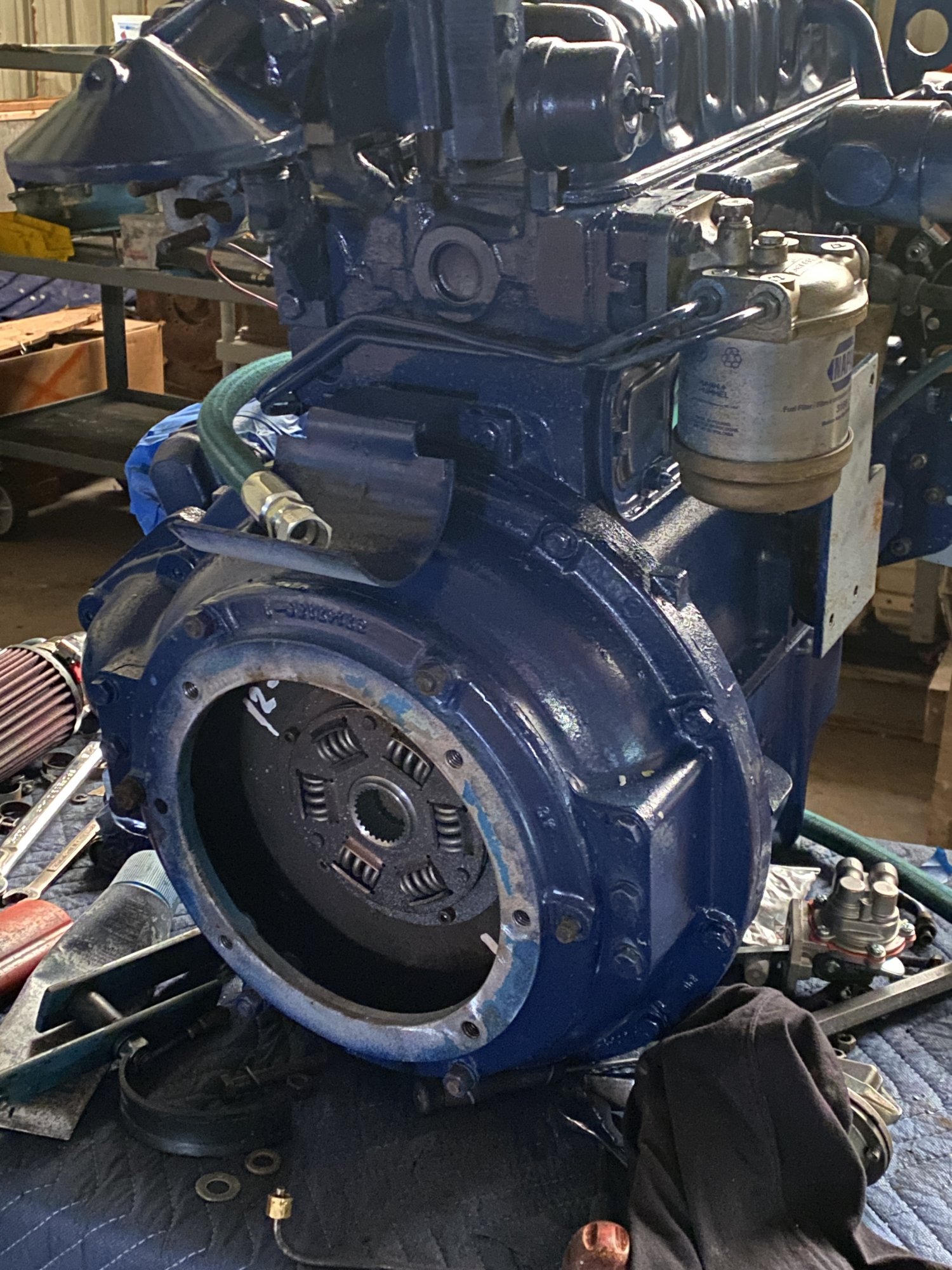

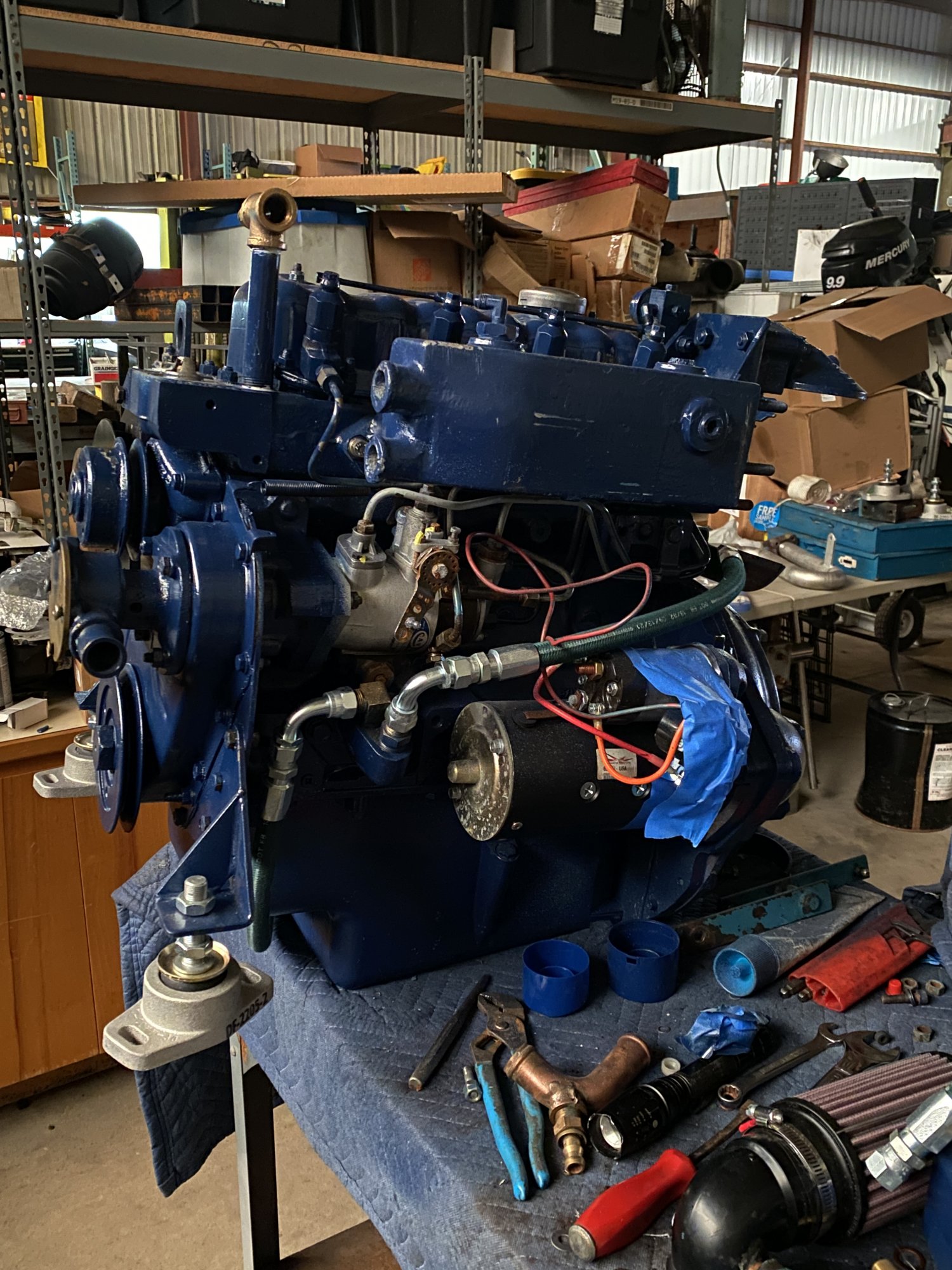

And the Engine
Paint look pretty. Soon we will test run the engine in the shop.. Hoping no mystery results.
