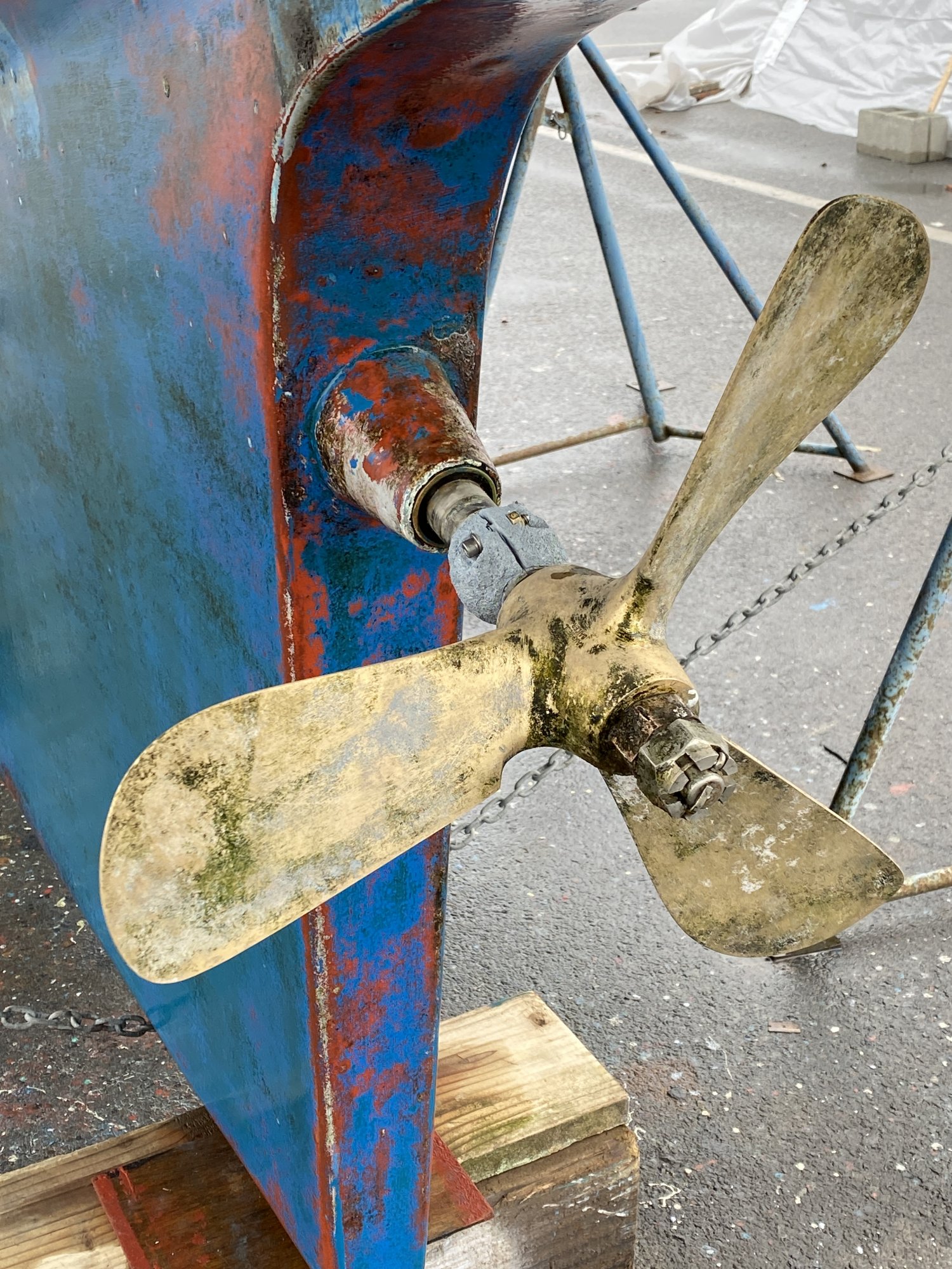

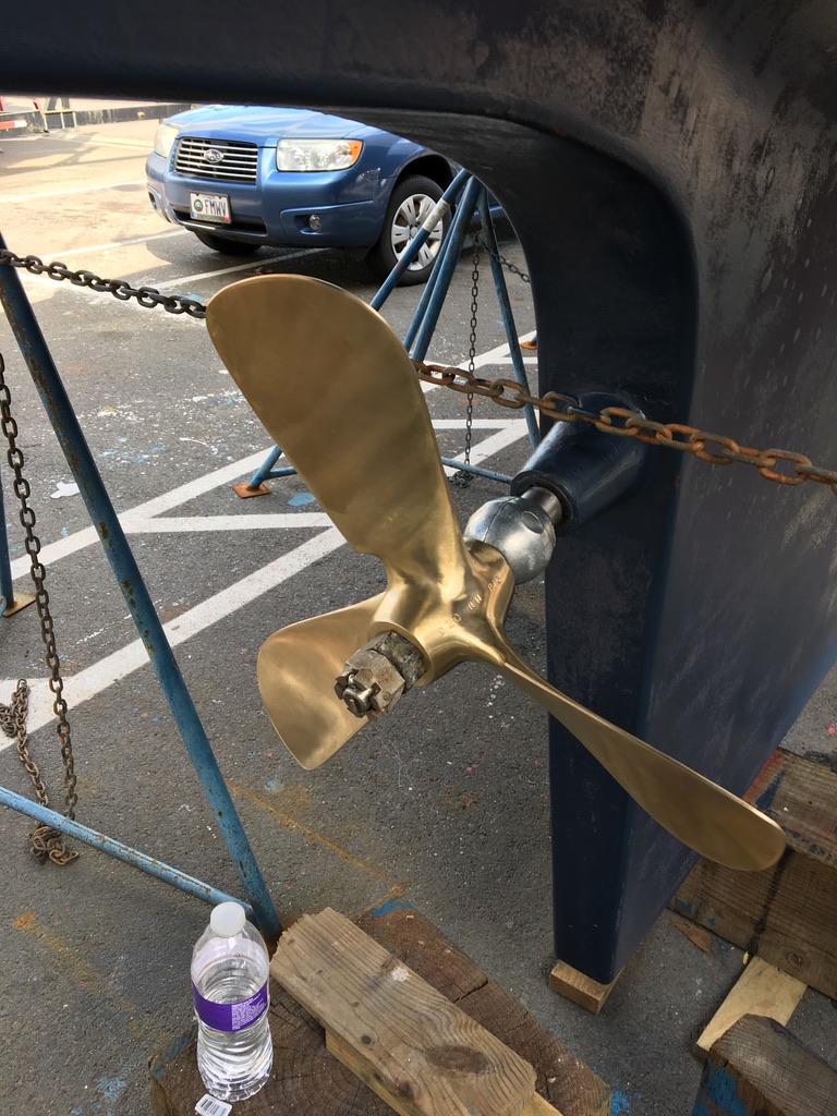

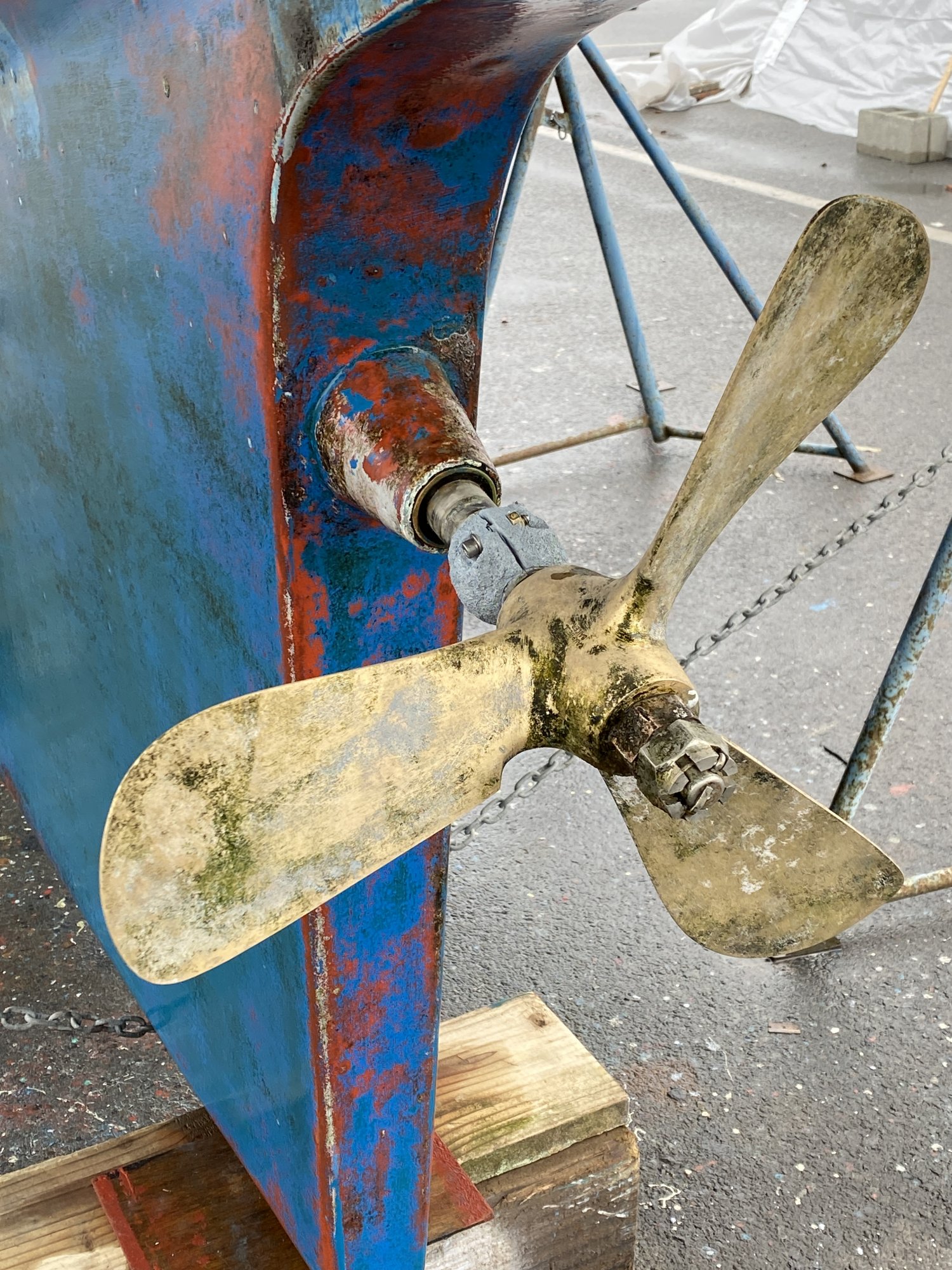

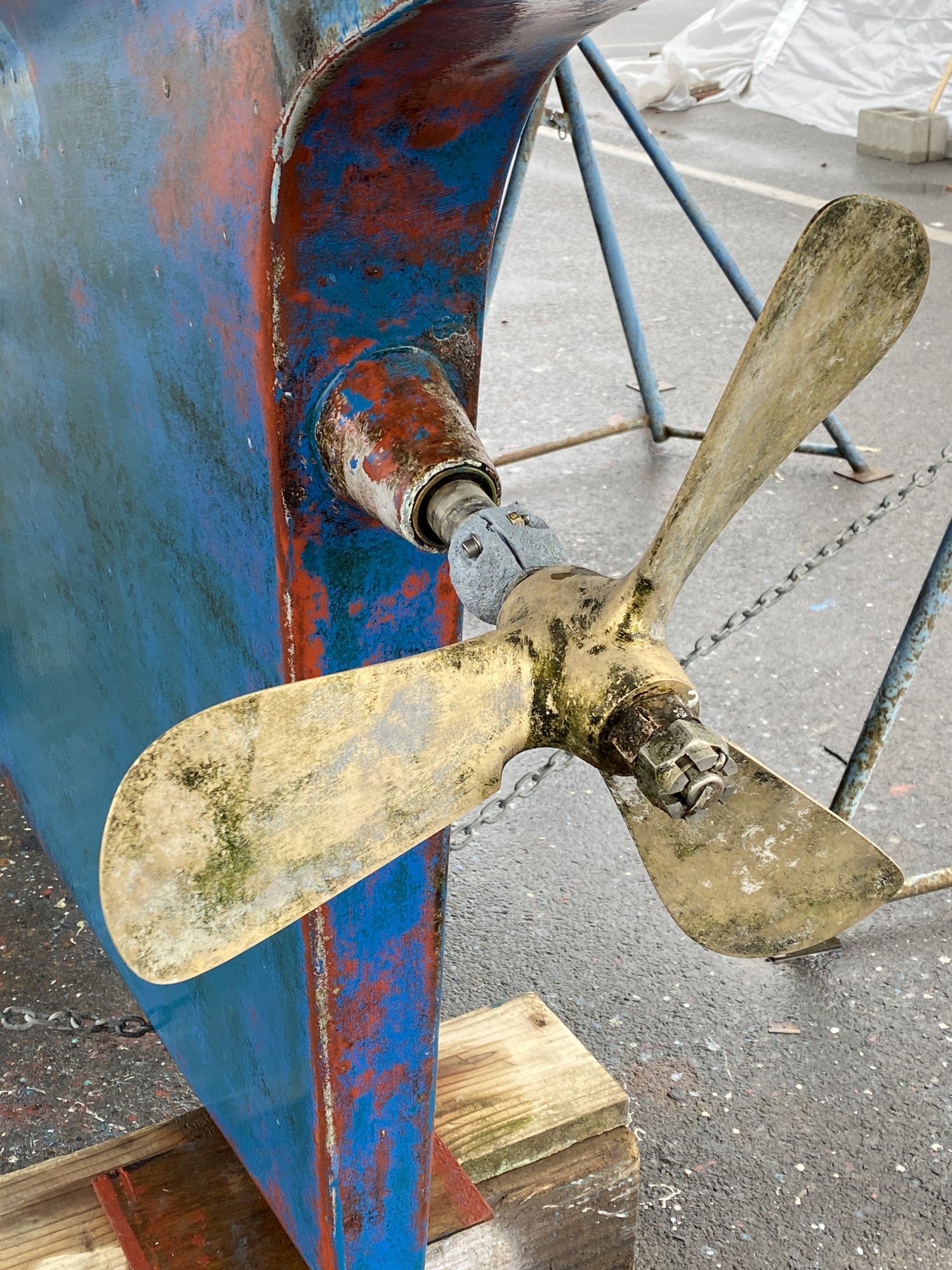

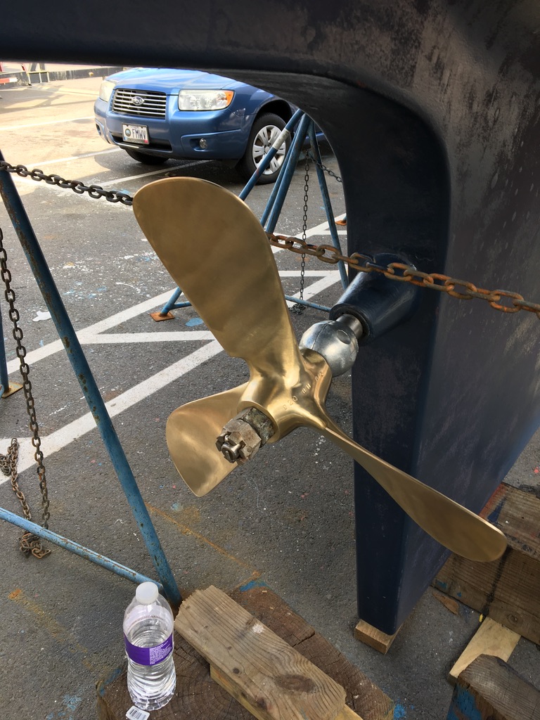

I was pleased with the look of the prop after being submerged since 2018. No obvious signs of corrosion of the bronze. No expensive prop paints. The marina pressure washed the boat and sprayed down the prop. Looking closely, It is time to change the zinc.
Before MAR 2018
After Feb 2023

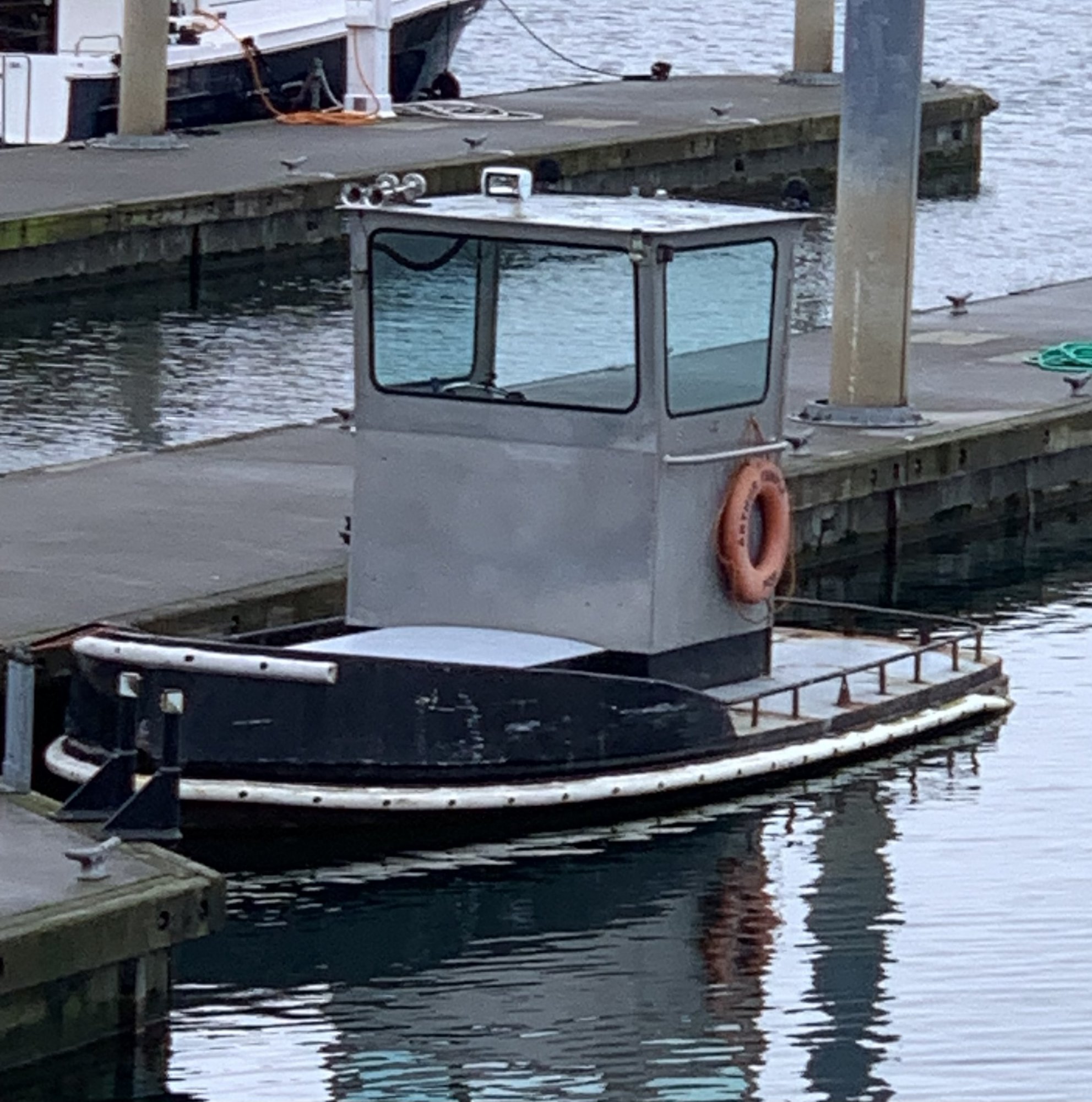

I was at the boat and captured a picture of the Tug that pulled me across the marina.

Sorry Richard. Did not mean to confuse. That zinc is about 4 months old.
The Prop was what I was talking about.
The prop was purchased in December of 2017. I installed it in March 2018. I consider paint and material like Speed Prop to protect it. After talking with the manufacturer he said, put it on your boat and run it. Have a diver clean it occasionally. It will give you good service with no fuss. So I did. I suspect I can give it a scrubbing and it will look nearly as pretty as the day I installed it.
I change zinc’s regularly in our briny water. Marina’s I expect to have stray current. The zinc is about normal for a 4-6 month period in our waters

Oh. My mistake. I was wondering how it could have gone that long and still look so good. I guess I should have known that if it lasted that long there would be other trouble.
The prop looks great!
Forge on with the new engine installation!

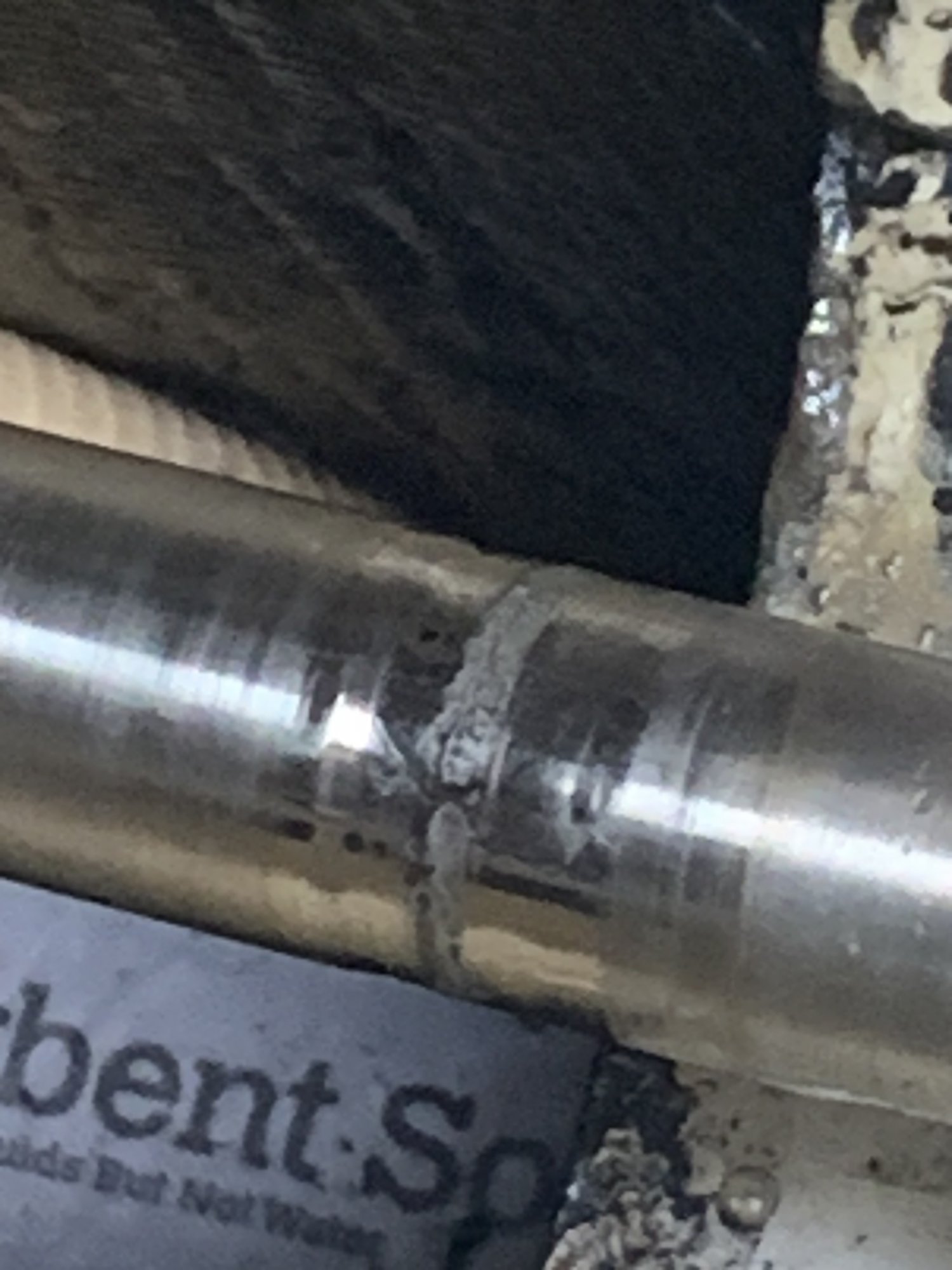

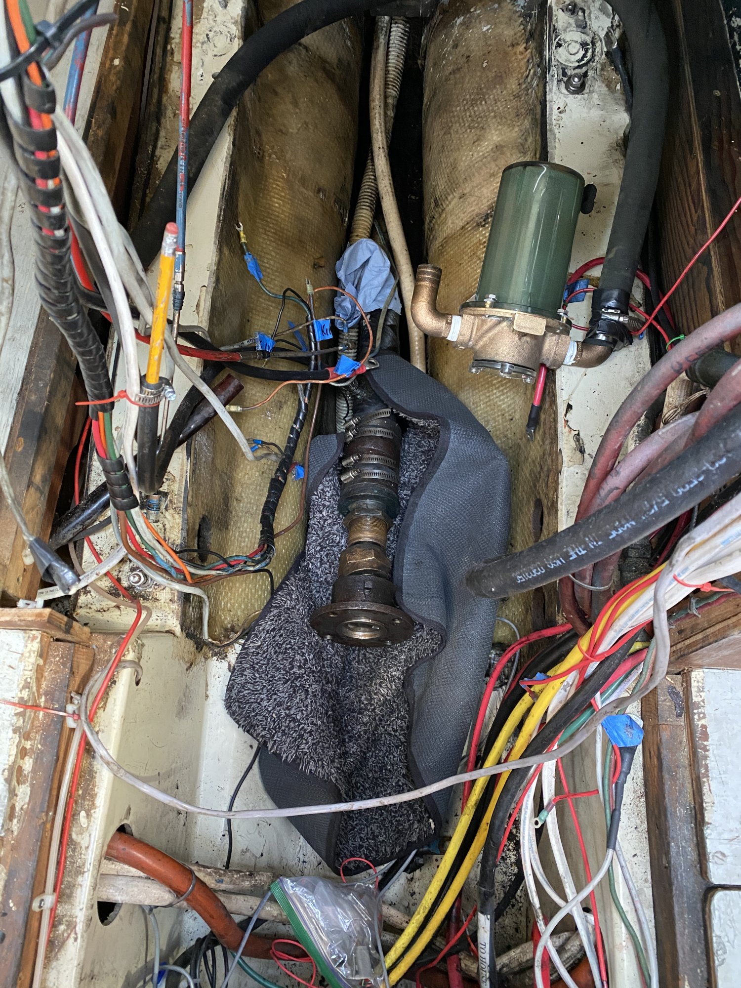

While this is going on outside the hull, I am up inside preparing for the engine. My hopes were dashed after I got the stuffing box opened and stuffing removed. I was not experiencing any leaks, the box had been just warm to touch after the having used the boat, the shaft looked polished, so I was hopping I would not need to change the shaft.

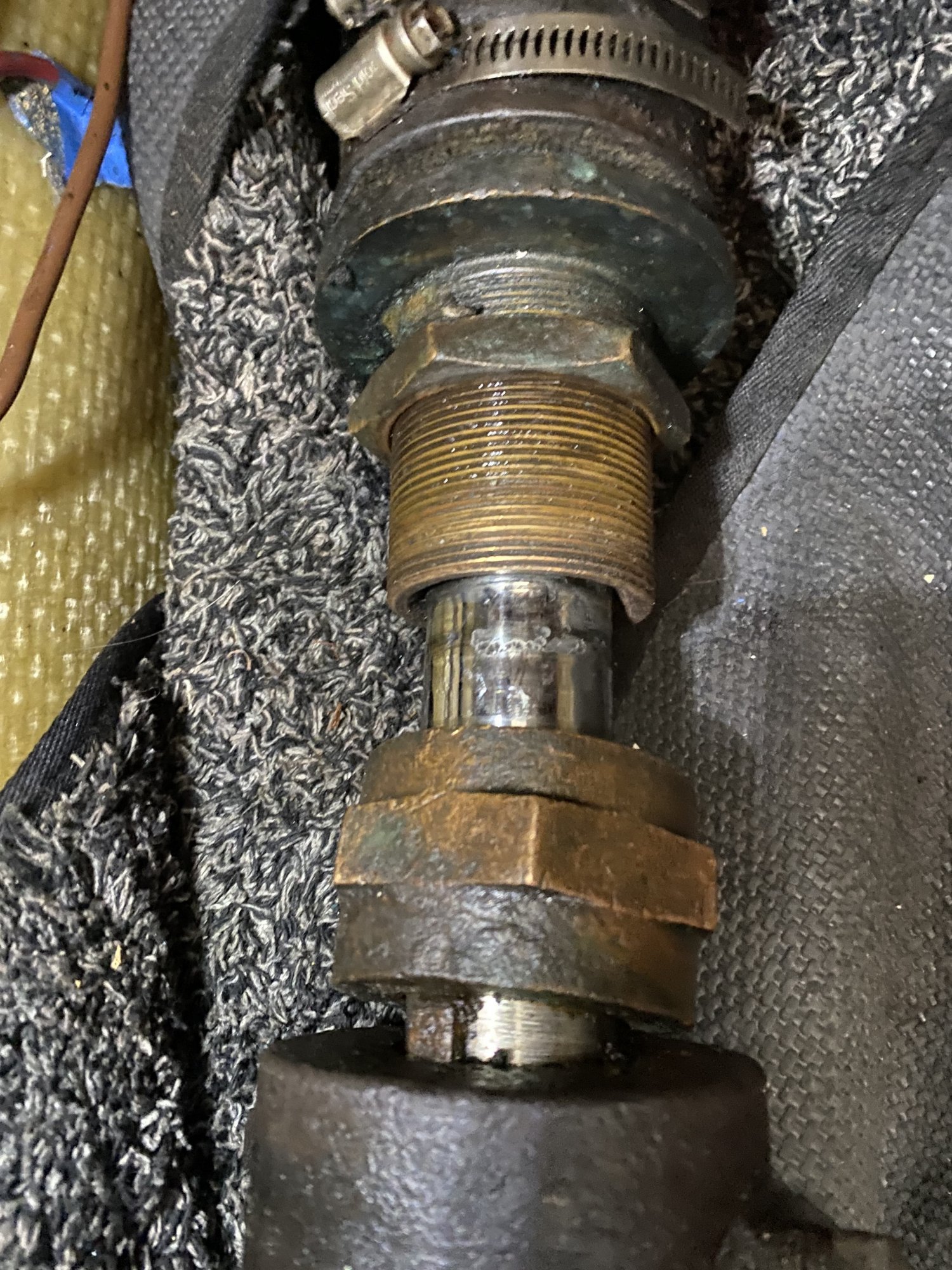

Then I saw and felt it. Pit corrosion.
That and the shaft was worn under the stuffing. Stuffing grooves.
Miserable rotten break :banghead:. This is something I have always marveled at, that I was not seeing crevice corrosion under my packing after a long winter's hibernation. Perhaps I have an exotic metallurgy protecting me.
I've got to ask ..................... have you ever used one of the graphite bearing packings in your stuffing box ? Any idea how long the corrosion's been going on ? The pitting looks pretty deep.
@jssailem I was going to ask the same question. I have heard of this type of corrosion with the graphite packing. I think Maine Sail did an article on it.
24,853
Last time the stuffing box was addressed was in 2015. I was new in the use of diesel auxiliary boats. Never had changed the packing while in the water. The stuffing box was dripping more than recommended. Tightening the nuts helped but did not stop the dripping with the engine off.
I purchased standard waxed flax of the proper size which was used. An experienced neighbor helped me. He said the shaft looked ok. I was not on the boat when work was done so do not know what was used before my service
What I pulled out looked like the stuffing I had purchased. Not graphite flax.

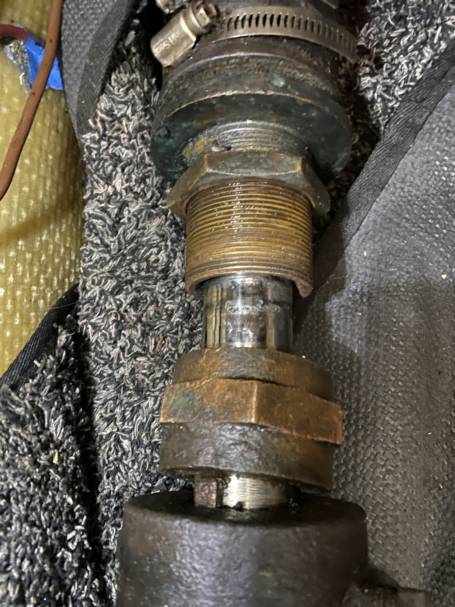

The stuffing box on my boat sits beneath the engine. The 4cyl Perkins 4.107 is attached to a BorgWarner V drive transmission. Access to the stuffing box is limited.
Based on the history I’ve learned about the boat I’m inclined to date the shaft as 1973. The portion of the shaft visible looked fine. Temperature monitoring of the shaft and stuffing box in operation ranged from 110 to 130 F.
With engine removal access allows full inspection.
BD9293A1-4CE9-45DE-A820-DB46DA42344E.jpeg 9565C194-8077-4452-99AE-BA70C0ECC6C7.jpeg
Here is a picture that drove the decision to replace the shaft.
One of those hidden from view conditions that can bring nightmare experiences.

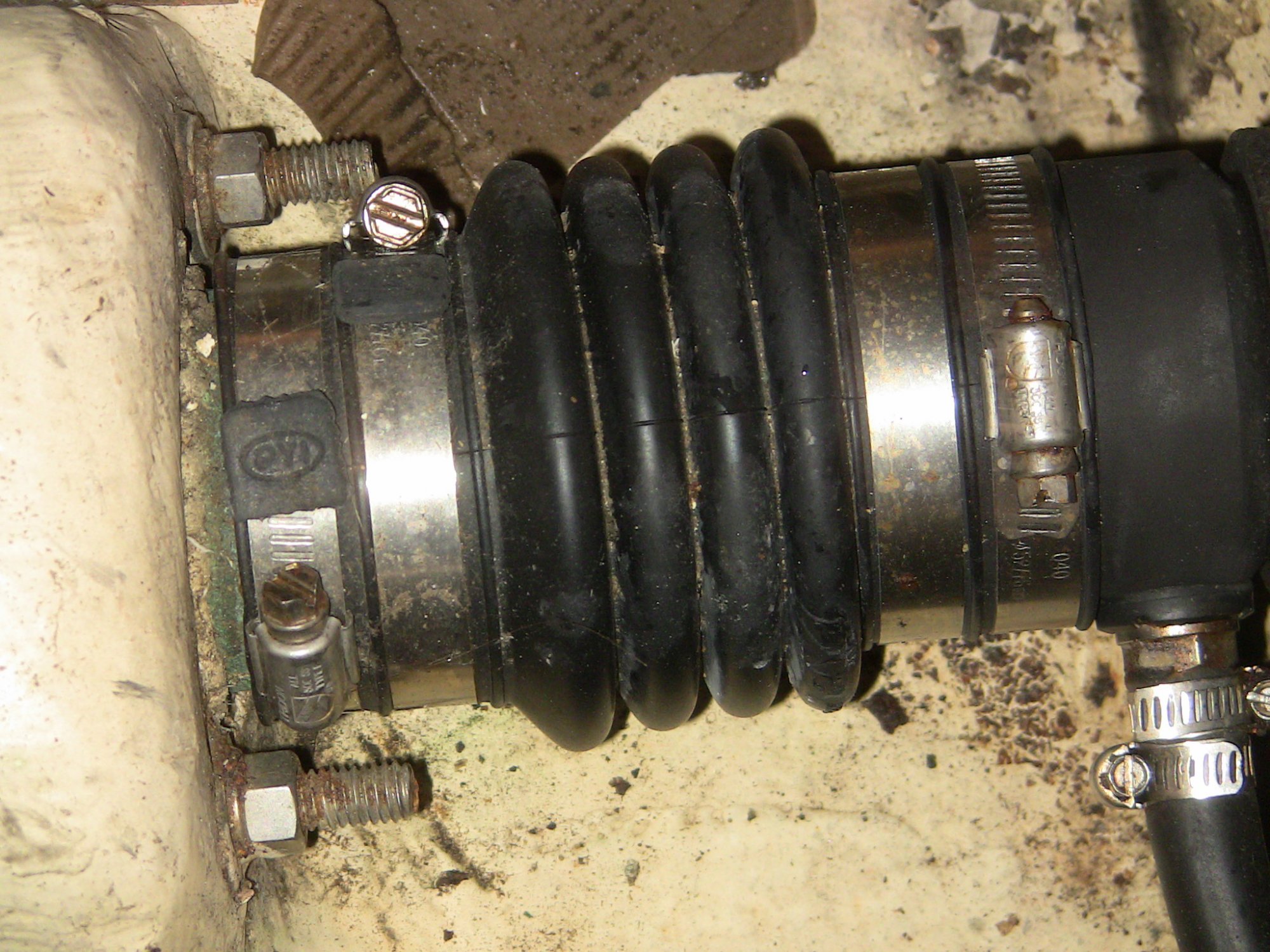

Given the V drive and poor access are you going to go with a dripless seal this time around?

Are you going to stay with the packing gland or go with one of the dripless offerings. I am not a big fan of any of the bellow systems and really do not like the recommended 6-year bellows replacement for the PSS. I installed the LasDrop Lip Seal which has a proper heavy duty silicone shaft log, cutlass bearing guide for the seal, no worries about low oxygen corrosion, and in-the-water lip seal replacement without the need to pull the coupler. The complete seal with two replacement seals cost under $200. So far, I have been very pleased with the results.

Especially now that the PSS dripless has a reinforced silicone bellows.
