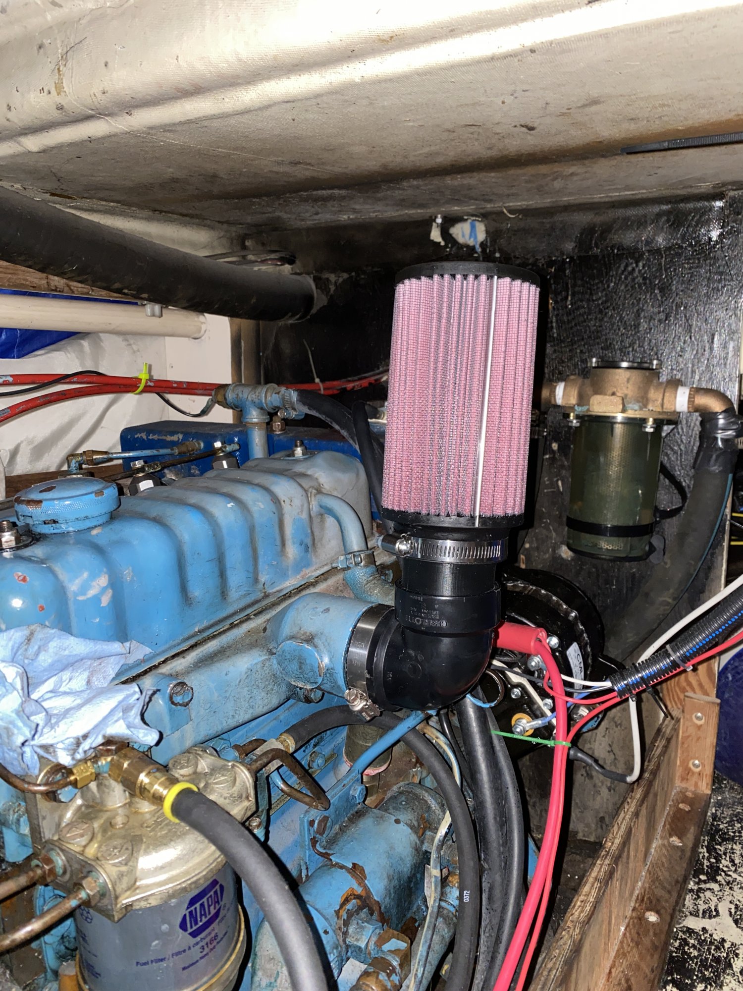

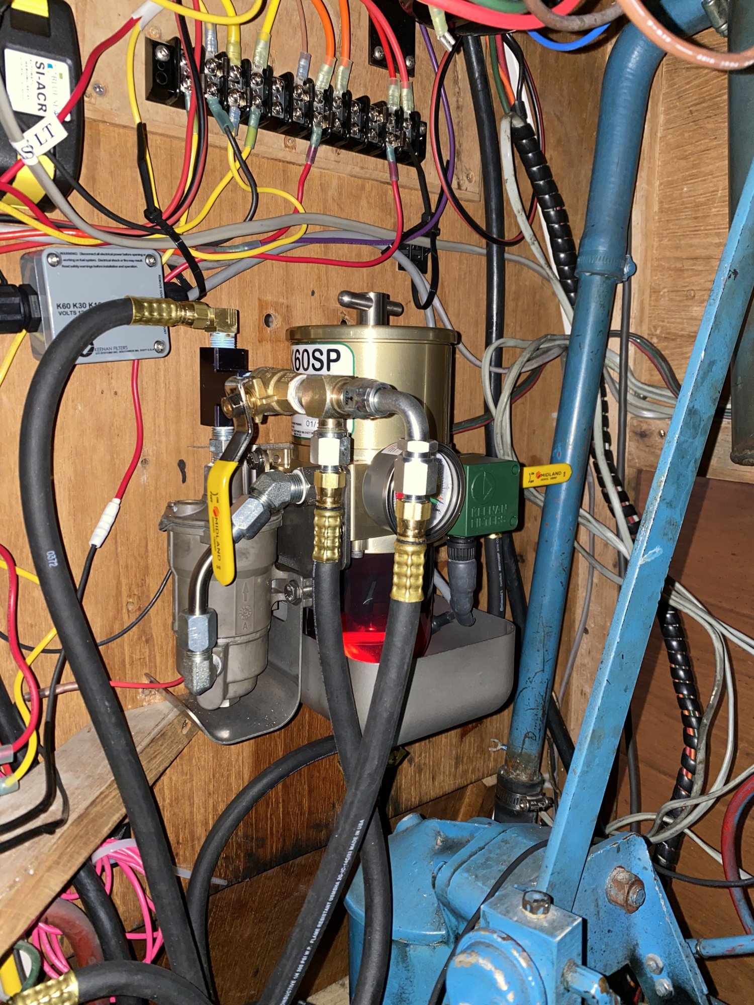

Only major system not yet ready was auxiliary power. While my Perkins 4.107 has been running smooth and without temperature issues for these past 6 years, I still wanted to have a mechanic look it over. Scheduled the appointment. The mechanic gave positive reenforcement that the engine still looked capable of making my planned voyage. We checked the valves and adjusted two of them to bring them all to a common place. Restarted the engine and all sounded good.
DE5A3085-BDAB-40F6-A0D7-EC4CCE2977BF.jpeg 5675601B-173C-49E2-9F9C-C3ECB2038B92.jpeg DC03C7D4-C42F-4A18-9A30-31F2046F8360.jpeg

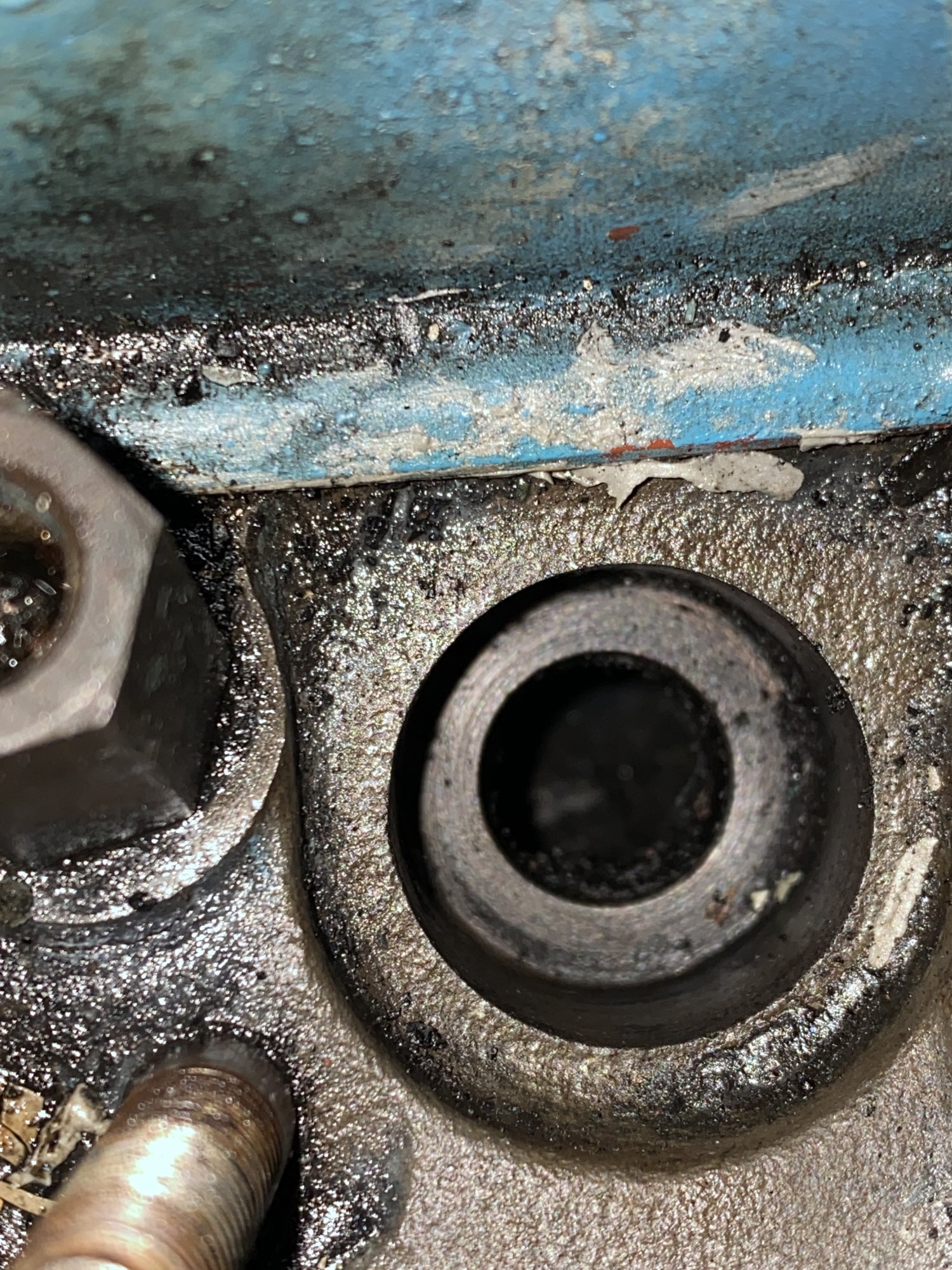

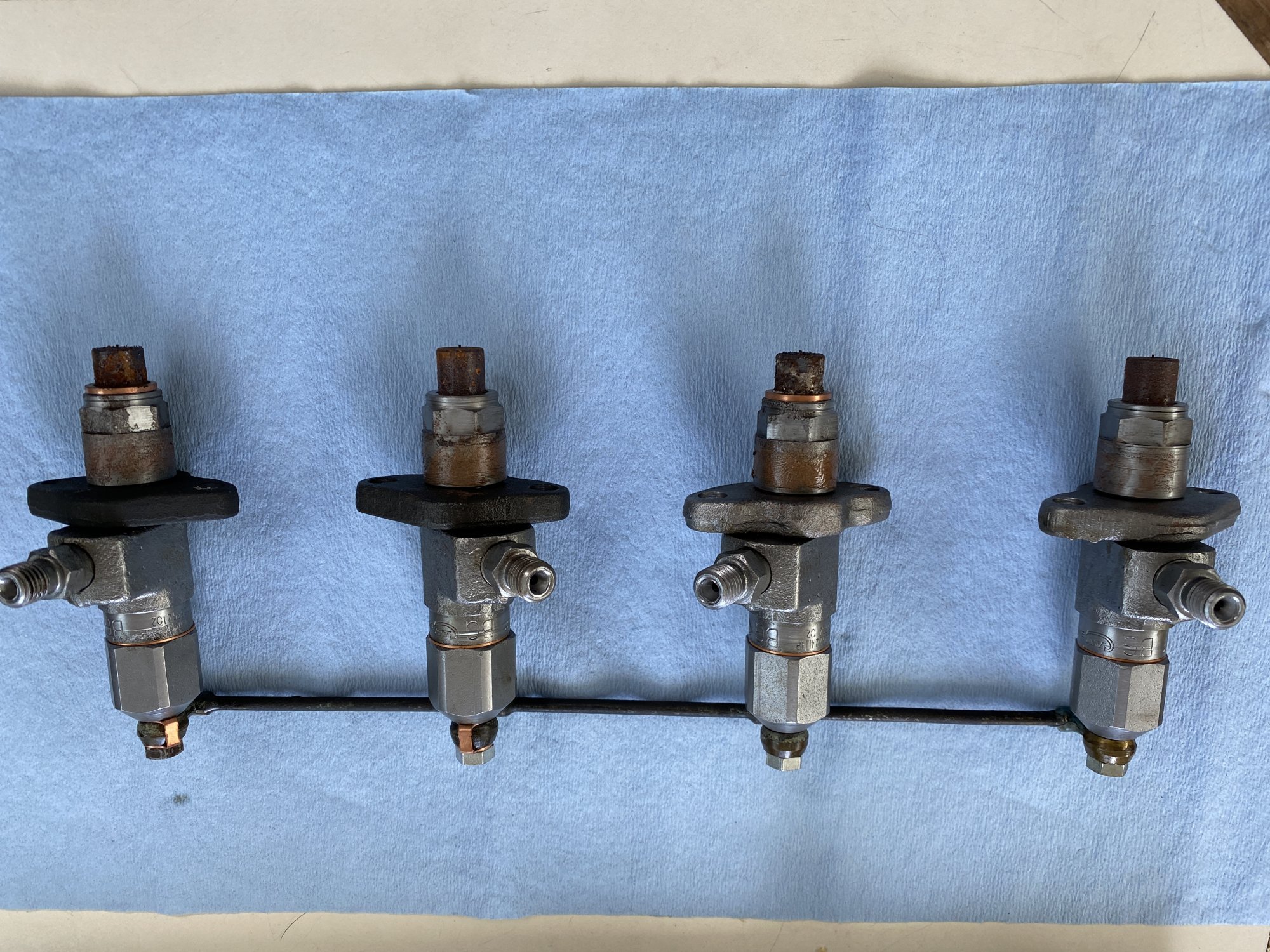

One major issue was noted. 2 of the injectors had broken hold downs. While they still functioned, it only felt prudent to correct this problem. I took all 4 injectors out and had them services as a Seattle shop. They came back in about 10 days ready for install.
FD47503C-F6F8-4B68-B04C-34EF1475D657.jpeg BED56A45-0A2B-409E-90BF-FA44CDAFD754.jpeg

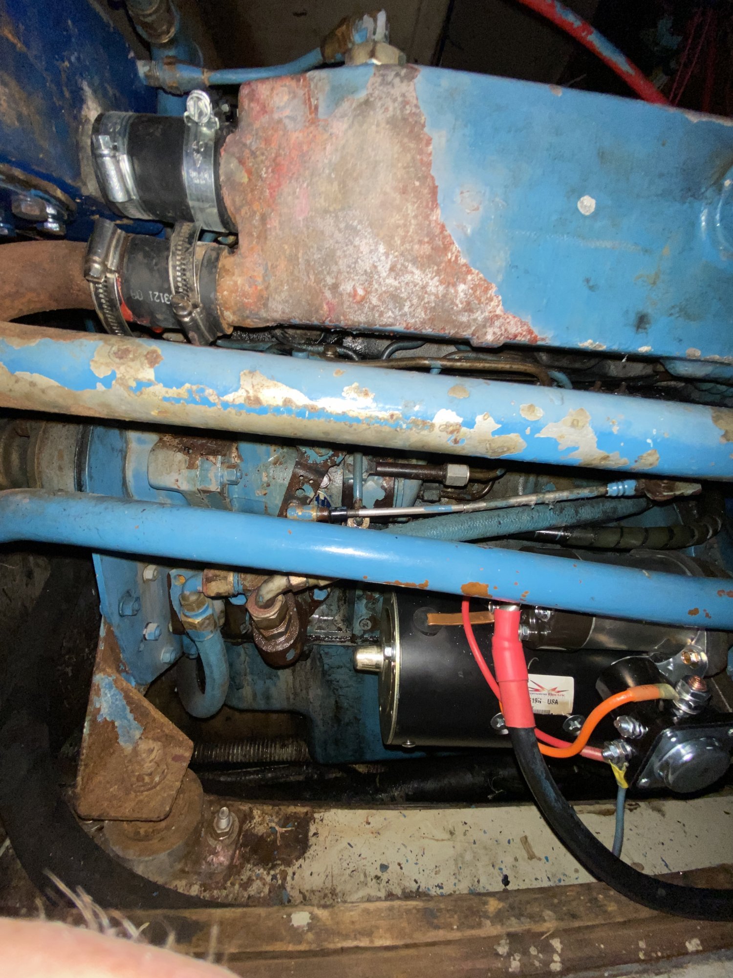

While my boat has what could be considered an engine space (tiny room), the entry requires a person to slide in a narrow door and then you can sit up or lay on your side to work on the engine. Slipping into the engine space, I went again through the procedure of checking fluids, affirming the fuel lines were bleed, turn on the power, and then push the starter.
While the starter turned the engine over perhaps a revolution, there was an ominous CLUNK. Then nothing. I tried the starter one more time NOTHING. No rotation… No VAROOOM… NOTHING. DAMN DAMN DAMN….

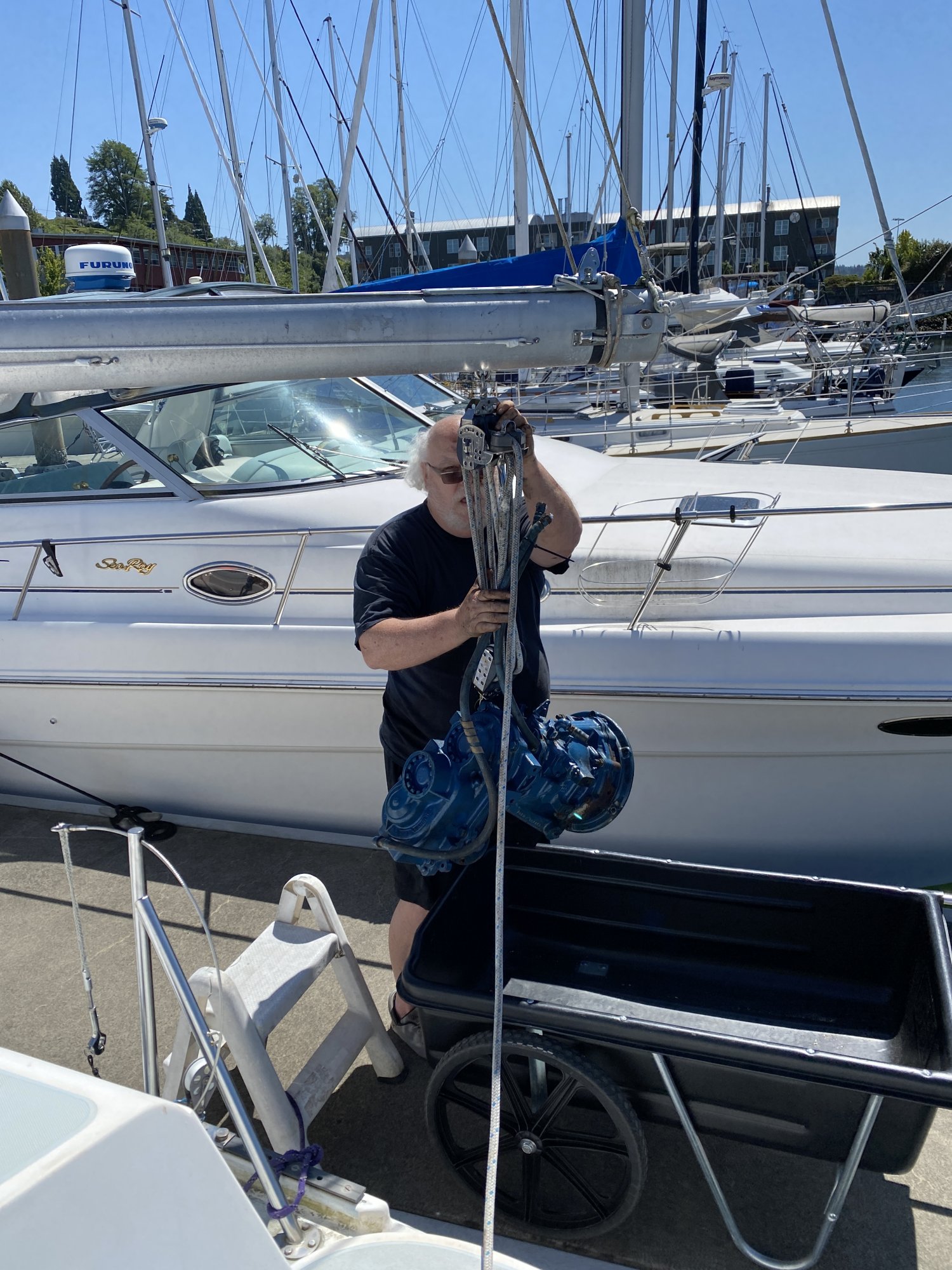

  • Are you in Neutral? Perhaps the Transmission is the issue. Yes in neutral. But maybe the damper plate has lost a spring or is causing the lock up? Removed the transmission and all the springs look in place. Nothing looks out of the ordinary.

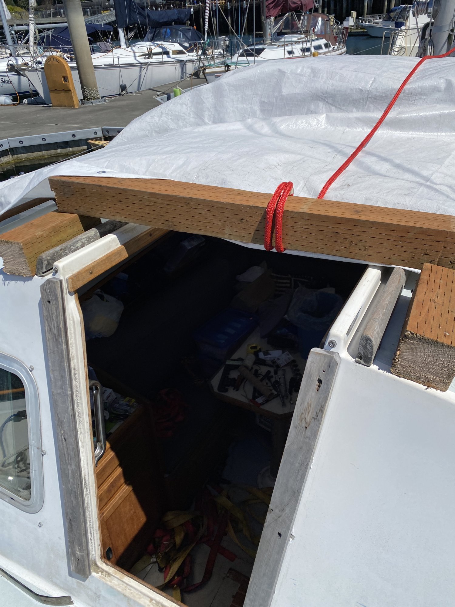

  • We used a 4x4 across the companion way and lifted the V-Drive up then attached it to the boom. Using the 6-1 mainsheet tackle we pulled it throough the companion way and over to the dock. It was lowered into a cart and delivered to the Tranny shop. 0528F8FA-1C46-4E01-B9DA-165E8CC004CE.jpeg 18CF6EF4-289F-4881-A74D-28A7B6482F22.jpeg

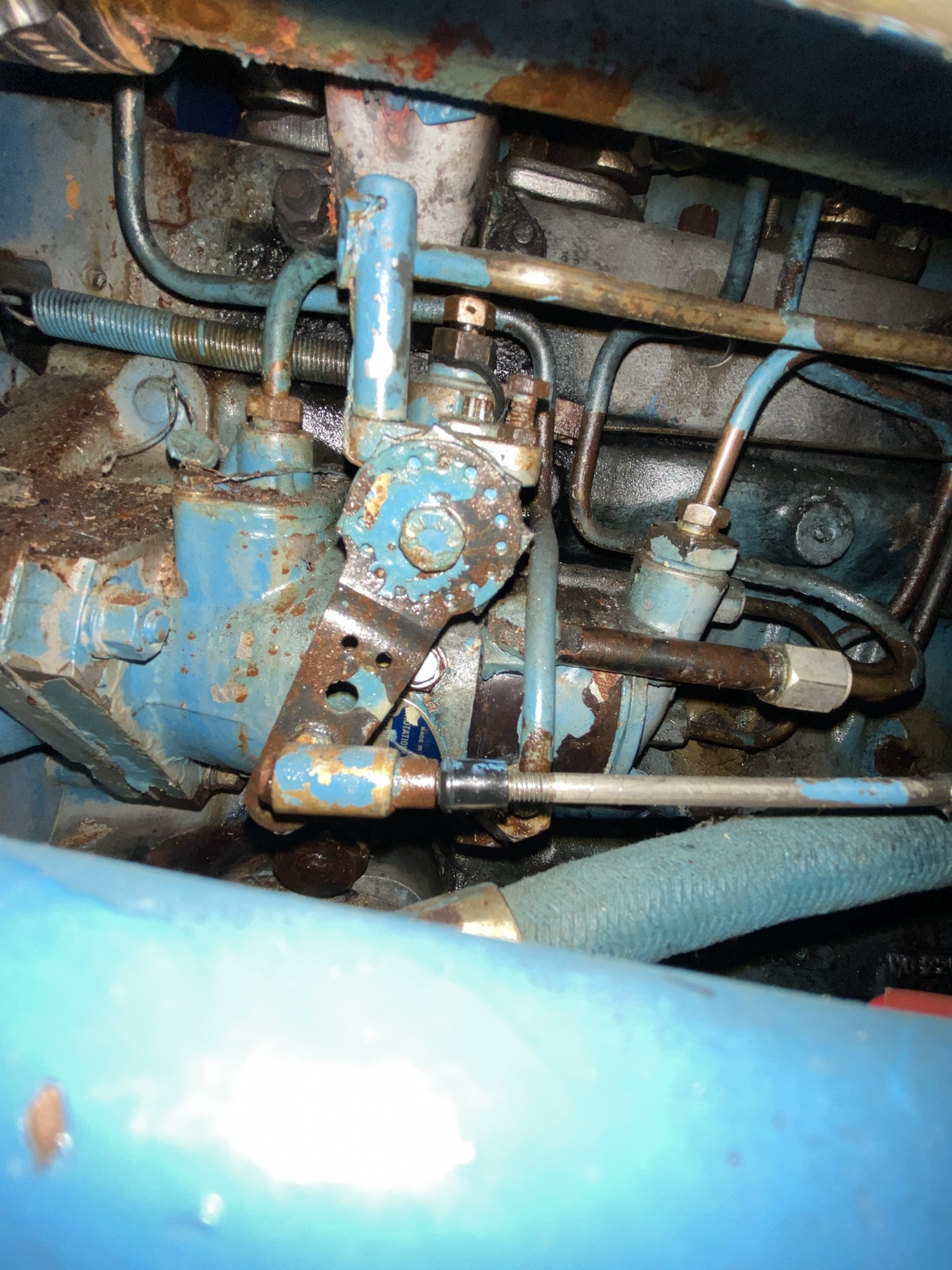

  • What about the high pressure pump. Perhaps the gears are jammed. Removed the pulleys belts and water pump to get at the cover plate. Removed the cover plate and all the gears have their teeth, are bathed in oil - yet the gears on the crankshaft are frozen in place. LOCKED UP. There is a little wiggle on the gear for the high pressure fuel pump so think it is still functioning if the crankshaft would rotate.

In this case the adjustment of the valves revealed that a previous mechanic appeared to over tighten the injector hold downs. Removal of the valve cover revealed two of them being broken (split into two pieces).
