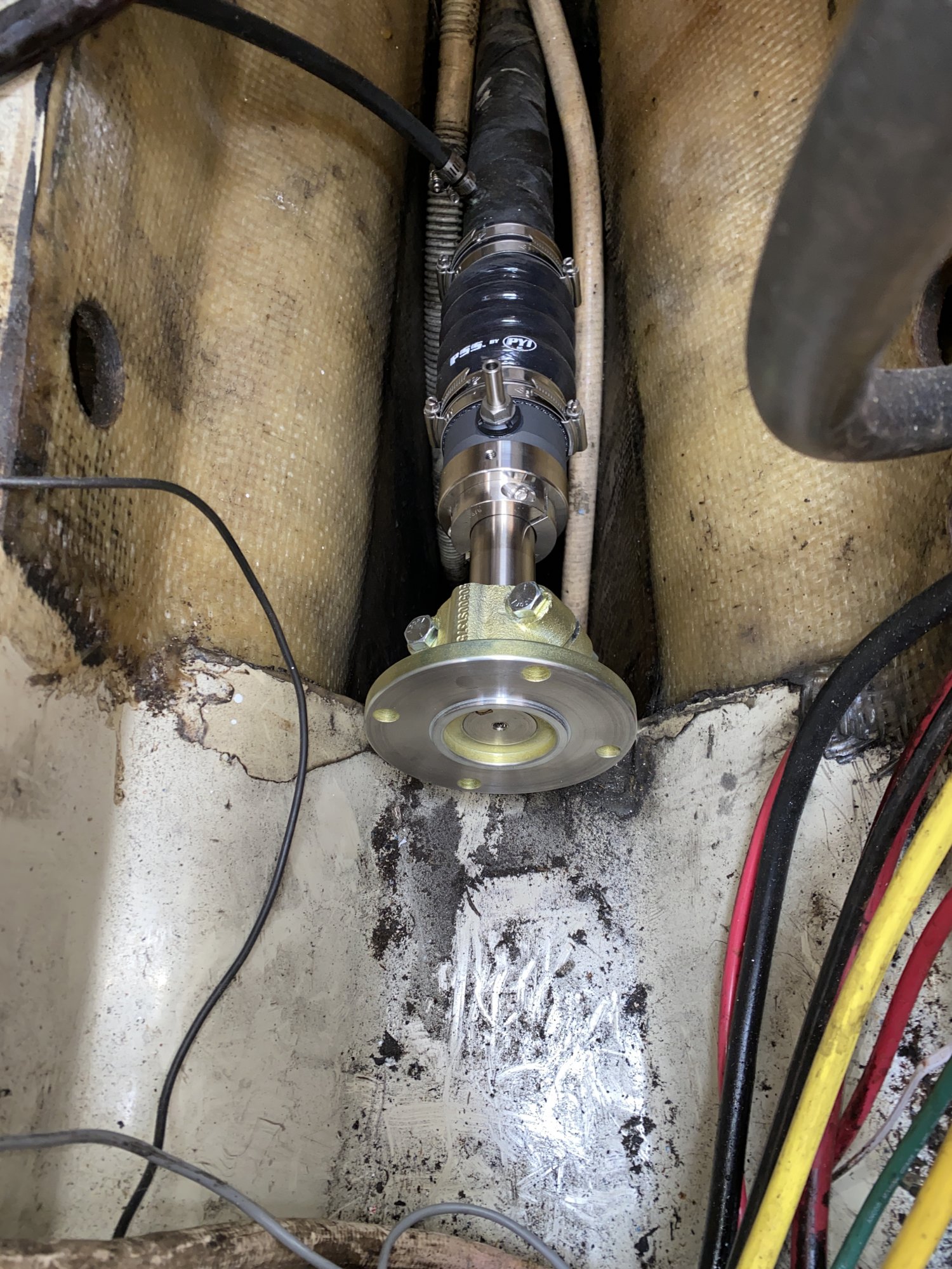

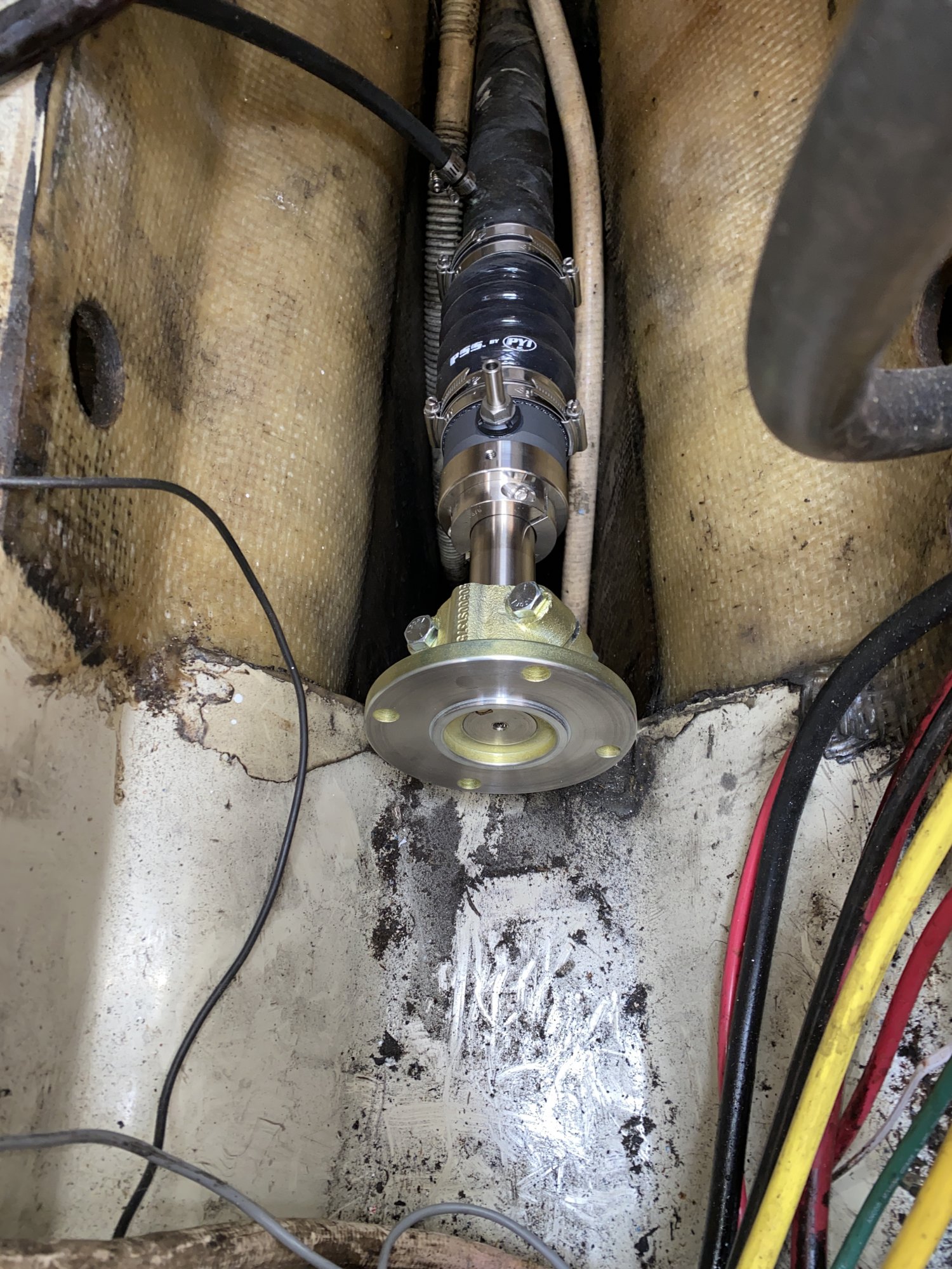

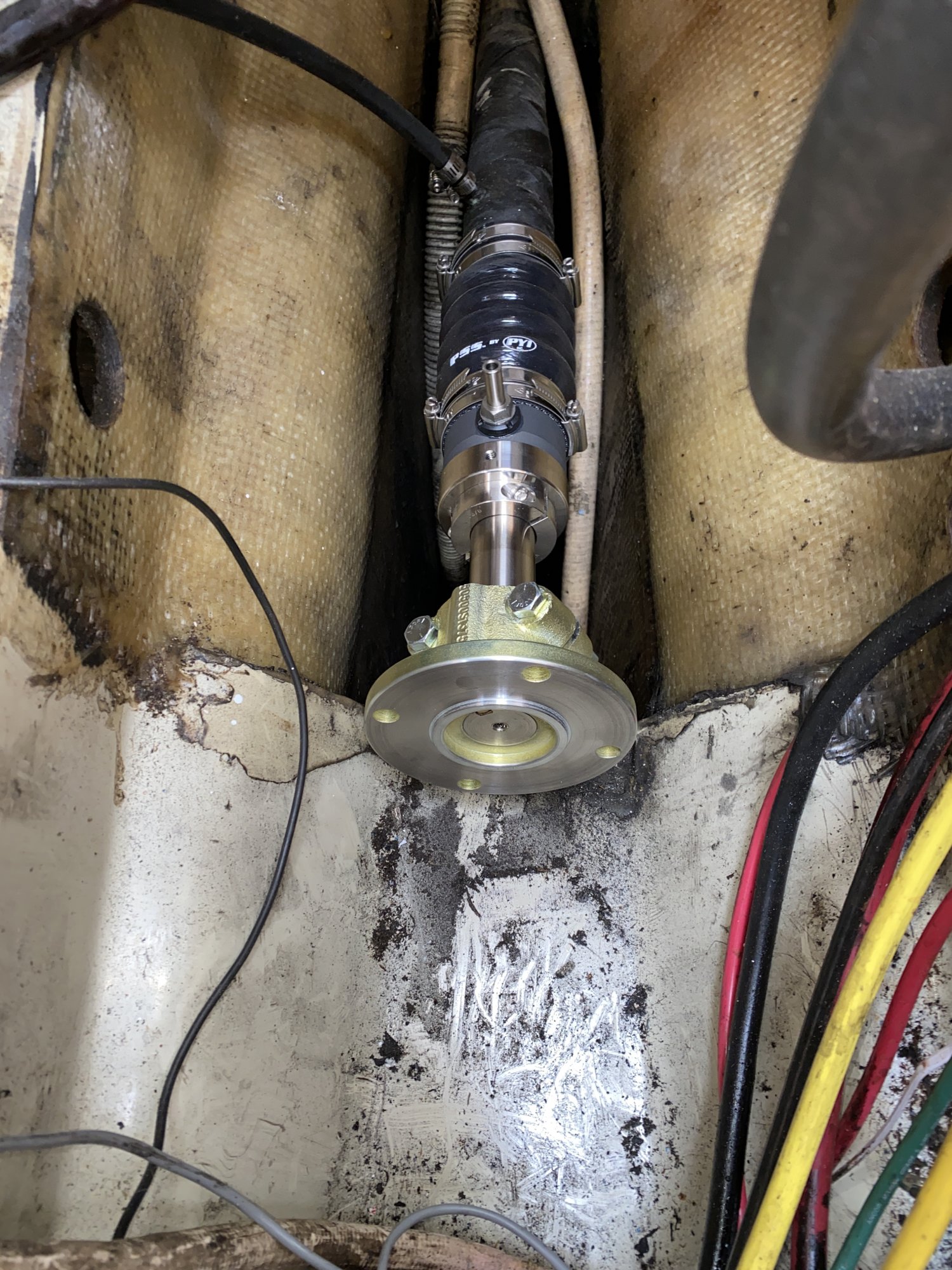

I had a good day. Got the cutlass bearing and new shaft installed. Then we put on the PSS Dripless shaft seal, the split flange, and finally the prop back on the shaft.
Need to tighten the prop and and install the new zinc, after positioning the coupling on the transmission. Here is an image of the shaft seal. Not yet compressed or locked down.
That sure looks good!!!! Next up - engine install!!! (hoping anyway).....
