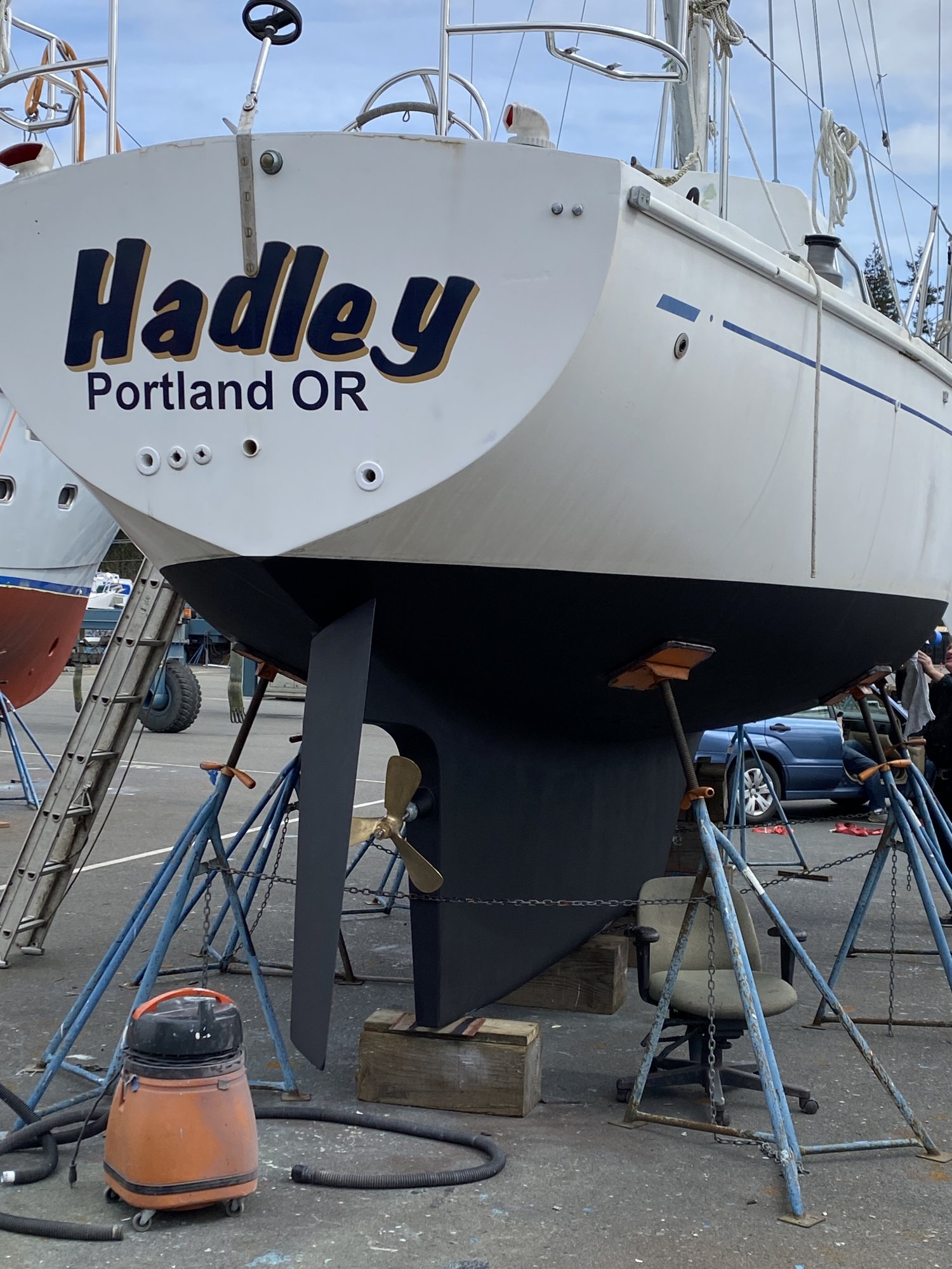

We have completed the blister repairs and painted the bottom.

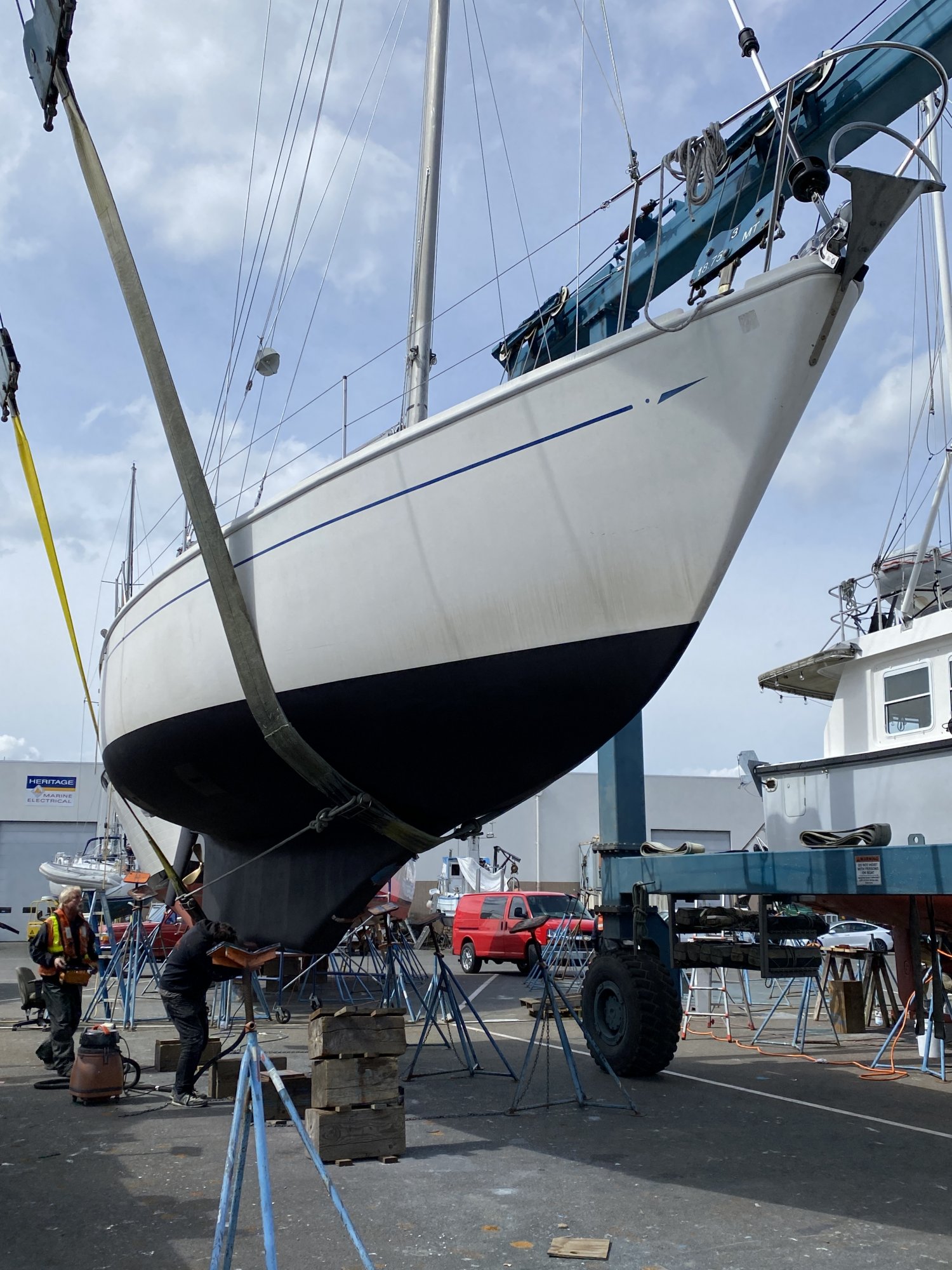

We were lifted out of the chocks and carried to the waters edge.
The lift operator lowered the boat into the water. I scrambled aboard and dashed into the cabin to check the 3 through hulls and the new dripless shaft seal for leaks. Our work proved to be successful. The through hulls and the Dripless Shaft seal were all bone dry.

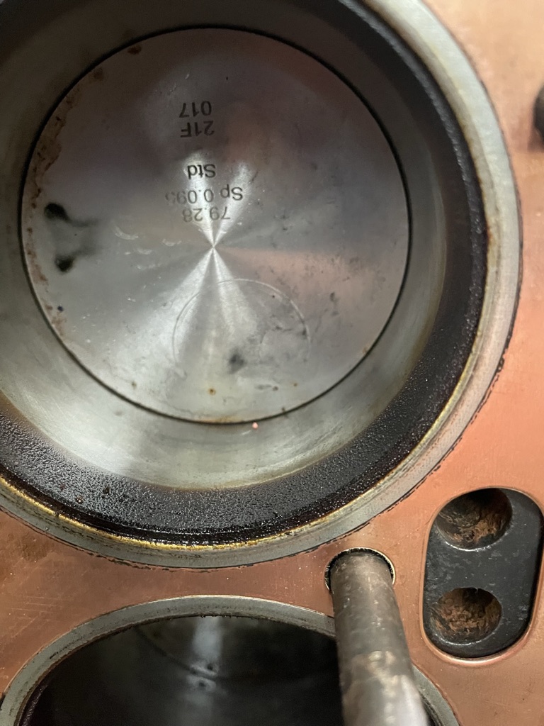

Last week the 3rd element of successful diesel engine performance was tested and found lacking. My returned mechanic was able to test the compression. It was found lacking.
To remind all, the engine was disassembled and all parts laid bare. After the machinist worked on the block and head, the rebuild was begun. New sleeves, pistons and rings were installed. It is directed in the shop manual, after rebuilding the engine needs to be started to properly seat the rings. When the build was completed attempts to start engine were met with no success. First the oil pump did not pump. Once pump was fixed, the lack of starting was thought to be fuel or timing. The injectors were again examined and and the timing was matched to spec. Still no varoom.
Compression being that 3rd element showed 190 psi on cylinder 1, and 100-110 spread across the other 3. This leads us to conjecture that the rings have not seated properly or the valves are a problem. My mechanic Scott says this week he will open up the engine to resolve the issues.

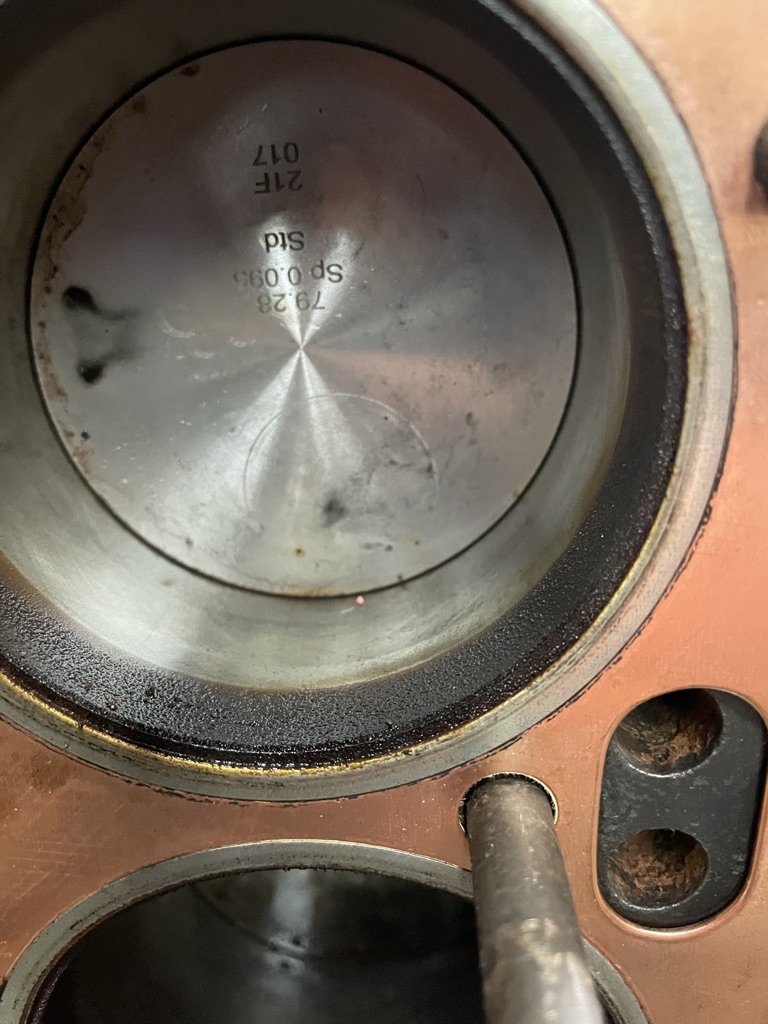

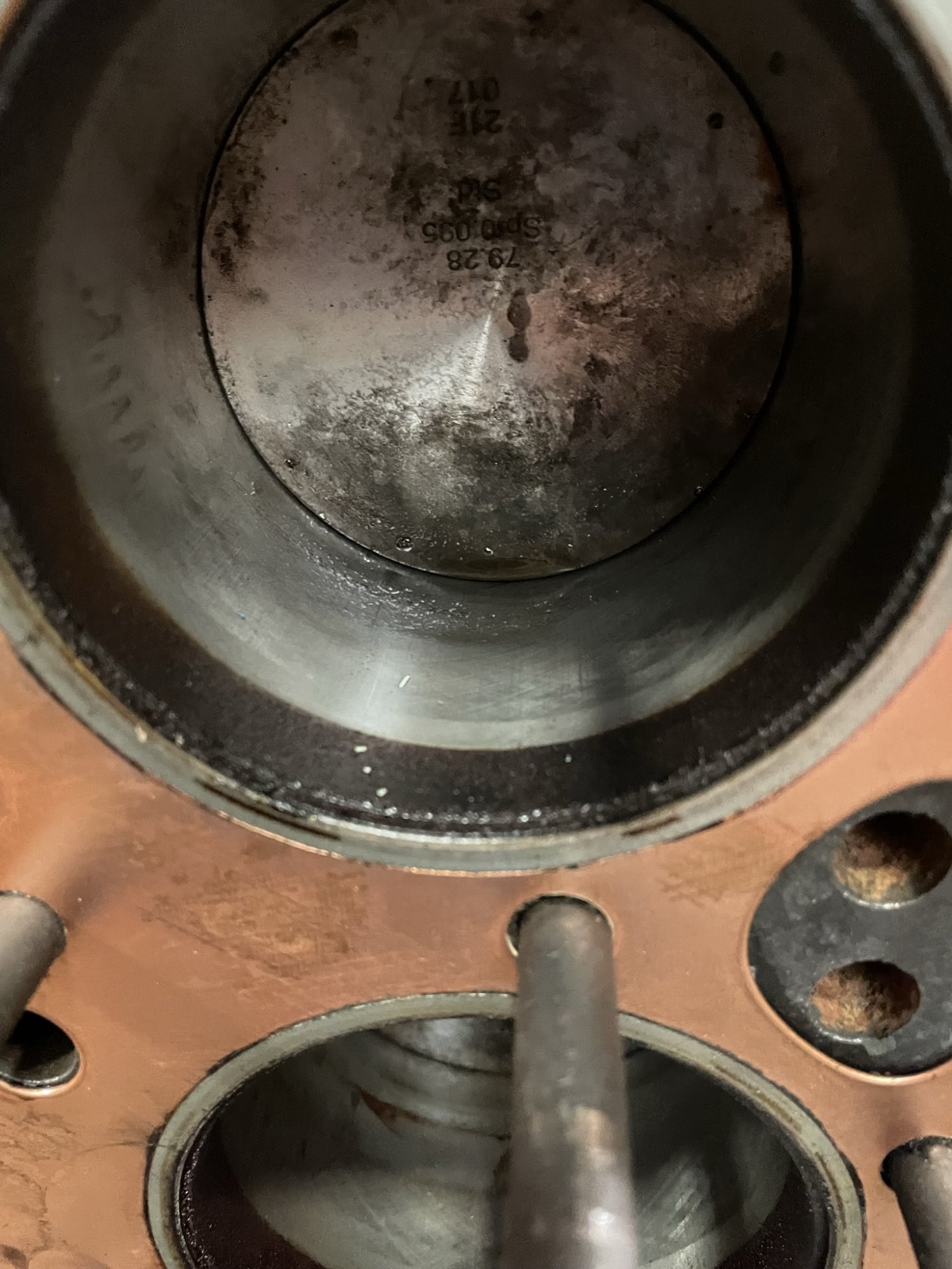

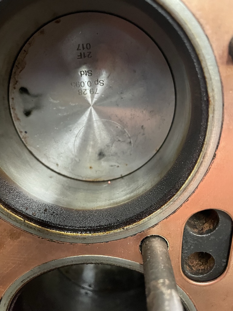

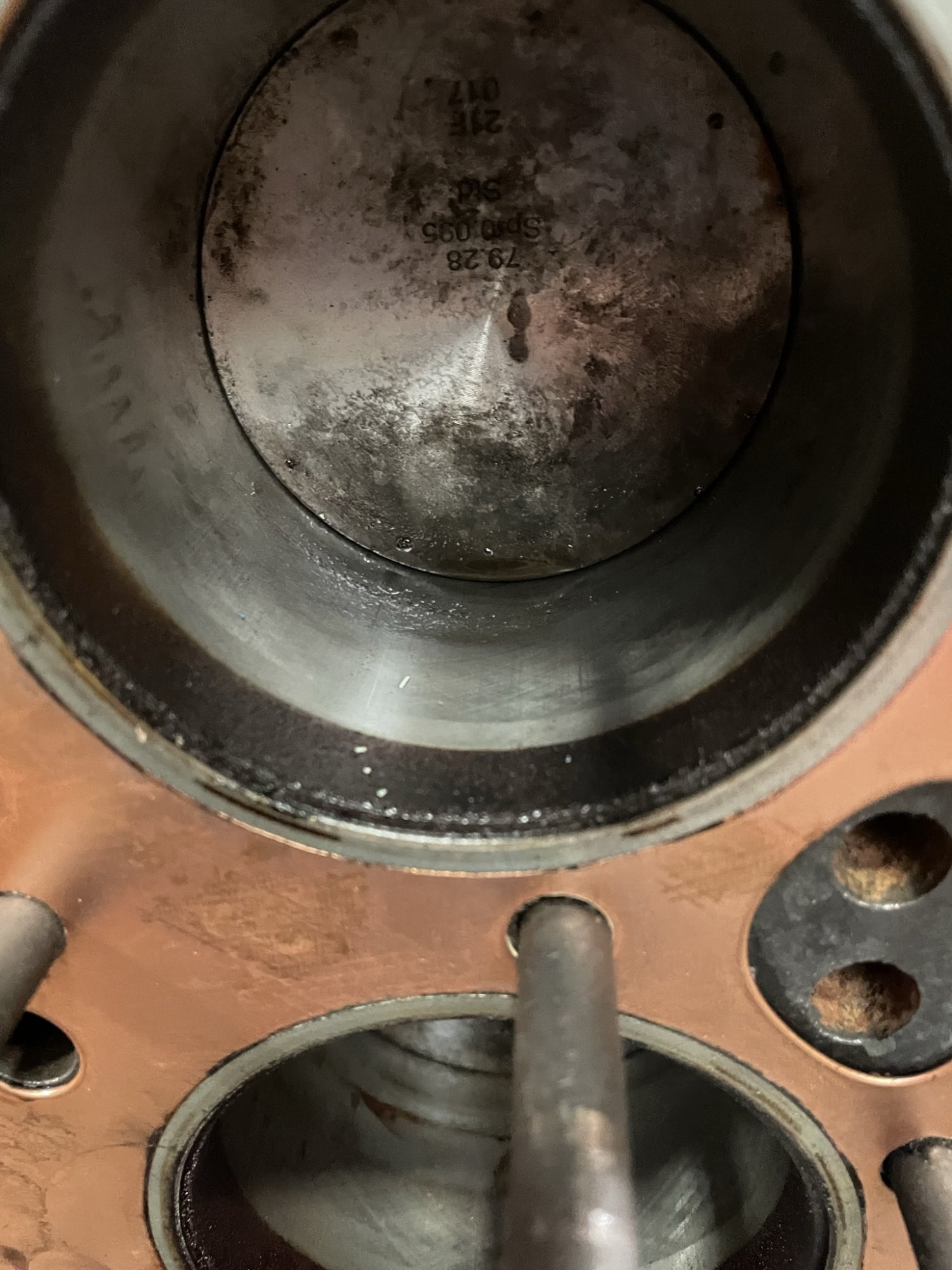

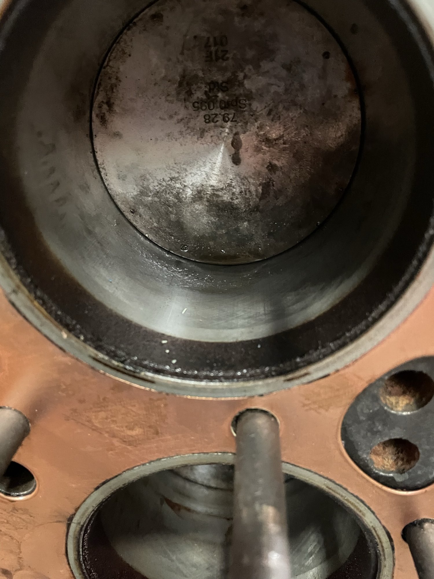

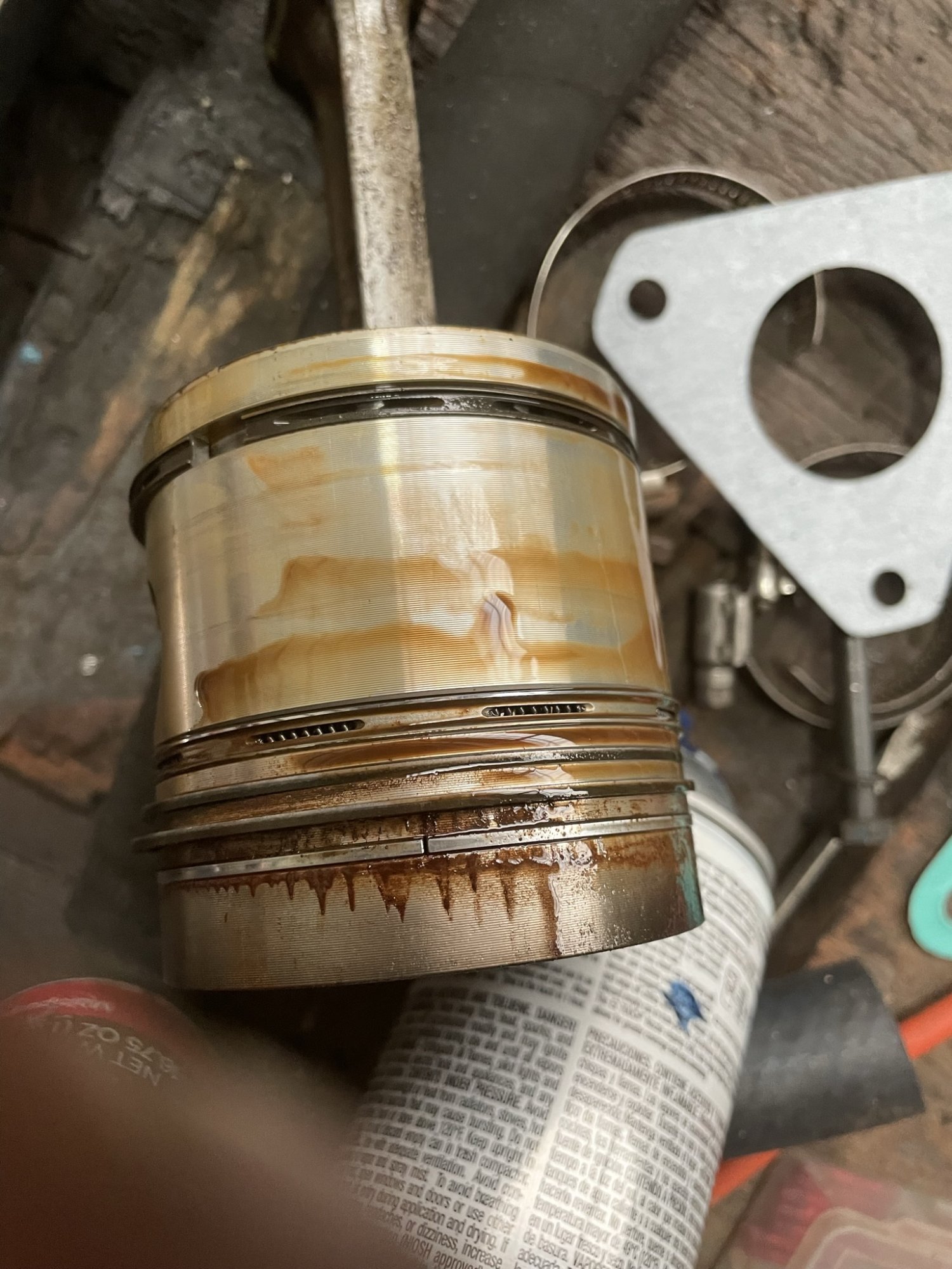

In the past couple of weeks... we have identified that the cylinders were not holding compression.
The mechanic's shop, over the winter, was located in an unused portion of a warehouse in the Port of Everett. He thought working on the engine between his other jobs would help manage his time getting him thought winter.
What with the freezing temps this winter, the damp marine air and the personal challenges of covid and a promised trip to his in-laws in Japan, the environment conspired against him. He got the engine put together, but we could not get it to fire up. Lack of compression. So he removed the head and found condensation in the cylinders. The rings never seated in the cylinders.
Here are a couple of the pictures.
Rings failed to seat. Believed due to the water in the engine. He resolved to order a new rebuild kit. This arrived last Thursday. We talked Friday. His plan is to complete the rebuild this week with any luck have the engine running in the shop Friday. If all works to plan, we should be able to install the engine some time the first week of June.

John, just some comments. I’ve had numerous engines apart (and back together) over the few decades. The reason the rings didn‘t seat is because the engine never ran. When I reassembled, I coated the ringed piston skirts with Power Punch which is a thick sticky “oil” and then stuff it into the cylinder. The Power Punch will not drain off thus increasing compression during the initial start. This is why I suggested putting some oil in the cylinders prior to first start. The pics show some oil but not much. And I have tell a story. Back in the seventies, I rebuilt a Chrysler 318 CID engine. I did not use Power Punch as I thought I would be starting soon enough. WRONG!! The engine just would not start. So, during starting, I poured (trickled) ATF down the carb. Smoke appeared and it started. It turned out over time that engine was one of the best I’ve had.
Last thought..You can put 24V to the starter for short periods to gain some compression..
Good luck and hoping for the VROOMMM!
