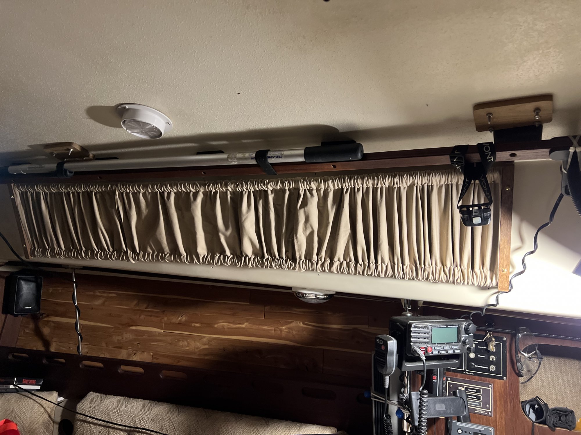

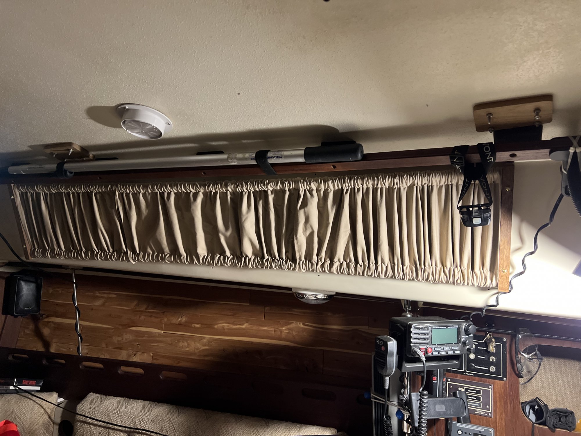

I installed my curtain set up this weekend. I came out alright, however I think I might ad another panel to tighten up the pleats.
I think they look great. I believe that you made them the correct height because they are tiget at each end. Are they mounted on rods? If so, it is likely that the tension in the fabric is causing the rods to bow inward so that the center appears to be loose. If you make them shorter, it will increase this tension in the fabric that will create greater bowing in the rods.
You might see some improvement by coming up with a way to support the rods at each dividing point in the curtains so that the unsupported length of the rods is shorter.
