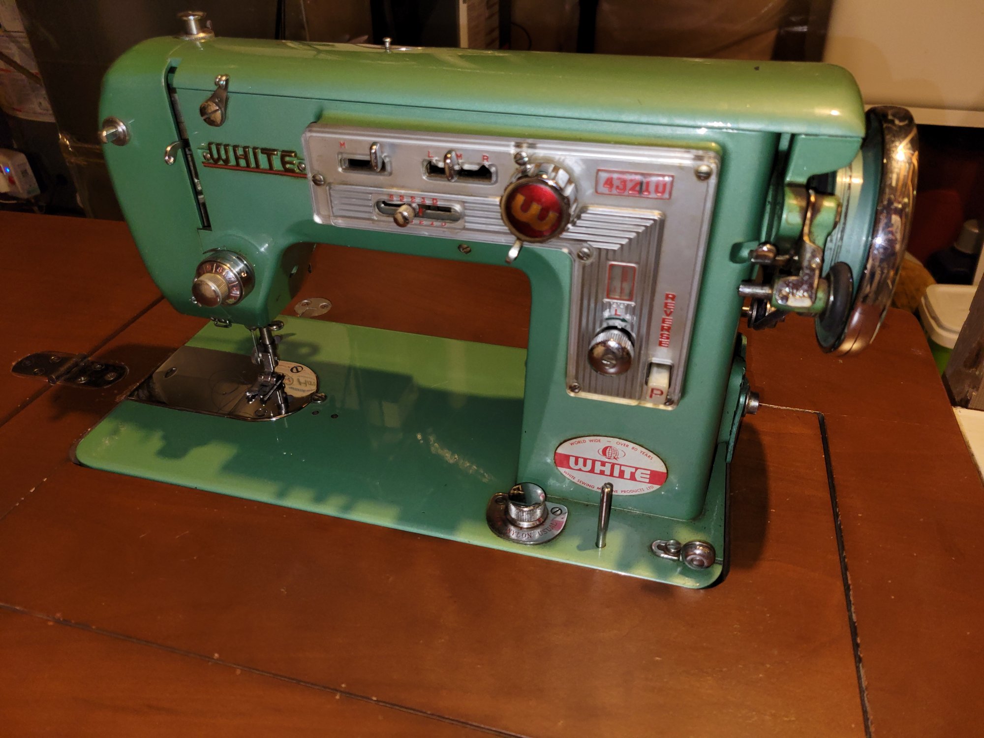

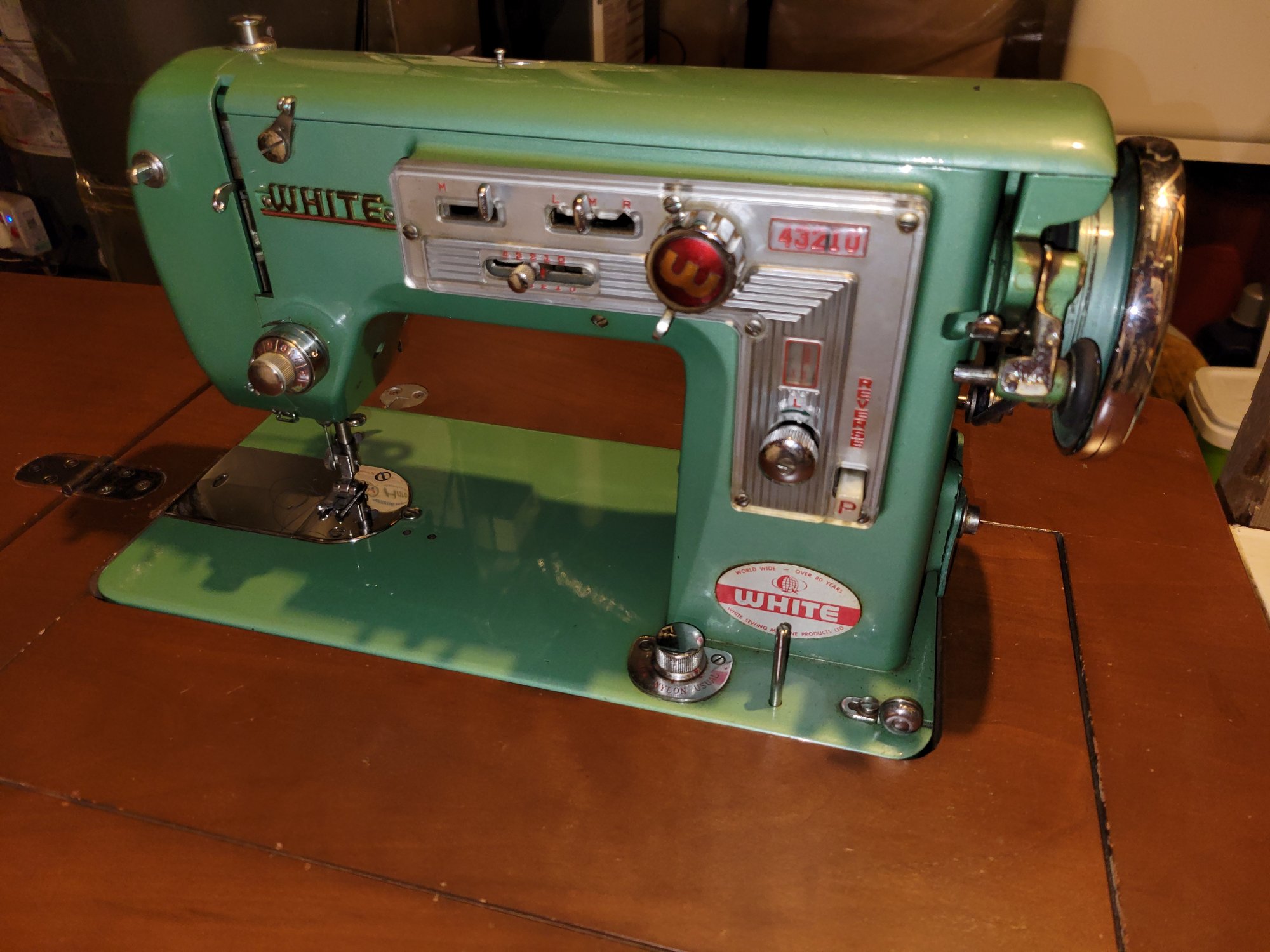

I have an old White machine that I have used to re-sew a main sail cover. I would love to have a proper walking foot machine for canvas work but I can't justify the cost for the little amount I do.
This full metal machine cost me a whopping $20 and makes it through many layers of sunbrella with only minor complaints and somewhat uneven stitching.

That's a very sweet looking machine.

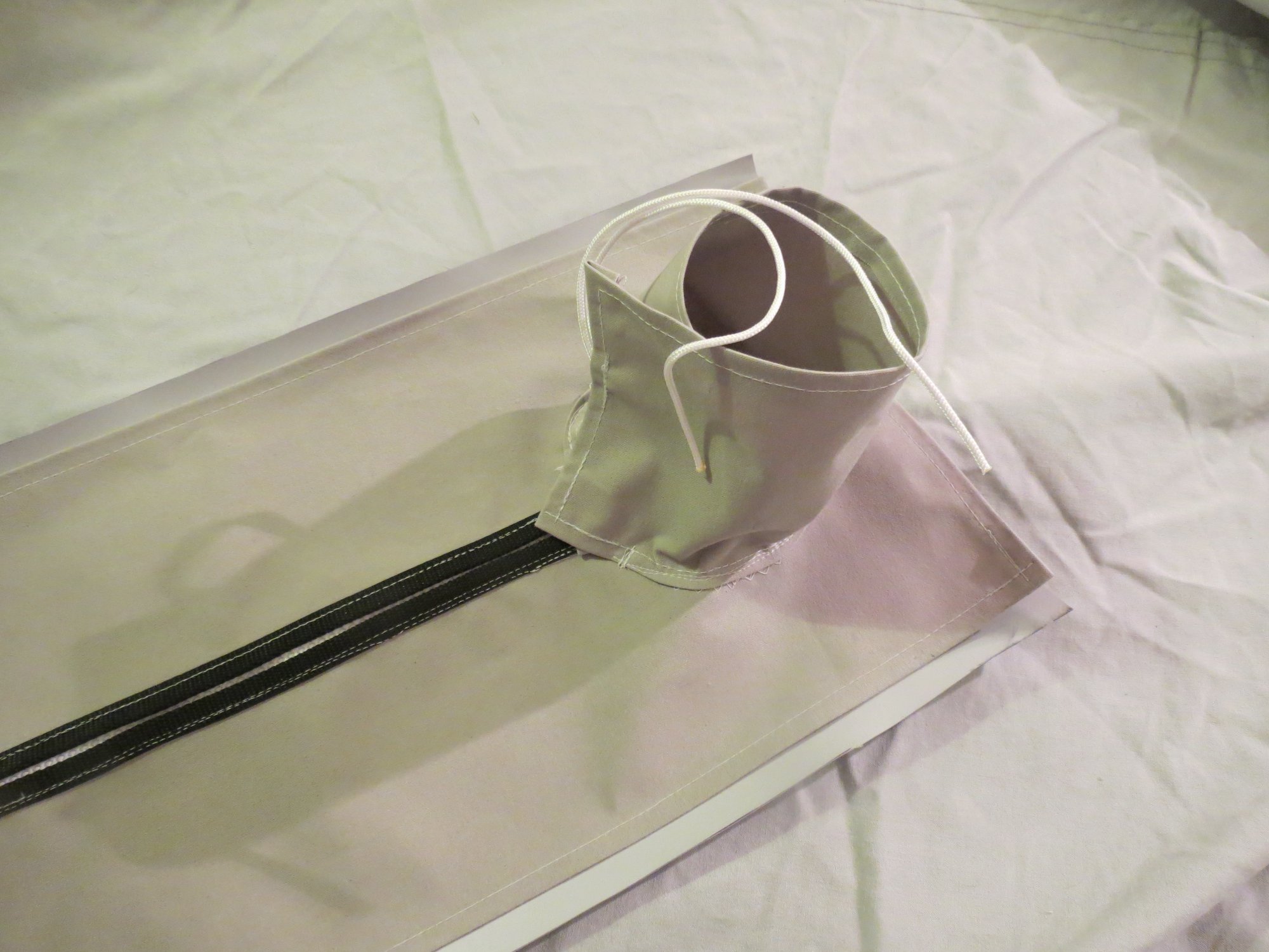

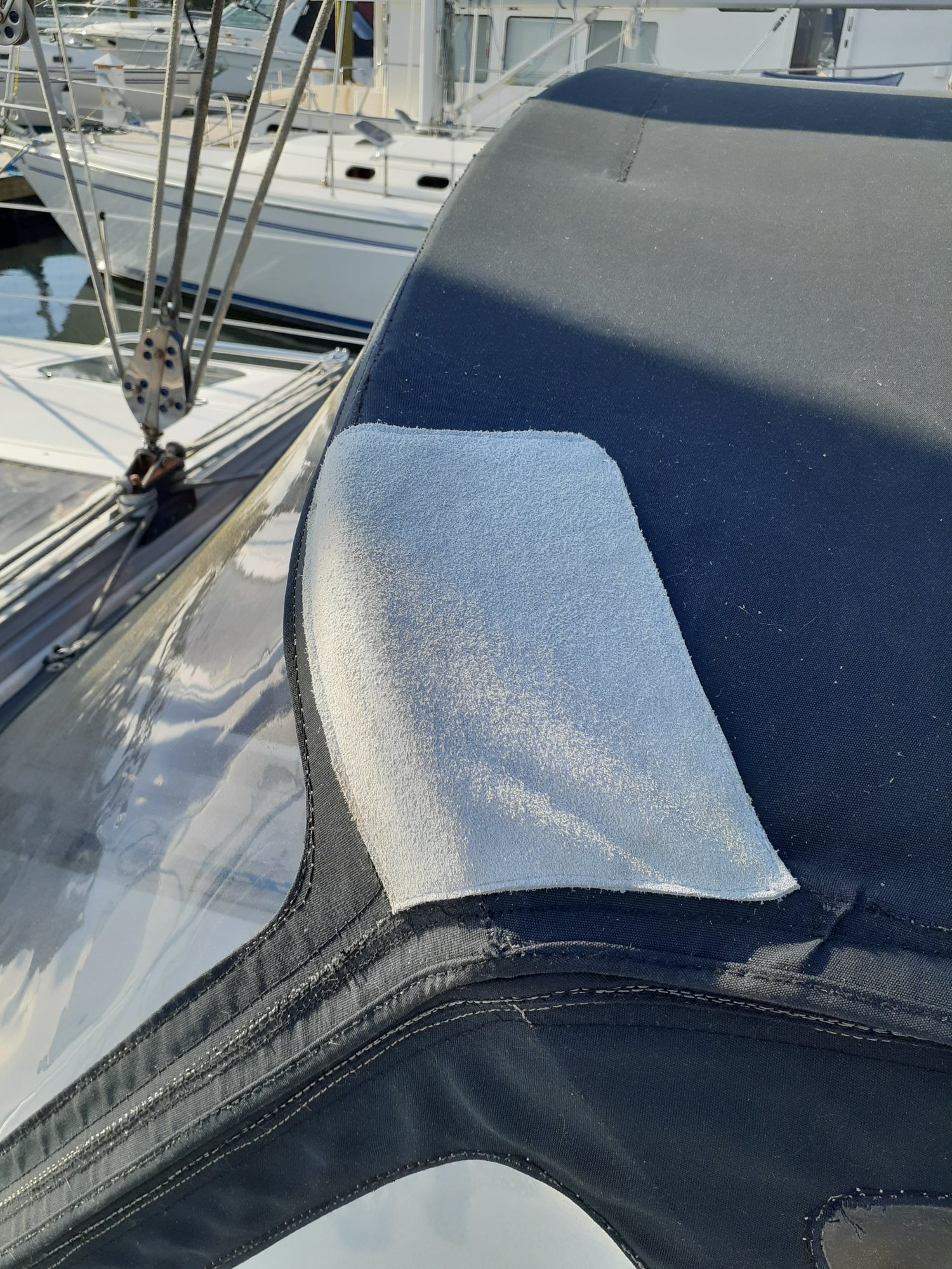

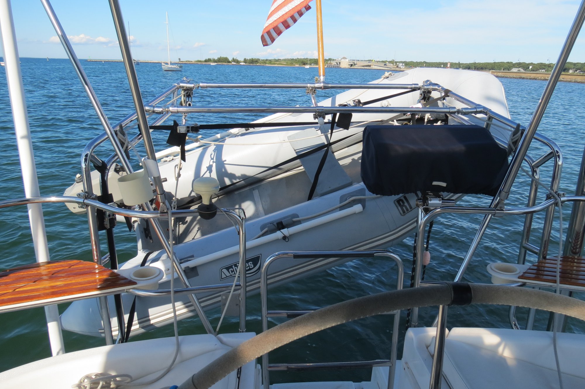

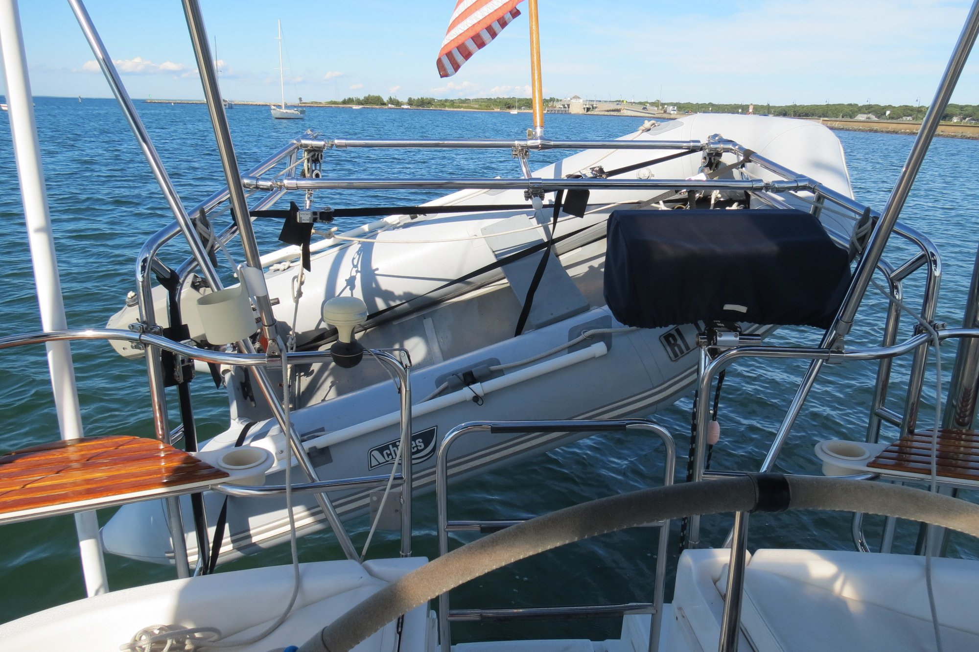

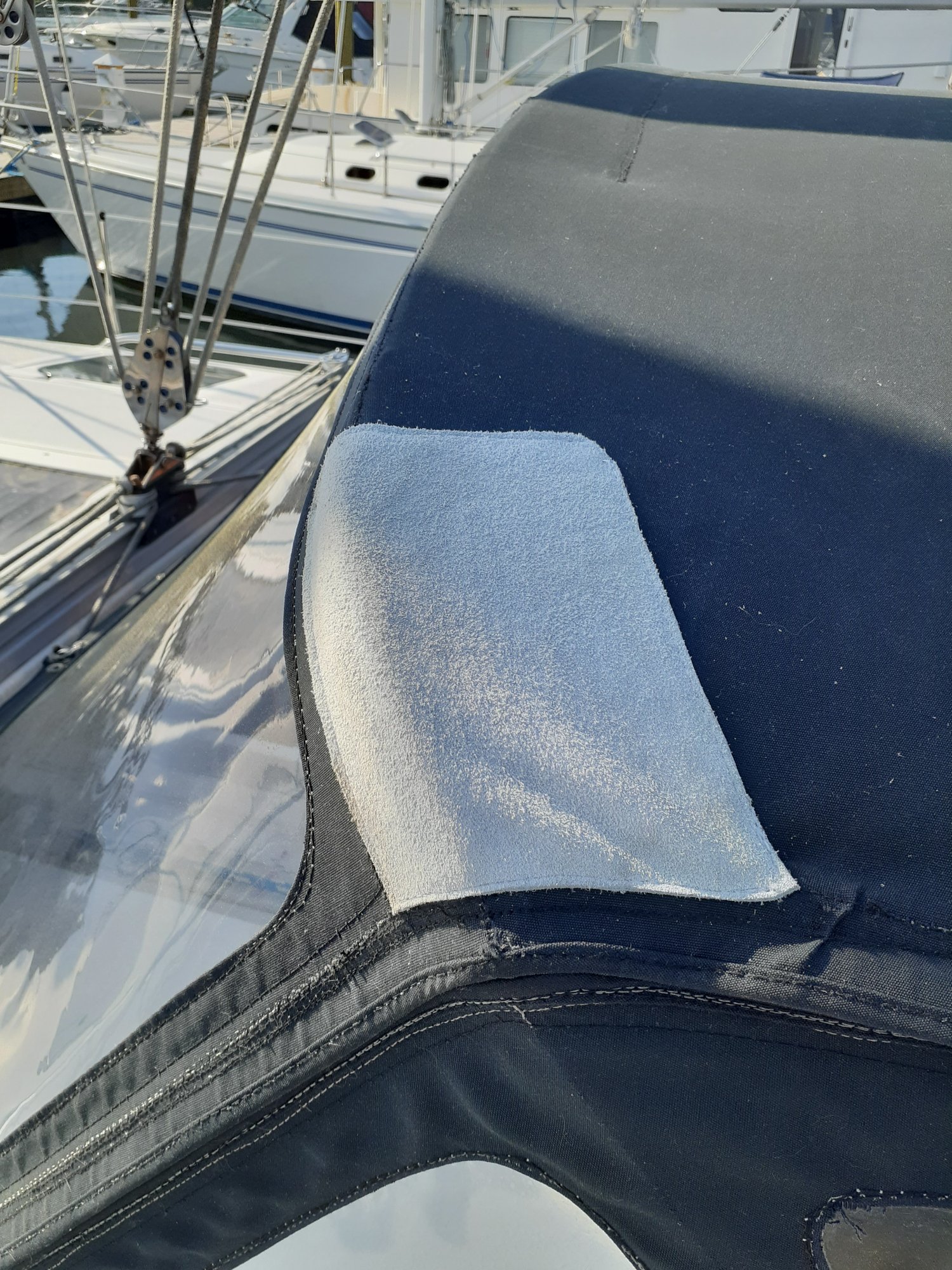

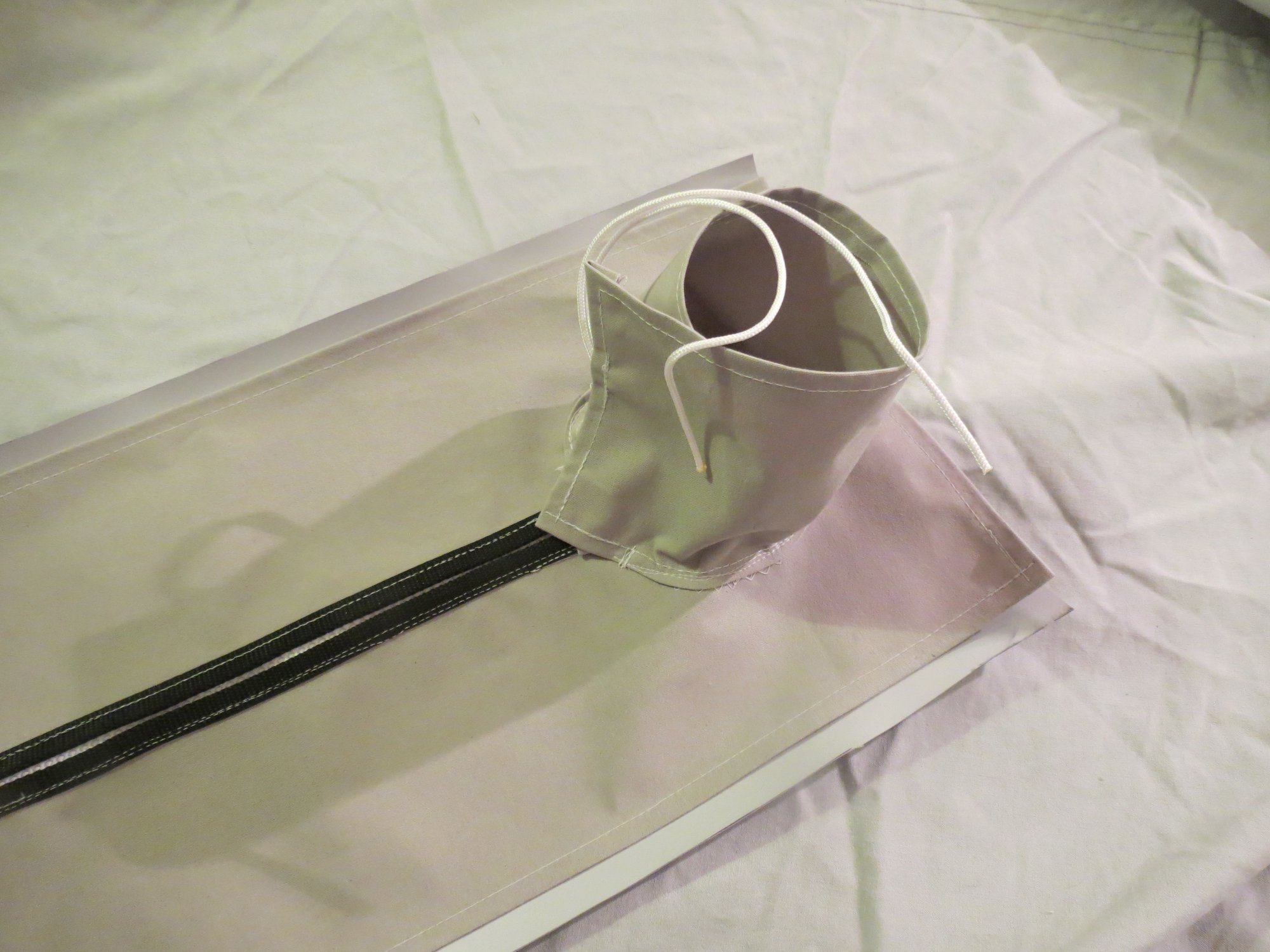

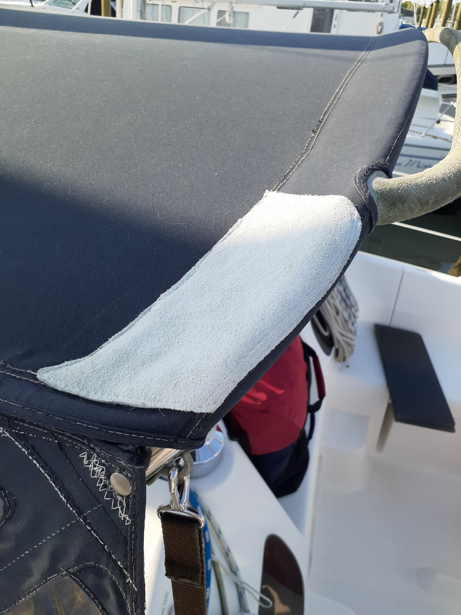

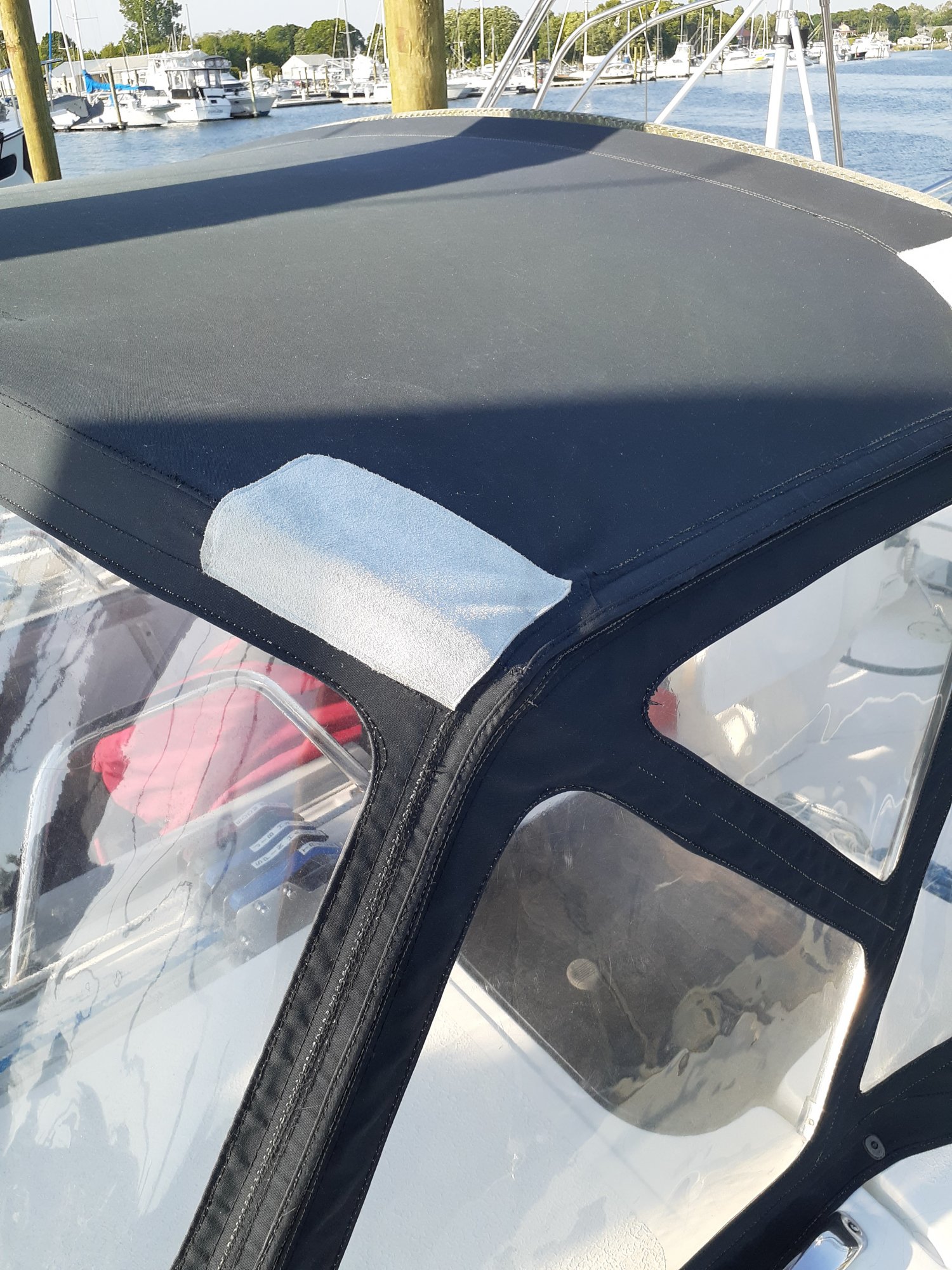

I have a friend who owns a Sailrite LZ-1. It has turned out that he doesn't do very much sewing, so I have custody of his machine. He comes to my home and does some sewing a few times per year and I use it the rest of the year. I primarily use it for repairs to my Fairclouth canvas winter cover and to repair stitching in my dodger and bimini. I have added zippers to my winter cover and split the winter cover into 3 pieces that zip together. I've added cutouts for my stern radar pole with zippers to close. I've added leather pieces to my bimini and to my dodger where hands come to rest transiting the cockpit, and I have replaced window vinyl in the dodger and bimini. I've made covers for my fenders and dock roller. I've made BBQ covers too.
And of course I hem my jeans.
The Sailrite LZ-1 and its sister machine that does just straight stitching are much better suited to marine work than a home machine. Their main claim to fame is the walking foot and the power to sew through many layers of Sunbrella and leather. I upgraded the Sailrite motor to the Worker-B system and IMHO it is the only way to power the machine. You can literally run the machine at 1 stitch per second at full power!
The only complaint that I have with the Sailrite is the short arm. It is a real challenge to get large pieces of work under the arm and it is definitely a limiting factor. And although it is billed as a "portable", the weight is far too much to lug around- I'm guessing it is about 50#.
Here are a few examples of my projects-
View attachment 220267View attachment 220268View attachment 220269View attachment 220270View attachment 220271

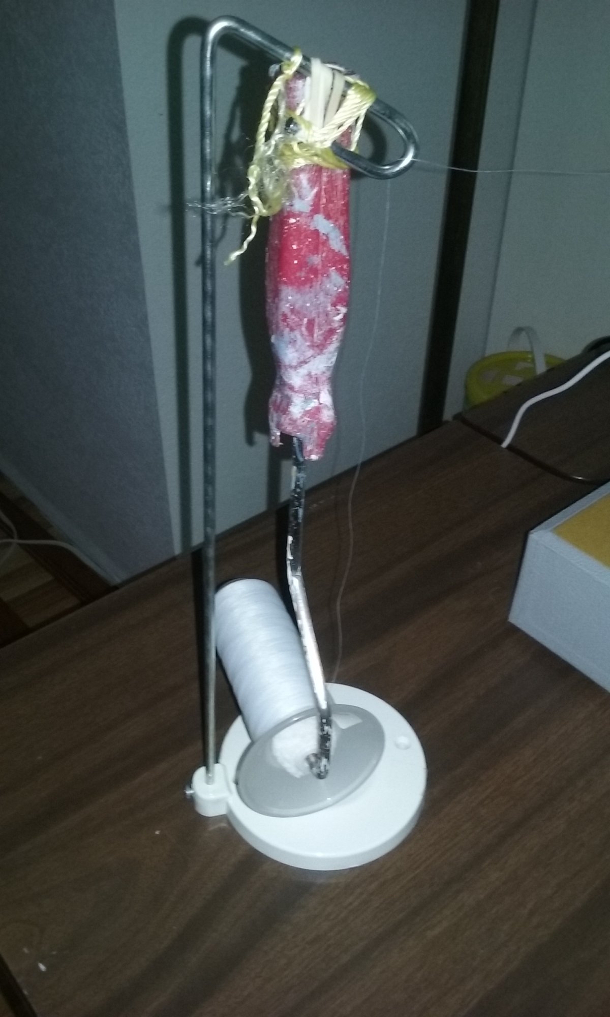

FYI, many say that the oscillating hook on the LSZ-1 will not work with Tenara thread. I used to have a ton of problems with it until I rigged up a TP roller type of thread holder [patent pending].
That and a seperate bobbin holder that has much higher bottom tension and it sews perfectly.
