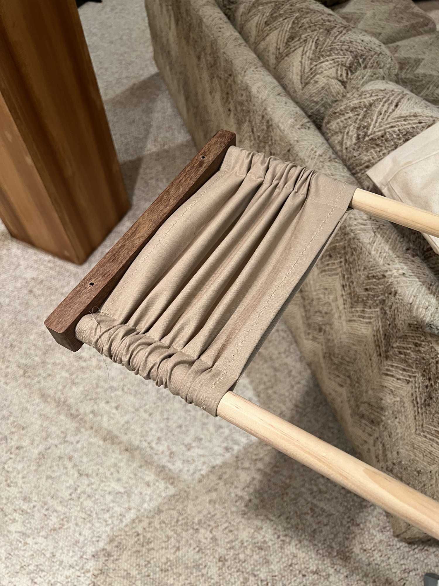

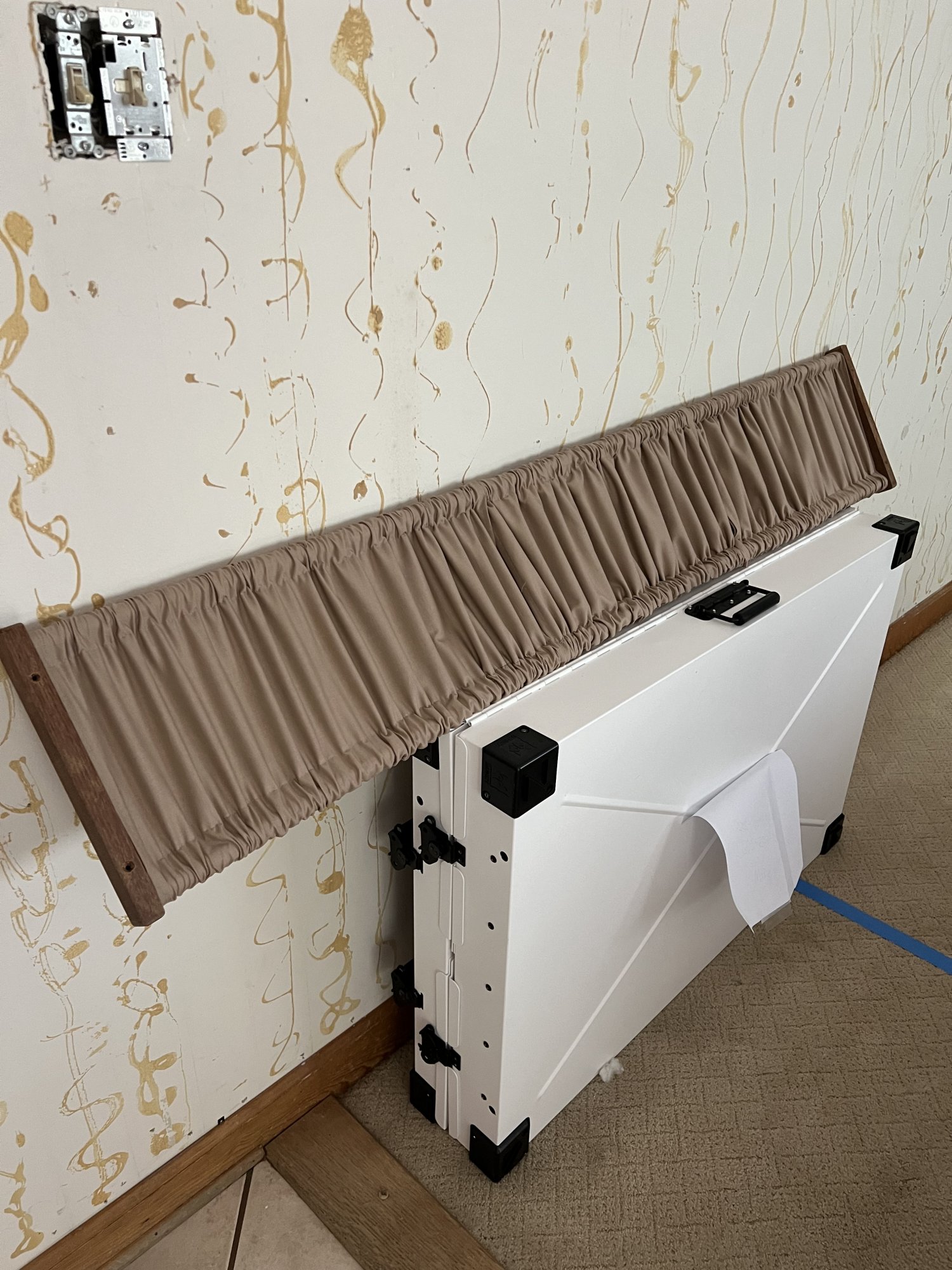

So I'm on a roll here. Having requested help from both my daughter and my wife to make some shades to go over my windows, I have continued my education in using a sewing machine, albeit the machine had to go back to the repair shop as i must have screwed something up. Yes, I admitted this to the repair tech. I think he took pity on me and fixed the issue at no charge. Today, raining again, I decided to continue on the shade project. I had made the frames and fitted them on the boat. I brought one set home to start the experimental and design process.
I made a small sample and fitted it.
Being happy with the results, I made three full size panels and assembled them on the frame.
Now to do side two.
Sometimes I just amaze myself......
