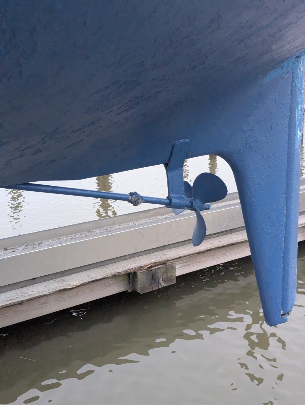

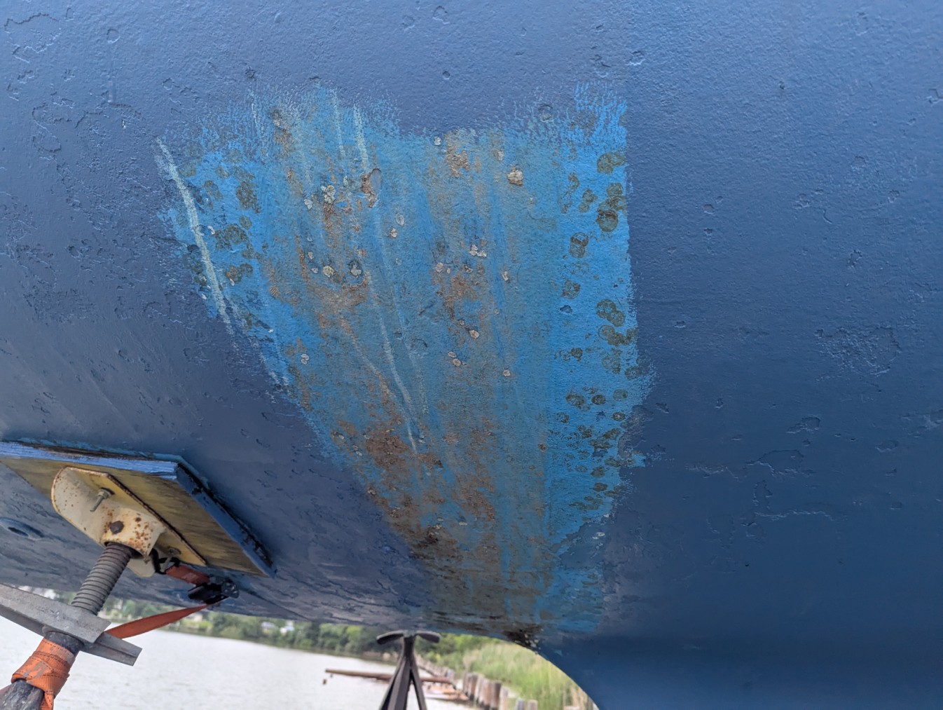

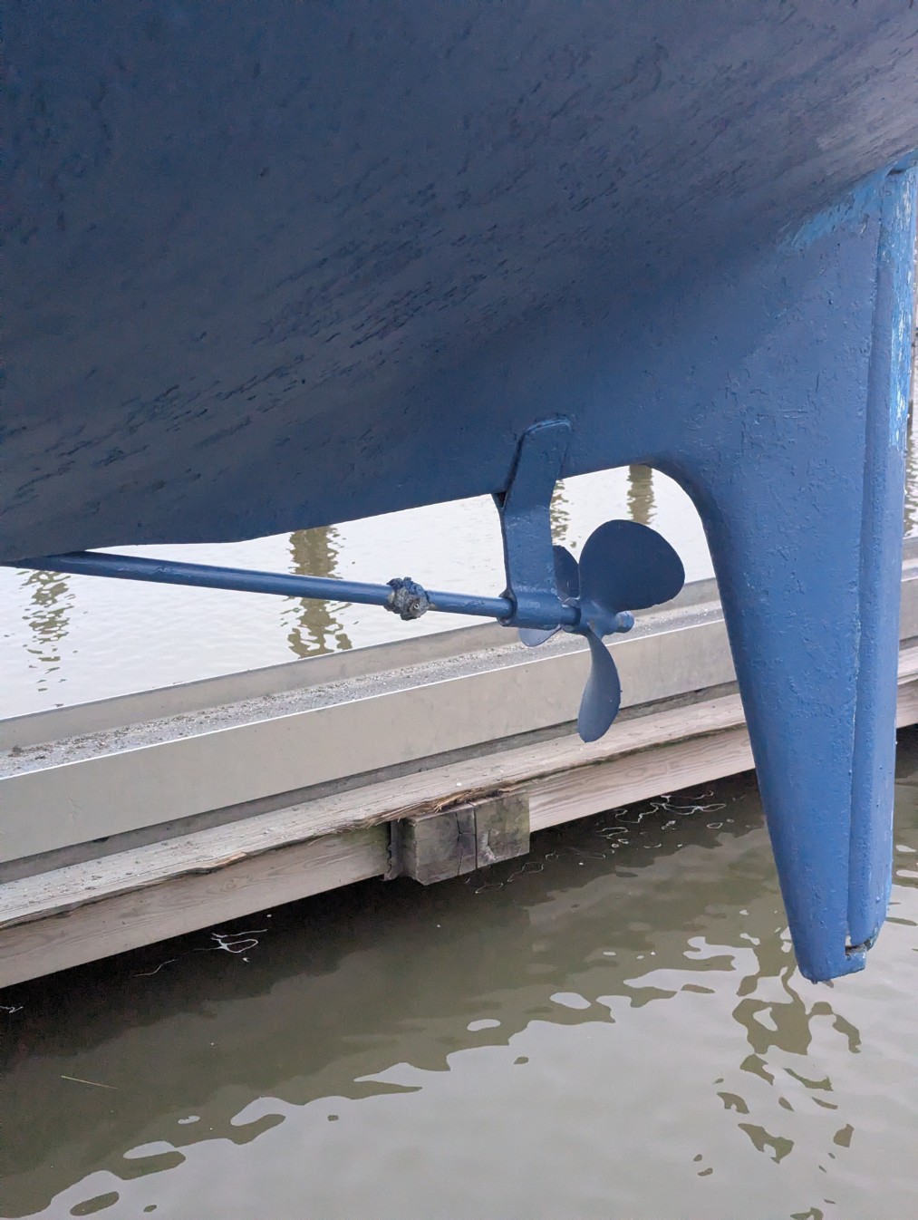

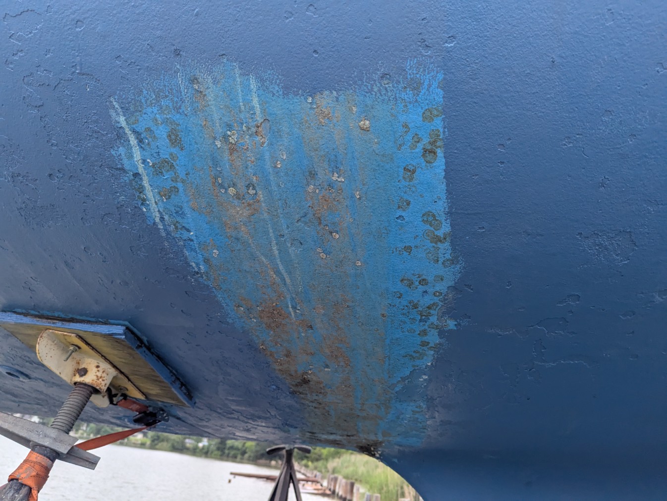

Paint looks good. Just wondering about the two pictures here. What is the purpose of painting the rudder? Just curious about the process.
May 17, 2004
5,954
In the first picture it looks like the bottom was painted while the boat was in slings, and the area under the slings not touched up. No big deal; you might just want to make sure to sand that section a little extra before repainting the bottom when you do.
In the second picture you’ll want to replace the anode before relaunching. That’s fast and easy. The existing one looks a bit deteriorated, and it looks like it has some bottom paint on it which will reduce its effectiveness. Be sure to sand the prop shaft a bit to get good connectivity before installing the new one.
The rudder needs paint like everything else on the bottom to prevent fouling growth. If barnacles or excessive slime are allowed to grow anywhere on the bottom the boat will be slowed. If they grow on the rudder steerage will also be a bit compromised.

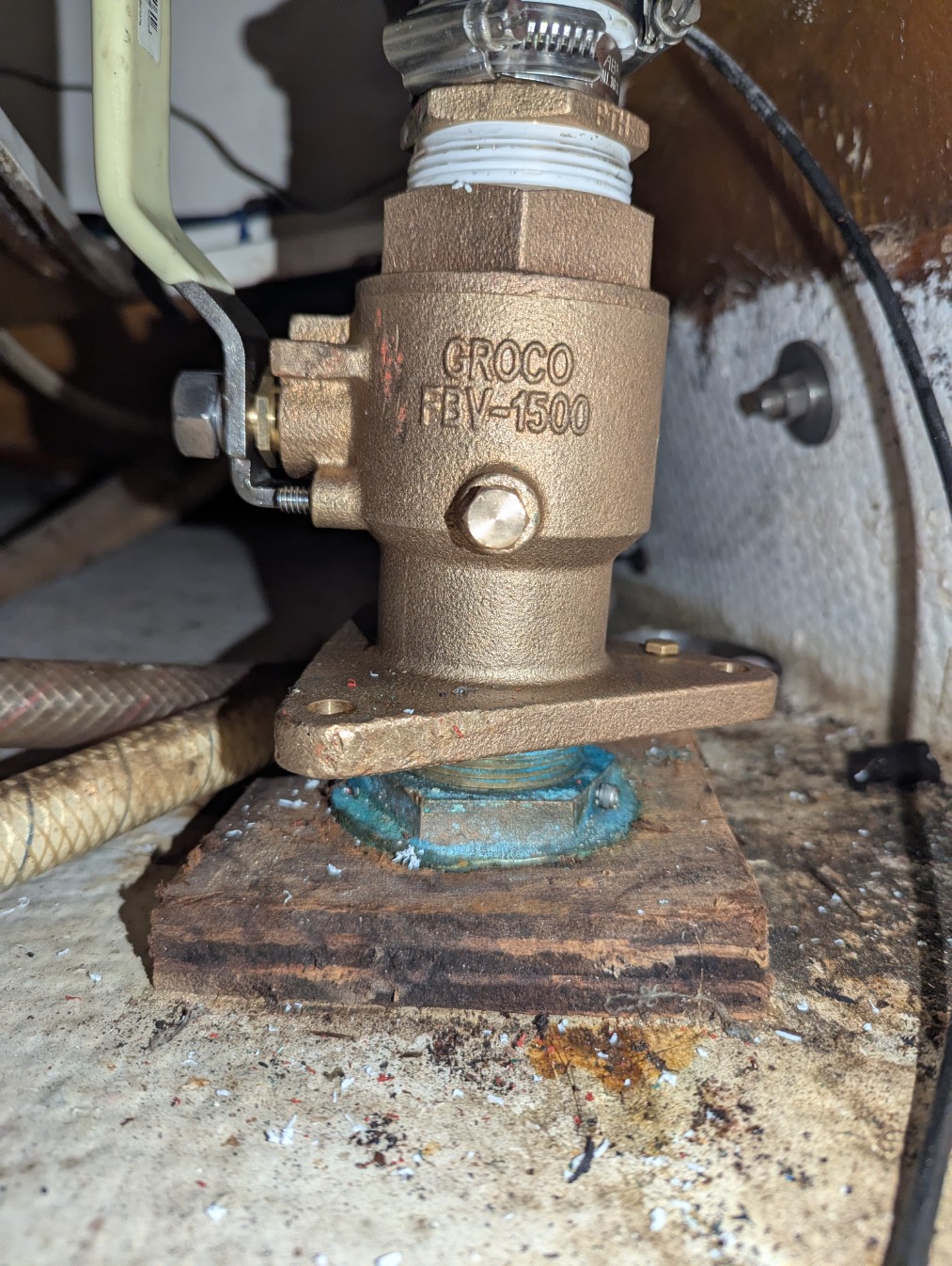

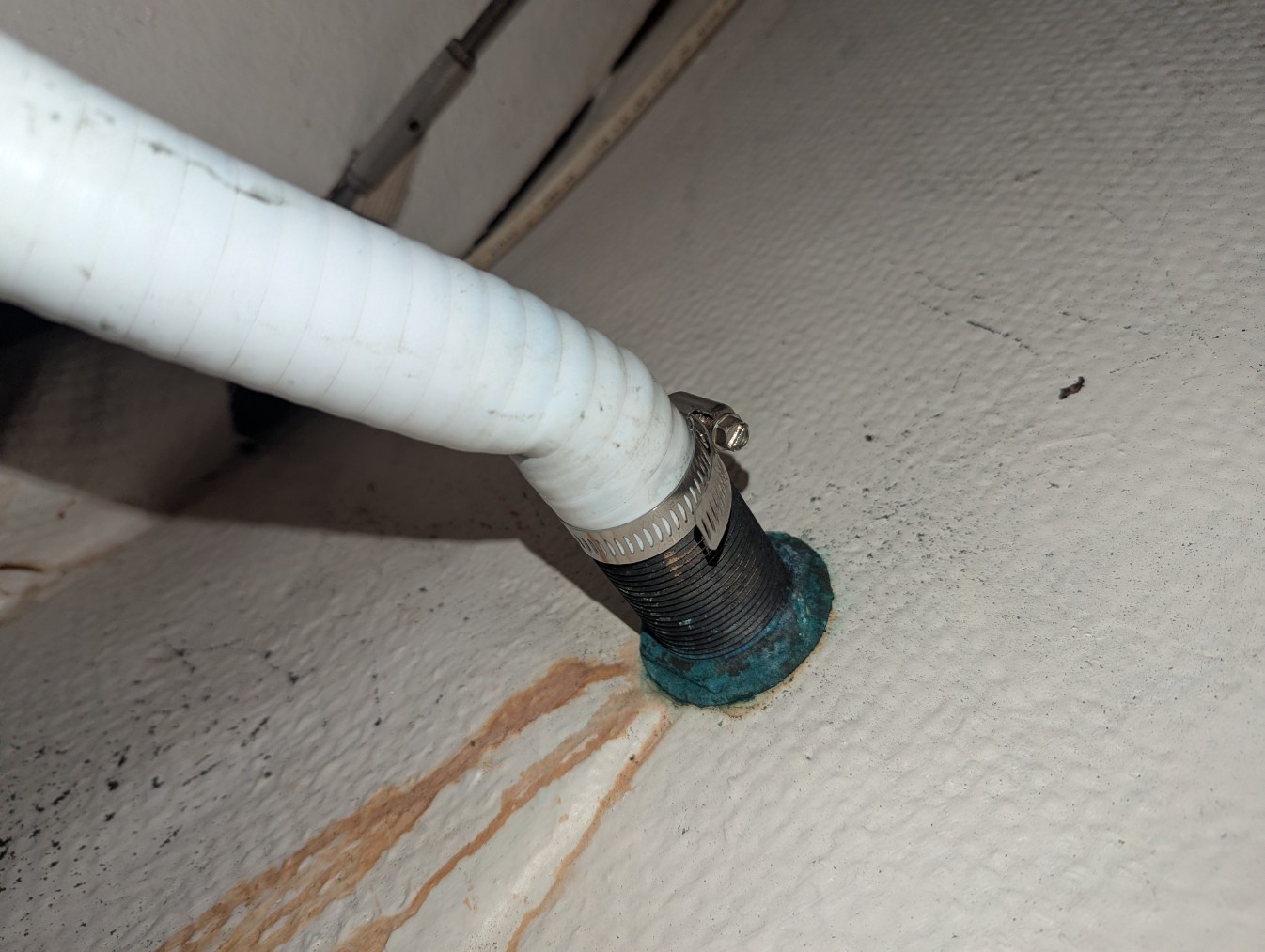

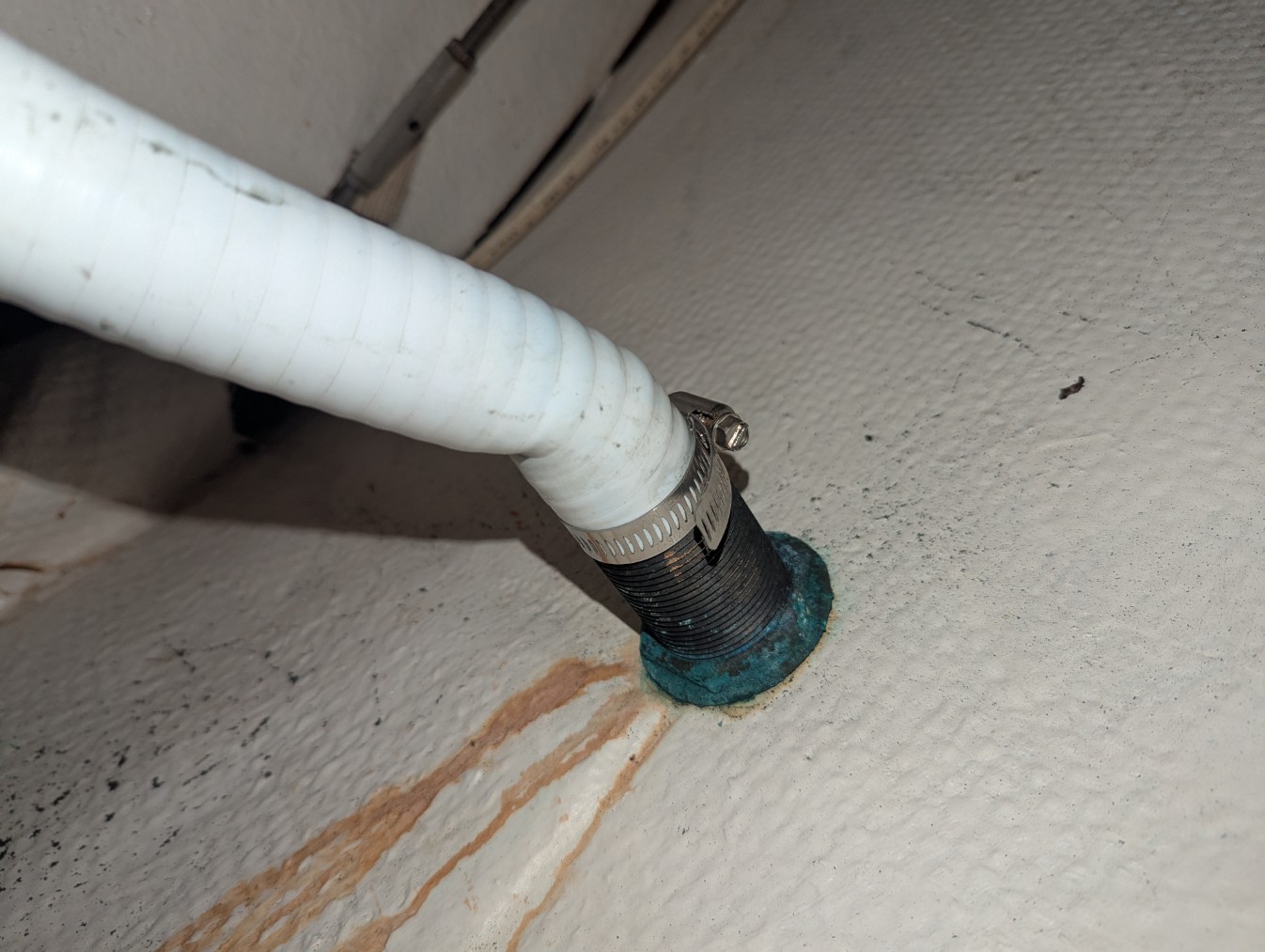

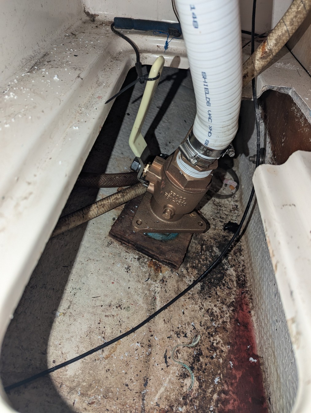

I don’t mean to be critical (and if the boat yard did this, it is terrible), but those photos are very concerning to me…:yikes:
The white hose with the hose clamp is NOT on an appropriate barbed fitting (they just put it on the skin fitting).
The Groco fittings with the triangular bases are not engaged with the skin fittings properly and the bases are supposed to be down on the backing plates…

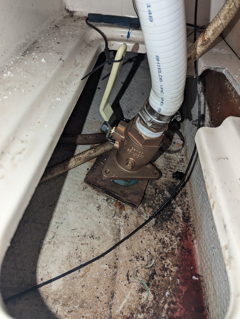

My boat is finally out of his yard and I'm trying to get it to a DIY yard to employ the wonderful advice from this thread.

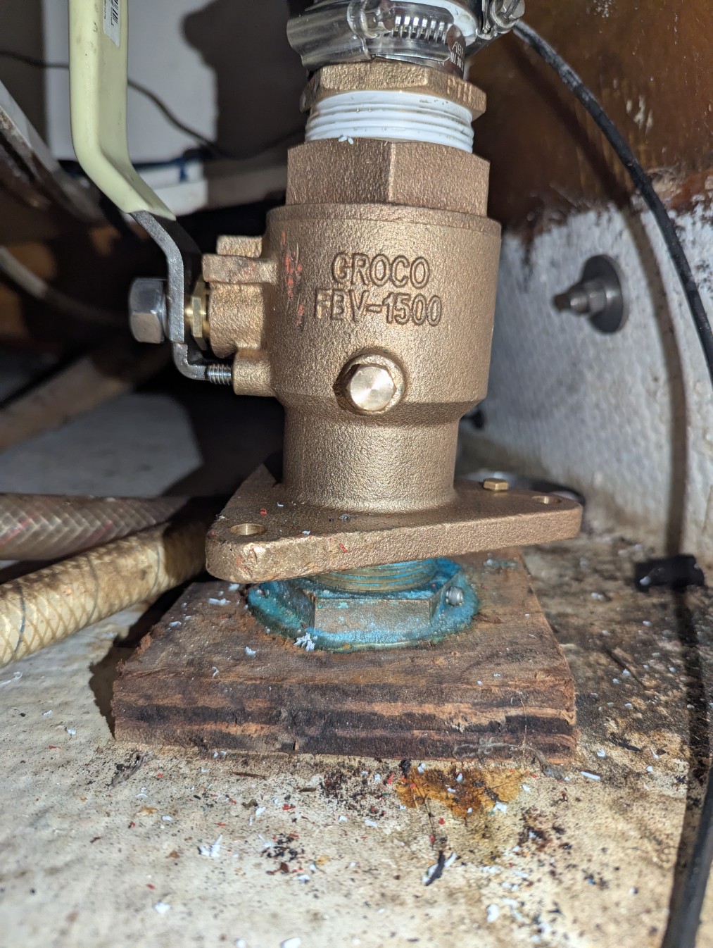

Here is some of the work.
Something was lost in the translation. :facepalm:
This is better than what you started with but can still be improved.
For a “proper” installation that Groco FPV1500 sea cock’s triangular base should be snug to the backing block, and the nut that is currently snug to the backing block should be eliminated. See Replacing Thru-Hulls and Seacocks - Marine How To
To make that change you need to remove it, remove the nut, grind the outside mushroom head off the thru-hull and start over with a new thru-hull. Measure the thread length of the thru-hull “tail” from the backing block to the end, and measure the length of thread inside the sea cock. If necessary, cut the tail of the thru-hull leaving about 1/4 to 1/8” less than the threaded length of the inside of the sea cock to allow the sea cock to be fully seated and still have as many threads engaged as possible. When seating the sea cock, use teflon tape on the threads, and put sealant on the backing block beneath the base. You will need to apply 4200 sealant and have an assistant screw in the thru—hull from outside using a step-wrench.
Other suggestion for improvement - use better quality hose clamps (solid not perforated) as mentioned elsewhere in this thread. When using double clamps, position the adjusting screws opposite each other when possible.
:plus: on what @Tally Ho wrote
PS - when cutting the tail of the thru-hull do the cut with the nut still screwed on. Then spin it off and discard it. When it’s removed the nut will help straighten any thread distortion caused by damage from making the cut. The sea cock will serve as the nut when properly installed. A cut-off wheel on a grinder will make a smoother cut than a hack saw. Dry fit your parts together for test with your assistant BEFORE using sealant for final assembly.

There are so many violations of 'best practice' and of 'common sense' in those photos, that one's mind boggles...
IF, an editor were selecting photos of dangerous installations to illustrate an article about boat plumbing, they would likely pass on those as too strange/difficult to believe!:(
A heartfelt outburst along the lines of" "By Grabthar's Hammer" seems appropriate!! :yikes:

These photos reinforce my philosophy of learning about boat systems & repairing by “doing it yourself” when possible. I learned quite early after one particular boat yard messed up several repairs and I had to go back & fix properly. Costly mistakes on my part until I wised up! You received sound advice from several experienced members on how to accomplish replacement of the defective ball valves. No one suggested the repair as seen in the photos! I know that the yard was pressuring you; however, you could have purchased replacement valves, tailpieces, & hose and swapped them out in three hours or less without the yard being aware. (Without replacing the thru hull fitting) and requesting that the yard splash the boat. Then do a more thorough repair (replace thru hull fittings) in a few months on future scheduled haul out.

... I'm trying to get it to a DIY yard to employ the wonderful advice from this thread.
I think the prior 4 four posts are ignoring the above part of the OP's post #111.
He is working toward a good solution. he has replaced the defective ball valves which, I think, were his original problem. In doing so he has used Groco flanged adapters which solve the mismatch between straight and tapered threads. He has said in prior posts that he is working on better backing plates and I assume he will follow through on what he has said and will use those backing plates to properly install the flanged adapters. Personally I think what has been done is a good interim step and better than what he had. You can't second guess him on whether he had the time or ability to do a more complete job in the time the yard he was in would allow.
The hose and through hull without a backing plate or valve is certainly an eye catcher but the through hull is the same as it was before, with what appears to be a new hose. An improvement. I think, (hope) that fitting is for an above the waterline head sink drain.
He is working toward a good solution. he has replaced the defective ball valves which, I think, were his original problem. In doing so he has used Groco flanged adaptors which solve the mismatch between straight and tapered threads. He has said in prior posts that he is working on better backing plates and I assume he will follow through on what he has said and will use those backing plates to properly install the flanged adaptors. Personally I think what has been done is a good interim step and better than what he had. You can't second guess him on whether he had the time or ability to do a more complete job in the time the yard he was in would allow.

A shame to spend $$ for a nice seacock, and then screw it on an over-long through-hull. A little better than a brass valve (mostly because these are straight threads, not tapered), but not a whole lot better. There are good tutorials on-line.
Note: You cut the through hull down to length before screwing the flanged seacock on.
I understand about thin hulls. This hull was only 3/16-inch thick, so I bond a fiberglass plate first to make a strong spot. Common practice, won't rot and get loose like plywood can. A flanged seacock then went on the bolts. Bronze bolts are better with a bronze valve (this was a Marlon valve). This was the AC water intake.
