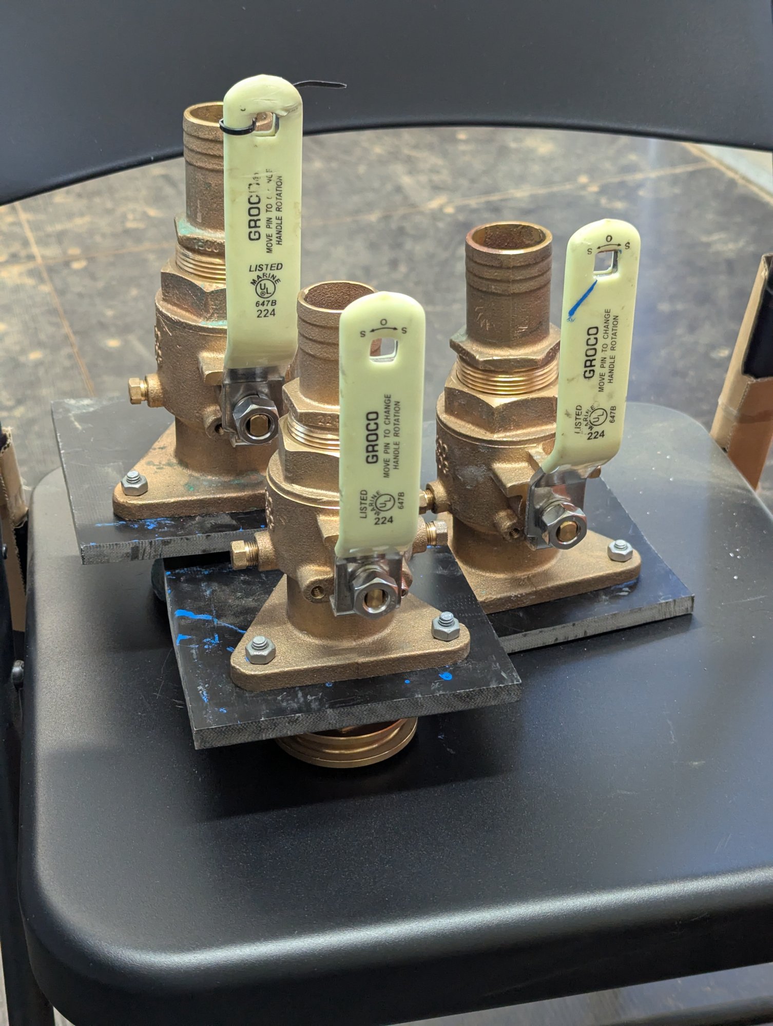

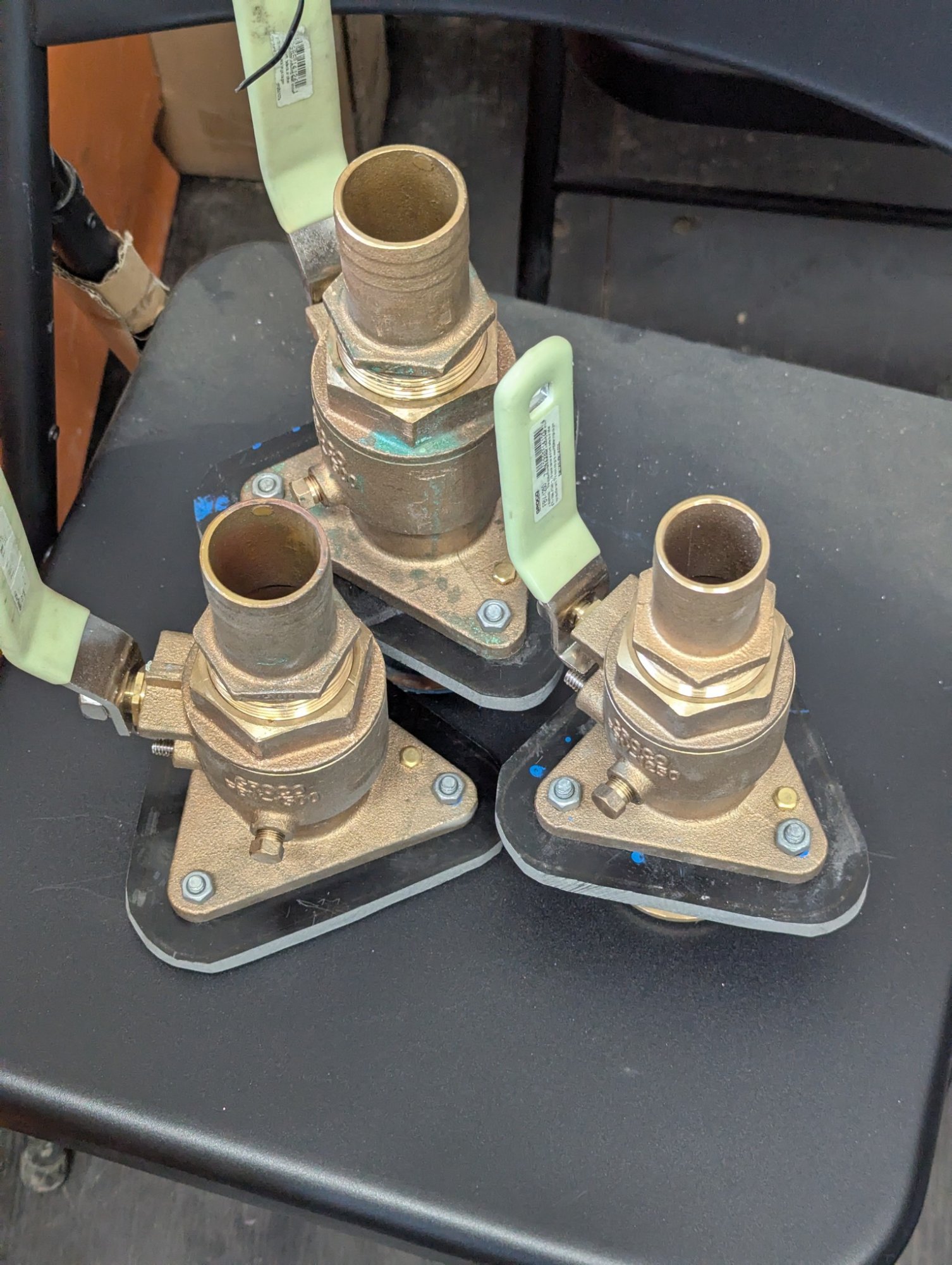

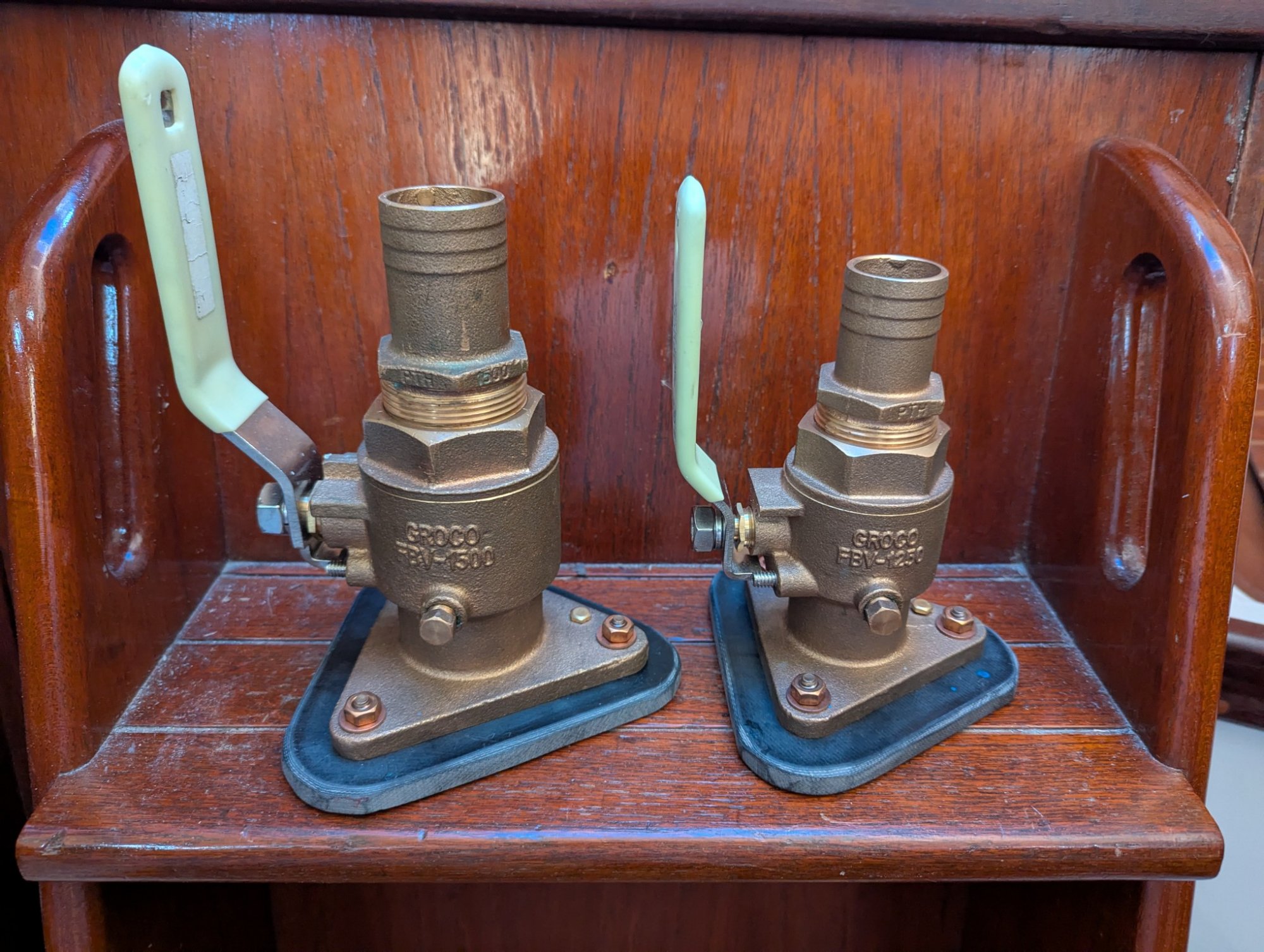

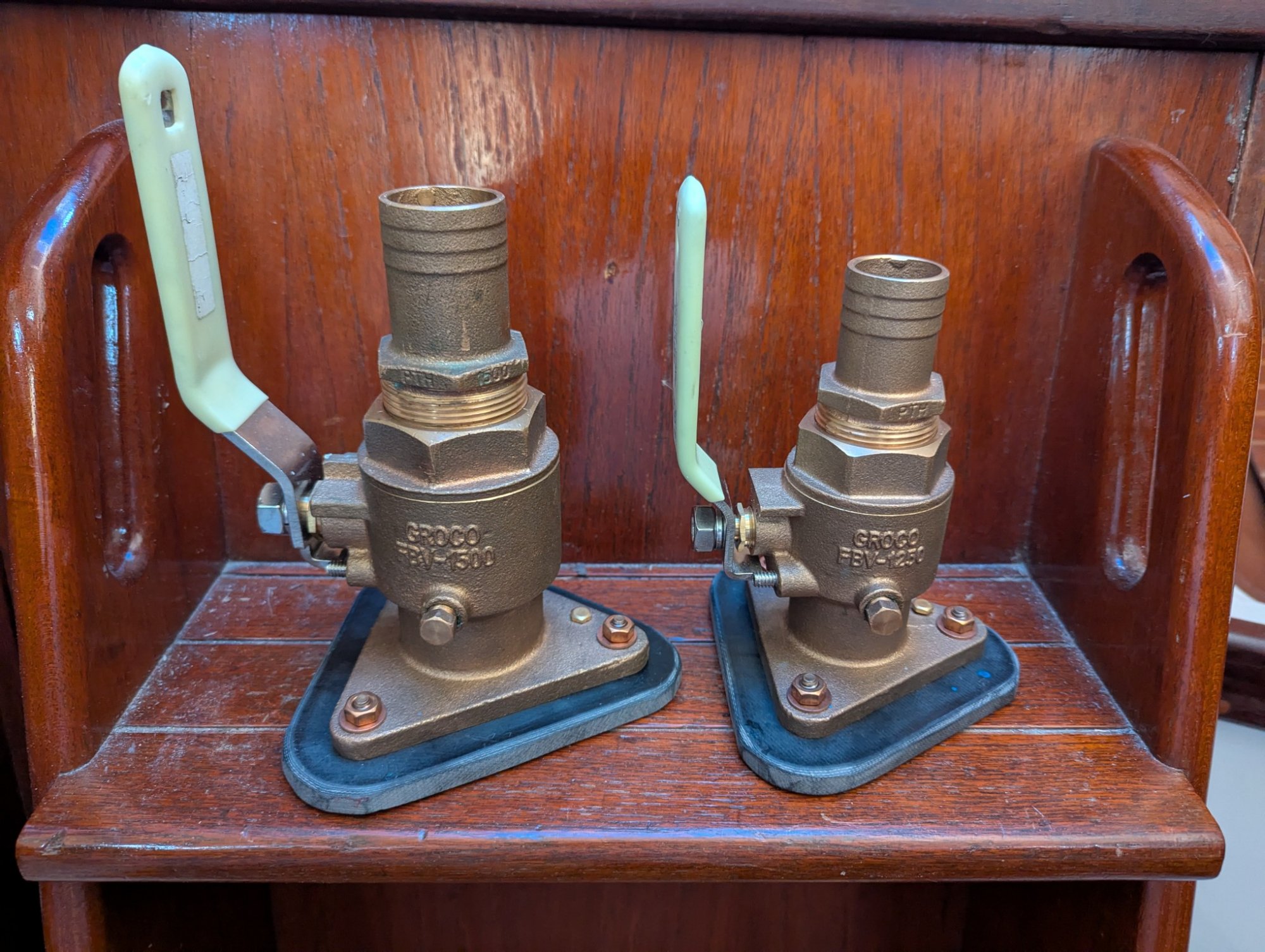

Some time ago I was researching using Groco adaptor plates & G10 backers on my boat. (The adaptor plates have the same foot print as the seacocks.). Some members suggested either tapping threads into the G10 or embedding nuts into the bottom surface of the G10 & screwing the adaptor plates or seacock down into the G10 plate to avoid having the threaded studs ( and nuts) protrude from the top of the plate. If the seacock or adaptor plates would ever have to be replaced, it would be very difficult or impossible to remove without cutting off the base of the seacock. The protruding studs would prevent rotation of the seacock to enable it to be disengaged from the thru hull fitting that is threaded into the seacock or adaptor plate.

I'm not sure what you guys are talking about, tapping threads or whatever...
What we are talking about is provisions for removing the seacock in the future if the need arises. With the seacock thru bolted thru the backing plate, as shown, how would you remove the seacock? I am assuming that your backing plate will be epoxied or adhered (4200/5200) to the inside of the hull. If the head on the bolts is between the hull & backing plate, you can hopefully remove the attaching nuts, but the studs will still protrude thru the seacock base, making it impossible the break the seacock loose from the thru hull fitting & backing plate. @mermike tapped threads into the G10 backing plate and screwed studs into the plate, that has nuts tightened onto the studs. If he has to remove the seacock, he can remove the nuts and then unscrew the stud from the G10 plate, allowing for means of removing the seacock.

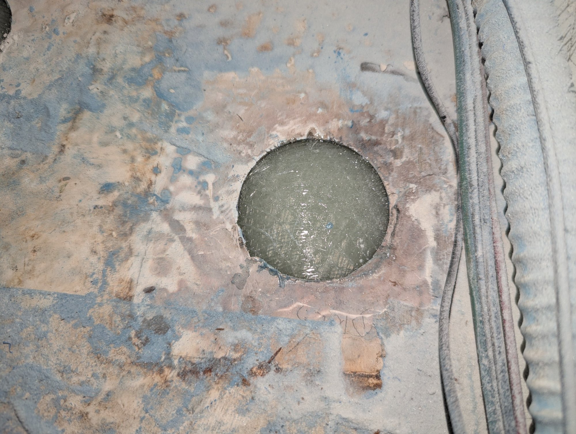

Expanded the head intake and engine intake to 1 inch using a hole saw and ordered the Groco Seacocks for them.

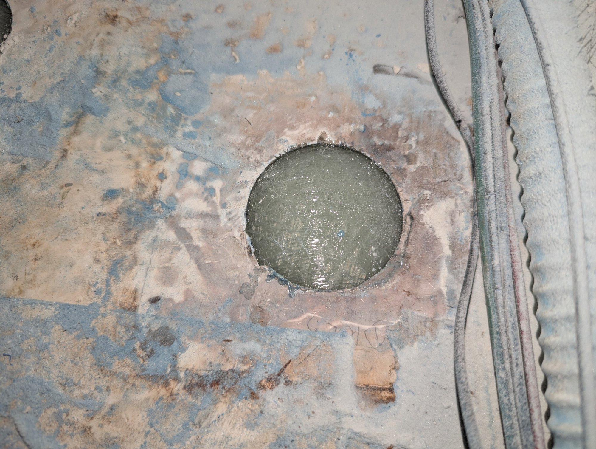

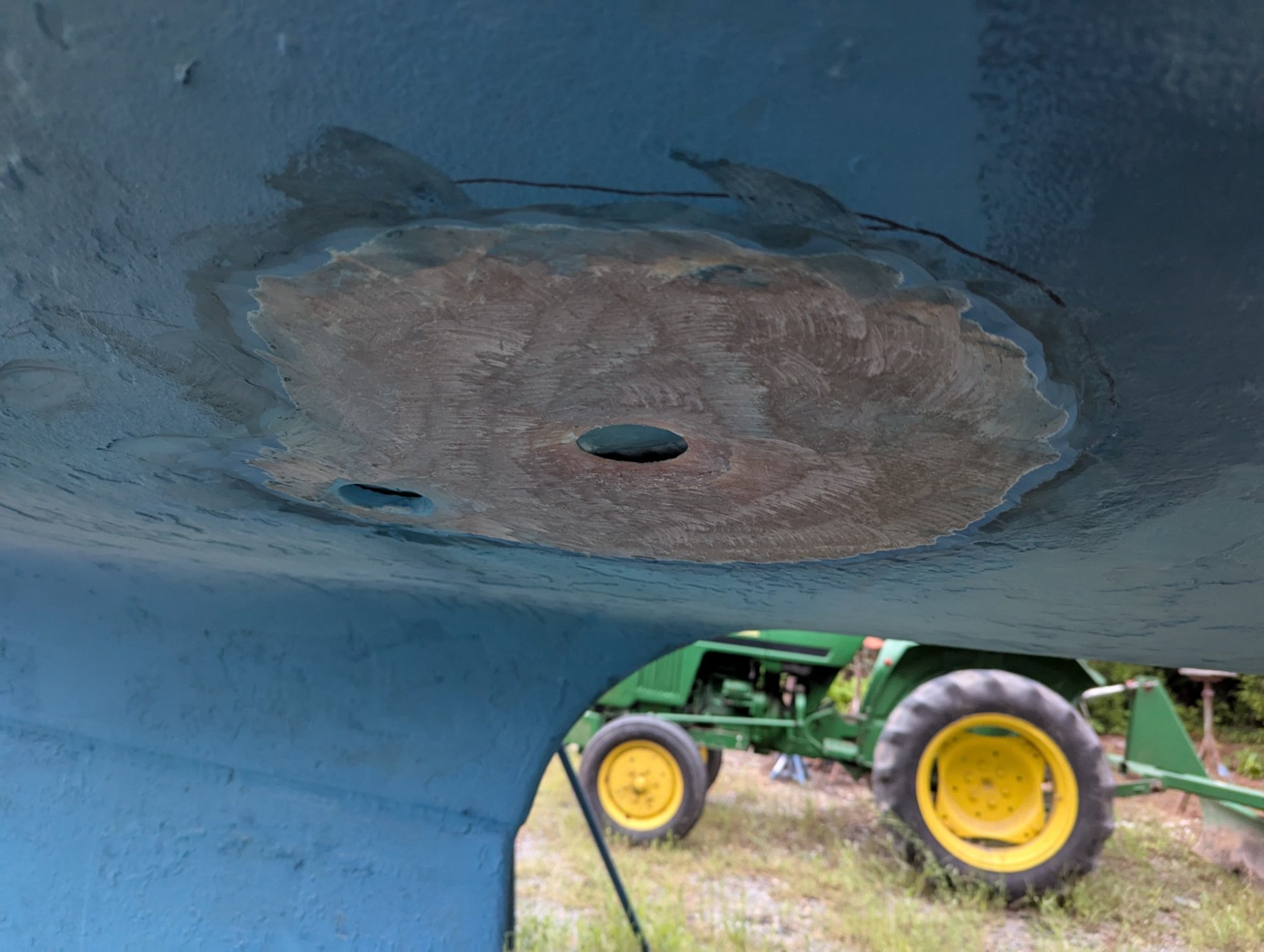

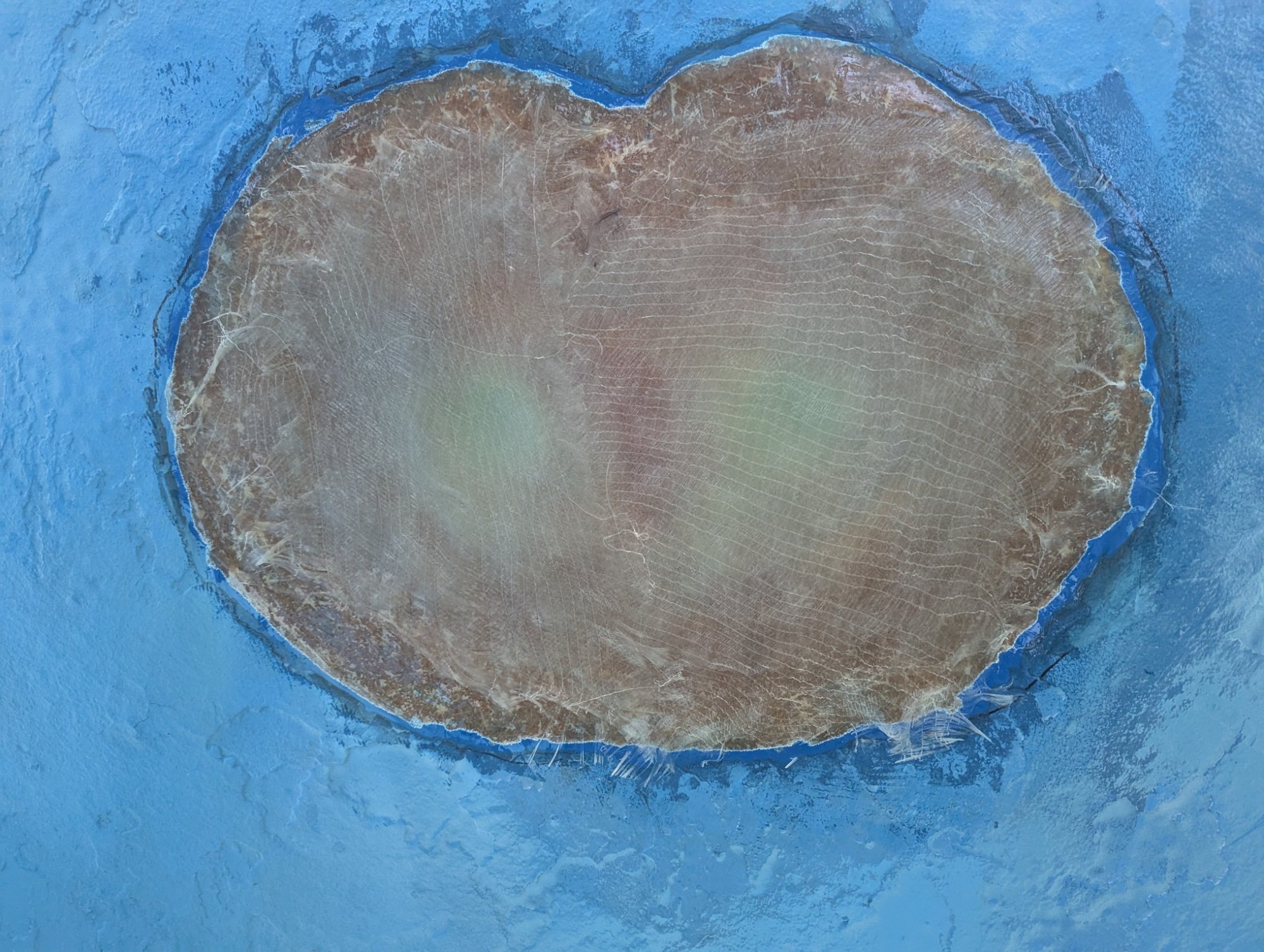

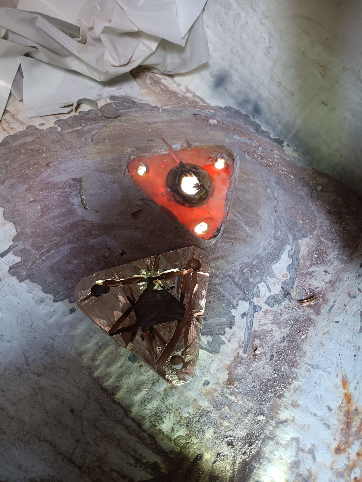

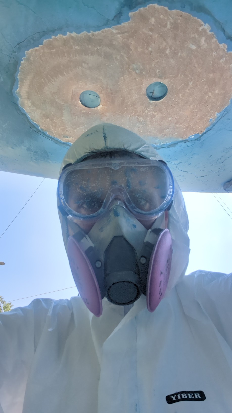

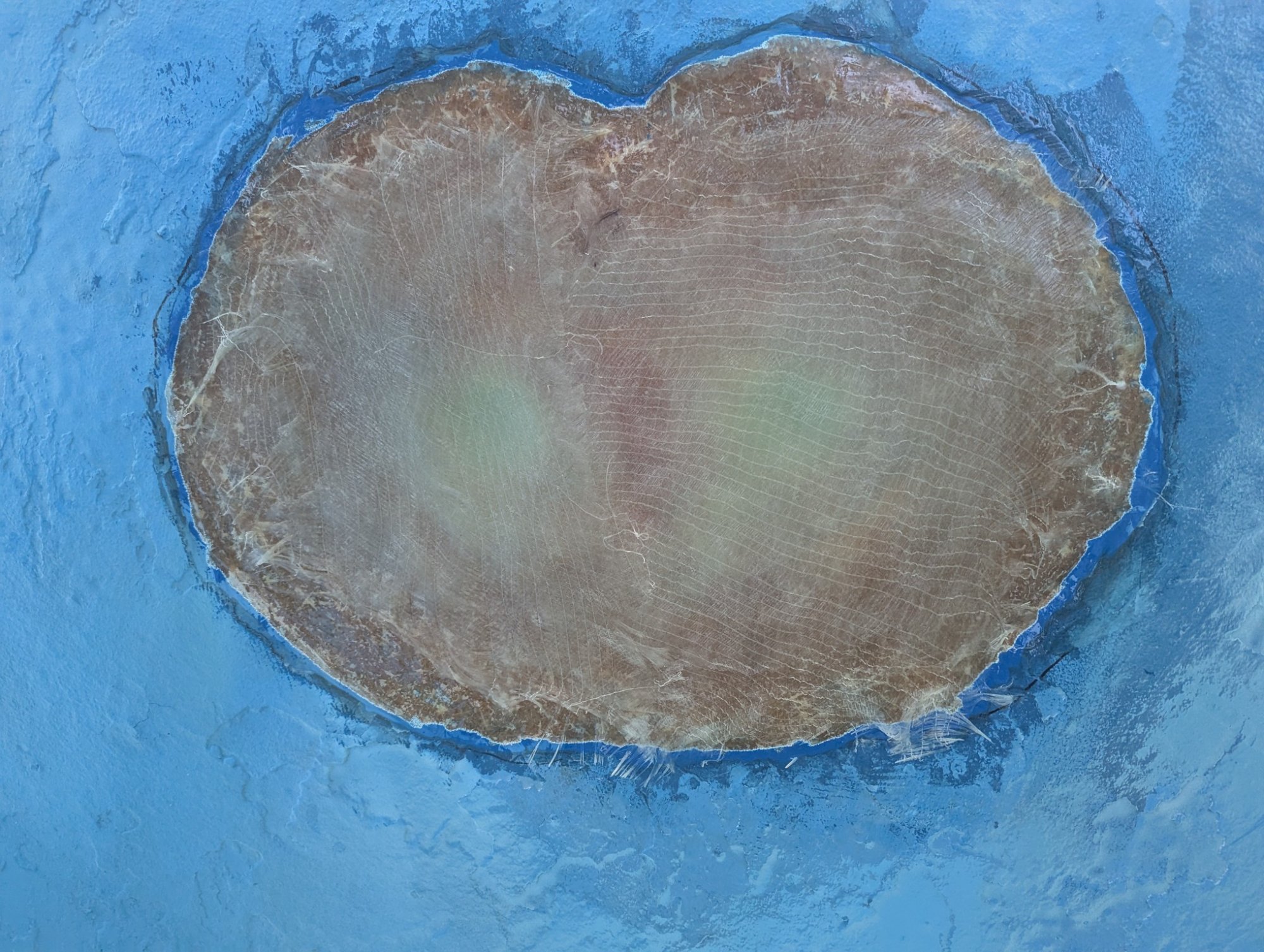

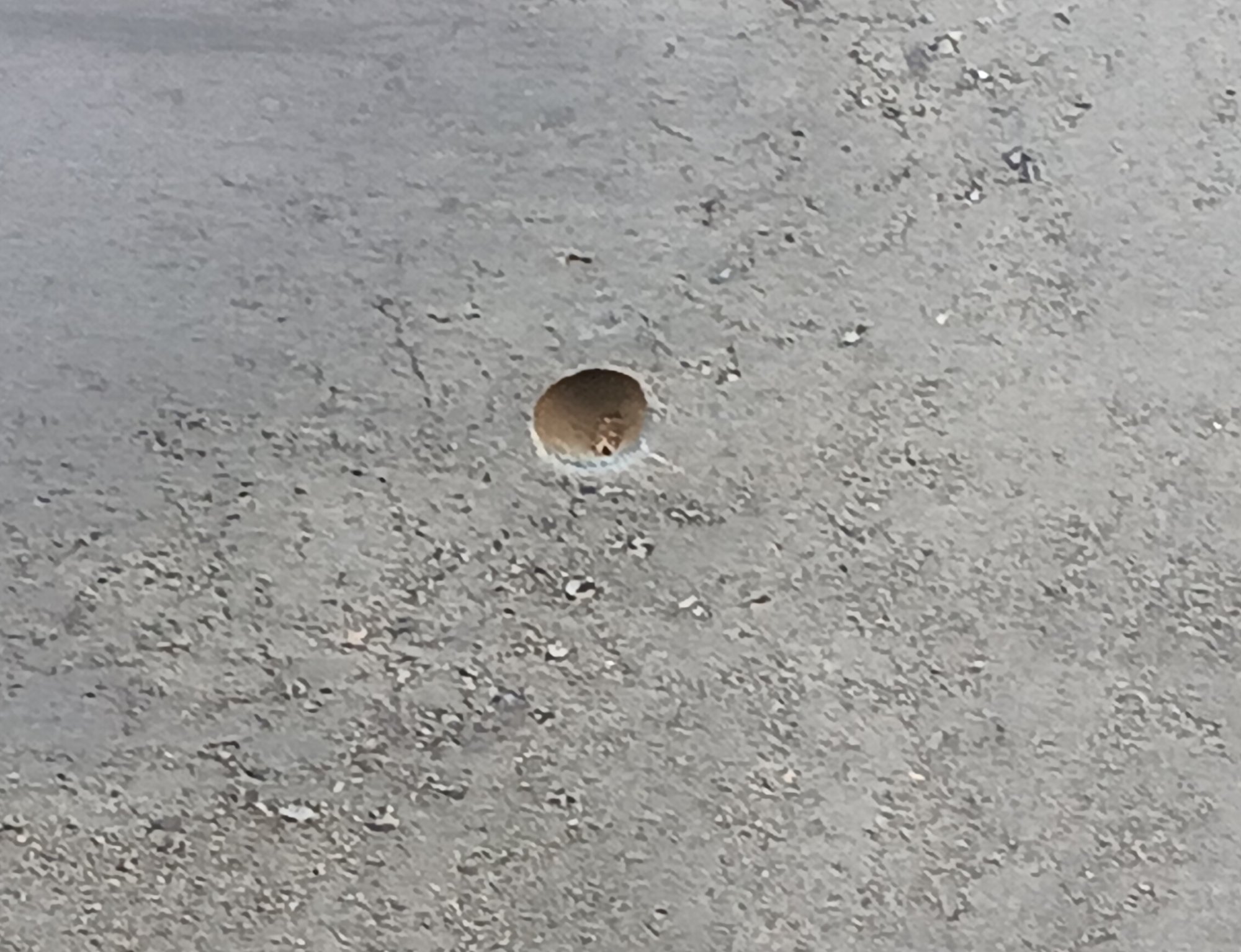

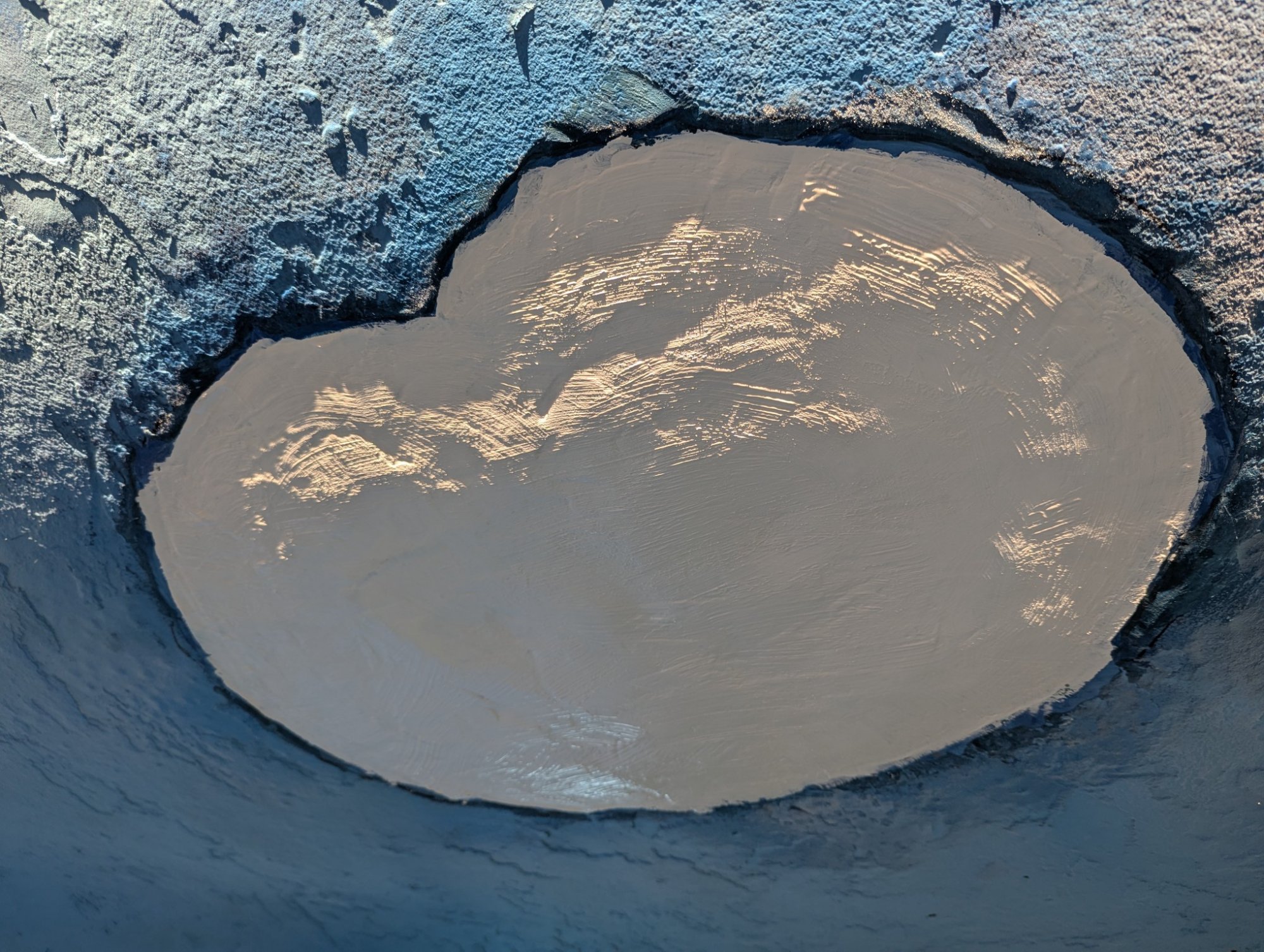

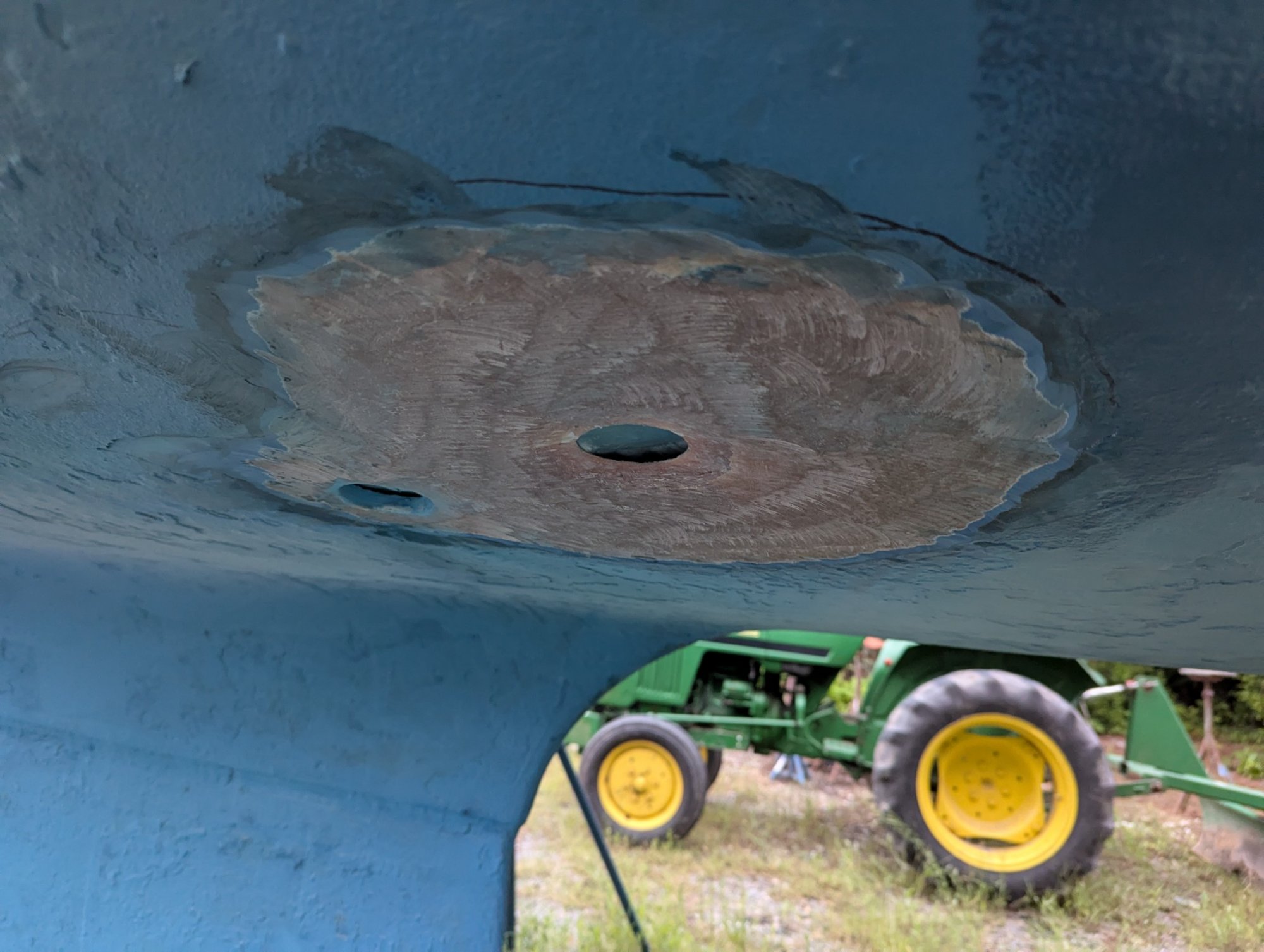

Spent today grinding and glassing up a couple of old through-hulls. The hull’s about 1/2" thick fiberglass, so I made a 7-inch bevel—roughly 14:1 ratio—to get a nice taper and give the new layup room to breathe.
I used West System epoxy with 17oz biaxial fiberglass cloth. Ended up doing about 12 layers total: started small, built up to bigger ones, then finished with a few wide ones over the whole thing. Also added a few smaller pieces at the end to fair it out flat.
There’s a slight cavity in the hull near the keel area—it’s been like that since well before I was born and hasn’t caused issues, so I left it for now. Took photos, though, so I can fill it later if I ever need to.
It got tricky wrestling those wet, heavy layers overhead—especially the big ones—but working the edges down with a roller helped a lot. Once the edges are fully set, the glass really locks in well.
I’m super happy with how it turned out. The cured glass is rock solid, and honestly, it might be stronger than the original layup.

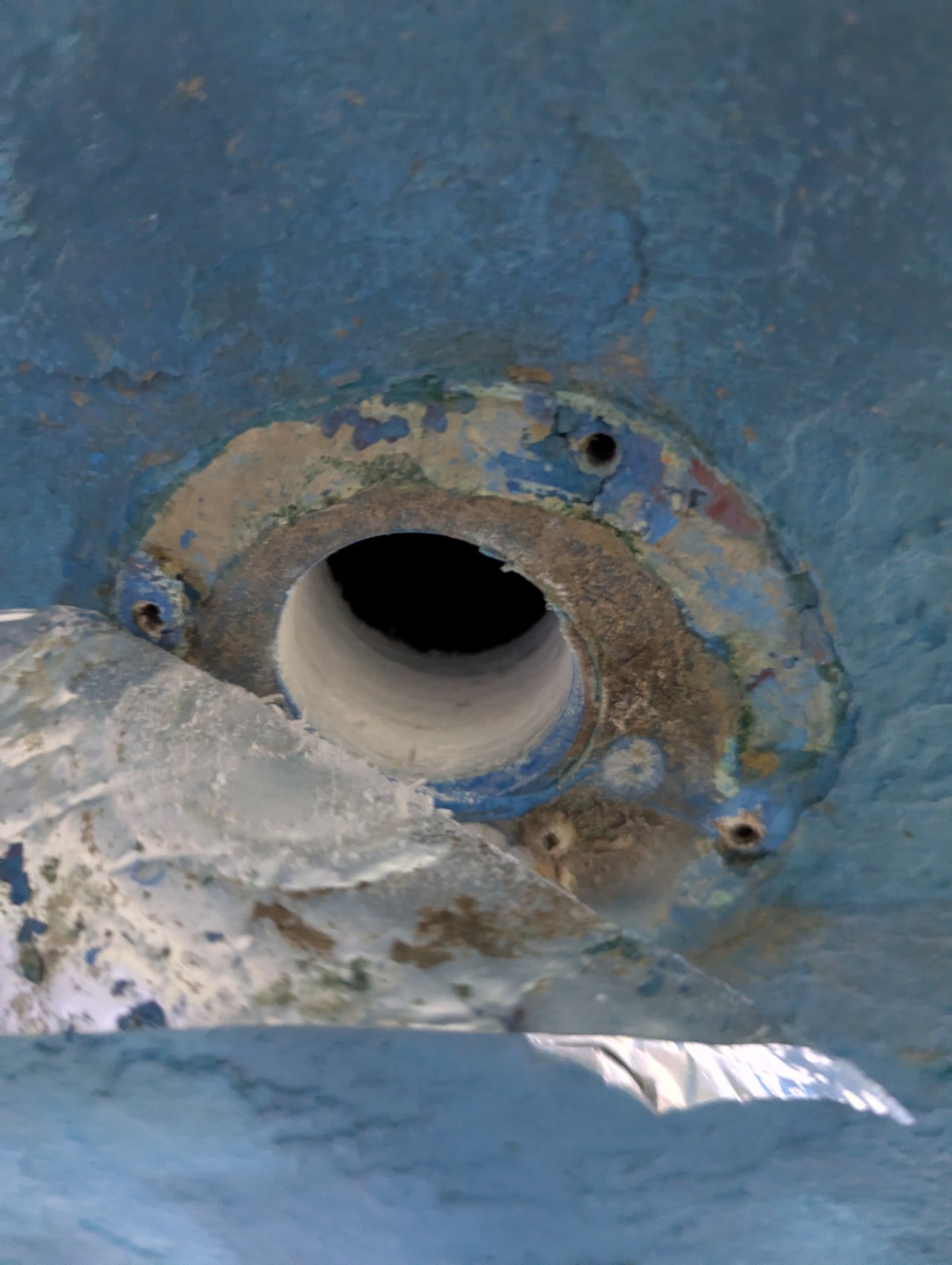

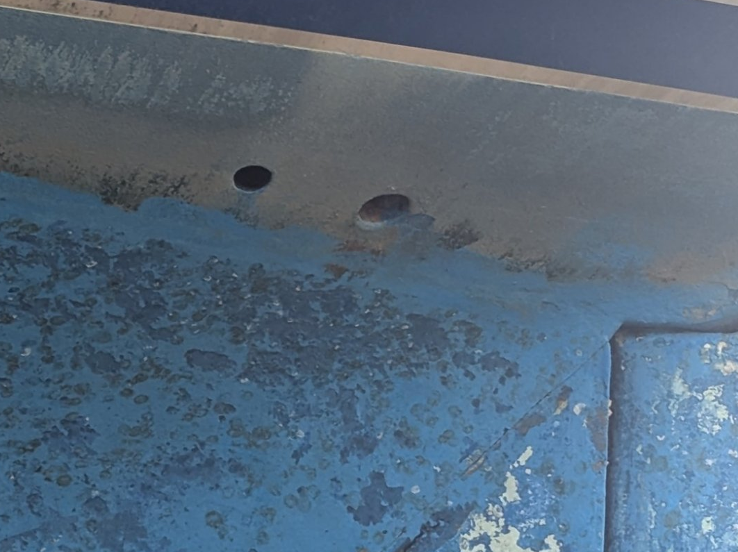

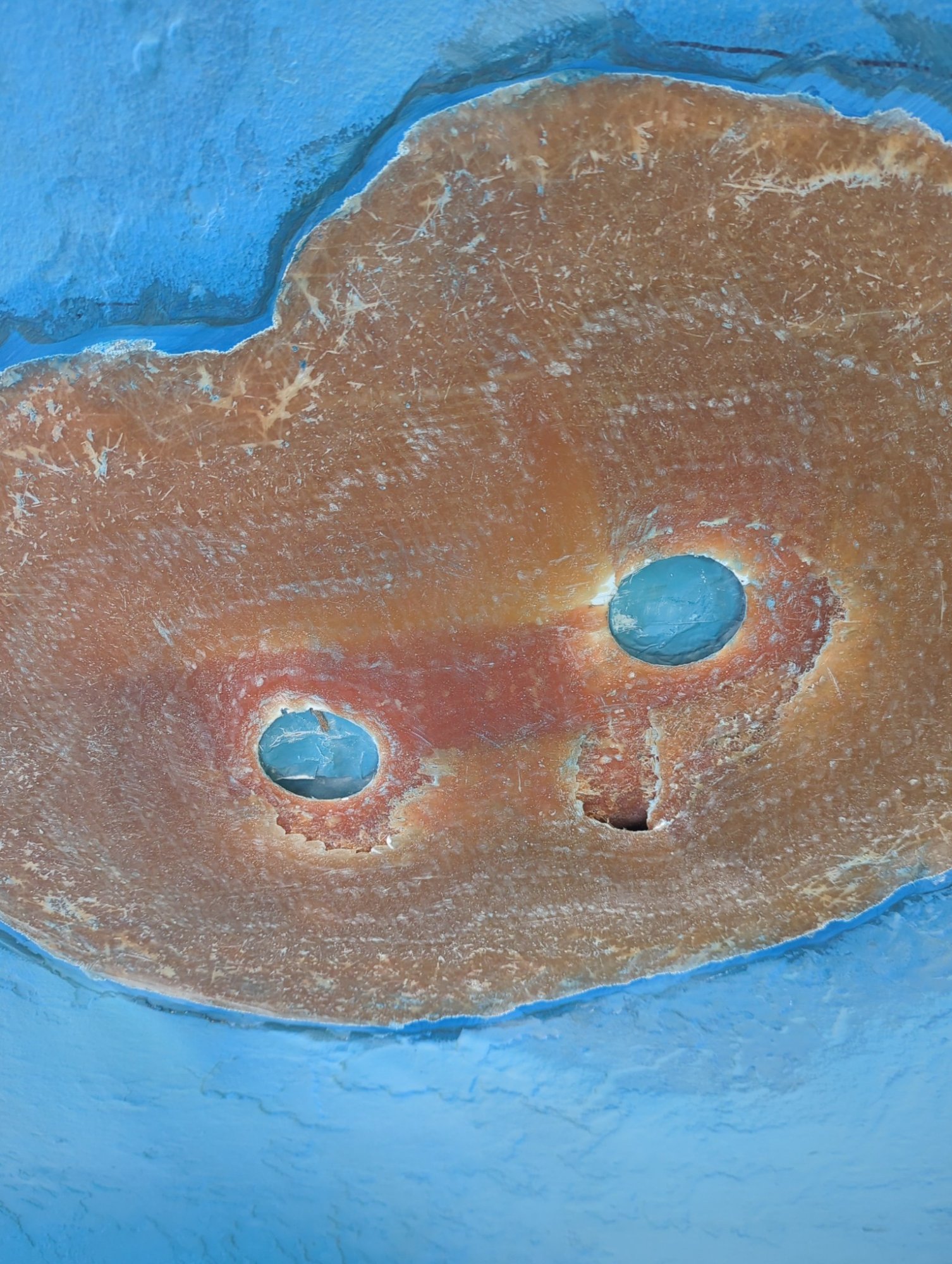

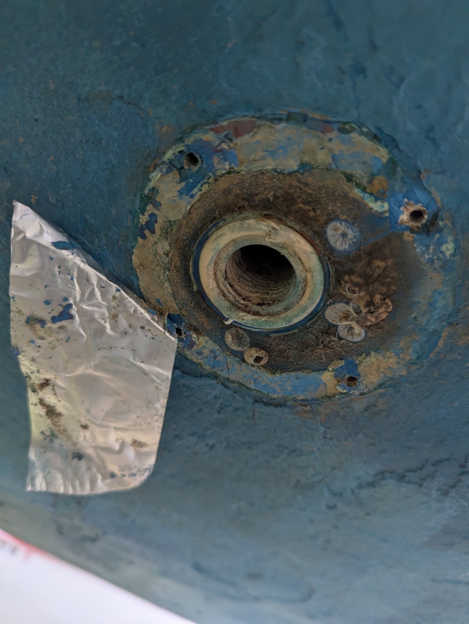

I'm in the process of replacing my first thru-hull. The summary, so far, is here.

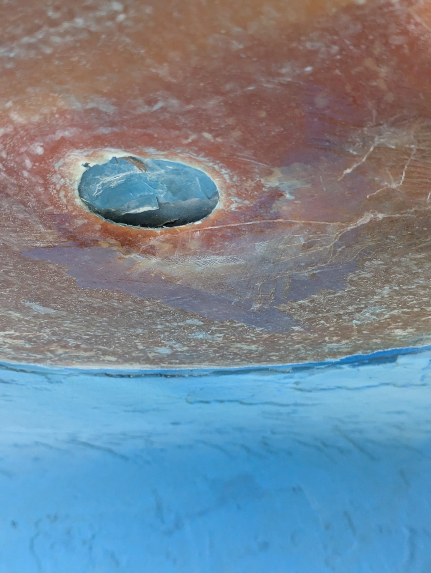

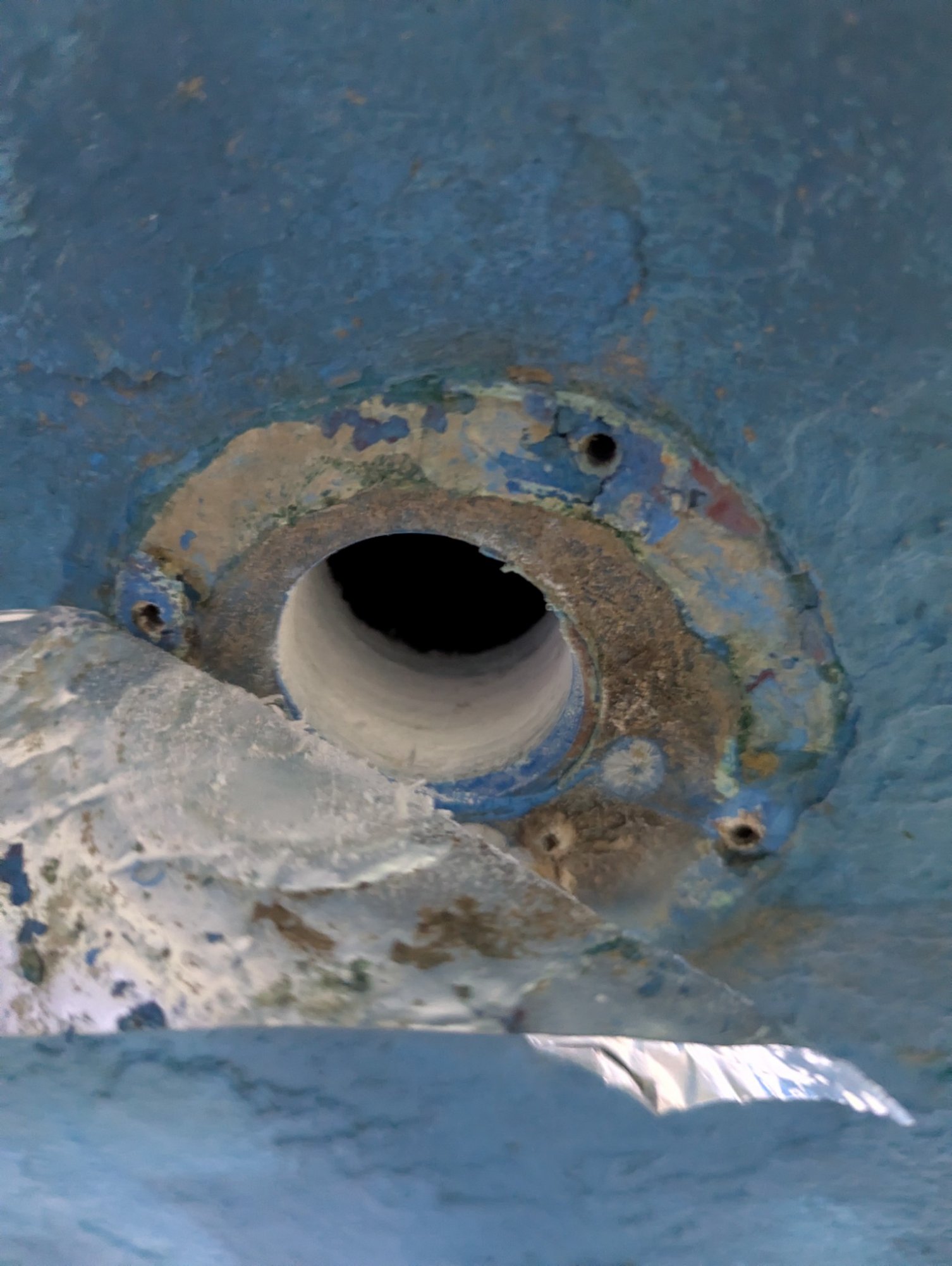

The part of your posting that would worry me is this (I cut these pictures down a little in size):

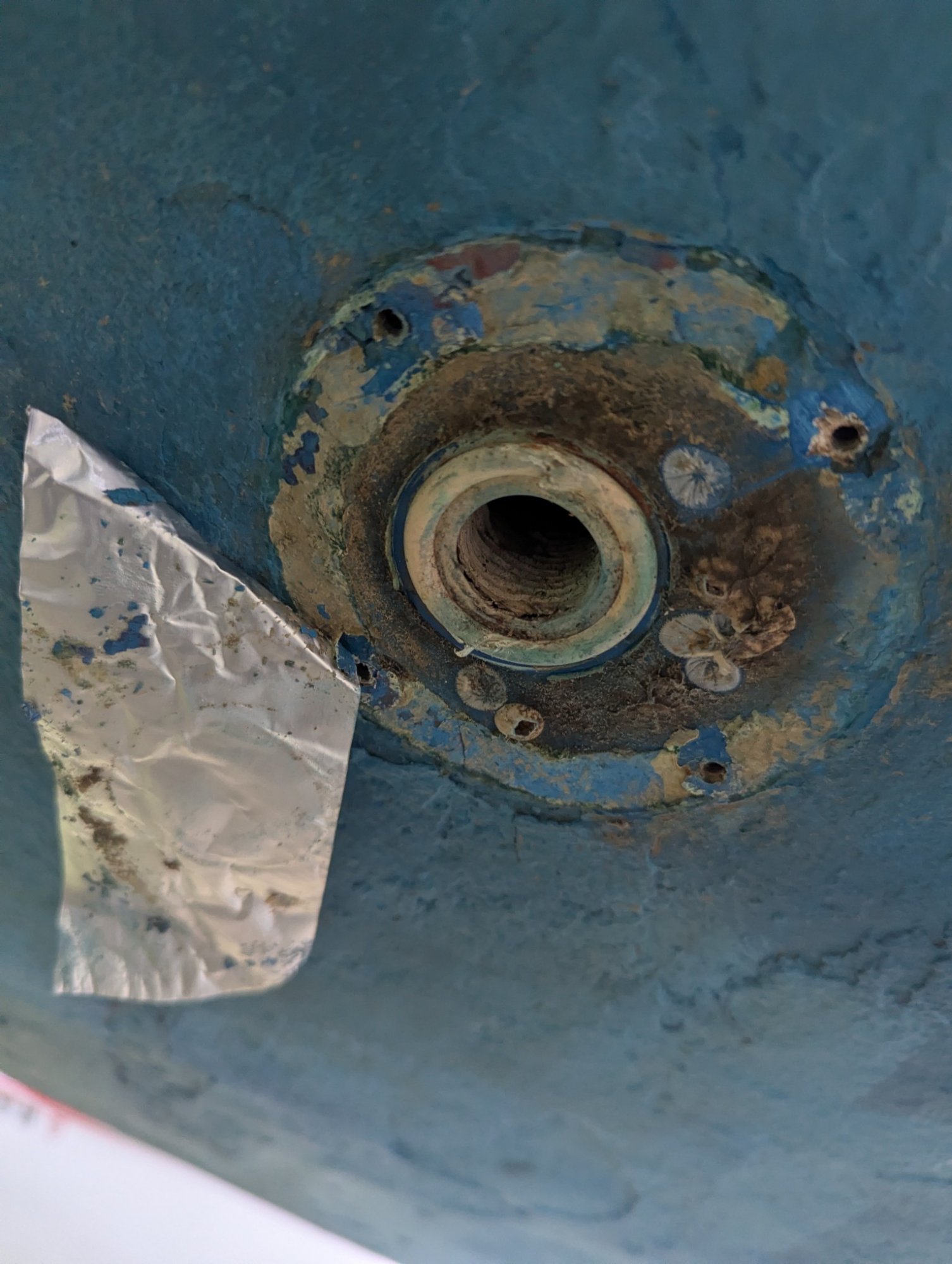

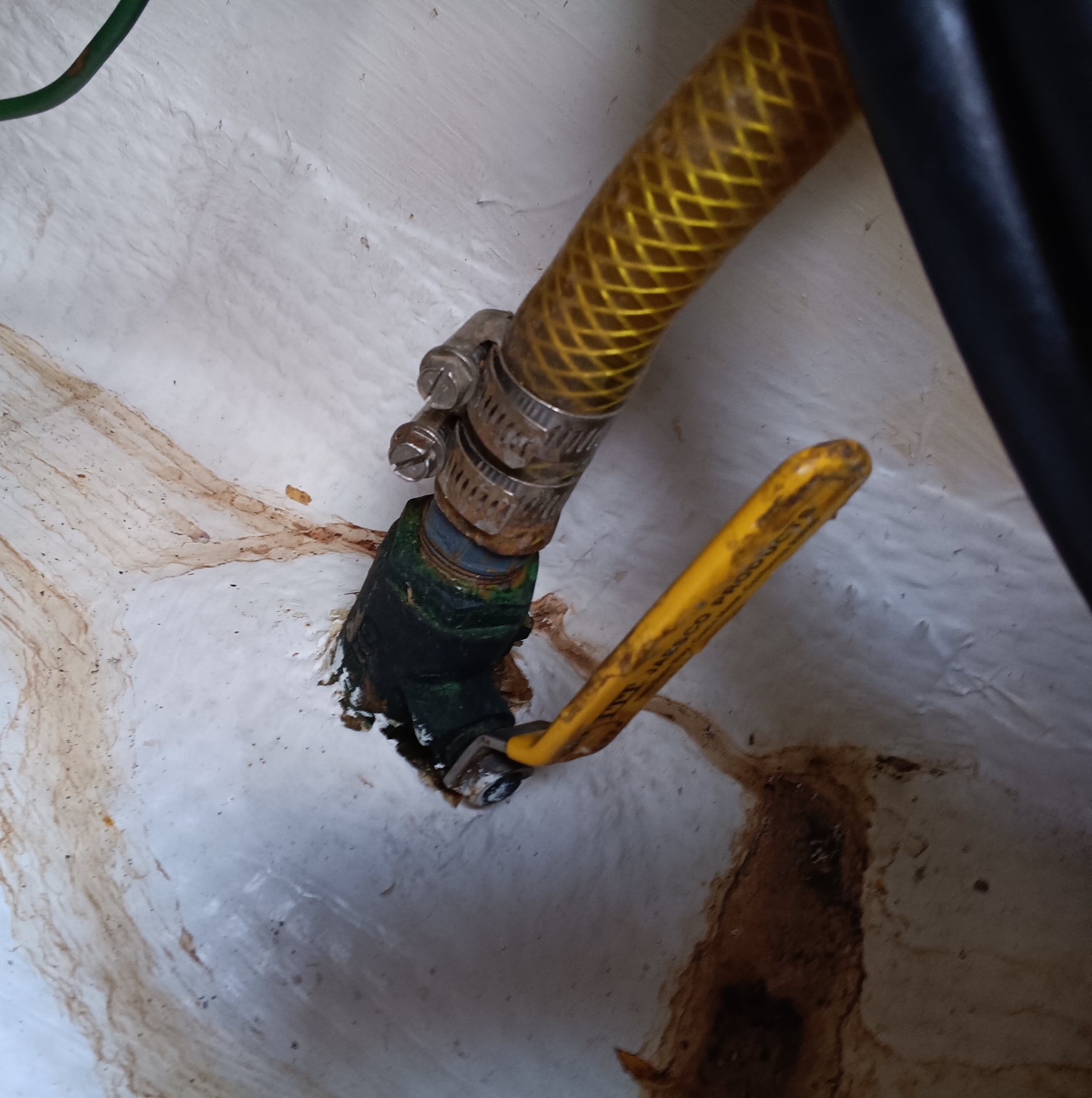

Maybe there's a recessed head on the thru-hull or maybe you have something I ran into:

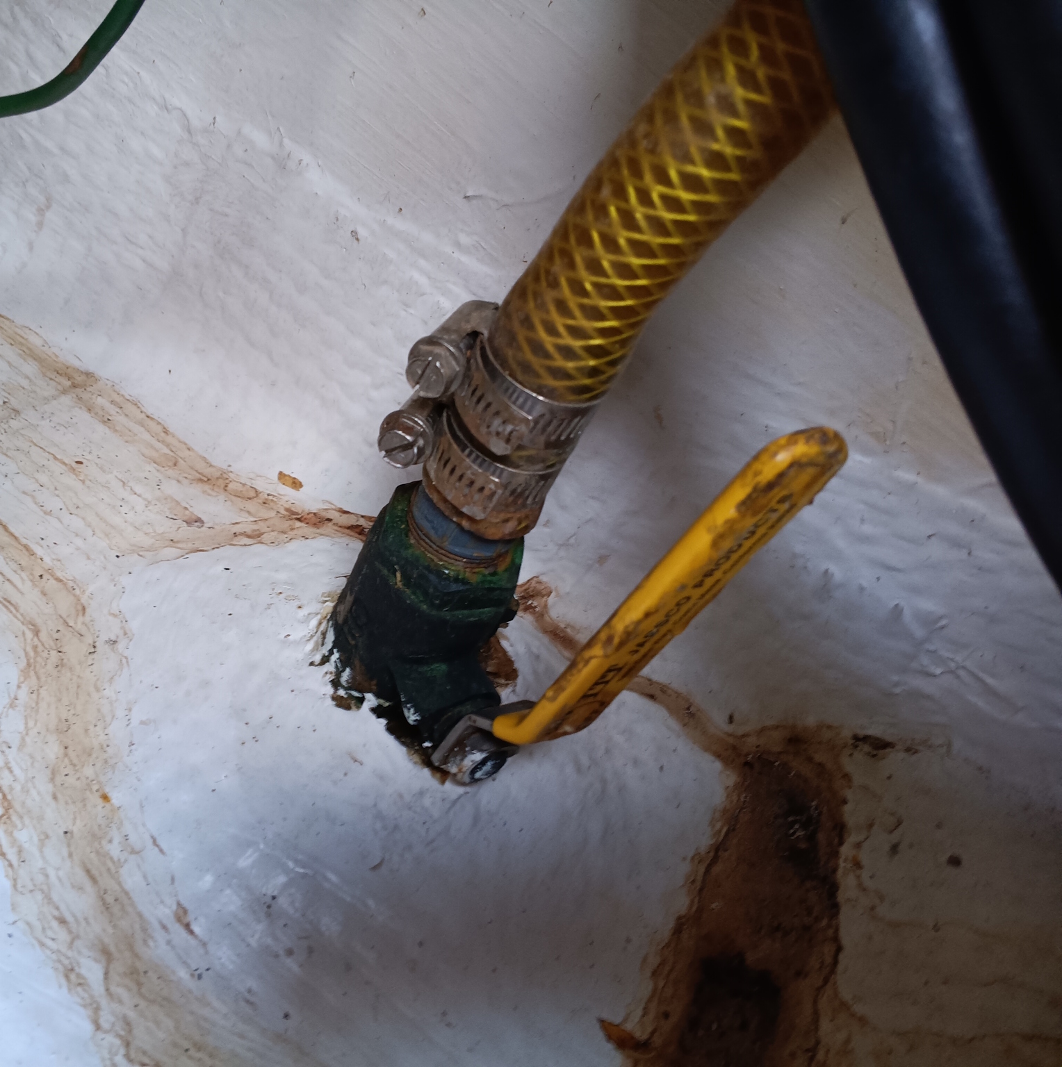

This was under the static water line so I was glad at least there was a valve there. Yours appear to be just above so that's up to you how you would handle it.

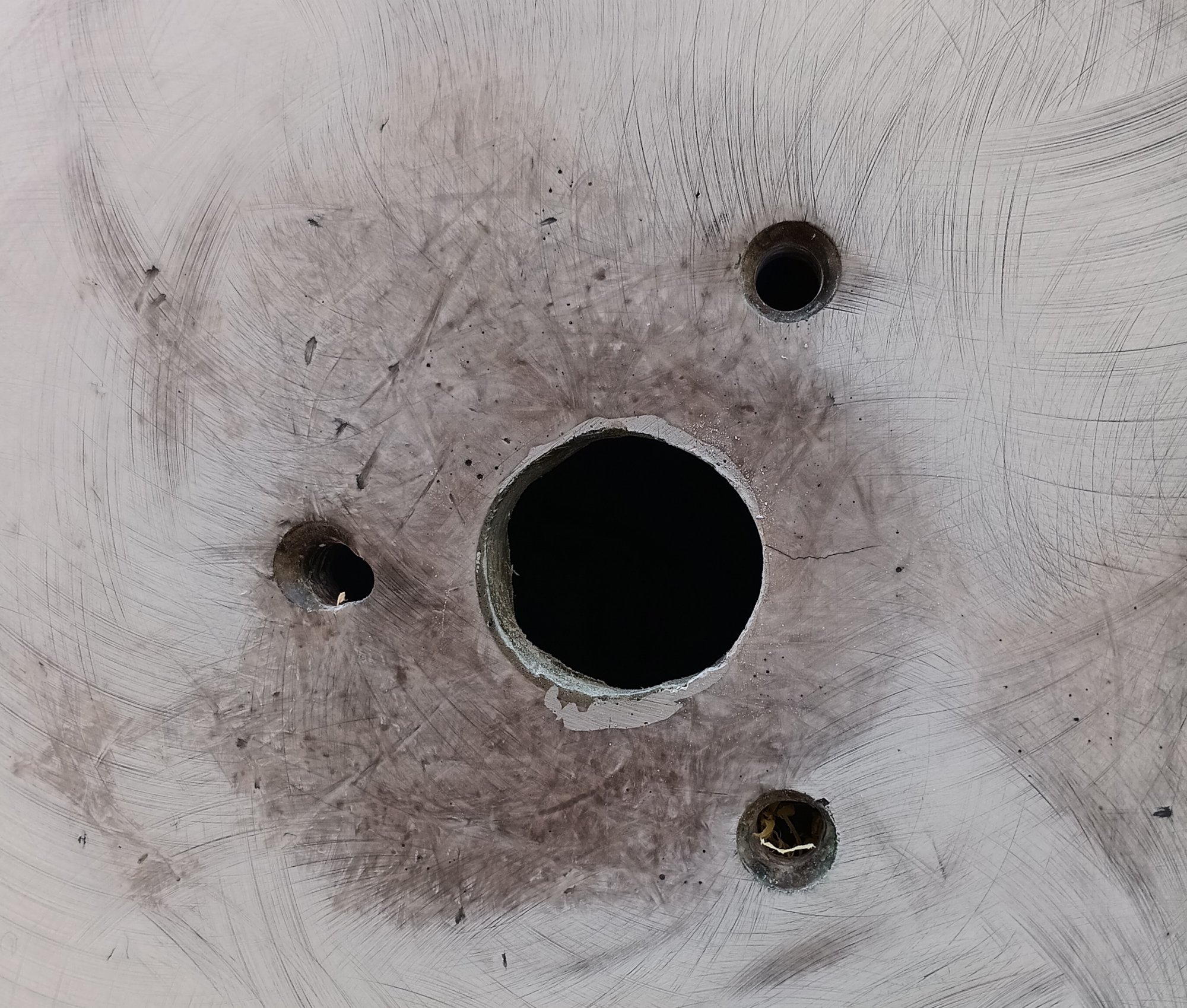

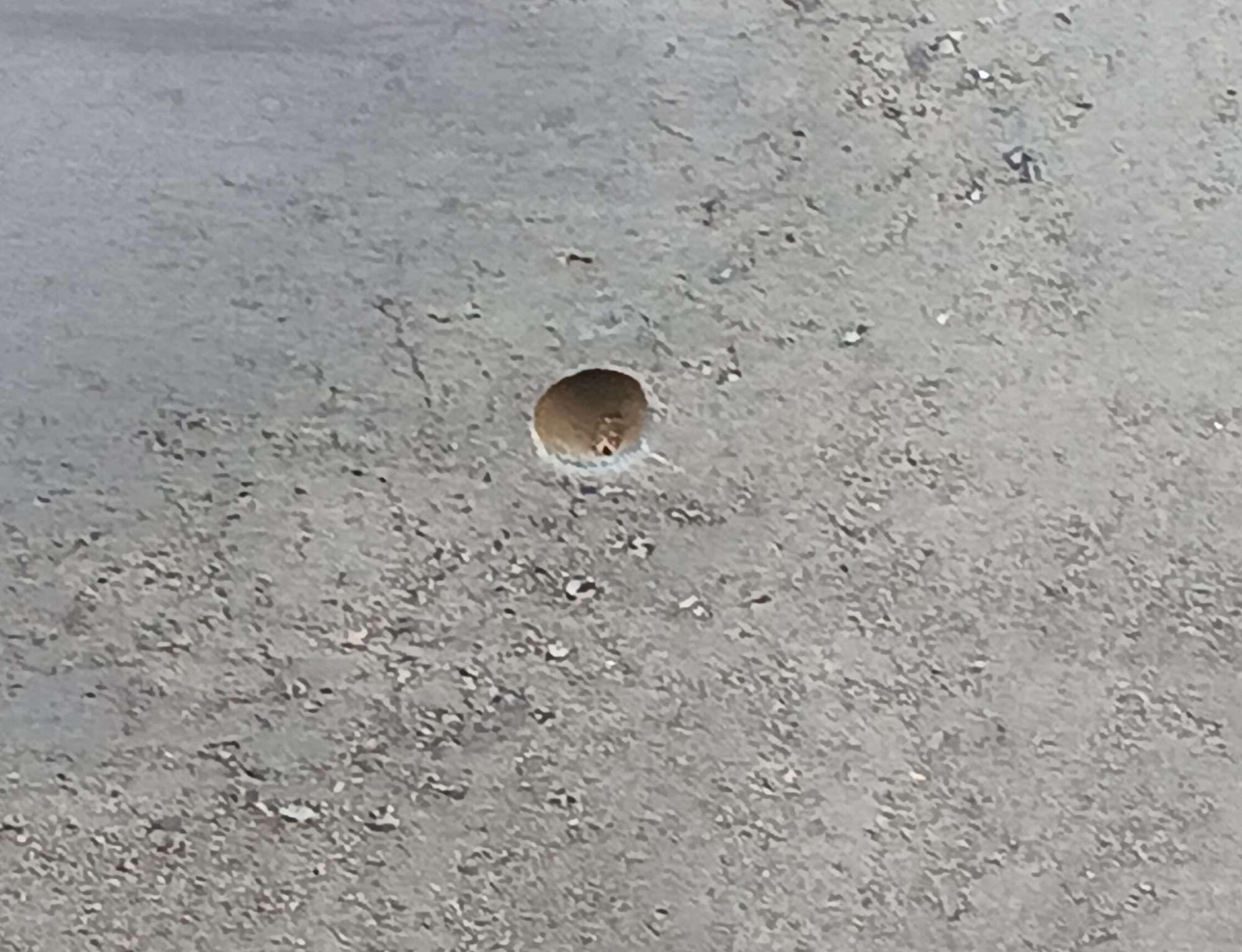

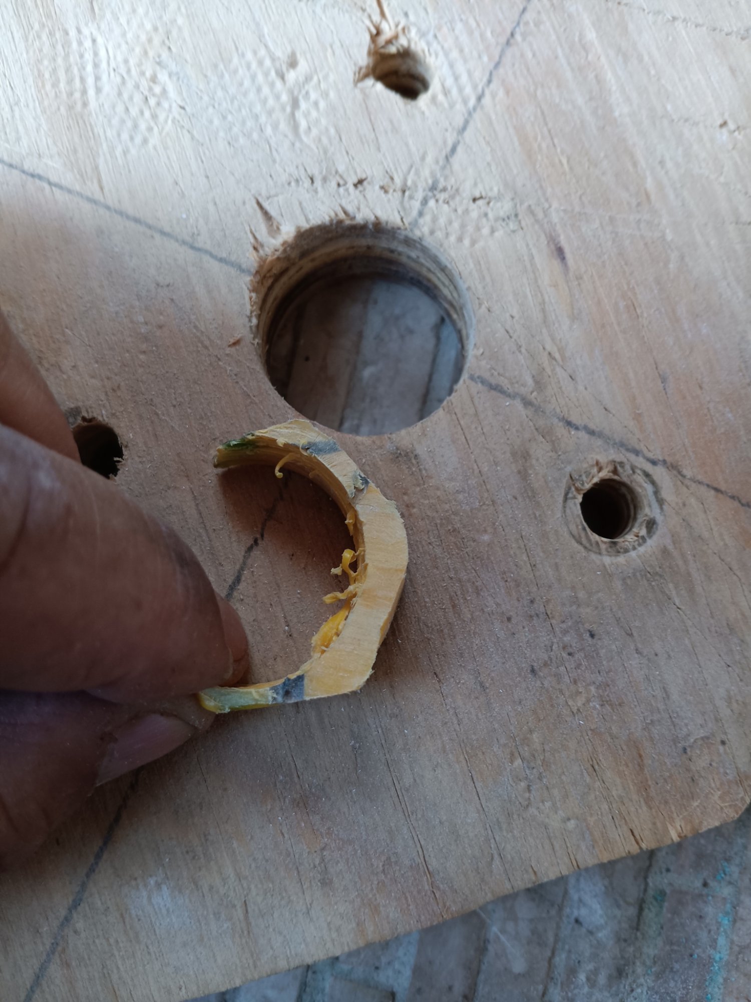

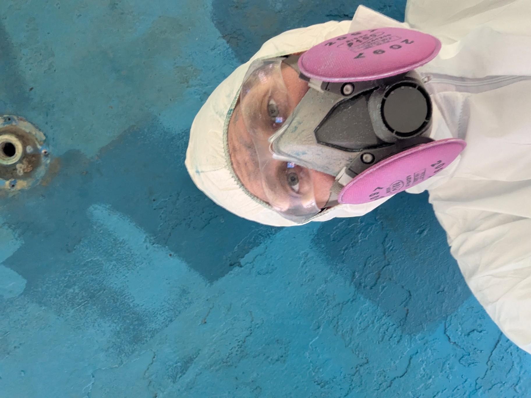

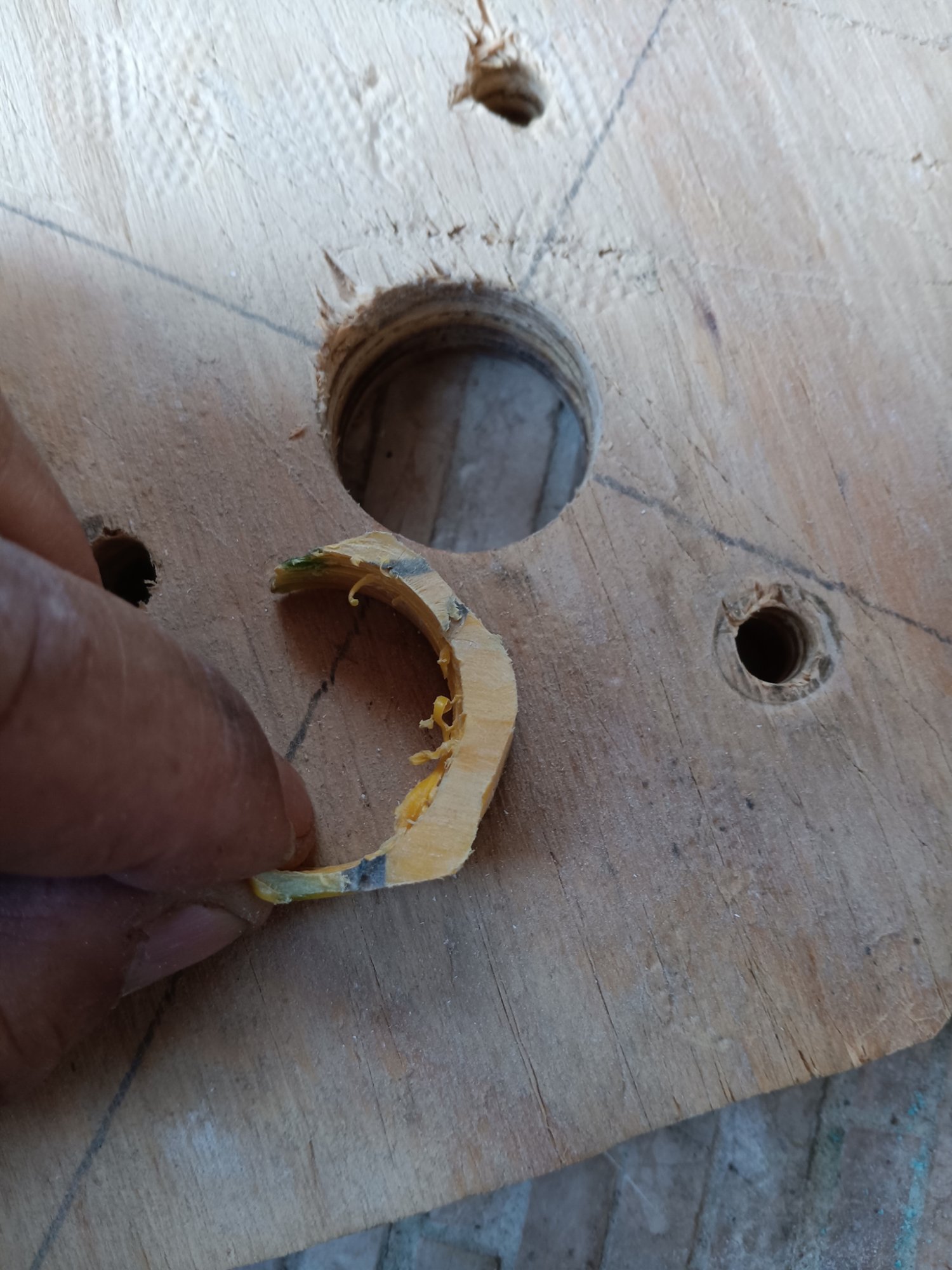

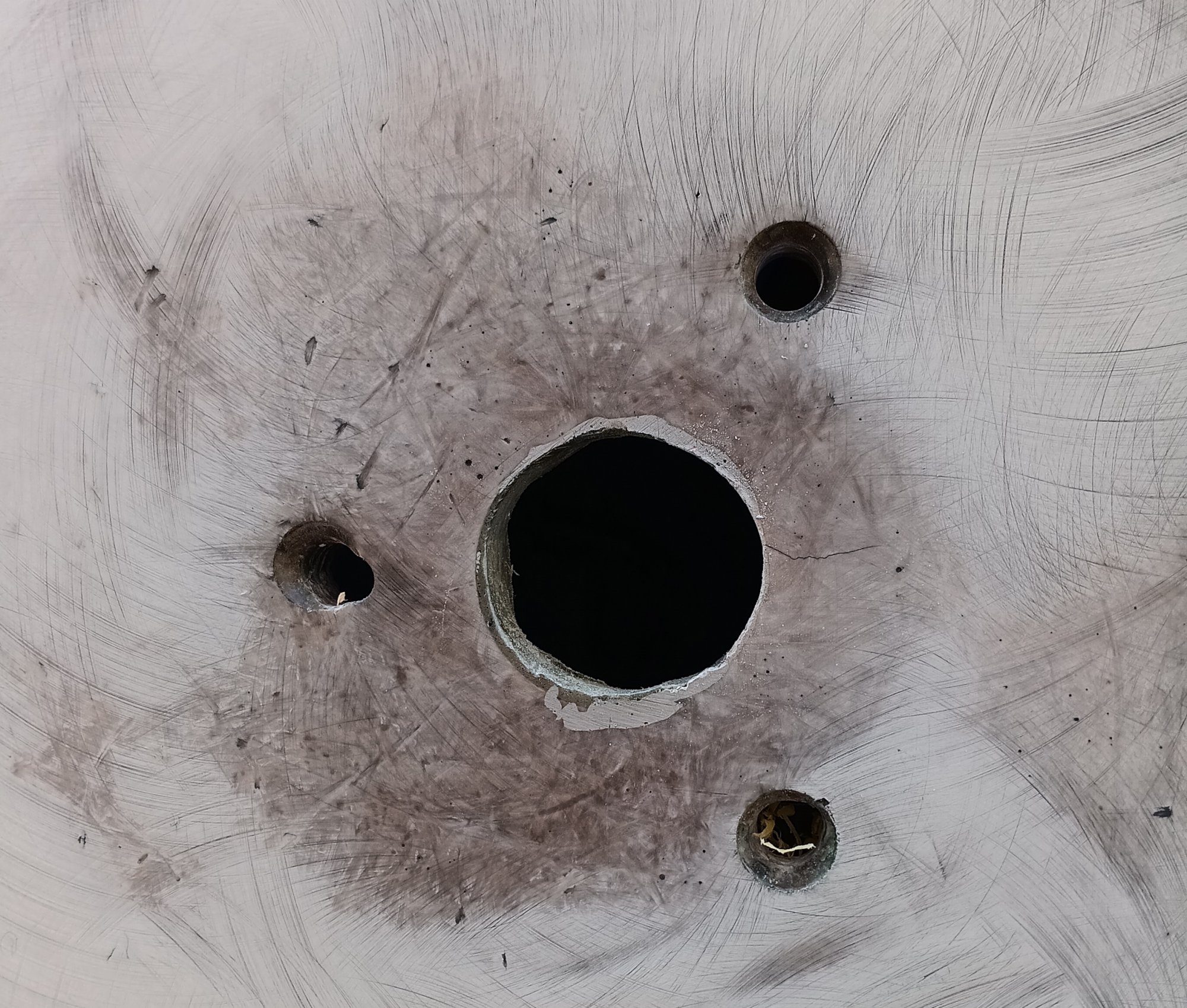

What concerns me is what I found. The flange base for mine was buried in the hull layup. The hull thickness at the flange is only about 3/8 inches versus about a 5/8 or 3/4 inch thick hull for the surrounding area. (Can't really tell because of the grinding I did to get the old one free.) What was worse, there was no thru-hull "head" (mushroom or recessed) there. Instead I found a plastic sleeve embedded in the hull. You can see it as a shadow in the first picture and it was visible once I sanded off the bottom paint. The 2nd picture shows what was left of the sleeve when I finally got it out. The rest was shavings all over the ground.
I'm not an old hand at this but I would be concerned if there wasn't even a bronze or Marelon thru-hull installed underneath those piles of fiberglass/epoxy. What I ended up with, after getting the plastic out, was a big hole 1/4" wider than the thru-hull fitting. A gap I'm going to have to fill in to get a proper seal.

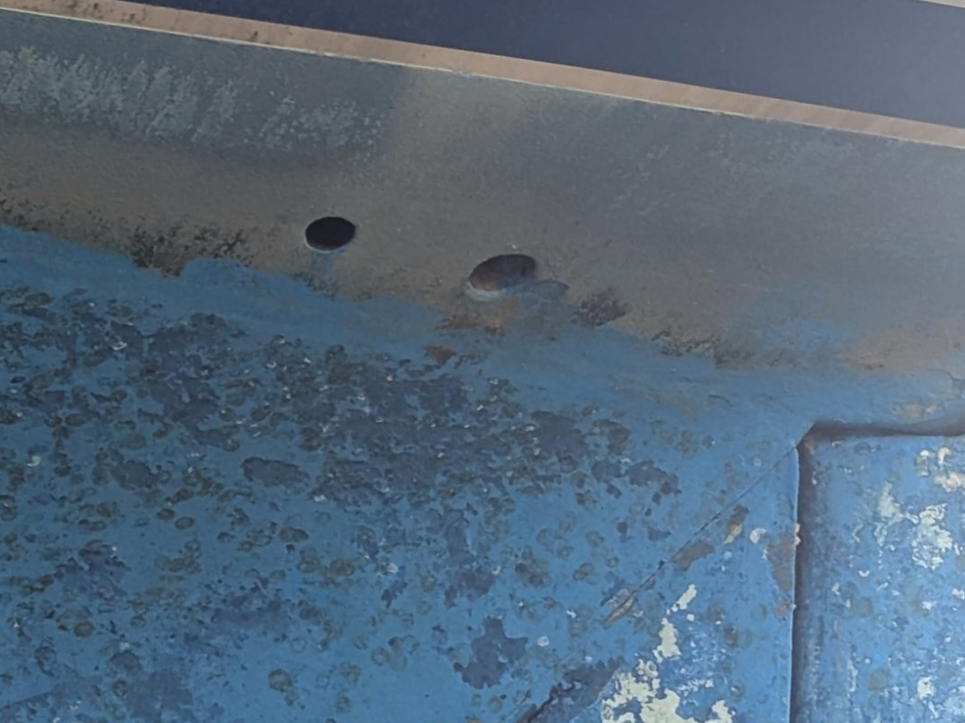

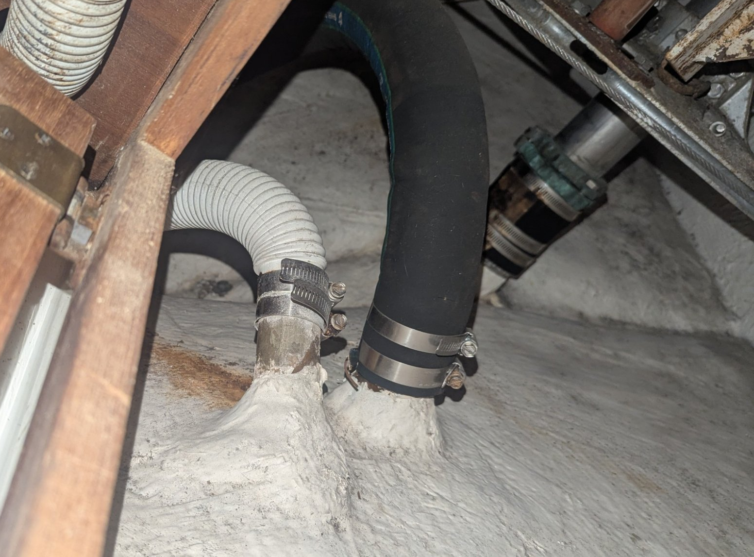

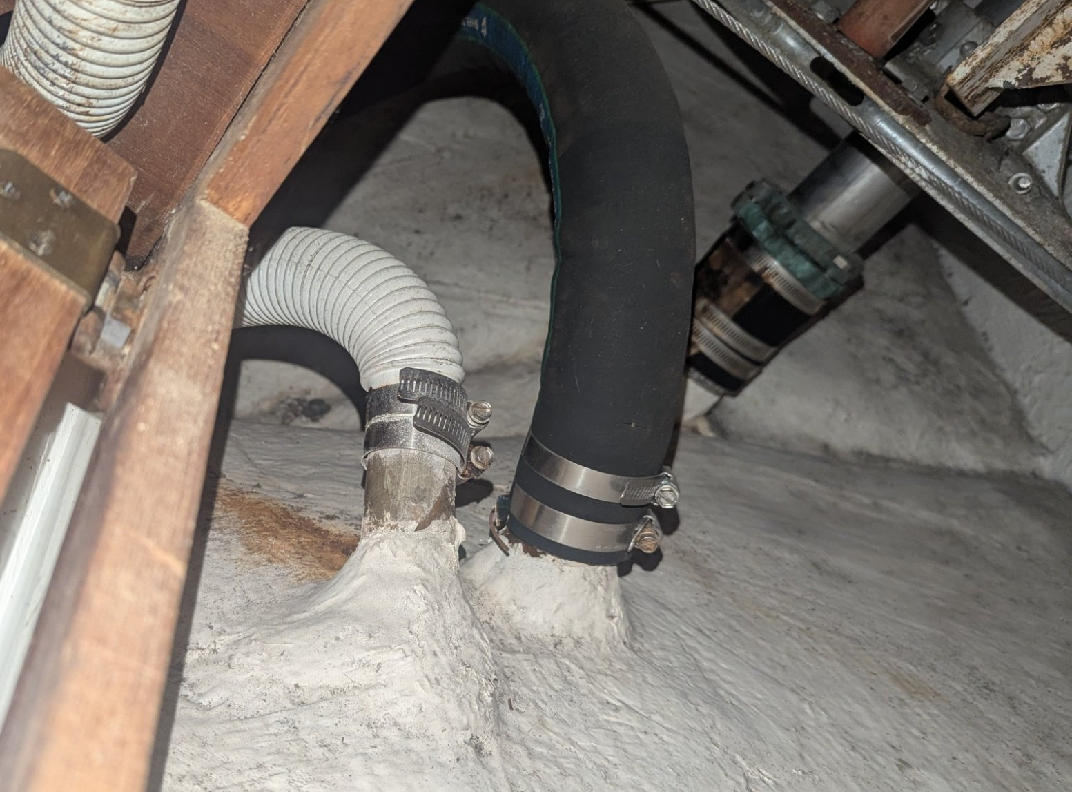

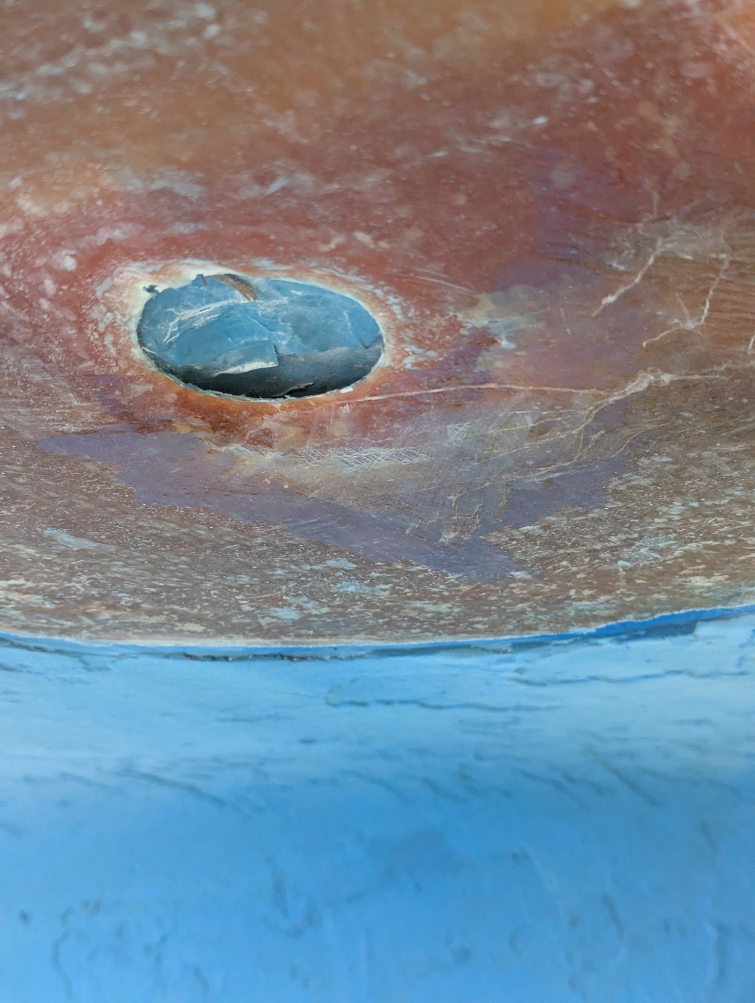

Still thinking about this post. I wonder why there is no mushroom flange on the supper and engine exhausts. Why did they glass them in a bit above the static water line? Would I just take an angle grinder to that little cone of fiberglass to get rid of it and drop in a groco thru hull?
What brand of boat and year is yours?
Sorry I missed this, been busy of late.
I have a 1982 Morgan 321 as kappykaplan mentioned.
Why no mushroom flange? Obviously, the builder chose thru-hulls without an external flange as mentioned earlier. BTW, the white hose is the bilge pump. Scupper drains are even further above the waterline. As to the blob of resin about each, the builder did that with anything that went through the hull except for vents high up on the topsides.
After what I went through on my first thru-hull, I went back to the scupper and engine exhaust thru-hulls on the interior. Both are sturdily mounted in good condition, above the waterline and the exhaust hose is in very good condition so someone had to have replaced it at some time. I have 4 other thru-hulls that I'm more concerned with getting replaced first. I don't think anyone recommends a thru-hull with valve for the engine exhaust as long as there is a loop above the waterline. Whether it has a flange, I'll defer to others. The bilge pump exhaust may be a possibility in the future but my first choice for now is to replace the hose with something more substantial.

I'm looking for threaded fasteners to help make a modular seacock. Specifically, I'd like to find 316 SS or bronze inserts with a small flange (lip) that can be pressed or lightly hammered into G10. Does anyone have a link or know of the right part?

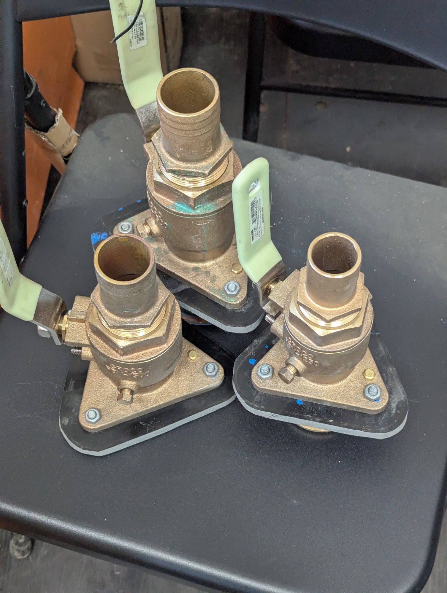

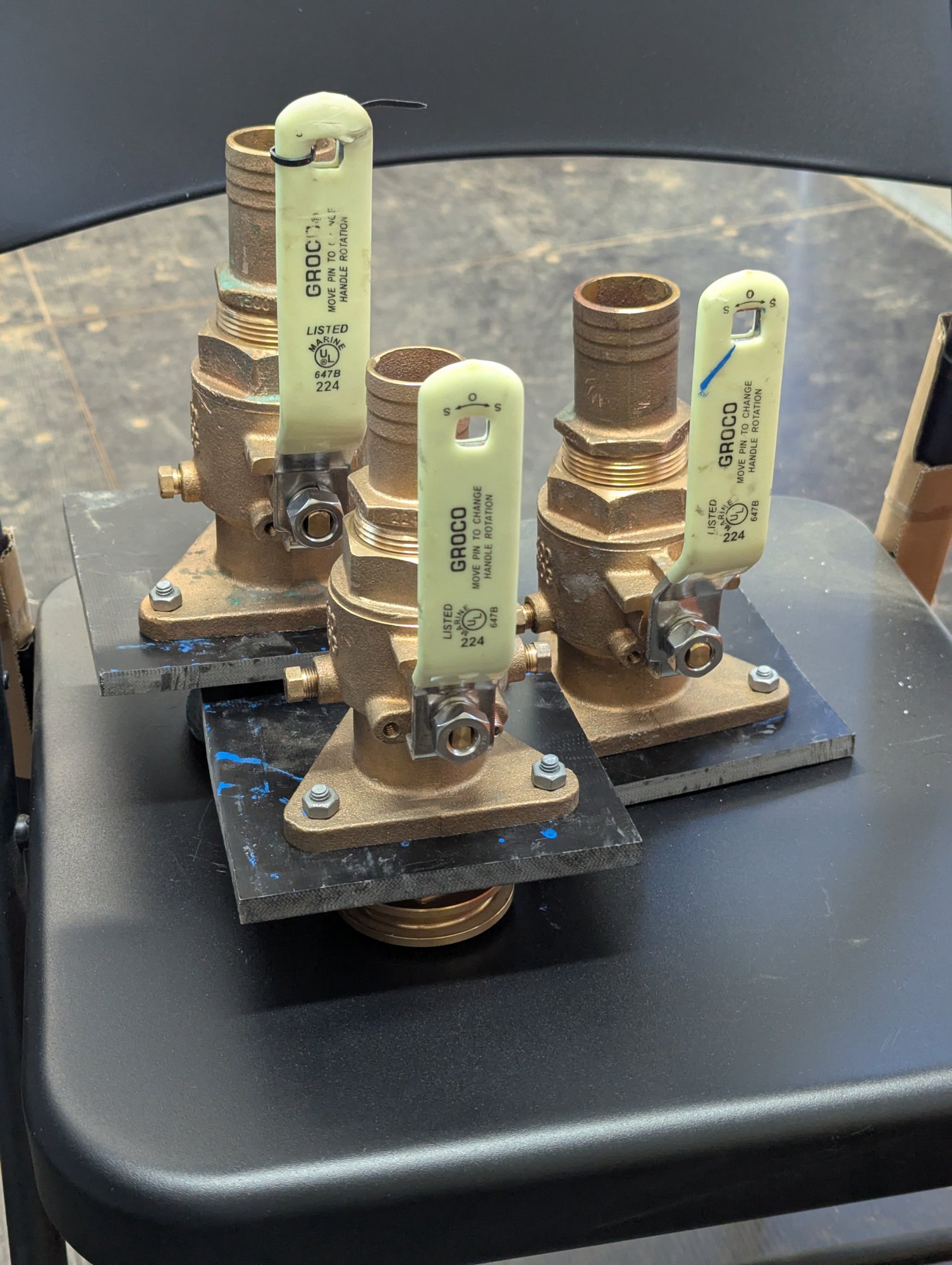

Hey all,
I'm going back and forth on how to mount my seacocks. I could go with bolts, nuts, and washers (like in the pics above), which seems simple and strong. But some folks have mentioned that this setup could make future servicing harder.
Here’s my thinking:
With bronze components, G10 backing plates, and proper bedding (4200 or even 5200 if I'm feeling bold), I don’t expect to touch these for 30+ years—especially if they're well-greased and maintained. That said, if I ever did need to service a seacock, I could remove the through-hull, re-bed everything, and lift the seacock off the bolts. Not convenient, but not catastrophic either.
Tapping threads into the G10 seems like more work than it’s worth, especially since I don’t see a realistic scenario where I’d need to remove just the seacock without addressing hull or backing plate damage too. If the seacock fails, odds are the surrounding structure needs attention anyway.
So right now, I'm leaning toward epoxying the backing plate permanently to the hull and using through-bolts with 4200 between the seacock and flange. That way, both the through-hull and seacock are removable—just not quickly.
Anyone see a flaw in this logic? Or had real-world scenarios where a fully removable setup saved your bacon?
