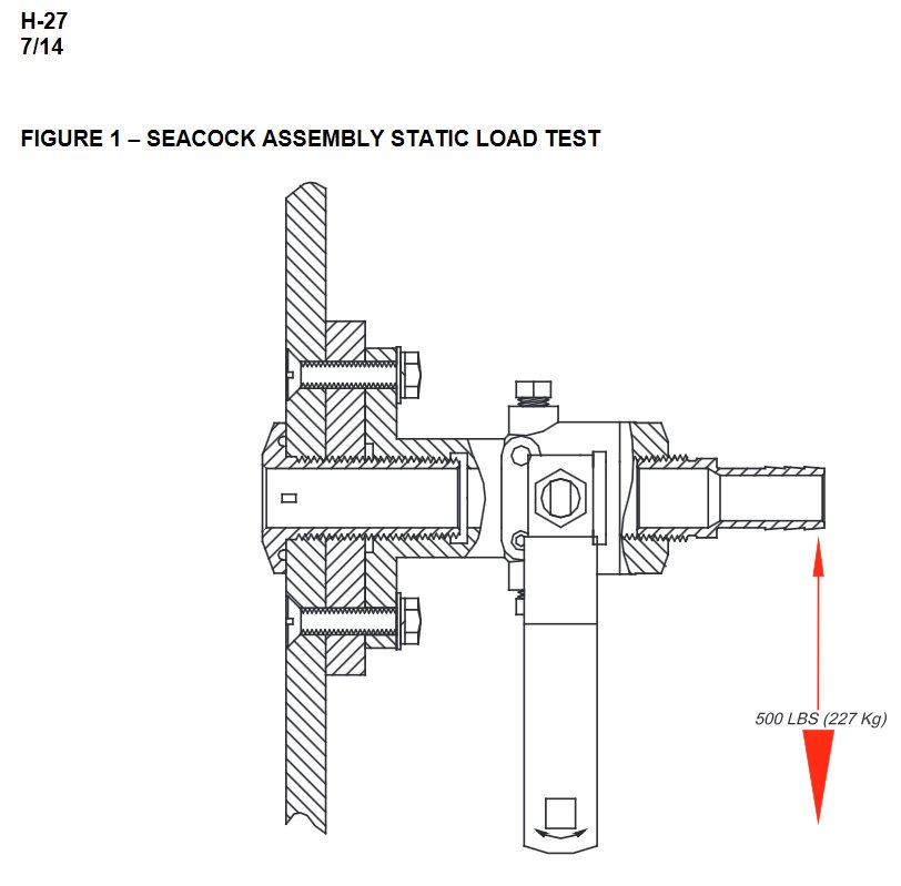

ABYC H-27 "SEACOCKS, THRU-HULL FITTINGS, AND DRAIN PLUGS" does not require two clamps. Pick up a copy and read it through.
The biggest issue is using the correct type of hose clamp - also attached above.

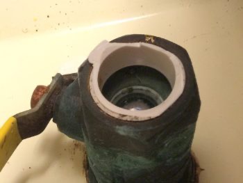

I'm in the process of replacing my first thru-hull. The summary, so far, is here.
The part of your posting that would worry me is this (I cut these pictures down a little in size):
Maybe there's a recessed head on the thru-hull or maybe you have something I ran into:
This was under the static water line so I was glad at least there was a valve there. Yours appear to be just above so that's up to you how you would handle it.
What concerns me is what I found. The flange base for mine was buried in the hull layup. The hull thickness at the flange is only about 3/8 inches versus about a 5/8 or 3/4 inch thick hull for the surrounding area. (Can't really tell because of the grinding I did to get the old one free.) What was worse, there was no thru-hull "head" (mushroom or recessed) there. Instead I found a plastic sleeve embedded in the hull. You can see it as a shadow in the first picture and it was visible once I sanded off the bottom paint. The 2nd picture shows what was left of the sleeve when I finally got it out. The rest was shavings all over the ground.
I'm not an old hand at this but I would be concerned if there wasn't even a bronze or Marelon thru-hull installed underneath those piles of fiberglass/epoxy. What I ended up with, after getting the plastic out, was a big hole 1/4" wider than the thru-hull fitting. A gap I'm going to have to fill in to get a proper seal.
Someone else mentioned the concern of the corrugated hose connected from the bilge pump. This is easily cut or broken off even when new. It may be above the waterline now but in choppy water or a big sea, they may not be.

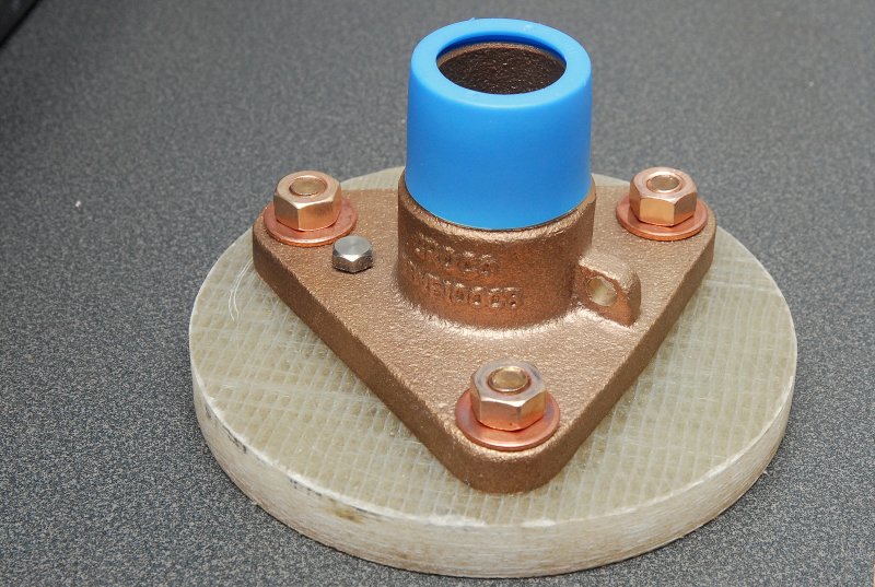

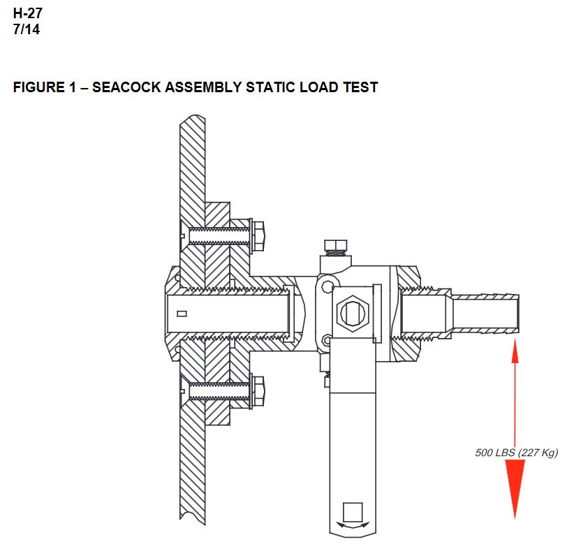

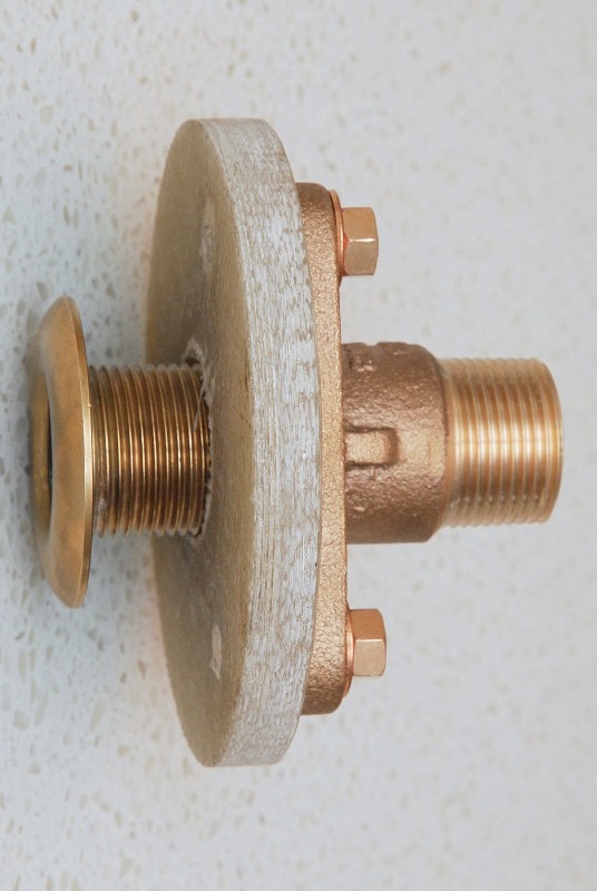

23,779

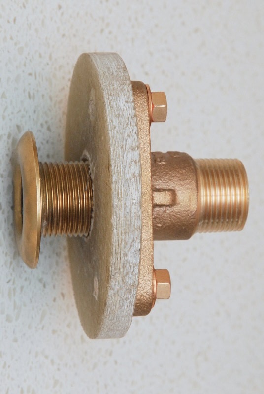

I’m still on the fence about flanged seacocks — not sure the hull is thick enough in spots.
IT IS YOUR CHOICE.
I sense that the flange seacock is not clearly understood. My belief is that the flange is even more important when the hull is thin.
Let me try to explain.
The support for this approach can be found here.

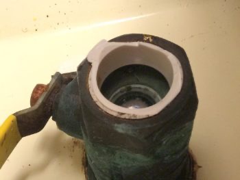

Some boat builders tried to save costs by installing the thru-hull using PVC pipe. Attaching a valve to a PVC pipe was quick and easy
Repetitive opening and closing of the valve stressed the PVC pipe. Eventually, failures occurred.
ABYC then set a standard to prevensuch events from occurring.

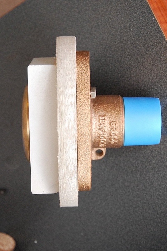

“27.6 INSTALLATION
27.6.1 A seacock shall be securely mounted so that the assembly will withstand a 500 pound (227 Kg) static force applied for 30 seconds to the inboard end of the assembly, without the assembly failing to stop the ingress of water.
Owners of boats with thin or wood sandwich hulls complained. These boats can not be penetrated with bolts and then be expected to remain sound.
When you examine the problem, opening the valve puts a bending force on the "thru-hull". The flange resists that bending force. If we place a backing plate between the hull and the flange then the flange can be screwed into the backing plate.The backing plate and flange can be caulked or glued to the hull. This solves the problem of the bending force and the bolts/screws do not need to go through the hull.

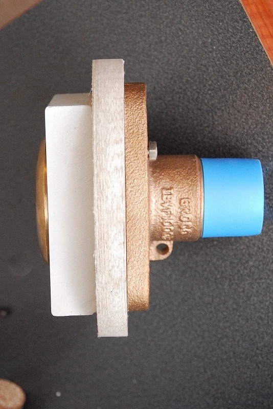

How it is set up
Mushroom through-hull on the outside of the boat. The white block represents the hull. Then the backing plate with the flanged fitting is attached. The mushroom through-hull is threaded into the internal flanged fitting. The blue cap is removed and the valve is screwed on.
This is a very secure design that will bring many years of service.

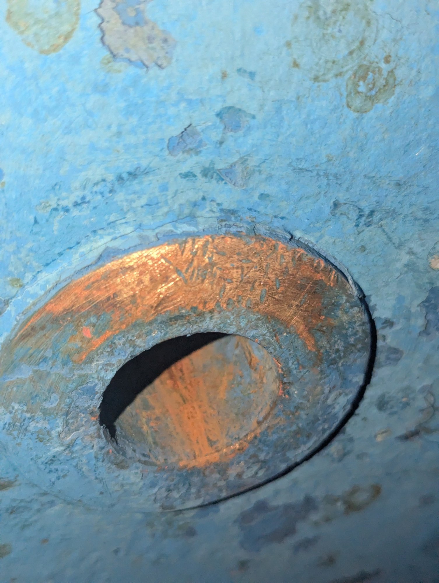

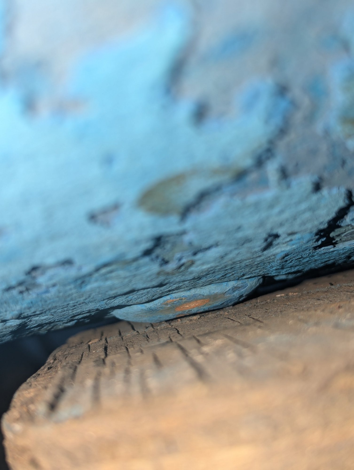

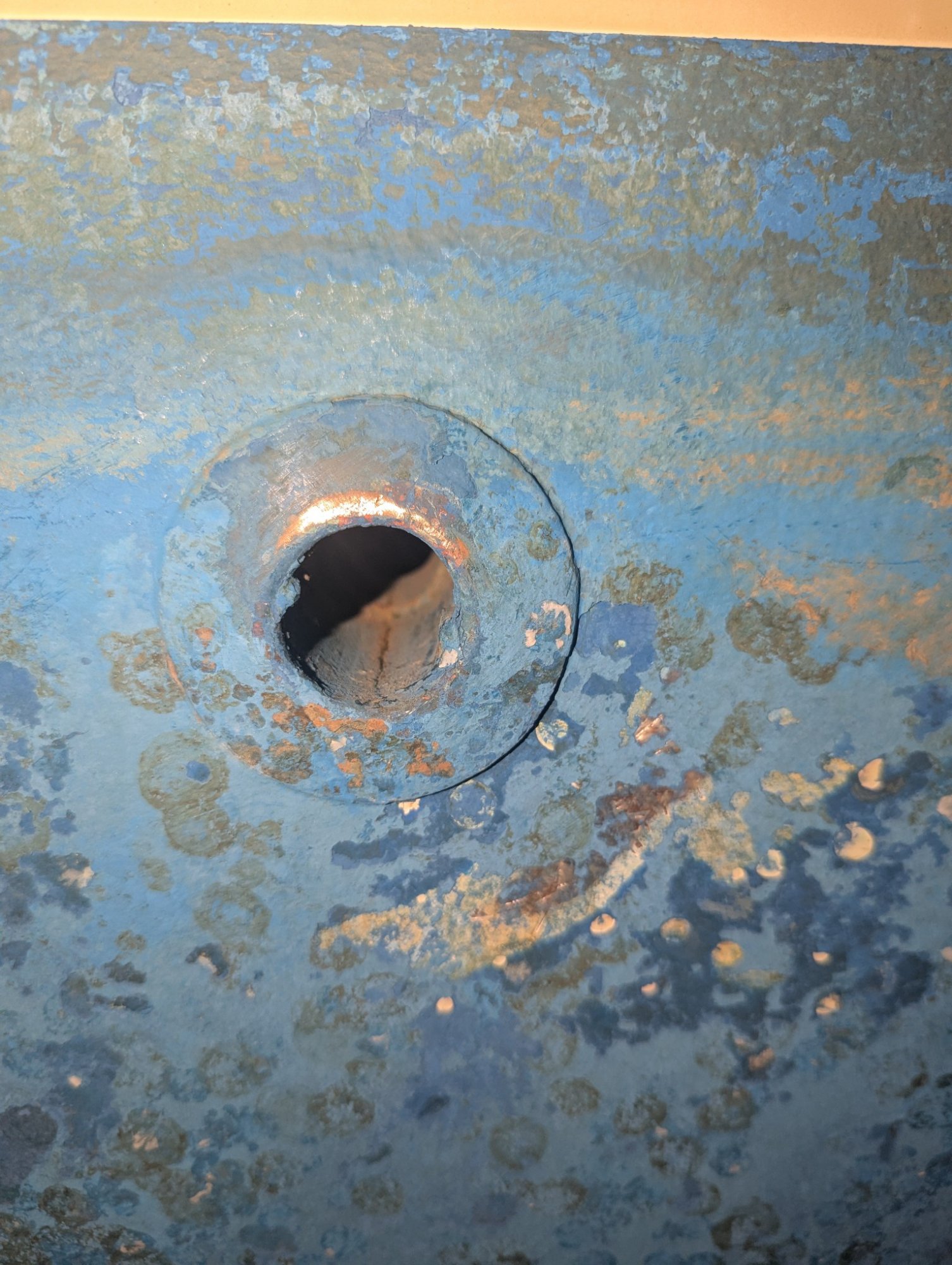

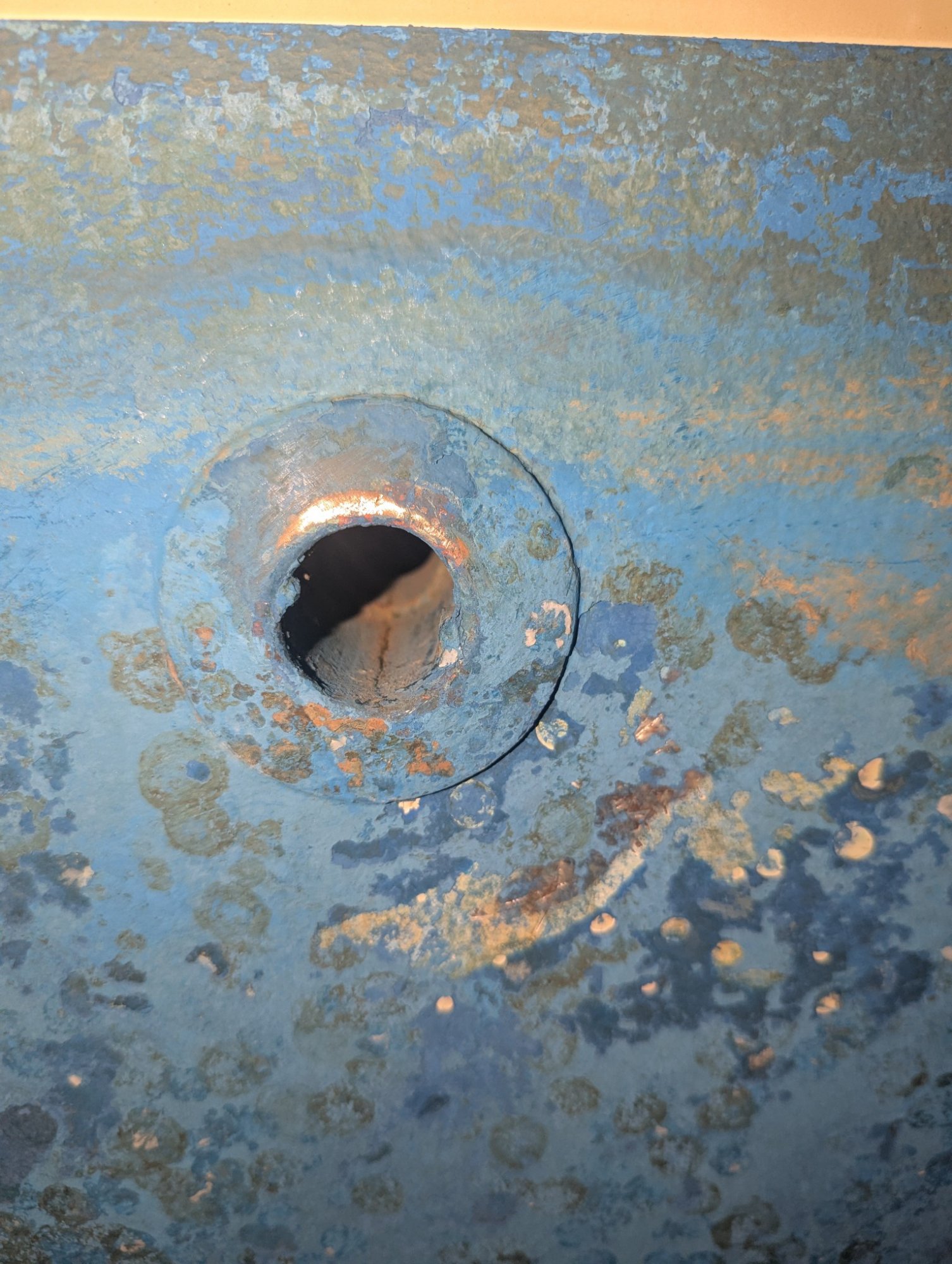

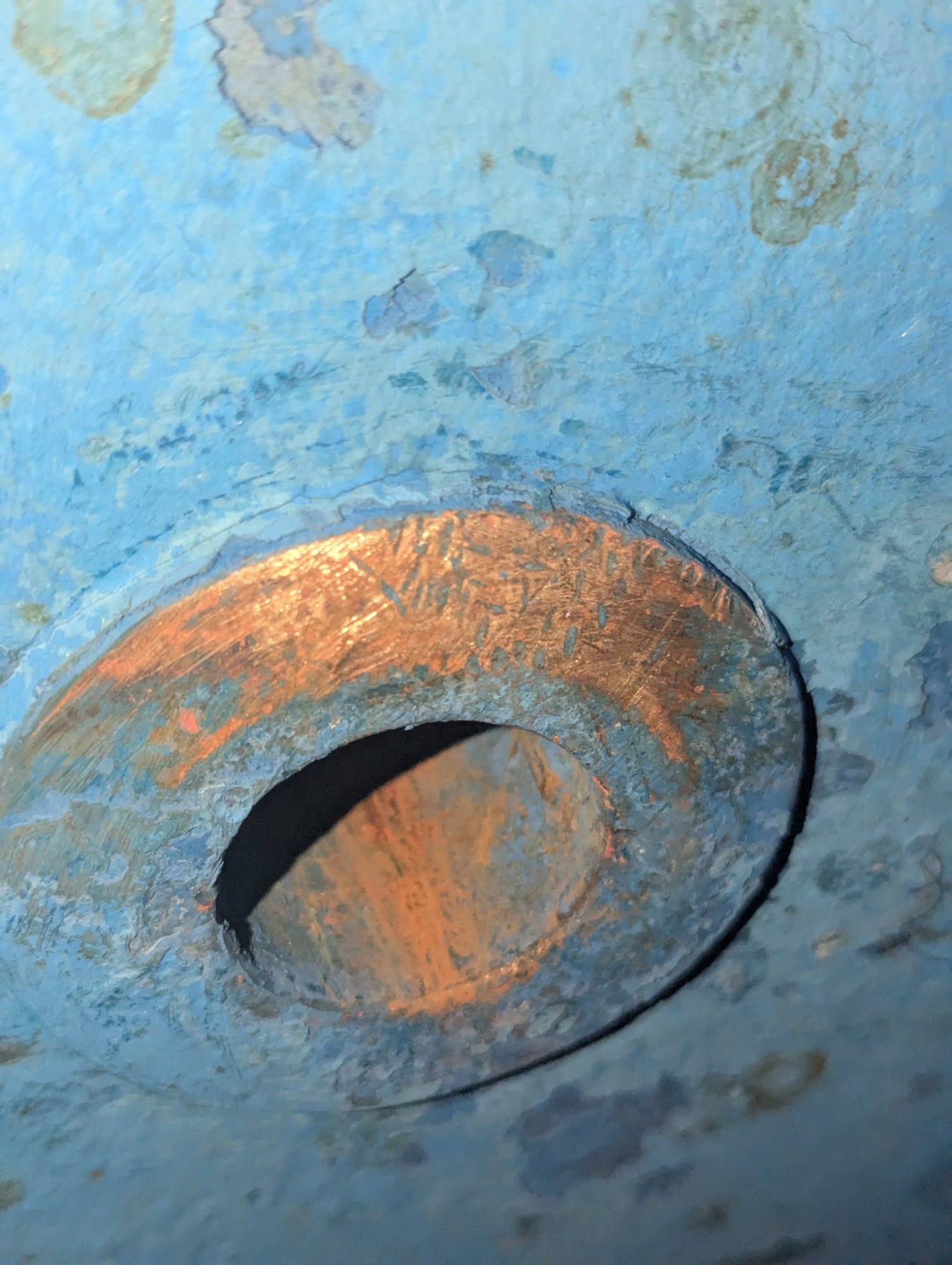

Last night I went out and did some testing. I took a hammer and banged on the through-hulls and sanded them down a bit. The metal seemed malleable and dented well without cracking. I also shoved a metal hammer handle up into the through-hull and dinged it around. Lots of clanking, but nothing broke off.
Color-wise, I’m hoping they’re bronze. It’s a pretty light color, but when I looked around the yard at other boats, I saw some similar shades on confirmed bronze fittings. I’m fairly sure all my through-hulls are bronze, and I haven’t seen any pink color or signs of dezincification so far. I even put a metal pole inside one and applied a good bit of pressure, and it held up solidly.
I’m thinking these through-hulls will at least get me through until my next haul-out later this year, when I plan to install proper flanged seacocks.

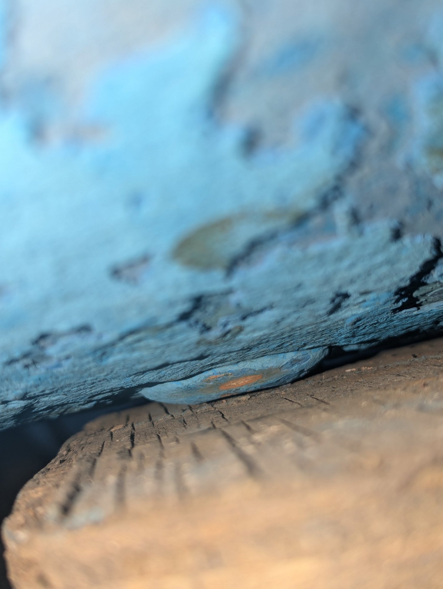

I’ll attach some photos here. What do you all think about the condition and whether I should trust these for now?
One other question: my sink through-hull is just below the waterline, but it angles upward so that the hose itself ends up above the waterline. Would that setup be considered above or below the waterline, given that the seacock is angled up but the hose runs higher?
dLj
Mar 23, 2017
4,757
Your sink is below the water line.
I'd have to inspect your thru-hulls to offer an opinion.

Is there any you'd recommend me to look for on the thru hulls before putting her back in the water for a few months before the next haul out?
dLj
Mar 23, 2017
4,757
I think you need to make the marina responsible for this job.
