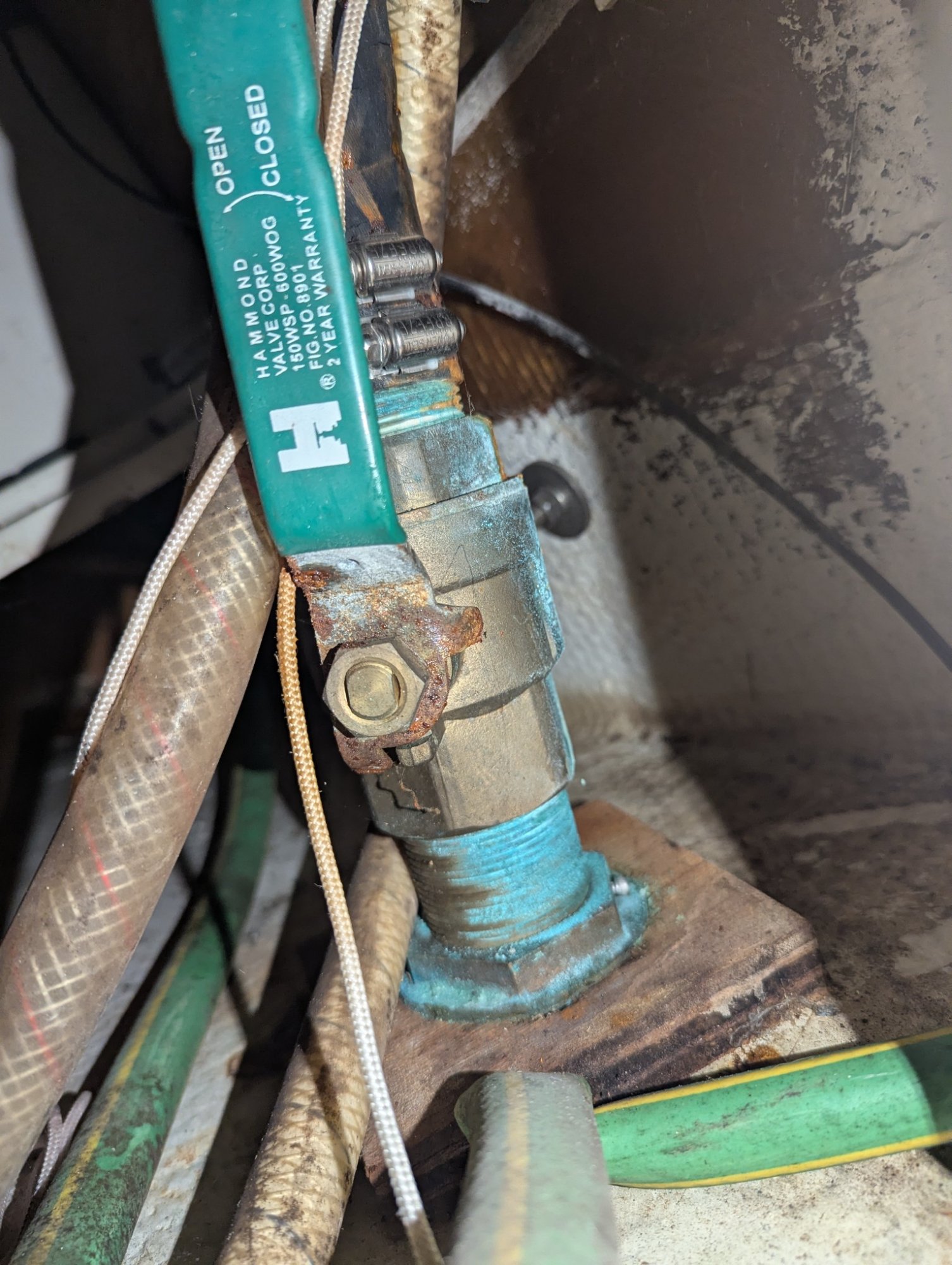

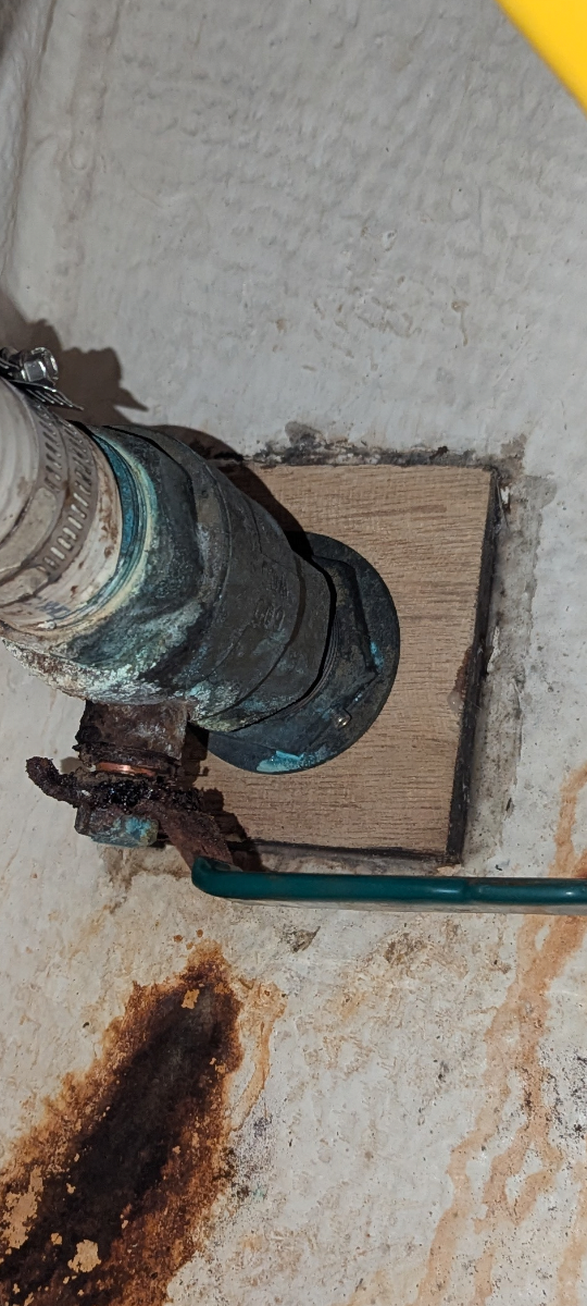

So one of these is stuck and the other turns over 90 degrees.
Should I replace these seacocks?
I asked to just replace all the seacocks... Reason I ask is because the boatyard contractor told me that might be a bit much and these bronze fittings usually last forever. He said we could just do the valve levers.
Just wanted a second or third opinion.
Thank you!

The second attachment looks like the notches on the handle are intact, so I presume that’s the one that’s stuck? It shouldn’t be able to turn more than 90 degrees with those notches. If that’s the case than the first attachment must be the one that turns too far?
If it’s stuck and you don’t know how old it is I would replace it. Being stuck is more than just a handle problem. The first one looks gnarly enough that again without knowing its pedigree I’d replace that too.
To be pedantic - what you have are technically not “proper” seacocks, they’re thru hull fittings attached to ball valves. There are major manufacturers that build them that way, so I won’t go so far as to say it’s absolutely wrong, but a traditional seacock is generally preferred if you’re replacing them anyway.
This was exactly my line of thinking and knowledge. I was challenged a bit by the contractor as he thinks the thru hulls look good and he doesn't want me to 'waste my money' on replacing perfectly good thru-hulls as it's an expensive job. What do you think? I didn't think the job was too intensive but I've not personally done it before.

Going against the general rule of always leaning toward the side of caution I would think if you could get the handles replaced, the stems cleaned up and the valves freed to easily move through their proper 90 degree arc (and no more) you would probably be okay.
But if it is something you are going to lose any sleep over you should just go ahead and replace them.

However, looking at your pictures, it looks like you can just change out those ball valves and be fine. I would definitely be thinking to change to bonafide seacocks as @Davidasailor26 said above - and after pulling off those valves definitely inspect those thru hulls. But there is nothing in those photos that looks alarming enough at this point to do that whole job right now.
But be prepared to do so, however, after pulling those valves in case those thru hulls are worse on the inside than they look on the outside...

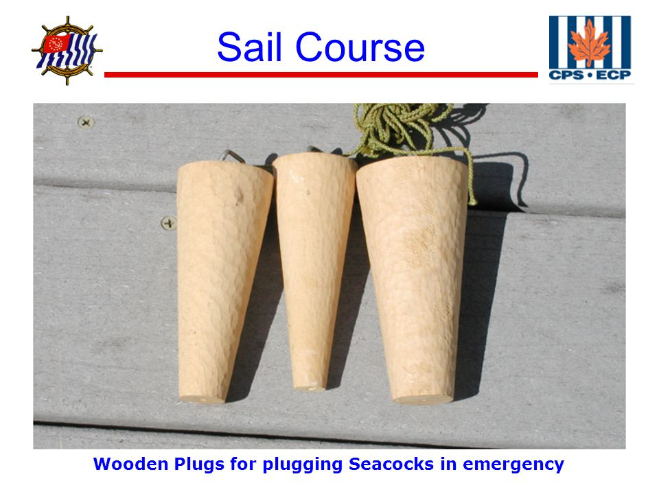

If you are going to take a chance, at least get some emergency wooden plugs to fill the hole should one of them start to leak.
