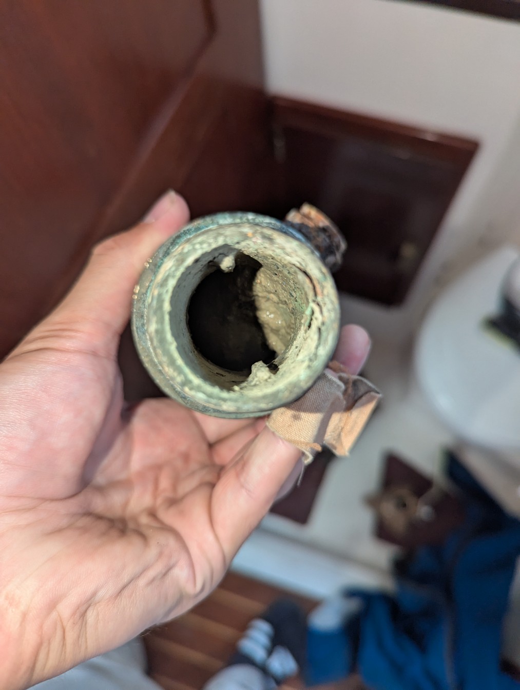

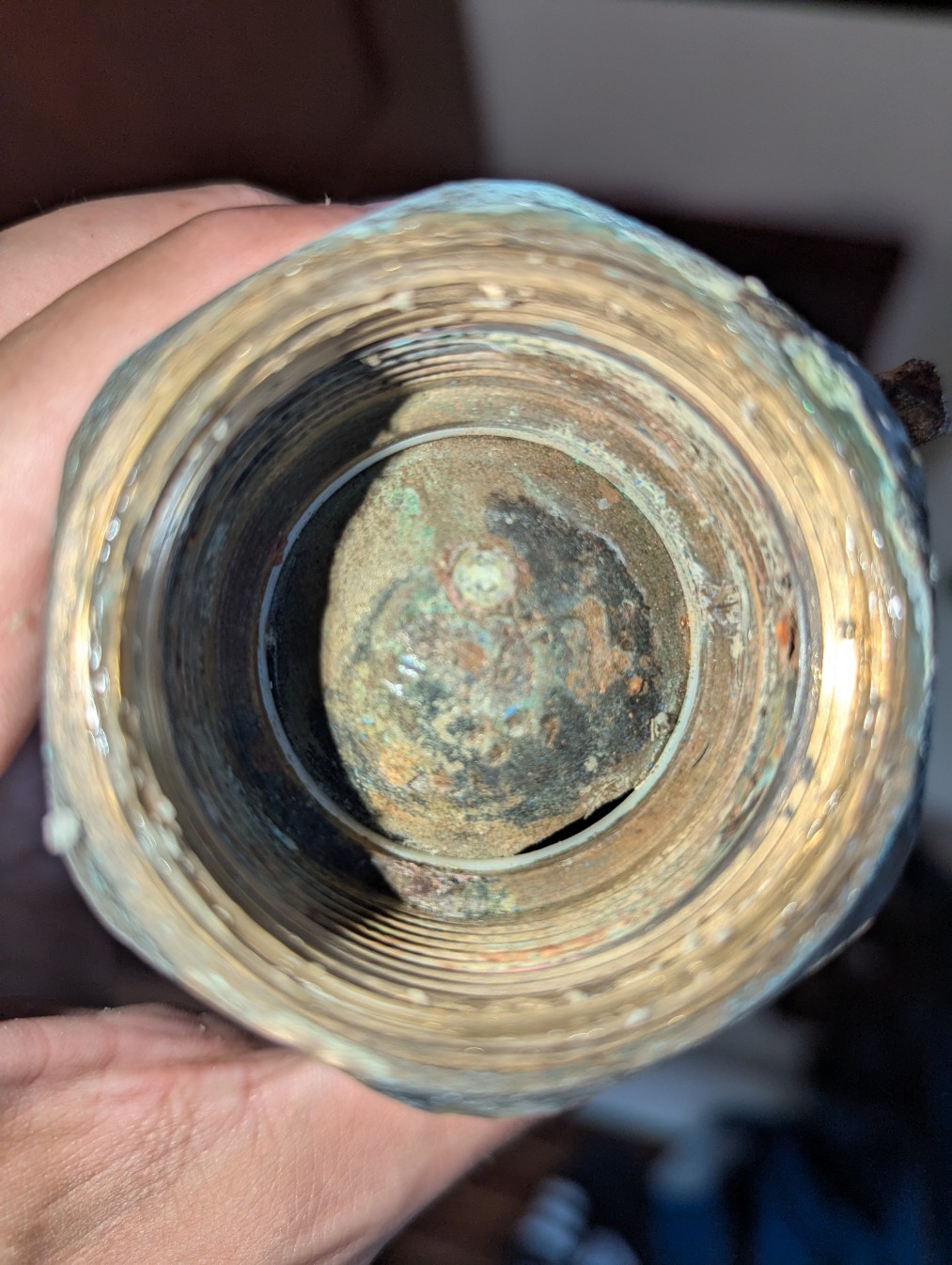

I think the prior 4 four posts are ignoring the above part of the OP's post #111.

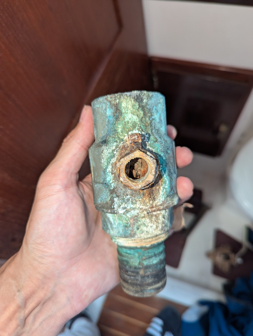

He is working toward a good solution. he has replaced the defective ball valves which, I think, were his original problem. In doing so he has used Groco flanged adapters which solve the mismatch between straight and tapered threads. He has said in prior posts that he is working on better backing plates and I assume he will follow through on what he has said and will use those backing plates to properly install the flanged adapters. Personally I think what has been done is a good interim step and better than what he had. You can't second guess him on whether he had the time or ability to do a more complete job in the time the yard he was in would allow.
The hose and through hull without a backing plate or valve is certainly an eye catcher but the through hull is the same as it was before, with what appears to be a new hose. An improvement. I think, (hope) that fitting is for an above the waterline head sink drain.
I assume @testingthewaters91will keep us aware of his progress
Richard, thanks so much for reading the thread so carefully. You’ve really followed the journey, and you’re absolutely right — this is an interim step before getting the boat to a DIY yard. The logistics of moving the boat there have been a bit tricky, but I’m working on it and hopefully I’ll get over there this week.
I’m honestly having a blast learning about all the different metals, seacocks, how flanges bolt in, and how fiberglass hulls provide the strength behind it all. These are details most of the local boatyard folks around me have never learned, and when I asked at another yard, they basically told me it’s “totally unnecessary.” They’re old salts, and that’s fine, but they’re not quite up to code, and I’ve decided I’m going to do it myself, properly, with the right tools.
Right now, at least I’ve replaced the old brass valves with decent seacocks on the old through-hulls — enough that I can float safely. The brass valves that were there before were awful. I’ll attach some photos so you can see what I was floating on. One was seized open, and the other had a pitted brass ball — pretty scary stuff.
And for the record, I have installed one proper clamp on the new under-the-waterline hose connected to a through-hull that still has no seacock. I’m not overly stressed about it, since it’s a good hose and clamp, and the real weak point is the old through-hull itself, which I can’t replace until I haul out. No sense losing sleep over something I can’t address until I’m in the yard.
One of the other posters doesn’t seem to grasp the scope of this entire thread, but he’s welcome to go back and read it from the start if he wants the full picture.
I’m fully aware that the yard’s previous work is subpar and will be redone by me and my friends. That’s just the journey of owning a boat, I’m realizing — so much existing maintenance out there is substandard, not to code, wrong metals, wrong wire gauge, improper bonding, or no bonding at all. That’s just not how I operate.
Thanks again for your kindness and support. I’m definitely moving toward a good solution. It’ll take some time, as all good things do, but once I get all the proper seacocks in place, it’ll be a huge weight off my shoulders.
Meanwhile, I am still dealing with some water ingress underway when running the Yanmar 2GM20F, which I’m chasing down in my other thread. Overall, though, things are improving — and honestly, I’m loving every minute of it, even though my anxiety spikes on a regular basis.
Thanks, everyone, for following along.

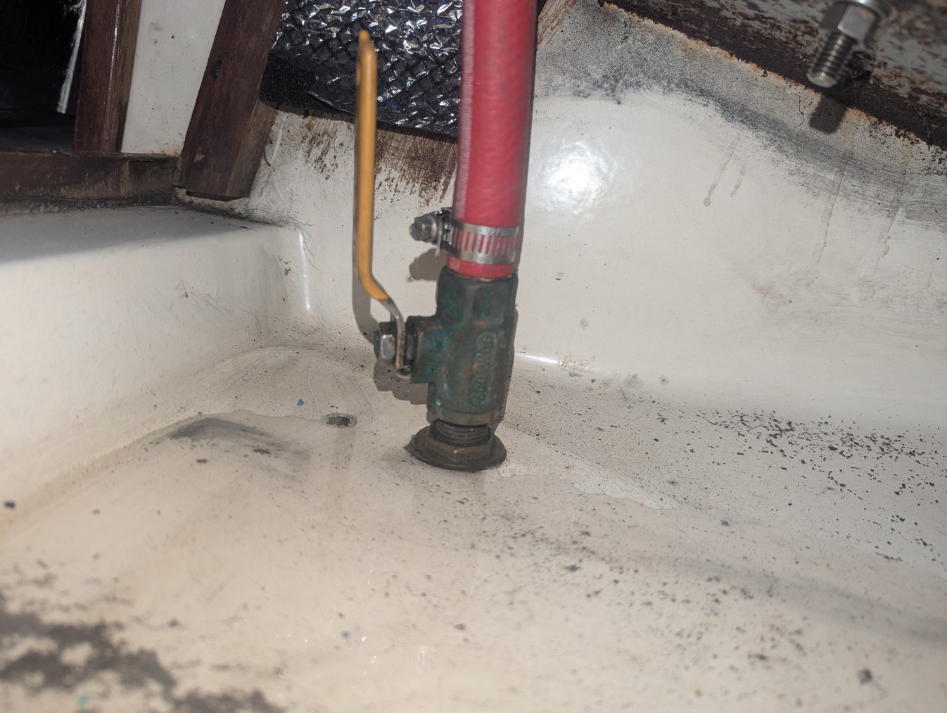

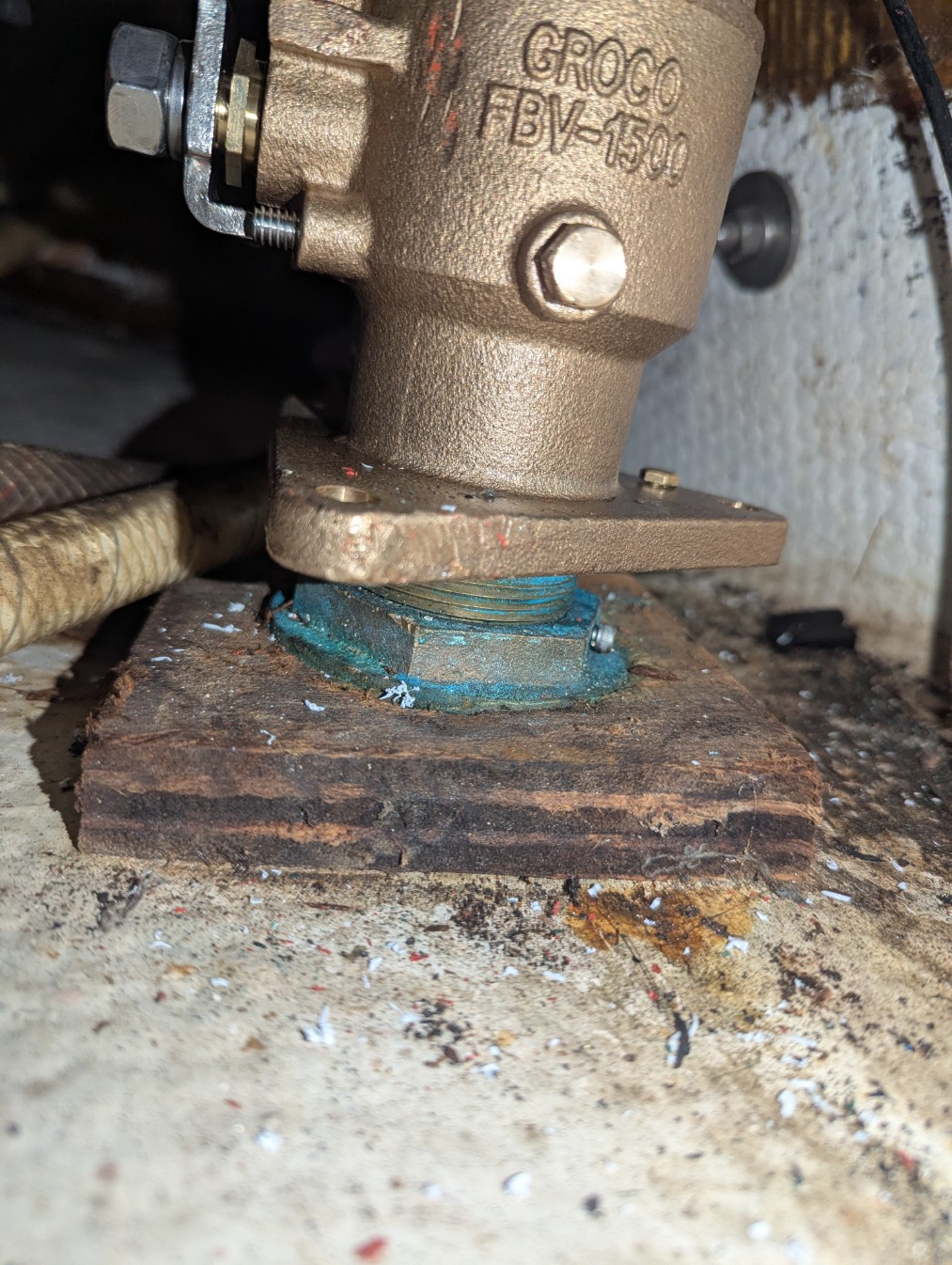

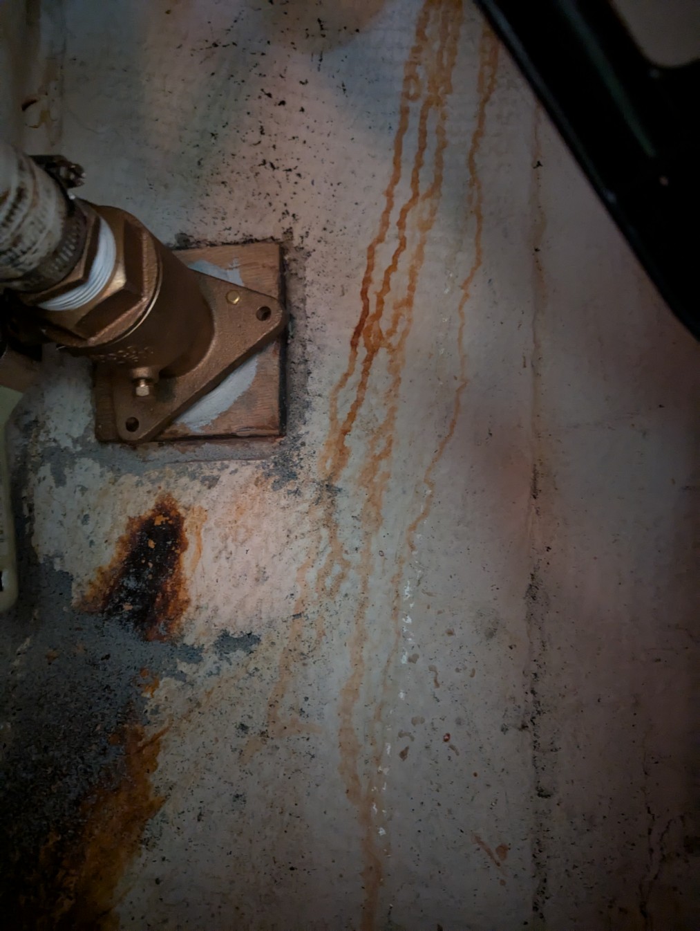

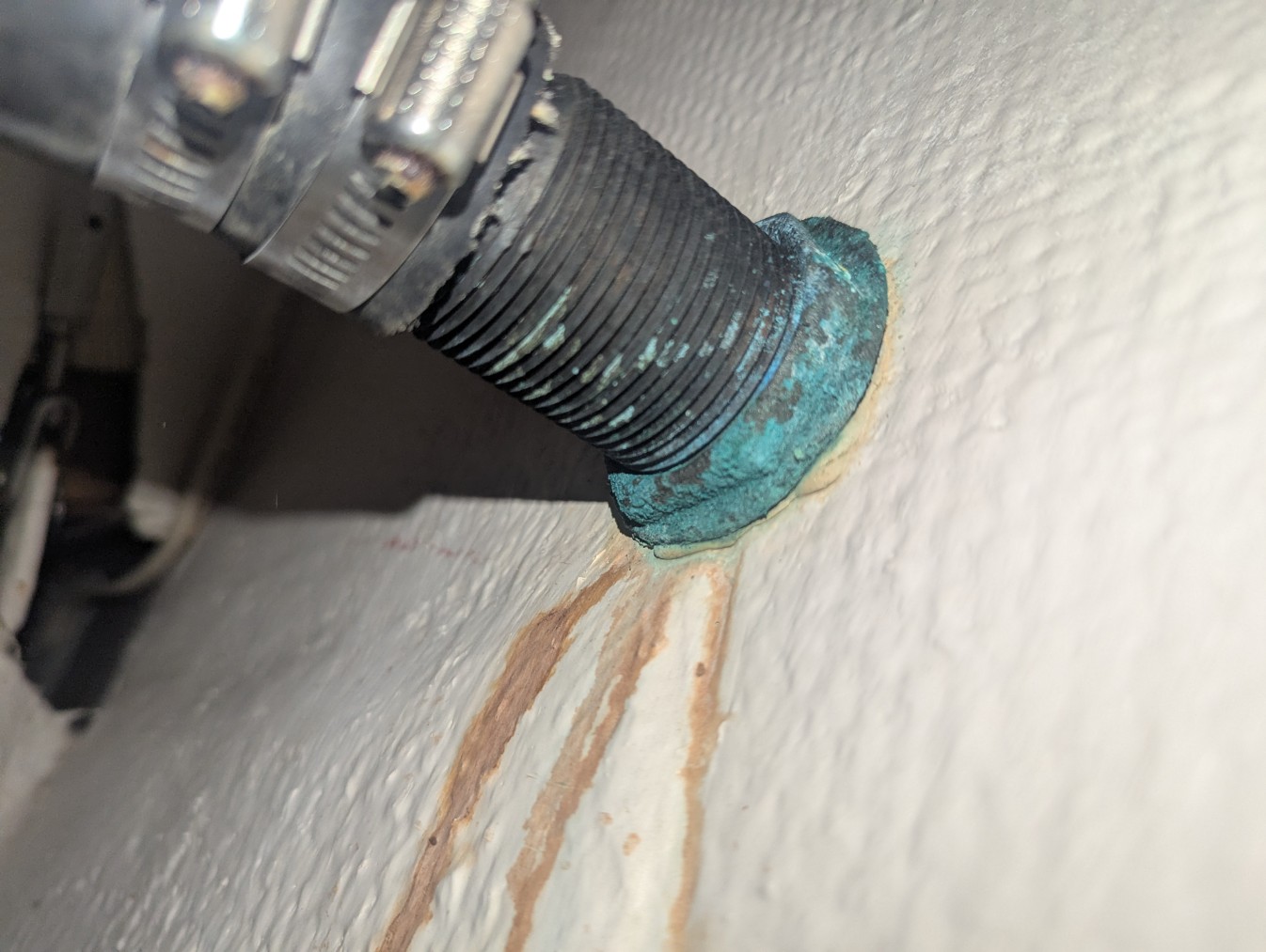

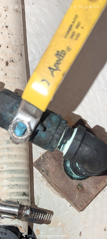

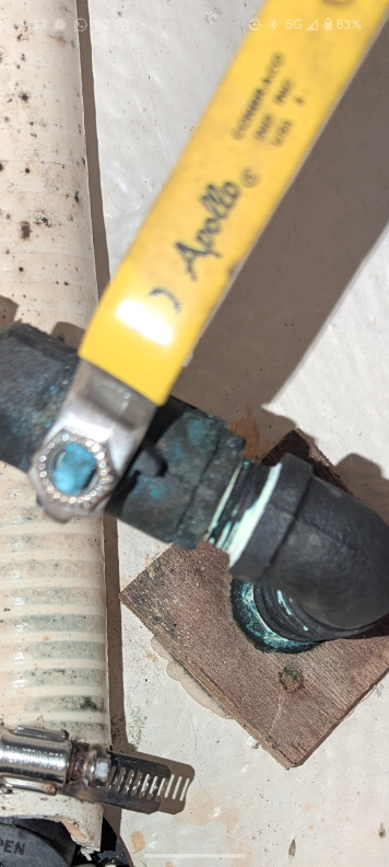

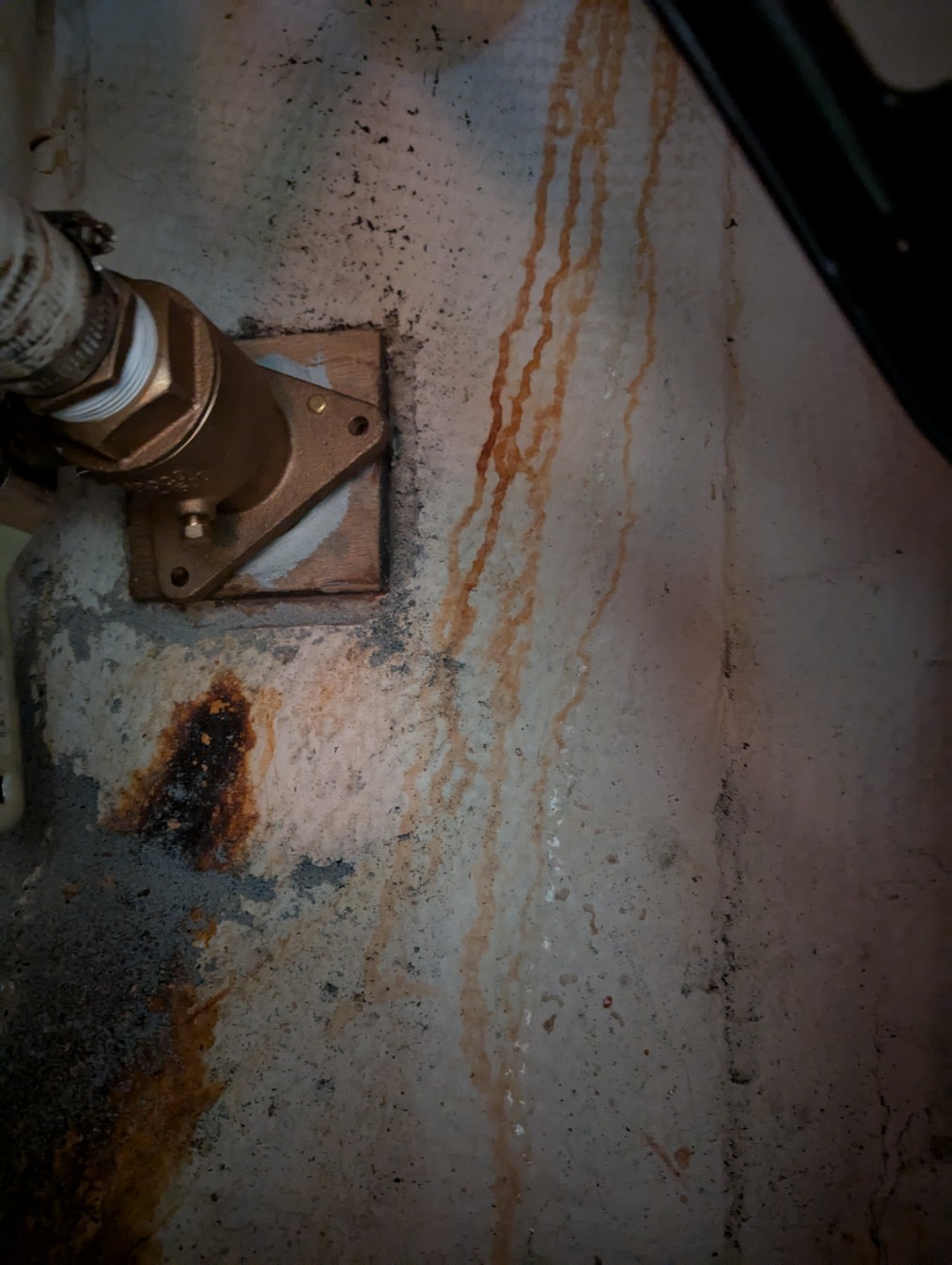

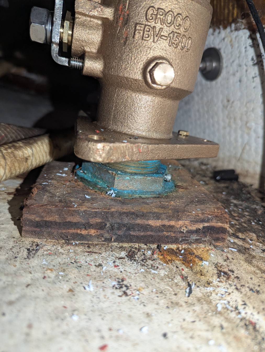

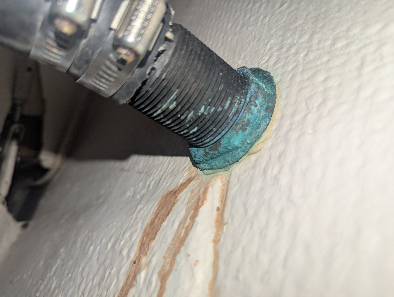

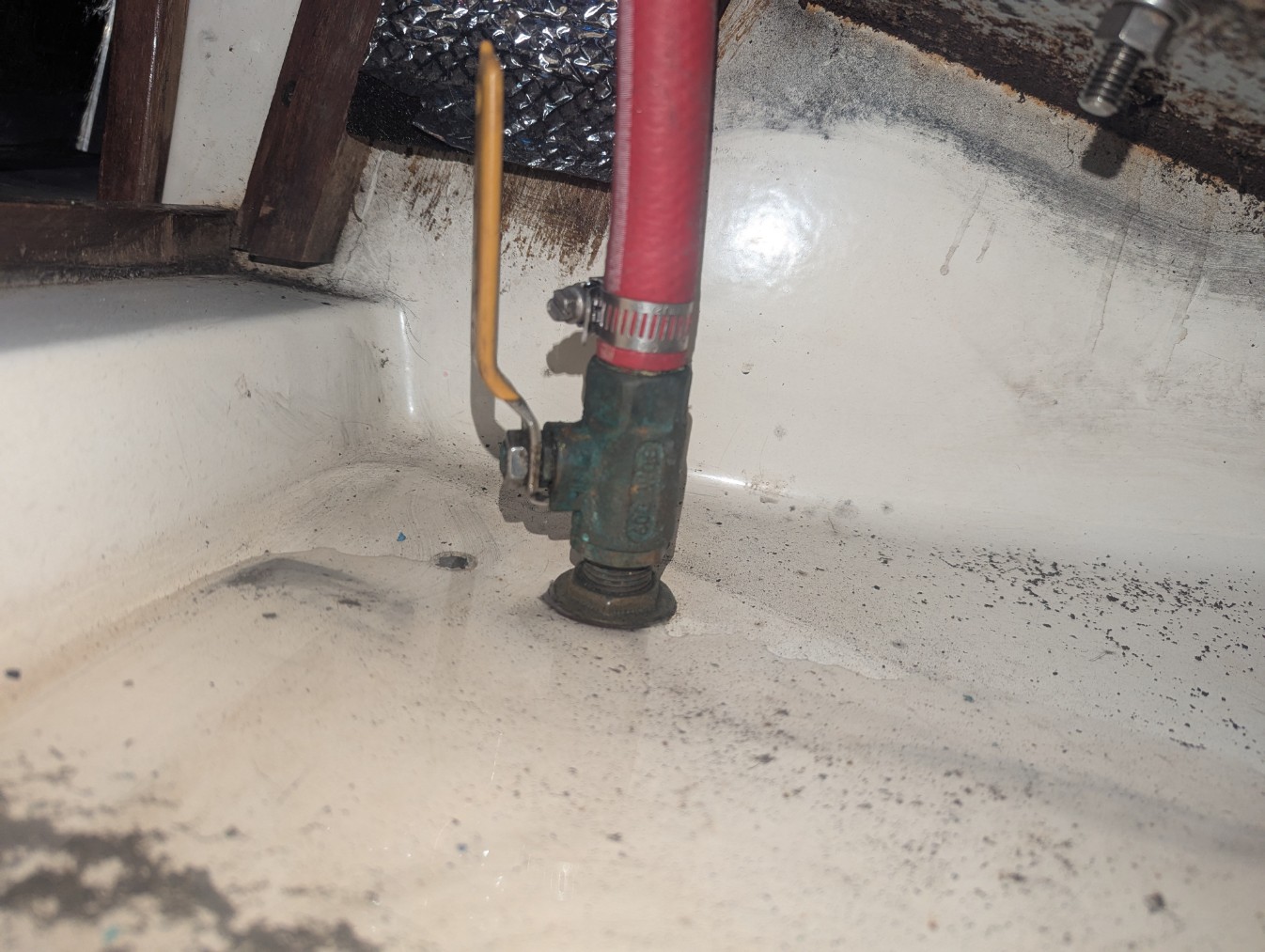

I guess part of my confusion is that OP states he wants to move to a DIY yard…so that tells me he is NOT in a DIY yard and paid the yard to replace those bastardized fittings. Apparently I read too much into that sentence and the OP did the work himself.
While those Groco thru hulls are top notch, the application is not. And the hose clamped on to a skin fitting is not.
Are these repairs better than the old valves….probably, but I have no idea how those thru hulls are screwed on to the old skin fittings and whether or not they will leak. And if that hose that is clamped to a skin fitting comes off, the OP will have no way to shop water from flooding in (maybe he has a wood plug at the ready…).
Hopefully the trips to the new marina isn’t very far and the haulout will be Set up and waiting for him when he gets there….
So, God Speed and good luck.

Just to clarify: the so-called ‘repairs’ were courtesy of the boatyard, not me. I’d have done it myself, but they turned down my DIY request — a detail I’ve mentioned more times than the repairs were actually attempted.
Jan 7, 2011
5,877
Oday 322 East Chicago, IN
Ok…so we are back to the yard doing a horrible job….what I said originally. I get lost in the…
”Right now, at least I’ve replaced the old brass valves with decent seacocks on the old through-hulls — enough that I can float safely. The brass valves that were there before were awful. I’ll attach some photos so you can see what I was floating on. One was seized open, and the other had a pitted brass ball — pretty scary stuff.
And for the record, I have installed one proper clamp on the new under-the-waterline hose connected to a through-hull that still has no seacock. I’m not overly stressed about it, since it’s a good hose and clamp, and the real weak point is the old through-hull itself, which I can’t replace until I haul out. No sense losing sleep over something I can’t address until I’m in the yard.”.
As long as you understand that the valves are not installed correctly and have a plan to get the boat moved and then hauled out, you should be Ok.
I just find it hard to believe a competent yard would think that they installed those thru hulls correctly.
Any way, God speed, and good luck. Check for leaks as soon as you put the boat in the water (before leaving the slings)…

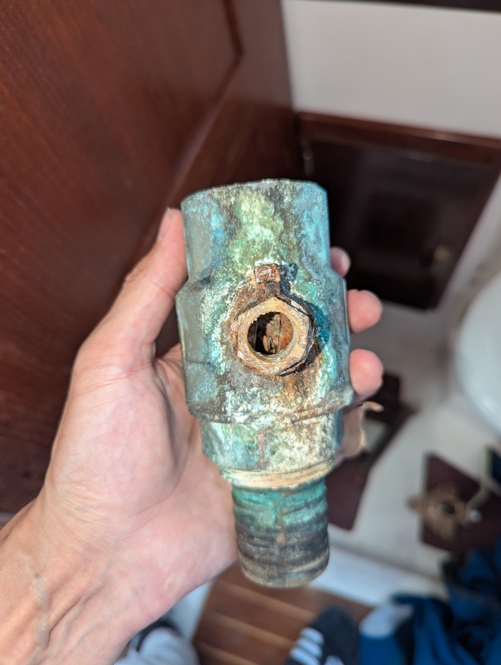

Hi all,
I’ve just had my boat delivered to a new marina with a DIY yard where they’ll be hauling me out soon. No leaks so far—my temporary 4200 fix on a through-hull with a broken seal is holding up well.
I have access to plenty of tools (Sawzall, angle grinder, sander, etc.) and I’m gathering materials to replace several thru-hulls and seacocks. One thru-hull installed by the previous yard was poorly done and bedded with 4200 (supposedly removable). I’d like to remove it without damaging either the hull or the fitting, as I’d prefer to avoid fiberglass repairs if possible.
I’m also dealing with old plywood backing plates epoxied to the hull and would appreciate advice on removing them cleanly. My plan is to replace them with G10 backing plates, glassed to the hull, and mechanically fastened under the flanged seacocks. Is G10 still considered the best material for this application, or is marine plywood (epoxied) a reasonable alternative?
Another question: the previous yard used Teflon tape on all the seacock threads. I’ve read this can interfere with proper electrical bonding. Is there a better sealant or method to ensure reliable electrical continuity between bronze thru-hulls and seacocks?
For my Yanmar 2GM20F engine intake, it currently has a 1/2" thru-hull that performed well during a recent test run (about 2800 RPM for 3 hours at 6 knots, with no overheating). Should I retain the 1/2" size, or consider upsizing while I have the opportunity? There’s also a small external grate or plate over that intake. What’s the safest way to remove that and access the fitting behind it?
Lastly, someone recommended using 5200 to bond the backing plates to the hull, while others suggest marine epoxy. Does anyone have experience with one versus the other for this application?
I’m aiming to start fabricating the backing plates on Monday and hope to complete all five thru-hulls by the end of next week. Any insights, tips, or lessons learned would be greatly appreciated. I’m keen to get this right the first time.
Thanks very much!
Edit: Added pictures of the five seacocks and thru hulls to be replaced.

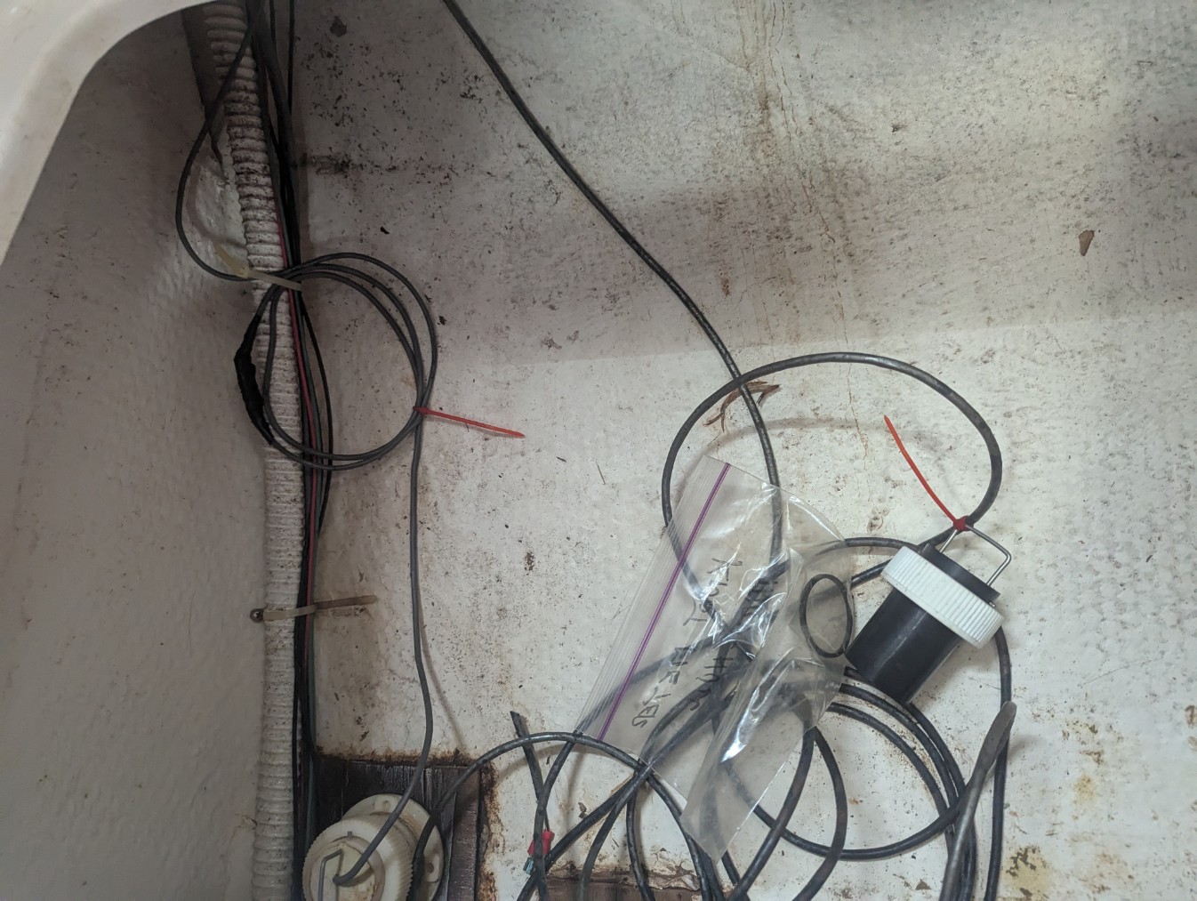

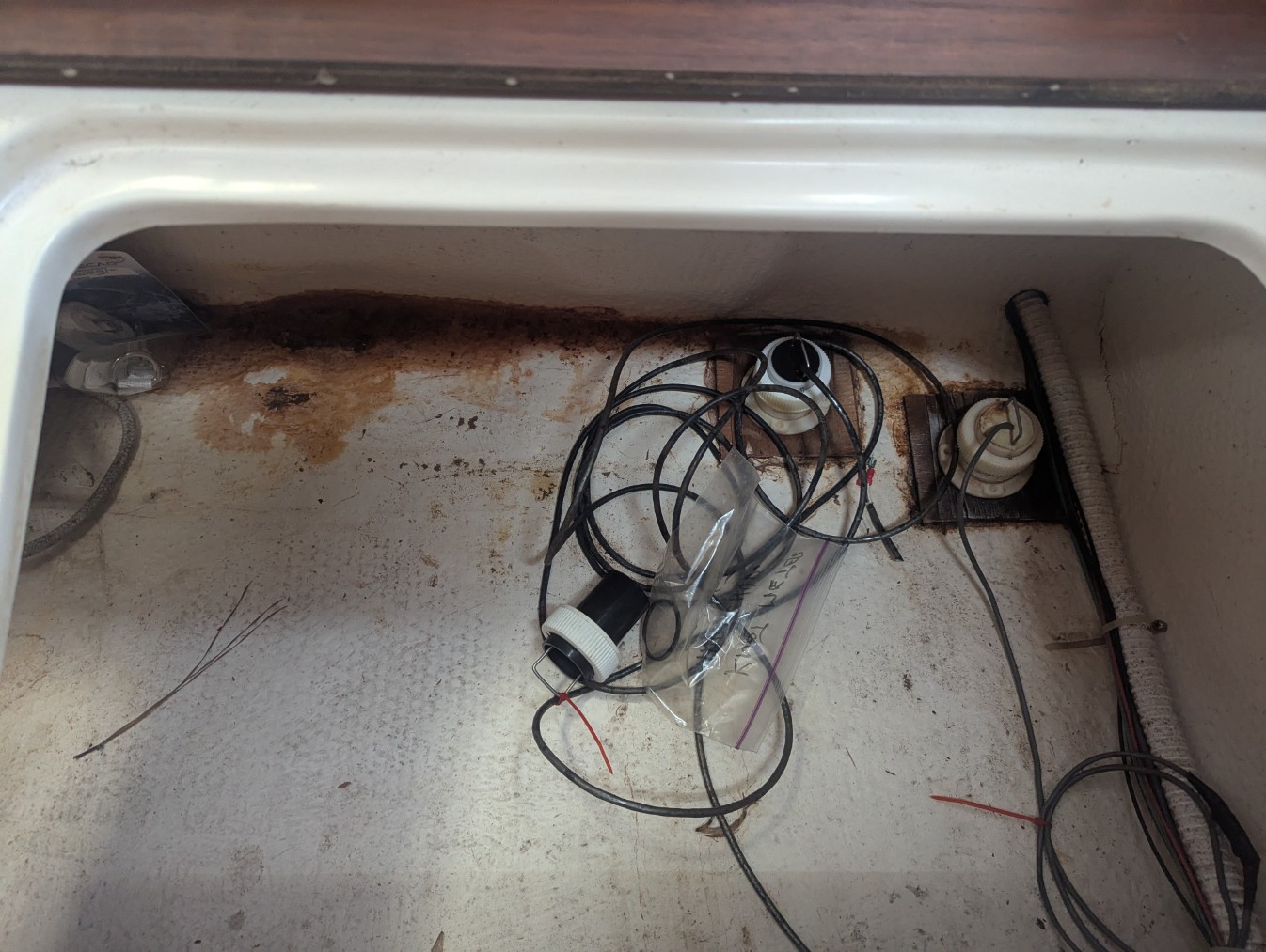

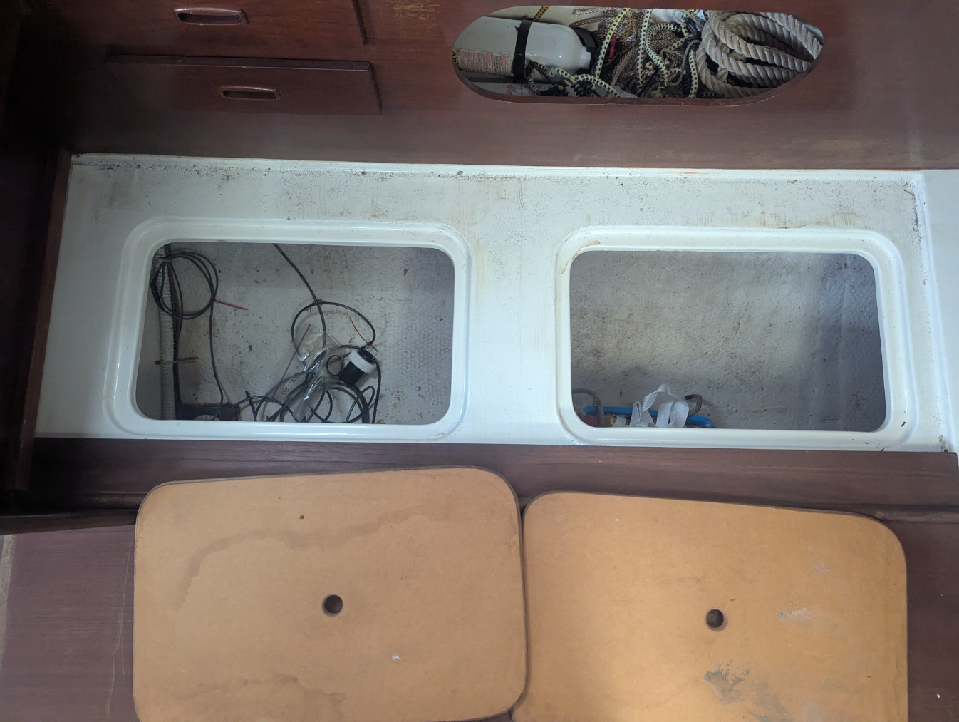

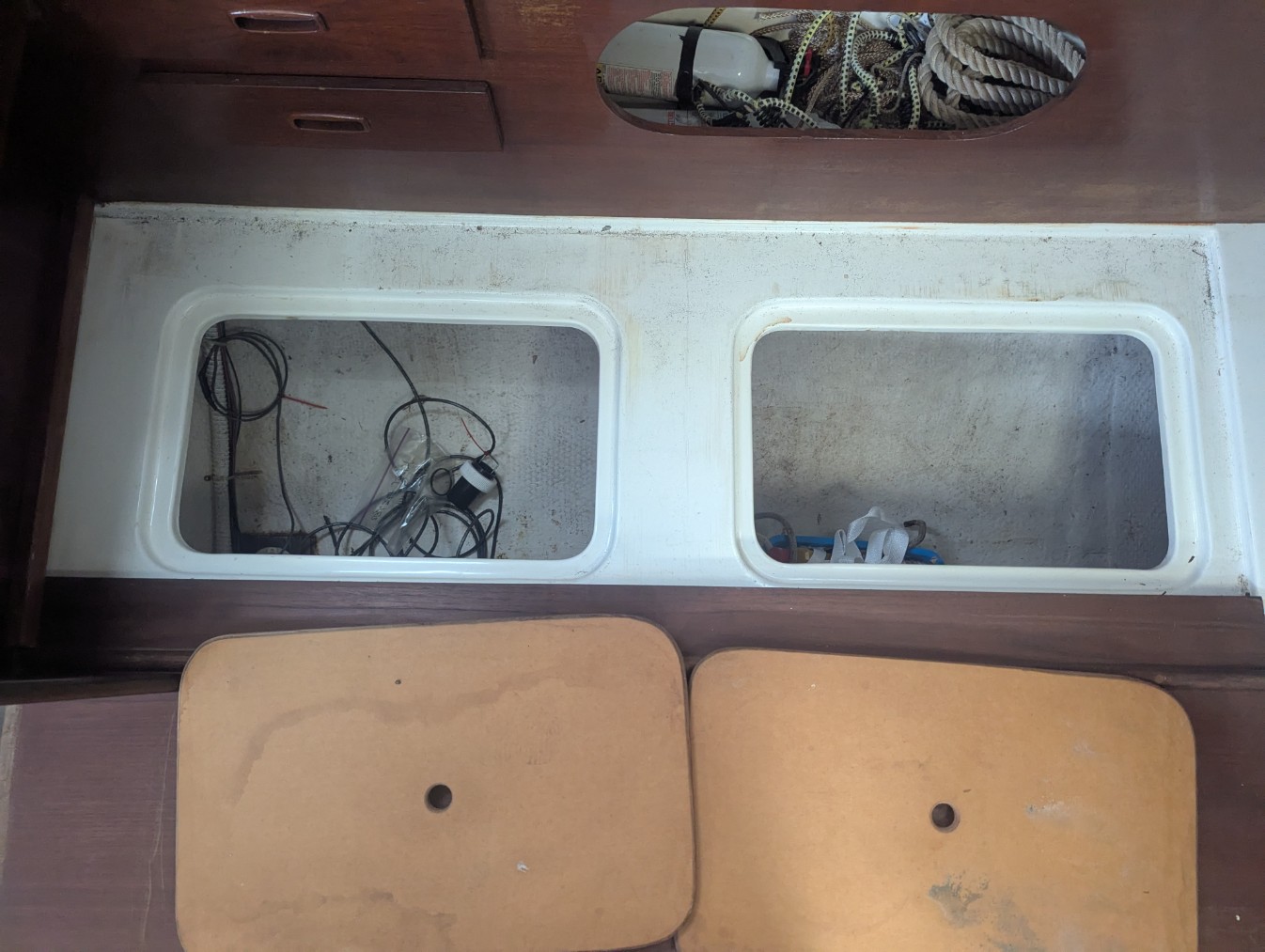

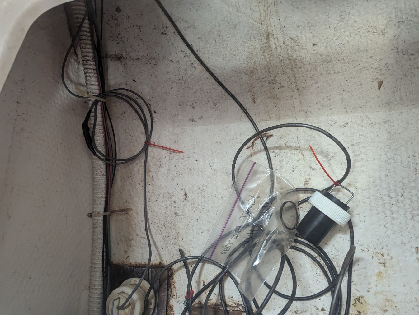

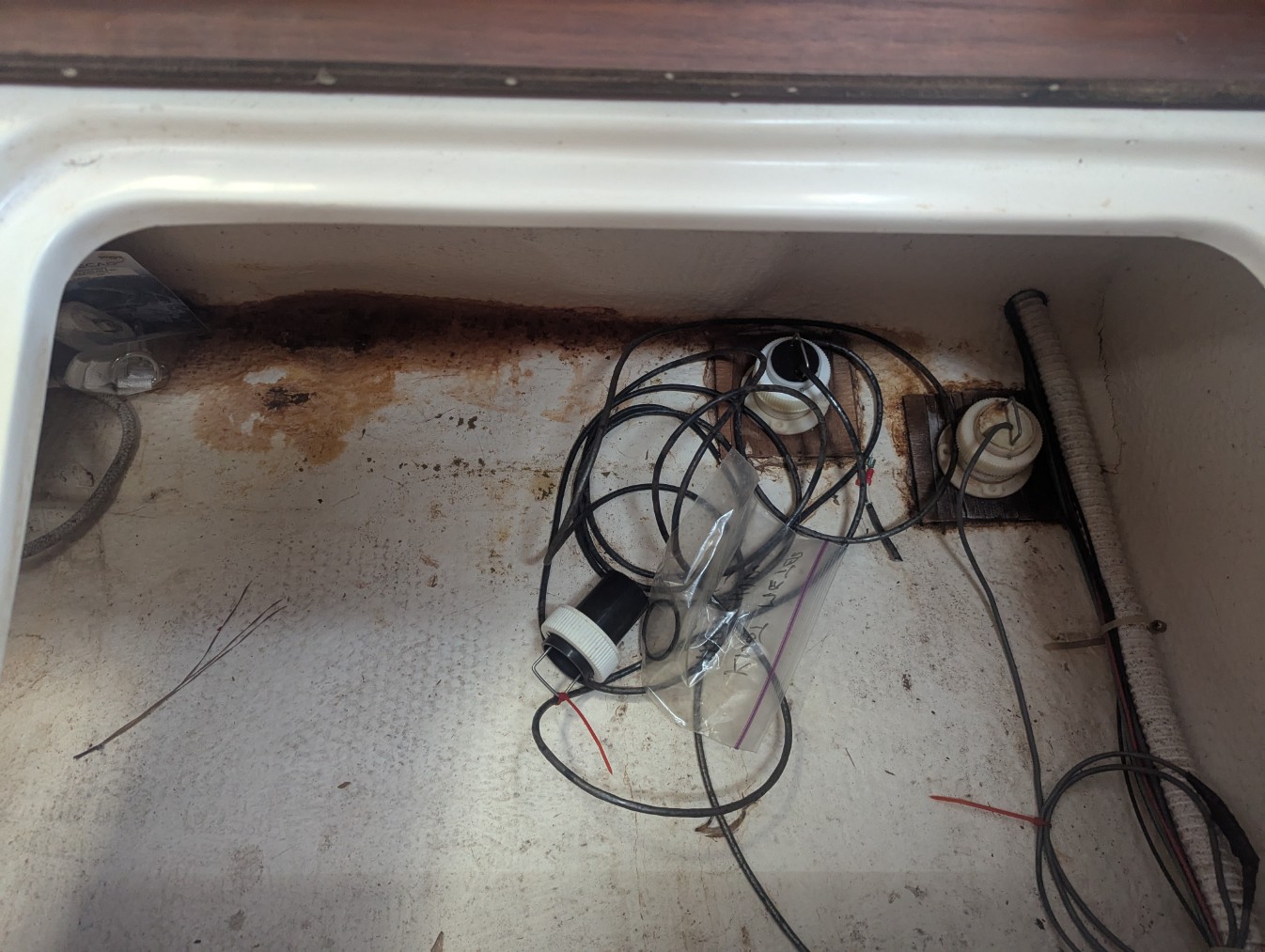

I also have a transducer and knot meter installed on the bottom of the hull. They’re not original equipment and were added by a previous owner or yard. Visually, they seem to be functioning fine, and the backing plates look alright, but I know transducers can be potential points of failure.
I’m considering whether to leave them alone for now and deal with them at a future haul-out (maybe next year), or whether it’s wise to inspect or replace them while I’m already doing thru-hull work.
I’ll upload some photos of the transducers for reference. Any advice on whether to leave them be or address them now would be much appreciated!

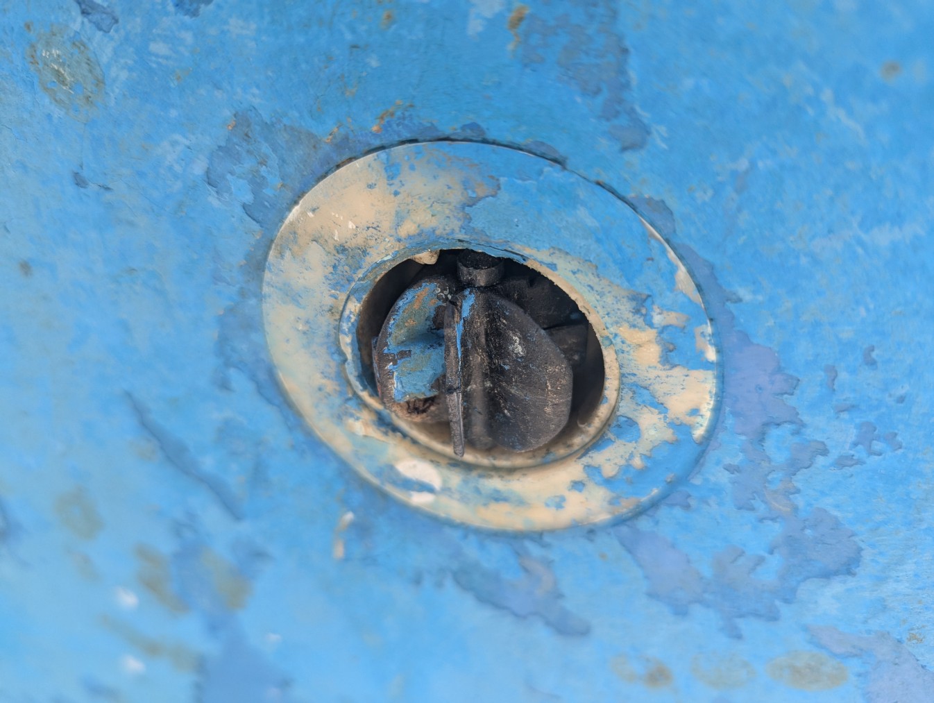

Very happy to report that she's back on the hard today in a yard that permits DIY work!
Current job list is short and sweet.
Replace thru hulls and seacocks, glass in the transducer and paddlewheel holes on the hull, and place the proper yanmar parts in the transmission.

I'm confused. In another thread you said you'd keep them because of the kind of sailing you plan to do.
I’ve been debating whether to keep my current transducers or replace them. Another poster mentioned that, since my hull is solid fiberglass, I may could switch to a shoot-through-hull transducer instead of a traditional thru-hull. I’m still on the fence, but if I can upgrade affordably to a shoot-through option that doesn’t require a hole in the hull, I’d definitely consider it.
There is no doubt I will need the transducer.
