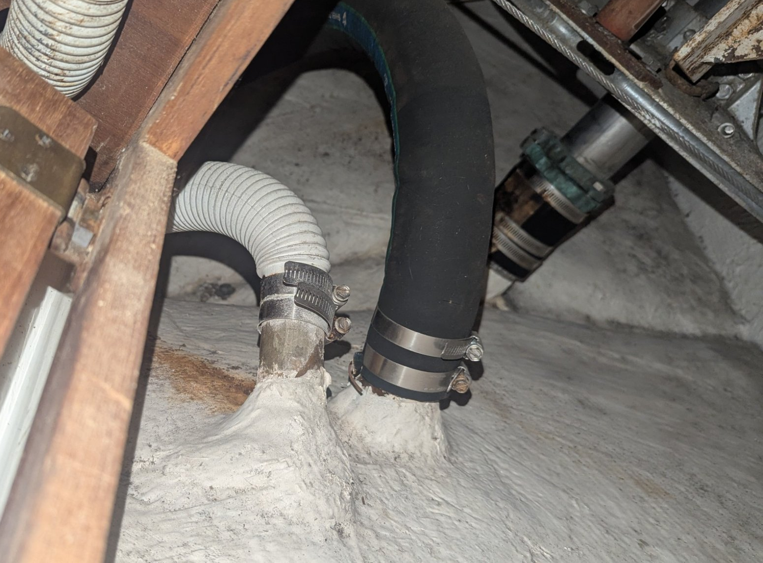

I’m going to go ahead and replace the two hoses in the aft compartment with robust marine-grade hose and double clamps set 180 degrees apart. That should hold up solid for the next couple years until the next haul-out.
For the seacocks, I’m planning to swap in brass (edit: I meant to say bronze) for four total: the galley sink, engine intake, marine head sink, and what I think is waste discharge. I believe the engine intake is half inch, the galley sink and waste discharge are inch and a half, and the head sink might be three-quarter or maybe even half inch—I’ll double check, but if anyone knows the correct sizes on a Hunter 30, I’d appreciate the confirmation.
A few of these had no valve at all, including the marine head sink discharge, which surprised me. I’ve attached a few more photos including the engine intake.

Swap in bronze, not brass. Brass is susceptible to dezincification, leaving it pink and brittle.
Ahhh! I keep mixing them up—I meant bronze! Shows you how much of my brain is left after all this.

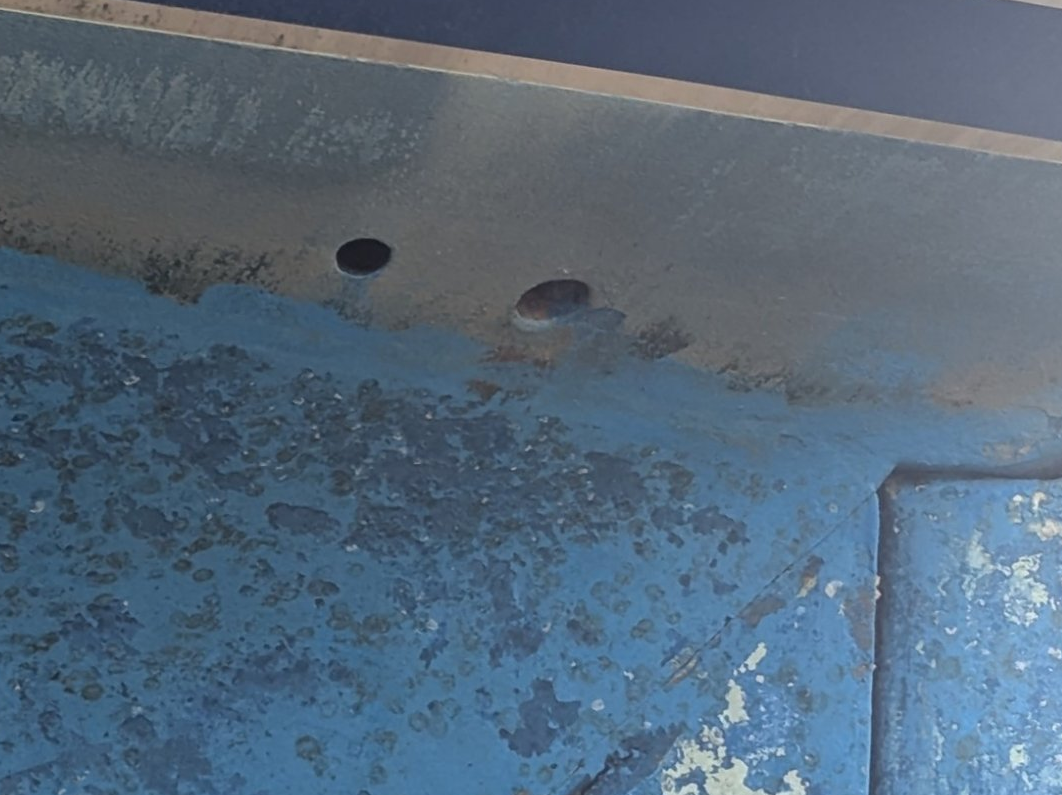

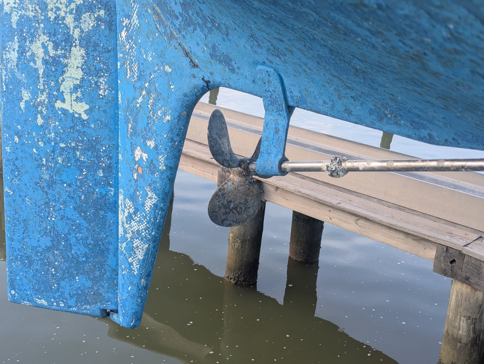

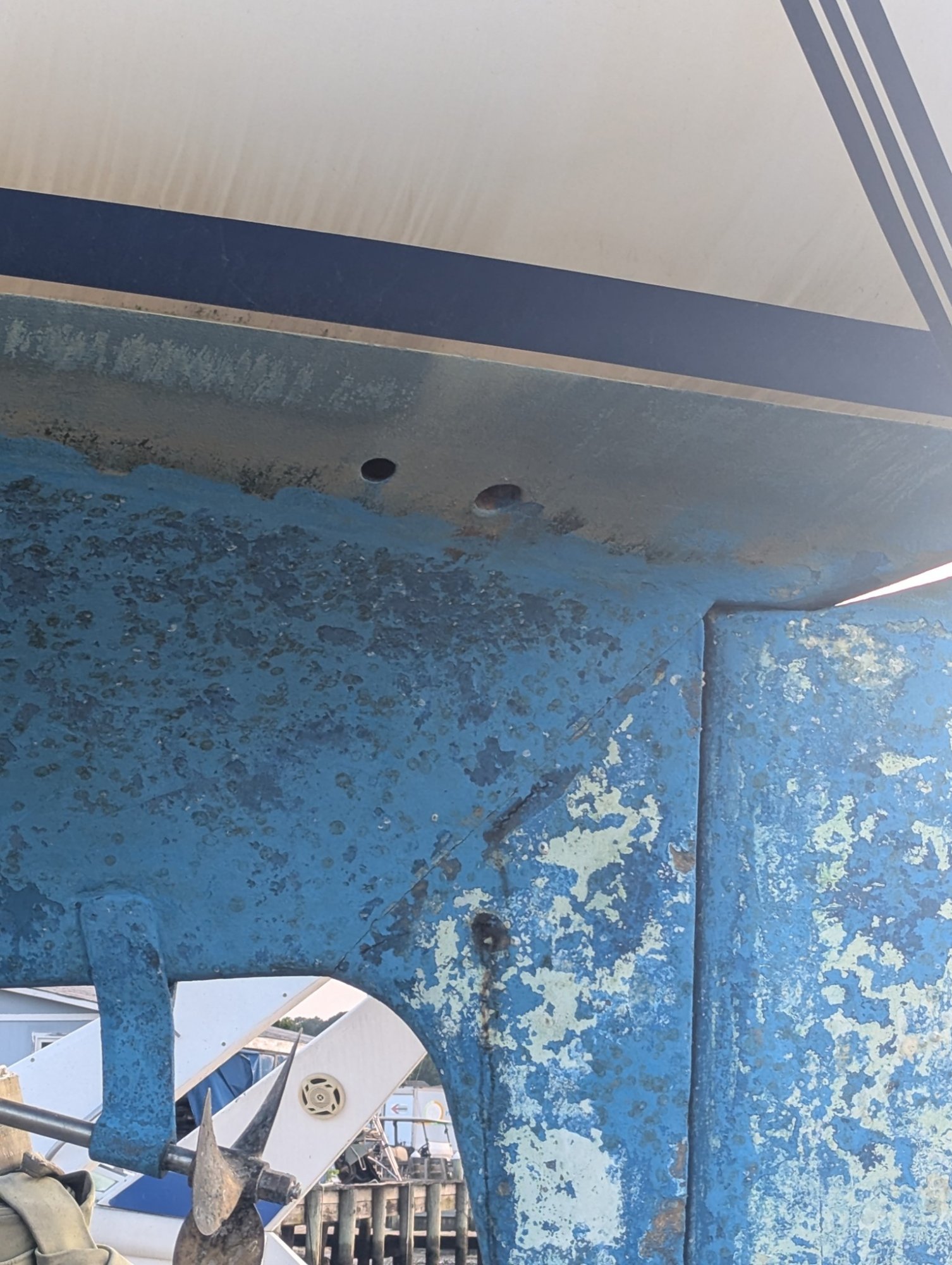

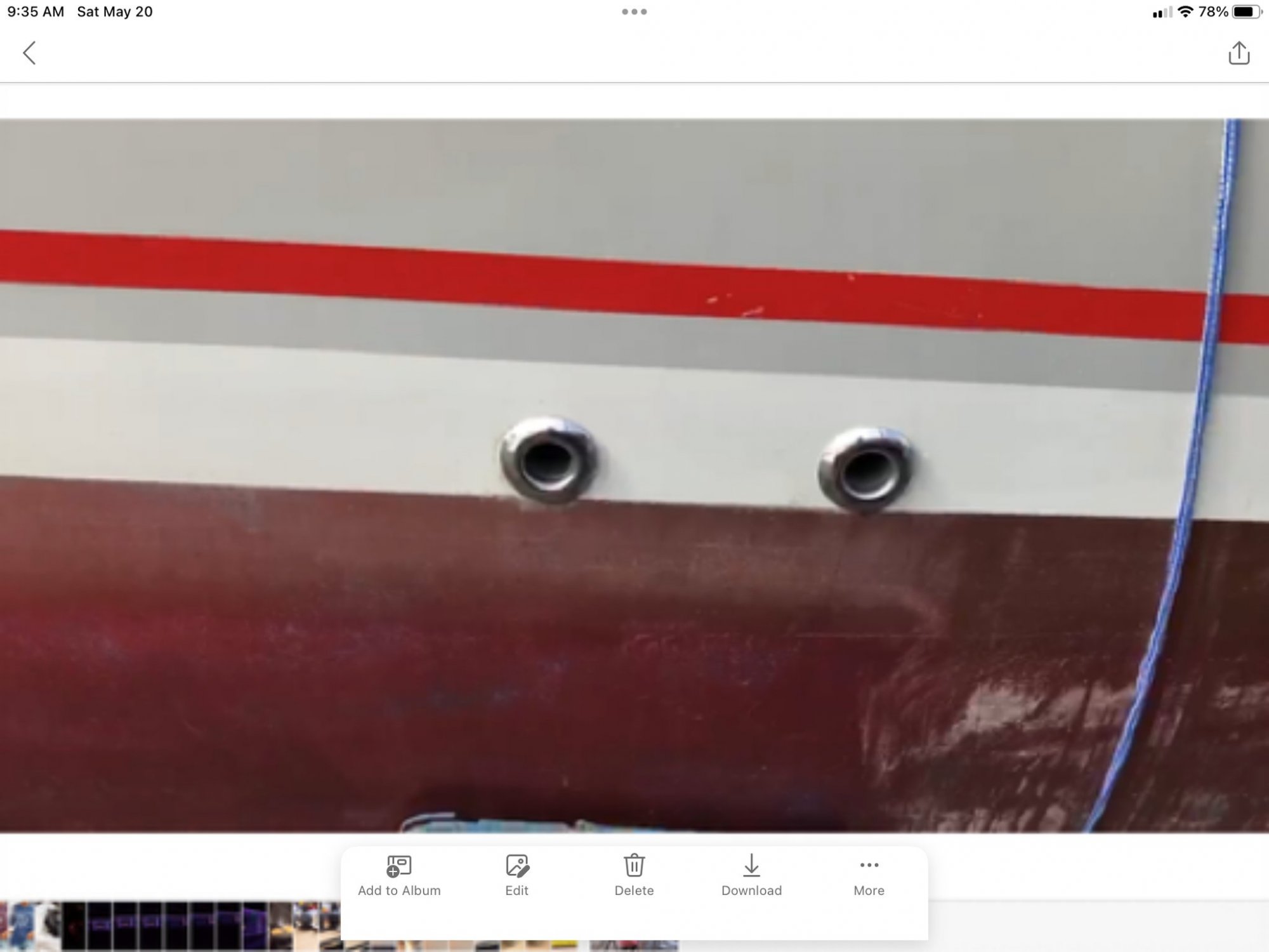

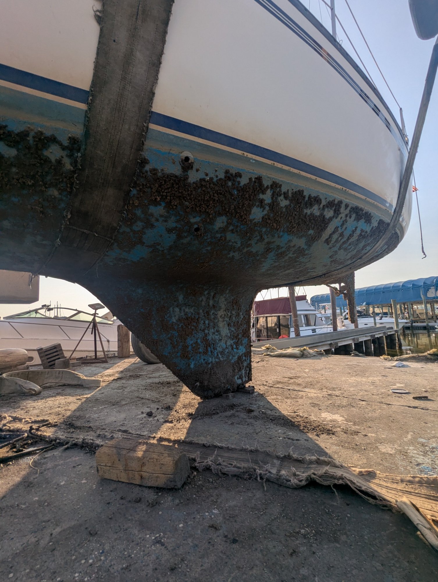

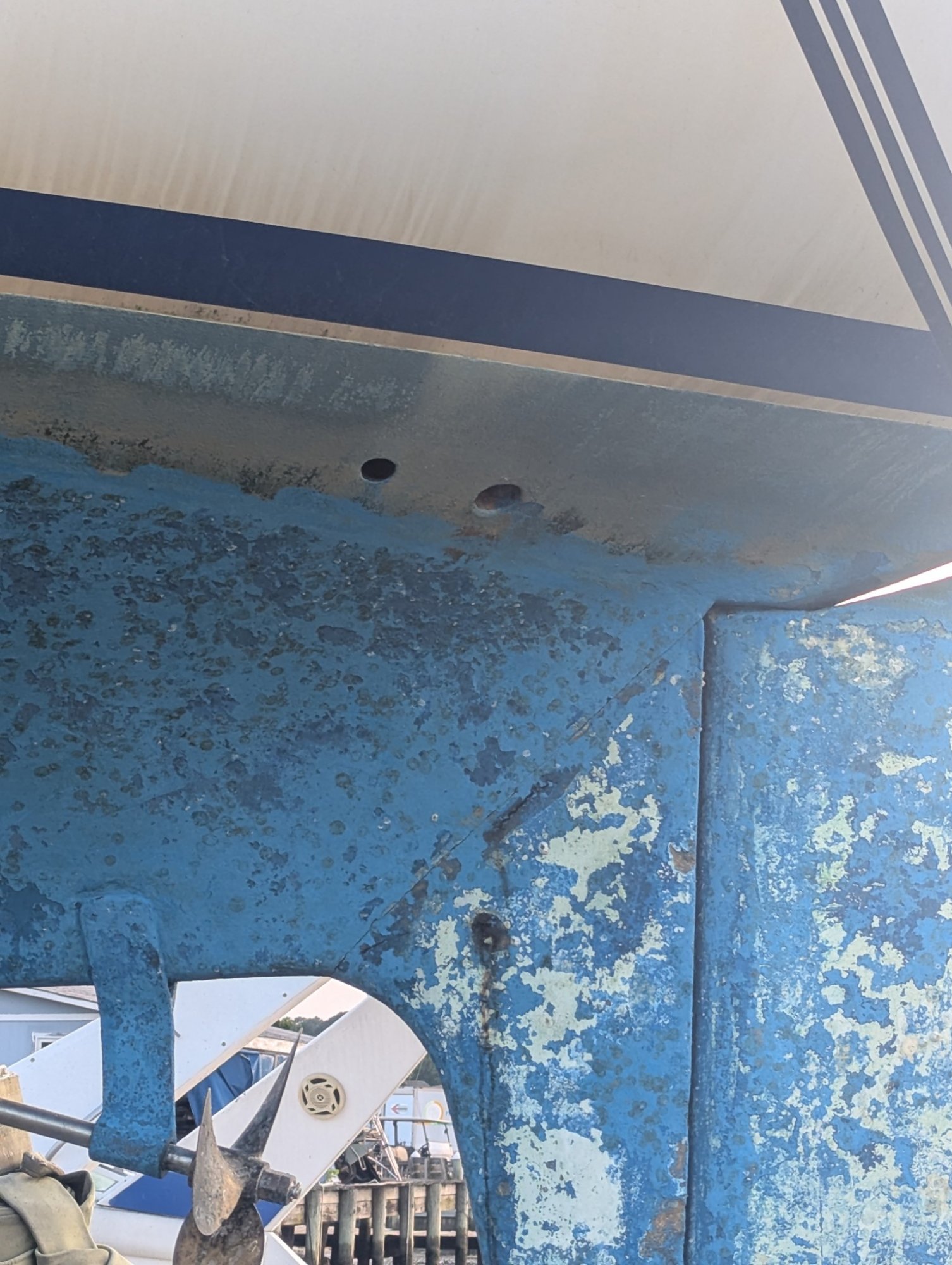

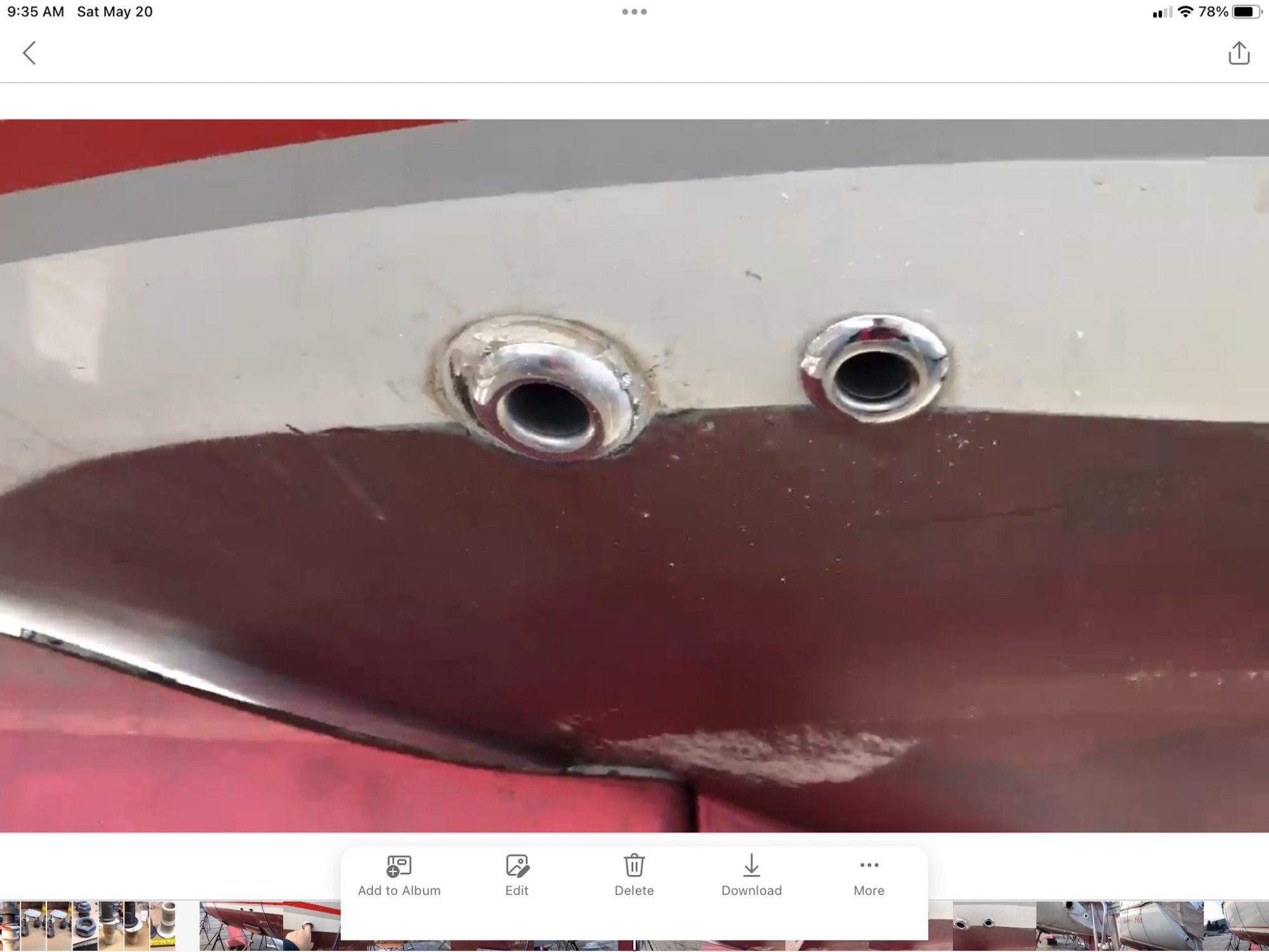

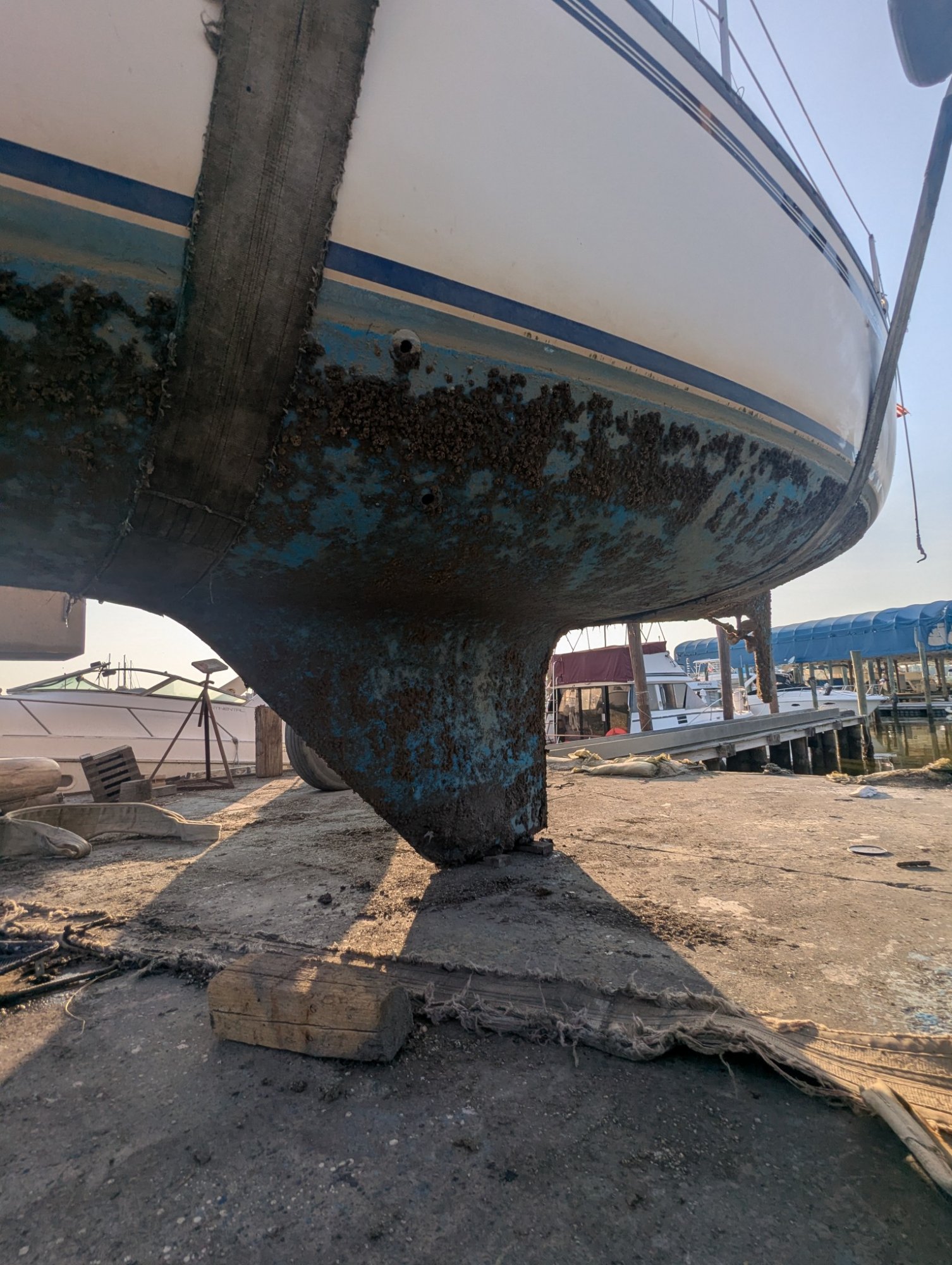

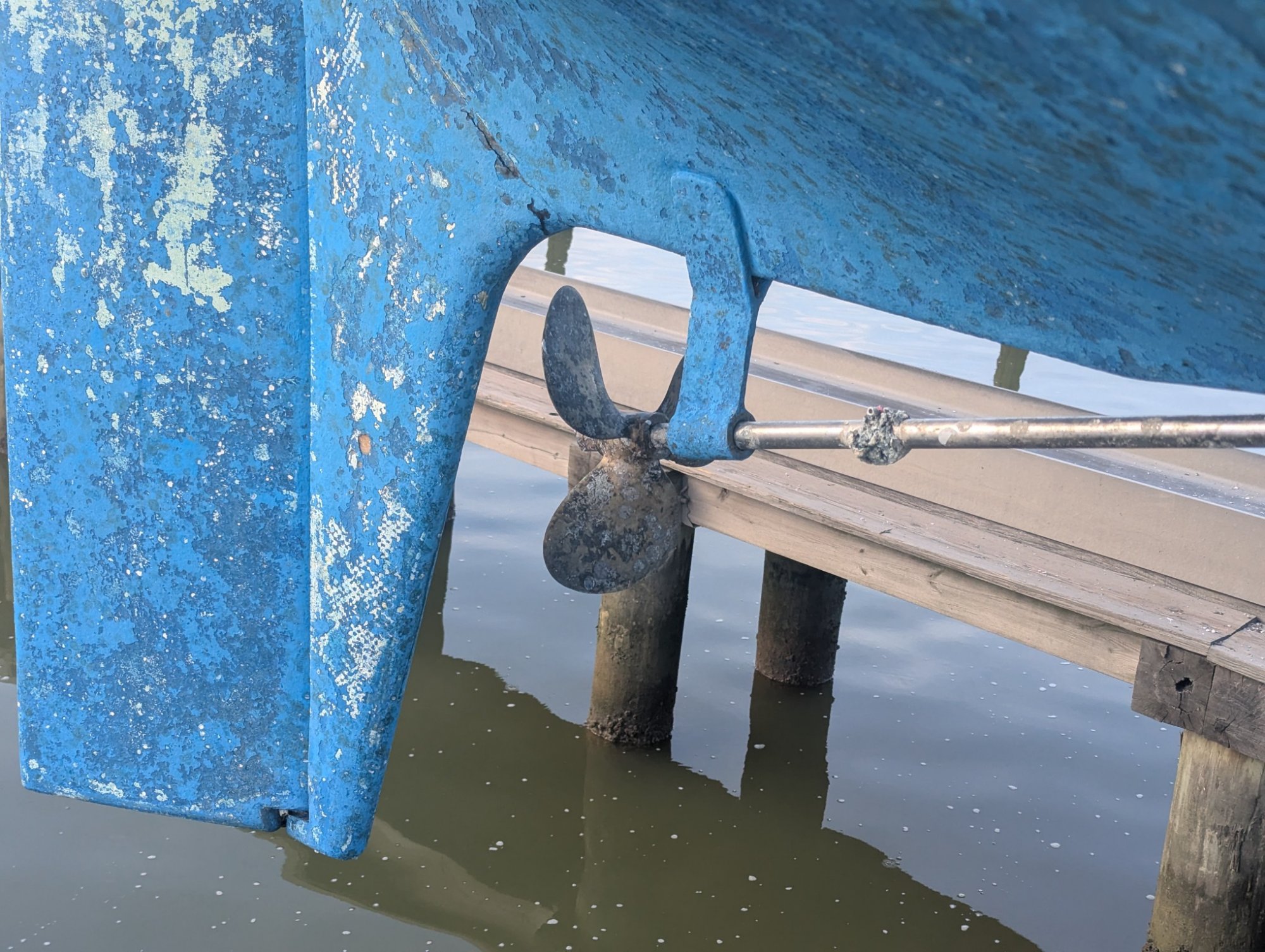

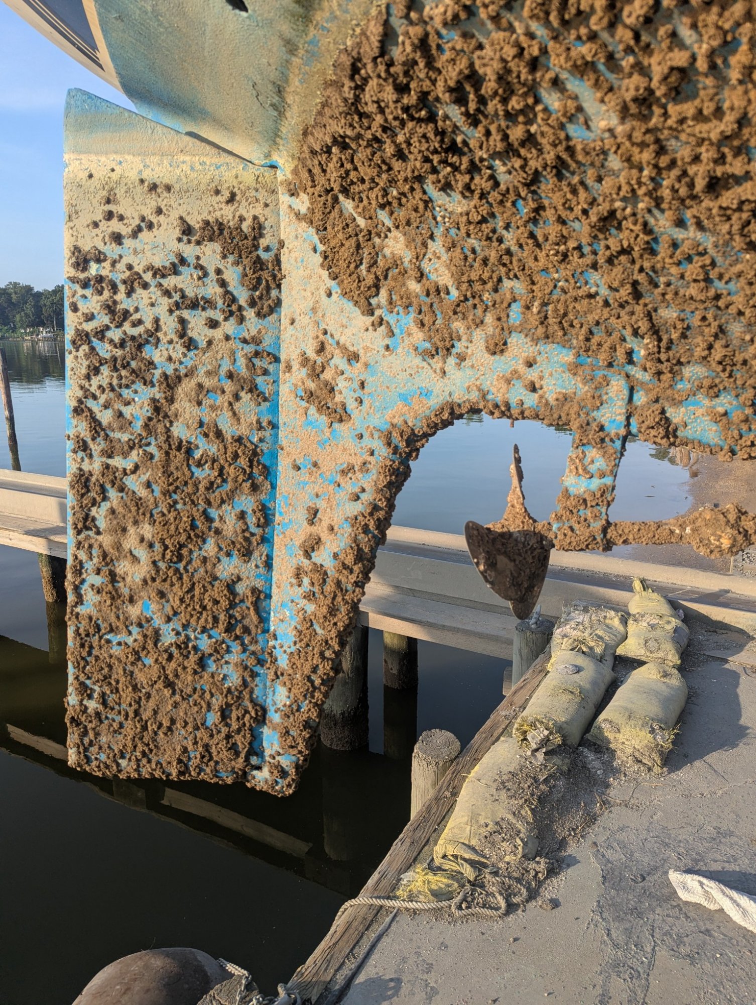

Also, I’ve verified the aft thru hulls are above the waterline, thankfully!
You can see in the attached picture.

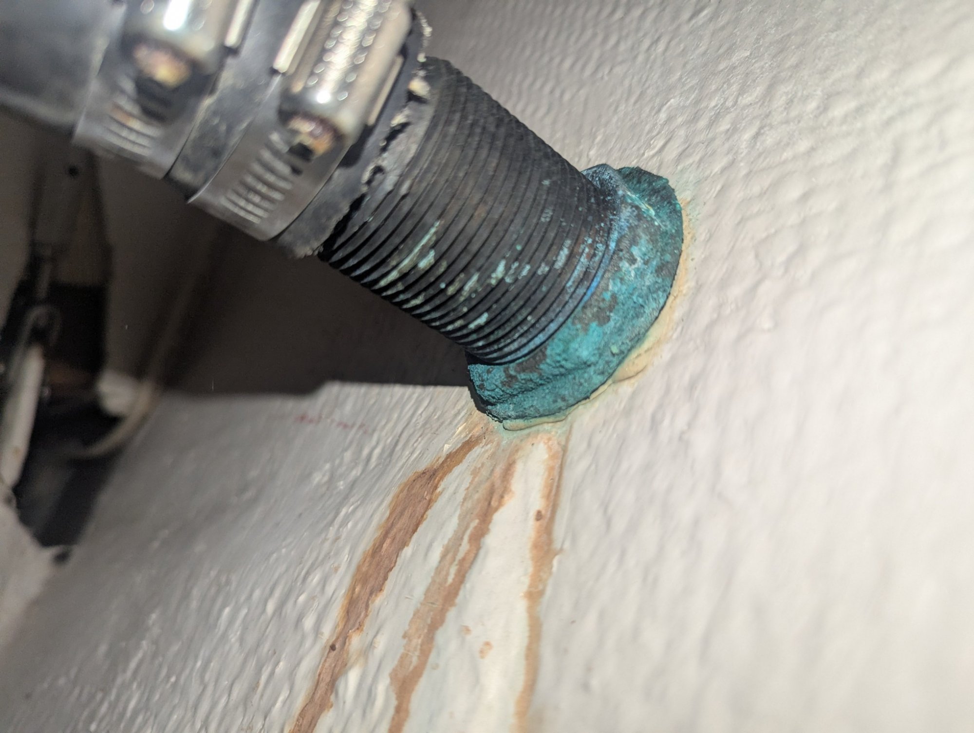

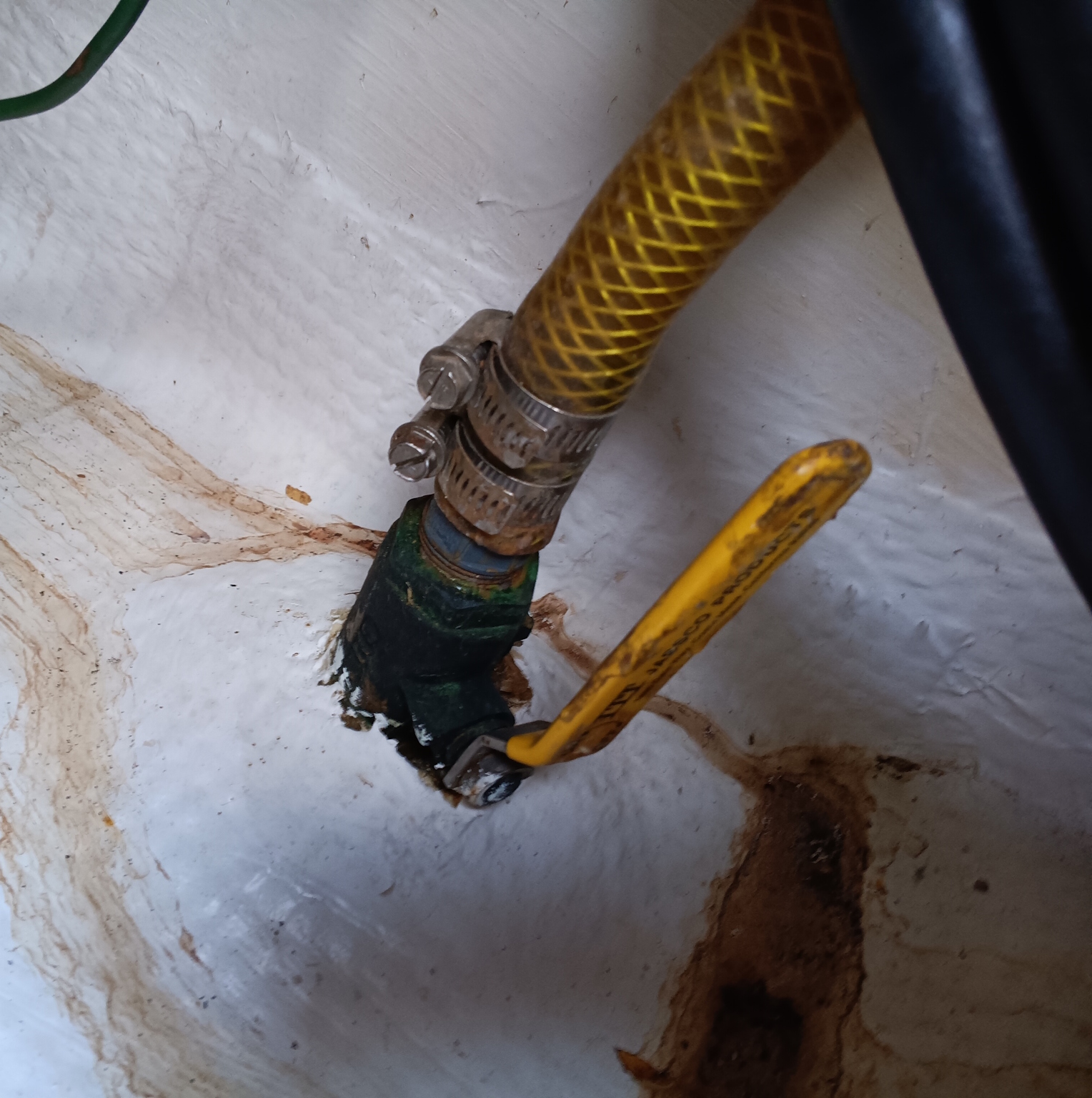

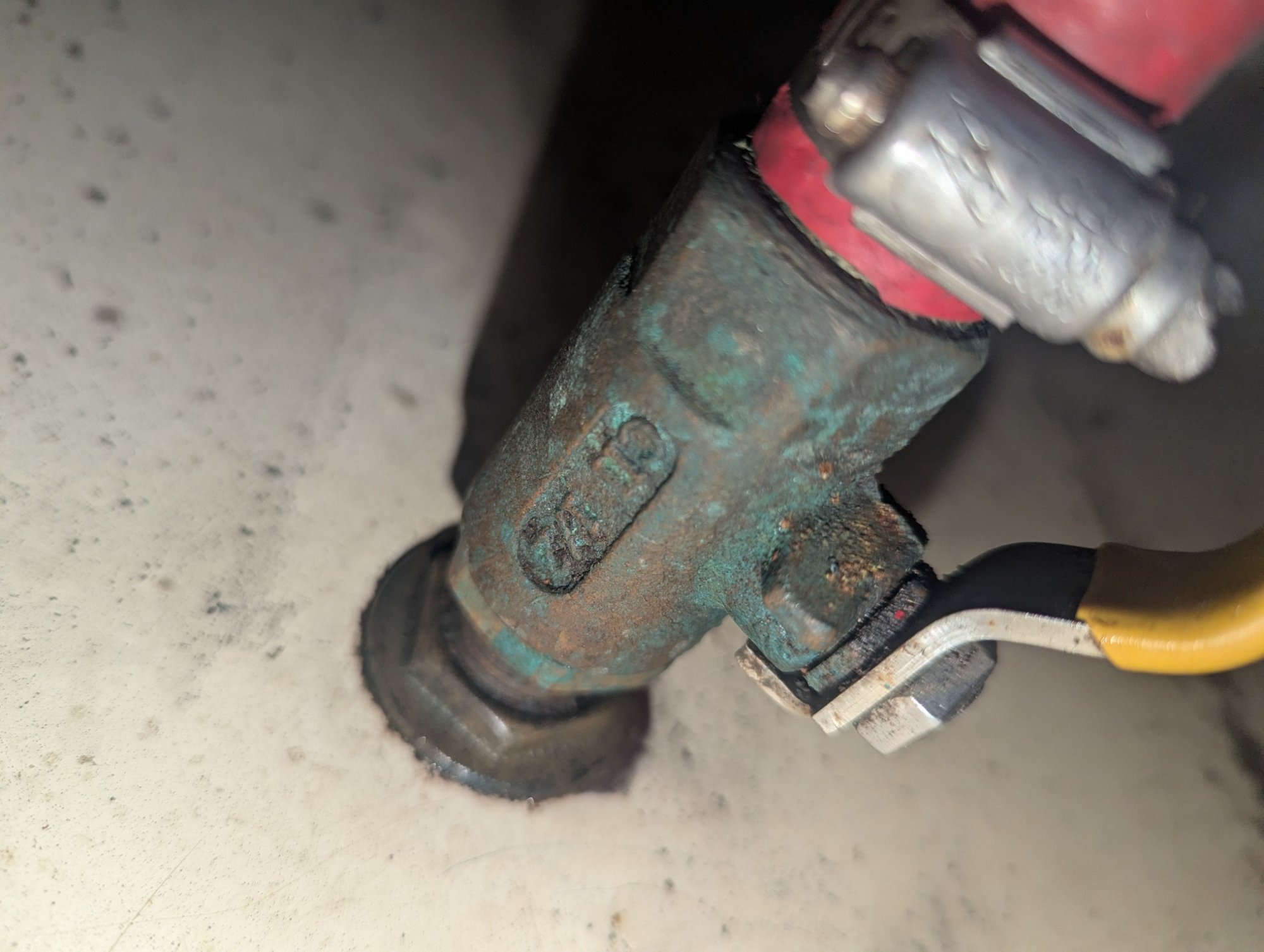

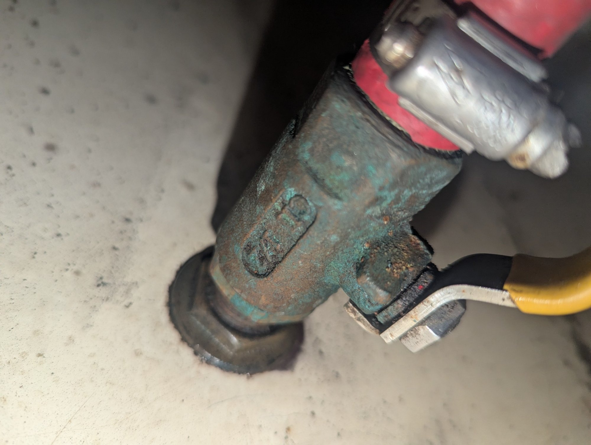

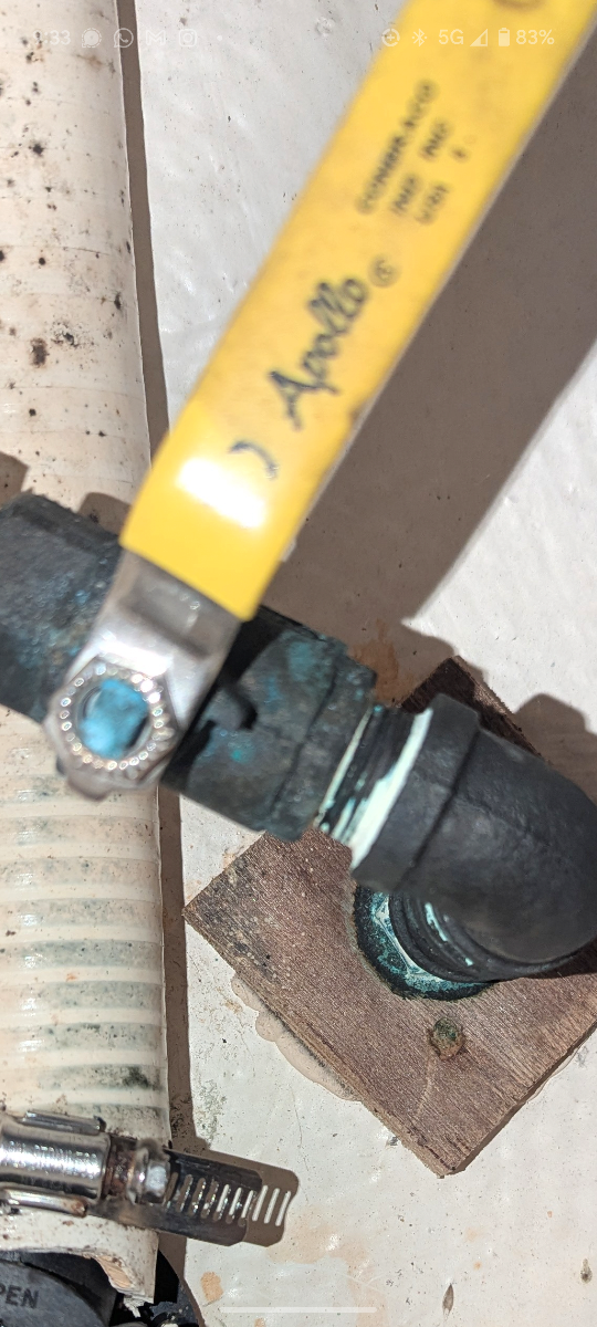

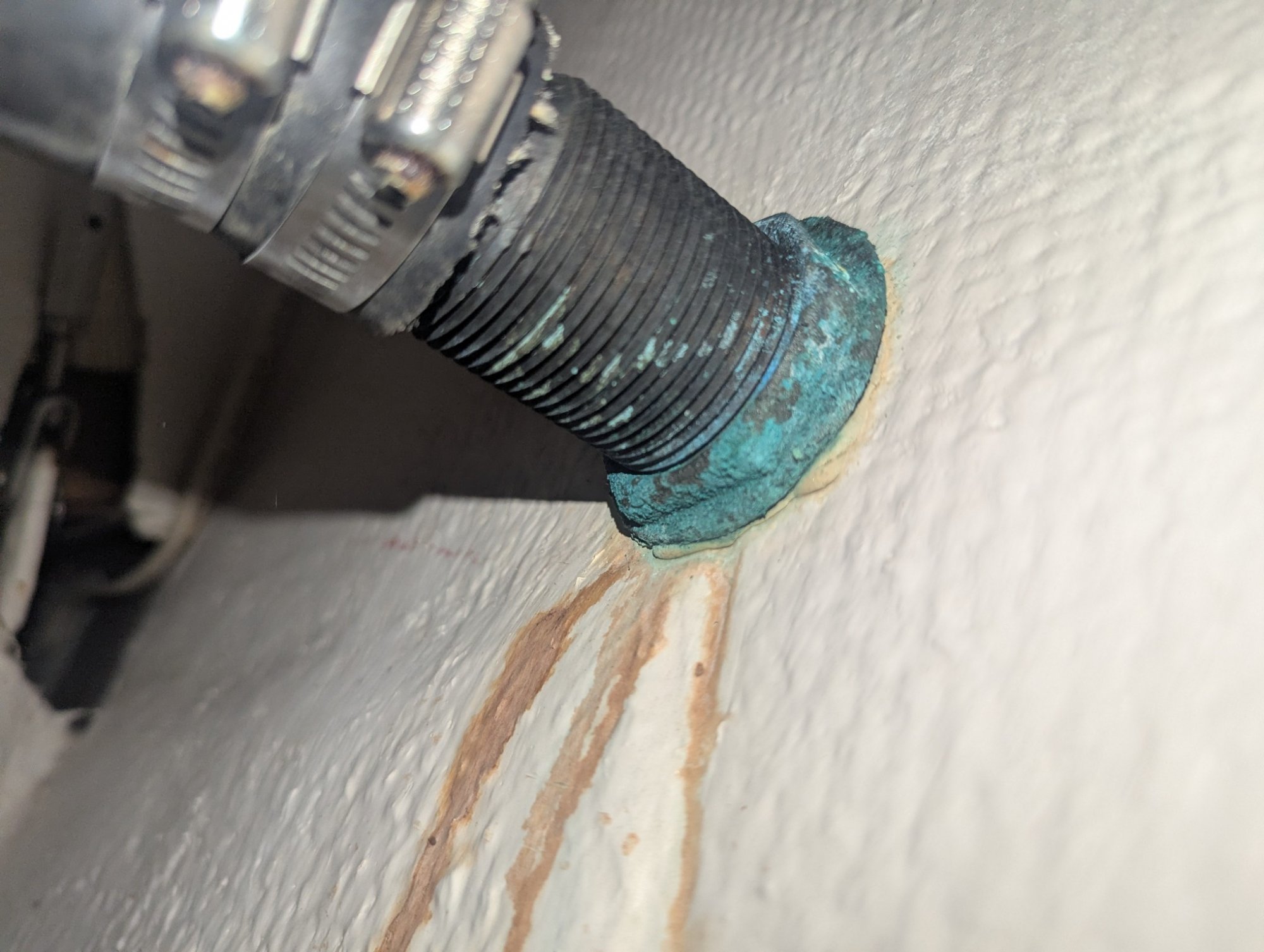

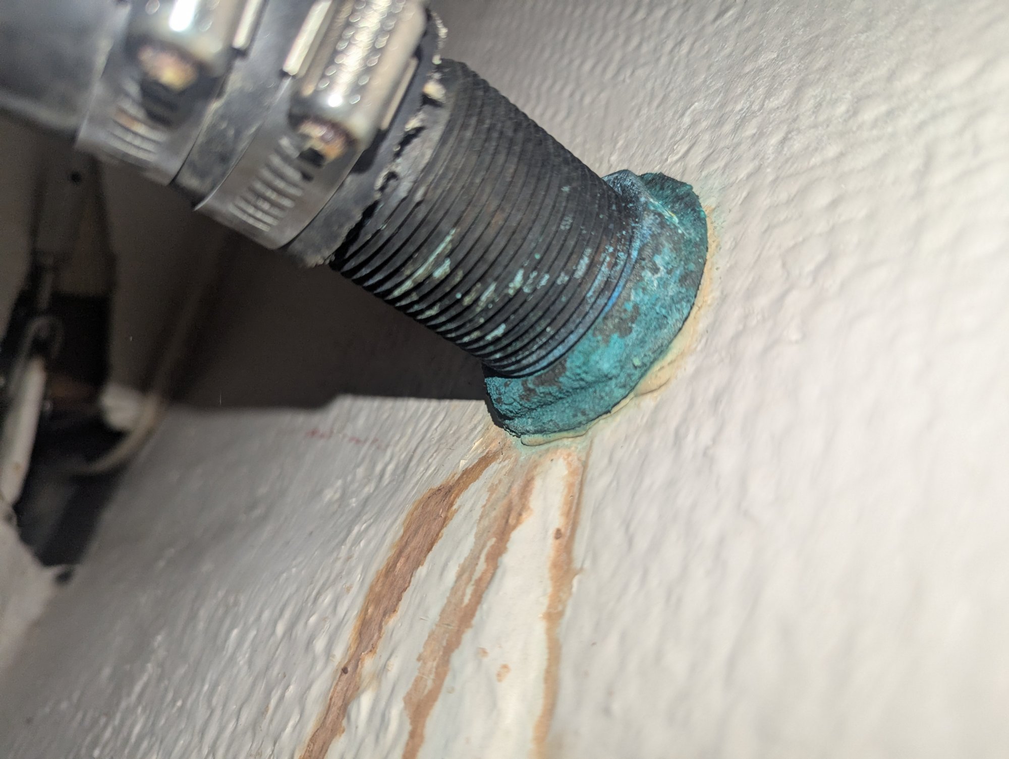

Still wondering if my thru hulls are brass or bronze, or if it's just the fittings.

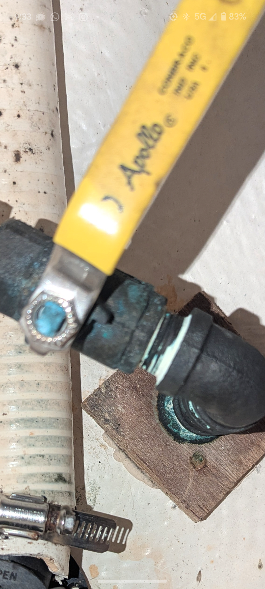

I'm thinking of keeping this fuel intake Seacock as is, because I believe it may be bronze (and it opens and closes like it should unlike the others). It looks so different to the others I posted. Right?

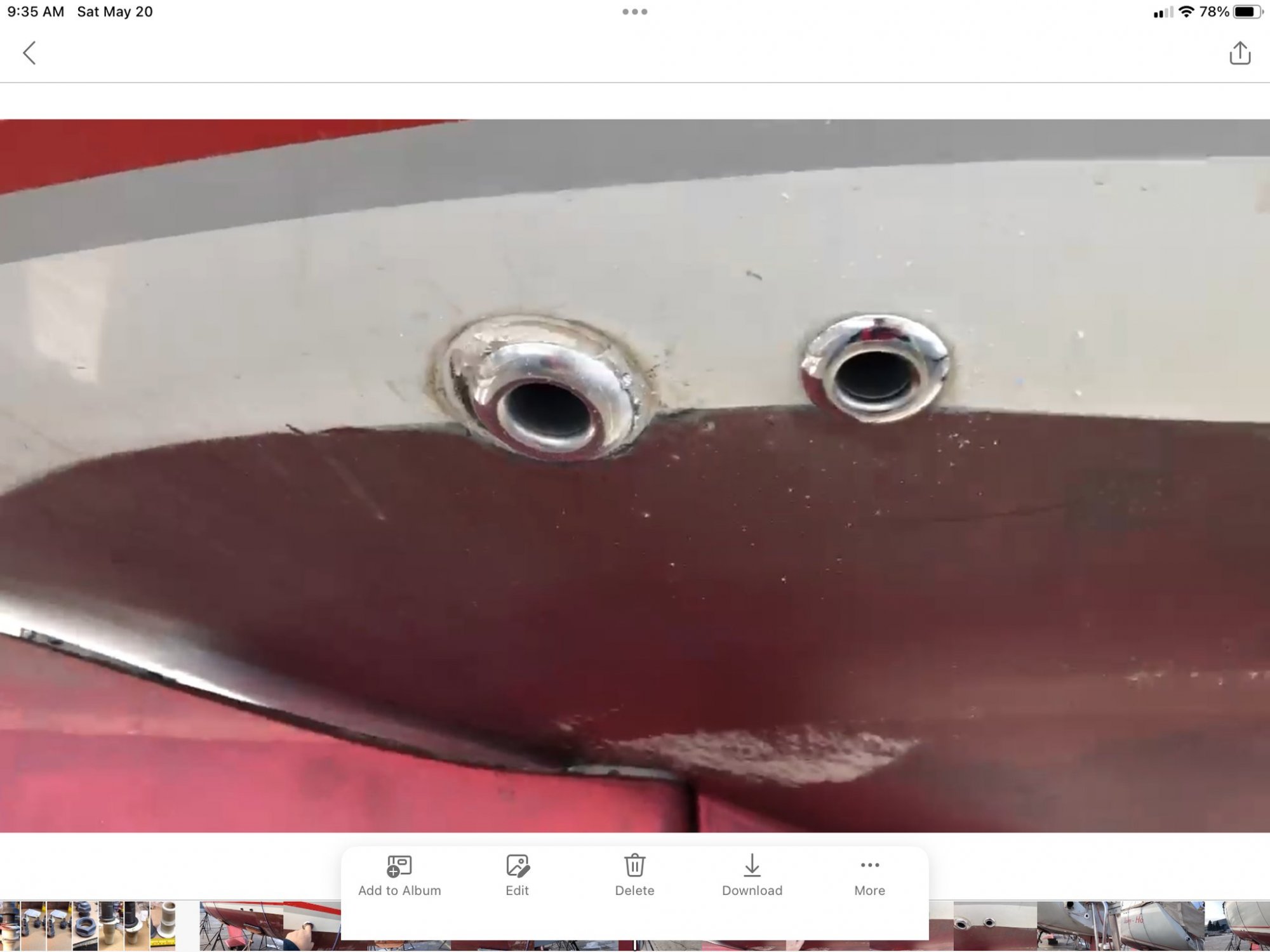

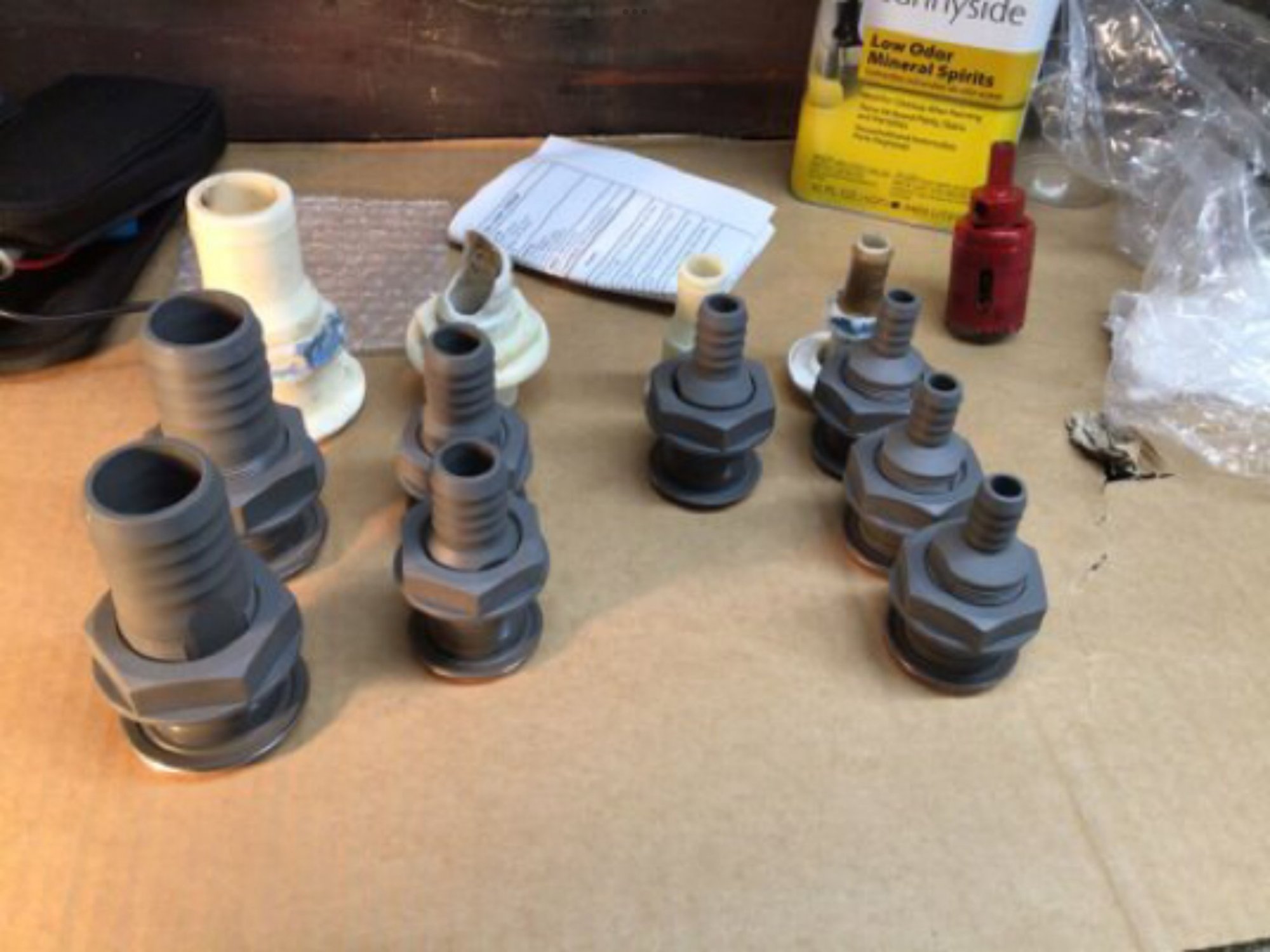

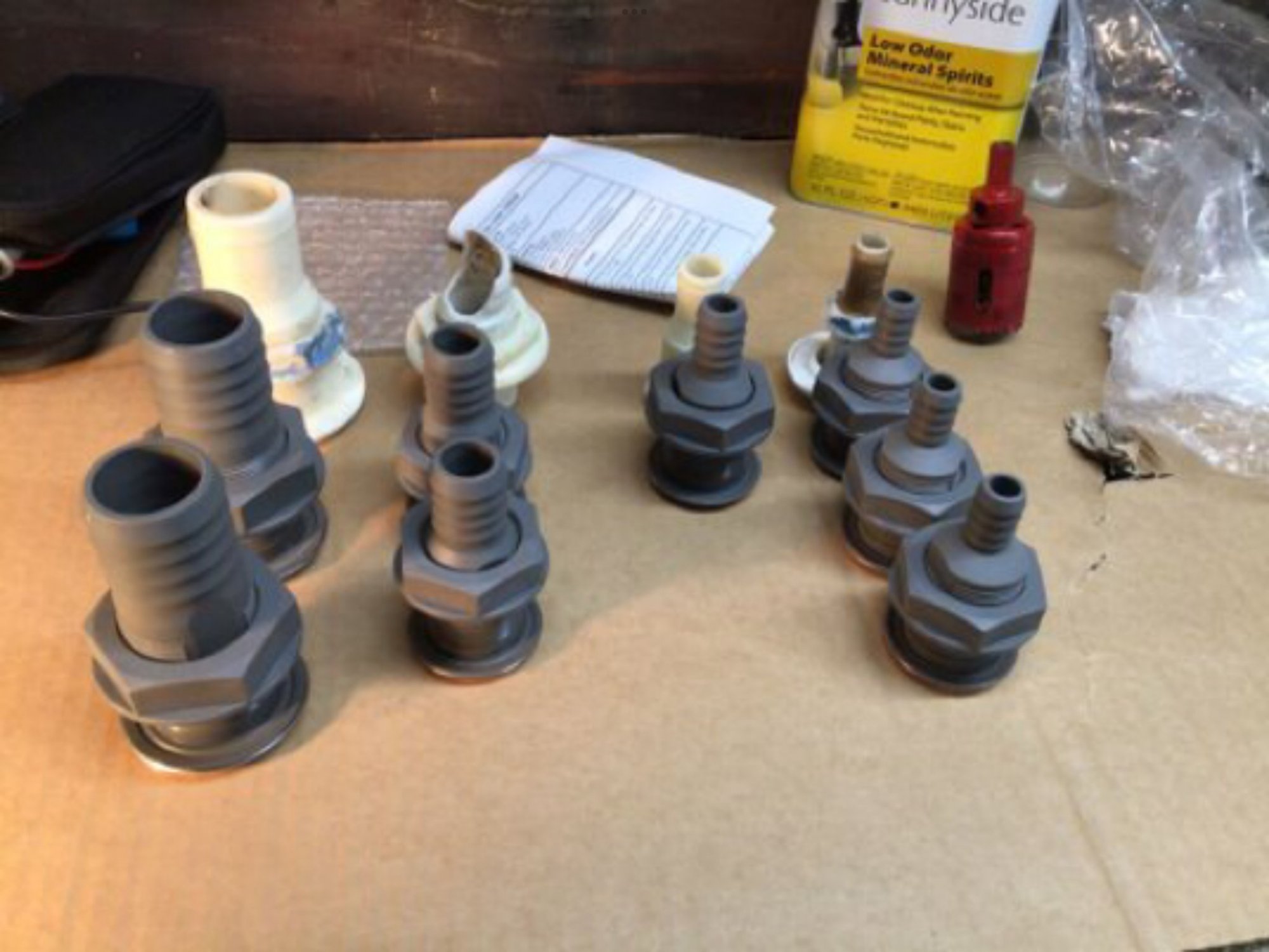

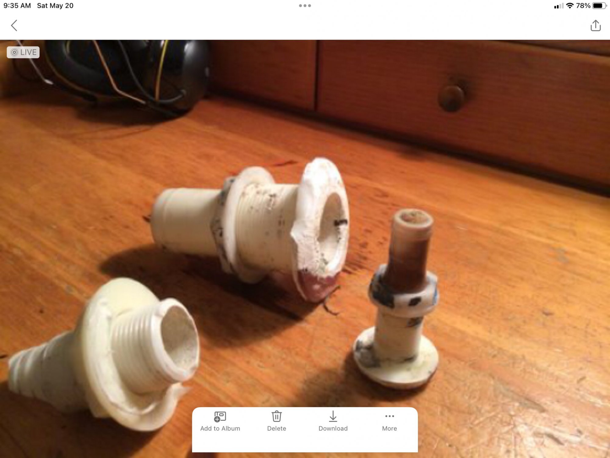

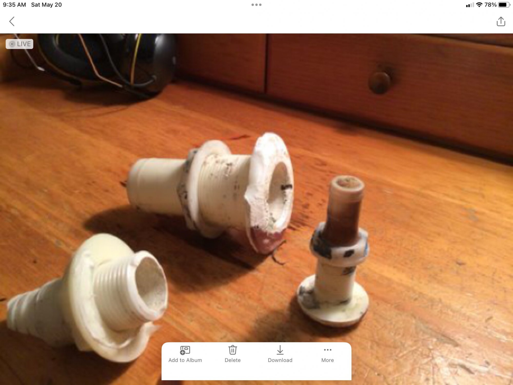

My Hunter 280 had an engine exhaust that exited below the water line. It did not have a valve. As has been stated, exhaust hose is pretty robust, but be sure to inspect it and also the hose clamps annually.
My current boat (O’Day 322) has cockpit scupper drains and propane locker drains that are “technically” above the water line, as well as a head sink drain. But all of these would be under water when sailing (depending on which tack I am on).

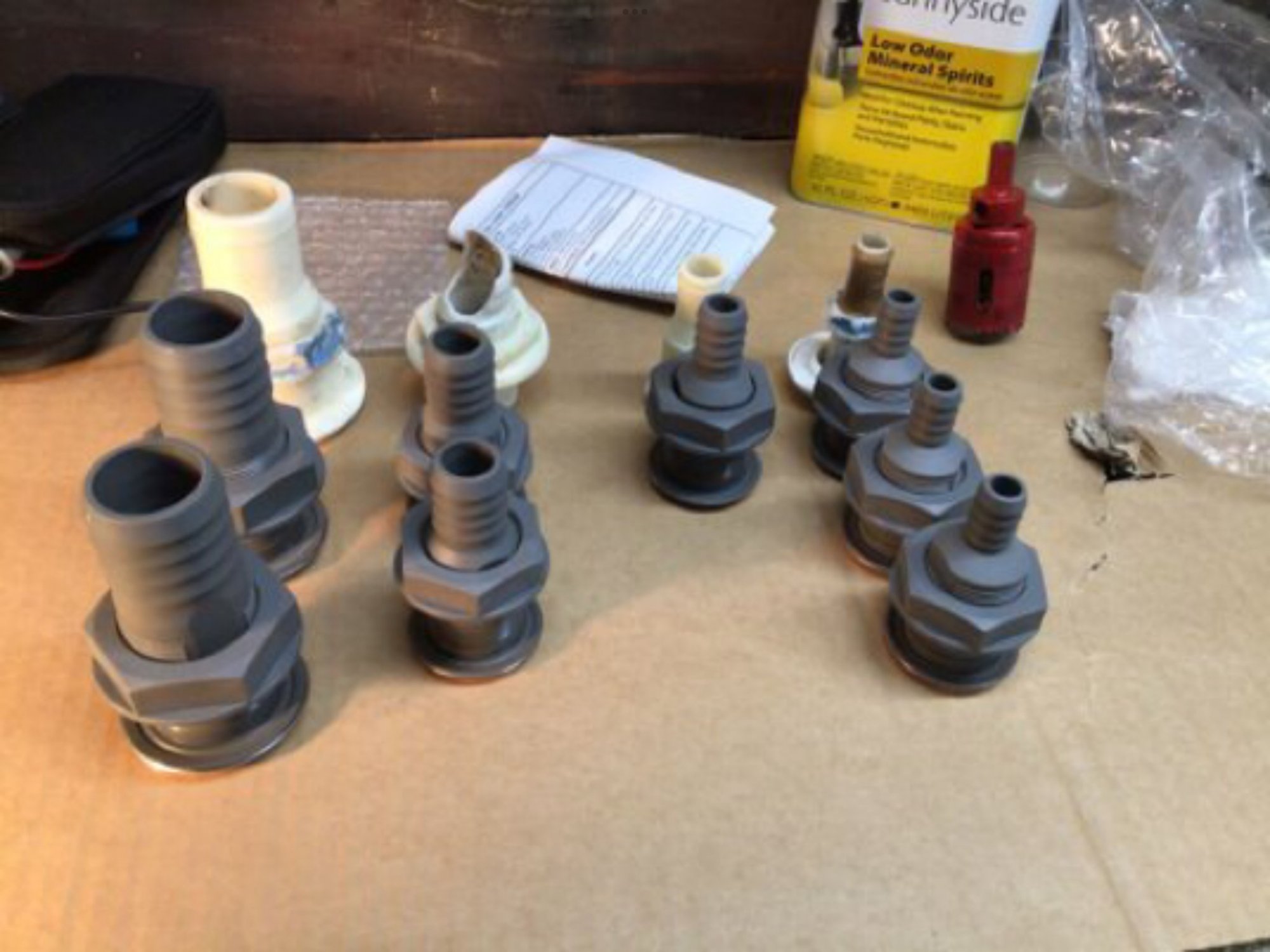

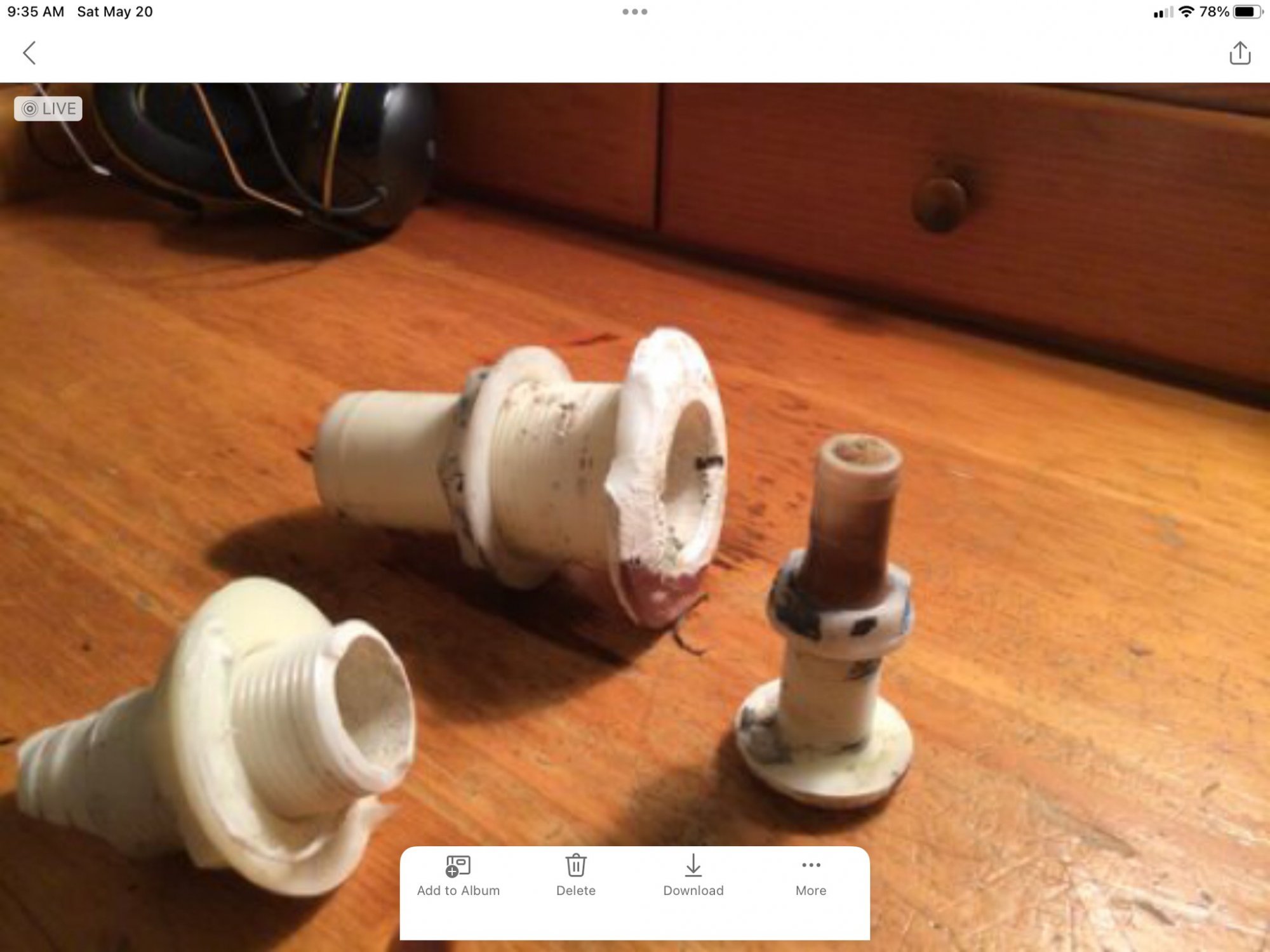

None of these have valves, but I did replace all of the old nylon thruhulls (some were cracked).
1m9YEJ1QRFOJMueJZhRJpg.jpg vDyuzdLcQpSiBlG9EpxMRw.jpg tUnbSEXcTTSTVlk19QlHfw.jpg LgJkfUzfSYCsMb73zOJLSg.jpg
View attachment 232457 View attachment 232459 View attachment 232458 View attachment 232456

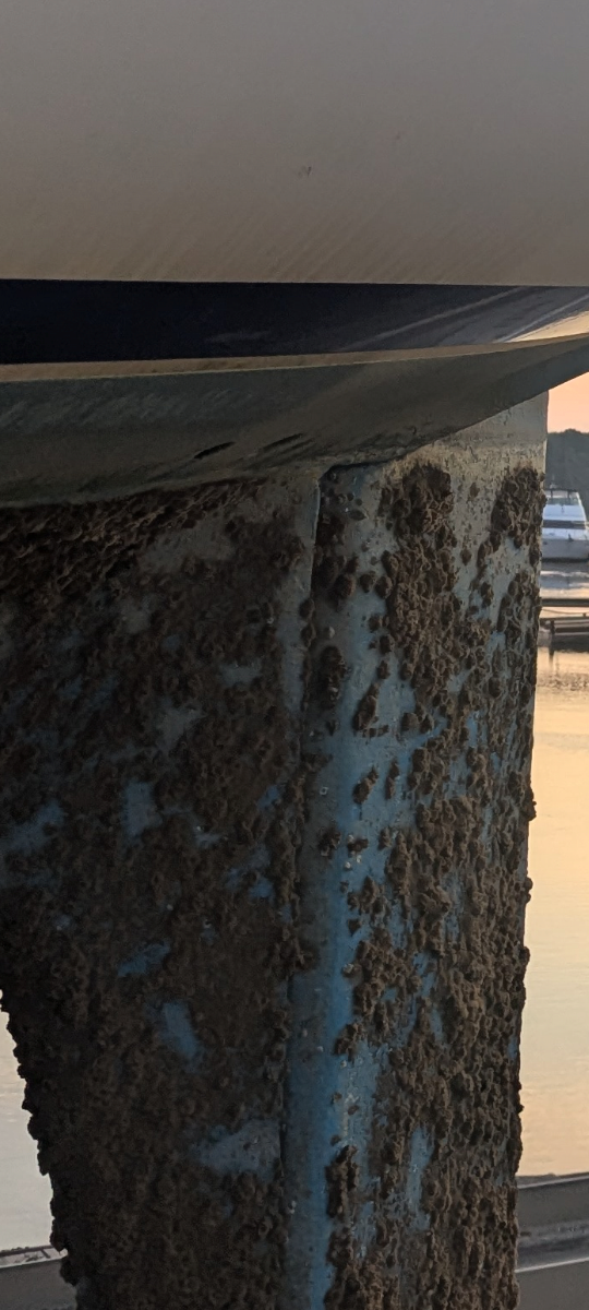

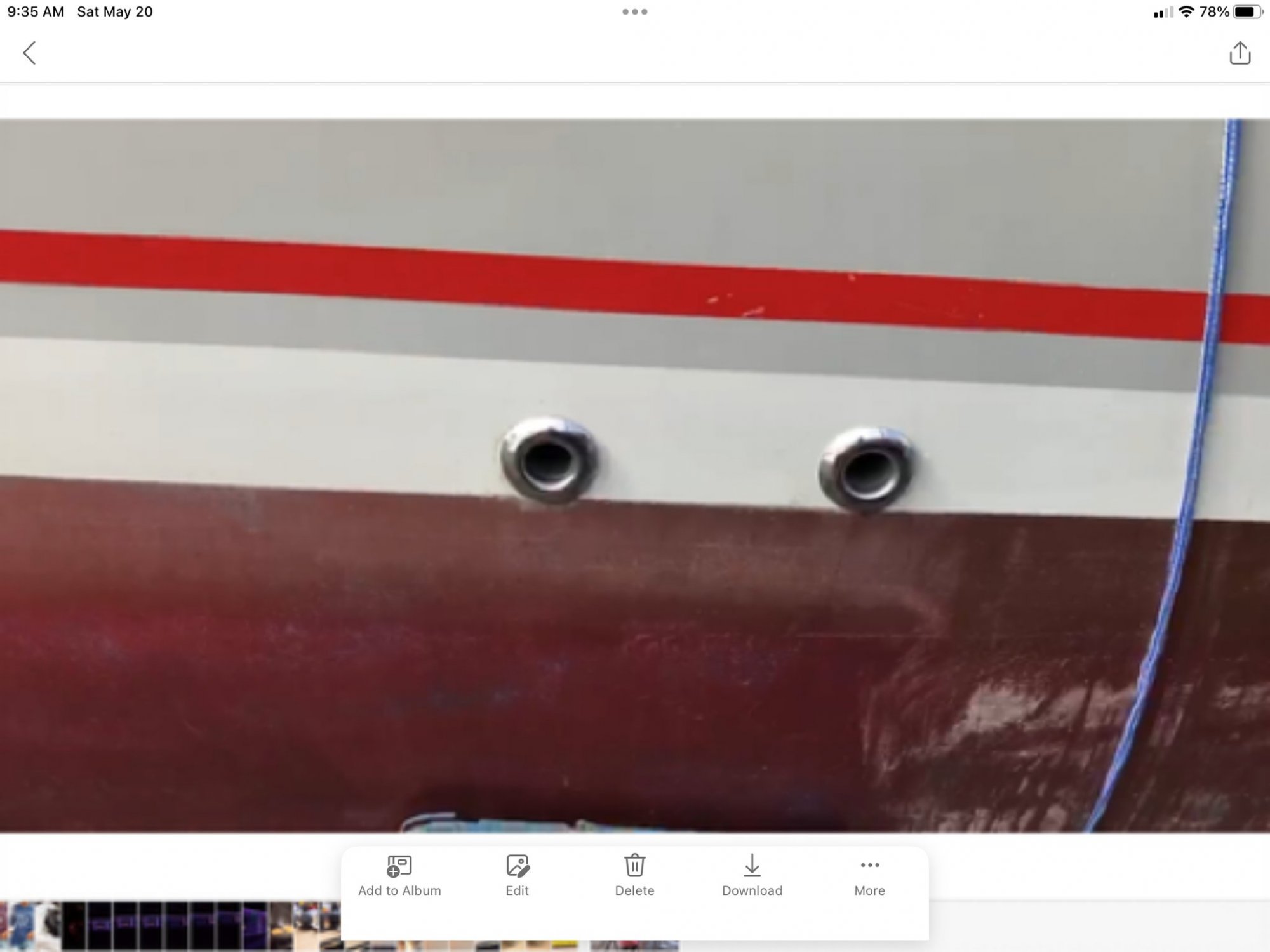

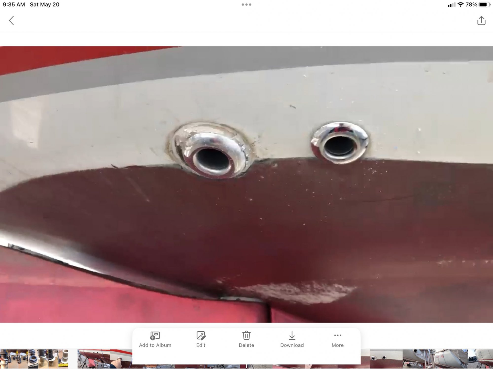

These sit just above the waterline while in the marina. You can see it in the pre-wash photo I’ve attached—right in front of the rudder, just above the grime line. Not by much, but they’re above.

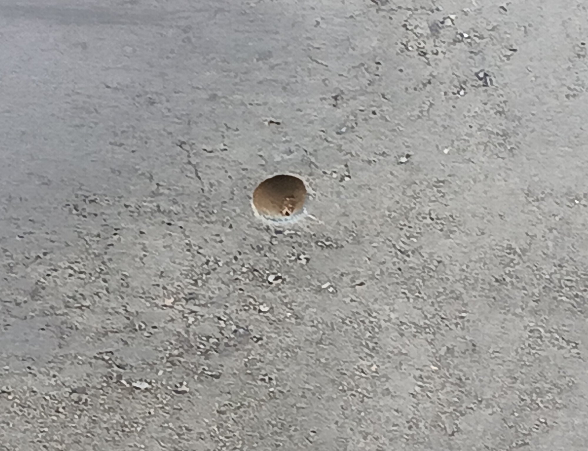

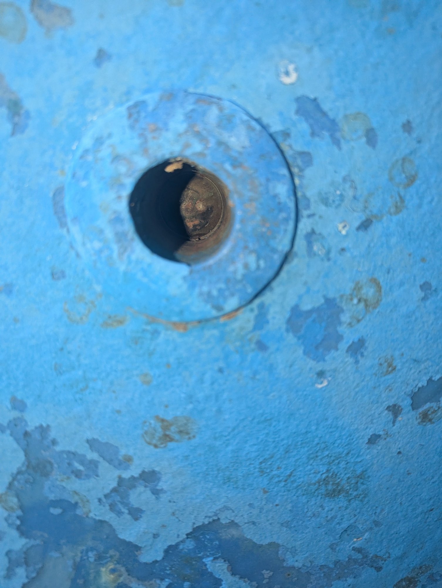

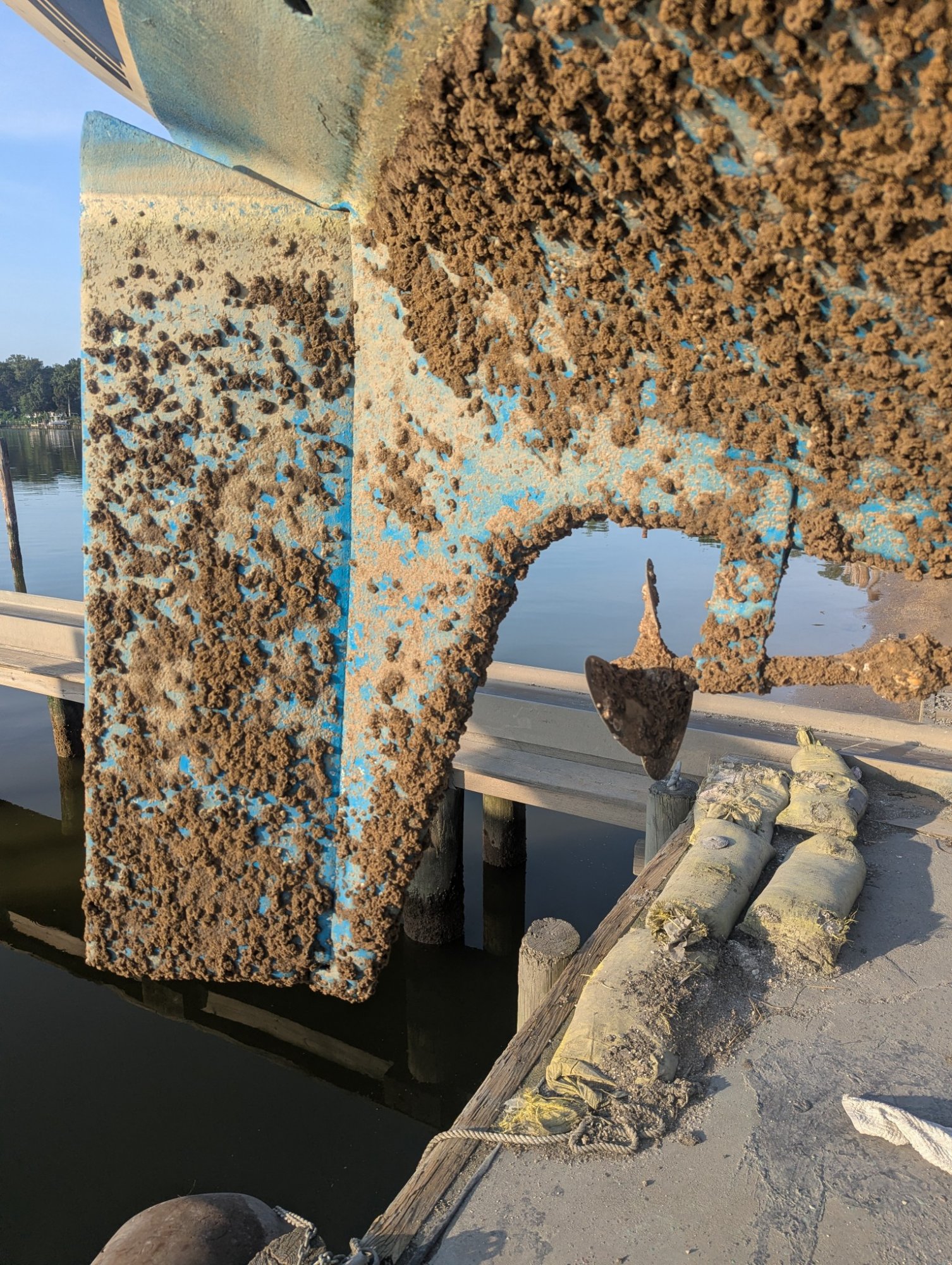

And I found one more!
This is feeling like an Easter egg hunt.
Walk about the bottom of the boat and identify all the holes in the hull.

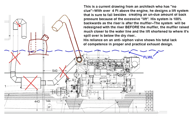

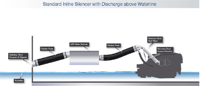

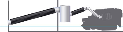

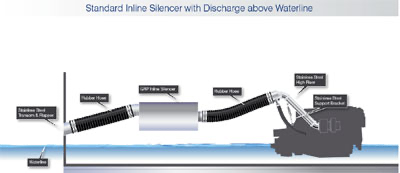

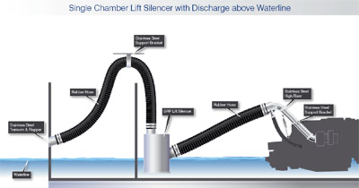

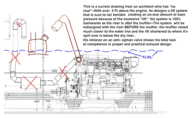

The Exhaust hose is part of an "Engine Exhaust System." You do not want a valve in that system. If you or one of your crew starts the engine without having opened the valve, the engine will malfunction. Please take the time to understand the system.
Here are three typical designs for engine exhaust systems. Note the level of the water line in these systems. Your boat may be different. If it is, it needs a system to address its own design (i.e., the engine sits below the waterline).

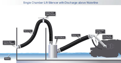

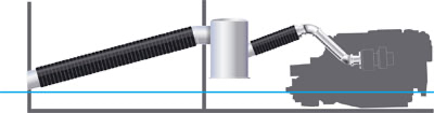

Here is an example of a flawed design and the alterations needed to fix the issues. The level of the water line is a critical factor in the design of the engine exhaust system.
Based on your images, the exhaust port will be just above the water line when the boat sits in calm water. When sailing, the water line will change, and the exhaust port will sometimes be below it. Your internal exhaust hose design must address that issue to prevent a siphon risk.
You stated you are considering replacing the exhaust hose. Double clamps should be used on the exhaust hose. Do not change how the exhaust hose is routed through the boat without carefully considering the design and how it will be affected while the boat is moving in the water.

The exhaust setup matches your diagram almost exactly, and the siphon issue is definitely on my radar. That hose was replaced two years ago with the engine rebuild, so I may leave it alone for now and revisit in a couple years when I know the boat better.

The 90° one with the backing plate looks like decent brass—seems solid.
The engine intake looks like brass as well.
The two larger 1.5" valves seem like bad-quality bronze or maybe even brass—definitely on my list to replace.
The head sink discharge just go straight to hose below water line—no valve at all.

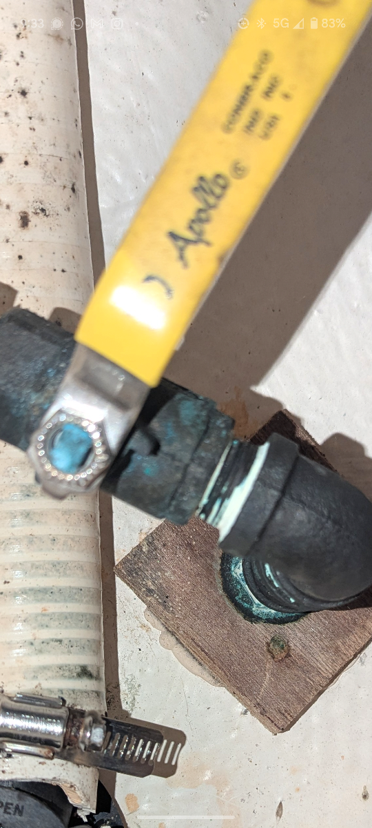

I believe this is the marine head water intake.
I understand the issue of belief, but I'm not sure yet.
It is your boat. You must KNOW!
That means you must get into places your crew, friends, or family will never go. You must trace the hoses and wires to know where they go and what they do.
I understand it is a new boat. Some things may not look correct. I suggest you take your time and validate what and why something is the way it is. No Rush.
Think about the healthy aspects of bending and contorting your body to find your boat's hidden spaces. It is known as Boat Yoga. :biggrin:

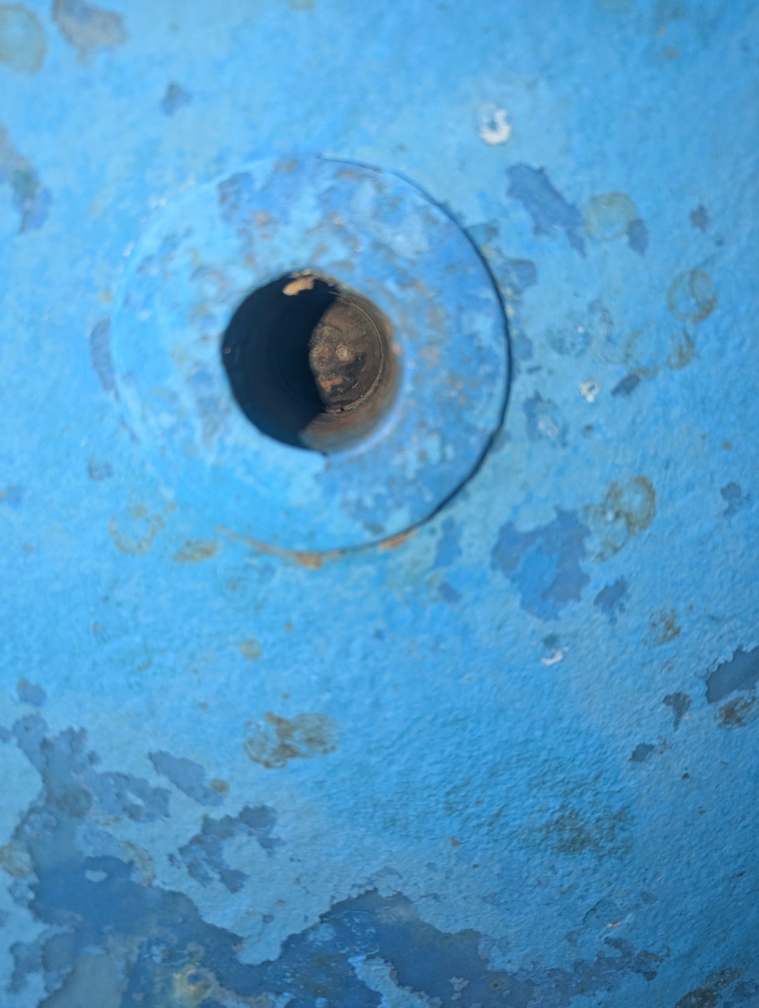

How could I tell is this thru hull fitting is bronze or brass?

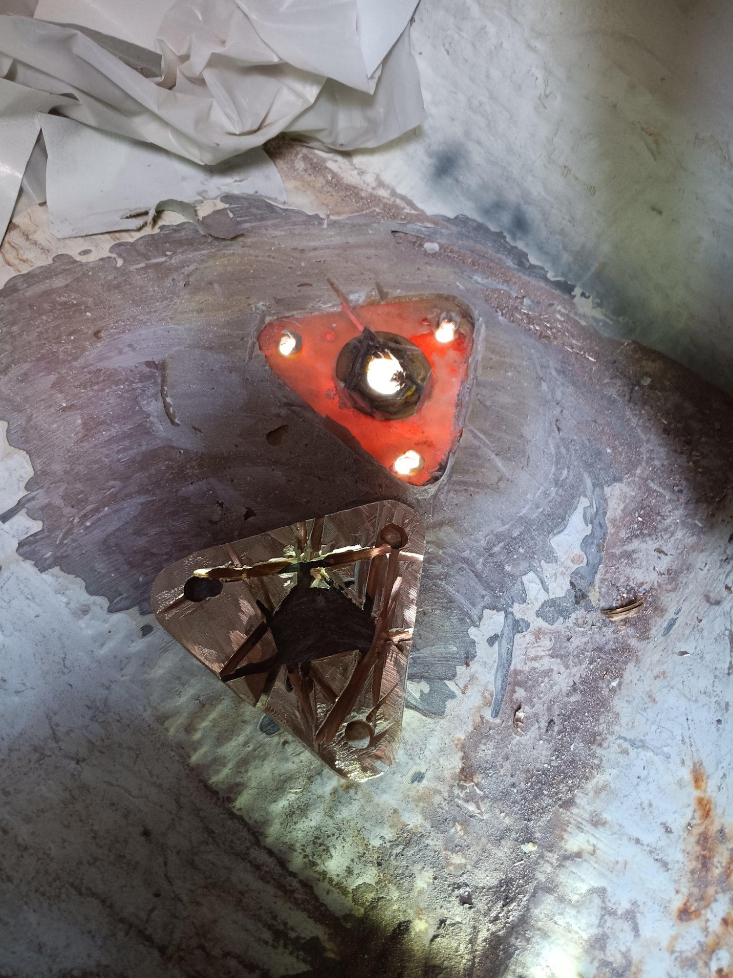

I'm in the process of replacing my first thru-hull. The summary, so far, is here.
The part of your posting that would worry me is this (I cut these pictures down a little in size):
Maybe there's a recessed head on the thru-hull or maybe you have something I ran into:
This was under the static water line so I was glad at least there was a valve there. Yours appear to be just above so that's up to you how you would handle it.

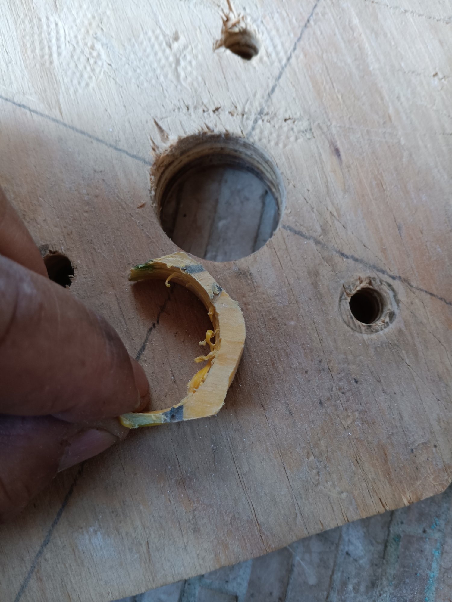

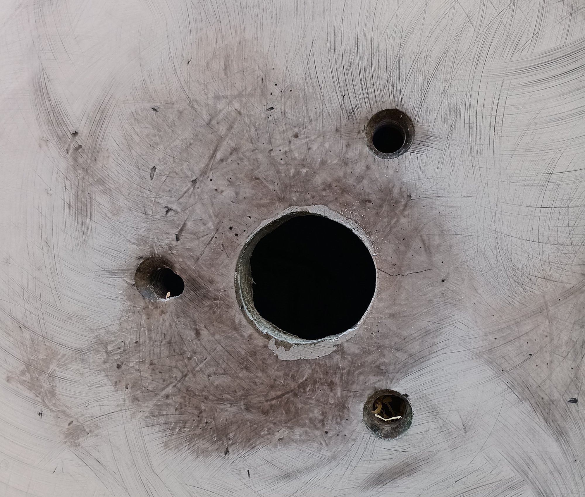

What concerns me is what I found. The flange base for mine was buried in the hull layup. The hull thickness at the flange is only about 3/8 inches versus about a 5/8 or 3/4 inch thick hull for the surrounding area. (Can't really tell because of the grinding I did to get the old one free.) What was worse, there was no thru-hull "head" (mushroom or recessed) there. Instead I found a plastic sleeve embedded in the hull. You can see it as a shadow in the first picture and it was visible once I sanded off the bottom paint. The 2nd picture shows what was left of the sleeve when I finally got it out. The rest was shavings all over the ground.
I'm not an old hand at this but I would be concerned if there wasn't even a bronze or Marelon thru-hull installed underneath those piles of fiberglass/epoxy. What I ended up with, after getting the plastic out, was a big hole 1/4" wider than the thru-hull fitting. A gap I'm going to have to fill in to get a proper seal.
