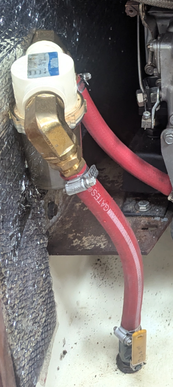

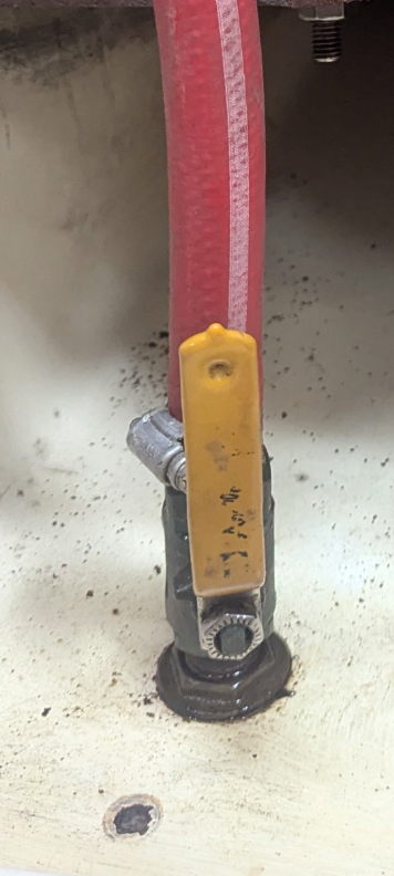

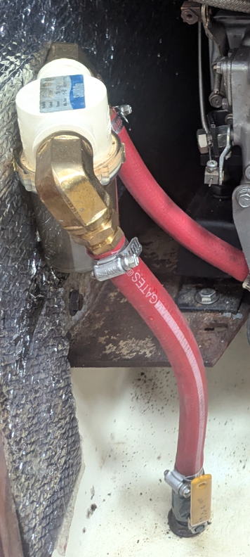

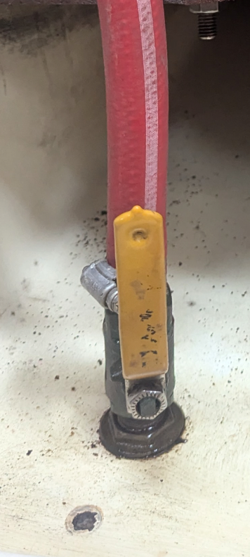

So I’ve confirmed that the "seacocks" on my boat aren’t actual marine-rated seacocks. They’re residential-grade Hammond 8901 brass ball valves threaded onto thru-hulls — totally inappropriate for long-term submersion in a marine environment.
The plan now is to remove them properly — either by unscrewing them from the inside or grinding off the thru-hull mushroom head from the outside.
I’m prepping new backing plates made from ¾" white oak plywood, epoxied and sealed. I’ll be replacing the old fittings with proper Groco bronze inline seacocks, which should drop into the existing hull holes with minimal glass work. I’ll sand and prep the hull, then bed the new fittings with 3M 4200.
This will be done for the three main locations:
Head sink drain
Galley sink drain
Waste discharge (head)
I’m still unsure about the engine intake. That valve operates smoothly and looks like it was installed more recently, possibly during a repower two years ago. However, the labeling is worn off, so I can’t confirm what it is. The yard guy mentioned that he was surprised by how little raw water was coming through, possibly due to undersized hose or partial blockage.
I'll post a few pictures shortly. Curious what others think — especially about evaluating the engine intake and whether low water flow could be due to the valve or hose sizing.

My rational is that I believe the Seacock was replaced when the engine was rebuilt two years ago, but will require further investigation.
How much water should be flowing into the YANMAR 2GM20F? The contractor seems to think there wasn't much.

I chose to match the through-hull, strainer, and hose diameter to the pump intake diameter.
That way, I know there is adequate flow to the pump. There are engineers who will determine the pump's specific demands and calculate the flow constraints from various hose diameters and strainers to arrive at the optimal combination of through-hole size and system.
Jun 21, 2004
3,211
Beneteau 343 Slidell, LA
As a general rule, head discharge, head sink drain, & galley sink should be 1.25 to 1.5“ and water intake lines for engine & head intake should be .75 ”. That strainer shown on the engine intake appears to be quite restrictive. I had a similar one on a marine air conditioner that repeatedly clogged with algae during summer months. Groco has a strainer that is suitable for engine intakes. The idea is for the strainer is to catch blades of grass, sea weed, plastic bags etc….rather large items. Also, be aware that the engine raw water intake should be double clamped at each hose end all the way from the thru hull tailpiece to the raw water pump. You can check out Groco’s catalog for bronze fittings & part numbers & check prices at your favorite marine chandleries.. For the large diameter hoses, Trident or Raritan saniflex hoses are good choices. Don’t be tempted to use clear or braided hose from the big box stores, it is not rated for below water use.
