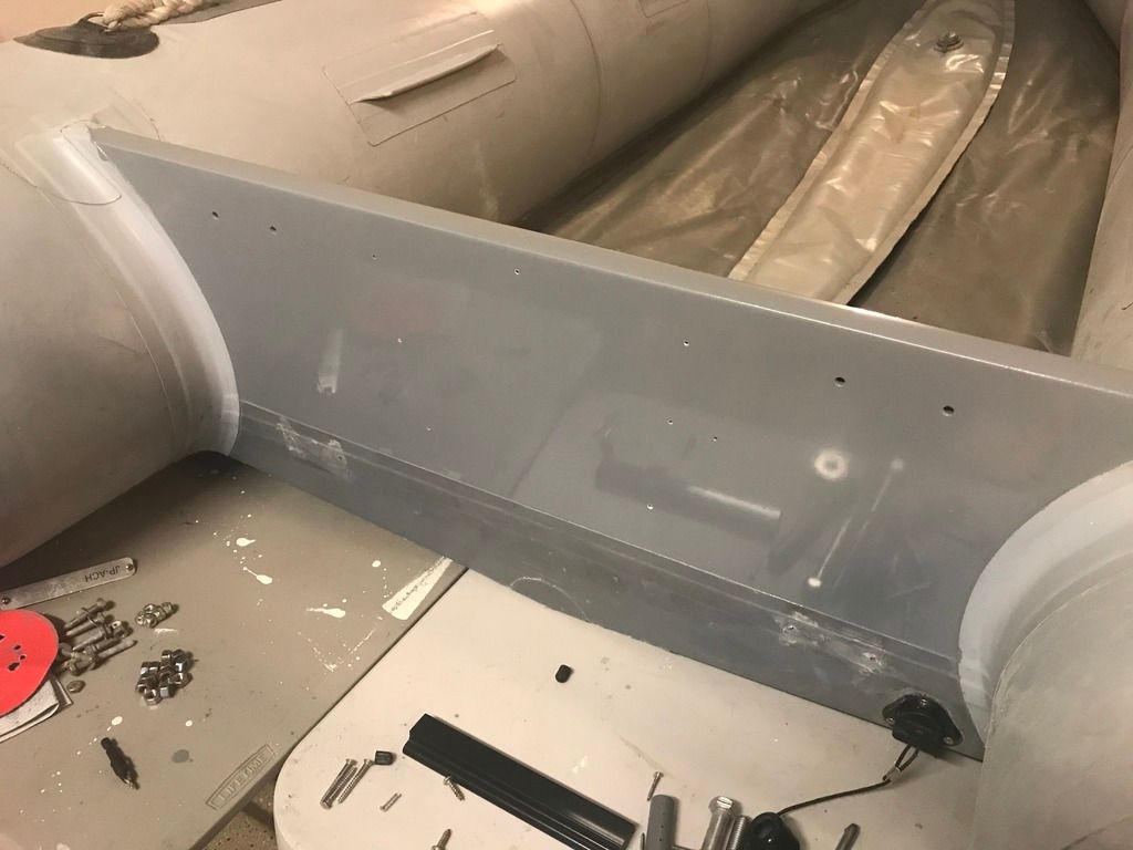

This a Hypalon Achilles inflatable I picked up that came with a Suzuki DF6 standard shaft. The motor was in great condition and I paid less for both than I would have for just the 6hp motor new. The big thing was that the Achilles is an air floor, my other Zodiac is a plywood floor. The Achilles needed some cleaning up and to small pinhole patches. The transom wasn't horrible but there were too many holes not properly bedded so I removed all the hardware and sanded down. Filled all holes with epoxy and re-drilled, epoxy sealed, sanded again, then barrier coat with Interlux Interprotect 2000 (doing my kick-up rudder at the same time to use up a 1 quart kit). I painted the transom and the detachable seat with the leftover grey bright sides. Now I just have to re-install the transom hardware with 3M 4000 caulk for bedding of the hardware. She'll be seaworthy soon.

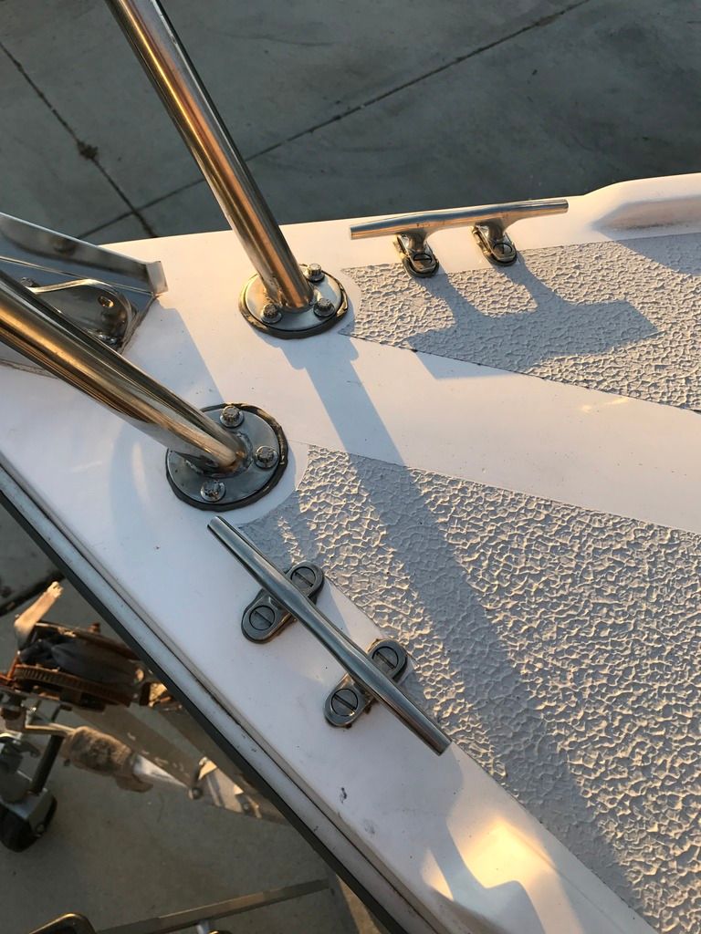

This is from several weeks ago, but I finally got the bow pulpit bedded and bolted back down. I have since trimmed off the oozing butyl tape after I let it squeeze out over several days.
