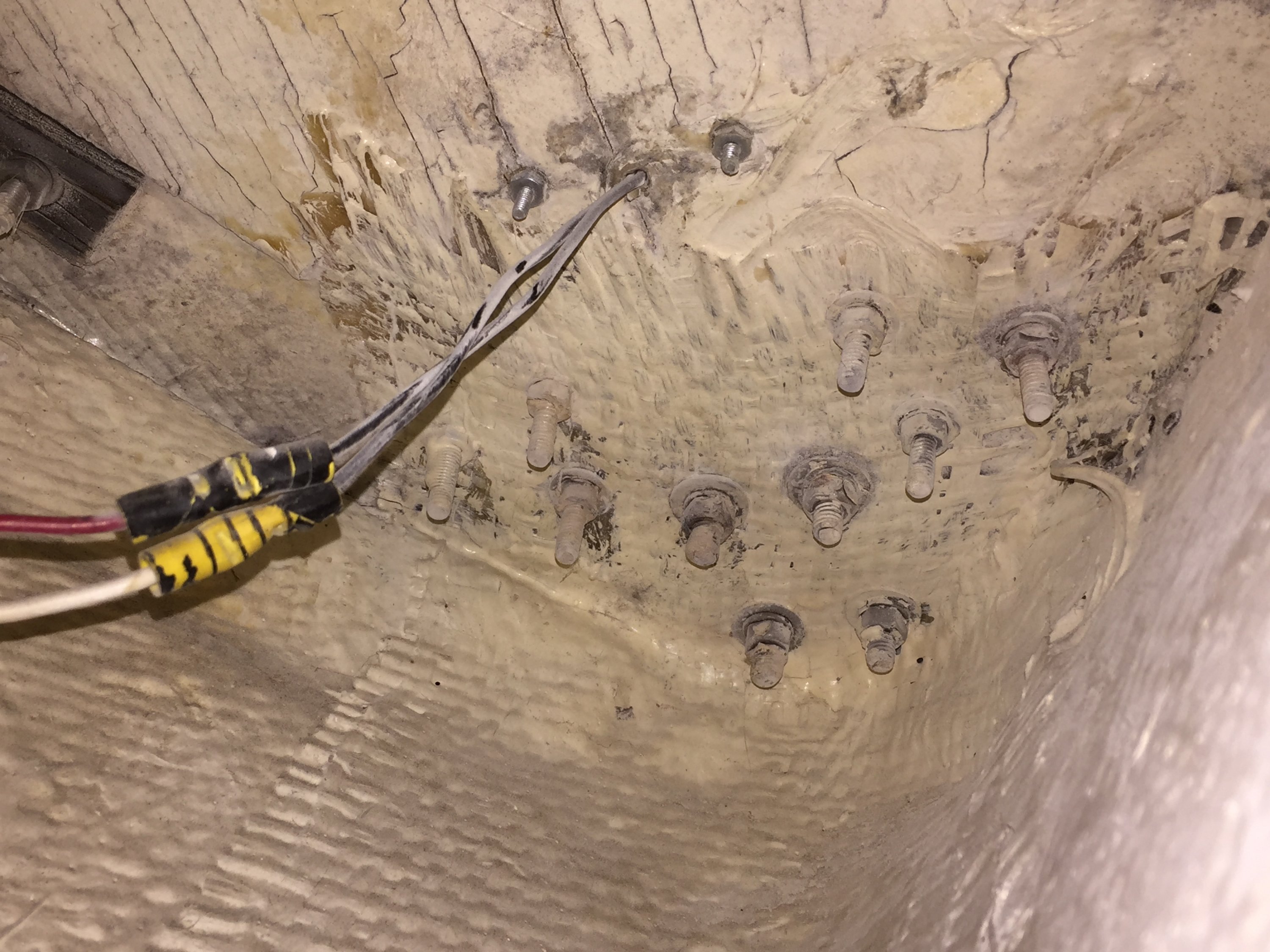

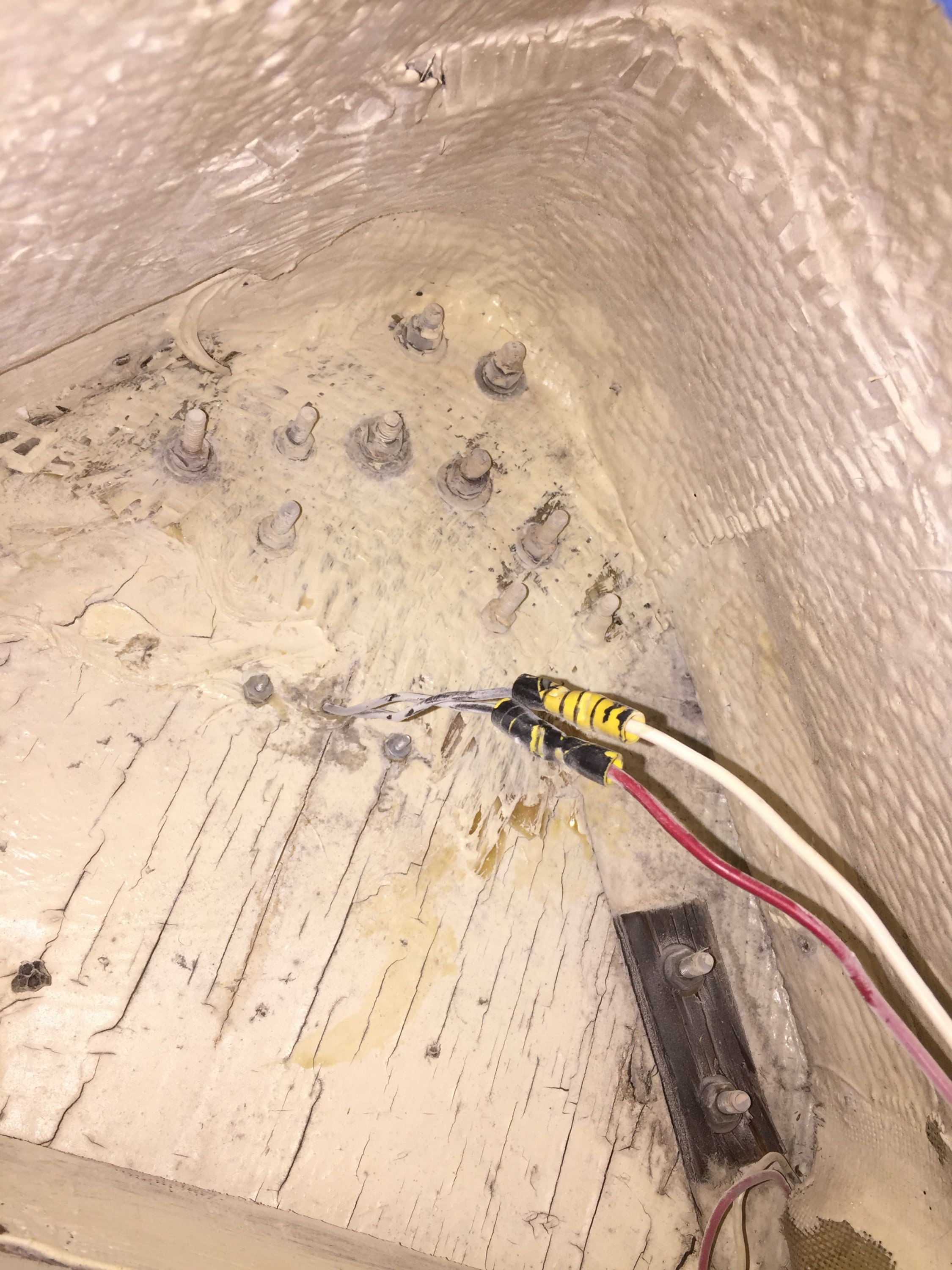

Hey Luke-- do I recall correctly that when you upgraded your forestay fittings that you Added a layer of ply to the underside of the forepeak as opposed to digging out the original ply from underneath and replacing with new? Strategizing about what's next for mine:
Yes, I used the new stye fitting from CD that has a tang going down the bow and I also added two layers of thin plywood to the inside with epoxy.
Yours looks pretty nasty, but that might just be flaky paint. It would be up to you on how you approach this after you clean that up and determine what you have left to work with. The plywood that was present in my forepeak wasn't rotted, so after a good sanding I just added layers to it. Realistically, if you have enough scrap fiberglass and epoxy you could easily laminate in several layer and it would be just as strong.

Many thanks —. Yep , eerily reminiscent of the checked / compromises ply I pulled out of the companionway step. Should be fun as usual :)
