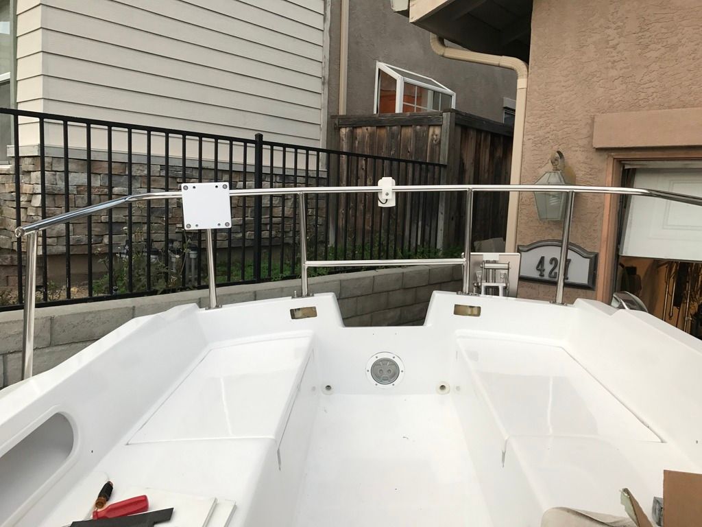

Stern Rail is finally polished and back on the boat, bedded with @Maine Sail 's Bed-It Butyl Tape. Before I went through all this hassle I used an inline fuse on gator clips with a battery to make sure the wires were good, didn't melt this time with the insulation sleeve inside. Stern Light and Dinghy Motor Mount all good to go. The Bow Pulpit should be much easier to mount, but I have yet to polish it.

Magnificent work. Looks like you could tow a barge from that rail!
You probably already answered this, but are you planning to incorporate a swim ladder?

gorgeous-- are you going with a traveler on the rail or are you going all in with a Barney Post?

At this pint I could still go Barney post if I wanted to, buy I already have the track and traveler car to put it on that horizontal rail that I added. Pros and Cons to both; I really tried to set the boat up for potential racing, but the barney post adds more holes in the deck and toe stub hazard. The back rail, the idea was to 'update' to post 86 traveler set-up, but still need to reach behind you to adjust the main sheet. I'm not installing the traveler or the non-skid in the cock-pit until pretty much dead last, so I have time to ponder.

I keep looking at the various options for Harken traveler tracks and thinking I'm going to drill the rail to fit one of their tracks and cars. Curious what they used stock on your later version ( I assume you are post '85 ? )

My boat is an 82, but the position of the traveler I am going for is the post 85 set up. I used the X bar traveler track and car from CD. Much less expensive than Harken plus (I think, but have to check) the length of the traveler is less than 24 inches, so any stock item you buy is usually 24 and you need to cut it. I hate having to cut aluminum track when it is anodized, especially black. Really no big harm doing that, but it just irks me to ruin the finish on the end. If you buy Ronstan track they come with plastic isolators for the bolt heads so they don't touch the aluminum and I believe you can buy packs of 10 separately. For your boat, without having to add the extra SS bars to the stern rail like I did, I would go with a Barney Post or use mid boom sheeting. Adding an X track or raised T track to the original traveler doesn't do much and is way more difficult. The bar is solid and only 1/2 inch in diameter. The X tracks are designed to nest onto 1 inch diameter tube. I would suggest researching different types of Mainsheet traveler set ups and see if you can build something that suits your needs without having to do a super complex set up. Keep in mind, any traveler set where the track is at the transom will require you to reach behind from the helm position... its not really convenient but manageable. The Capri 22 I've been sailing from the club has a cross cockpit knee knocker. It really doesn't get in the way as much as I'd imagined and puts the mainsheet right in front of you when holding the tiller.
As I mentioned before, I can still go Barney Post if I wanted to, anyone can do that mod at any point. If I could do it over again I would have investigated two other options; 1. rather than adding SS tube to my stern rail I could have made a traveler support arch from G-10 board, kind of like a little spoiler and the track would rest on top. 2. Since I totally repainted the boat, I could have also cut a recess just forward of the cockpit seat hatches and glassed in supports for a teak or composite cross cockpit traveler support.
Ultimately I didn't want to clutter my cockpit... sailboats are always a compromise. I'll just have to get used to reaching back for the mainsheet.
