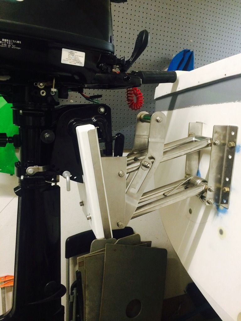

I also finalized the position of my motor mount and re-drilled the holes. Its pretty much in the factory position, the lower holes you can see that were filled in must have been put there when a P.O. tried to run a short shaft motor. When I got the boat those holes were sealed with bolts and silicone... poorly.
I'm not liking the position of the tiller arm so much. When I bed the motor mount I may go up a notch on the 3 position holes of the mount bracket.
Also, a shot of my backing plate on the inside, just 1/2" marine plywood coated in epoxy.
Hey Luke,
I getting ready to re-install my motor mount. I've over-drilled the previous holes and epoxied them so that they are ready to be re-drilled. Did you bed the mount with butyl tape? I also plan to use marine plywood as a backing. Did you just paint the plywood with epoxy? I wasn't planning on doing any bedding on the backing plate, correct?
Thanks!
Kevin
Sep 8, 2014
2,551
Catalina 22 Swing Keel San Diego
Hey Luke,
Thanks!
Kevin
You can certainly use butyl tape to bed the motor mount, but I used 3M 4200 UV... either will work fine, and only really necessary to bed from the outside. I did paint epoxy onto the plywood backer and I painted it for good measure, no harm in that. Remember to still use fender washers under the nuts, otherwise the tightened nuts can still compress the plywood enough to loosen the motor mount over time (and a lock washer too!).

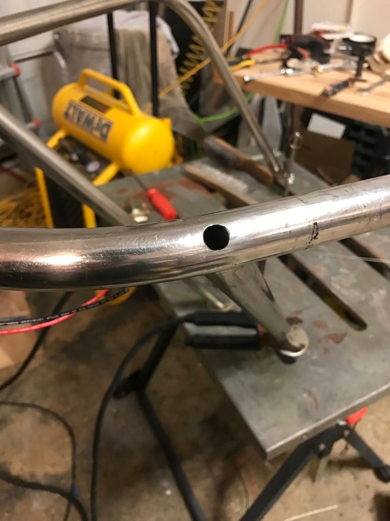

Way back in an earlier post I figured out how to make Nav light rail clamps since Aqua-Signal discontinued them. I got that worked out, but the wires have to run through the tubes, so I would have to drill holes in the top of the tube so I could then drill through the bottom of the tube and pull the wire down the leg, like so;
Sep 8, 2014
2,551
After the holes were drilled I could run the 18 ga wire through, pretty easy. Then I used a piece of solid 5/16 stainless rod to plug the hole and weld it in, then cut off the rod, and grind/sand/polish smooth. Well, everything was going well until I heated up the tube too much and melted the wires. Bad move... smokey stinky mess that was. So I had to re-drill the hole to 3/8 and start over.
This time I reached in to my chopper-building bag of tricks and ordered a small roll of this spark-plug wire insulation that is good to about 800 degrees of direct contact to hot metal. I cut a 6 inch piece and slipped over a new pair of wires and heat-shrinked each end. The insulated portion lives right under where the weld will be, 3 inches past the down tube hole and 3 inches into the down tube too, helps with chaff against the drilled hole also.
Sep 8, 2014
2,551
With heat protection on the wires I could weld the top hole shut again, but rather than a big 3/8 plug I decided on a new approach. The plug was needing too much heat and was distorting the metal too much, so I cut a short piece of stainless tube and then cut it in half, more like the top 1/3 actually. This would make a square patch to lay over the hole and weld the edges. I cut the heat on the torch down to 30 amps. Here is the two tacks on the bottom edges since I can't use a clamp, then I could use a hammer to smooth the curve of the patch tight around the radius (same size tube won't exactly 'nest', needs a little help). Then I tacked the top two corners.
Sep 8, 2014
2,551
After tacking in place I could slowly stick weld the sides of the patch plate. I only went a short distance and then stopped and allowed it to cool completely before welding more. The bow pulpit is almost done, then I'll do the patch on the stern rail with the stern light wire run in place. After the welds I'll use my pneumatic die grinder and ending discs to clean them up, followed by scotch discs, then polish the entire rail. Maybe I'll get them both back on the boat this weekend?
