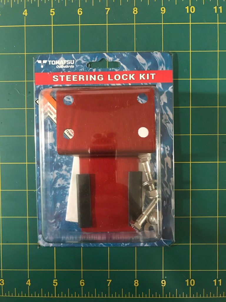

We were all talking about locking the outboard and steering with the rudder several months ago; this finally came in the mail from Defender. It had been on back-order so long that I forgot about it, I think I had ordered it in February.

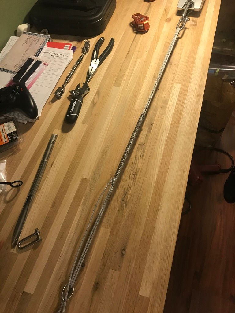

I was messing with some rigging ideas the other night. I picked up some 7/32" Amsteel when it was on sale at WM, buy one foot get one foot free; so at .39 per foot I got 100 feet for $19.50
I will be possibly be using lashing to make tension for the lifelines, but I may also use deadeyes for the forestay. I have all new turnbuckles, but my synthetic rigging can be tricky... when splicing the eyes it takes some serious math and a little trial and error to figure out how much line is lost to locking brummel splices and then gain back when I stretch it under 400 pounds of tension on my rigging table. My forestay actually came up 2 inches short. (on a side note, when I figured out my math error I then spliced one of my main shrouds and got it within 1/8"). Anyway, I have a 2 inch long shackle to make up the difference, but I was wondering if I could use lashing to create tension instead. I also don't want to spend extra boat-bucks on Colligo deadeyes so I figured I would try what I have seen many riggers do, just lash through stainless sailmakers eyes.

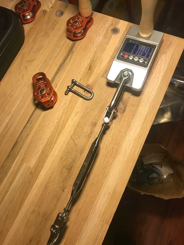

Any good experiment has a control experiment first, so I set up one of my 1/4" turn buckles on the rigging table with the digital scale to see what kind of pull I get in pounds. I only turned the body to the half way point, it was getting a bit difficult to wrench in half turns of a flat table. I got to around 140 lbs of tension and it settled to 110 lbs.

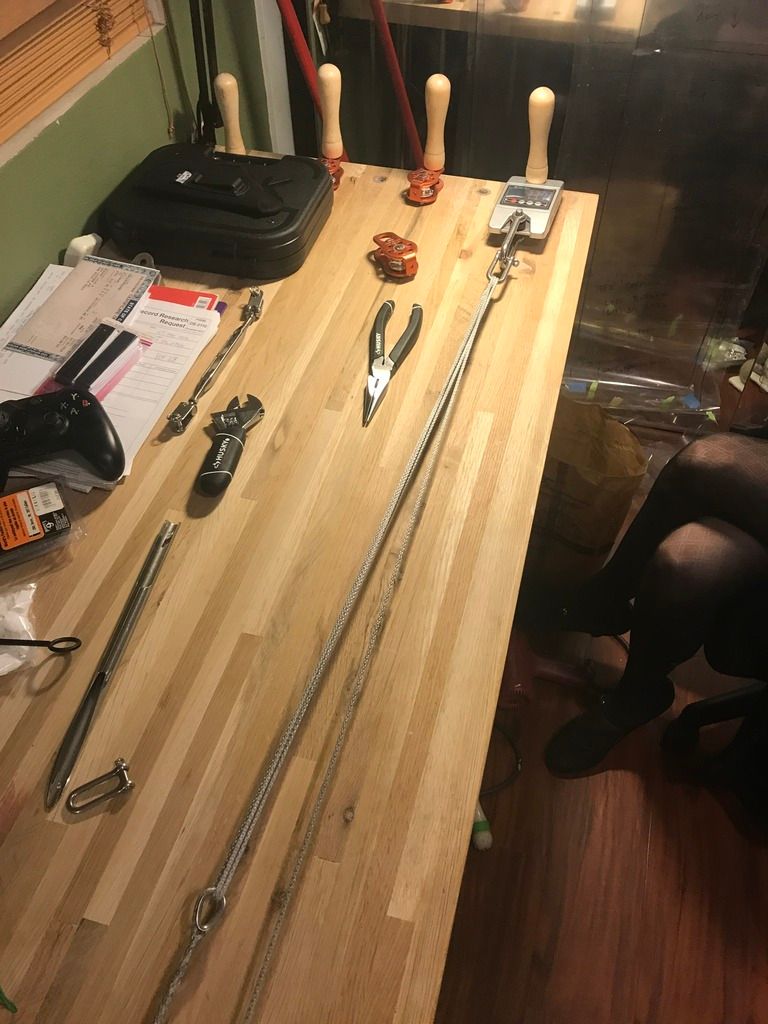

Next, I wanted to see what kind on tension I would be able to pull on my adjustable backstay. Here I am just using the tackle without the extra block and wire, so you can imagine I will get even better results. The key point to testing this was to know that if I were to use lashing to set my forestay, even If I can't pull some crazy amount of tension, as long as it is firmly set and vertical I can get the majority of tuning tension from the backstay.
Spiked around 150 pounds, settled to about 130 lbs.

So I spliced a short scrap piece of NE Ropes 3mm Dyneema STS HSR with eyes at either end and set the splices at about 400 pounds on my 2 speed bench winch. One end is a standard thimble just as an attachment point, the other end uses a closed sailmakers thimble from Ronstan, of which I use a larger size than normal to give more space for the lashing. There still is much space for multiple passes of lashing even with a larger eye, the more passes you try to make, the more they bind up on each other. Basically, I just got two complete passes. I put a couple turns and hitches on my largest splicing fid and pulled with all my might. I din't get any pics of the scale as I was trying to find the best mechanical advantage to pull tension and girlfriend was watching the scale. It spiked around 60 pounds and settled to less than 20 by the time I had locked and turned the lashings.
Sep 8, 2014
2,551
Catalina 22 Swing Keel San Diego
So the verdict? Well, the jury is still out. I know I can put a fair bit of tension on it, but I need to find a more efficient way of doing it and get better at locking and lashing. Also, its obvious that the turns bind up on each other in the small eyes. I don't really want to buy the Colligo deadeyes, but my curiosity will never be satisfied if I don't at least test it... so I ordered them from Vella Sailing Supply. If I don't use them for the forestay I will probably surely use them to cinch the lifelines. I will post the same pull test with the Colligo bits once I get them, the rigging bench is all set up and ready to go.

Looks like that steering lock could be modified ?
Instead of bolting it in place, I wonder if it can be bolted to flat metal stock and have it designed so it can be pushed in/out with a lever. Is there enough clearance ?
I figure I'll be looking into some alternatives once my Tohatsu arrives.
