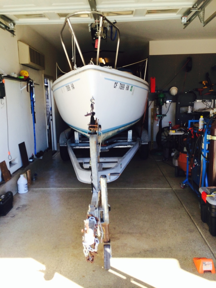

Once I got it home I was able to slip it into my garage.... yes, I have it inside. I'm blessed to have a 37 ft deep garage with a 10 ft overhead. My door is only 8 ft high so the mast has to come off and I store it hung up on a 60 ft fence down the side of my house. Otherwise the hull clears the door frame with about 3 inches on either side and plenty over the top.
I don't back the trailer all the way in with my truck, thats just way too hairy. I have a bit of an incline on my driveway, not too severe but enough to make backing up a trailer into the door a real PTA. So I back it up to the door, chock the wheels and drop the trailer. Then I use a Warn winch and a couple of snatch blocks with anchors bolted into the concrete all the way on the back wall of the garage to gently pull the trailer into the space in a controlled fashion. Sounds complicated, but its really not. A little time consuming to do for every sail so when the rehab is done my ideal situation would be to keep the boat at a marina on the trailer, stick up, and ramp launch or crane launch.
For now I have it inside and I can do my work in a climate controlled space with direct and easy acsess to all of my tools, power, and coffee!

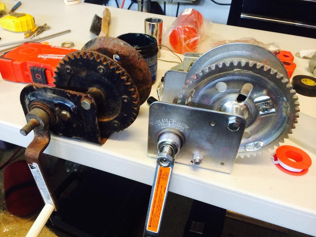

I have already fixed the keel cable that was broken using the Catalina Direct kit, and replaced the original and totally rusted to hell winch. I got my winch from another source for 1/2 the price of the Catalina Direct winch at 1/2 the price and free shipping, it is the exact Dutton Lainson 1200 lb galvanized brake winch that is required.
https://www.etrailer.com/Winches/Dutton-Lainson/DL14934.html

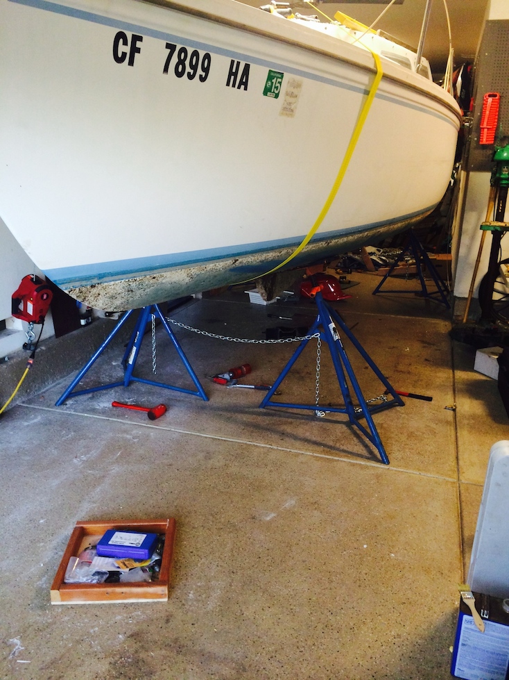

Off the Trailer and on Stands
I got a good deal of heavy lifing done this weekend. The hull is now off the trailer and on Brownell stands.

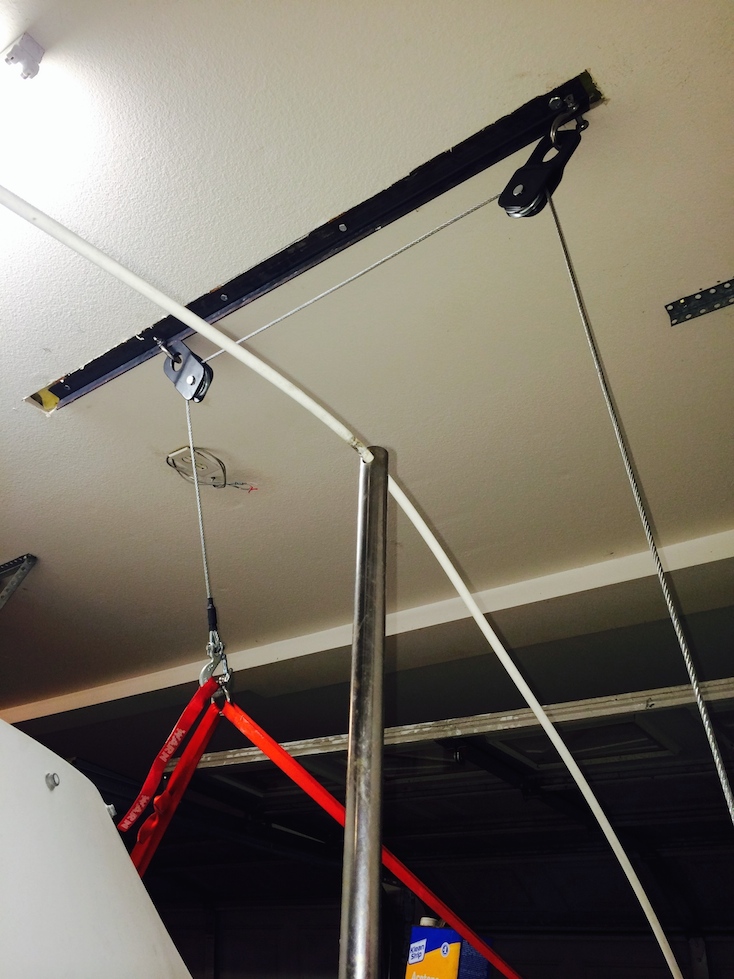

I had to re-engineer my hoist arrangement. On my test lift I almost tore out some ceiling joists. I sistered the engineered plywood joists with 30 inches of 2x4 on each side and then through bolted my anchor bar with 3/8 x 6" bolts. After doing that and getting a better 2 inch strap the front lifted fine with the transom already on stands so I could roll the trailer out from under. Then I set the bow down on the front stands.
On the rear I laminated an athwartships 'bunk' from 3 layers x 3 wide strips of 3/4 x 3 pine. When I tested the stands initially the pads were pushing on the unsupported hull which could have done some damage. The laminated lumber follows the curve of the transom and distributes the wieght just like the trailer bunks. Up curve of the hull is too sharp just in front of the keel where I put the forward stands but I found the area was plenty strong enough to be supported by the stand pads.
This was my first hoist set up, it failed. Didn't break off but pulled one lag screw out. On the second attempt I kept the angle iron but cut out more drywall, sistered the joists, and then used the long through bolts.

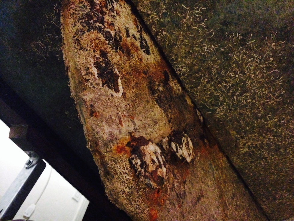

Keel Off

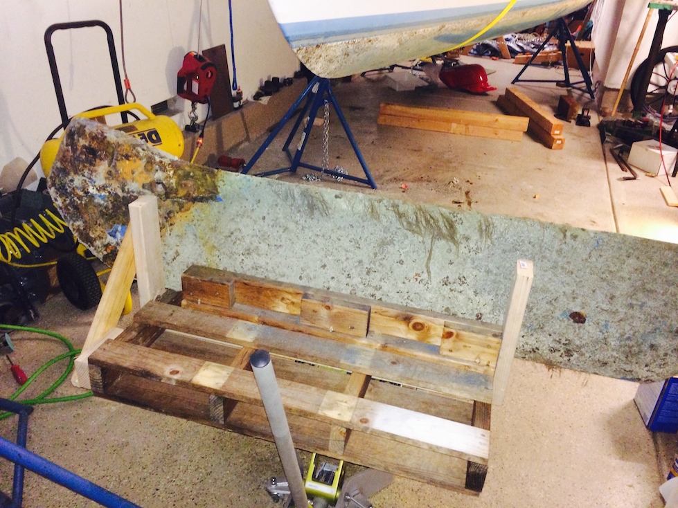

With unlimited access to the under hull I was able to roll a small lift and pallet under the centerline. I modified a regular shipping pallet as a swing keel holder with vertical 2x4 supports.
After digging around the bedding compound with a putty knife I found the bolts and scraped away the mess. To my relief the bolts came loose with no galling or cross threads. It was obvious that everthing had been previously bedded properly and the bolt threads were sealed with silicone or a softer bedding compound. No major corrosion or damage on the bolts at all, and nothing wrong with the weldment threads, I'll just clean them with acetone. Thankfully I wont have to dig into the glass to replace those weldments!
With the pallet lifted up under the keel and the cable tension released I just gave the stern end a shake or two which helped the bronze castings pull free of the bedding compound and the keel dropped about .25 inch into the waiting pallet. I pulled the cotter pin and securing pin from the cable lifting eye and then I lowered the lift and just rolled it away!
1st Pic in the cradle, 2nd pic is what it looked like in the slot....

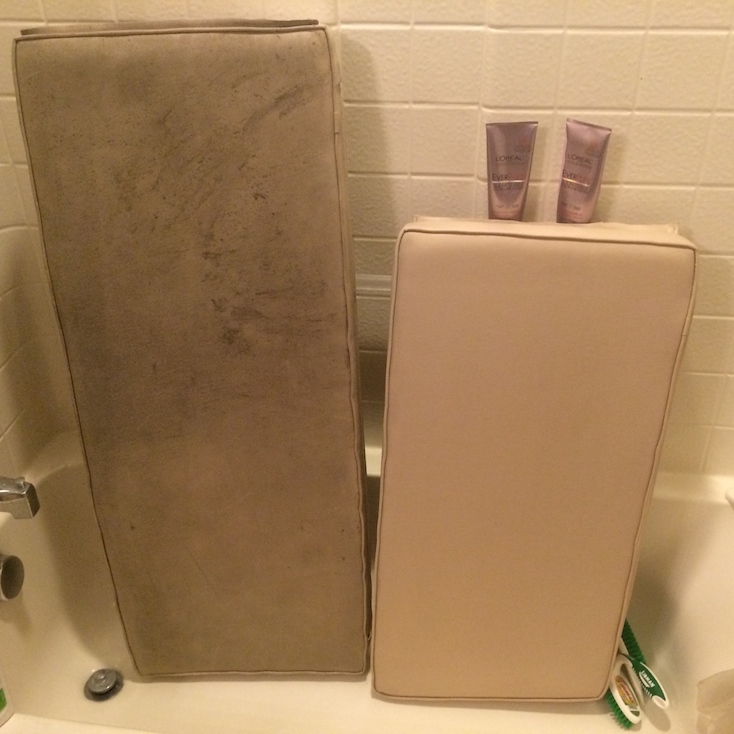

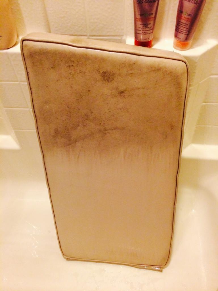

Here is a fun pic... Cockpit cushions had some mildew. I gave them a once over with SoftScub and they look almost new after. 3 out of 4 zippers are corroded shut so I will replace them later.

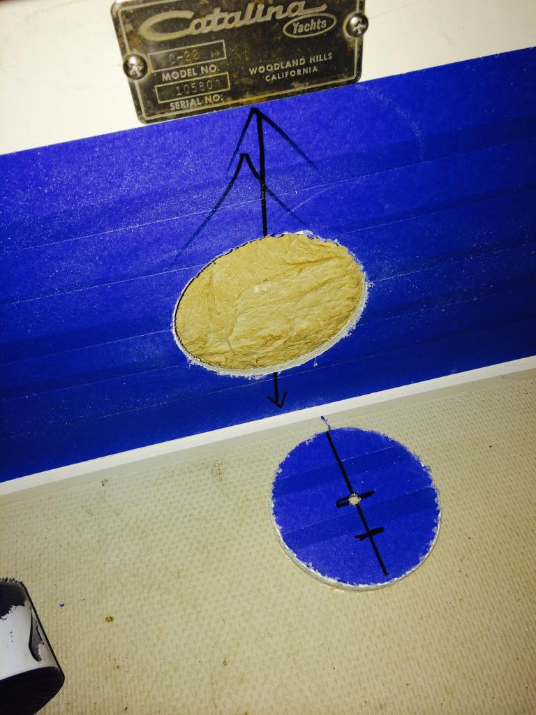

This where I drilled the hole for the inspection cover that will give me access to the rudder gudgeon hardware. What you see is that hard filler foam I was talking about. I think I'll have to go after this with sharp chisels. My new backing board will be one piece of 1/2" marine plywood that goes top to bottom on the transom.

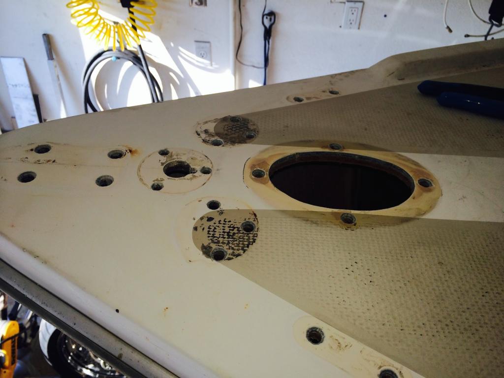

This is where I cleared all the hardware off the bow. I over bored all the 1/4" holes to 5/16 and counterbored just a bit. All the holes will get resin filled and re-drilled later. That chain hauser has to go, looking for something smaller.

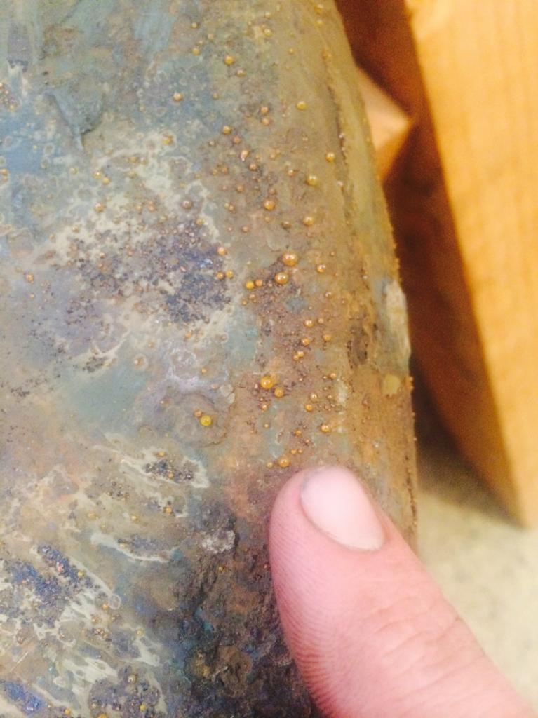

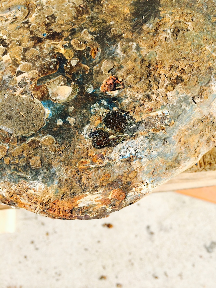

This is one of the MOST interesting pics for anyone who has a Swing Keel C22... What you are looking at is where I chipped away some of the Paint/fairing epoxy coat right down to the porous cast iron using a mallet and chisel type paint scrapper. Forgive the nasty analogy, but it was as if you picked off a scab and watched the blood rise out of the freshly exposed dermal blood vessels... yes, the cast iron was BLEEDING moisture!

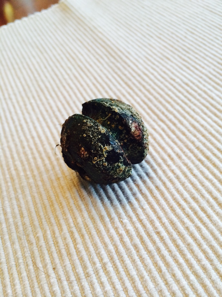

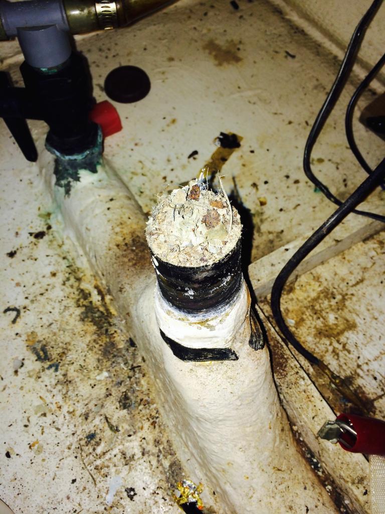

The Volcano after I removed the old Winch and took off the tube... yes, the turning ball is in that mess somewhere!
What the turning ball looked like after I got it out;

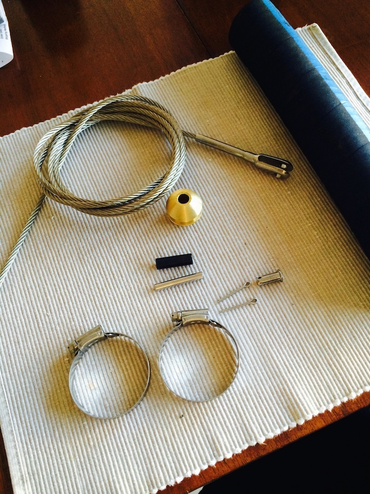

The Catalina Direct Kit before I installed it with the new winch;
