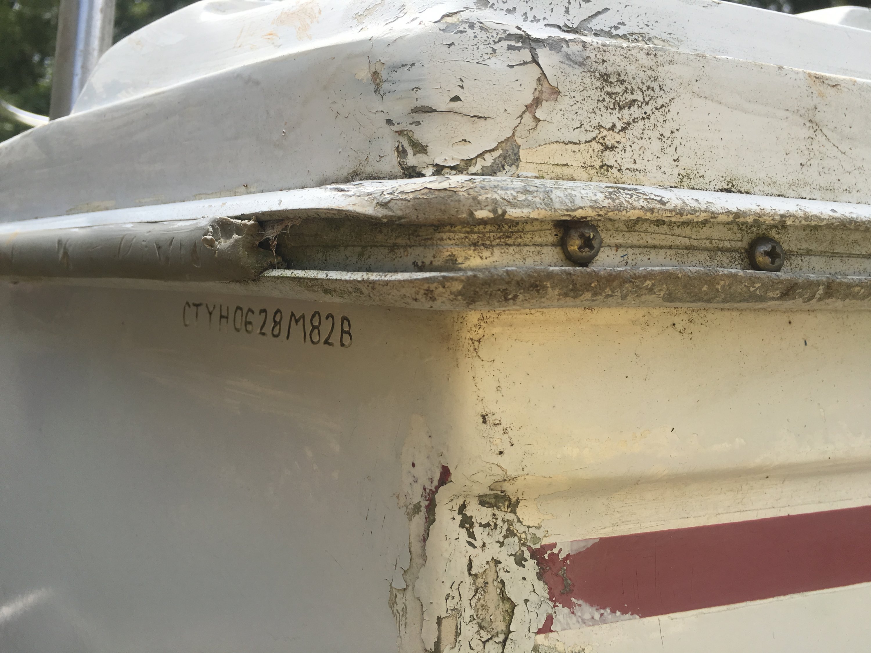

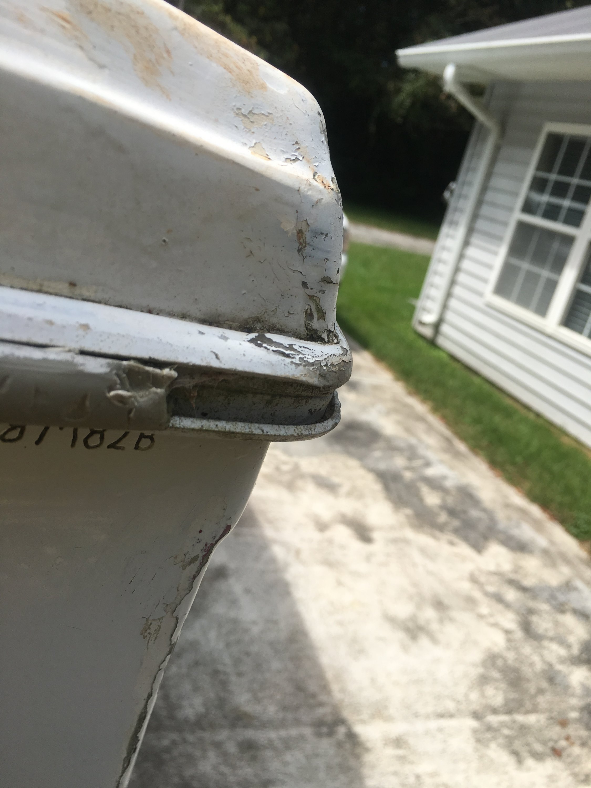

Was your old channel the narrow or wide and how did you bend it around the corners? I have a small section at the starboard corner transom that got kinda shmushed. If i can't raise it to be useful replacement may be in the future project list.
Goeff
Sep 8, 2014
2,551
Catalina 22 Swing Keel San Diego
Goeff
I used the original channel, so it was already shaped. It is the original narrow channel like yours. I had to clean off a considerable amount of the white, chalky, and very hard calcified corrosion... it was a tedious task. You channel does not look as bad, I don't see any of that bi-metal corrosion behind the screw heads. That dent in the channel is very minor, use a blunt flat-blade screwdriver or similar tool to lightly bend the lip back into shape before you remove it to do the gelcoat repairs.
I did a lot of research into replacement rub-rails. There are tons of products out there and some with plastic channels that might work well on a C22. At the end of the day it was just more economical to clean up my original channels and get the replacement insert from Catalina Direct for $90.

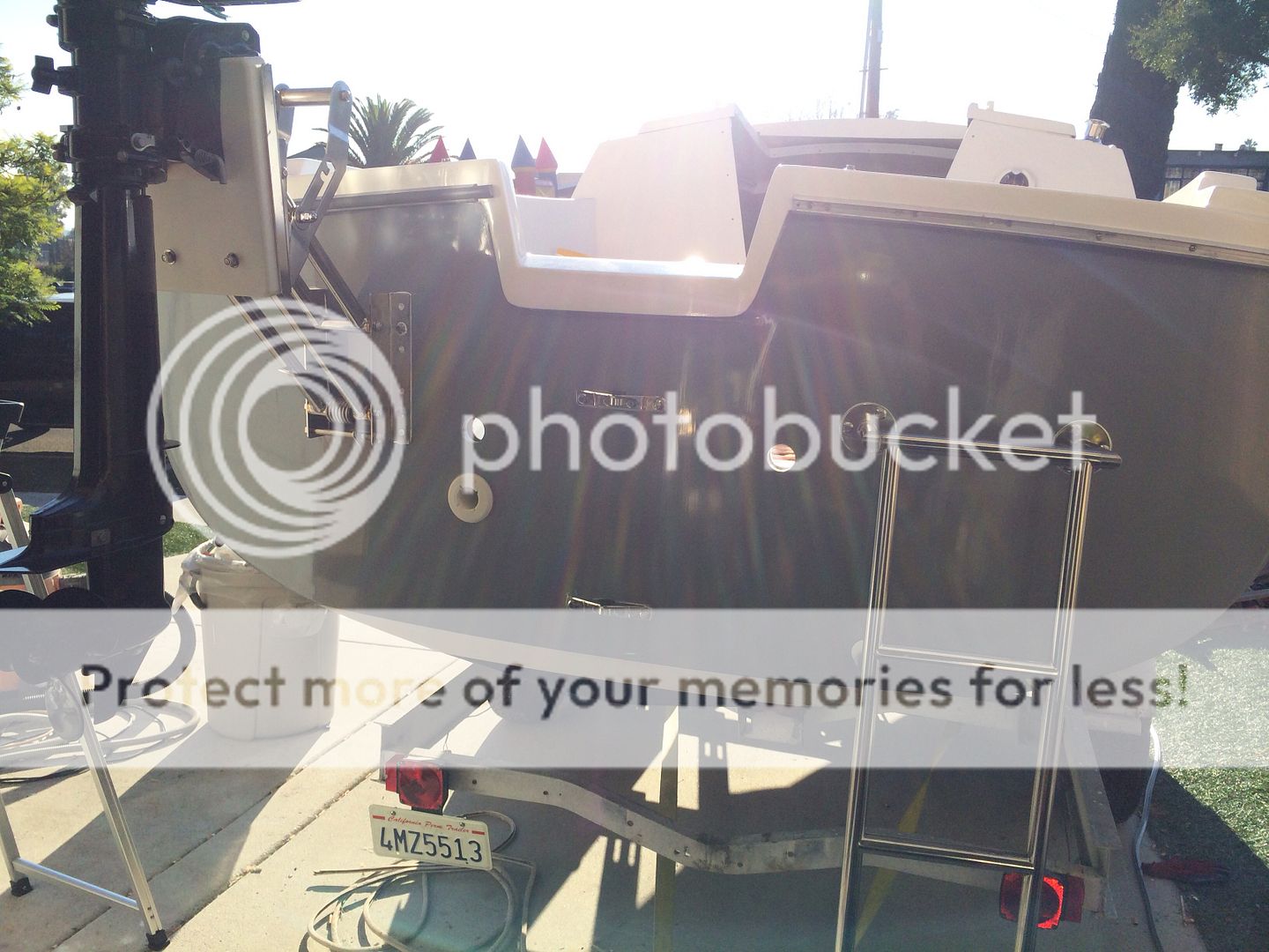

Quick Tip... 3M 4000 UV will last at least a week partially used in the tube (caulk gun size tube) if you put a long deck screw down the tip, wrap the end up in cling-wrap, and store it in the fridge. Last weekend I used 3/4 of the tube when re-installing the rub-rail channel and saved the rest. This weekend I wanted to use up the rest of the tube and was happy that the storage in the fridge kept it fresh. I was able to bed the swim ladder, rudder gudgeons, motor mount, and up front the anchor roller/stem fitting with what was left in the tube. Everything is bedded on the transom now except for the cock-pit scuppers, I'm waiting on my step wrench in the mail to install those.
I didn't finish the port side rub-rail insert yet, LOL... I'll try to knock out a few feet while its still warm, sun will down in about an hour. It might be hard to see in the pic, but the swim ladder is polished to near mirror. That was a buffing kit that I got from Caswell Inc. that puts polishing wheels on a standard 4 inch grinder. Works wonders but is time consuming. Worth it for that shine eh?
