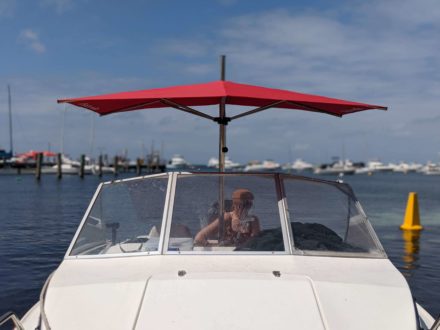

Umbrellas can double as drogues or even fresh water distillers. They are good fold away biminis,
Finbrella-Umbrellas.-F-220-SS-all-316-stainless-steel-ribs-struts-and-centre-pole-on-deck-moun...jpg
