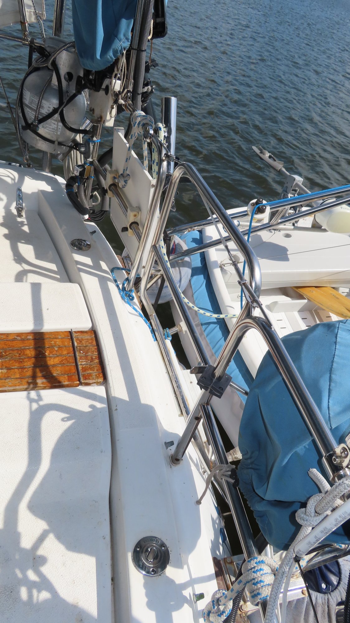

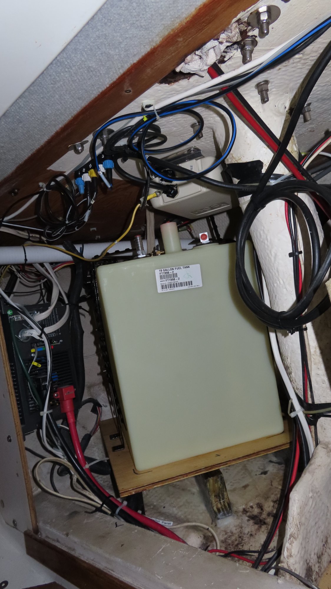

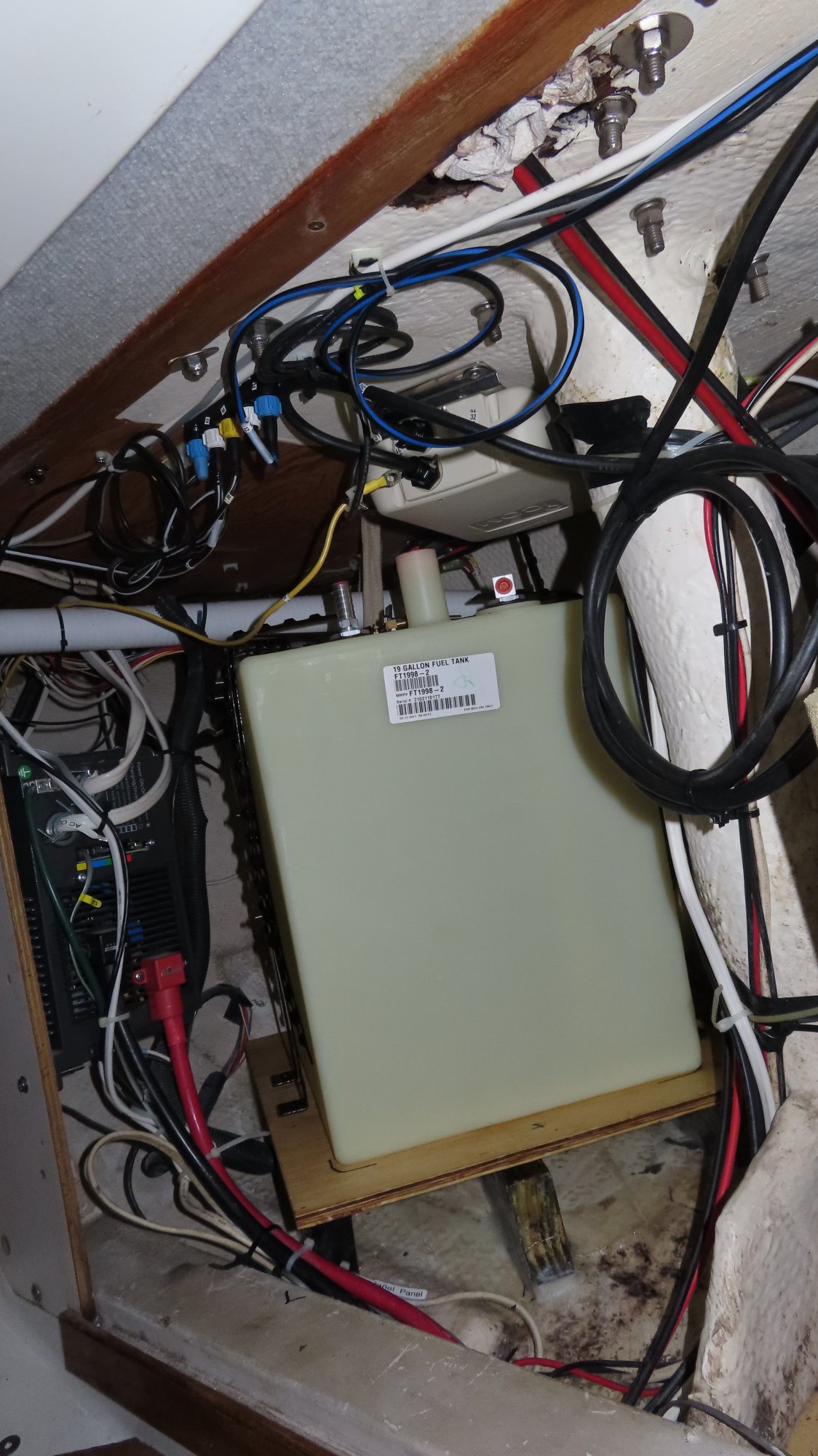

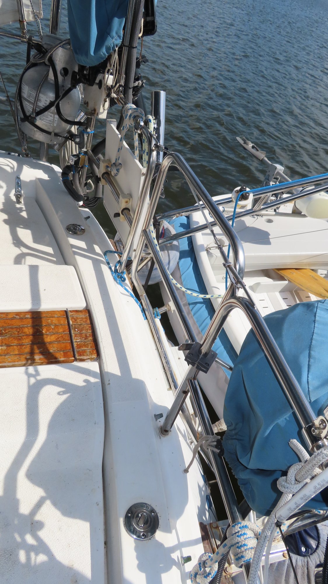

Here is the 19 gallon Mueller fuel tank mounted at the back of the boat, the factory 40 gallon metal tank is on the port side. I mounted the tank to pressure treated sleepers mounted in West epoxy. I put both the new deck fill and I relocated the existing fill onto the gunnel above the tanks. I didn't like the factory deck fill as it was in a wet area and hard to reach plus I couldn't reach the hose to replace it. I wanted a bigger tank but the charger/inverter takes up a lot of room, you can see it on the left of the new tank.

Here is the 19 gallon Mueller fuel tank mounted at the back of the boat, the factory 40 gallon metal tank is on the port side. I mounted the tank to pressure treated sleepers mounted in West epoxy. I put both the new deck fill and I relocated the existing fill onto the gunnel above the tanks. I didn't like the factory deck fill as it was in a wet area and hard to reach plus I couldn't reach the hose to replace it. I wanted a bigger tank but the charger/inverter takes up a lot of room, you can see it on the left of the new tank.View attachment 206105View attachment 206106
I like what you did with the deck fills for the fuel tanks! Genius:yeah: I might be copying you on that since I have the same complaint about the location of the fuel fillers. I'm also going to be relocating the aft cleats to the toe rail from the cockpit siding. That should clean up the aft deck area nicely.
My boat had a (factory?) configuration of the 40 gallon fuel tank located starboard of the rudder post and a 50-ish gallon water tank to port. Not much space remaining and with both tanks in place the area left over was/is essentially inaccessible. Looks like you found a good use for that spot :).
