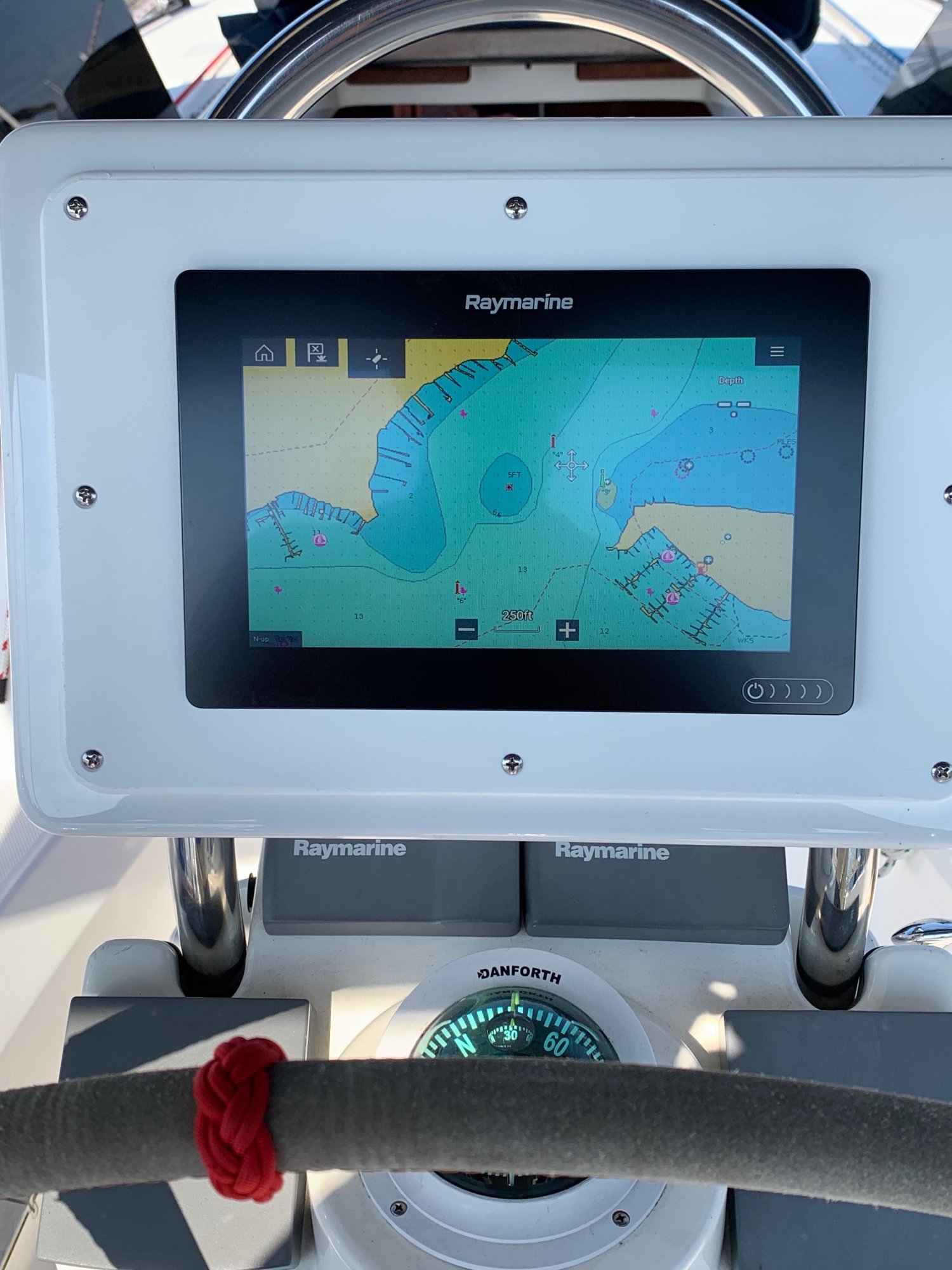

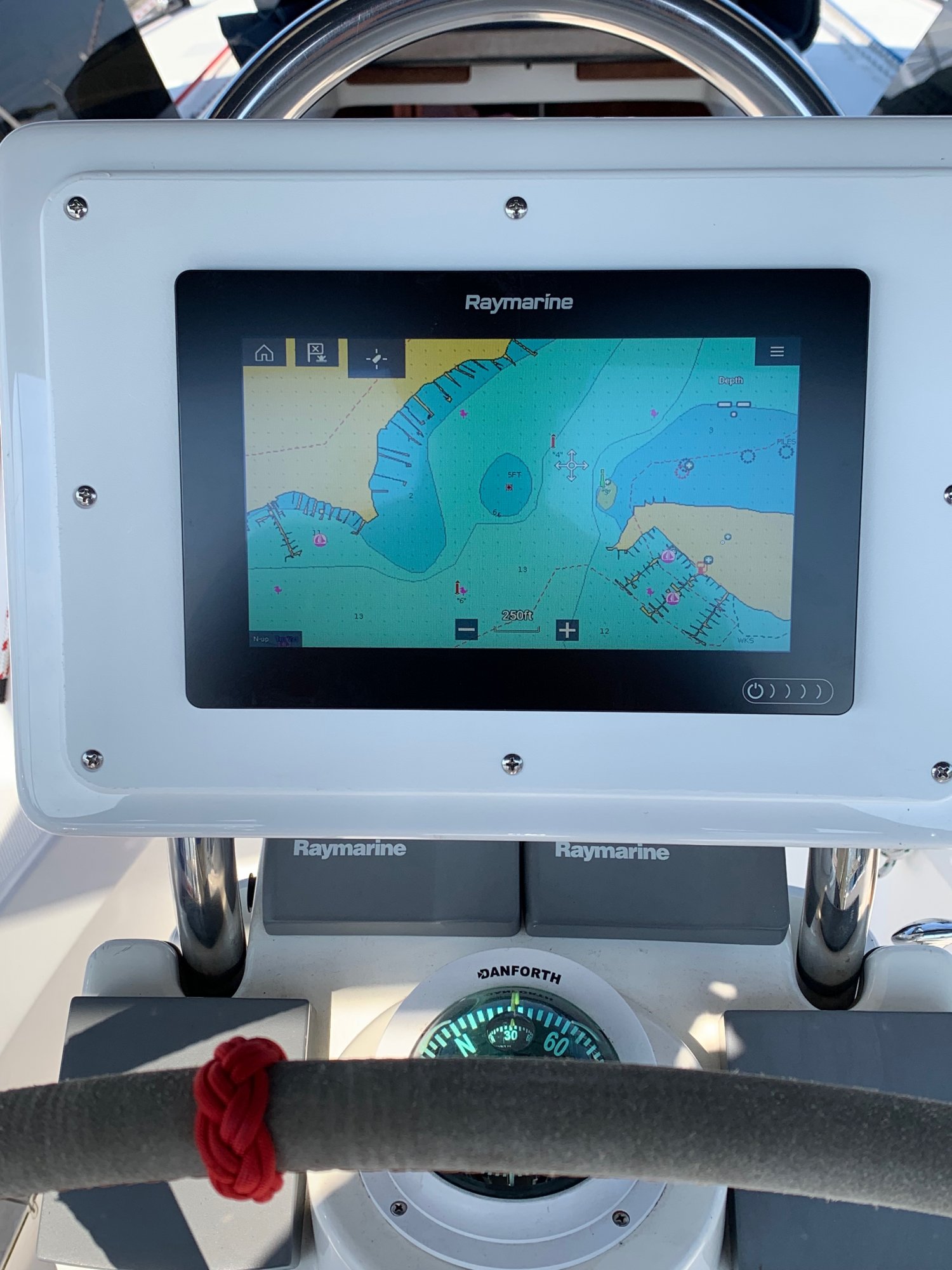

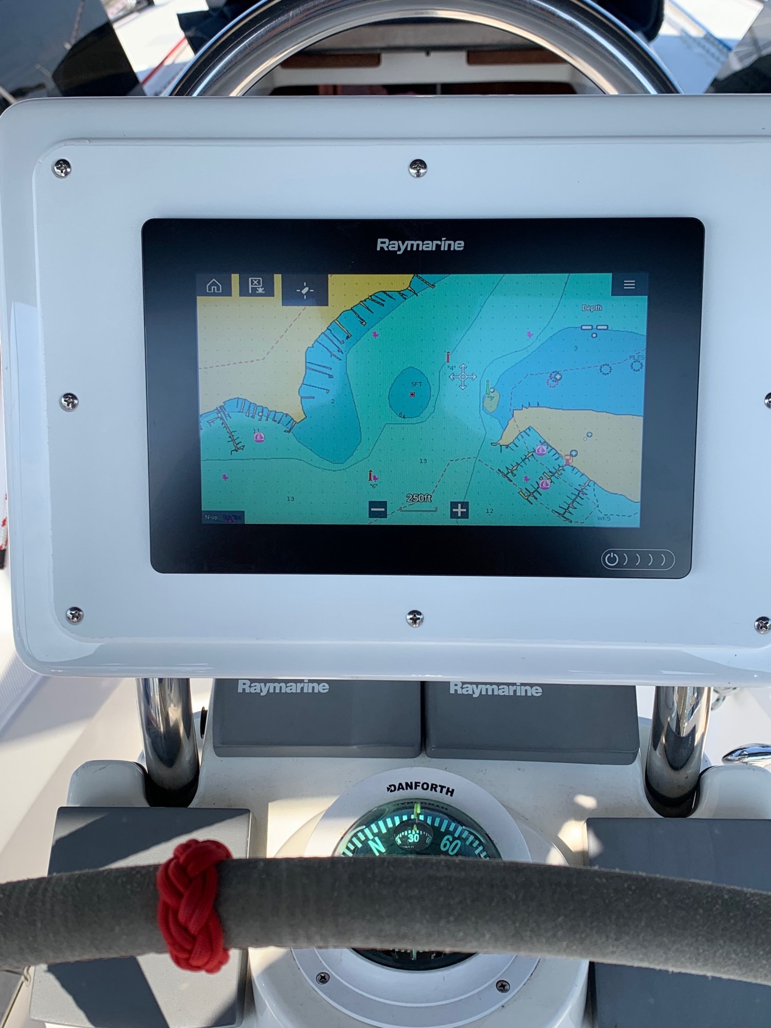

Sometimes I get a bit paralyzed between wanting our boat to look perfect (like it did the day it was new), vs. making improvements which look tidy and nice and yet utilitarian. As I look at more and more boat blogs (and your thread qualifies as one), I think I'm leaning more towards well done, utilitarian, but not necessarily glitzy improvements. In other words, I like the way your new floor looks! It's got LVT instead of teak and holly (boats get wet), it's got visible screws (because they make sense), and it's got nicely recessed polished hinges and pull tabs. It's not like a new Swan or a Hinkley. But it makes sense and looks good. Of course, most of what you've done in your refit doesn't qualify for the word "utilitarian": it's just plain fancy. So I'm talking myself into a corner here, but I hope you know what I mean.
Here's something I did last Fall that I wasn't too sure about, when I replaced our old chart plotter:
At first, I thought: well, there's these exposed stainless screws, and I had to put in a backing plate to cover the hole. But what the heck: it's a boat, and it looks pretty good! Not perfect, but nice.
I should probably stop here. Please take my comments in the spirit in which they were intended. Your boat looks great, and I wish I had half your skill.
Welcome aboard Jay,
I don't see where you talked yourself into any corner at all :), and I fully understand the spirit you intend and thanks for it!
I think you did a bang-up job on the chart plotter. There is and always will be different thoughts and ideas on our boats about, for lack of a better term, how they age. While the desire to keep the boat as factory original as possible might be desirable, it's not very practical sometimes. Case in point - my original head plumbing was an Orwellian nightmare, with a spaghetti-like array of soft, flexible and VERY permeable hoses that my nose determined had to go at the first opportunity. Unfortunately replicating that factory setup with better materials was impossible, necessitating a wholesale change and complete re-engineering of the plumbing - which required major changes - cabinetry, fixtures, etc. - to everything surrounding the factory setup.
Everything on and in the boat has a lifespan, no matter how hard we try to keep on top of maintenance. Eventually parts & pieces will need replacement and the likelihood of the replacement being an exact match diminishes with time. That alone means adapting a replacement in place of the original, or sometimes a redesign/reengineering job. This is where my attempt to balance form vs. function - utilitarian vs. glitzy leans towards maintainability. I KNOW that eventually I'm going to have to fix or replace something and to do it I will have to remove parts & pieces to get to the parts & pieces ;). Thus, leaving (for example) screwheads exposed makes sense to me, or - in the case of the flooring - using screws to secure the tiles makes more sense than other more permanent methods to secure them.
Having said all that, there is a sense of style I'm shooting for. Just like what I said when building the hard dodger - I didn't want it to look like the box the supplies were delivered in, I wanted it to look like a factory option - there's no harm in adding a little style to the utility, even if the style appeals only to me. If it appeals to someone else too, yay! :biggrin:
As a final thought, as I'm sure many of you guys do, I follow a few sailing and cruising channels. blogs, videos, etc. Ever notice how much of those folks' time and energy is spent repairing things while underway? What percentage of time in that faraway exotic locale they spend wedged under a cabinet with a wrench? And how much of that time is spent ripping out that nice looking (factory-built as a unit and dropping one-piece into the boat before the deck was put on) cabinet or locker? While I know that when I do get to that faraway exotic locale I also will have to spend some of my time with a wrench in hand, I don't want the first tools used to be the hammer & chisel!
