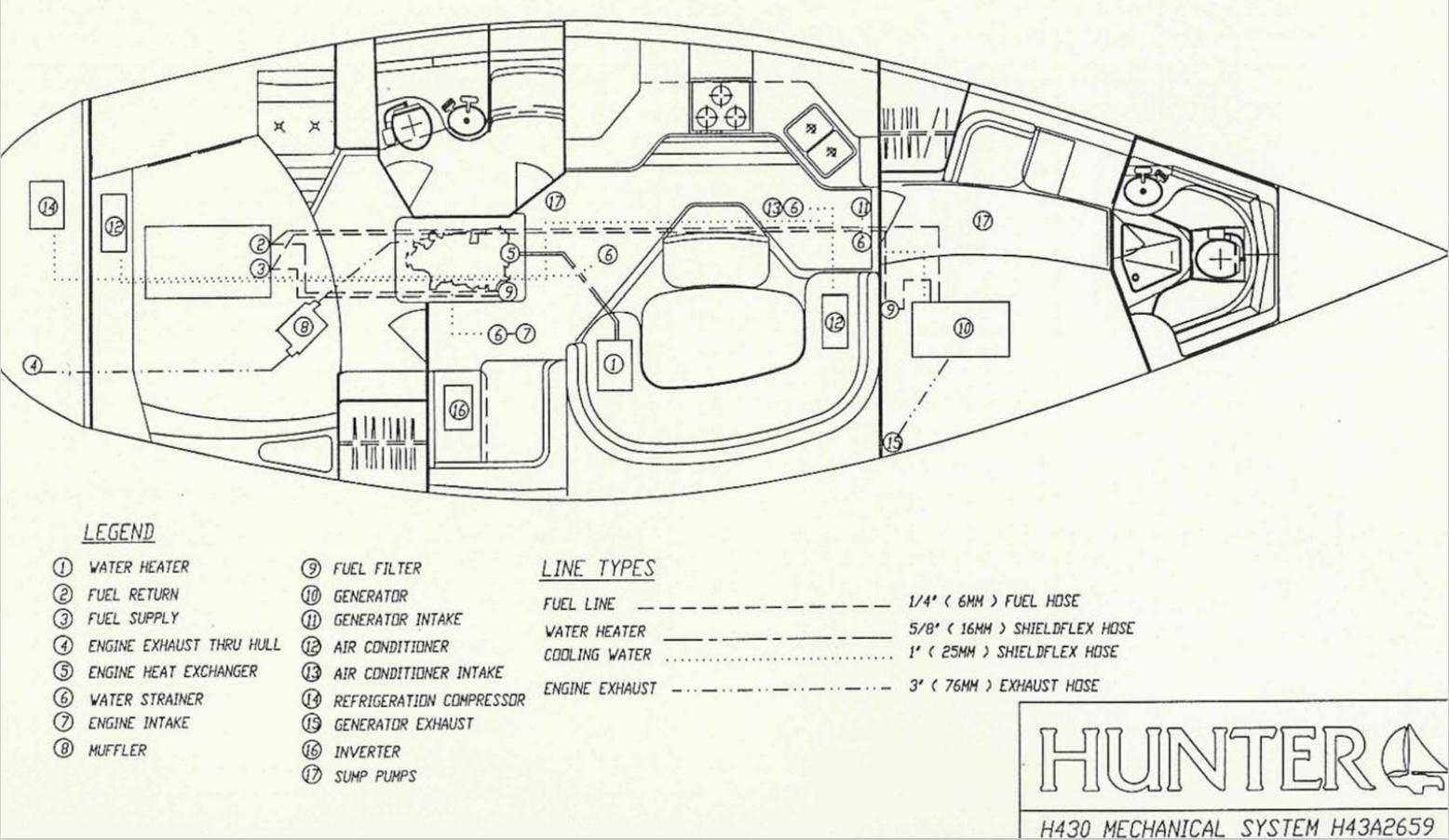

Mechanical Systems Layout.
Fig 5.
This is the last of the basic references.

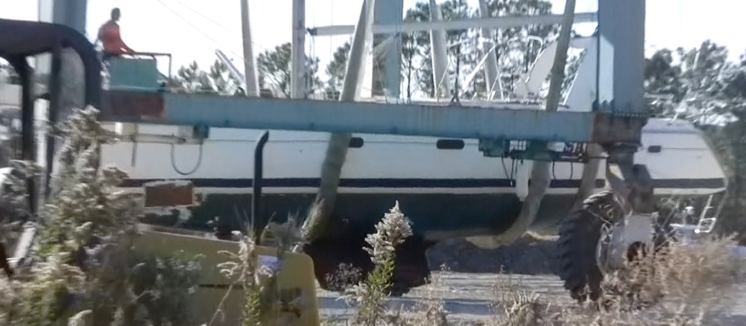

The provisions by SeaTow were from this lift damage. Perhaps the reason they were not "Happy Campers" when setting up for the final tow to Dry Docks.
Here is what happened on the lift.
Before....
After...
Saba must have nosed down when put back in water, and that hole cause the wave of salt water to enter the cabin.
That is the Starboard Anchor locker area.
This is the only hole in the hull and perhaps the largest damage to the boat.
Oh well, a 13.5 ton boat has a center of gravity unexpected by the crane operator.

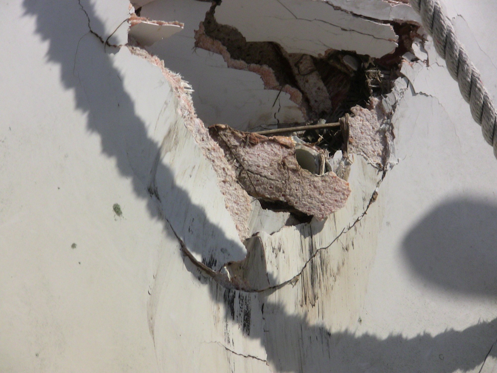

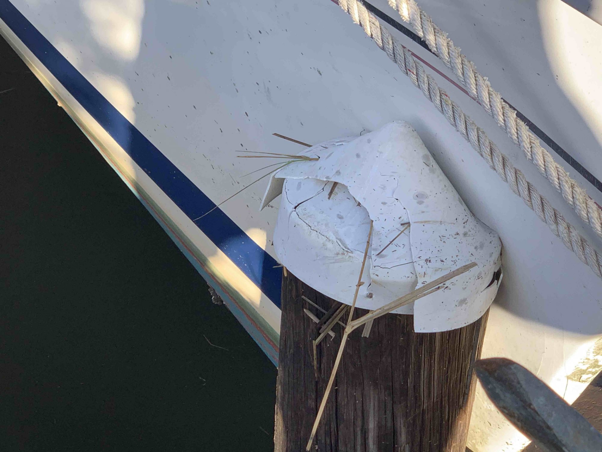

Oh well, a 13.5 ton boat has a center of gravity unexpected by the crane operator.[:badbad:]
After further investigation, that hole was in the Starboard Bow, before the lift by SeaTow.
If you Zoom in on the Before Small picture above in post #42...
You can see a small crack was there already, and the fact the bollard is Round, it has pushed in the hole already.
The size of the hole looks huge, but it only about half the diameter of the post. Thus the hole was hidden from camera view.
No way could SeaTow fix it while dangling from the crane, nor was it their fault.

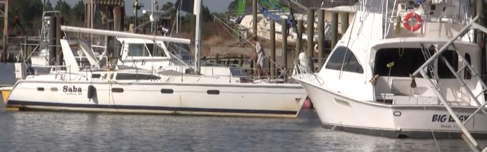

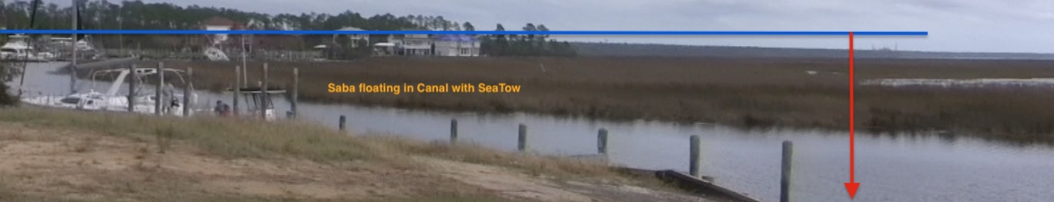

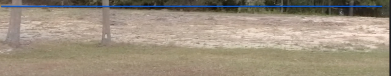

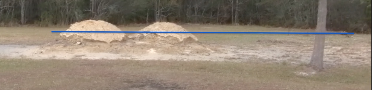

More Proof of the ≈14 foot surge that got Saba
As I was doing a video, watching SeaTow tie up the 50 Gallon garbage can for a stabilizing Drone [Sea Anchor]
I noticed these 2 Dirt Piles on an empty lot.
I added the Blue Horizontal line to show how that Wave came ashore.
I continued that Blue line in a pan toward Bay St. Louis.
Plus the Tides were 2 foot higher this day, versus Zeta at start.
Note the other Sailboat still on top of the finger pier, right above that guys head.

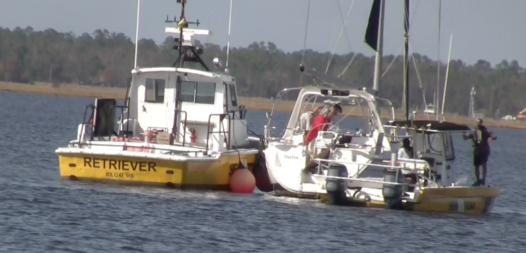

Towing To the Dry Docks....
Will only put few pictures of the ≈5 hours journey from Bow tie up to set down on Stands at the...
Pass Christian Yacht Works or [PCYW] [Chis tee Ann = Christian]
_______

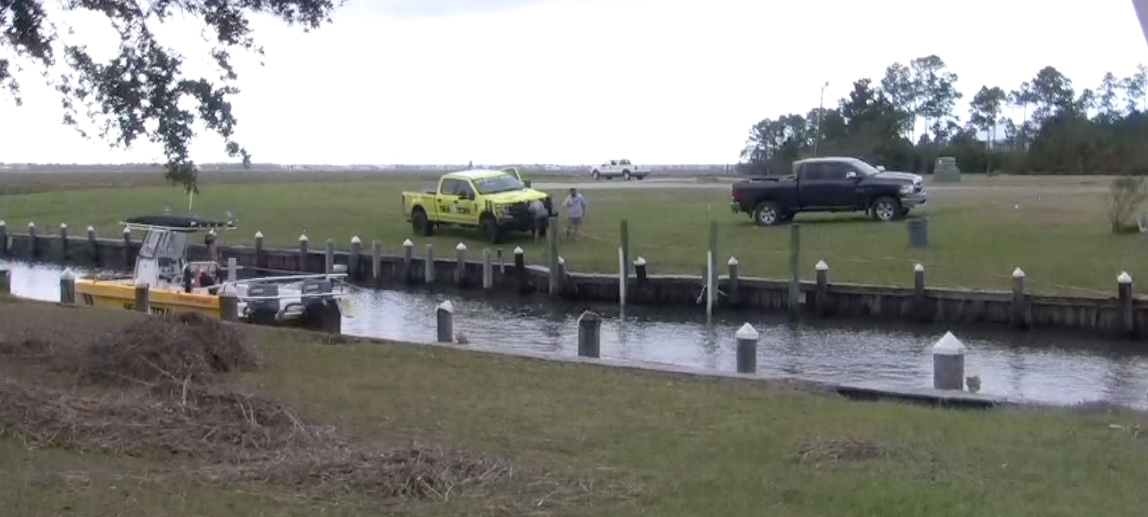

After the lift to the Canal water, the Keel was stuck by setting down, not plowing into the mud.
Their twin 150hp motors heated up when trying it alone.
Then they used the big winch on the truck with a Dual Shackle and Boat.
Finally slowly pulling it to Float in the deeper part of the Canal.
That Towing boat then towed Saba by bow lines , to a deeper area in the Bay of St. Louis.
This is where they exchange Tows to a side tow for more control and a faster speed.
The next part of the Tow had to pass under a Draw bridge to enter the Industrial Canal to the PCYW.

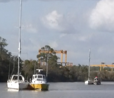

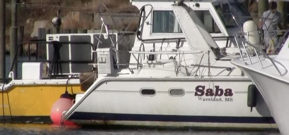

You can barely see the hole on the port [duhh Starboard:oops:] side, just below the anchor.

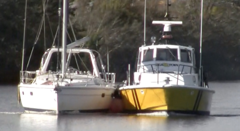

Another Tow servicing a sailboat behind the Saba.
SeaTow releases and PCYW slowly pulls it into the Lift Area.

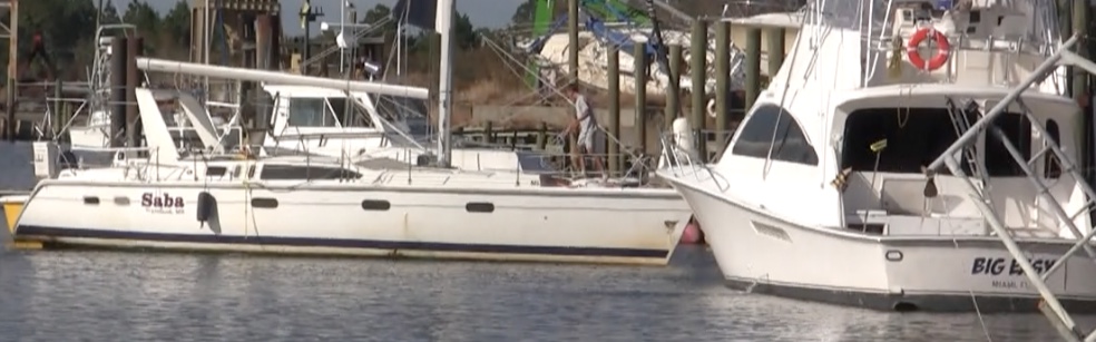

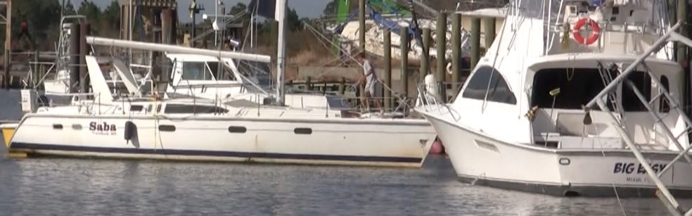

Fun picture, for @BigEasy , but that power boat is out of Miami FL.:biggrin:

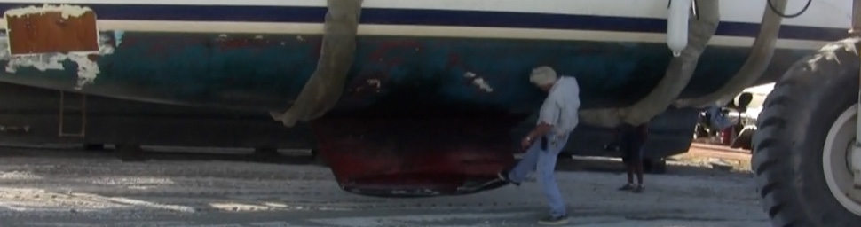

One of my favorite pictures is the White haired Owner of PCYW, kicking the bent Keel fin, to straighten it.:)
That Lead/Antimony fin was bent on the original set down of Saba.
Also note the precautionary plywood patch that was screwed to hull and foamed.

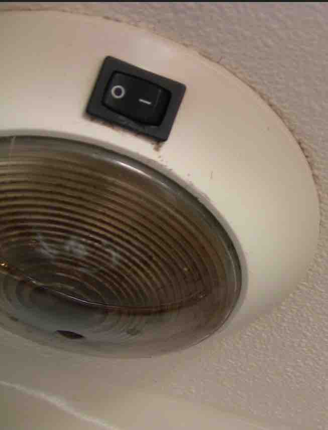

These are two iconic pictures from the boat...
Completely Dry and will be of some use.:laugh:
From the Dome light in the Front Head...
It was submerged for about 3 minutes.
Whew , it was NOT a LED bulb. ;)

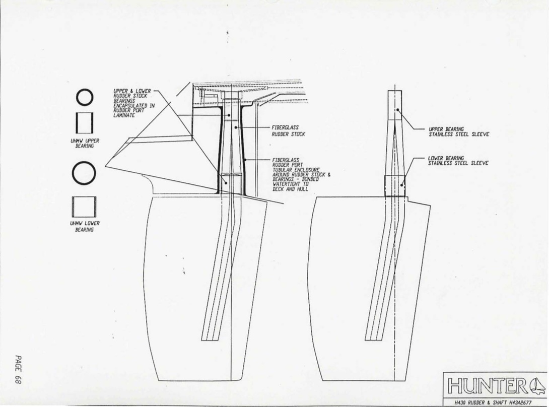

The RUDDER...
My New Rudder is on Order from...

The OEM Rudder
The shaft is Fiberglass with 2 Rudder Bearings. We never had wear or play on those bearings. Diver verified it by standing on the bottom and attempted to rock the Rudder at various angles thru the 48° Port/Starboard swing.
Joe Kerr, from SBO "1 to One Service", was very knowledgeable about the Rudder design and installation.
To make the new Rudder, we will ship our Old Rudder [Picture in post #18], Freight Collect, to them.
But since no Rudder of this Hunter size and age had been made for 18 years, the new Rudder has a Stainless Steel Shaft with new Bearing Points for the new Rudder Bearings.
The old Rudder will be 3D modeled to match the Shape!!
The first PIC Adjustment to the boat's restoration had $345 for a new rudder. :yikes:
Now PIC newest Adjustment is the Quote from SBO, with Shipping, at ≈$4800. Not installed.
