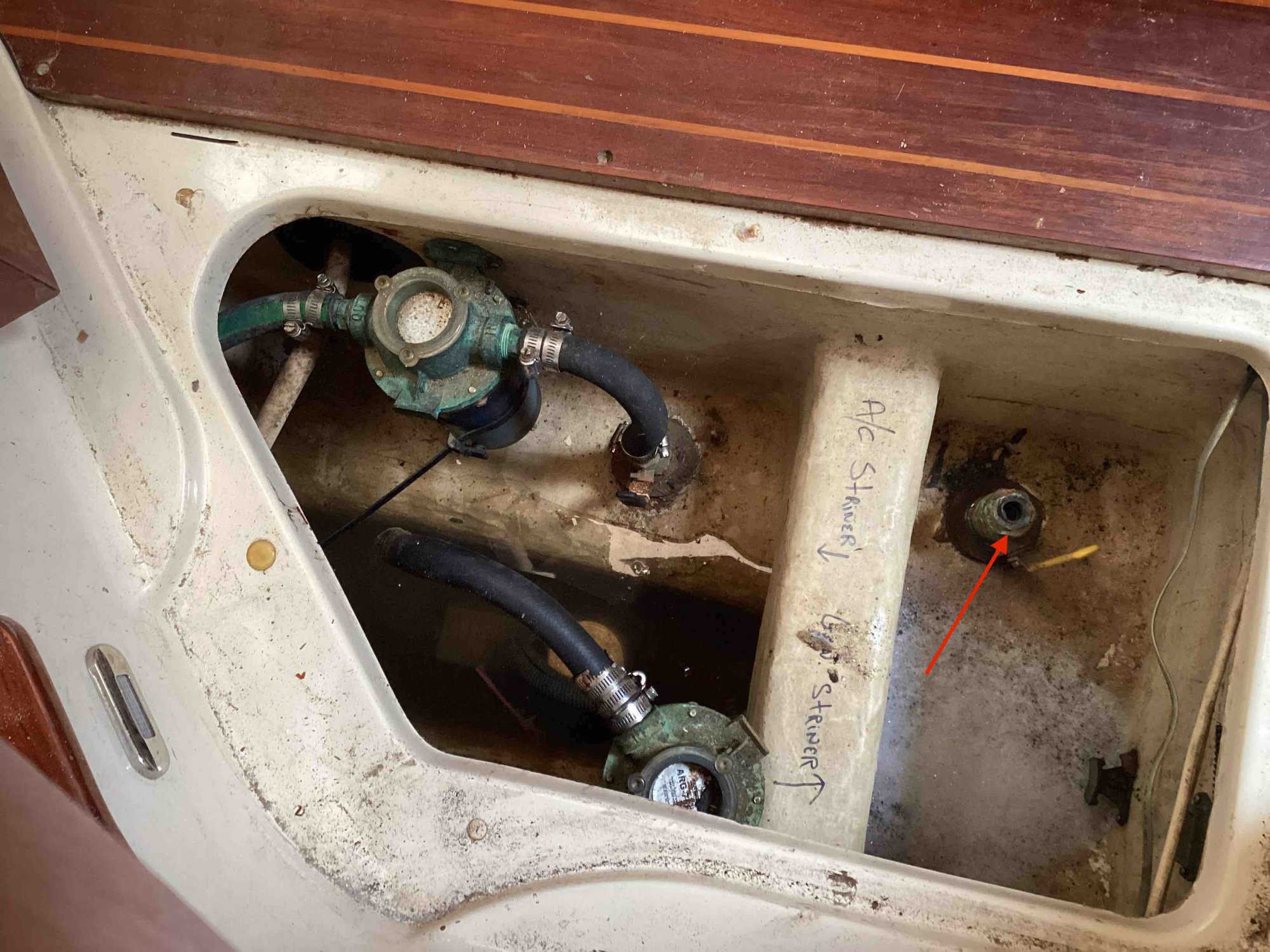

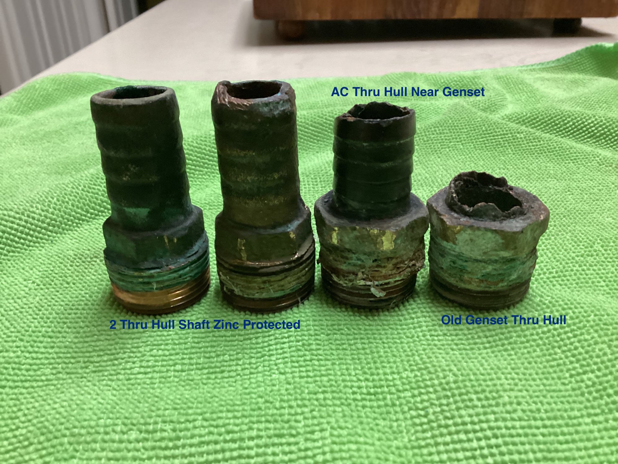

I am replacing all of the Seacocks [9] and discovered this.
This is a new one.
What happened?
The old genset, now gone, had pencil Zinc to protect it.
I found one in the Previous Owners supplies and I changed it, but the PO, never changed it.:facepalm:
Kohler said change every 300 hour of use or 1 per season.
1500 hr of use, when I changed it.
Boat sinking failure waiting to happen.:yikes:
Good thing I am now a Seacock/Thru hull expert since I read this advice.
Seacocks, Strainers & Hose Clamps Archives - Marine How To
New Kohler is now well protected.:biggrin:
Jim...
PS: Working our way back to new sails soon.
Is the generator electrically connected to the seacock? I’m sure the pencil zinc will protect the generator itself, but unless there’s a wire from that to the seacock the seacock won’t be any more protected than before.
JamesG161
Feb 14, 2014
8,105
Hunter 430 Waveland, MS
Before the discovery if I would have put a bonding wire to AC valve, then yes no bronze loss..

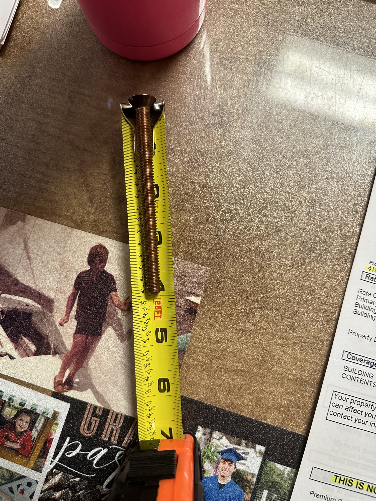

7 are done, but the 3 that have a backer plate were missing the Silicon Bronze machine bolts that hold the valves securely to the boat.
The Yard called ME to find this Machine bolts, nuts and washers. :facepalm:
So with the help of my good friend John @jssailem we began the search.
But I finally found the only place that had them.
It is a 2 man warehouse operation in Rhode Island that has almost any Marine Fastener needed.
Fair Wind Fasteners - Finest Quality Marine Grade Fasteners
Ask for Rob, and tell him James referred his business. [ I get no compensation for referring or sales]

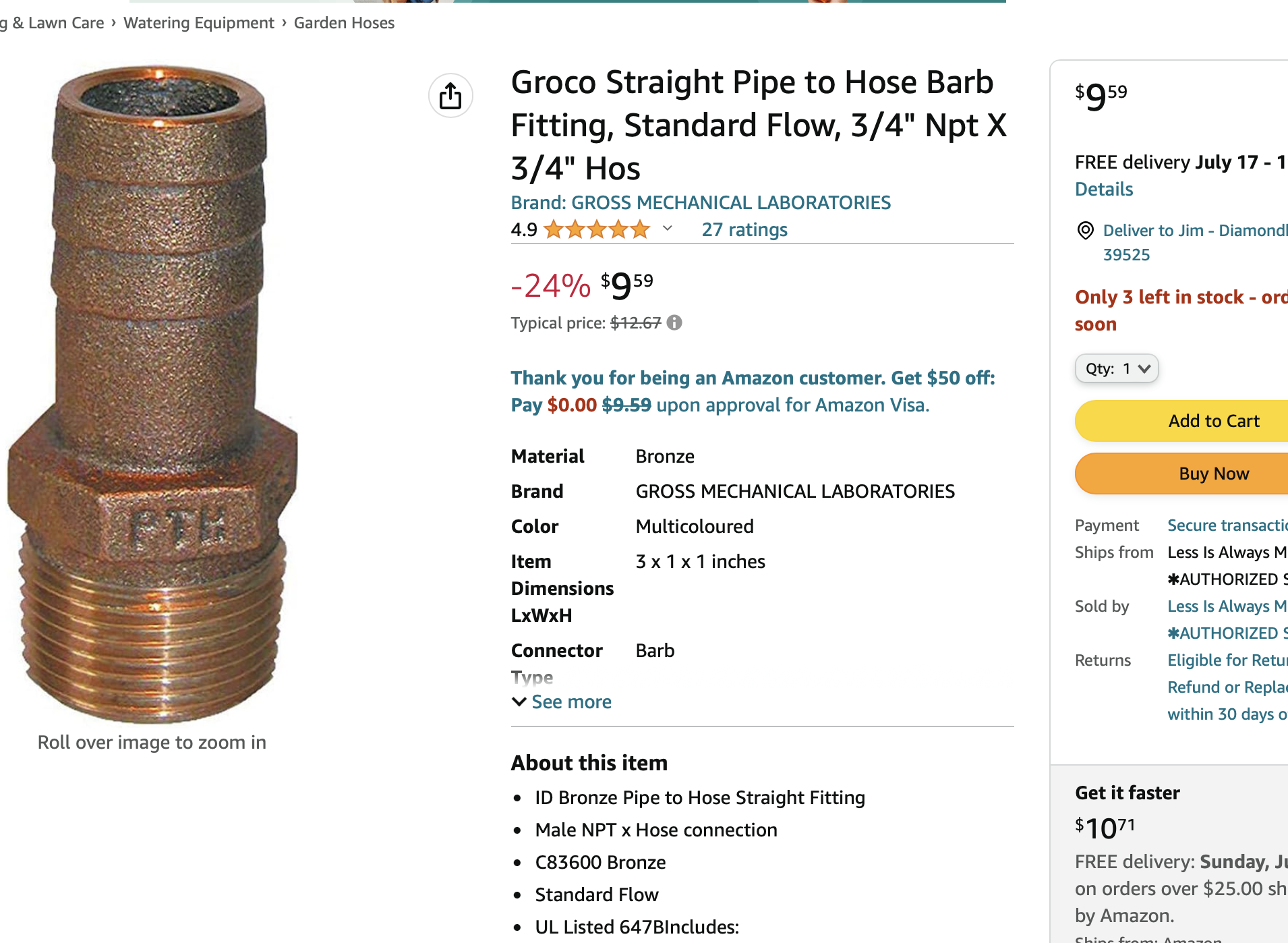

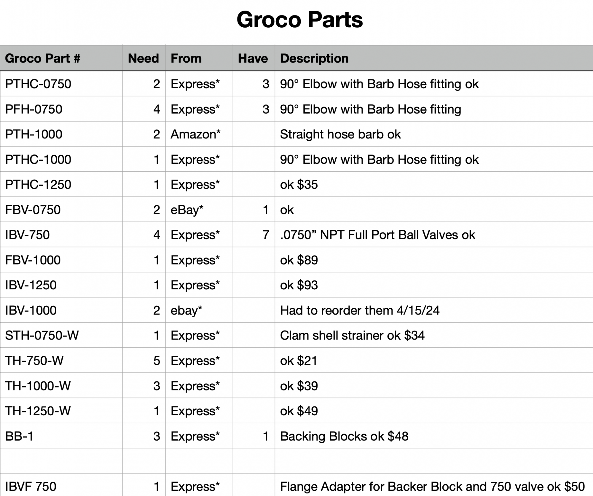

We found 10 Thu hulls on our Boat. The full parts list is very complex so I had to create a Spread Sheet.
The "*" shows where I bought the parts from. The Right column say "ok" and the lowest Price.
This site beats all prices normally.
