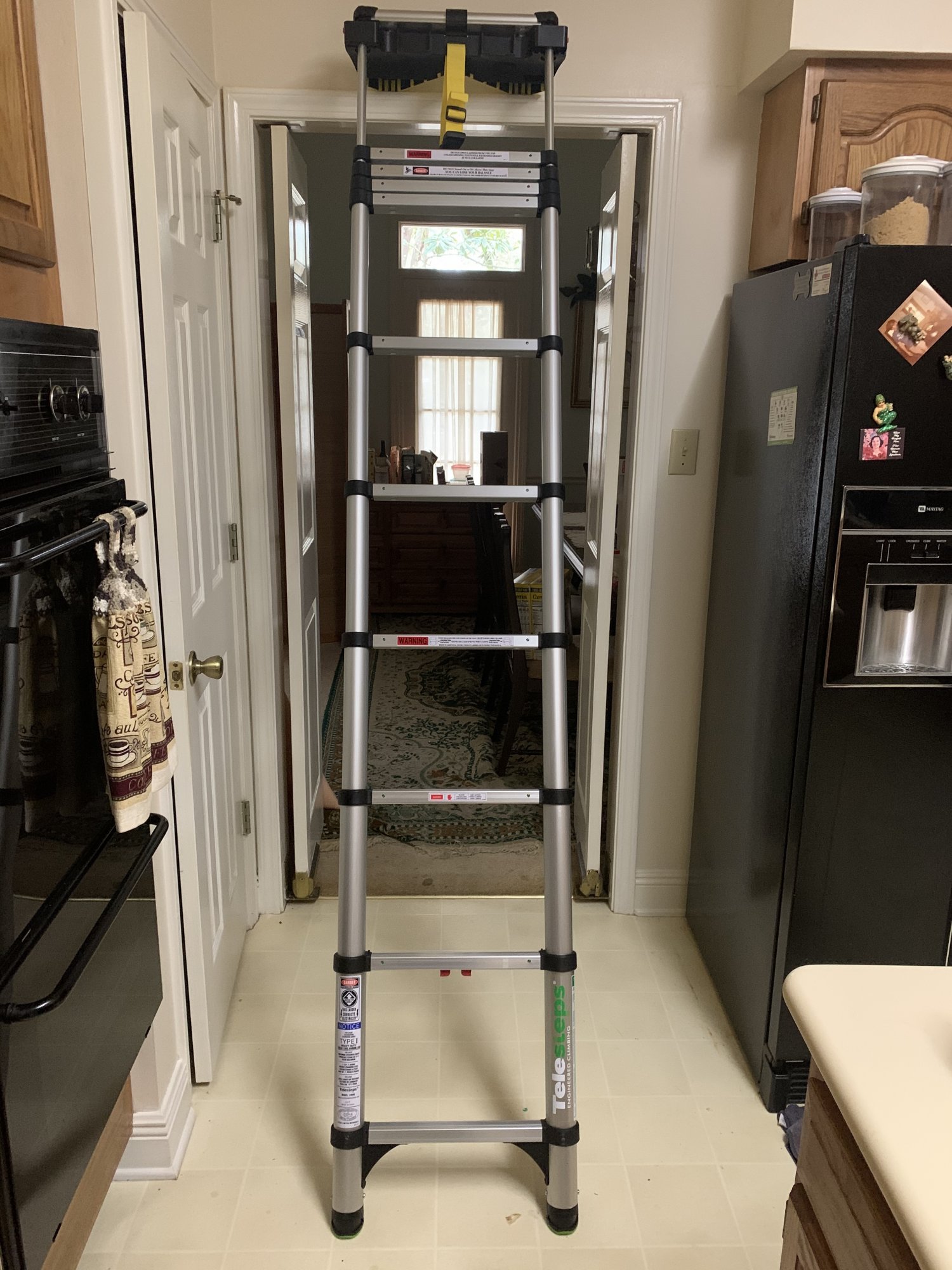

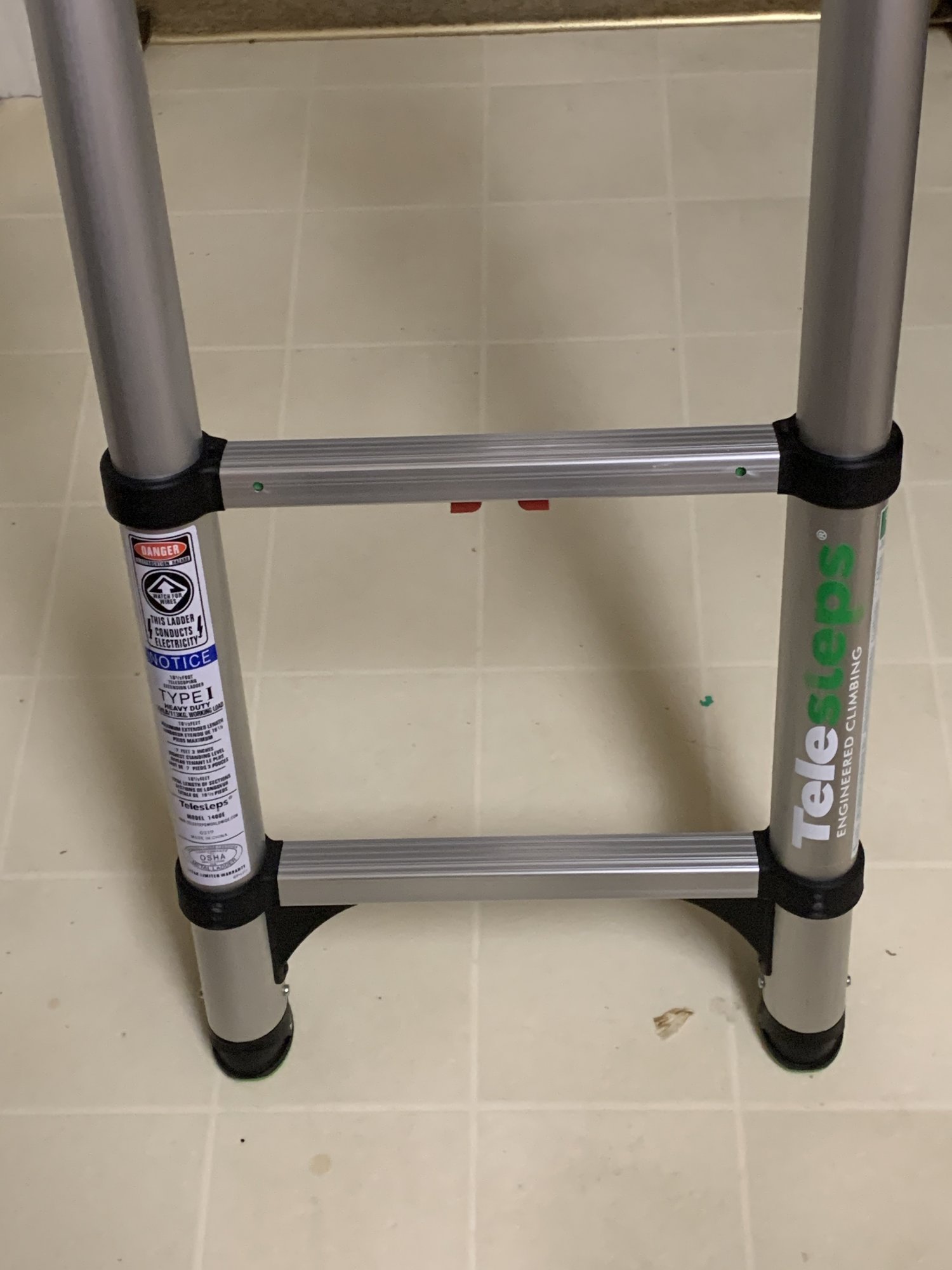

He [Dan the PIC Adjuster] brought a special extension ladder that was amazing, and I did not get a picture of it.:mad:
Very easy to board the boat.
Well Dan returned for a 2nd Adjustment to the boat and I asked him about that ladder.
I wanted that ladder, since the boat will be on the Hard for months.
This is the ladder maker.
Telesteps Ladders
This safest portable telescoping ladder, I have ever seen.
1) Anodize Aluminum
2) Can be Electrically Isolated from a Ground
3) Weighs 18.5 lbs. with adjustable heights up to 14 feet [my model]
4) OSHA standard
5) Safety indicators on each step to assure locked.
6) Fits in a bag to carry to job. 21.5 inches in the bag.
My first test in my Kitchen.
Note 2nd step has a Green indicator to prove safe steps and the Red pinch levers, that releases all the segments at once.
I will put mine to good use!
They even have the Military Grade, black tactical ladder too.;)

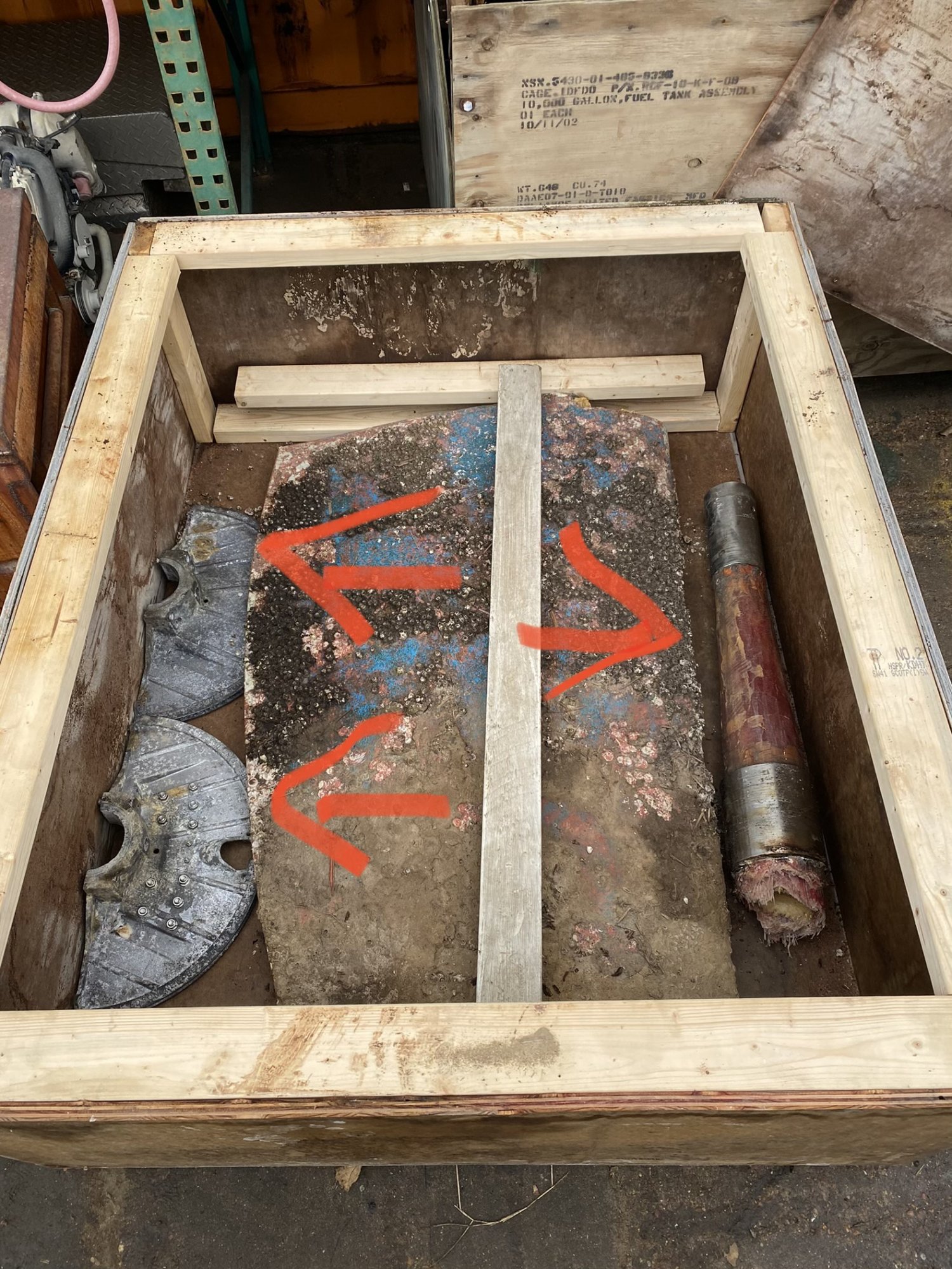

JamesG161
Feb 14, 2014
8,105
Hunter 430 Waveland, MS
Wow! It should arrive safely in that crate.
The only parts needed are the precision Stainless Steel [SS] sleeves shown on the Shaft.
The other stuff are just role models.
It will be interesting to see how they use the SS Sleeves on the new straight SS Rudder shaft.:huh:
The UHMW precision matching Sleeves to the SS Sleeves are Glued in the Rudder tube on the boat.
The RUDDER reinstallation will be another adventure in about a 45 days.:pimp:

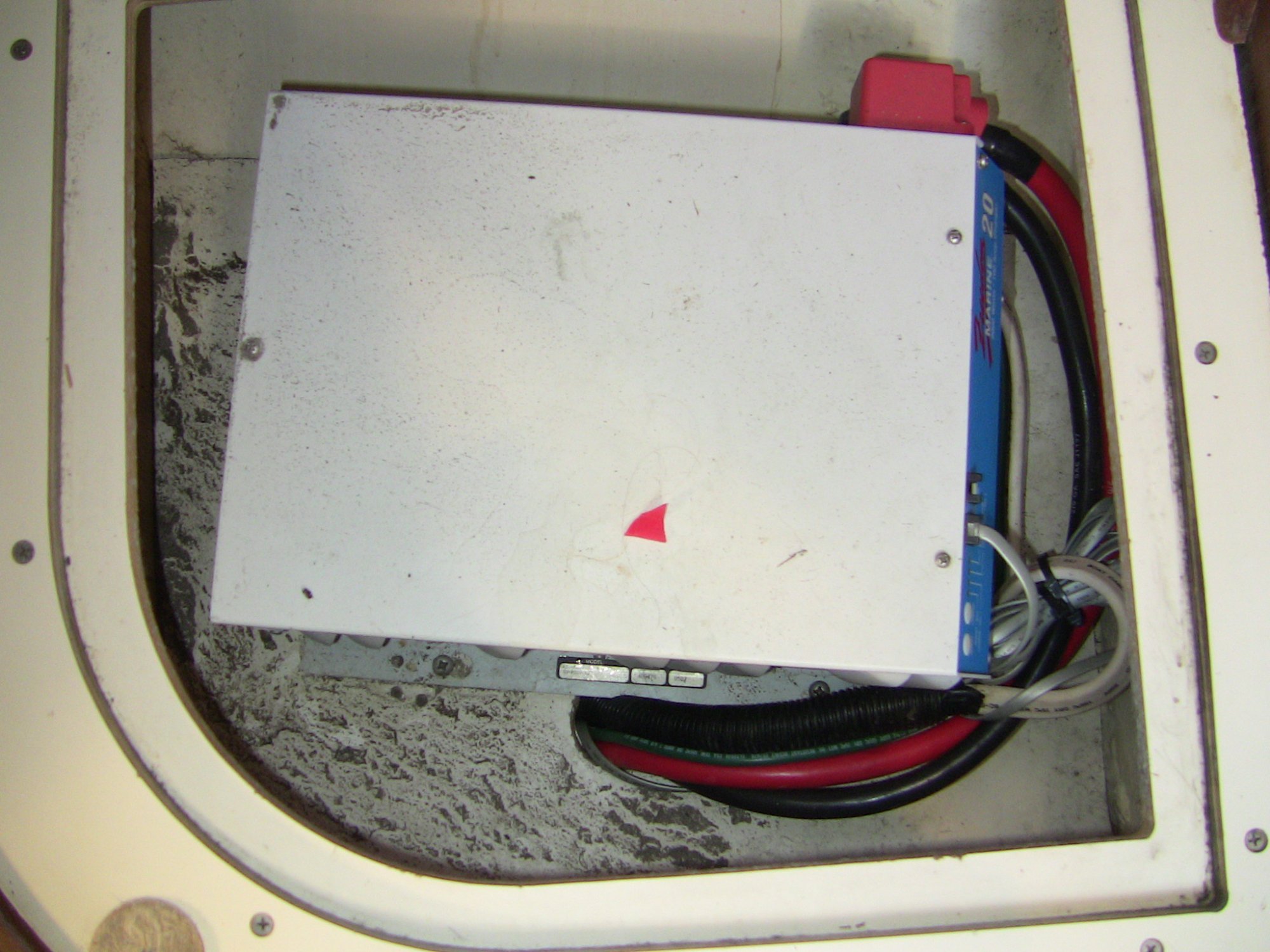

JamesG161
Feb 14, 2014
8,105

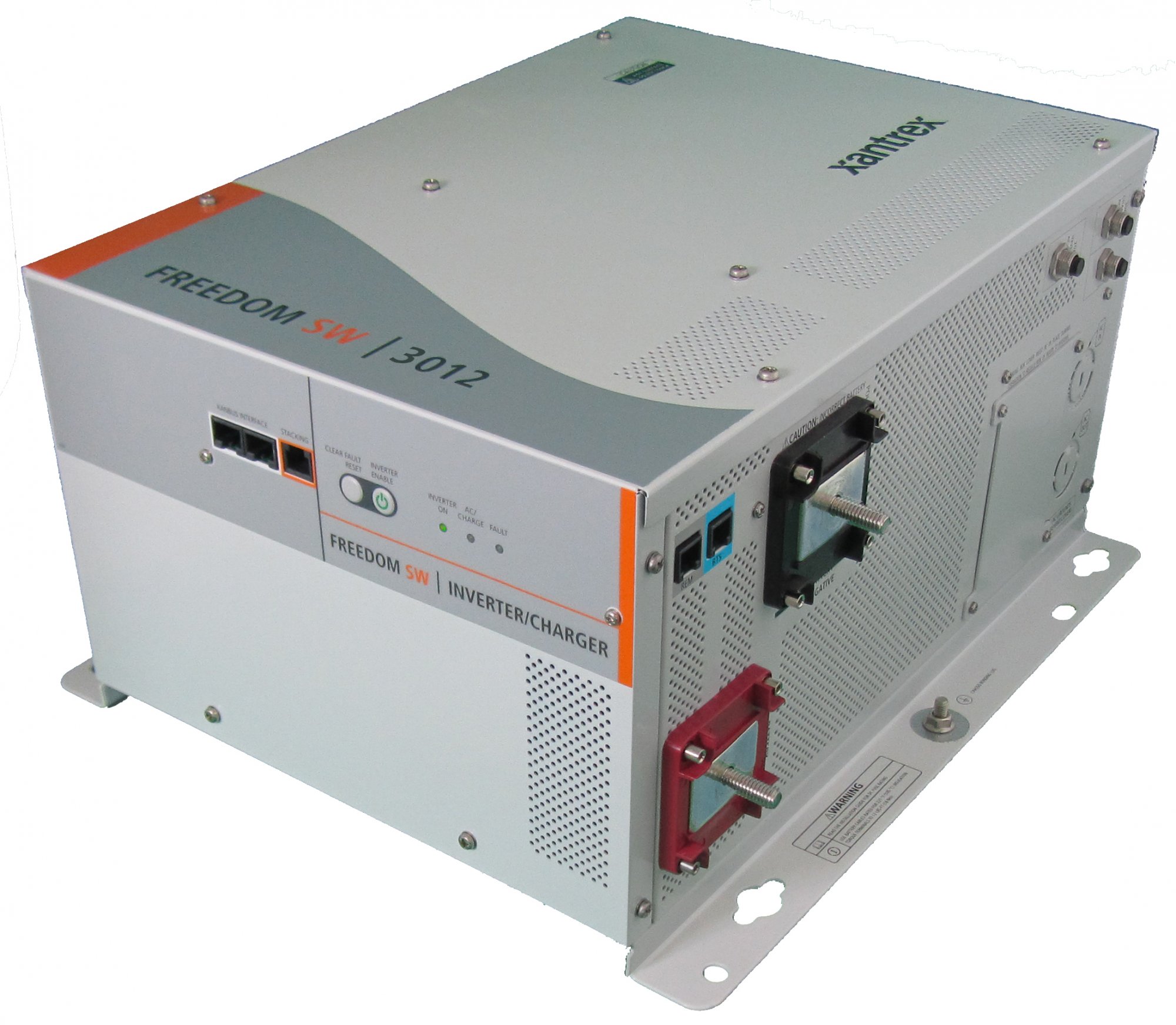

The Inverter/Charger... Figure 5 [post#41] Item 16
Brand, Freedom 20, 100 Amp DC with remote control panel.
______
It got "sloshed" through the vent panel [heat removal] to the left of the picture, not shown.
We have replaced the unit already and cleaned the power connections, which were already clean.
Megaohm the wires and Anti-Oxidant put on the terminal.
The newest Xantrex replacement is Freedom SW 2012, which has a new Xanbus control panel [on backorder] { It will charge Lithium Phosphate batts}
It did not fit exactly in the same place.
The Big 100 amp Cables [Red&Black] were too short and the inner hull, in the picture, was curved by the old plugs.
We had to clip the corner edge of the hold down bracket to make it fit nicely.
We did check all of the rear cabin 120 VAC outlet to assure they worked. [Not exposed to water]
So they are fine and being used now without need for exterior extension cords.

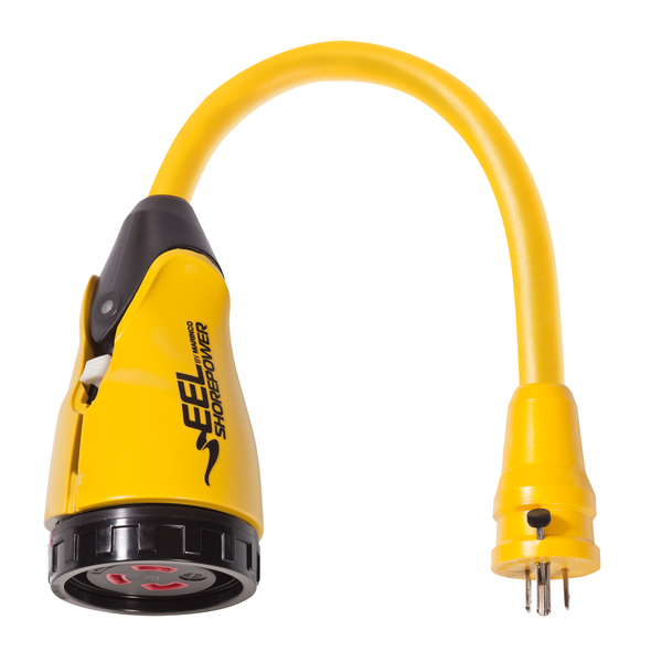

I wanted to use our shore power connection for 120 VAC so I bought this.
Works great!
______
Now our house batteries have a float charge, and we have 120 VAC aboard!!!

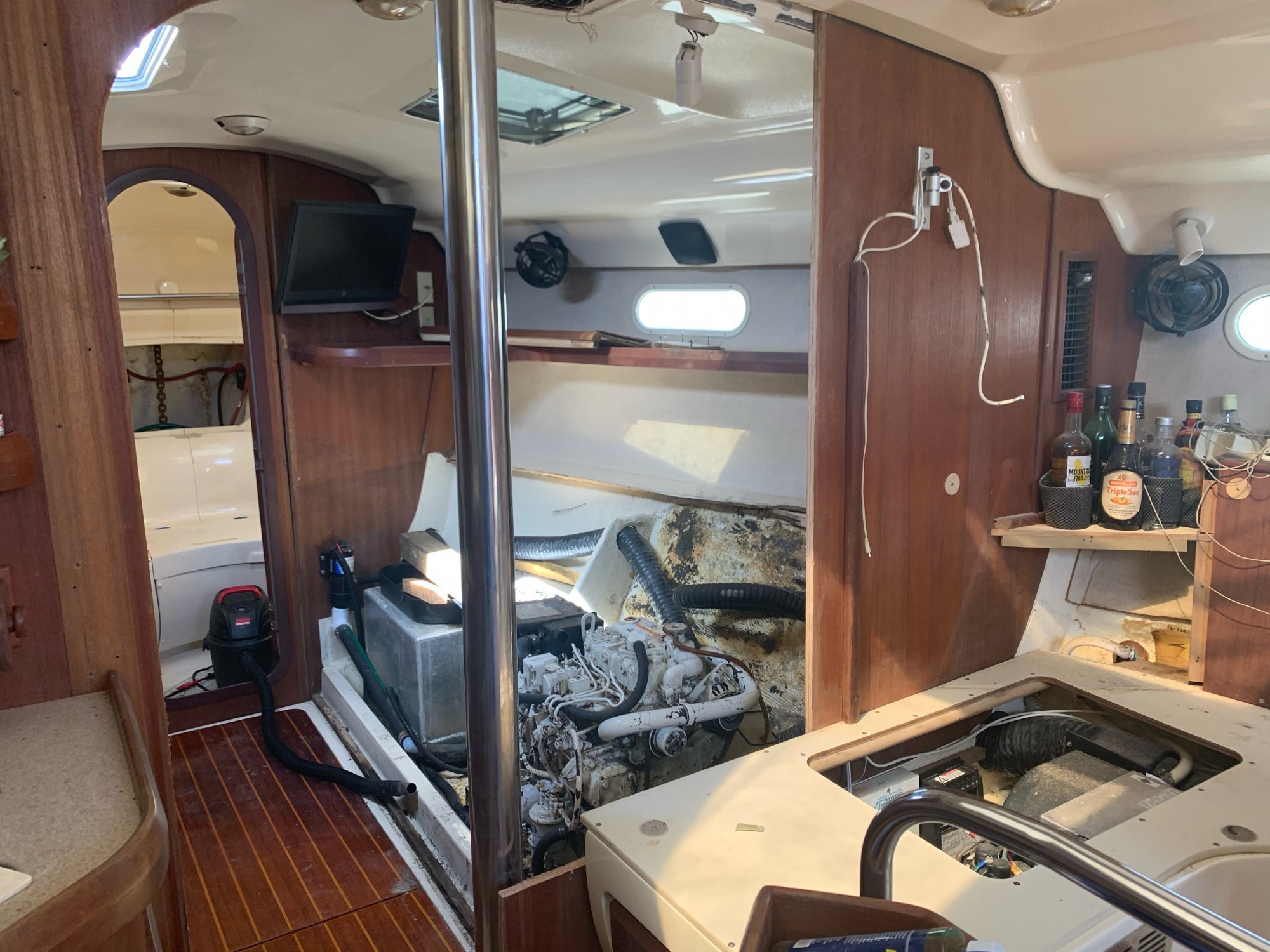

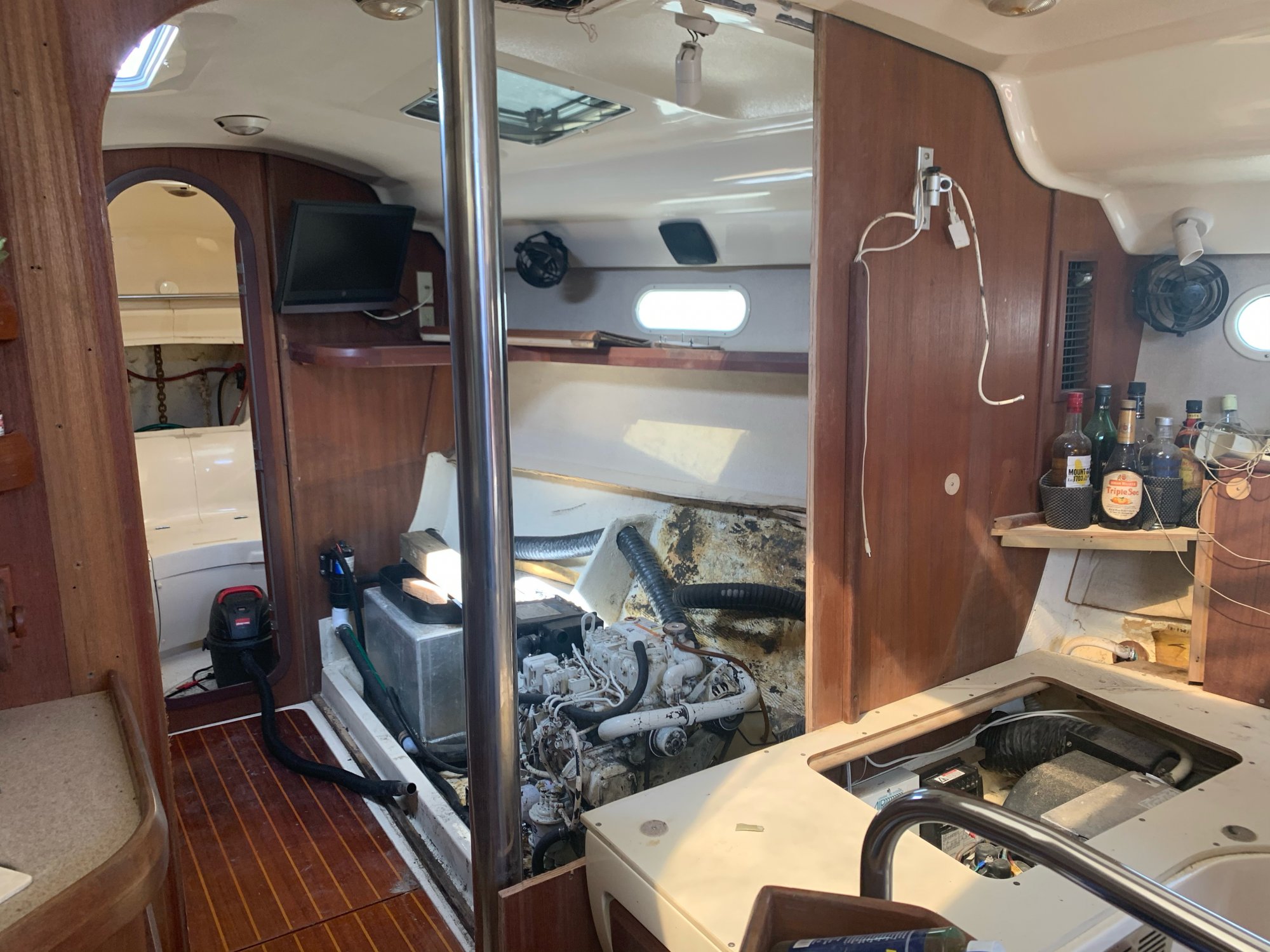

JamesG161
Feb 14, 2014
8,105
This is what you do to get a OEM Generator off a boat.
Please note I left the BOOZE on the boat.
Guess why?
Jim...

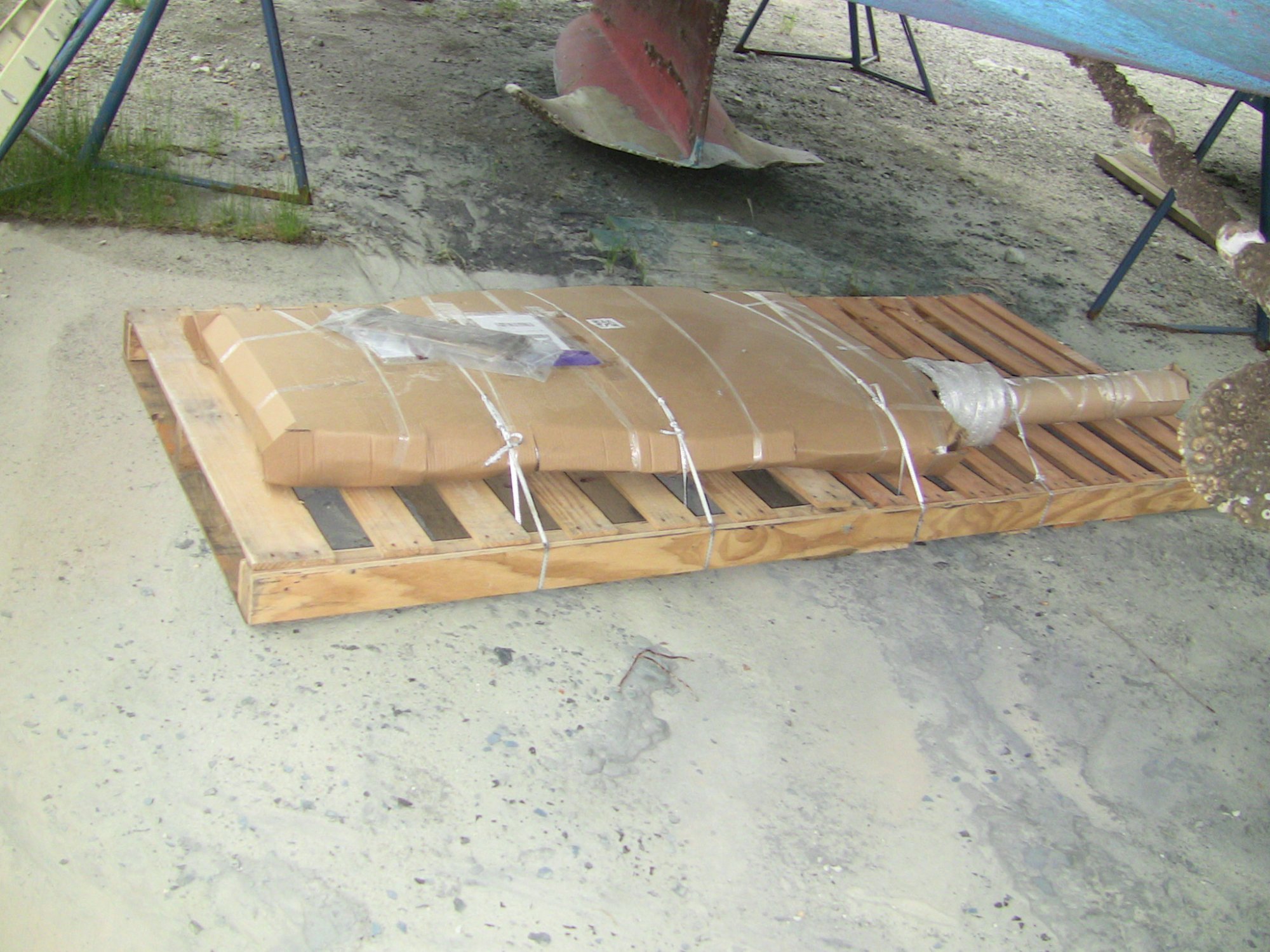

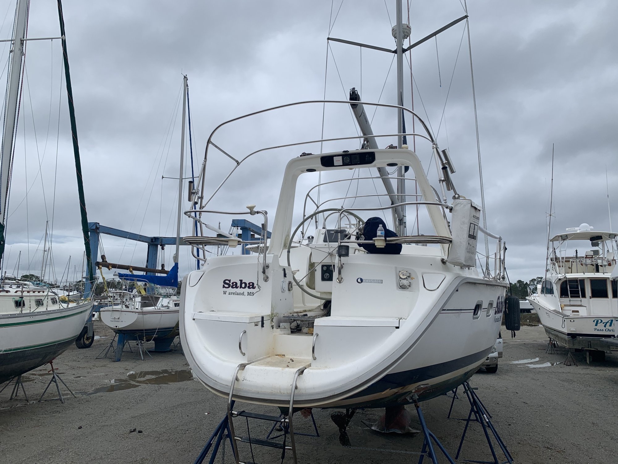

The Rudder next step...
New Rudder is here on the yard now and stored under the boat.
Good shot of my slightly bent Keel fin, too. Plus my 2 shaft Zinc.
New Propeller on order too, from SBO shops. They matched the Propeller to my Volvo Penta 50 HP transmission!
I will get some good videos during the rudder installation. Maybe share it on YouTube.:cool:
Jim...
