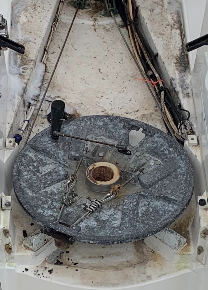

We both had the shop drawings of the Rudder bearings and a picture of my steering Quadrant, which was the key to understand how the rudder is installed and secured to the boat. Very enlightening discussion, and Joe clarified my rudder situation.

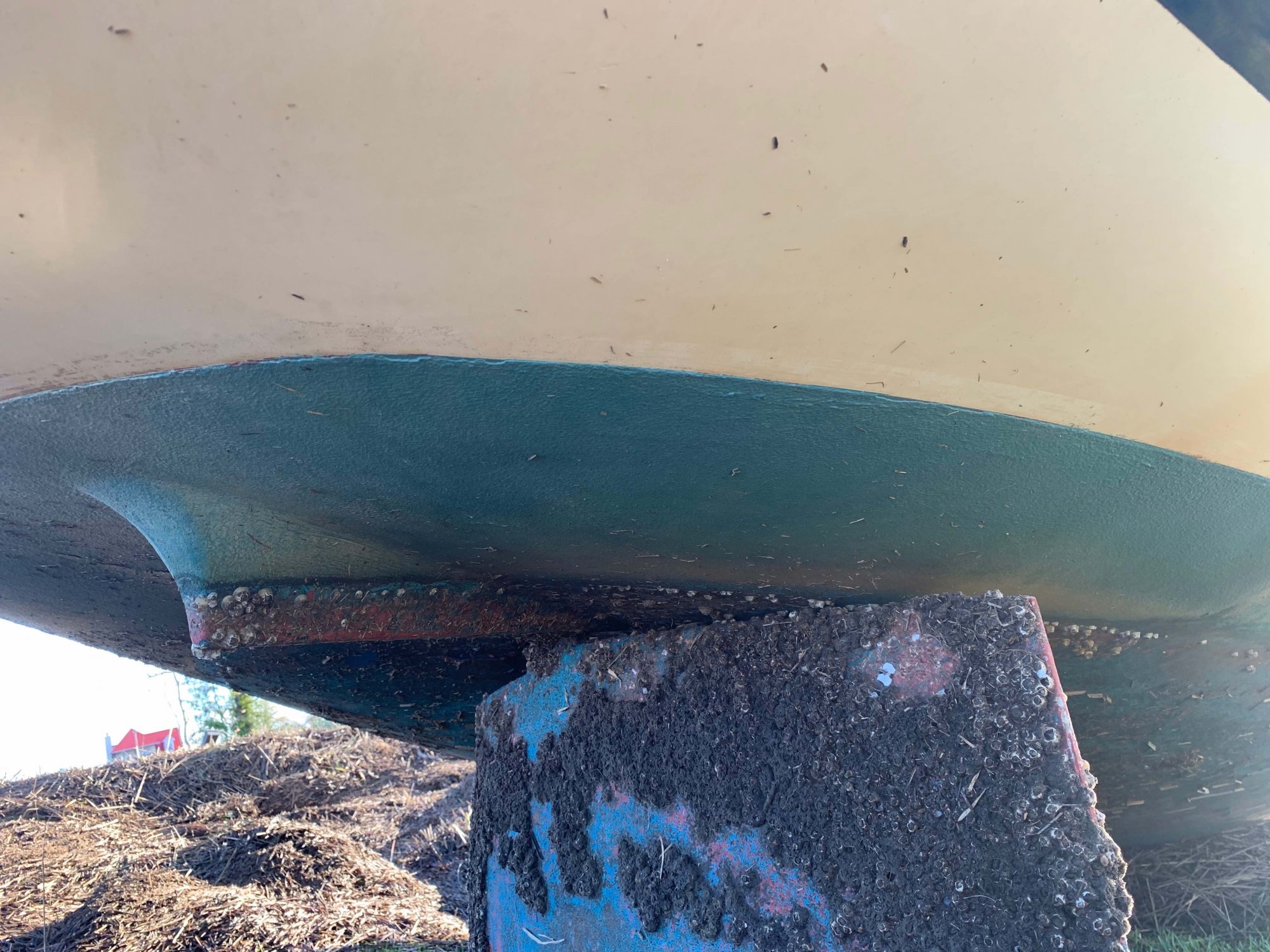

The Zeta surge wave [not rising tides] set Saba down gently as shown in picture. Note the mast is vertical.
Rudder damage, but hull intact. As the surge fell back, she settled gently to this spot.

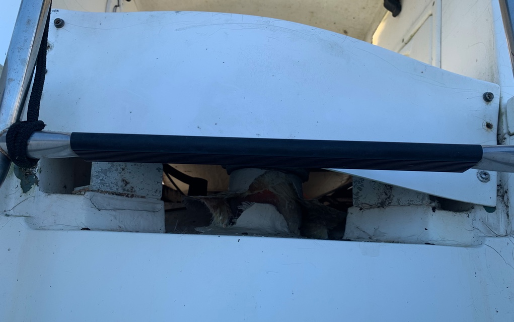

The RUDDER...
This is the obvious damage to the boat.
When we first tested the boat, I did a hard over, turn and the 43' boat made a ≈55' foot circle and very responsive.:)
Opinion: Hunter design team did a great job.

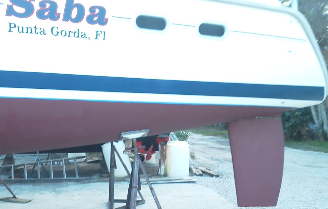

Here is picture on the Hard in Tampa Bay for general work in Jan 2014, when we bought her.
As she sat down, the keel and Rudder bore the weight first, but as water receded, the keel slipped on the wet ground, driving the Rudder upwards till it bore maximum weight.
Shown at ≈90° versus rudder limits of ±24°. To do that turn, the "Rudder Tube" that is Fiberglassed to the Hull via a passage hole in the stern. That passage hole is isolated from the interior, thus preventing the boat sinking from rudder damage:cool:
The Rudder Tube contains the Rudder bearing that are also in a "precision cut tube".
That tube is made of this material
UHMW
They reason Hunter used it... Precision cutting and very strong material for stresses.
The top part of that UHMW tube is the white circle on the Quadrant in this picture [Fig #1].
[Fig #1]
That Steering Quadrant use is where I was "enlightened" on its multiple functions, by Joe Kerr [ see post 1]
If I remove the Quadrant, the Rudder will drop freely.:eek:
The Rudder Bearing Tube is bolted to the Quadrant, not seen.
That whole area of the boat has many factors in its design.
Well done Hunter Design team!!
_____
How the Rudder turned 90° and the Damage.
If you look closely you can see the Rudder Tube and a "spiral" on outside. That spiral is the "glue" that affixed that Tube to the hull.
Hopefully that Rudder Tube is ok.
____
The good news is my hull it water tight!!

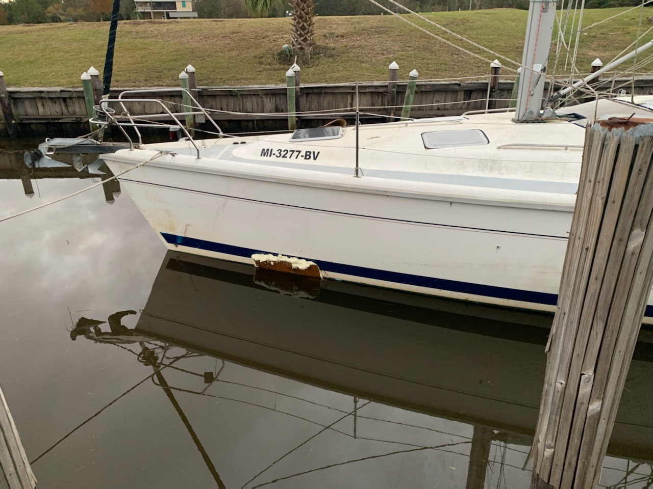

Well the Admiral and I decided to take a Sunday mid-Afternoon ride down to the boat.
When we rounded the bend to see our boat...
Admiral screamed....
The Boat Has Moved!
SeaTow did not call me
and lifted the boat back into the water.
I guess they did NOT want the owners around.
There was a Hairline crack below water line and they put a patch on it.
The good news is she is afloat again!!!:biggrin:

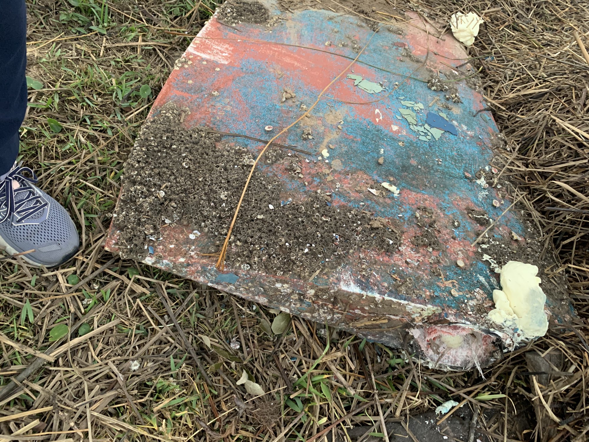

where you're going to procure a new rudder?
Yes the rudder broke off on the lift, and Joe Kerr on post #1 is sending me a quote on the exact match.

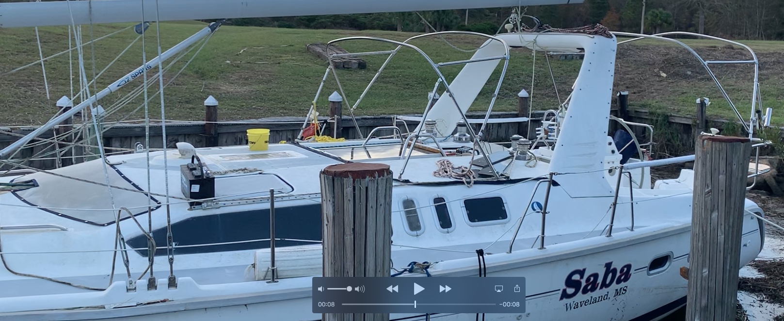

Fearful of a lot of water in the bilge, SeaTow clipped off my cabin way lock and put on their own bilge pump.
You can see the SeaTow yellow bucket and battery in this picture.
SeaTow came prepared for sure. You can see their portable generator in the cabin way.
Also our brand new CO detector was screaming bloody murder. I did a video and the noise will wake everyone.
I was not too happy with how they left the boat tied up.
The Admiral said keep you cool, as I did when I called SeaTow.:cool:
It is a good thing I did, they had planned to tow the keel into the mud in the wrong direction.
So I am meeting them in morning to help tow the boat to a reservations in the Dry Dock tomorrow
Whew...

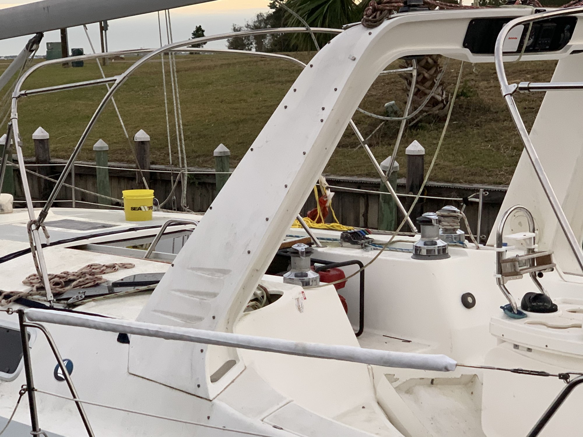

Wow what a morning....
All I can say is....
SeaTow knows what they are doing!!
They had to use their towing boat and winch off a truck to drag the keel off the mud.
Luckily we have tide 1.7 feet higher that normal.
Since no rudder, guess what they did to help steer our boat?
Sea Anchor or drone.
They tossed over a 55 gallon garbage can, to act like one, but they tied off the stern rail , not my best spot to tow, but is their show to tow. Believe it or not, I just shut up, smiled, gave them the thumbs up.:thumbup:
I am taking a short break to find the next spot I can continue my video recording of the trip to Dry Docks today.:dancing:
All dry on interior and all stuff stored below.
Onward we go...
Jim...
