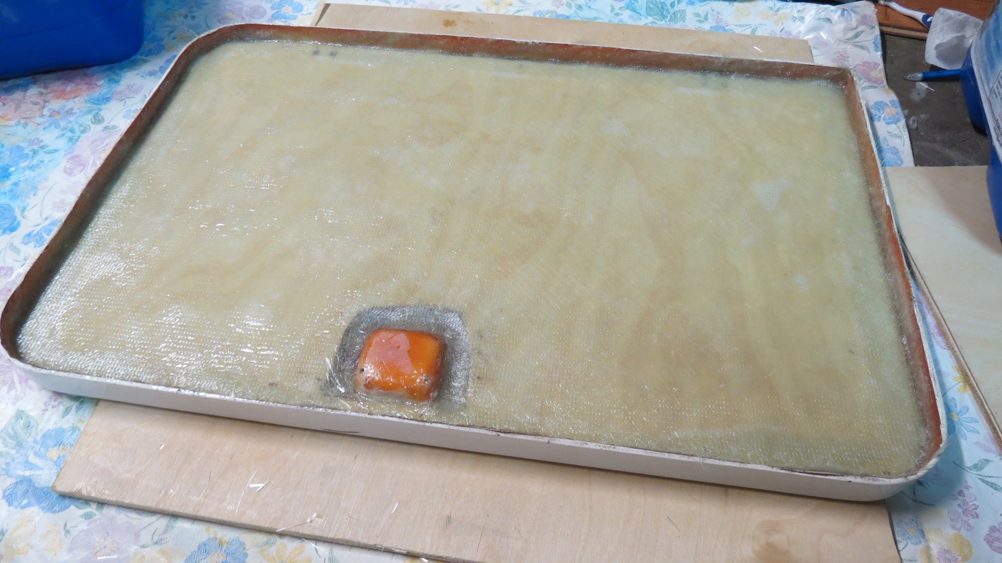

Then laid up some fiberglass plywood and fiberglass
Not a perfect job but expect it'll do the trick.

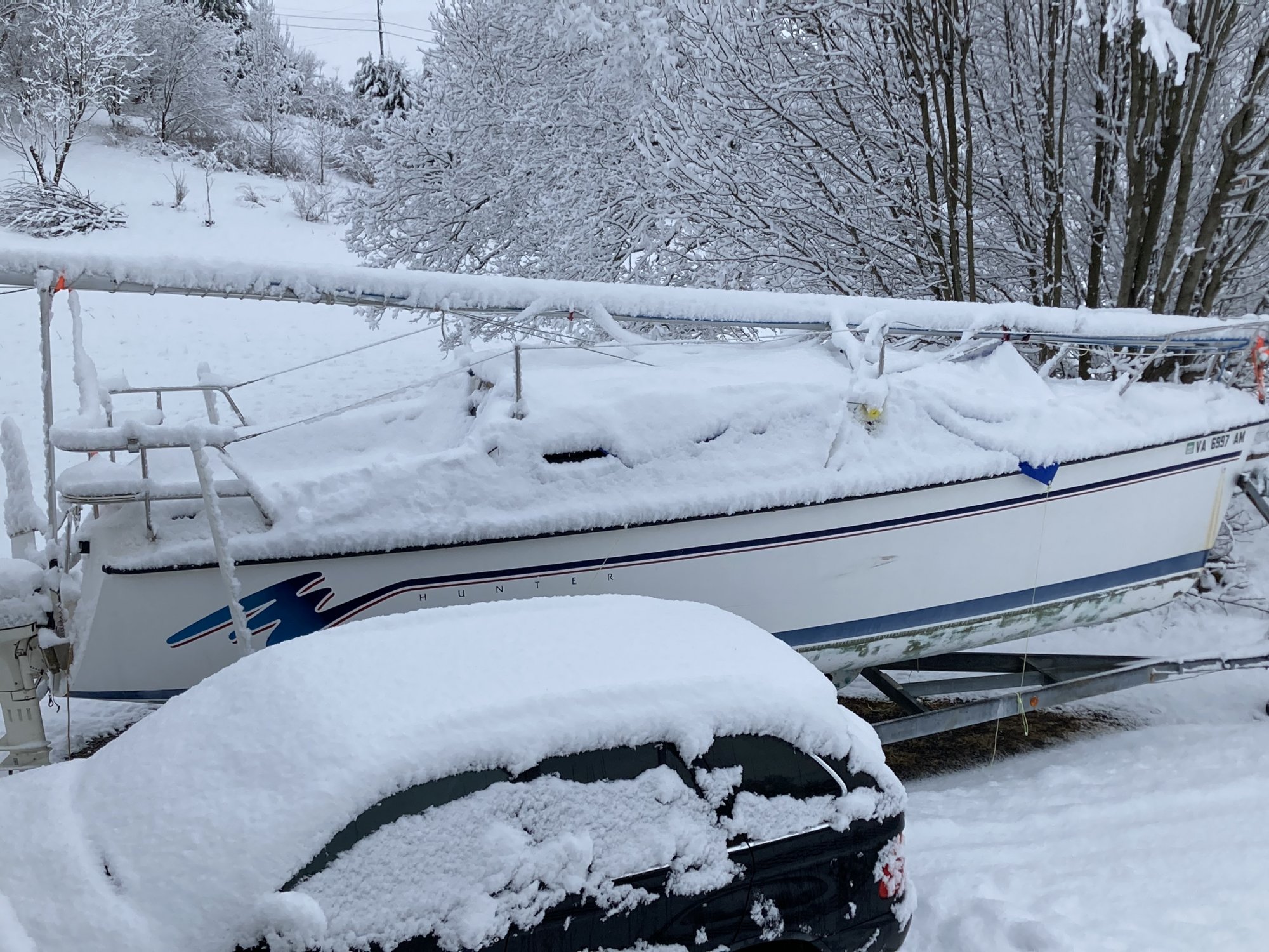

Oh this morning we wake up to this:
It's so not funny :)

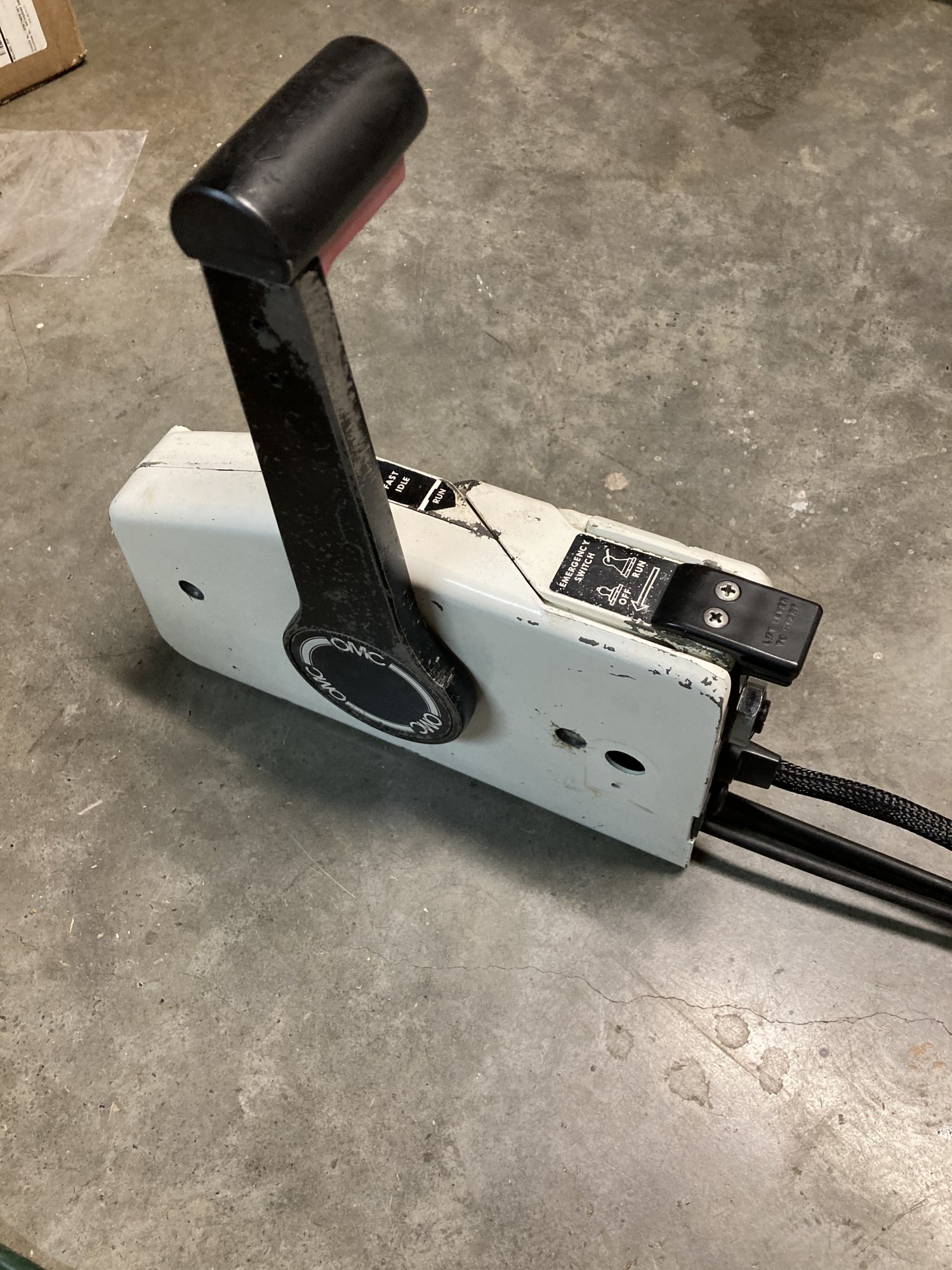

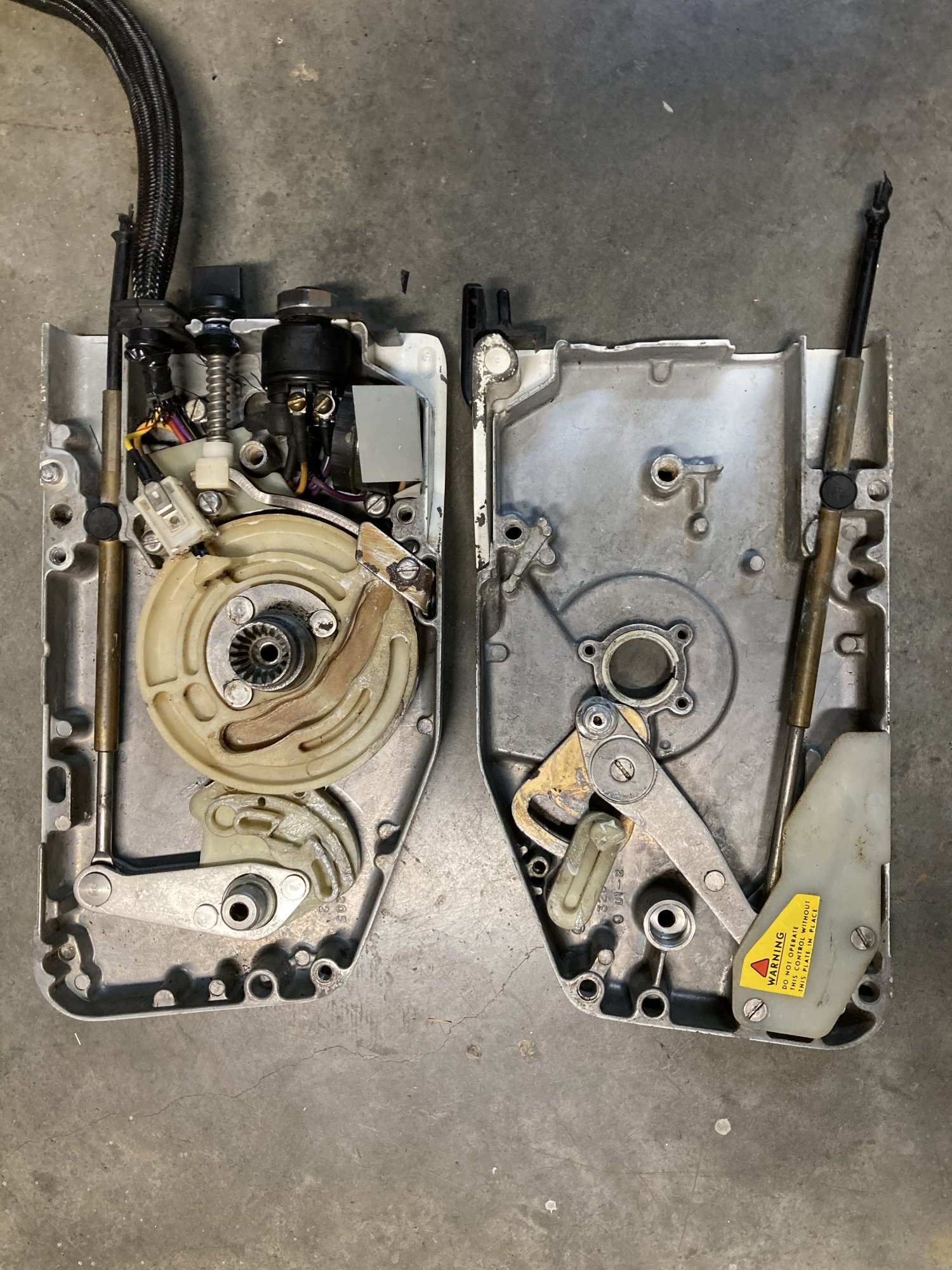

Feels like not much happened this week. But did get a few things done. The remote controls I ordered (used) arrived. I disassembled them for cleaning and improvement. Here is is cleaned up.
in addition to cleaning I replaced the key switch. Had planned on using the key switch from my boat but it was identical except missing the start pole from the switch. The start position is one of the key features (punny) I was happy to be adding. So new switch it was. I also had to add a wire for start to my boat wiring harness. Added a wire for electric choke too but probably won't be worrying about that. At least for now. So the control side is done except for the new control cables which should arrive Monday.

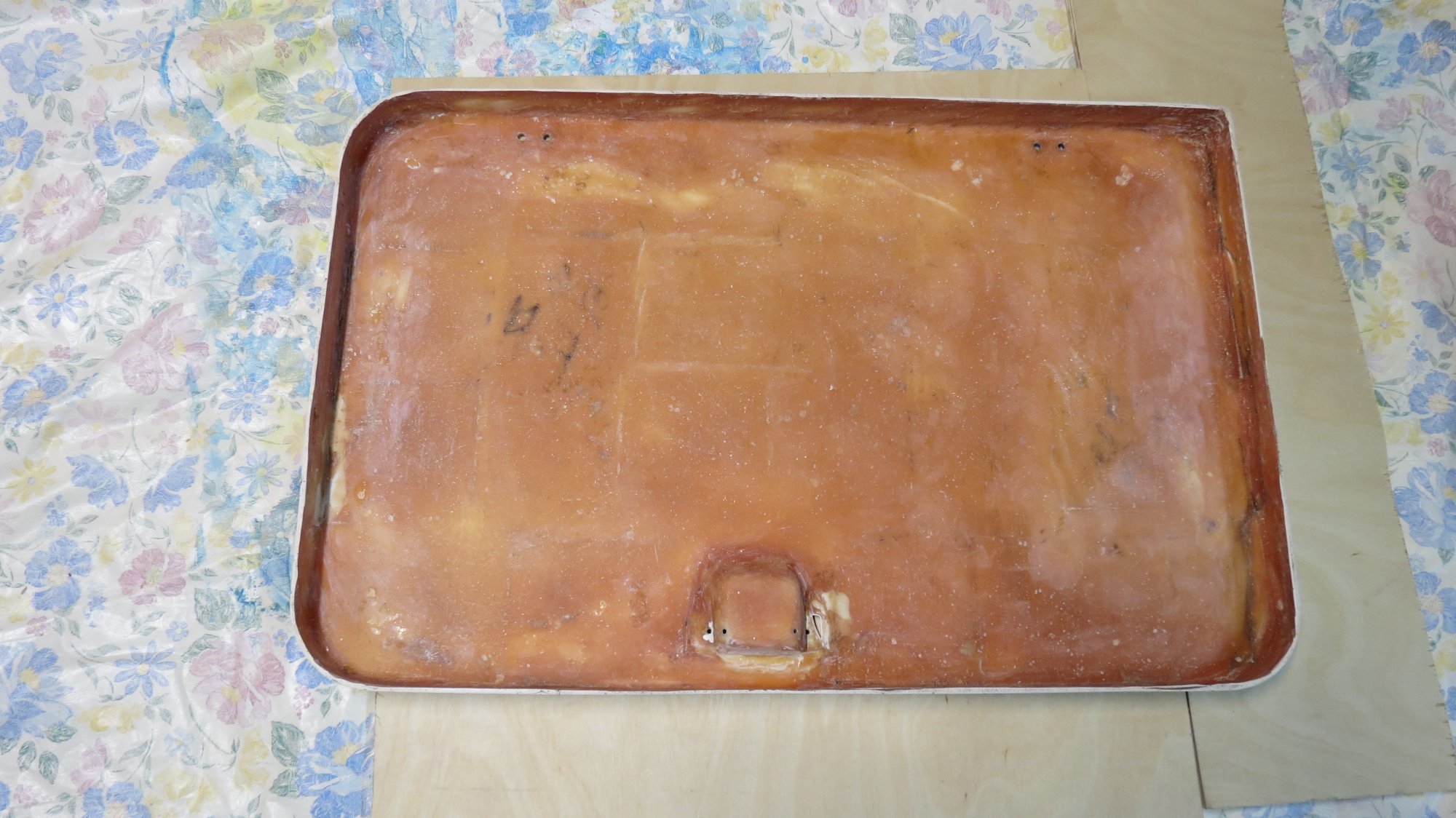

No picture but one of the hatch boards that was under the bed had been warped and cracked from being wet. Flattened it out and glued it. Picked it up to take a picture and realized it looks like all the others now. So not much to show. But it was an interesting repair.

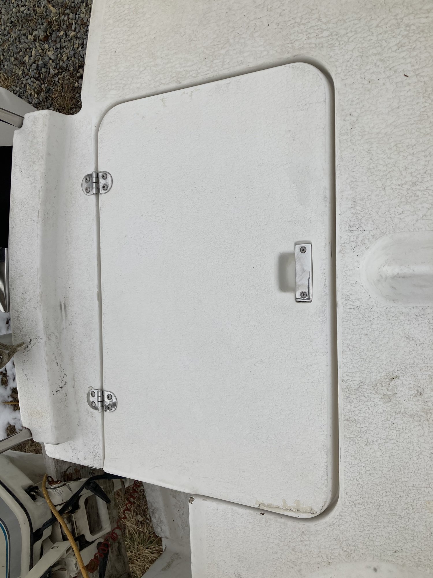

Installed the gas tank locker cover and it's great and it is as strong or stronger than new. The one bad thing is it makes the surrounding area show even more that it needs a cleaning :) . Other than the actual crack it looks great. In the future, on a warm summer day, I can gel coat the crack to make it invisible (or nearly invisible). There are a number of small blemishes other place on the boat I'd like to touch up and figure it'd be easiest to do it all at once. Not sure I mentioned this, when I redid the wood core I drilled the holes in the wood core before fiber glassing. And I made them slightly larger. So the holes are completely encased in epoxy and water can't get to the wood core anywhere even if the bolts leak. Very happy with this repair.

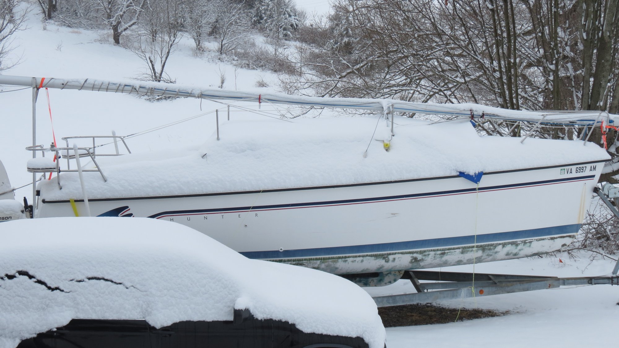

Notice in the above picture that there is no snow in it. Most of melted and I actually got in the boat a few times. That was until this morning.
more snow :-(

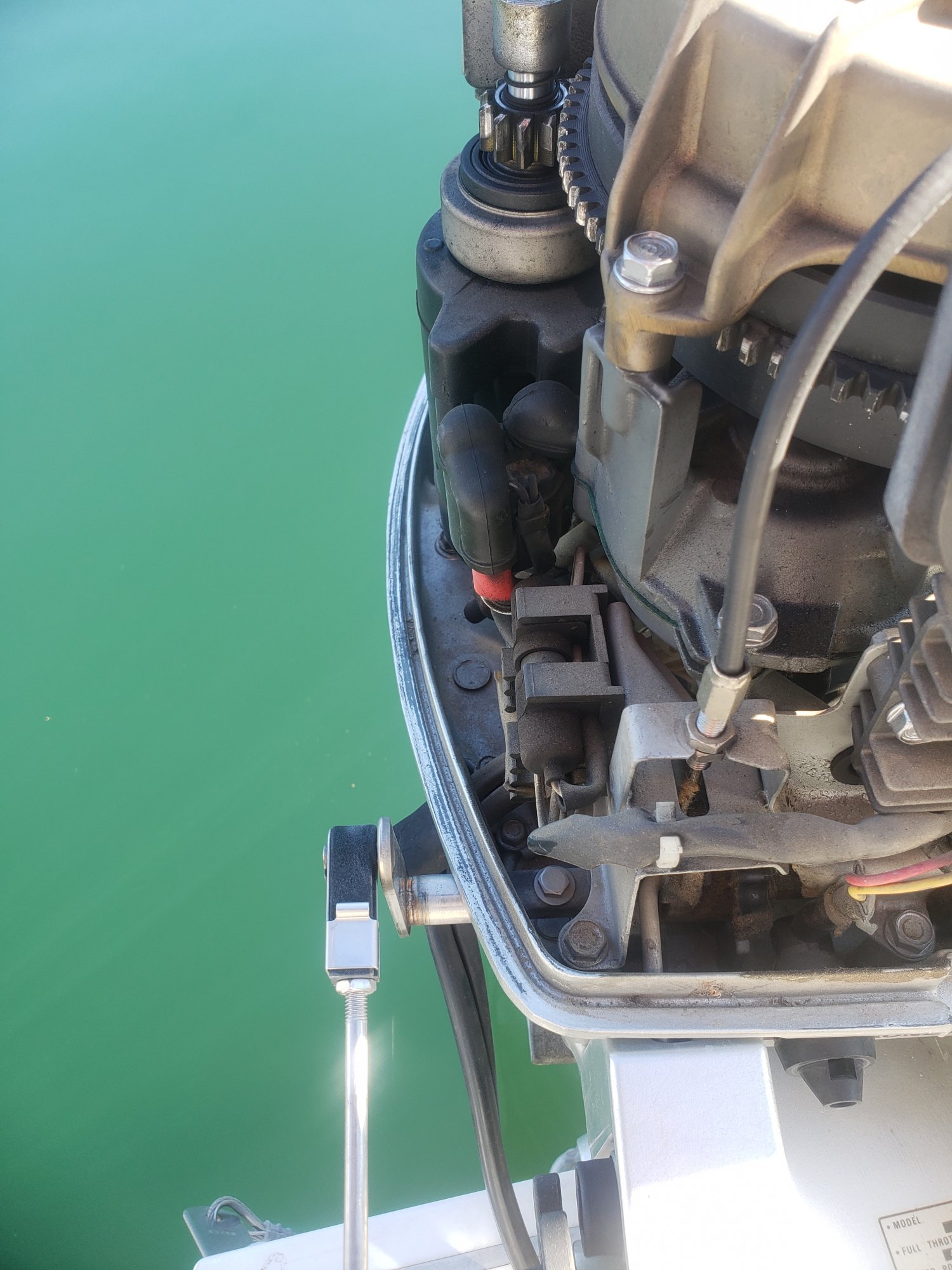

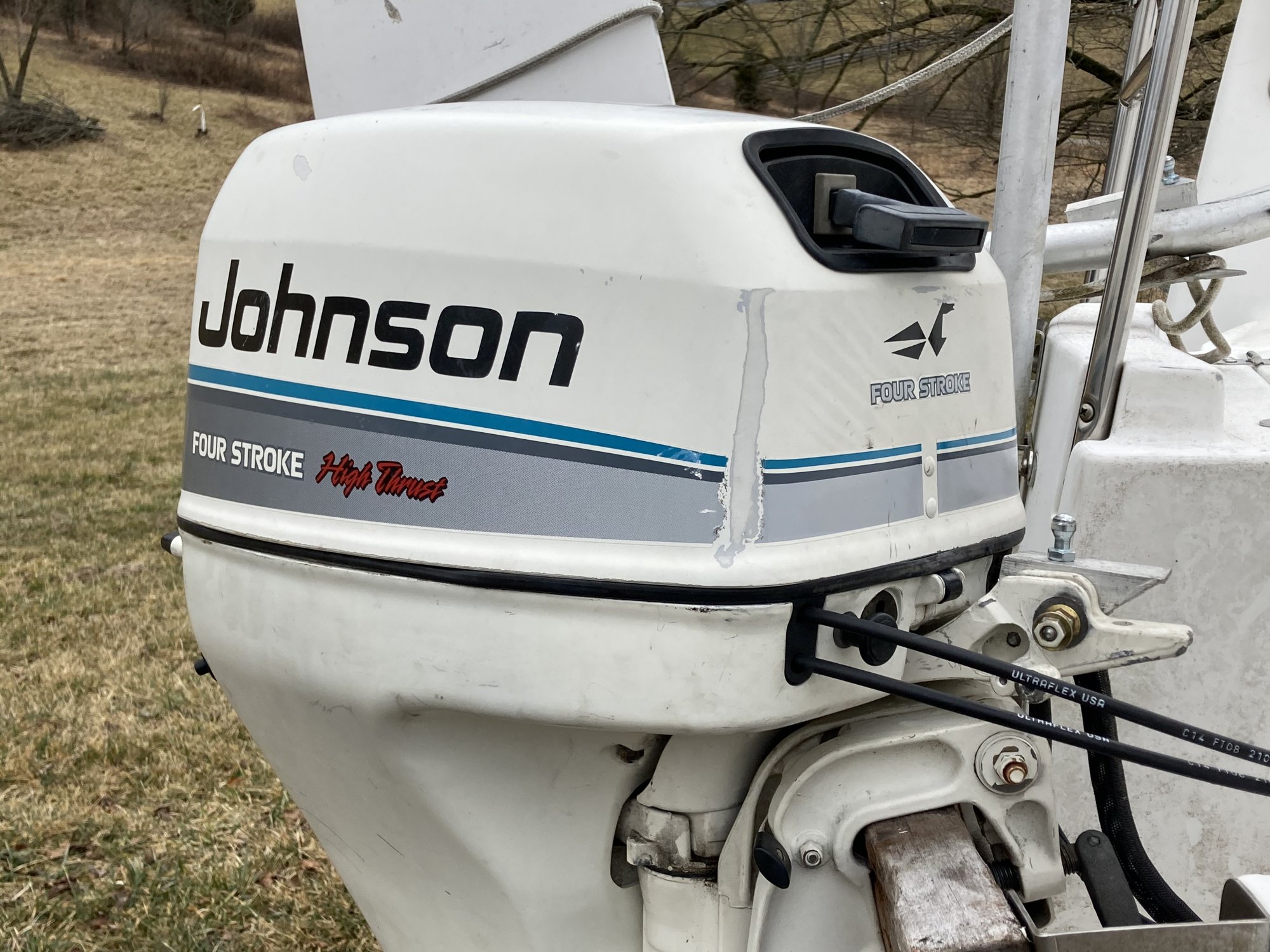

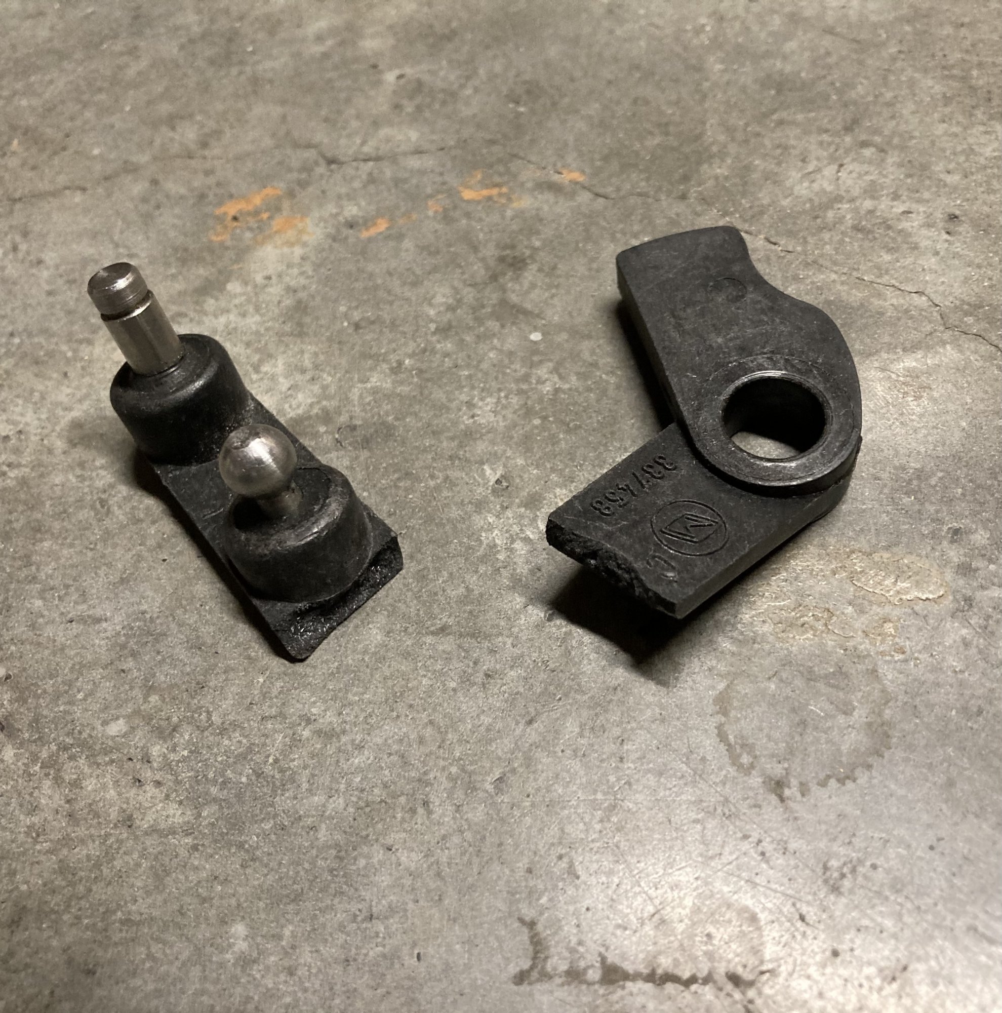

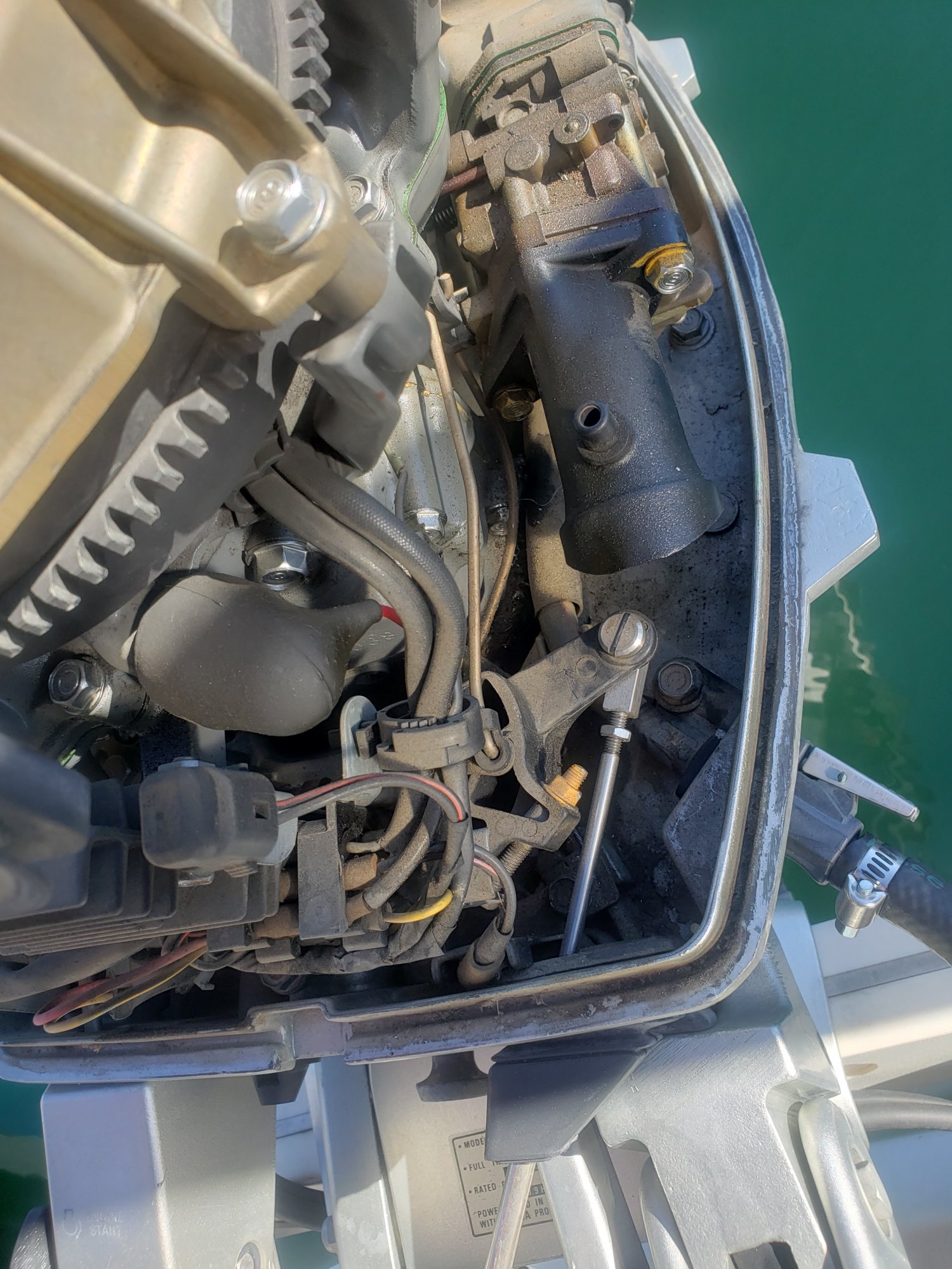

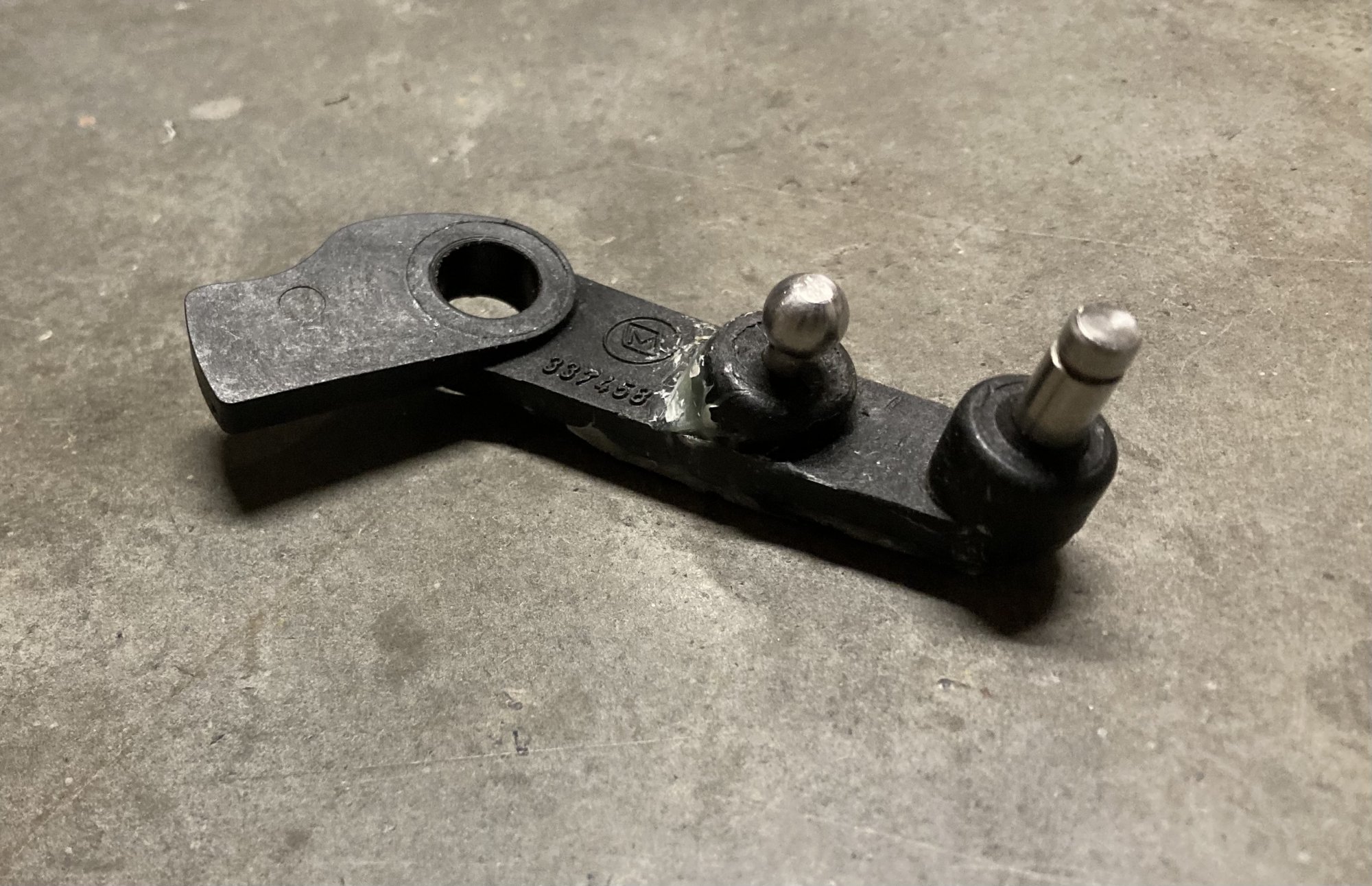

This week the cables for the remote controls came in. Opened up the motor and started getting ready to connect them by disconnecting the tiller from the throttle. When this happened
Oooohhhhhh fuuuuudge.......
Well that's not what i wanted. Had removed the cable from this before and guess i was less careful this time. Nothing some epoxy can't fix.
I added an overlapping piece on the back. It's quite strong and should be fine again. Maybe a blessing in disguise though. When I removed it from the engine to fix it I found the pivot point had grease that had turned to what is more like glue than grease. This is pretty much what I've found about everywhere there has been grease. With that cured back to the original story.

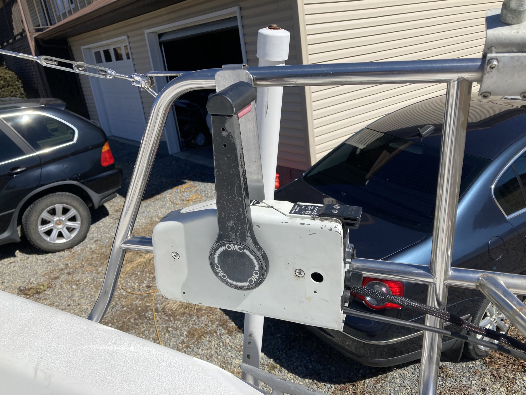

Assembled the cables to the remote control and shortened the wiring to a similar length. Removed the start switch from the motor and cut the connector off and added it to the remotes wiring for the start wire. Should be plug and play now.

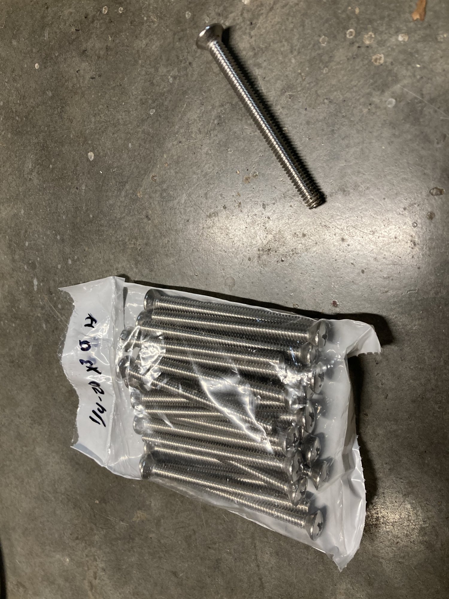

Also bought some screws and stainless to mount the controls to the boat. The OEM parts houses were wanting about $15 each for the mounting bolts ($30 total). Crazy. I bought a pack of 25 stainless oval head screws (same as the OEM) for $10 total. I have a few spares I guess. They are pretty and fit perfect.
With it all together it was ready for Saturday morning so I can go out and measure and make the mounts. Over the week the snow had melted and it hasn't snowed again. Just some rain!

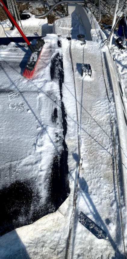

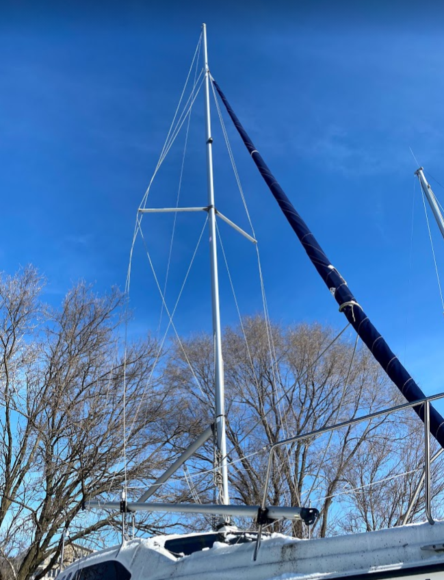

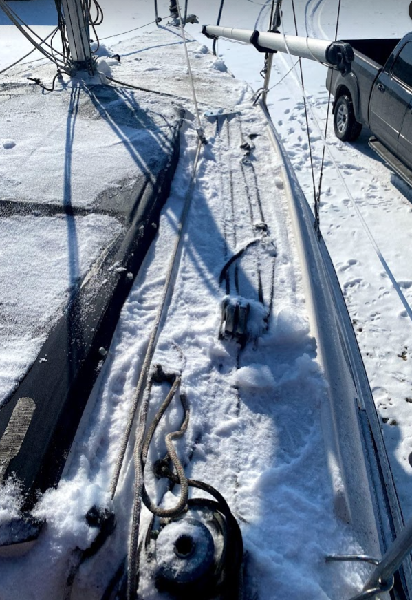

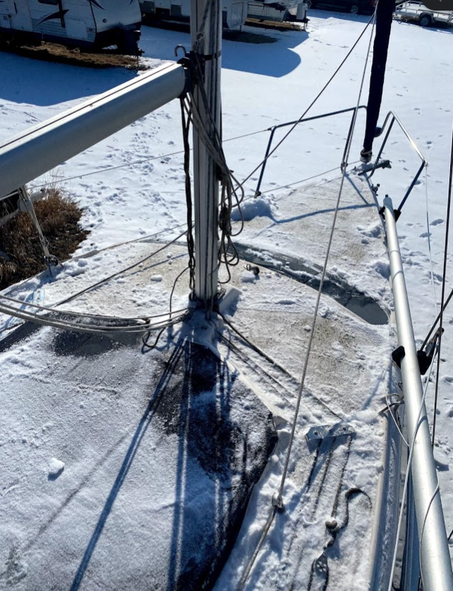

Greetings from the frozen midwest. We got above zero today so to celebrate, I went to the boat and swept off the snow. I debated starting a new thread but thought this would be very applicable here since it's a refit. Most all of my running rigging is due to be replaced so I'm going to start from scratch. I've looked through the manual and quite a few other forums but I still have a few questions. I'm self taught and rigged my last boat for a spinnaker but it was a guessing game and I made it work. My new to me H26 is half pregnant and I want to see what everyone else does. Here's a hand sketch of what I think I have. Pardon the crudeness but it helps me plan and, for the most part, get's the point across.
First, my H26 had a mast replacement and I'm in need of a pad eye on the front of the mast for the spin pole. I also need a block for the topping lift. There's a block between the roller furler and the cabin hatch and I'm assuming its there to route the foreguy aft to cockpit? Does the topping lift come back to cockpit port or does it cleat at the base of the mast? The pictures below show what I'm talking about. There are blocks and cams for the spinnaker sheets.
Missing spin pole pad eye and topping lift block
Mast base
Starboard cleats and double jam
Port blocks and cams. Currently no running rigging except for jib sheet and furling line.

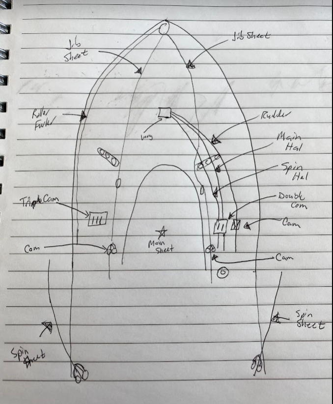

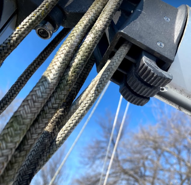

Second, does the reefing line and outhaul cleat on the boom or do the lines run down the base of the mast and back to port as well? Here's a picture of my boom and it looks like they are cams. Sorry, this one could be a thick question. Is the boom vang also left aft port? Right now the bang has a triple block with a cam at the base of the mast. I think I would prefer all lines aft for ease of single handing.
Boom at goose neck.
How accurate would this diagram be? I'm probably going to end up following this as close as possible.
My last question is does anyone have any strong recommendations for running rigging colors? I was going to do solid colors for halyards and white/colored tracers for sheets.

I can comment on how my 23 is set up, and the front of the boom looks very similar. I assume you have 3 sheaves in a fitting at the back of the boom. The three lines through these sheaves and cams are the topping lift, outhaul and aft reefing line. I don't have any blocks on my deck to lead the lines to the cockpit, I have to go to the mast to adjust. The luff of the main is reefed to a Rams Head hook at the gooseneck, which I think I see in one of your photos. Some people including me re-rigged the topping lift line to go through a swivel block that is attached to a fixed line or wire attached to the mast crane. That lets you adjust it more easily due to 2 to 1 mechanical advantage and you don't need to pull the topping lift line out of the boom to remove and stow the boom.

For symmetrical spinnaker rig- I have a 23.5. Very similar boats, except for the size, of course. My boat came with a symmetrical spinnaker, and I had to figure out the rigging myself as well. What I use works pretty well. You seem pretty much on track for what you need. You will need an eye for the spin pole, set at the correct height for the sail. My dock neighbor has a 26, but I wont be back to the marina till probably late March.
For rigging, I use a jib halyard, topping lift, down haul, and sheets. You dont really need a fore guy for this boat. You will need a small block on the mast for the topping lift. I run both of the lines (topping and down haul) to a double block at the base of the mast. My mast foot has some holes that I used to secure a loop out of line and secure the double block. The topping lift and down haul both go through the double block and aft to the cockpit. They are secured by some cam locks from the cockpit. The sheets both run full aft to the aft cleats. I use a small block secured to the cleats with another loop of line. The sheets then run up to the cleats that I normally use for the jib sheets. I probably have some pics and Ill post later if they will help.

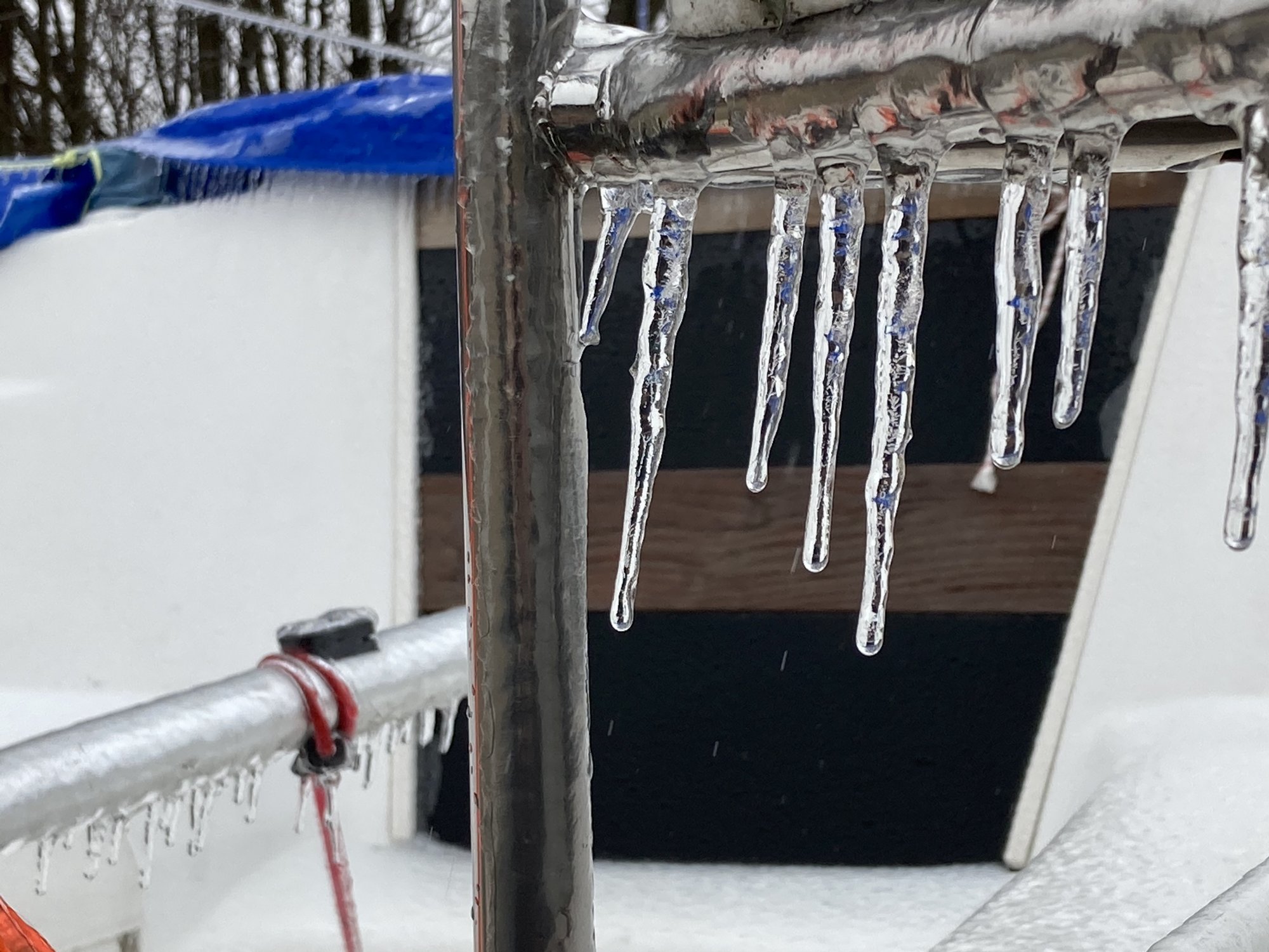

Thanks for the commends on the thread. Motivates me to continue to post :) Last week we had freezing rain again. Got tired of posting pictures of the boat covered in snow and ice. So didn't here is a post of a tree instead. That's not liquid water. It's ice.
This Friday it snowed yet again. Up north this isn't a big deal. But here they close schools for heavy frost. This weekly snow and ice isn't a typical winter. Anyway we did do some to the boat.

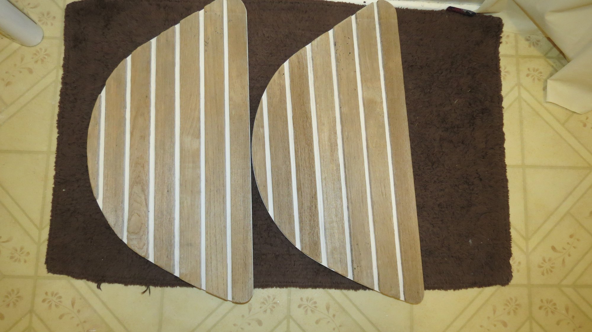

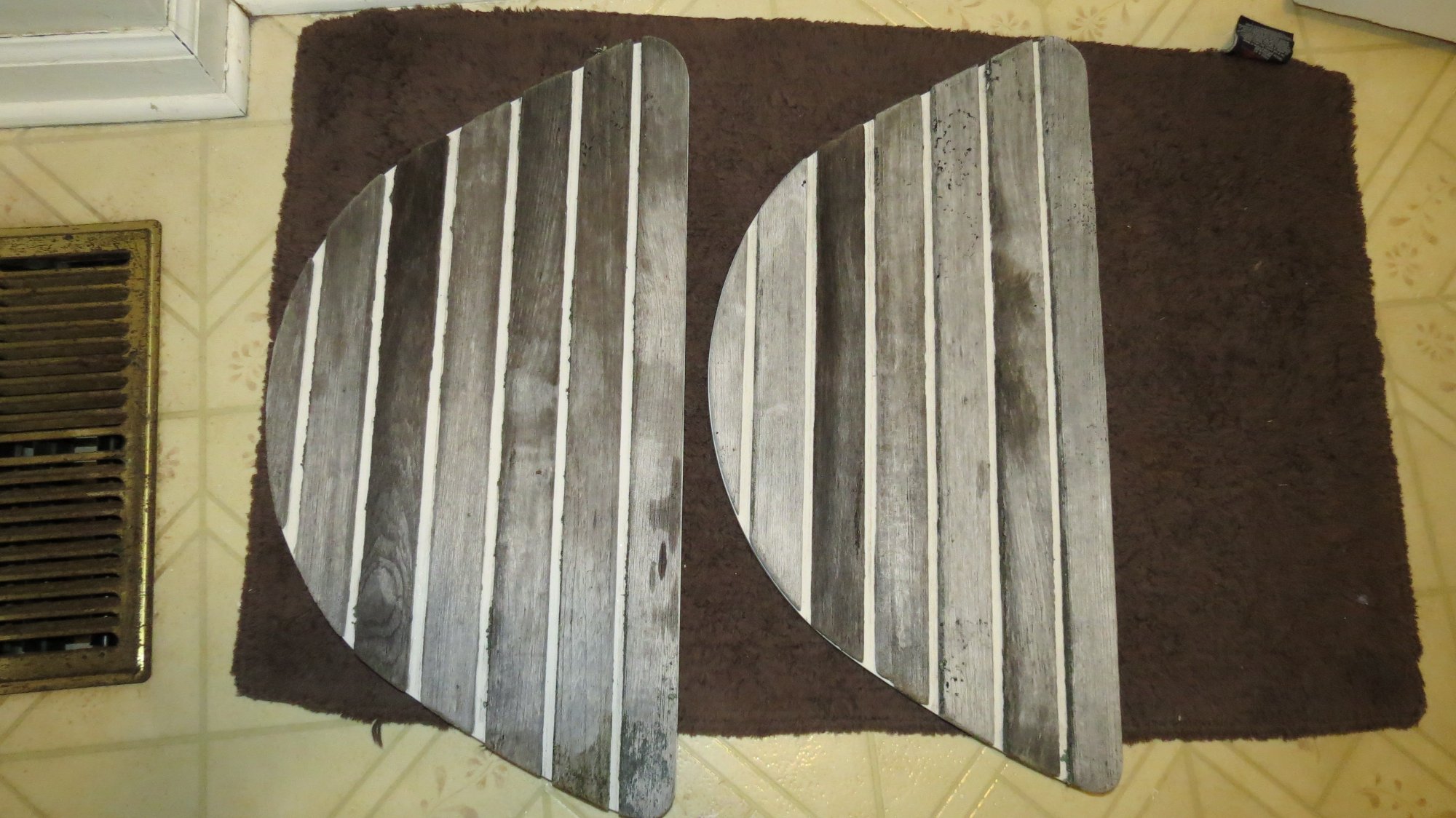

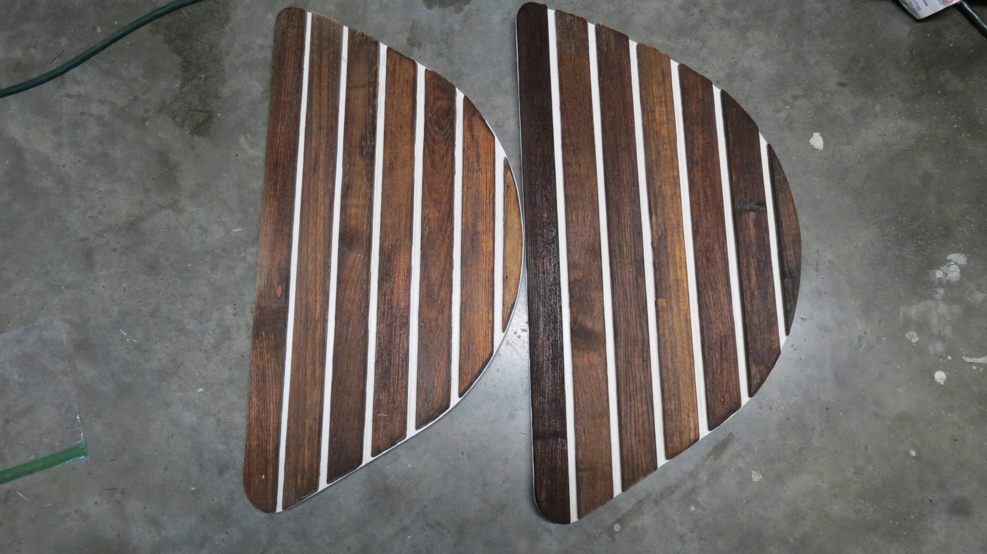

With the weather terrible we looked for something we could do inside. I took the stern seats off and Katherine cleaned and oiled them. After cleaning we found that a few of the stainless screws holding the wood planks down were starting to poke through. Sitting on a prickly seat. That's not fun. I decided to just remove those screws and grind off the tips and put them back in eliminating the prickly seat. Here are the pics
As removed from the boat
After cleaning
After oiling

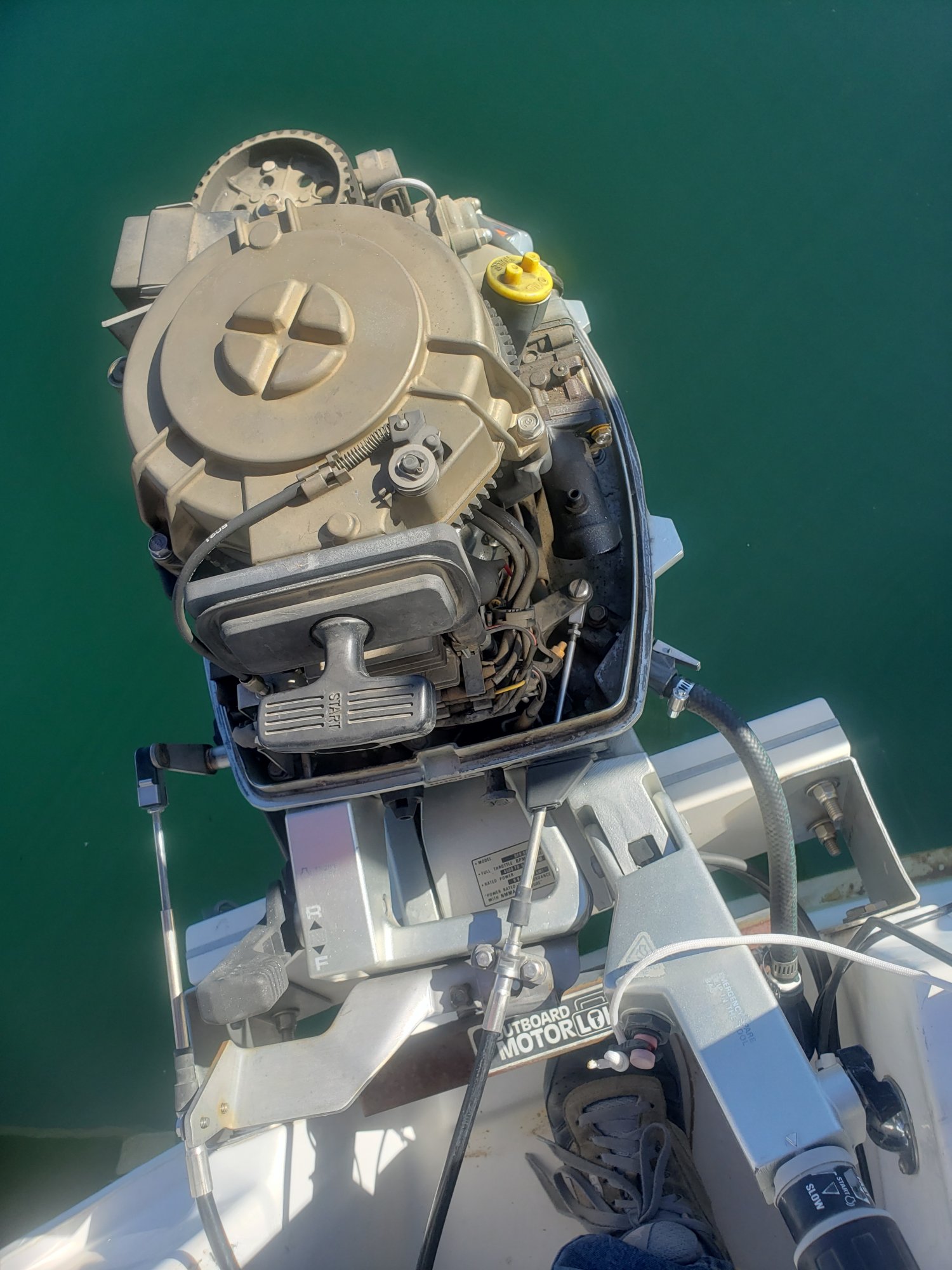

I was also able to fabricate the mount bracket for the engine controls out of some stainless and aluminum. The weather improved and on my lunch breaks I got in a little time here and there and mounted the controls to the boat. The location is similar to what a few others on the forum suggested. Looks like it will work nicely.
From there we worked on the motor to tiller link. To get the motor and tiller to turn at the same rate the connection to each has to be at the same distance from their pivot point. And the length of the connection bar needs to equal the distance between the pivot points. With the Motor's pivot point being much farther aft then the tiller it made getting the connecting link over there without fouling on something a bit challenging. Originally we looked at connecting to the back of the motor. It had some merits but reaching past the boat to disconnect was not preferred. And we would have had to create a connection point on the back of the motor. On the front of the motor is where it's designed to have a steering connection. But if we used the factory mount hole and measured that distance out on the tiller the bar would totally collide with the stern rail mounting post. With some experimentation we found if we mounted as close to the motor cover as possible, and that distance out on the tiller the connection bar would barely clear the stern rail post. So that's what we went with.
There is a big height difference between the tiller and the motor though. So I fabricated a "Z" into the bar so it drops lower at the motor. Yes I could make a bracket to raise the engine's mounting point. Originally that was the plan. But the bracket would interfere with removing the motor cover. Long story but the tie bar is more complicated to get right that it looks. Astonished the factory didn't make design provisions for this and engine remotes.
