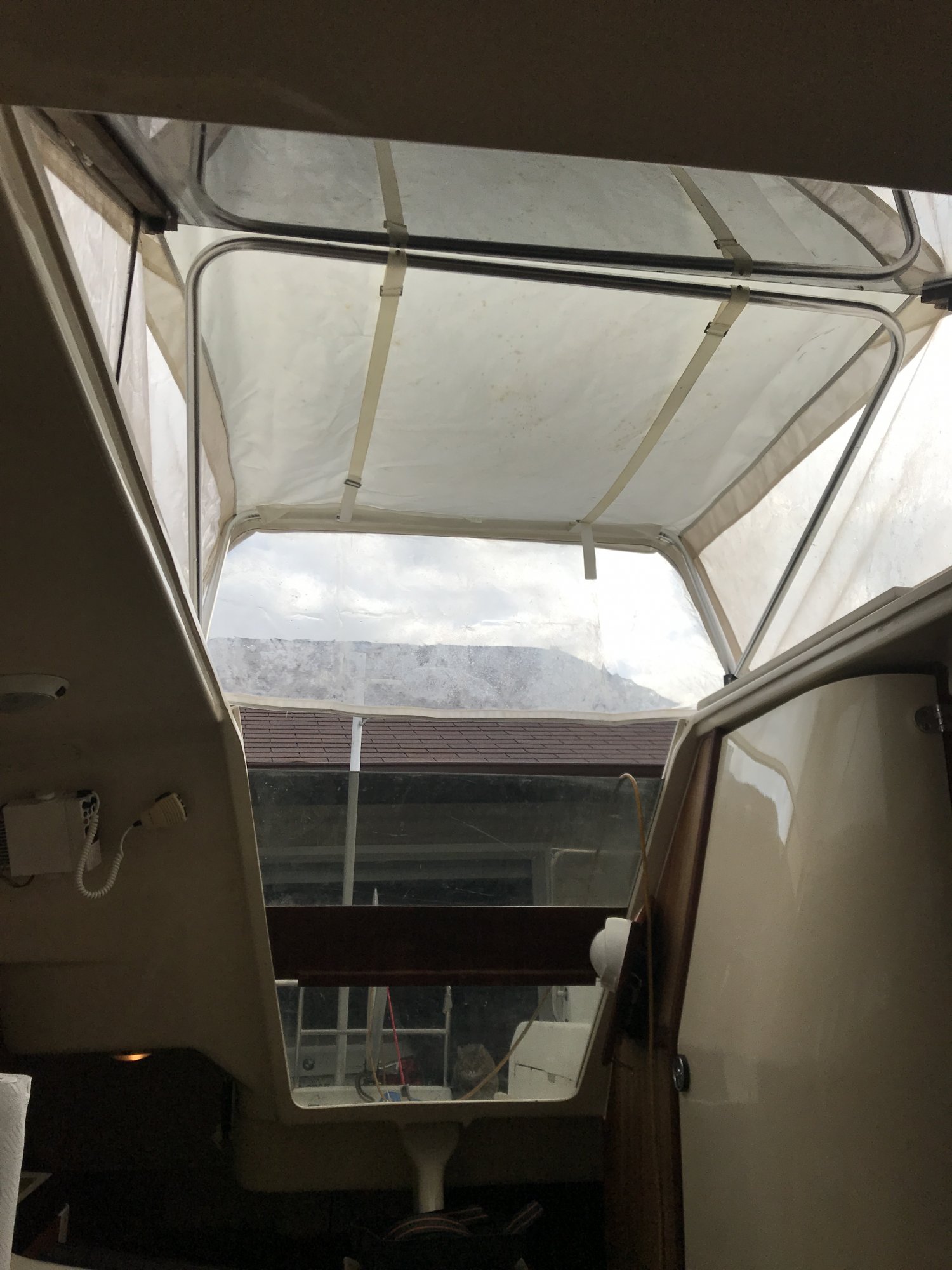

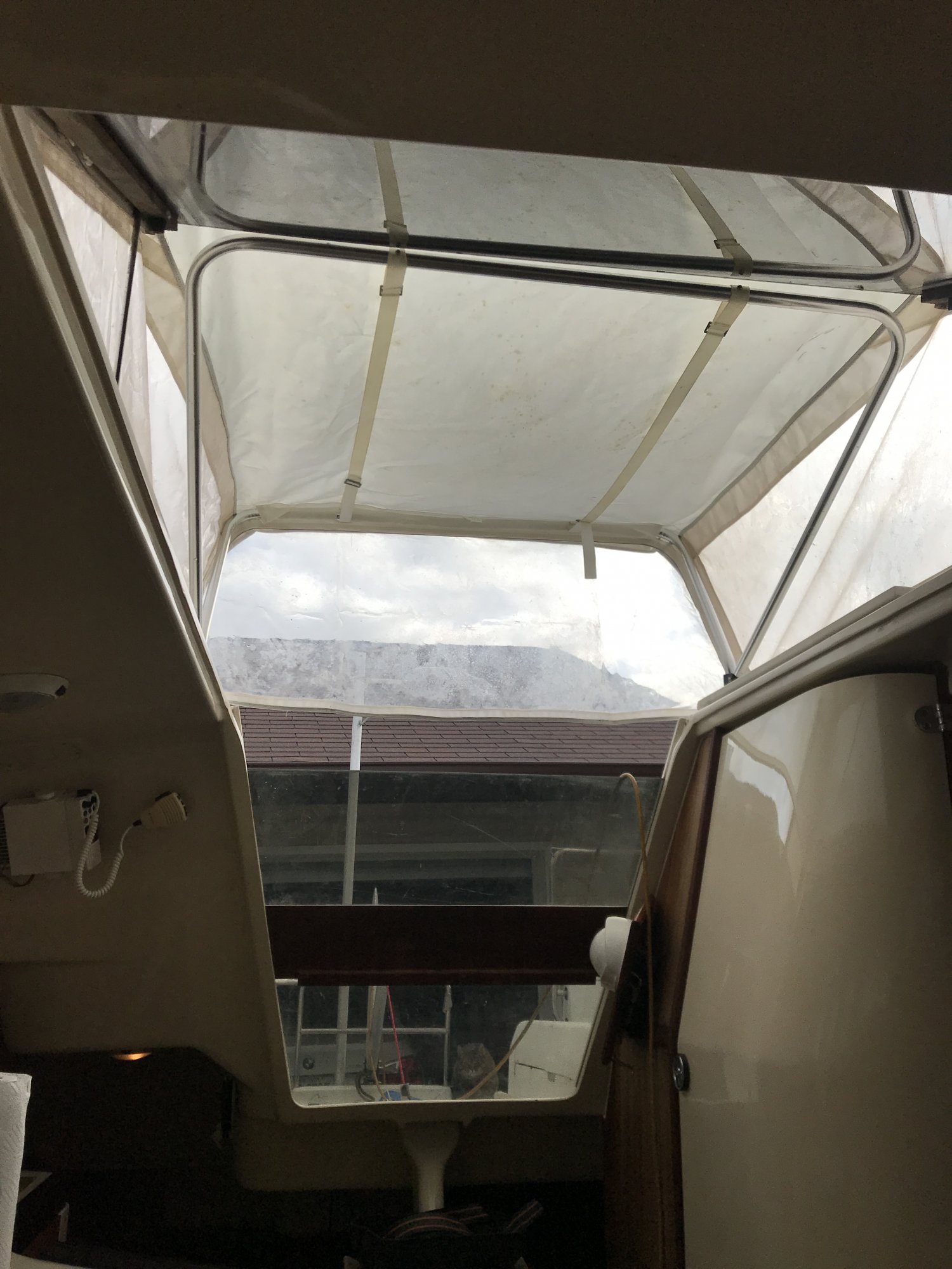

It was looking like it could rain and it's a nice way to keep out the rain while maintaining the extra headroom. Oddly though I couldn't close the companion way slider all the way with it on. Is that right? Anyway we decided we like it and want to bring it on trips. However it's a bit bulky and won't fit in the storage compartments. May have to modify the frame so it will come apart into smaller pieces so it can be stored more easily.

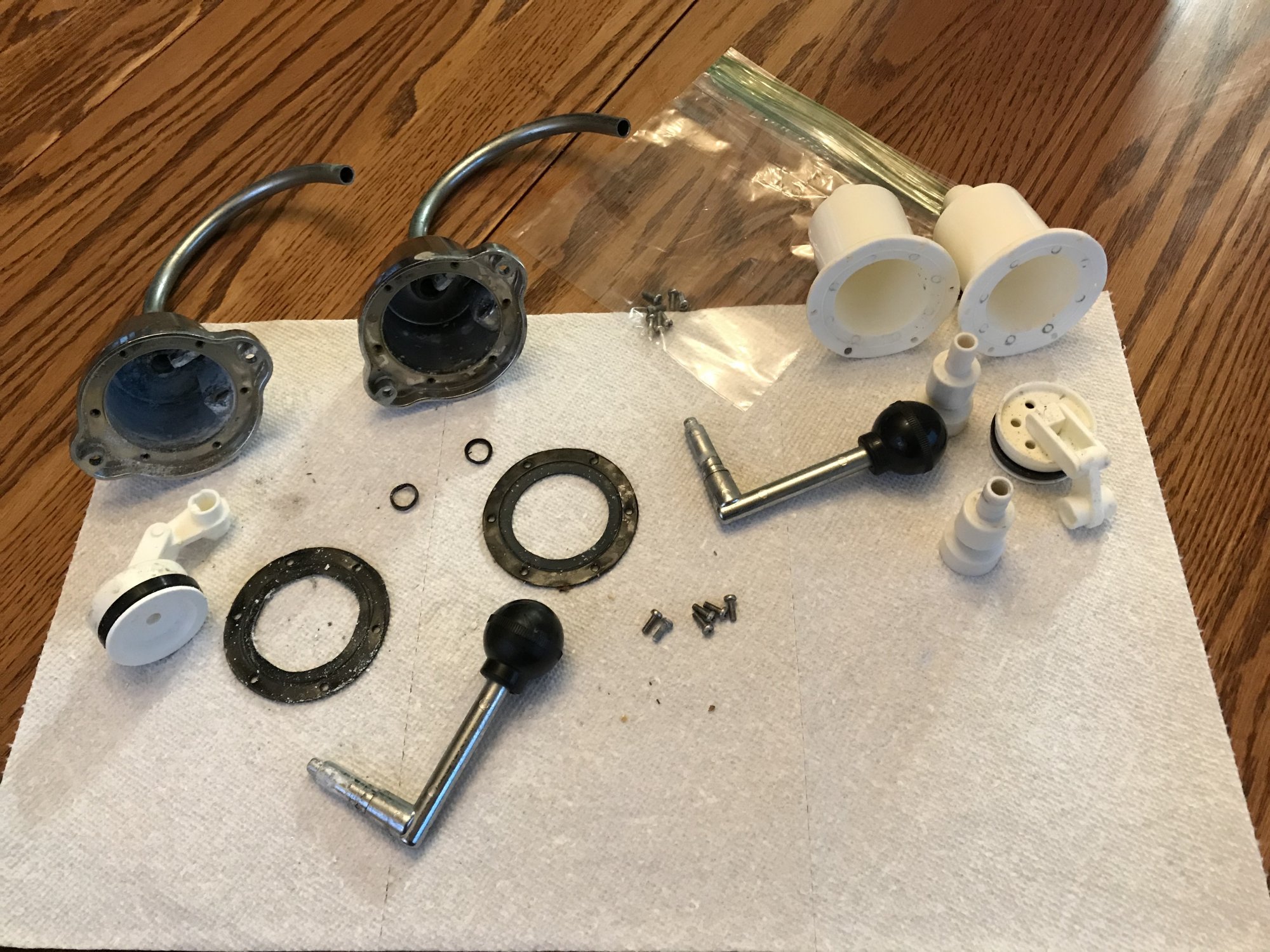

We also removed the faucets for cleaning. The bathroom faucet was still attached to a water tank under the sink. The inside of the line was black with mold except where it was grey with mold. The tubing was cut off and the tube and tank discarded. The kitchen faucet didn't have a tube attached to it. Perhaps it was because the electrical outlet they installed is kind of in the way? Maybe. Both the faucets were removed from the boat and brought in to be cleaned thoroughly. View attachment 188738
This is before cleaning.

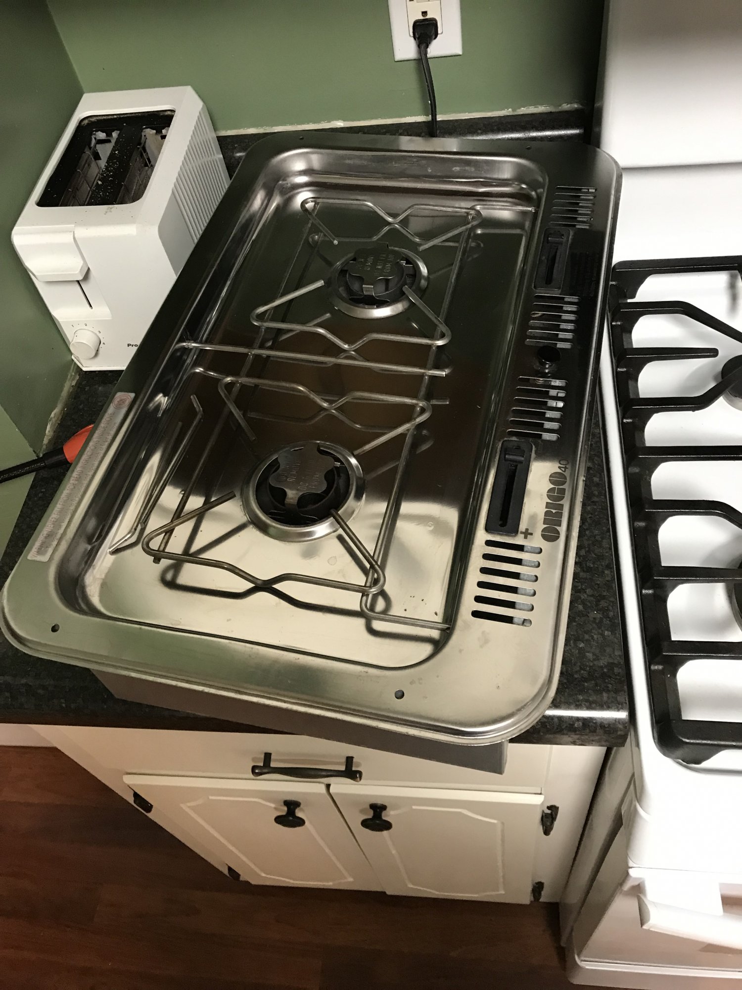

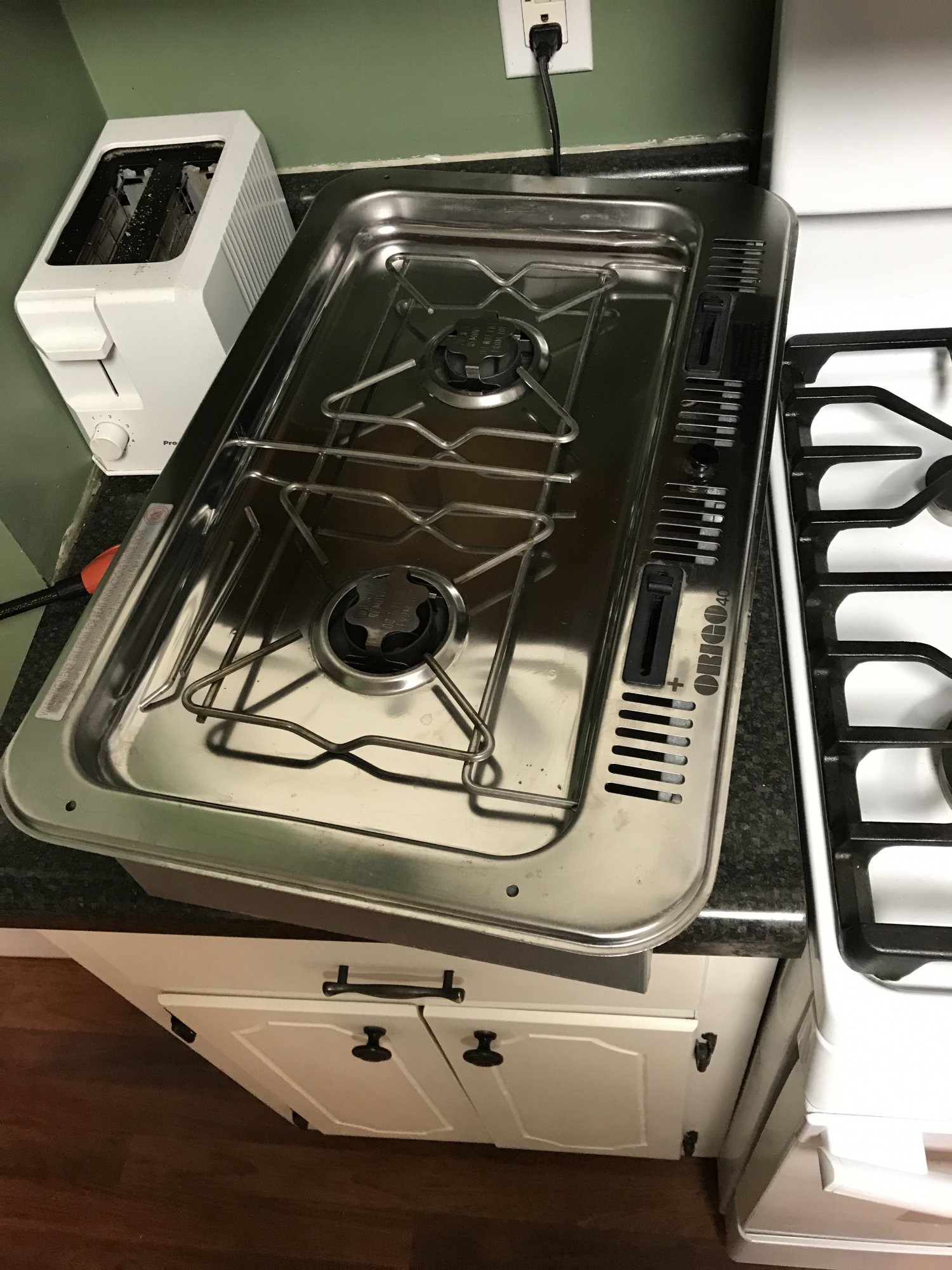

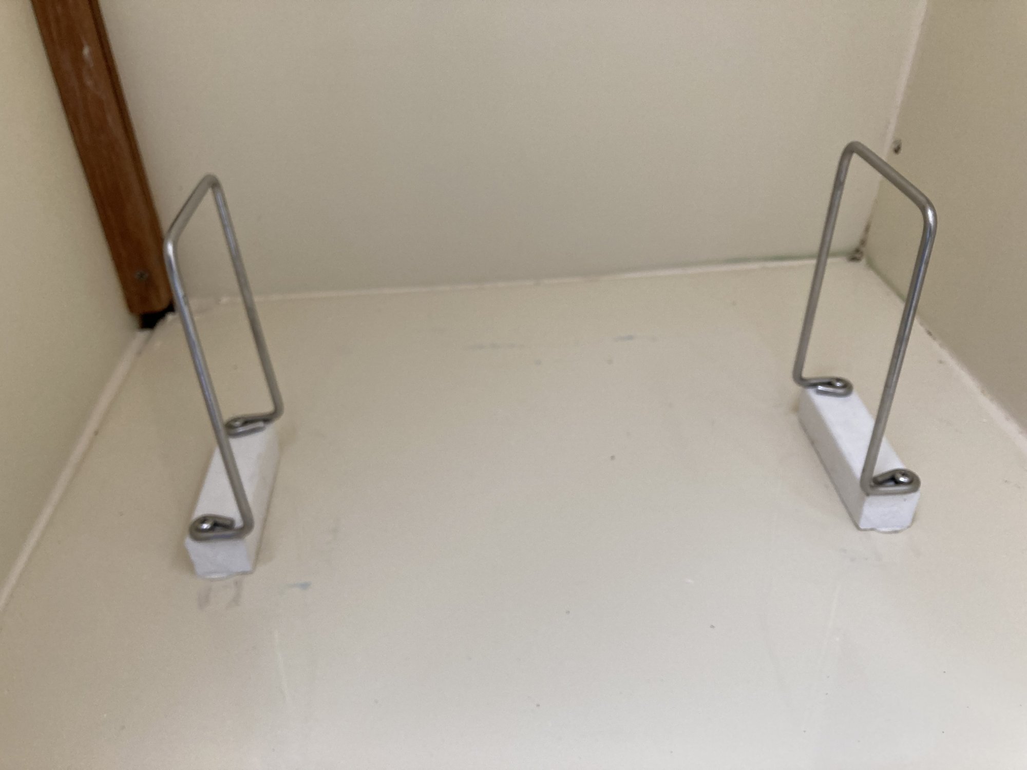

We looked at the stove with the idea of testing it out. It was dirty from bugs and dirt and I decided it'd just be easier to remove the whole thing from the boat and take it inside to clean it (also warmer inside). We later cleaned in and then filed tested out a burner. Had not used that kind of stove before. It seems to work.
Stove after cleaning and testing inside the house.

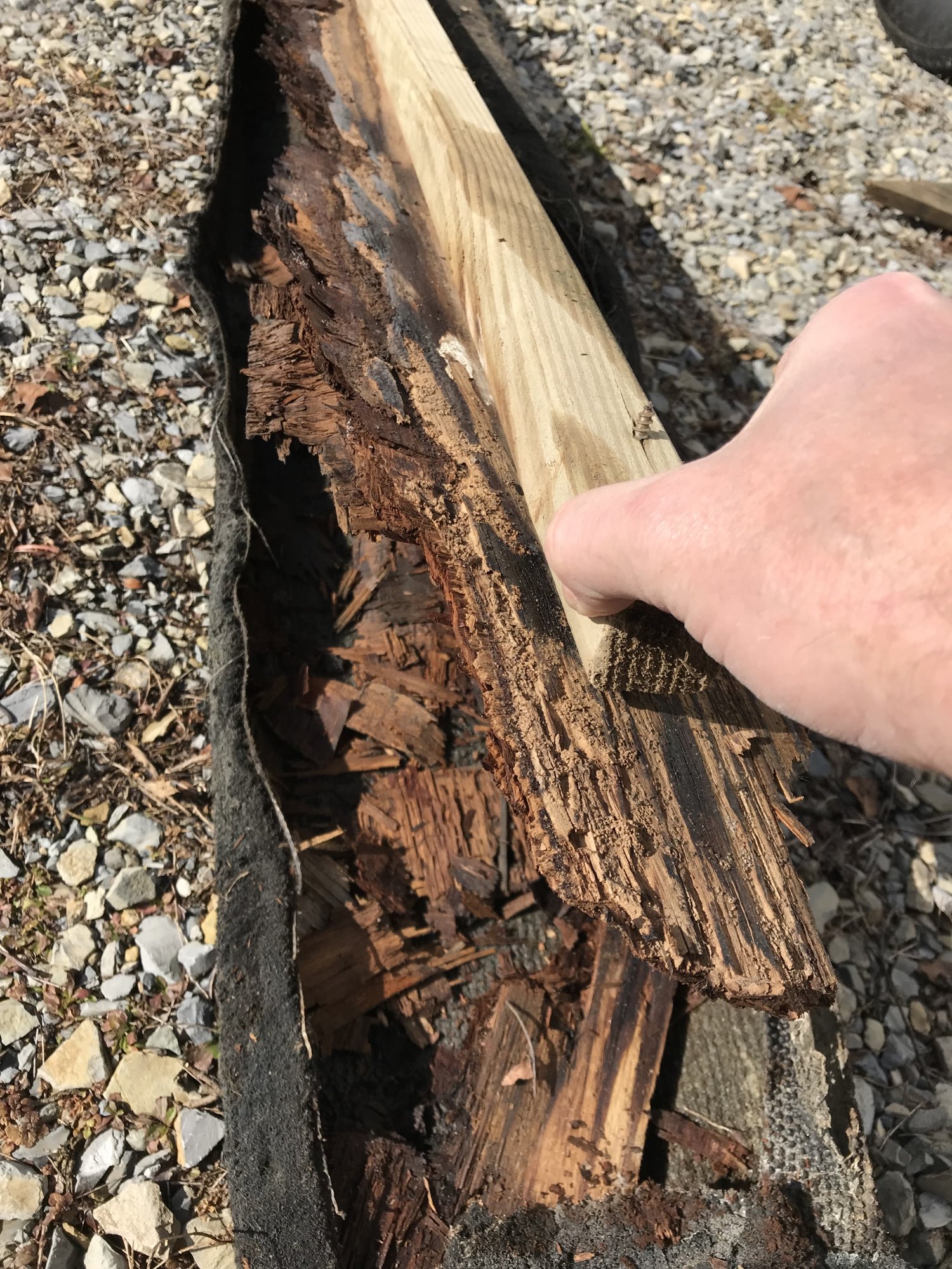

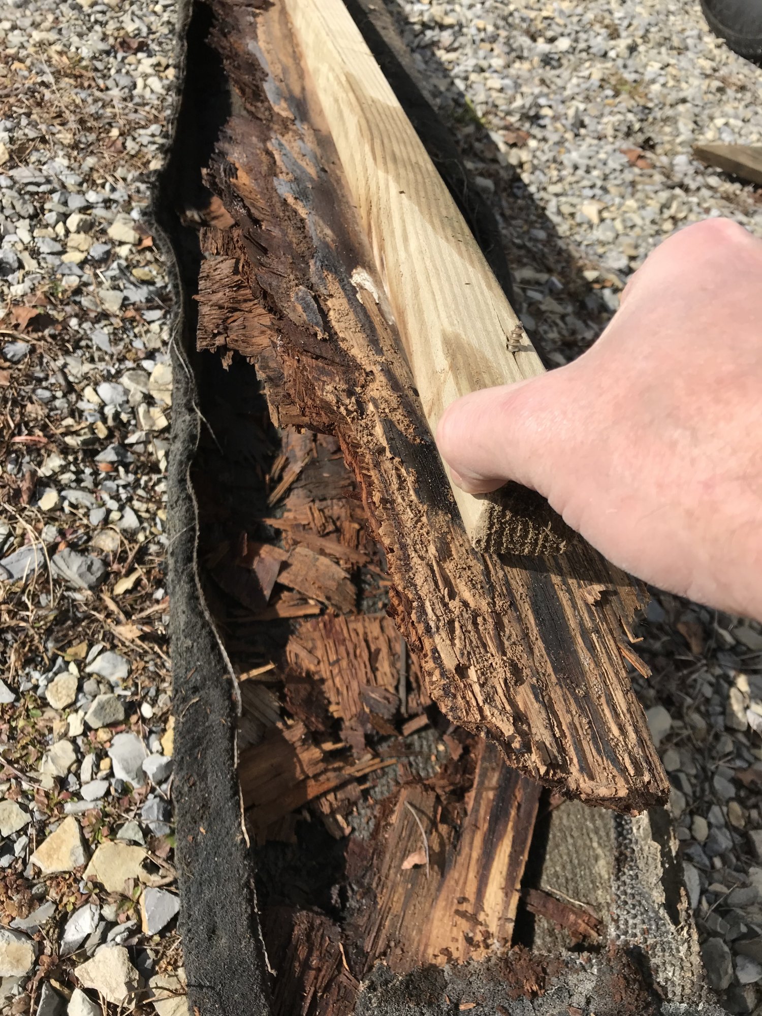

I also removed one of the center trailer bunks. The boat is loaded slightly to the right so the center left bunk has nothing on it. The center bunks are very rotten at the aft end. Later when cleaning the cockpit area I could see why. Water would run around the boat and drip off the hull right onto the center bunks. Humm. Have to cover them to keep the water off when i store it. It rains a lot and it is often very humid here. Will start collecting the bits I need to make both replacement bunks. In the pic below there is a pressure treated 1x1 screwed to the back. I don't think this is was there in the original design. Someone let me know if it's supposed to be. I'm thinking it's not supposed to be there.

Damn the stove looks amazing!! Tried to do a good clean of the faucets but they’re pitted. The black gasket has degenerated. Havent been able to find a replacement gasket. Anyone find one?

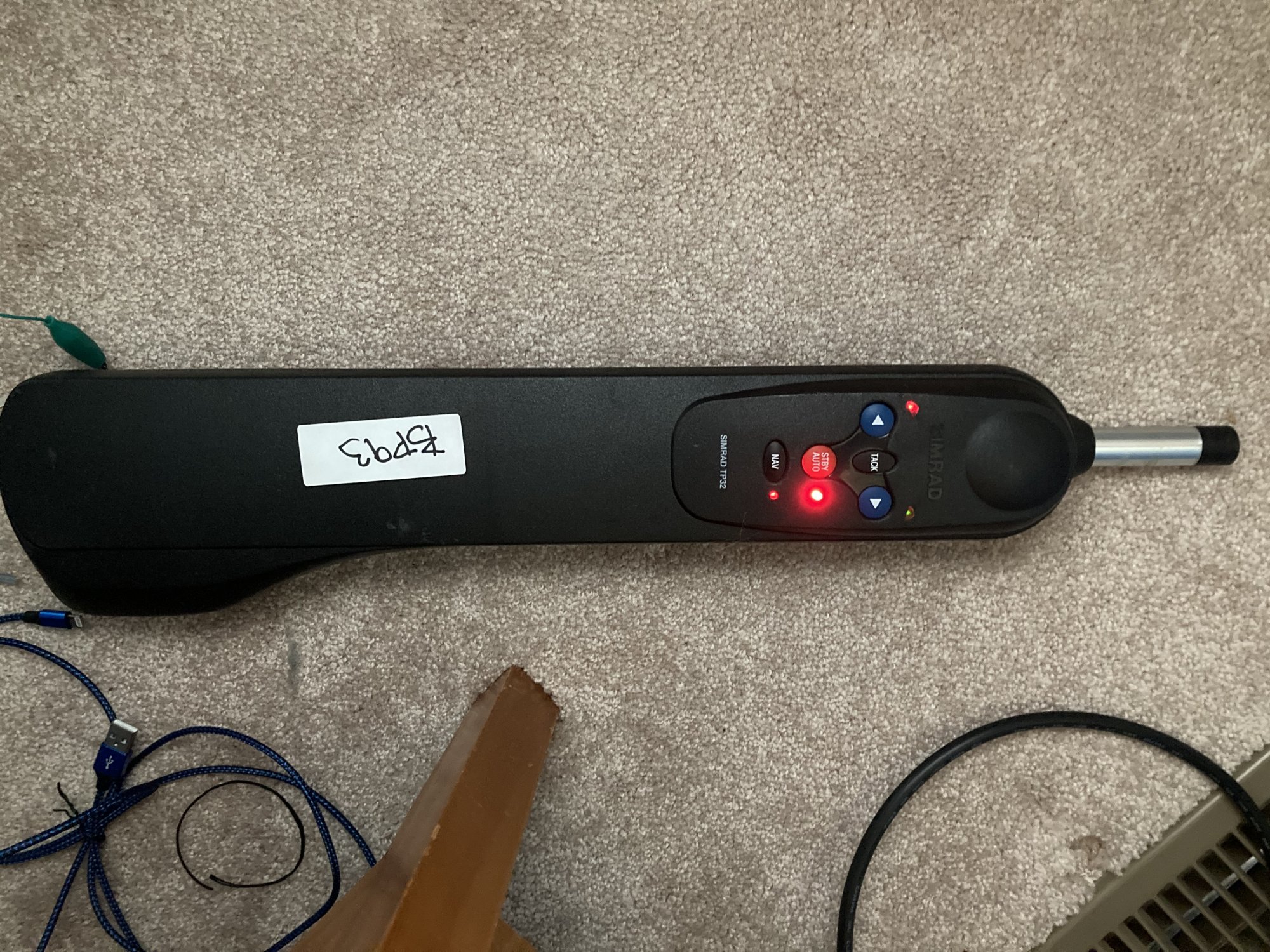

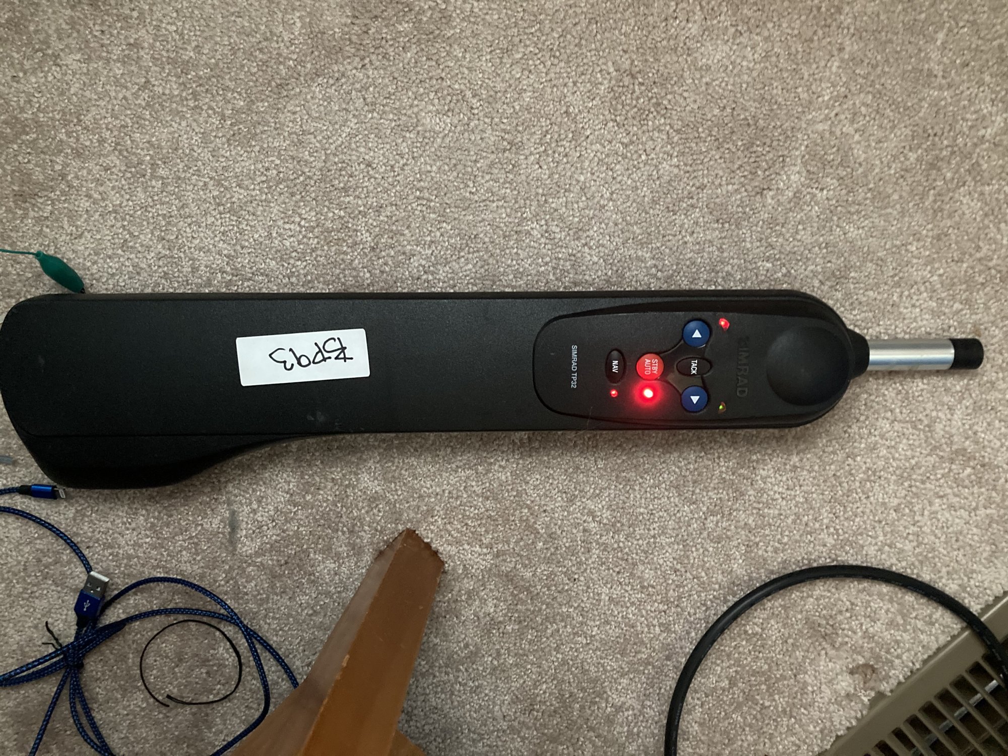

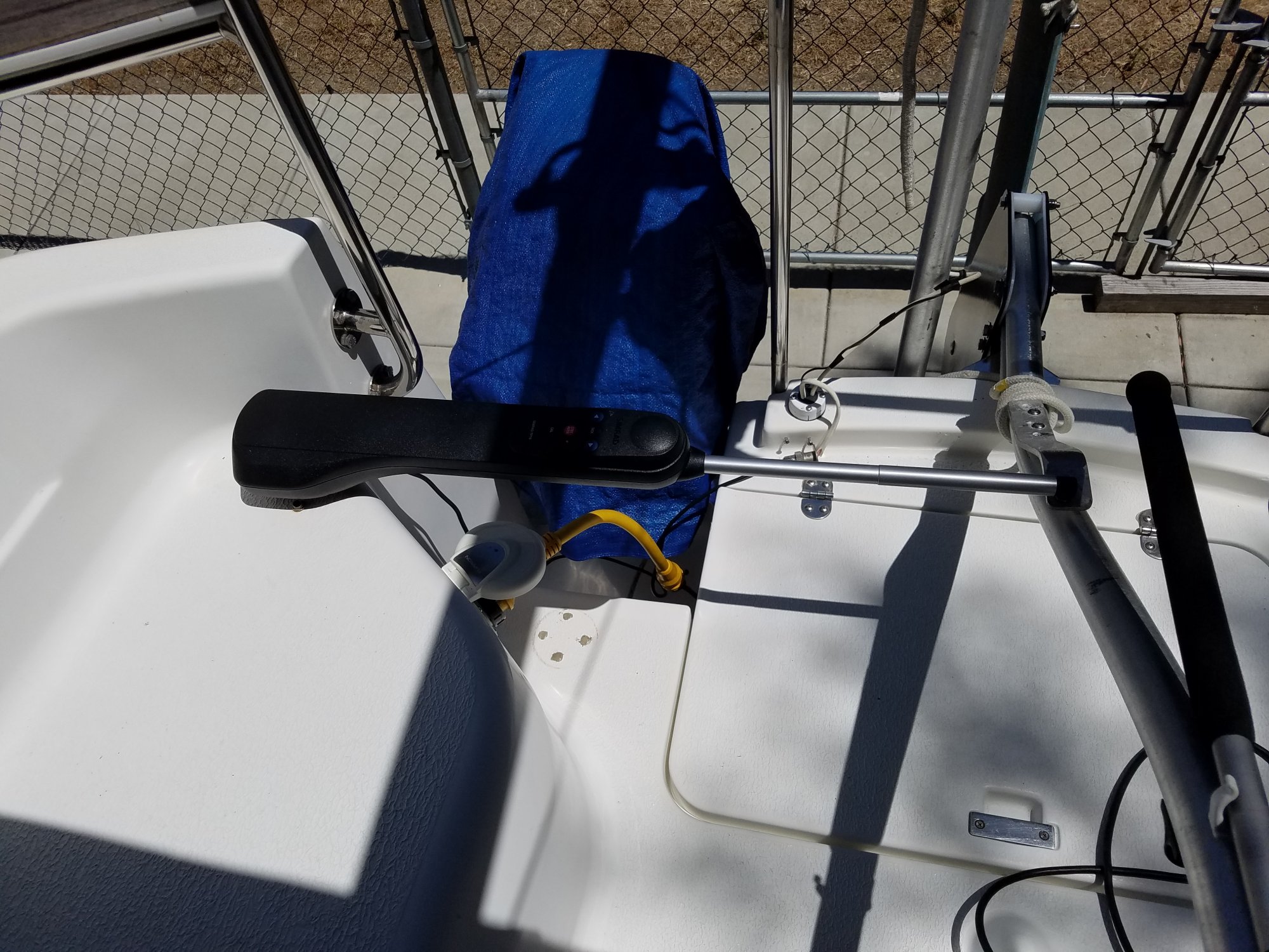

Look what showed up today. An upgrade for the boat!
It is used and there was no promise it would work. But in initial testing it looks like it works. Yay. Now to install it.

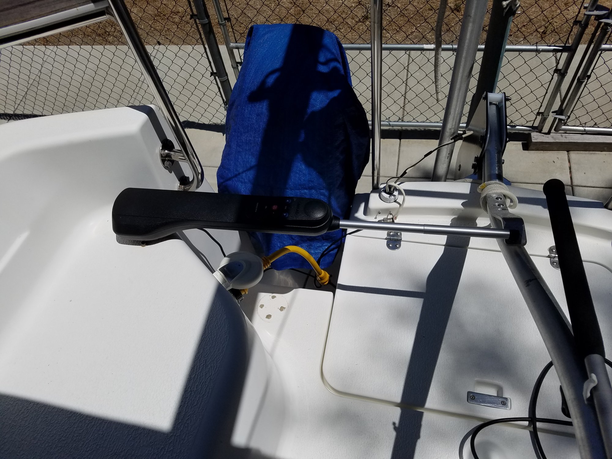

I have a Simrad TP10. If you're interested, here's how I installed mine.
Hunter 26 Owner Modifications and Upgrades
Thanks. That looks like a great installation.
Question it appears to take control of the boat the autopilot has to be physically removed. Is this correct? Is there any other solutions. Not sure about trying to pull it off in a panic, especially because helmsman tends to freak out under pressure
The rod snaps on to a pin installed on the tiller. You can just press the red standby button and lift the rod off from the tiller connection, leaving the other end still connected to the cup and swing it out of the way. When you want to activate it again, simply swing it over and snap it back on to the tiller and press the red button again.
I only use mine for holding a compass heading and tacking. It's awesome, you'll love it. The model you have has more capabilities. I believe it has the ability to interface with a GPS and actually take new headings, more of a a true autopilot. I personally don't want that. The function of holding a heading and tacking is all I want, giving me the freedom to handle the sheets while single handing.
Thanks for the info on disconnecting. Sounds pretty easy to use. I have a bit of fear of it popping off and going overboard. Perhaps it's not a big concern.
Yes it should a wonderful thing to sail with and I am looking forward to it. I'll likely use it just as you do. It can connect to more stuff but I don't have anything else to hook to it. For now it'll be great for it to just hold a heading and tack.

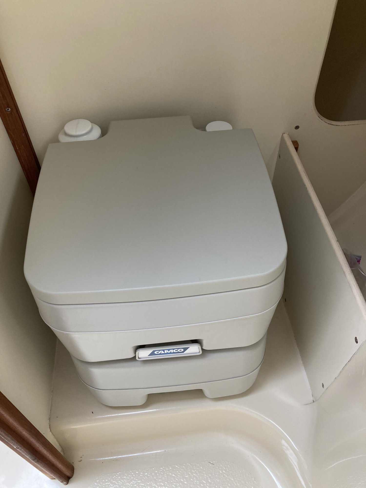

Replaced the side port hole seals and screens. Replaced the port-a-poty. On the last trip we never used the one we had, which looked original. Lucky thing too as it developed a leak at a the bottom corner from years of rubbing around I guess. So out it went and we found a new one that fit almost the same as the original. It was about 1" higher at the mount points. So added some spacer blocks and it's all good.

Tiller pilot. Didn't I say I had to have this? Yes I did. So I put time in to fabing up a tiller mount bracket and a bracket that comes off the stern seat mounts. Then i had to add some wiring. My tiller pilot was missing it's pigtal so I just soldered on some wire and connector I had around, including a fuse between it and the battery. I was a bit surprised at the tiller pilot power wires being so small. So stupid me found the smallest fuse i could find around my place (5 A) and installed it. On the water the tiller pilot was totally fun to use. Well for those 5 min before it blew the fuse. According to the literature it should be on a 10A fuse. Oh why didn't I think to look what the instructions suggested. Oh well next time we take the boat out will have the right fuse.
