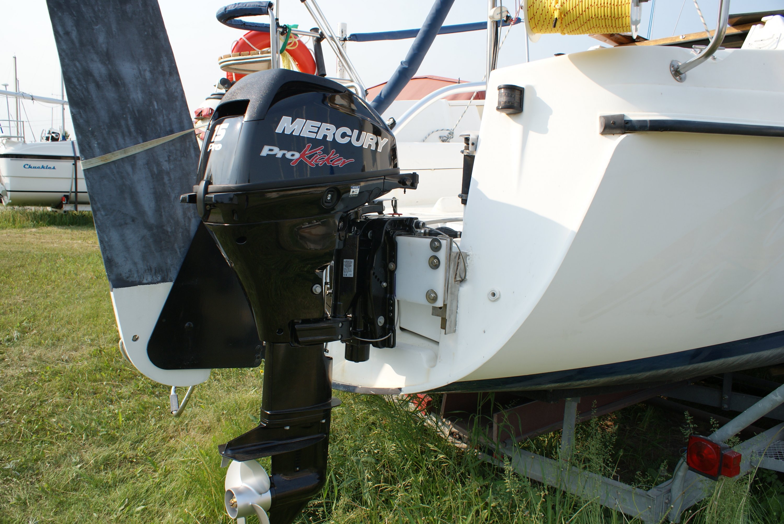

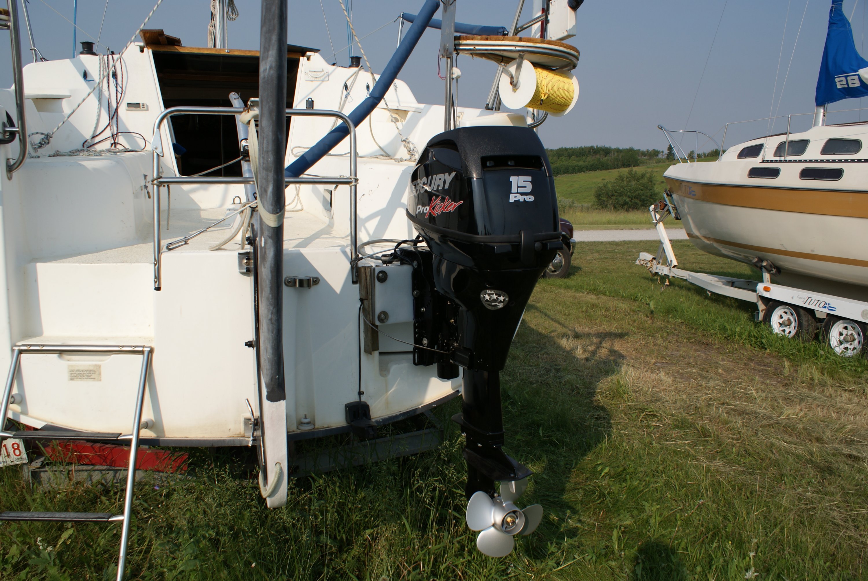

I used 4 foot control cables and have found them to be the perfect length, no tight radius or excessive length. I did have to shorten the electrical cord as it only comes in one very long length. As to the motor mount issue, I also had flexing of the mount and the transom fiberglass. My solution was to reinforce the transom mount area with SS plates and build a more square to center-line set of mounts that are longer and higher than the original. The motor now is positioned 2" higher and almost 2" closer to the transom. All flex, twist and bounce is now gone. G.

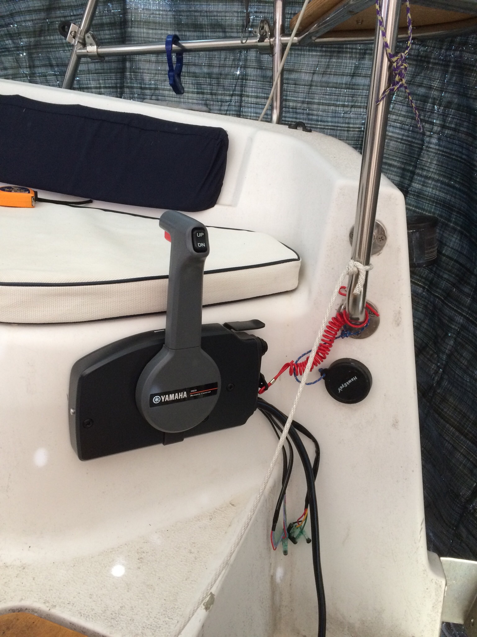

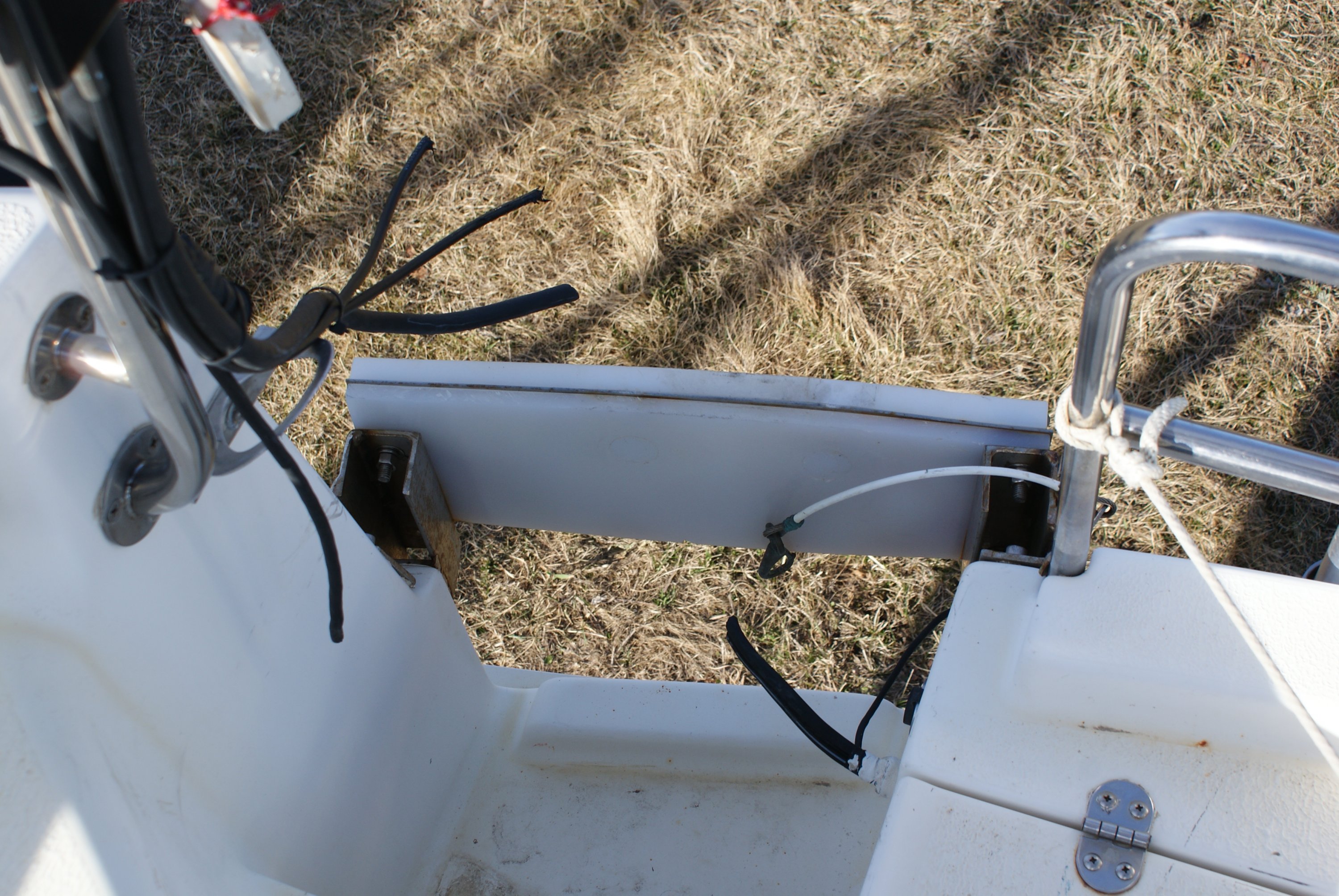

The power tilt and electric start take a lot of work out of boat handling on the dock and at anchor. I have never needed the outboard to steer with the tiller to get into tight or complicated places so I have no experience. Here is a photo of my set-up. I also have a tiller extension so sitting on the rail seat and driving works well. G
DewHunter...
Based on your installation, if you had the option, would you prefer to have the handle on the cockpit side of the control box with forward in the down direction? Seems to me that would make it more convenient when standing in the cockpit.

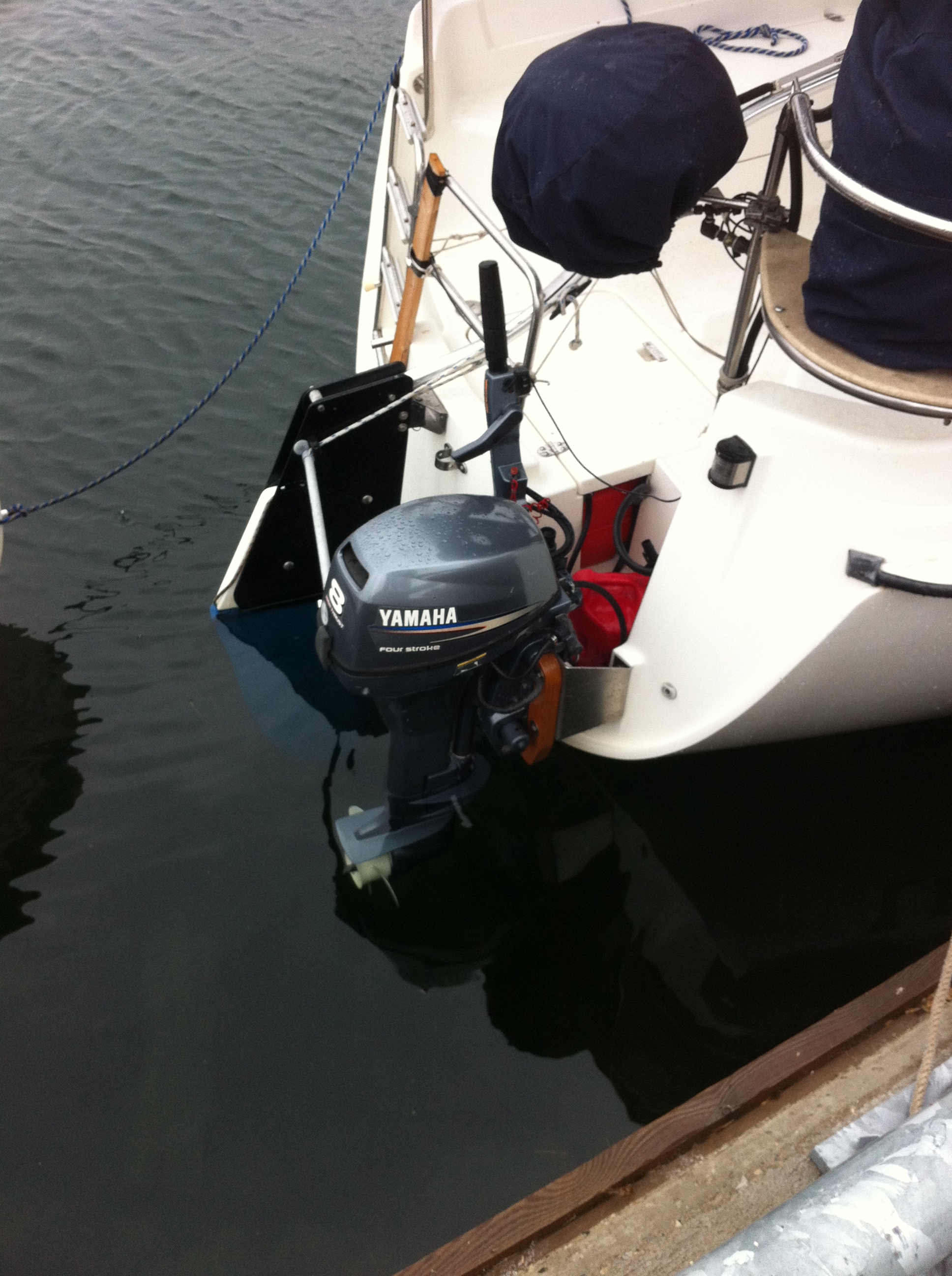

P.S. I found and added a picture that I took last summer of a H26 that had a modified motor mount which was perpendicular to the boat centerline. I do not recall the boat or owner's name.

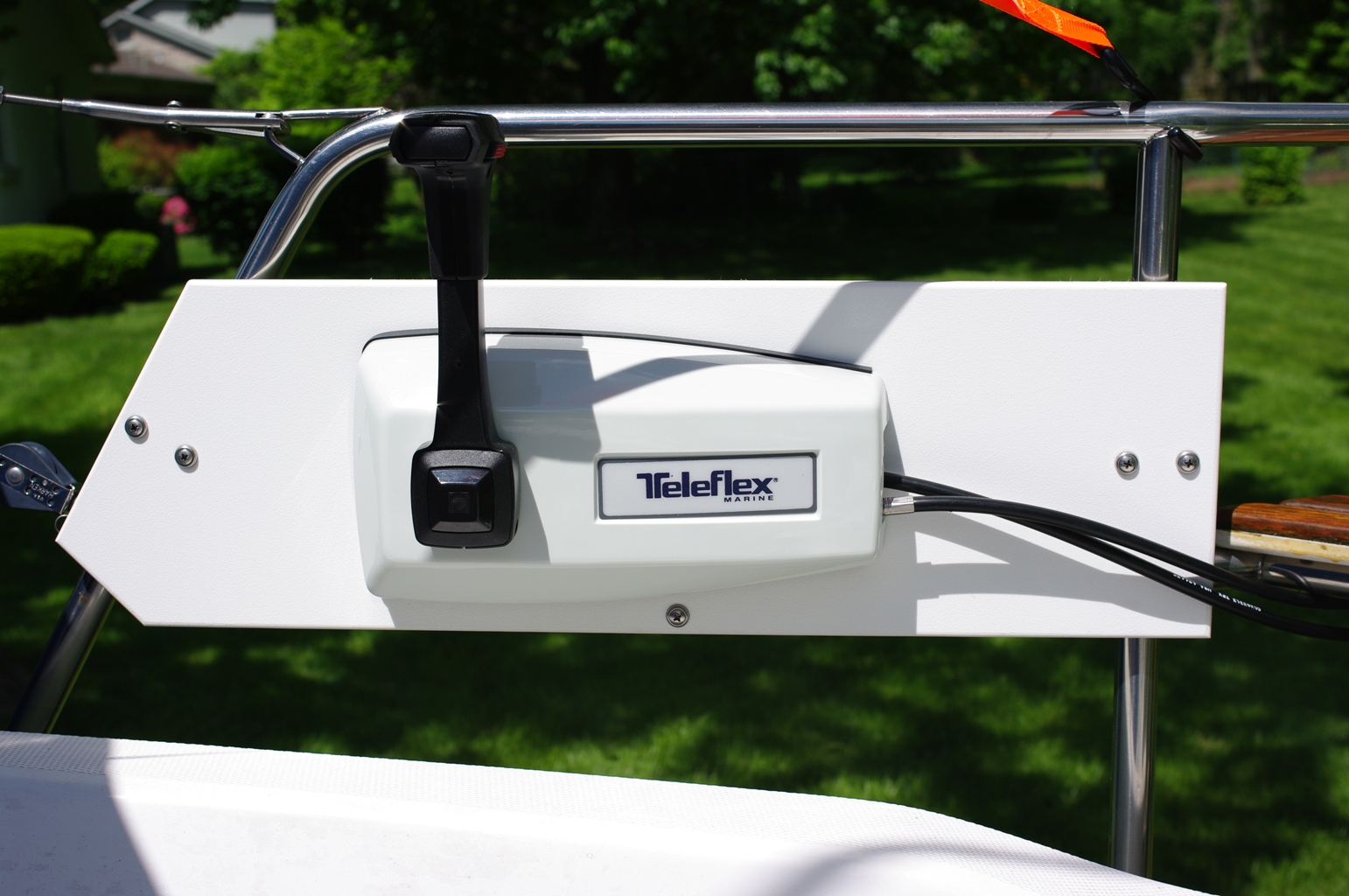

I converted a Honda tiller motor to a remote control model by simply ordering the parts over the Internet. The Honda dealer told me I could not do it, "trade in the motor". It only cost $124 and a few hours of my time. Could you do that with your current motor ?
I once saw a Yamaha outboard with the original tiller handle remotely mounted on the pushpit. The owner told me he bought it from a Yamaha dealer, it was factory product.

Unfortunately Fred the controller handle has only one mounting position due to the gear lock out feature. That being said I would have liked the handle in the vertical position with a more intuitive forward for forward motion. I could have flipped the controller around to locate the handle inboard but this created another obstruction to movement (hazard) in the already small cockpit. With the long/short motor mount to square the motor to center-line, I found that the outboard comes clear of the water on all points of sail and powers the boat more like a larger inboard engine boat. I like the consistency of steering under power or sail and I don't have to adjust to different turning radiuses at the dock or anchorage. The 13amp charging verses the 5amp is a bonus if you like to anchor out for a night or two. G

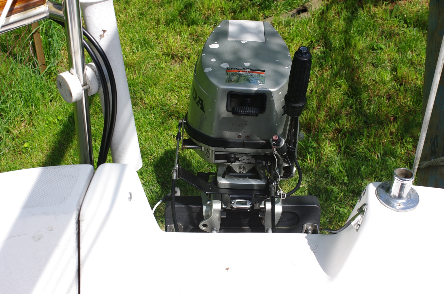

I built my mounts out of 1/8 2" SS angle and thru bolted them into a 1/8 backing plate on the inside of the transom. You will need to do this because the transom is quite weak and tends to flex. The inboard mount has less set-back than the original mount and both mounts are higher on the transom. The first photo shows the original mount in stock location with an aluminum mount board. (not good vibrations) All other mount boards are a laminate of plastic with SS core for strength, 1/2 SS bolts used thru out entire project.

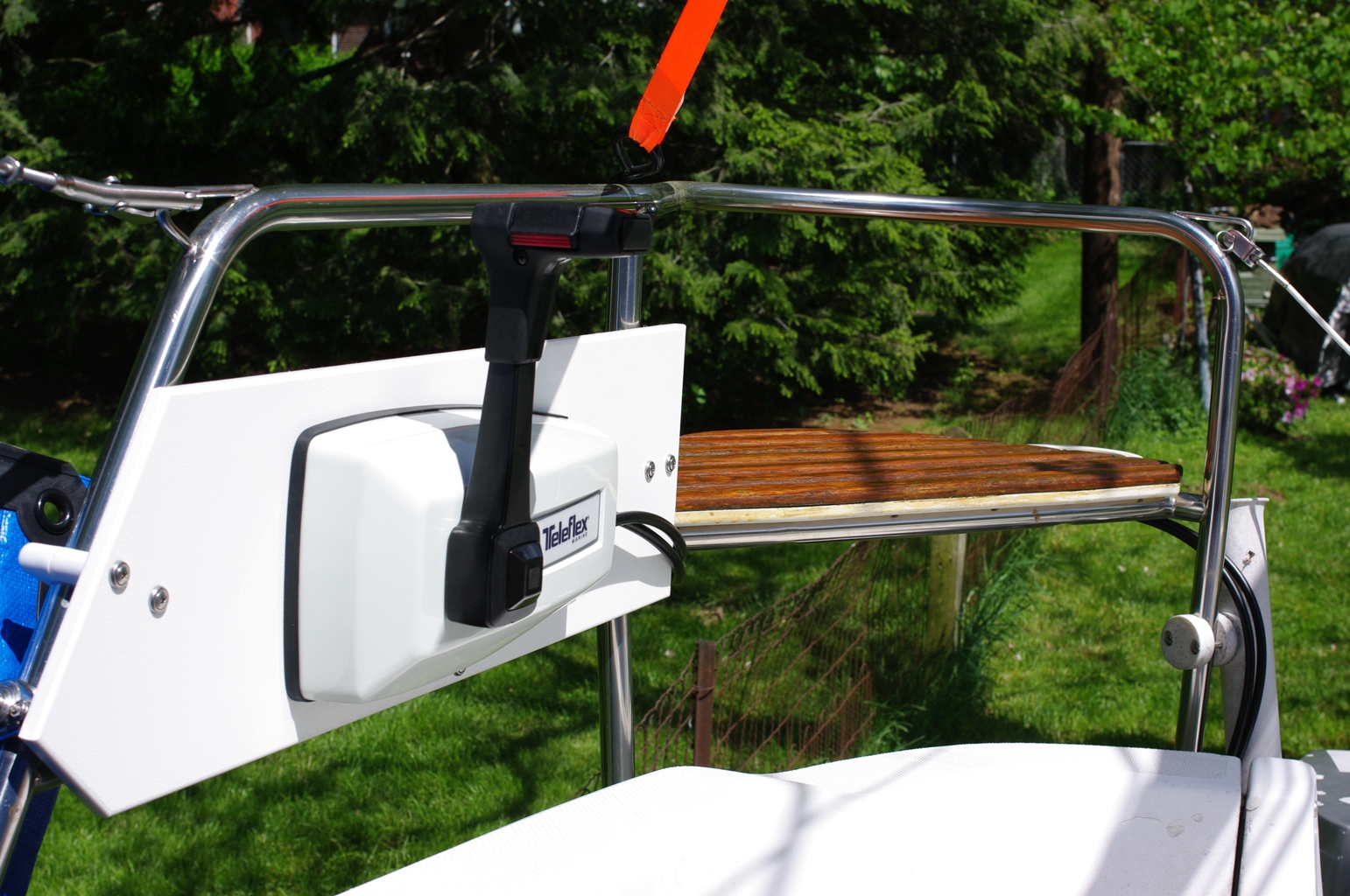

Was at the boat today checking out how to mount my motor control box. Thought occurred to me that one possibility is to mount on underside of starboard stern rail seat. This would make it quite accessible and put it at a convenient height when standing at the helm for docking etc. The controller would be horizontal but I think that the handle motion would be quite intuitive i.e push handle away to throttle up in forward direction. When not in use the handle can be moved to full forward direction which would put it out of the way. This location hides the bulk of the controller and makes for an easy, short cable run to the motor.

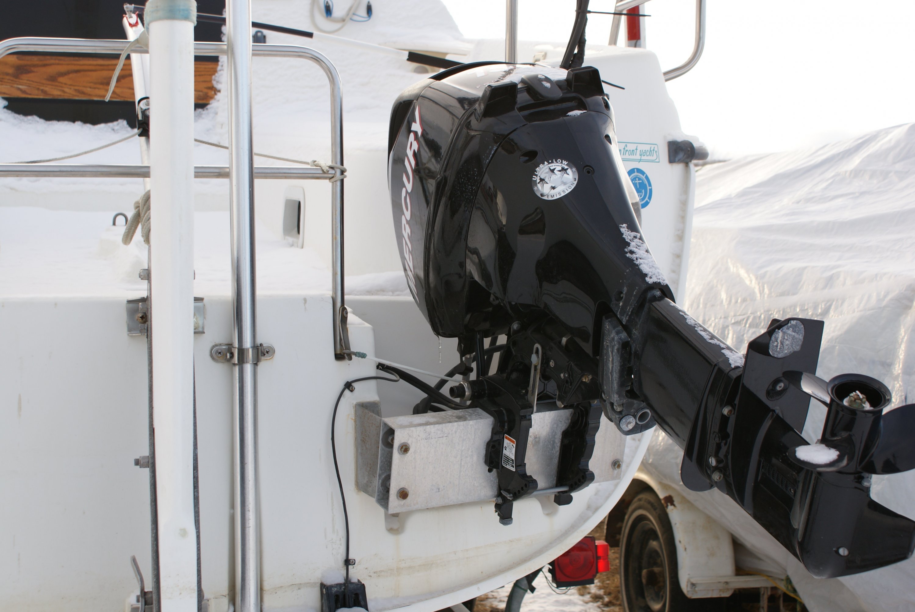

Here's how I mounted my remote control for a Honda on a 240. Cut starboard to fit rail, attached with 3 Lifesling rail brackets. Cables routed under stern seat and down. Huge improvement on a 240.
