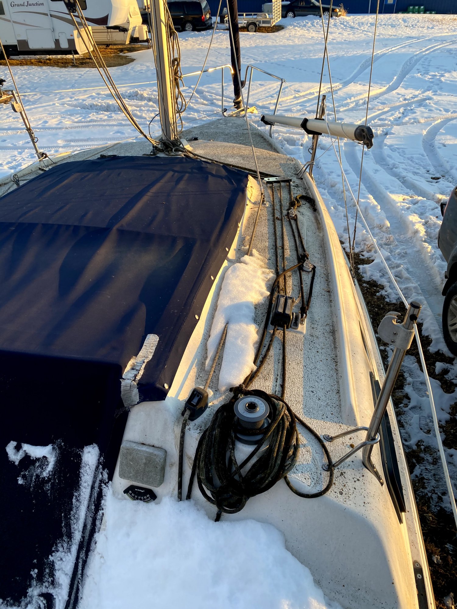

After 2 days of rain, then snow and now the snow melting we got into the boat to see if we had a bunch of water get inside. Checked in all the compartments and happily the boat is totally dry inside. That's a relief. After I finish the trailer repairs it might be time to take it to the local lake to see if it floats :)

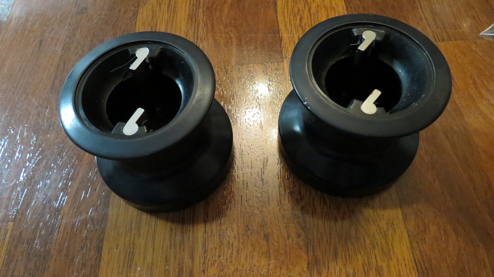

Not sure I mentioned it but the RH winch on the boat had stopped working when we hoisted the main sail. So took them both off and brought them in the house for cleaning. The grease in them had turned into sticky goo. A little cleaning and they were good to go. Put them back on the boat today.
Here they are being cleaned.
I also pulled the winch off the trailer and brought it in. It was rusted solid. It's missing the handle and the strap was weathered to the point I wouldn't trust it. I managed to get the winch working again but after buying a handle and a new strap it might be worth just getting a new winch. Actually I bought an inexpensive single speed, but higher load capacity, winch locally. Thinking the two ratios might be a good idea. So undecided what we will do at this point.

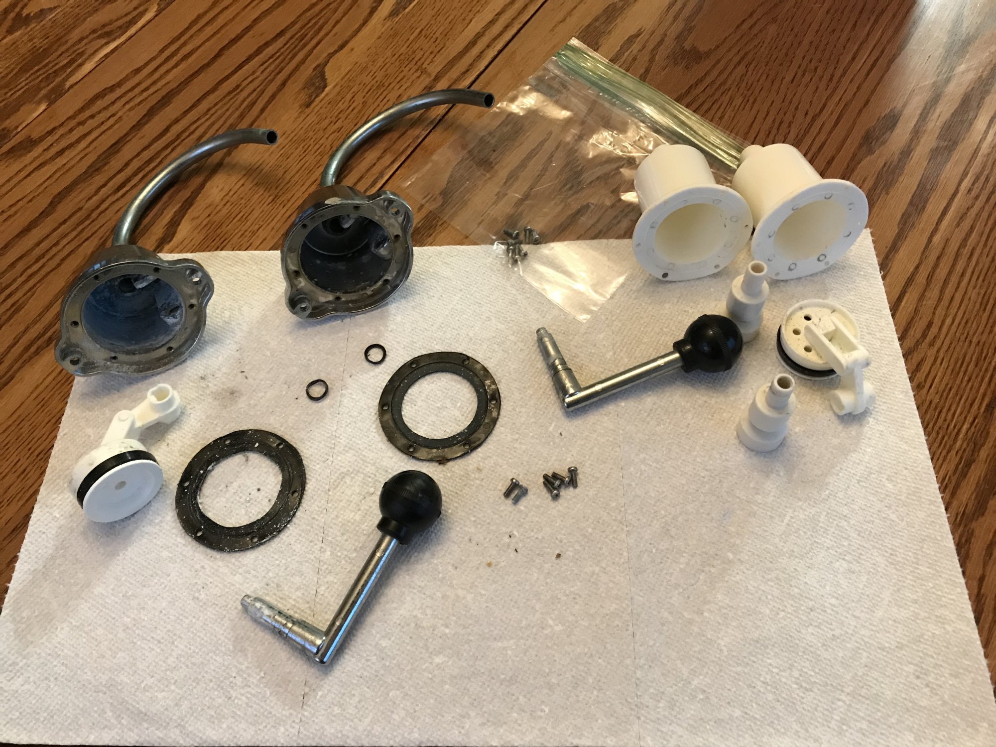

We also removed the faucets for cleaning. The bathroom faucet was still attached to a water tank under the sink. The inside of the line was black with mold except where it was grey with mold. The tubing was cut off and the tube and tank discarded. The kitchen faucet didn't have a tube attached to it. Perhaps it was because the electrical outlet they installed is kind of in the way? Maybe. Both the faucets were removed from the boat and brought in to be cleaned thoroughly.

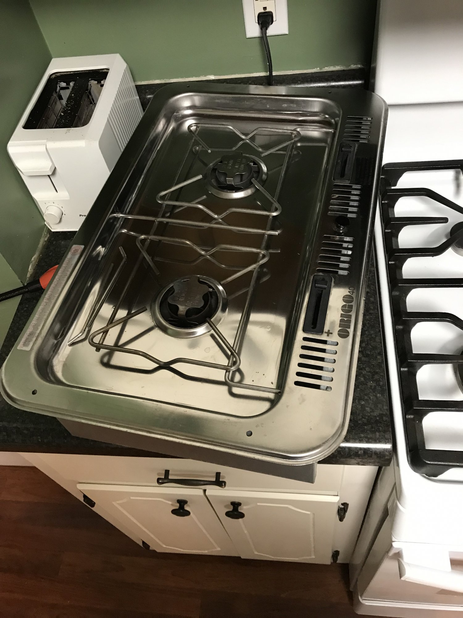

We looked at the stove with the idea of testing it out. It was dirty from bugs and dirt and I decided it'd just be easier to remove the whole thing from the boat and take it inside to clean it (also warmer inside). We later cleaned in and then filed tested out a burner. Had not used that kind of stove before. It seems to work.
Stove after cleaning and testing inside the house.

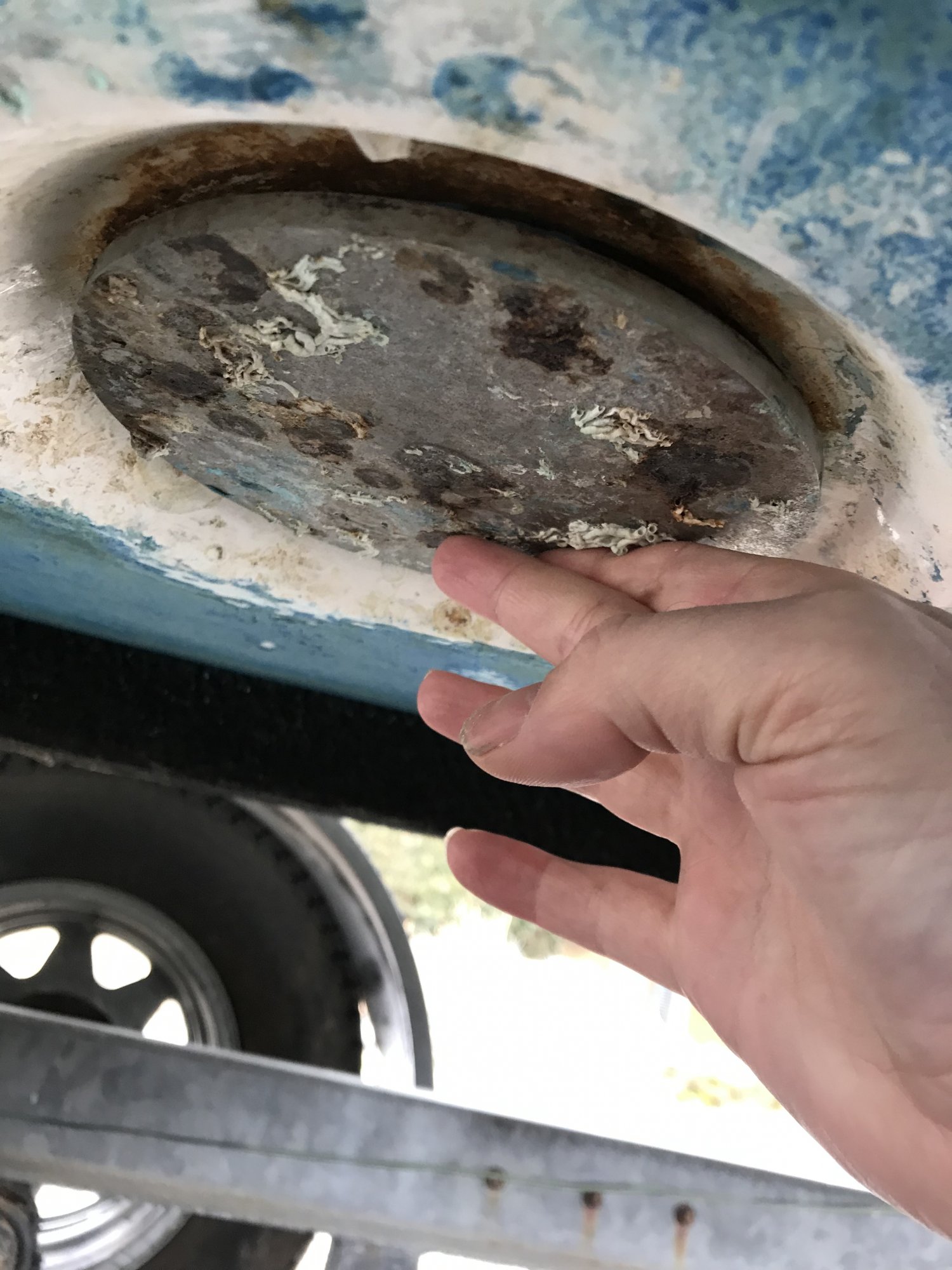

Oh while under the boat I noticed that the ballast valve was open about an 1". I thought it was closed for some reason. I pushed on it to see what it would look like in place and it didn't budge. Oh, that's not good. I put some penetrating oil on it from the bottom and the top. I could get it to wiggle a bit from the top but not much else. Will come back to that another day.

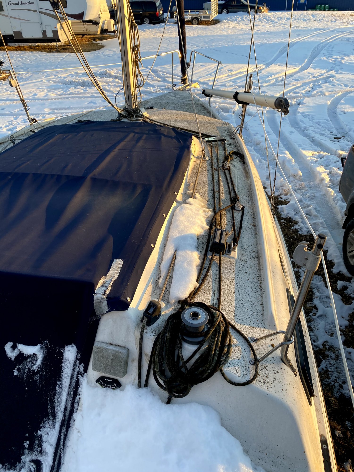

Here's an update since I promised to try to take over this thread. The snow stopped and the 30 degree days came out. This boat hasn't been sailed in two or three years so it's had a lot of time to sit. I opened the companion way hatch and found a snow drift inside. We had a nasty blizzard and I think the driving wind blew snow under the companion way cover. I scooped as much snow out as I could and wiped it all clean. I removed all of the cushions out of the boat to begin the cleaning process. Some are ripped so I'm going to have to decide if patching or replacing is in our future.
I have a slew of mold and mildew on the nonskid. I've read a standard mold and mildew remover works well. I'll wait until I can use my pressure washer in the spring. I'm open to any suggestions.

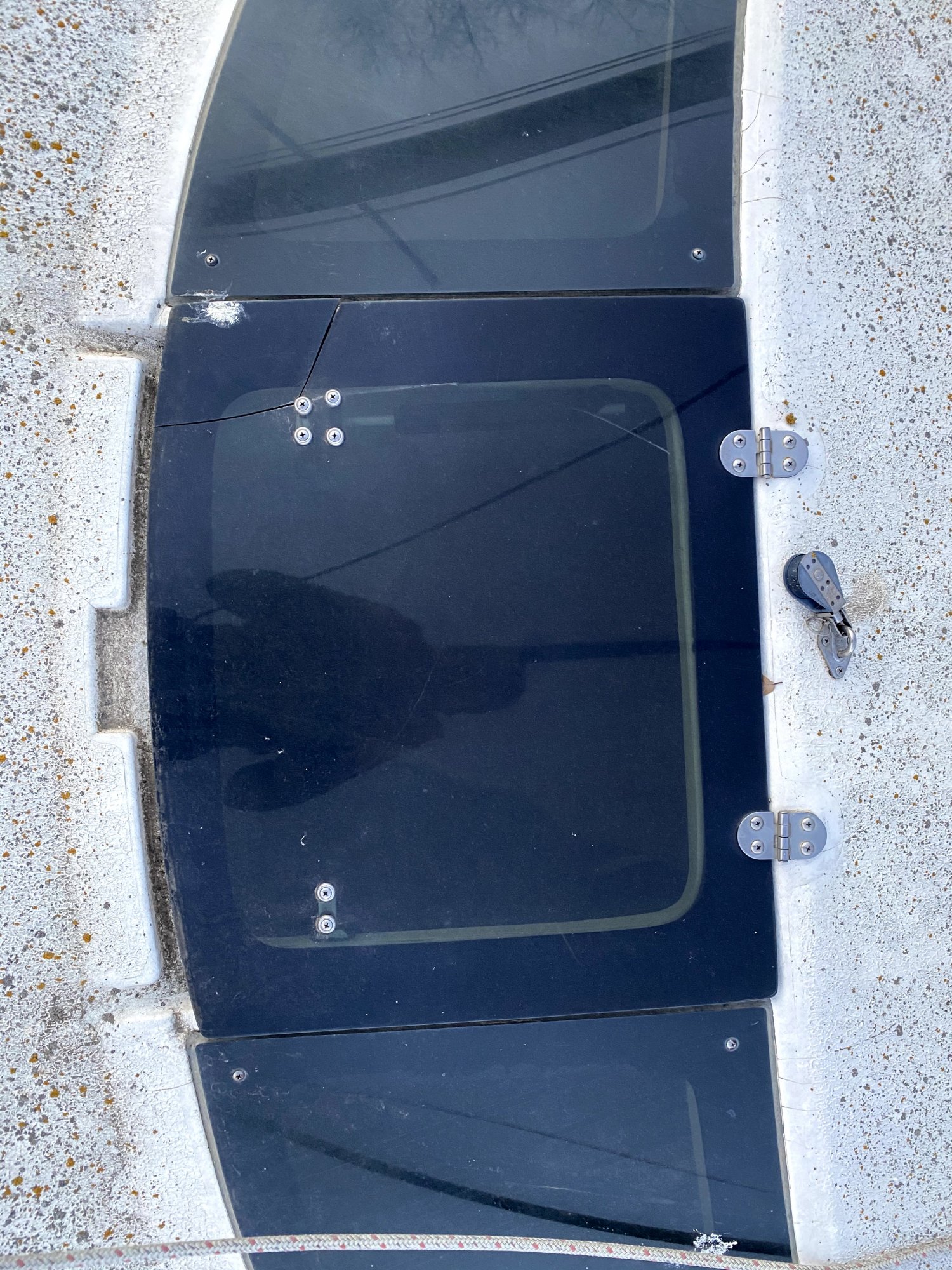

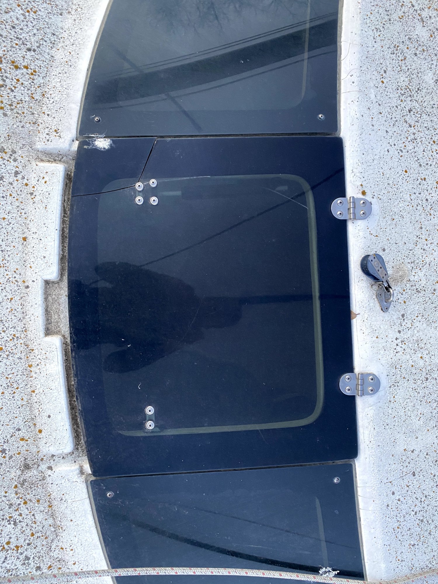

Has anyone tried to replace the front hatch with a flat piece of tinted acrylic or does it need to be curved?
Hunter 26 windshield / opening hatch

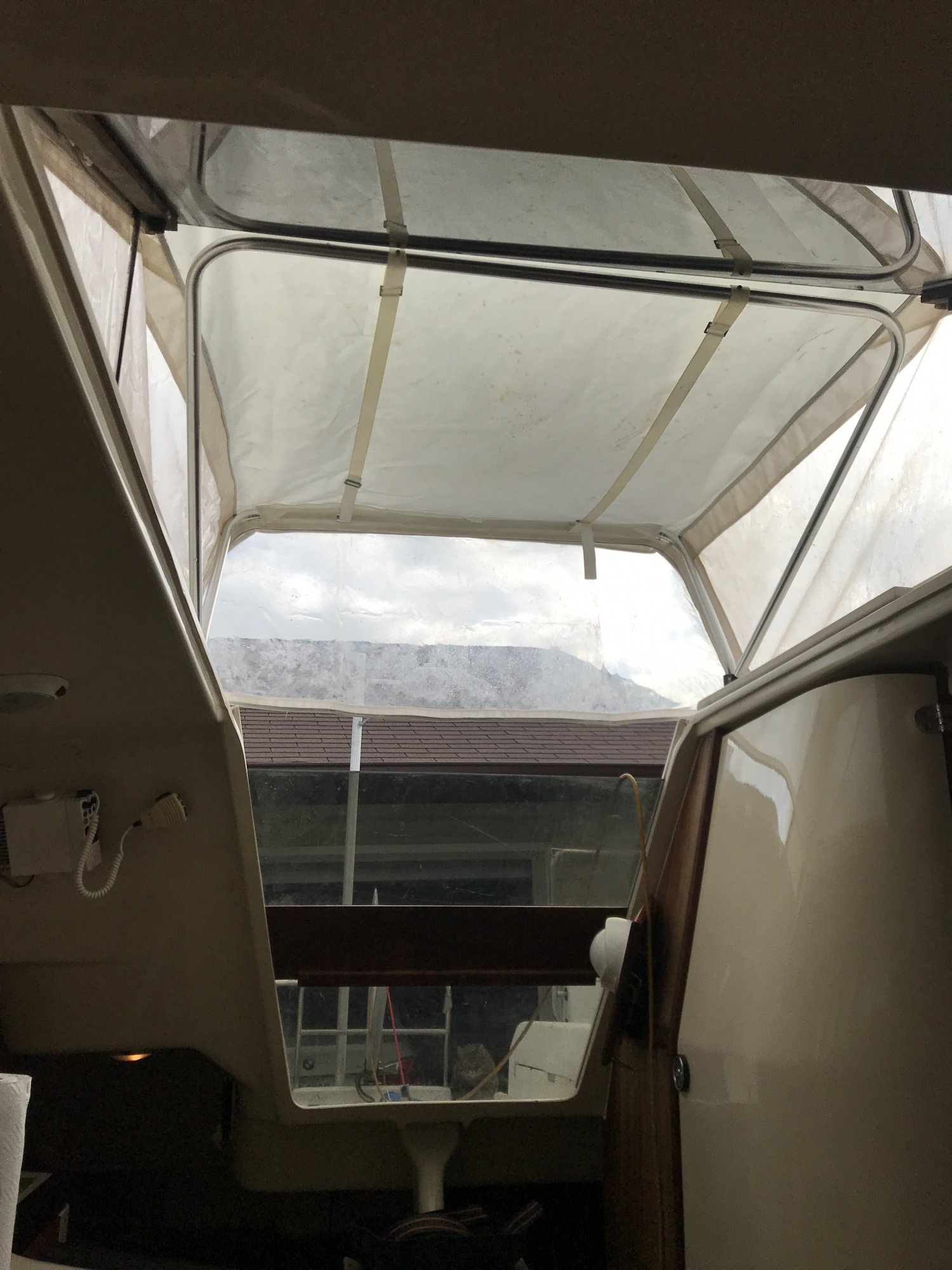

Suggest that you put two throwable cushions underneath the companionway top blue cover to deflect rain water

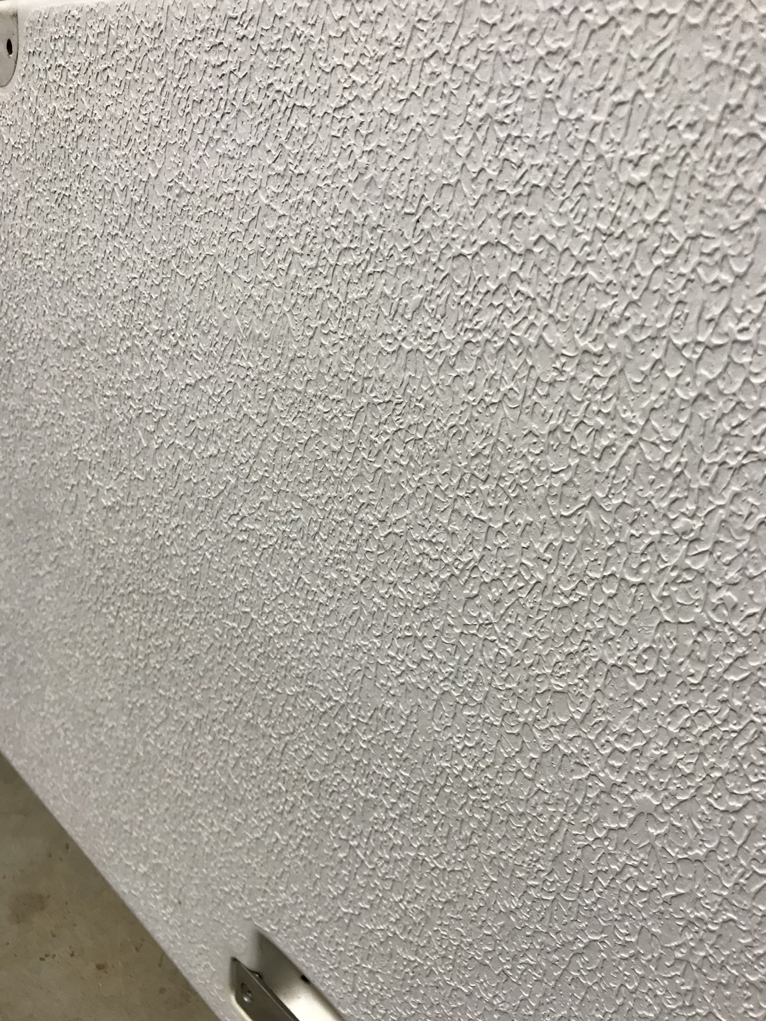

Katherine tried this on the gas tank locker cover.
She thought it worked very well
Will try it on more of the boat later.

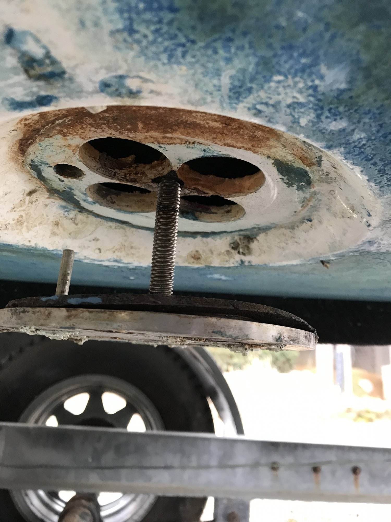

I crawled under the boat to check on the ballast tank valve (some boat yoga to get in there). It was still stuck so I gave it a light bump with my hand and it move a little. Ohh :) Gave it some twisting and wiggling and:
It dropped down (I'd removed the wing nut and washers, only thing holding it in is the clip/key ring through the top of the shaft). Now it moves nicely up and down.
I could easily push it closed. One more thing off the list.

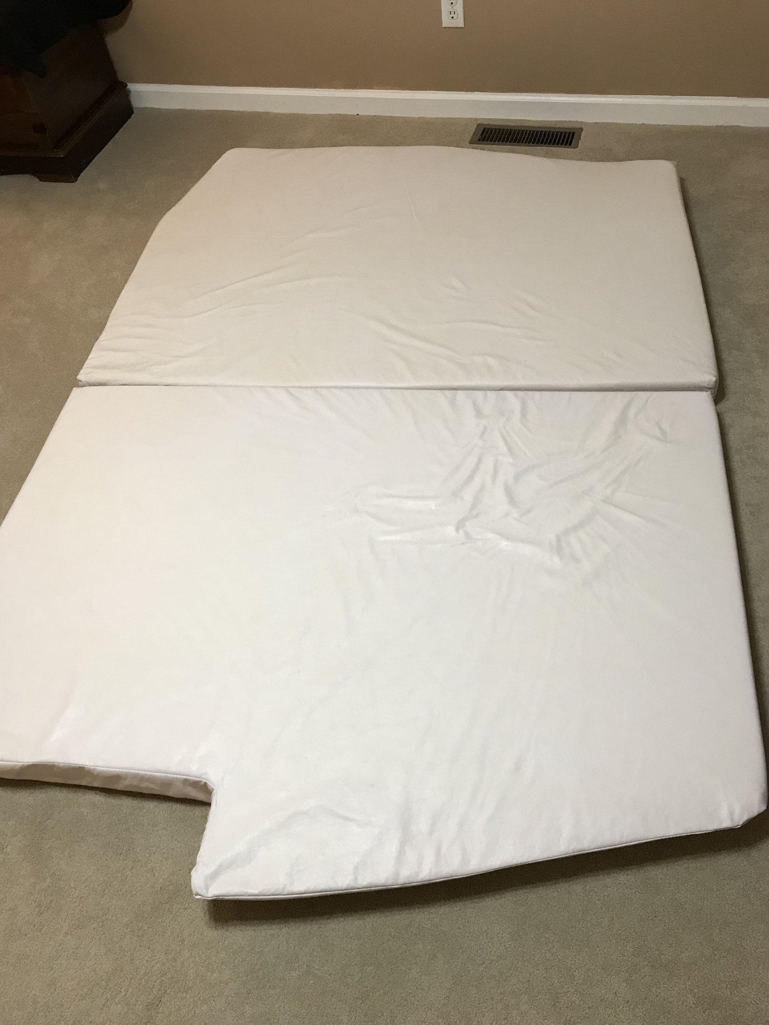

In looking at something else we could cross of the list we saw the rear bed cushions needing to go back in their covers. Seems easy enough. Well not so easy. The first one we started to install and if they hadn't come out of there I wouldn't have thought it could go back. But with enough squeezing and manipulating we got it in. Whew. Now just zip it up. Uh wait. What's this. The zipper doesn't move. Now on this bed cushion it was unzipped when we got it. Didn't think anything of it. But now trying to zip it up we find the zipper traveler is corroded making it clamp onto the fabric. Didn't seem like it should take much to free it up but it did. Then after getting it free it had been distorted enough that it wouldn't zip it properly. Since it is not something that needs open often and I wanted something done and not another thing added to the to do list I persevered with trying to get it to zip. Little by little with lots of help it was finally zipped. The amount of time it took is embarrassing but voilà. The bed cushions are done and ready to go back in the boat.
Dec 20, 2020
127
Prindle 16' Corrotoman River, VA
Well it seems a bought a weather machine and not a boat. In the Month I've owned the boat it's snowed here 4 times. Which for this part of the south is quite a lot. We can go a whole winter with only one snow some years. Things have went a bit slow because of the snow and we are still waiting on engine parts. I very much hate waiting on parts and it has been about 3 weeks waiting on the stator :-( But here are some of the things we got done in the meantime:
Out of the 20 seat cushions the boat has 18 have been removed from the covers, washed, dried and put back together. The remaining 2 are the cockpit bench seat back cushions. These to be only vinyl covered with no additional covering. Ours were screwed to the boat but reviewing pictures of other boats there are no screws. Curious how they attach on those boats. Anyway we are undecided on if we will replace, just toss or reinstall them.

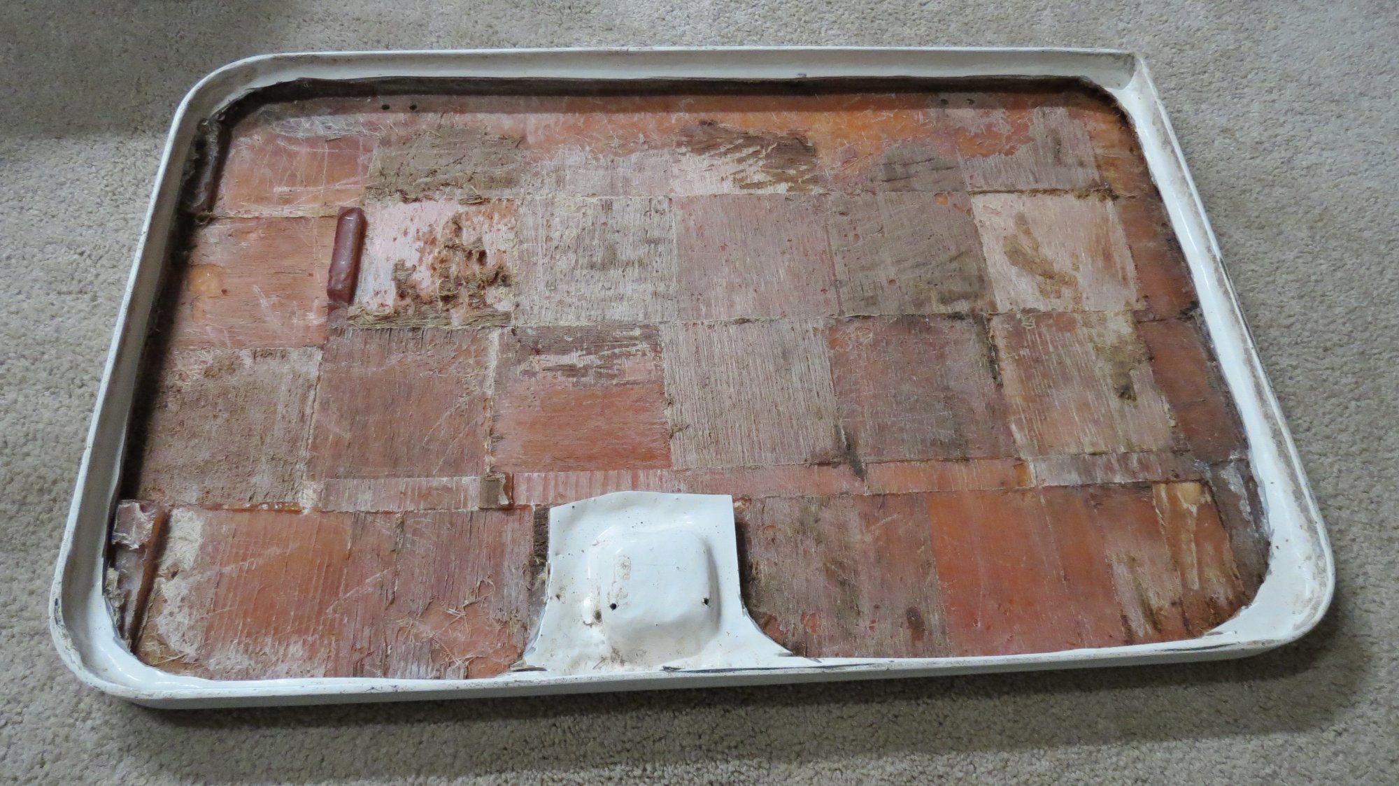

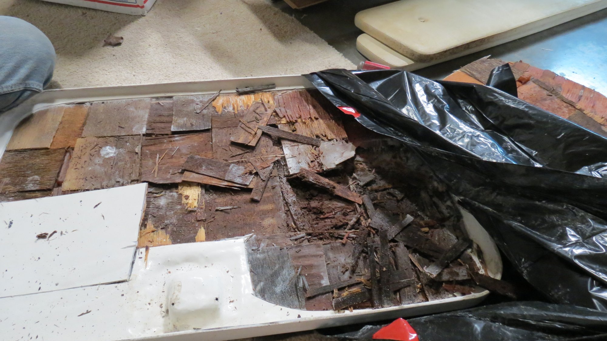

One last thing for today. There was a crack in the gas tank locker cover. Noticed it when we first looked at it. Figured i'd glue the crack up and we'd be good to go. Had brought it in the house and well I'm sure you already guessed it. The crack appears to be from water entering at the hing bolts freezing and splitting it. Which of course means the wood core is all rotted. So we watched some videos of how to repair that which lead to Katherine saying "I want to try it" so we cut ours open to start the repair process. Oddly the wood is a bunch of small pieces like a quilt. Not a big piece of plywood.
Ummm. Not so good. It's all got to go.
Would removed. Need to do some more cleanup before we can start putting it back together.

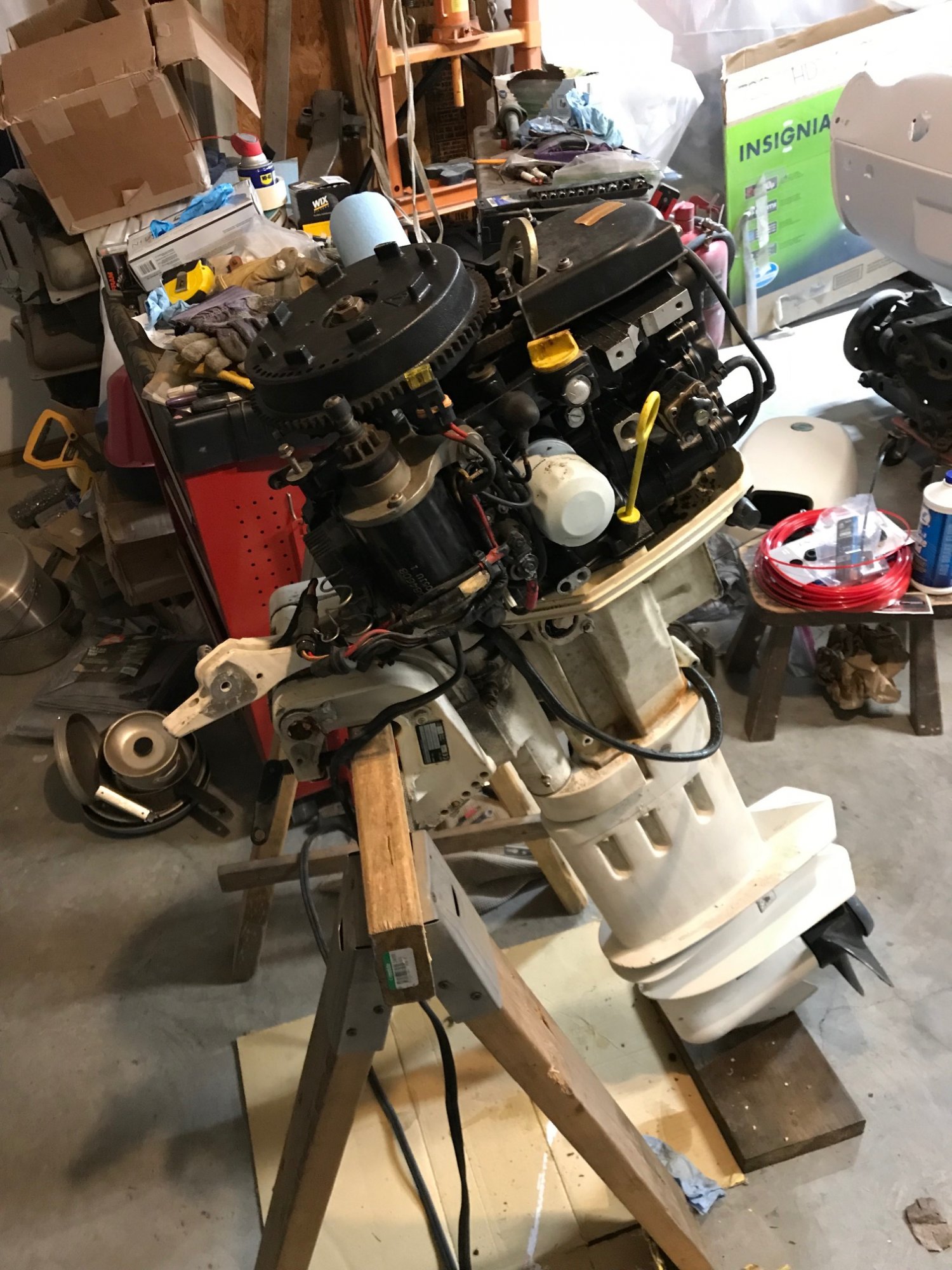

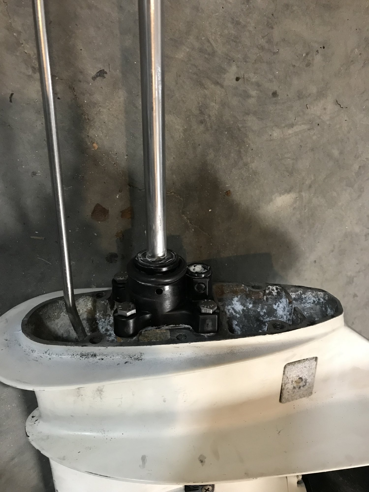

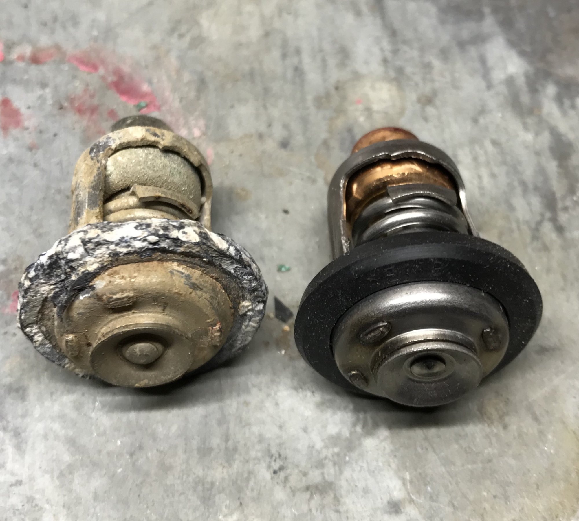

Big news for Saturday is that the motor now has spark! The stator came in and once installed beautiful spark :) I tossed a bit of fuel in the intake and it ran for about 3 seconds and sounded good. With it looking like it was going to run it was time to replace the water pump impeller and housing. Also replaced the thermostat. They were definitely in need. Not many pics of that as I'm sure you have all seen those kind of parts before. It took quite a bit of time but was uneventful. Next up is to see if the engine will run on it's own. To do that I'll have to setup a water system. Something I'm not excited about with freezing temperatures everyday.
New water pump installed. The shift and drive shaft cleaned up well. Old vs new thermostat.

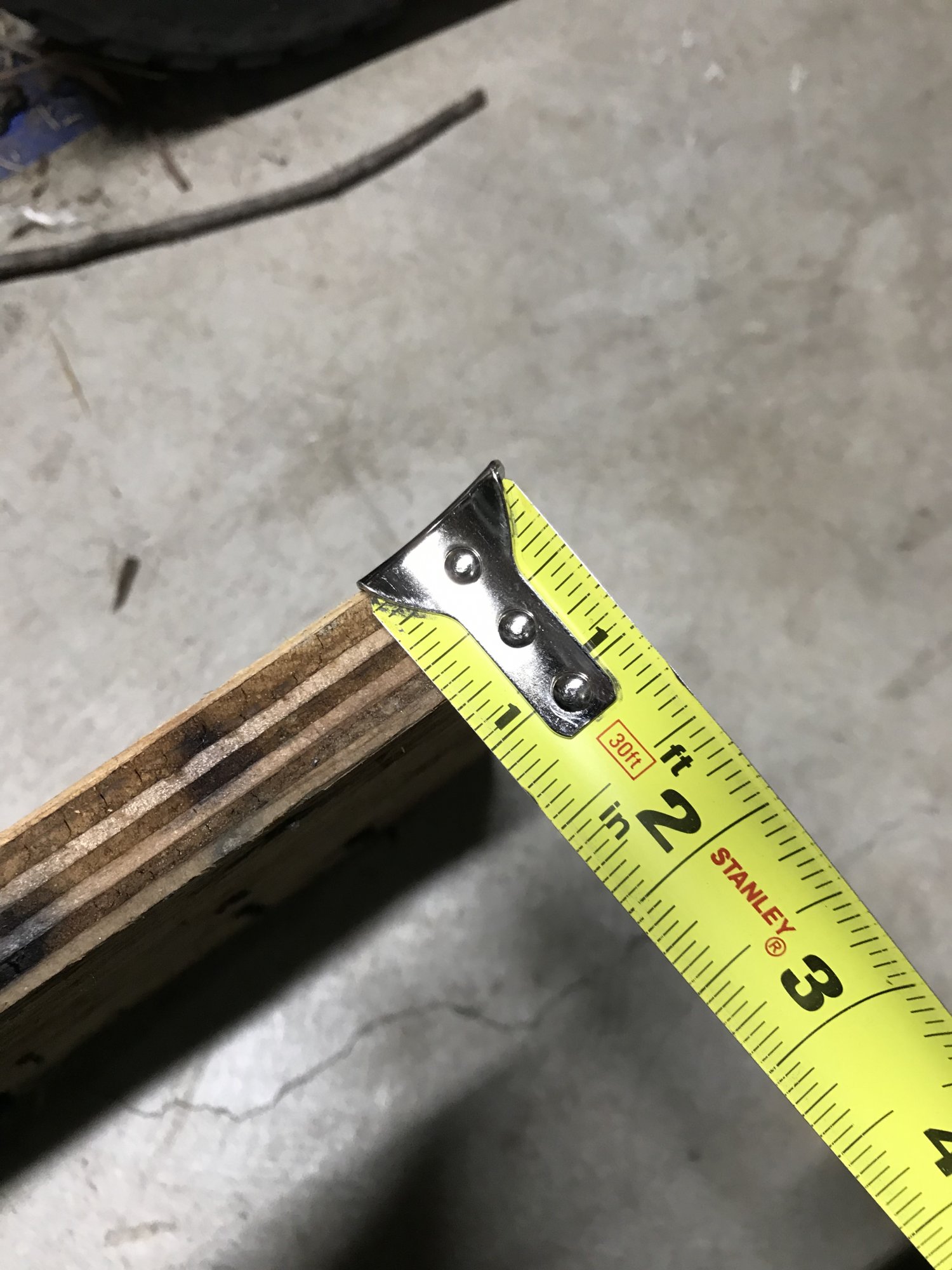

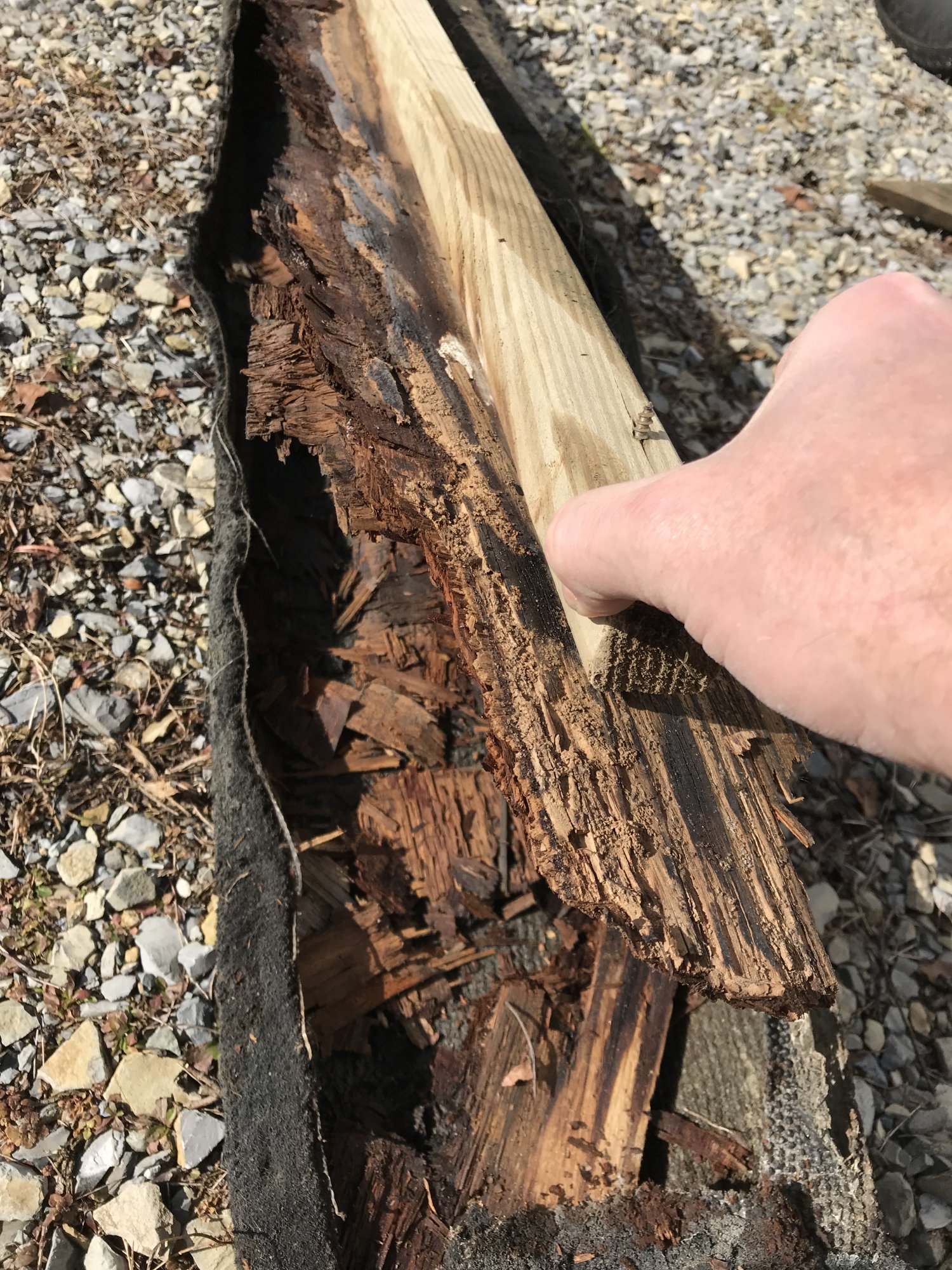

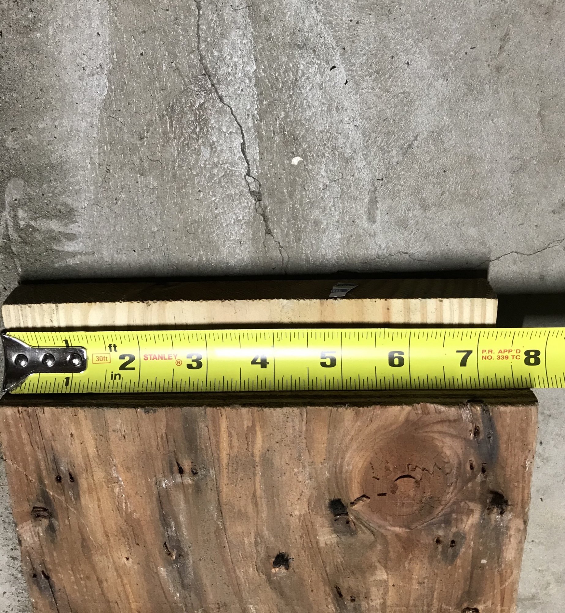

Before the stator arrived I took on the Center board trailer bunk. And as projects go the bunk is NOT a 1" x 8" x 8ft board. It's a piece of plywood that is wider and thinner than the board I have. Ugh. Plywood doesn't seem like the best option to me but that's what it is. After the Fuel locker hatch, I'm thinking that perhaps these were the sizes of some scraps they had from something else? As if it was plywood why not make a 16" wide piece instead of two 8" pieces. Either way i'm going to try and make what I have work. At least for now. I drilled one hole and removed the fabric from the old bunk and stapled it to the wood (sorry yes, reusing the old fabric. Getting tired of spending money on this project and odds are this will be redone with plywood later). Took it out to the trailer and it looks like i can get it to bolt it. But was not in the mood to fight it at the moment as it was snowing....again.
New board is 7 1/4 wide and old plywood board was 7 3/4 wide.
What is that 11/16" thick? Whatever that is in nominal plywood thickness.

When I bought my H26 the gas tank cover was made of plywood so I suspect the same thing happened to mine at some point. I currentlyhave a project on the go to replace the plywood with HDPE. The stern rails seats were also plywood which I changed to HDPE as well some years ago and posted some pics. I was very happy with the results of that project.
