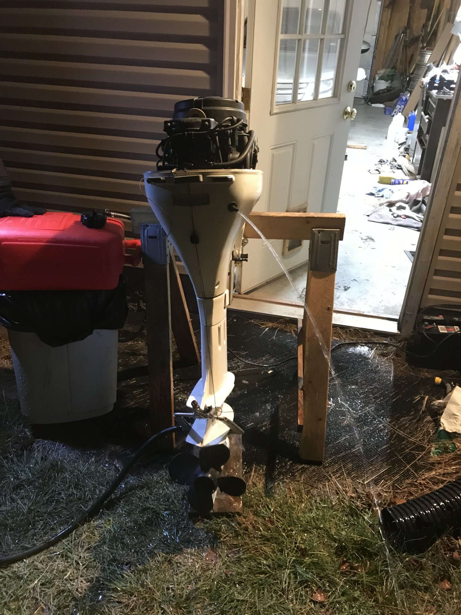

Monday night we started the motor in the garage. Had it in a tub of water but it wasn't putting out water through the overboard tube. Shut it down after a few seconds and checked it all over. No faults found and most diagnostics say replace the water pump, and I did that already. Started it again and it was still no go. Was becoming worried my water pump repair was a bust. Then I took the overboard hose off and checked it seperately and it that little hose was clogged, easy fix. With the motor now pumping water we got to run the engine quite awhile and splash water all over the floor (my tub was a little on the short and small side.) Was good to verify the engine works. I'm still thinking of opening up the carburetor. The idea of it sucking up some dirt and conking out when I need it most is a bit worrisome.

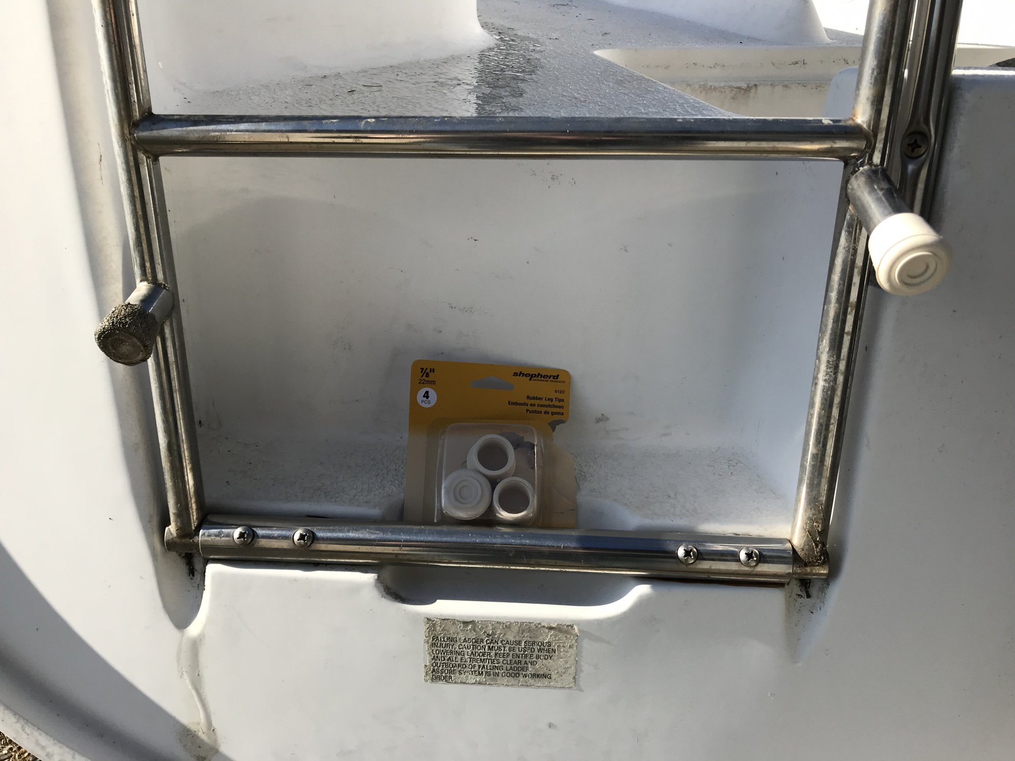

Also replaced the ladder rubber bumpers. White chair ends were a near perfect match. New on the right. Decaying old nasty one on the left.

Not sure what motor you have. But if any of the jets can be removed without taking the whole carb off, I'd do that and make sure the orifice is clean. My 8hp Honda has an idle jet on the top that simply screws out. It gets dirty easily causing the motor to die when throttle is applied. By cleaning it kind of often it's much more reliable.
Sounds like a nice feature to be able to clean it without taking everything apart. On mine I cannot even get the bowl off without removing the carb from the engine. So I did. Feel better having cleaned out the little bit of goo in the bottom.
And tonight I took it out of the garage and ran it some more. Seems to run pretty good.

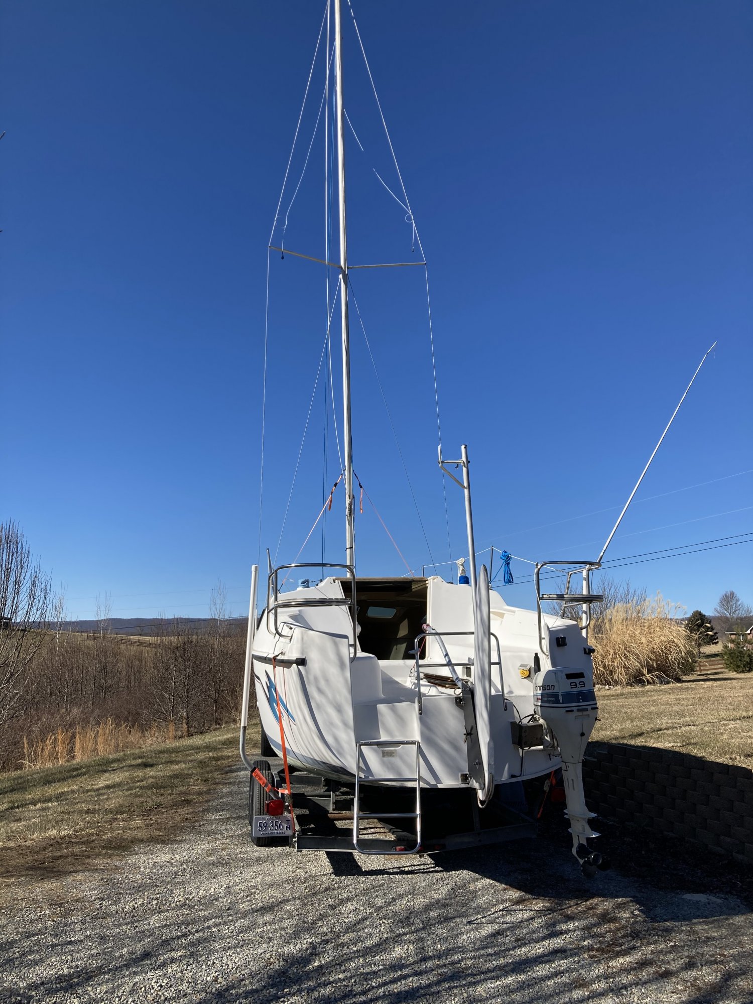

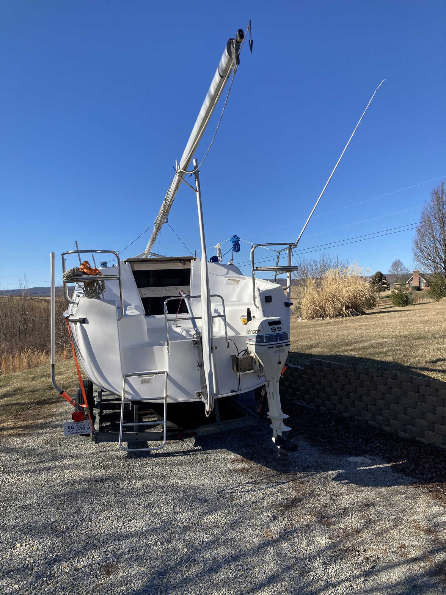

Here is what we did:
  • Installed two new tires (they are all new now)
  • Tightened the RH fender. Well broke the bolt off trying and replaced it.
  • Checked the torque on the motor flywheel and installed the motor cover.
  • Installed the motor. This time tightening the claps and installing the bolts. Scary we drove home with neither of these inplace.
  • Installed the new (well slightly used) Trailer winch.
  • Installed the new LH centerboard bunk.
  • Made a mast bridal out of a couple of "s" hooks and a couple straps we had.
  • Lowered the mast - The bridals worked great and it went right into the mast crutch with no assistance.
  • Installed the battery
  • Installed a yach battery charger (well I strapped it to the battery box, chincy but it'll work)
  • Reinstalled the bulkhead aft of the bed.
  • Coupled the truck to the trailer and found the saftey chains and light wires didn't reach the truck. What the? Then it hit me the new coupler is longer than the old one. Oh. Well that has to be sorted out before we do anywhere.
If you didn't guess already we didn't make it to the lake. But the weather forcast is predicting in the 60's here on tuesday. Might be worth a half day off of work to go out in that :)

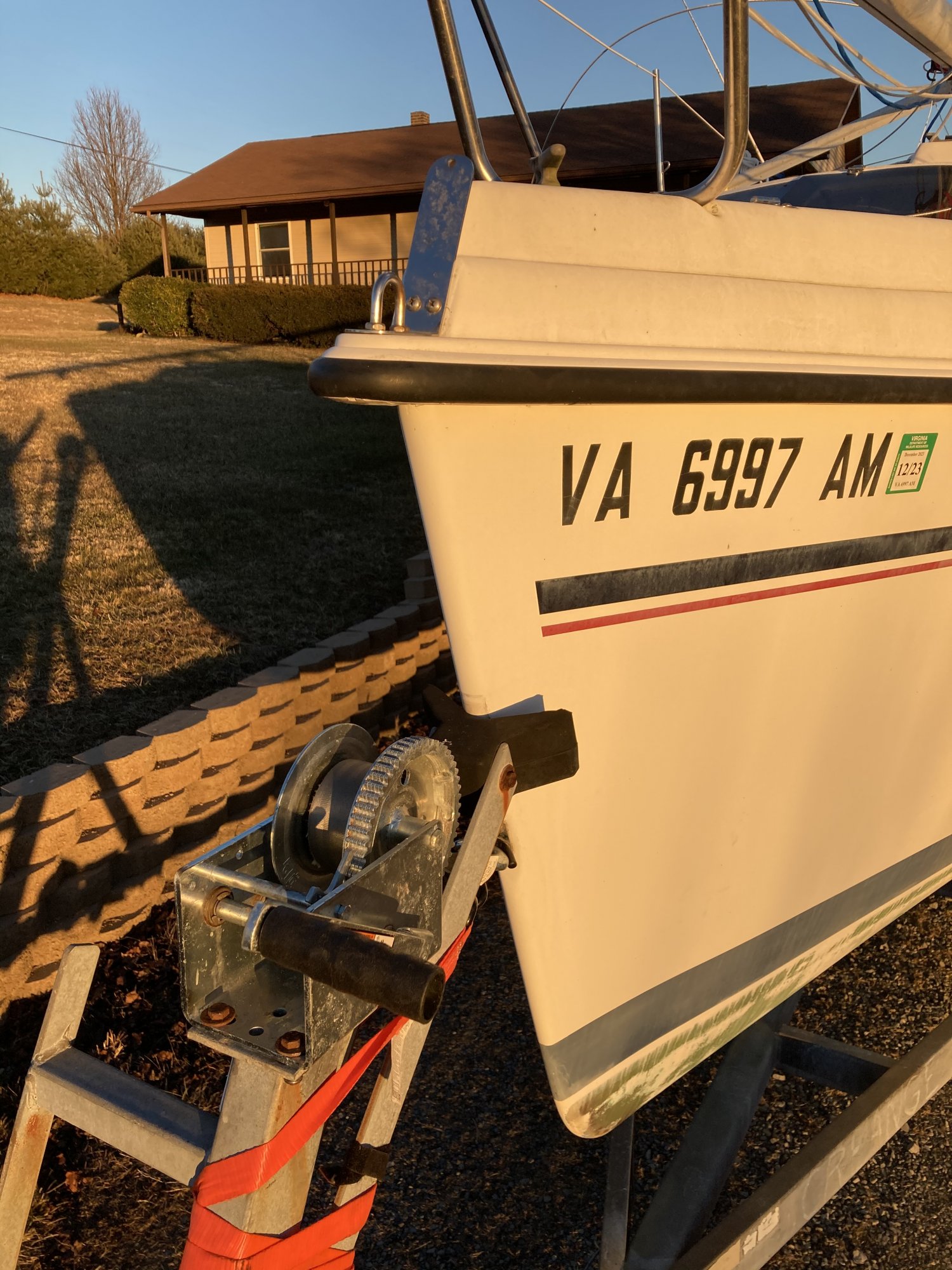

Tie down winch handle on trailer stand as I have seen locking mechanism come loose. The one on trailer winch stand. Tie off rudder in up position to port stern rail. Learned hard way when a new rudder came down in transport on I-64. Advise if transporting motor on transom. Is antenna being laid down during transporting? Which lake are you going to. Weather will be windy as same system will hit here first
Thanks for the tips. I'm very surprised the boat trailer doesn't come with a safety strap for the front. I thought that was common. For the original trip home and for this as well I added a strap. Though when we got the boat there was also a bolted cable, kind of like a bike lock on the front.
For the test float we are going to Claytor Lake state park which is only a 15 min drive from my house. The boat will be secured better than it was for the original 5 hour trip home. So no worries there.

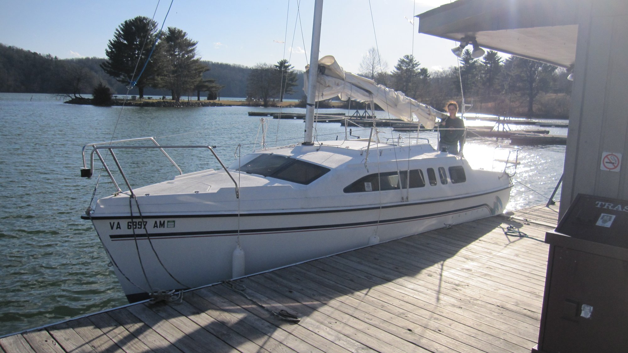

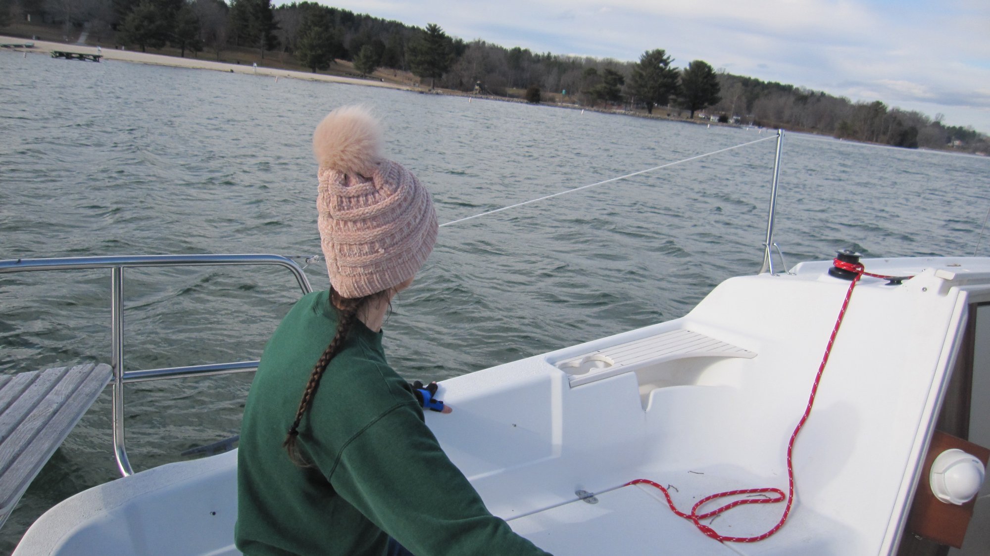

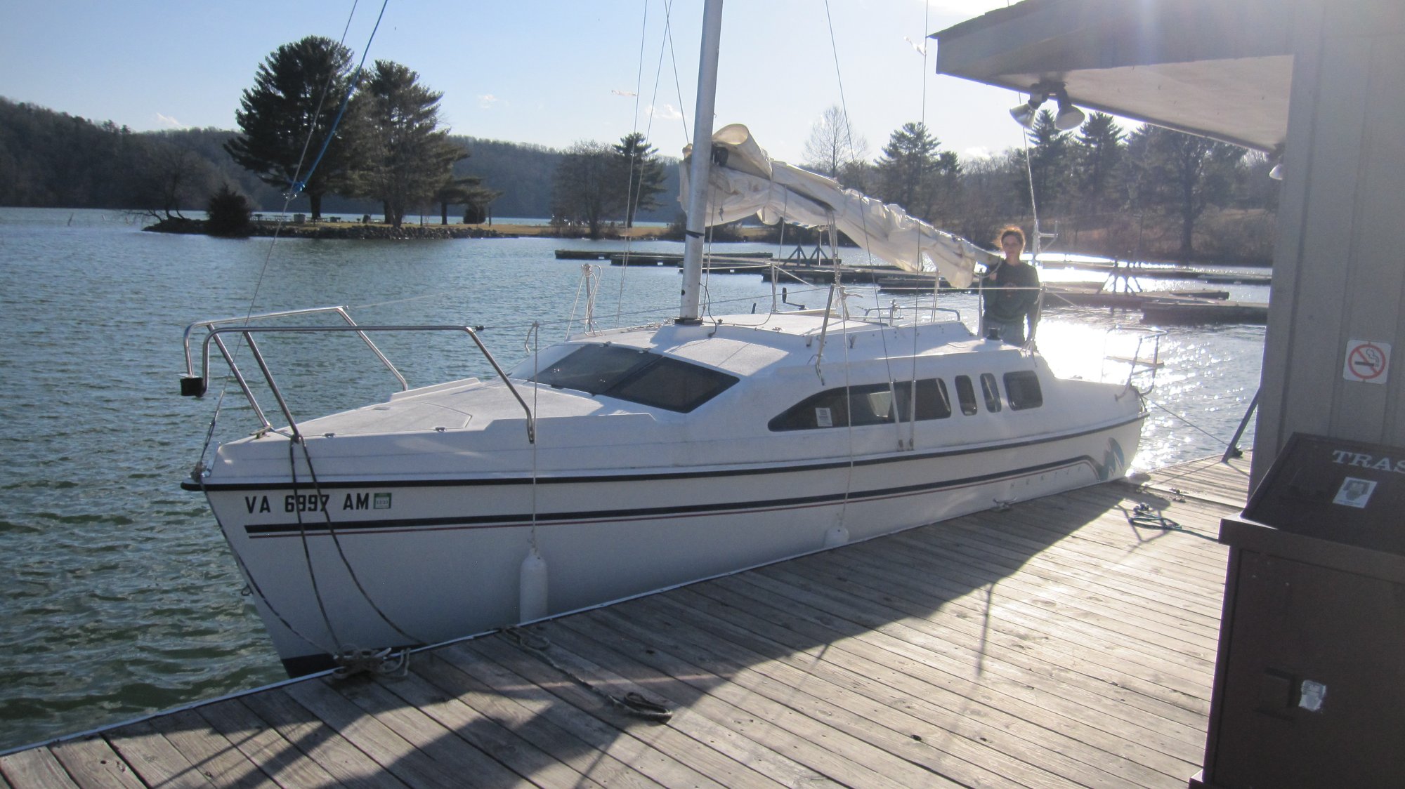

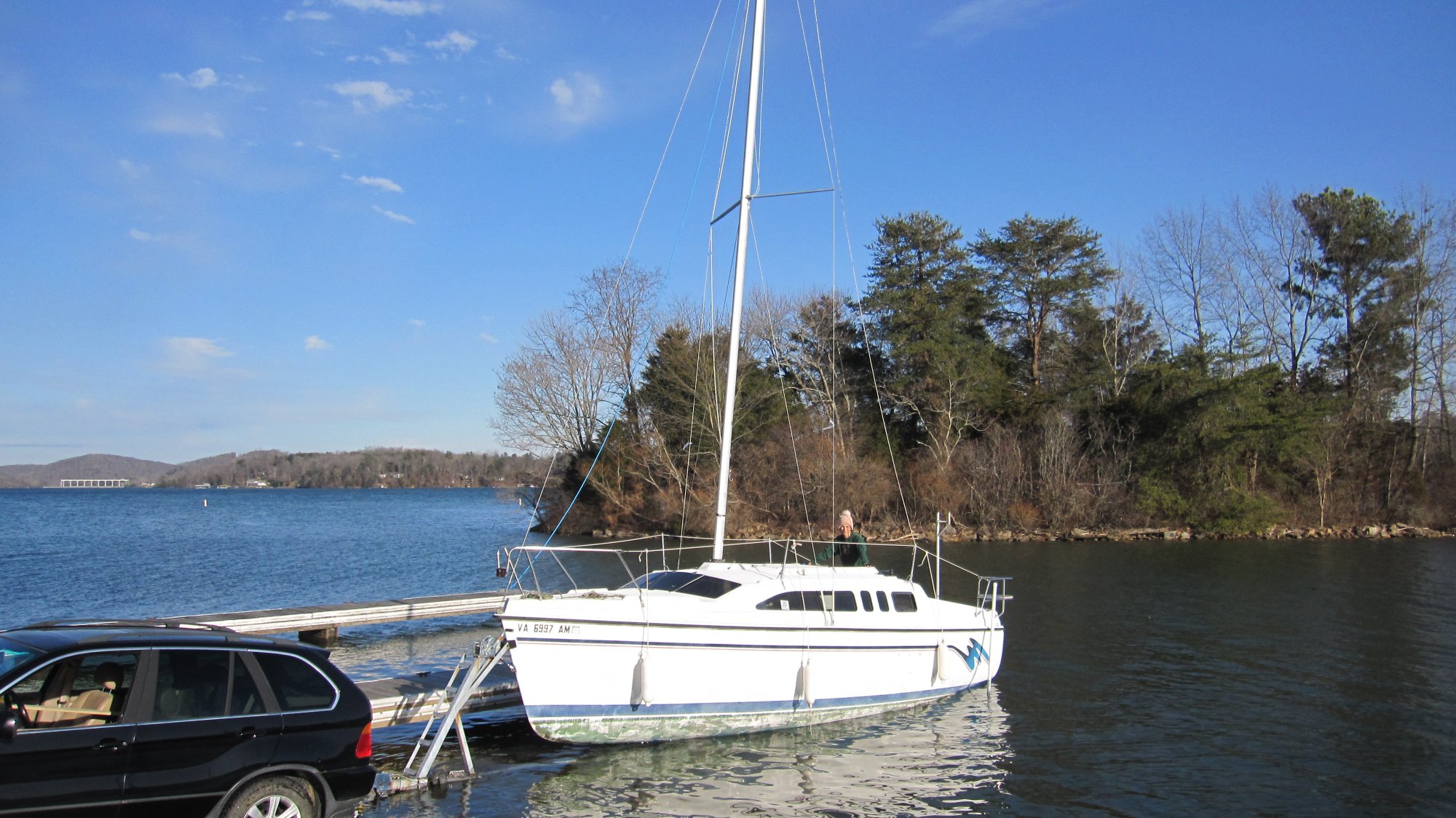

Well the boat floats :) Tried it out and we didn't sink. Didn't do a lot as we didn't have much time. But we did take it out on the water.
Heading back to the boat launch. Katherine on the tiller.

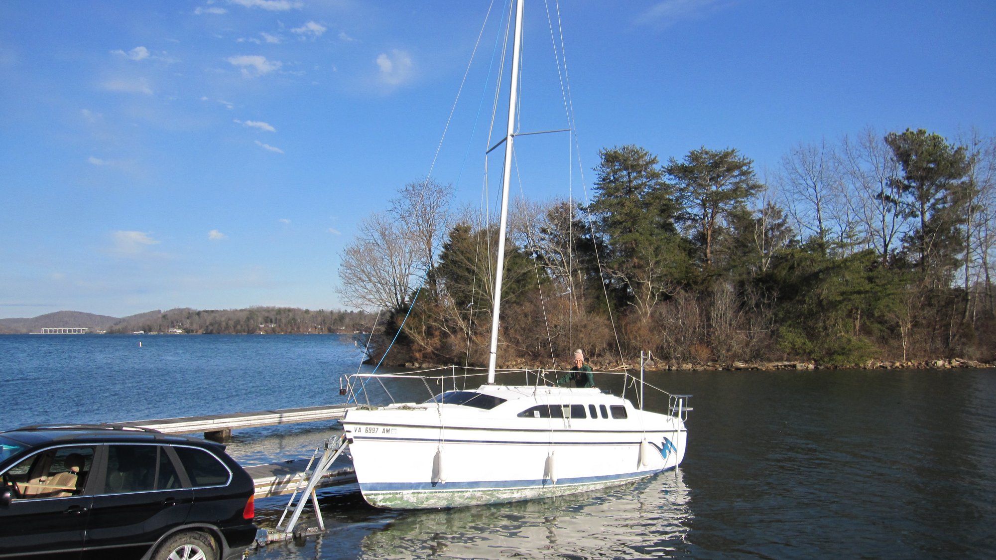

Docked and removing the sails while waiting for the launch to clear. Oddly a bunch of folks were launching when we were ready to pull out. For my first time loading the boat. I thought it'd be best to have fewer things to hit.
Successfully on the trailer. That actually went really well.
One of the most striking things about the test was how difficult it was to see to steer/drive while underway using the motor. We have a tiller steering motor and to reach the throttle and FWD/REV lever I basically have to sit on the floor. In that position it's impossible to see where we were going. I've motor boated a lot and never expected the driving under motor power to be so hard. To get on the trailer Katherine sat on the bow and pointed right and left to guide me. We've got to come up with something a bit easier.
My boat is set up with a wheel and the transmission and throttle are remote via cable (like a bicycle brake cable). I have the original Honda 9.9 so it can be set up for remote control. If you would like pictures, let me know.

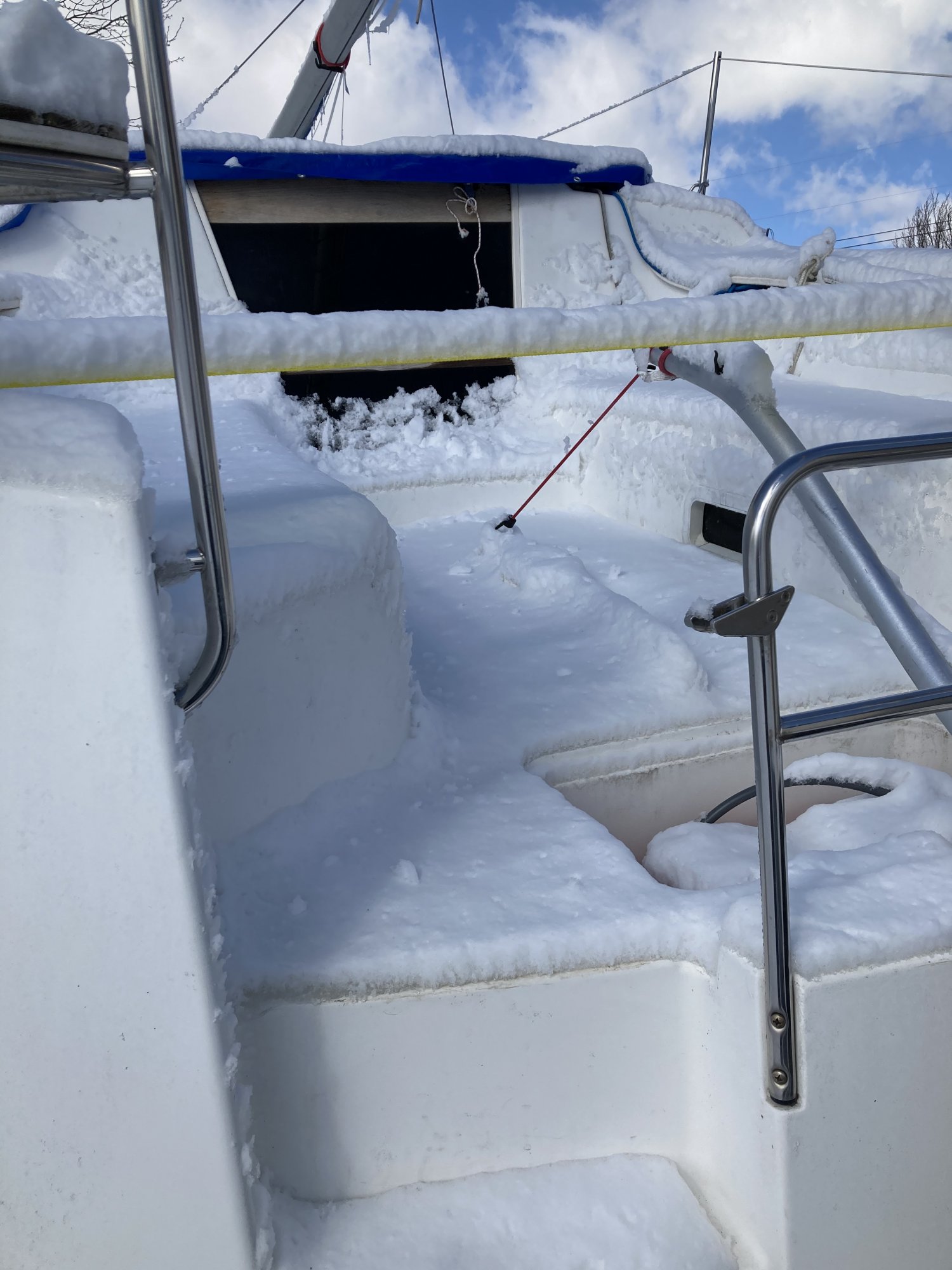

I have also ordered an remote engine controls box. Would like to start mocking up mounting locations but our weather machine brought us this.
