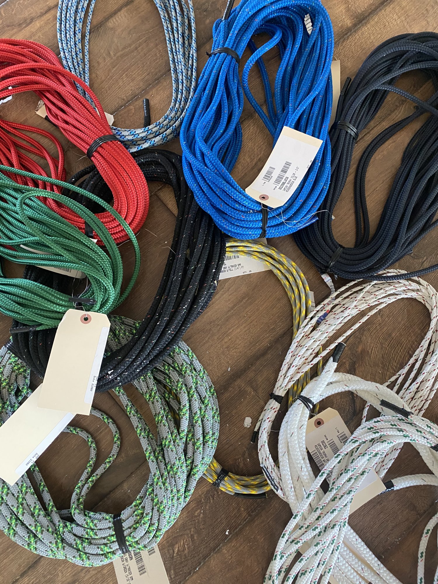

On color coordination of lines, look under boat information at the 260 as it was standard with all waterballast. Solid red for jib halyard and solid blue for main halyard.
The reason for color coordination was primarily for the new sailors who lacked sailboat terminology till they learned it

Thanks for everyone’s comments and replies. I tried to pick out a color scheme but availability and price ended up deciding for me. I have a few projects in the works that I’ll throw up in a week or two.

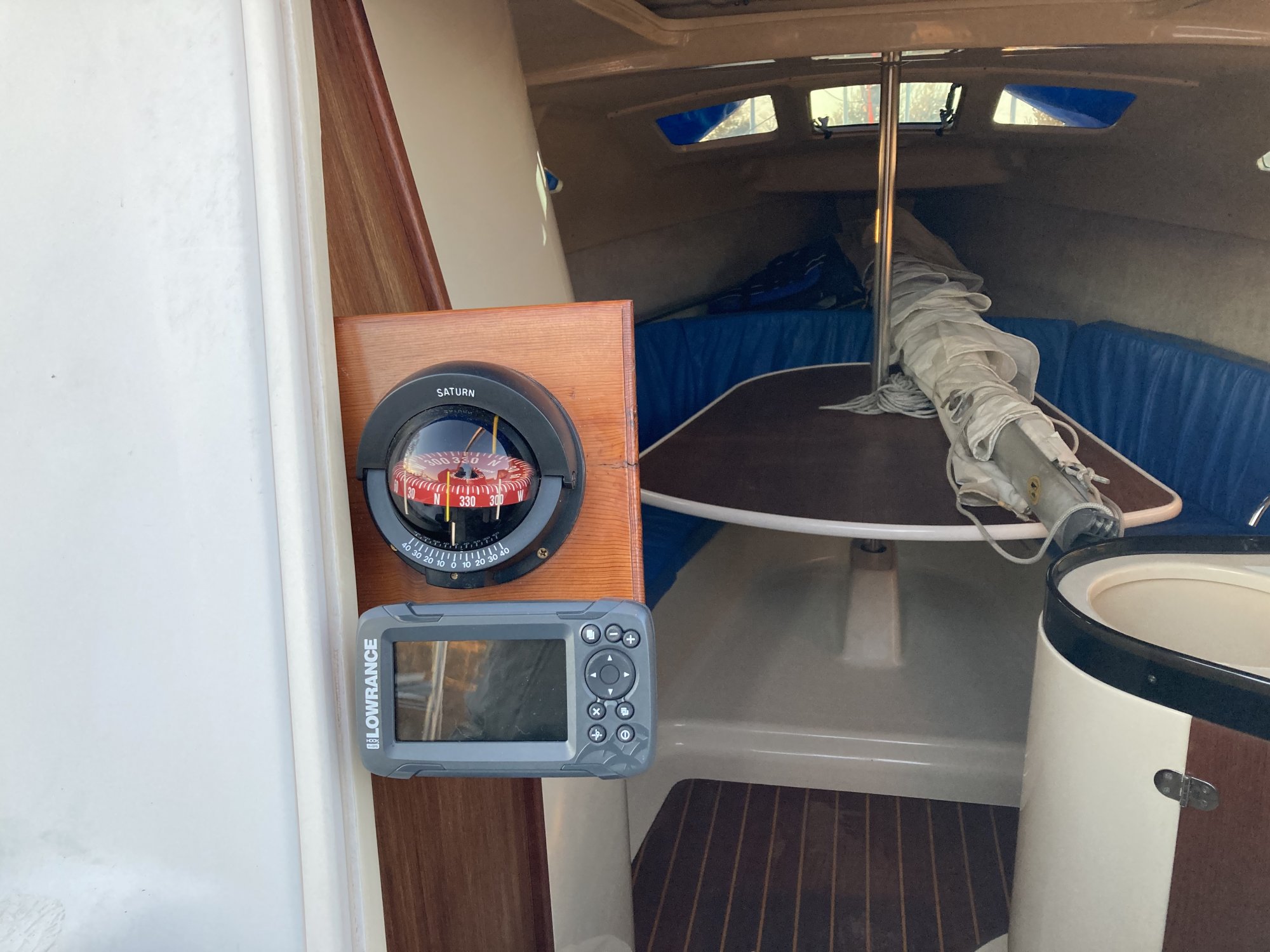

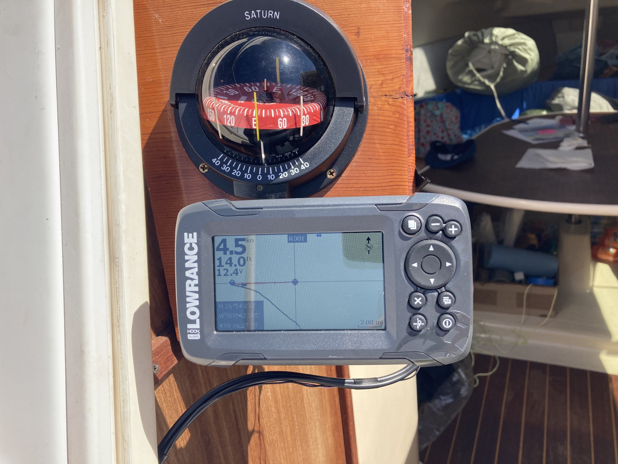

This week we had a warm day and I opened the boat and started looking at how to install the dept finder. The previous owner installed a swing out board to mount the compass (without connecting up the compass light wiring). For now I figured it's a good place to try for the dept finder. I didn't mind drilling holes into the added board as I'll likely be revising that anyway.
Still more to do but it has a home for now.

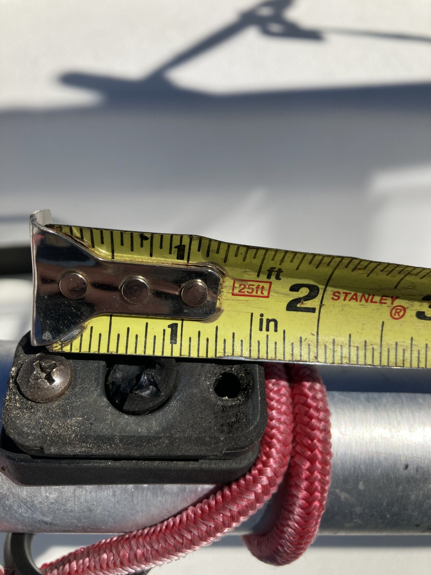

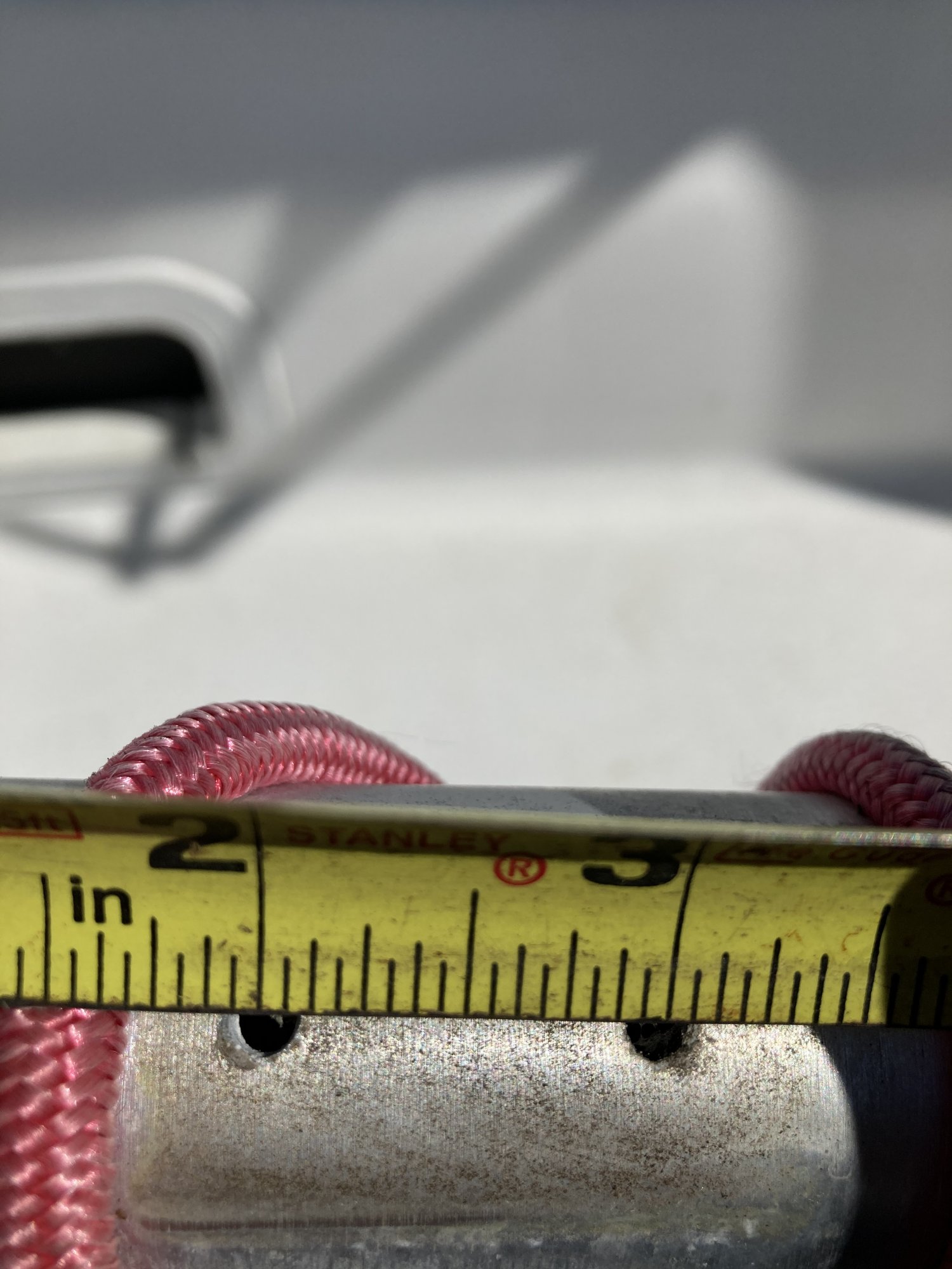

I also looked at the broken tiller extension. Apparently this is not original as there was only one screw holding it down.
And it was clear why, the hole spacing is different in the tiller.
After some looking on the web I finally realized what is often sold as a "universal joint" is just a piece of flexible rubber ("I don't think that word mean what you think it means"). I had pictured a ball in socket affair. Glad I figured that isn't the way it works before buying one. I guess people like the flexible rubber thing but it doesn't sit right with me. Especially since it appear the rubber degrades and breaks off in a fairly short time (as mine did at some point in it's life, loosing the whole extension) I may as well just lash a piece of tubing to the tiller with some rope. Yah I see there are some real universal joint versions out there. May look at that later.

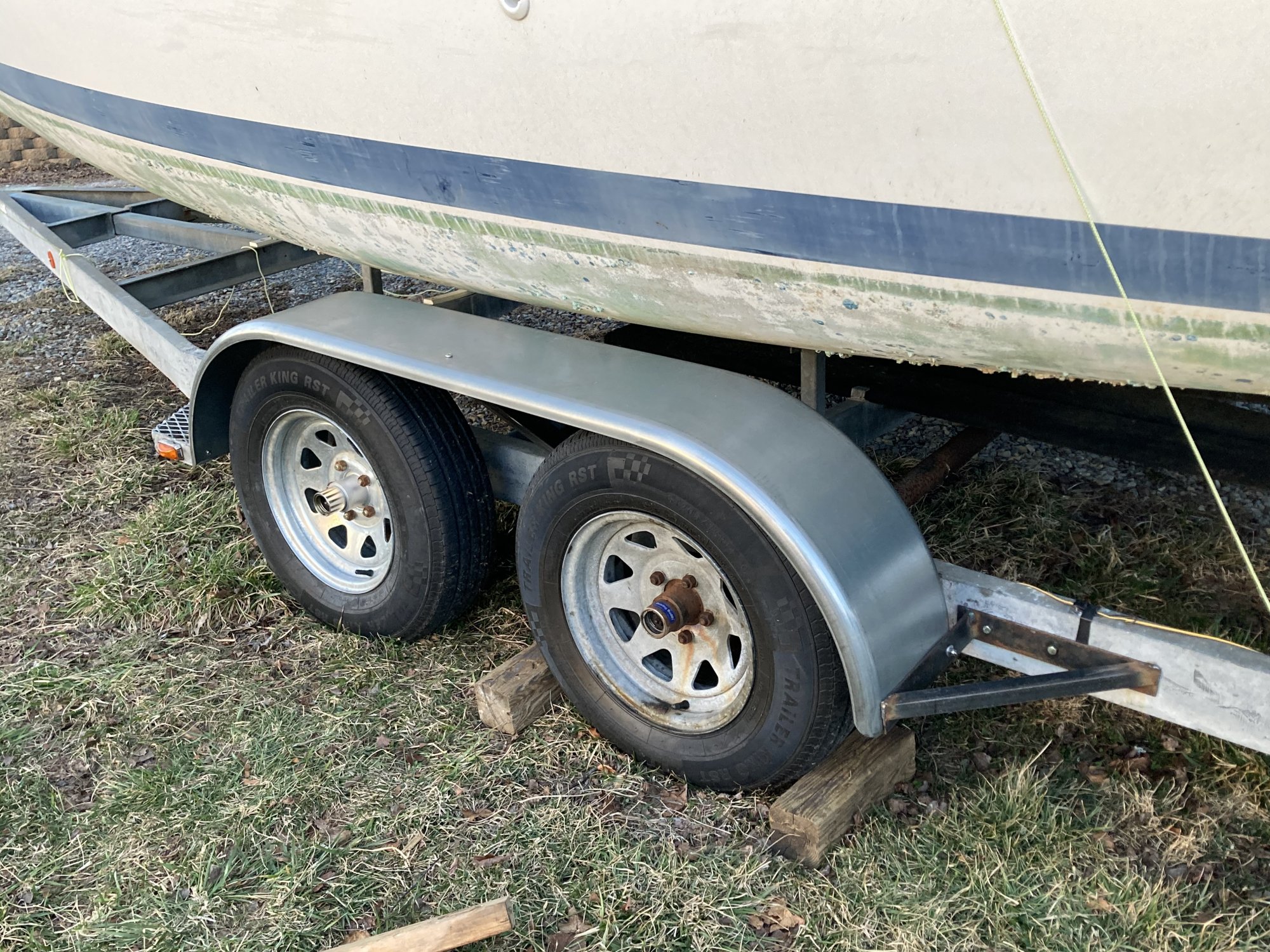

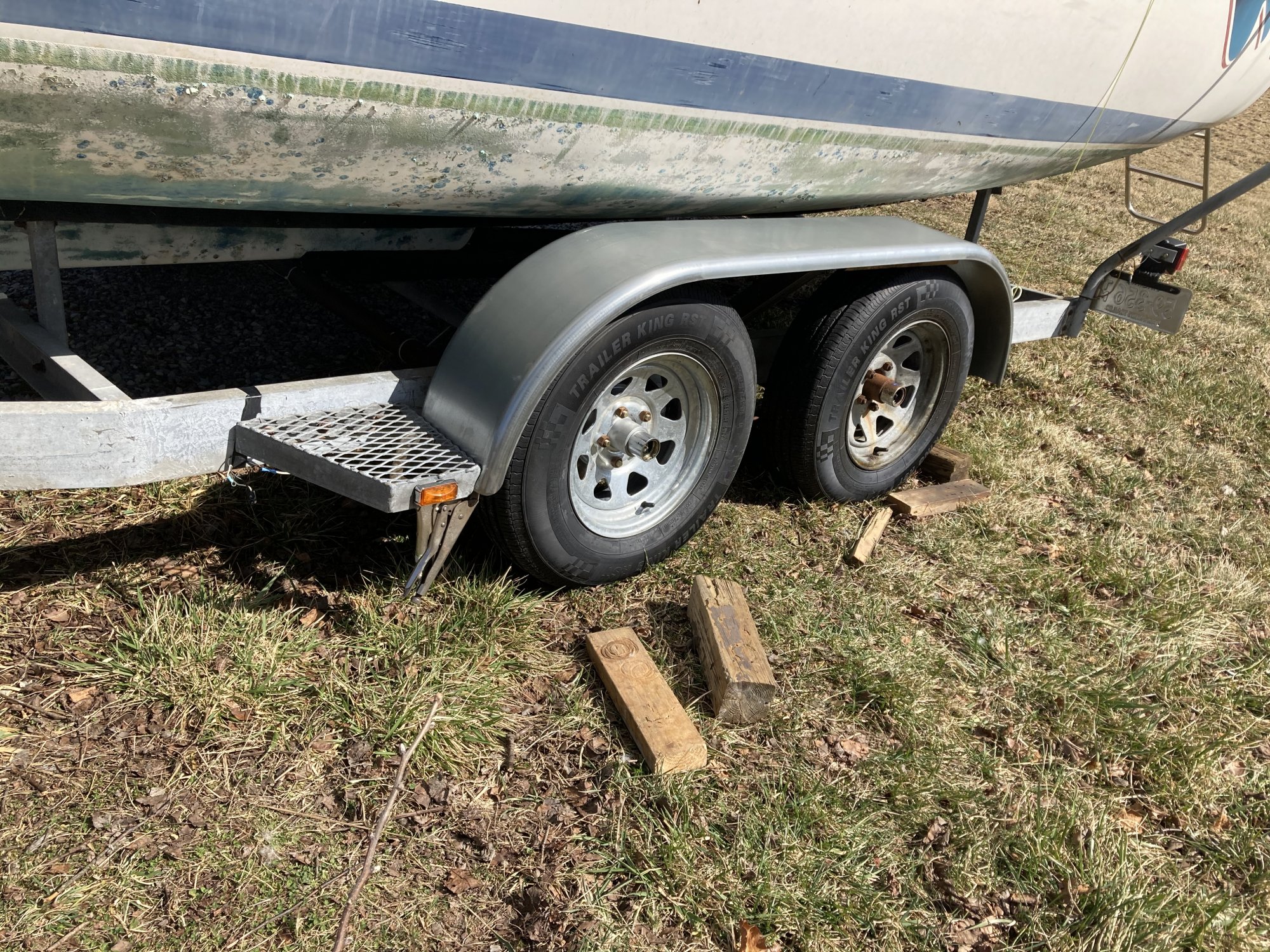

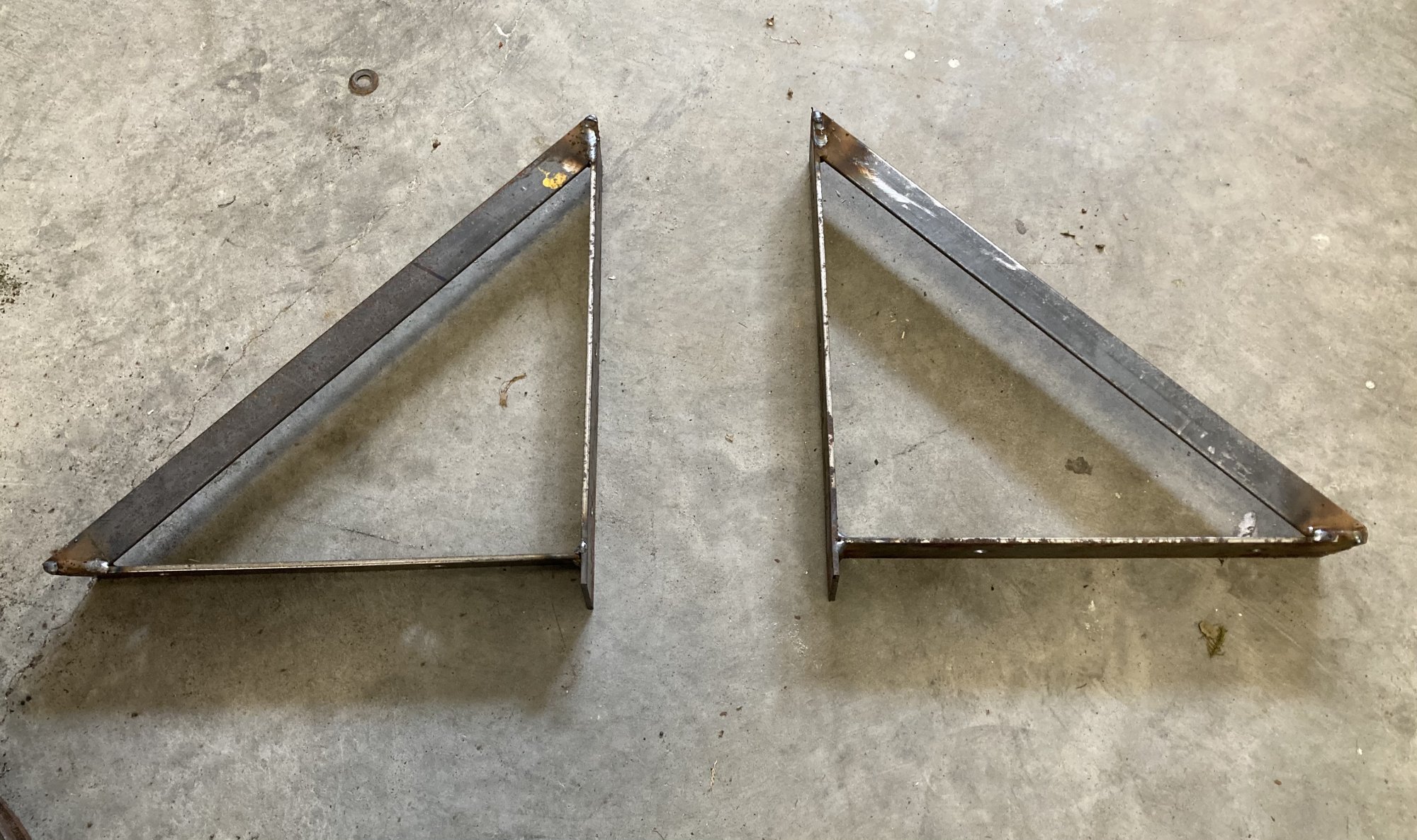

One of the big issues left before the trip, that is drawing close quickly, is the trailer fender. Decided to buy the fender part instead of fabricating it out of flat stock. Running out of time and it's not been warm enough to enjoy being outside. But that leaves me needing all he mounting brackets/steps. Katherine had the great idea of taking the rear one from the RH side and using it on the front left. Sure enough all 4 of the brackets/steps are the same. Well except for the mounting for the clearance light. We did exactly that. Drilled a few holes for the clearance light and voila, looks factory original at the front.
For the back, since it didn't need a light, I fabricated some angle brackets with the same hole pattern and lengths on the "L" as the factory brackets. I also made a new center support bracket. Ran out of energy and time but there is just need a little more and that needs to be done.

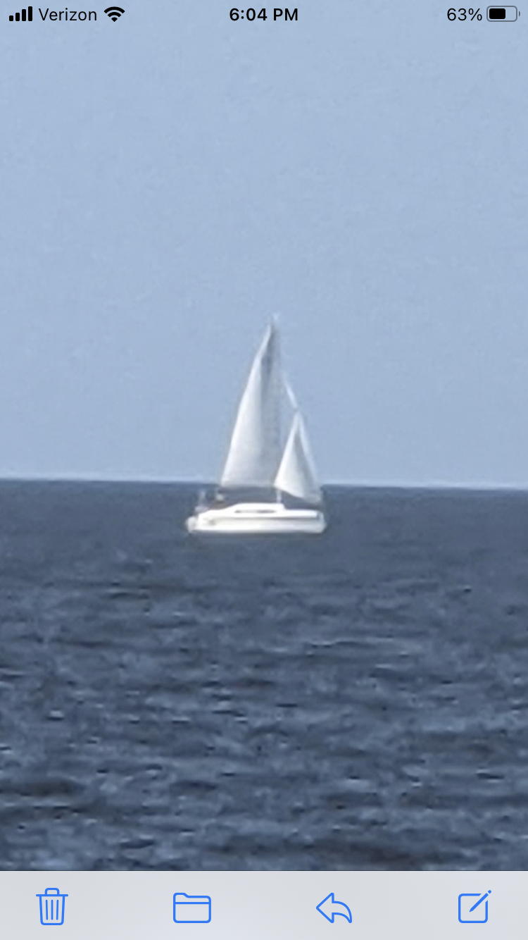

I just reviewed your posts and see you already posted pics of the boat in the water. But more would be nice :)
Also, I don't know if you have gone to the Hunter owners resources section of this site, but you'll find there the H26 owners manual that has some good diagrams that should help. Also, checkout the 260 manual. It is better quality, and much information is similar to the 26.
Looking forward to seeing what else you do to your boat! No pressure ;)
https://sbo.sailboatowners.com/downloads/Hunter_26_82584071.pdf
HunterOwners.com downloads
Yes the only owners section is great. Read so much over there.

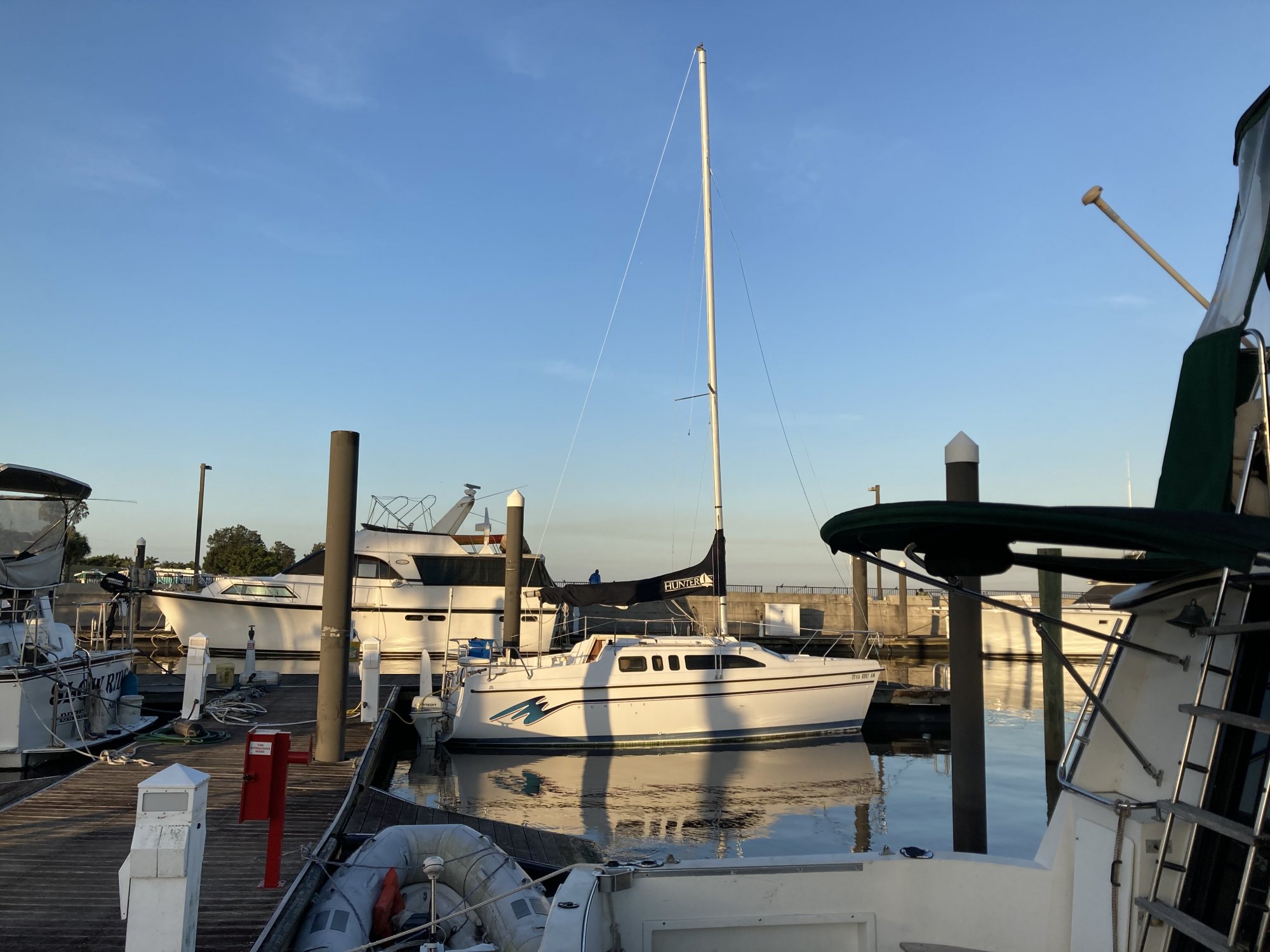

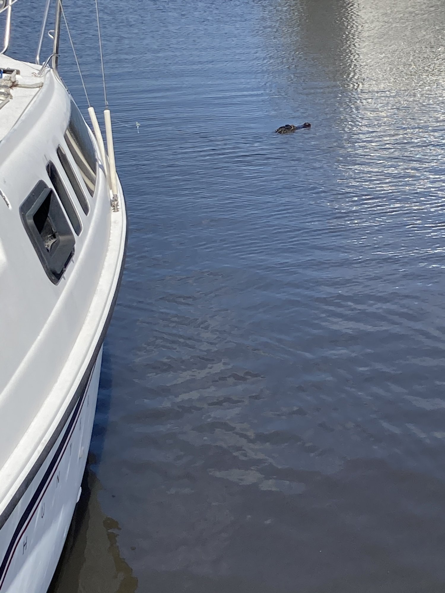

Attached are some pics of it n the water. And yes there is an alligator next to the boat in the shot looking down it.

Our depth finder isn’t anything fancy. It’s just a fish finder with GPS. The transducer is designed to be transom mounted in the water. I mounted it to the inside of the hull with wax like others described in the forum. It t seems to be working though
I temporarily ran the wiring to the marine radio for power and used painters tape to stick-it to the walls. I was serious about bailing wire and duct tape. More about where else those have been applied later.

The first up was finishing installing the fender brackets I made.

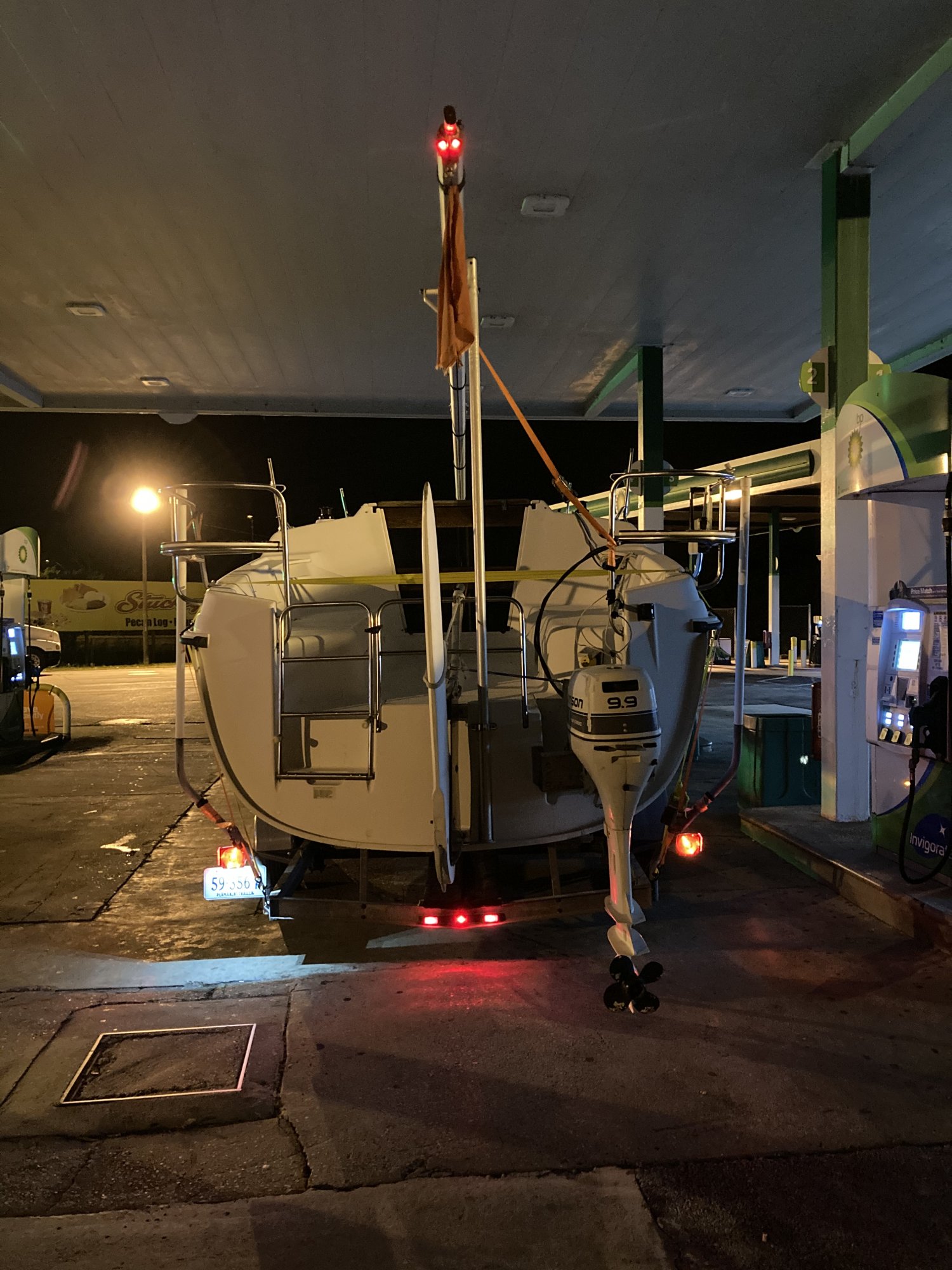

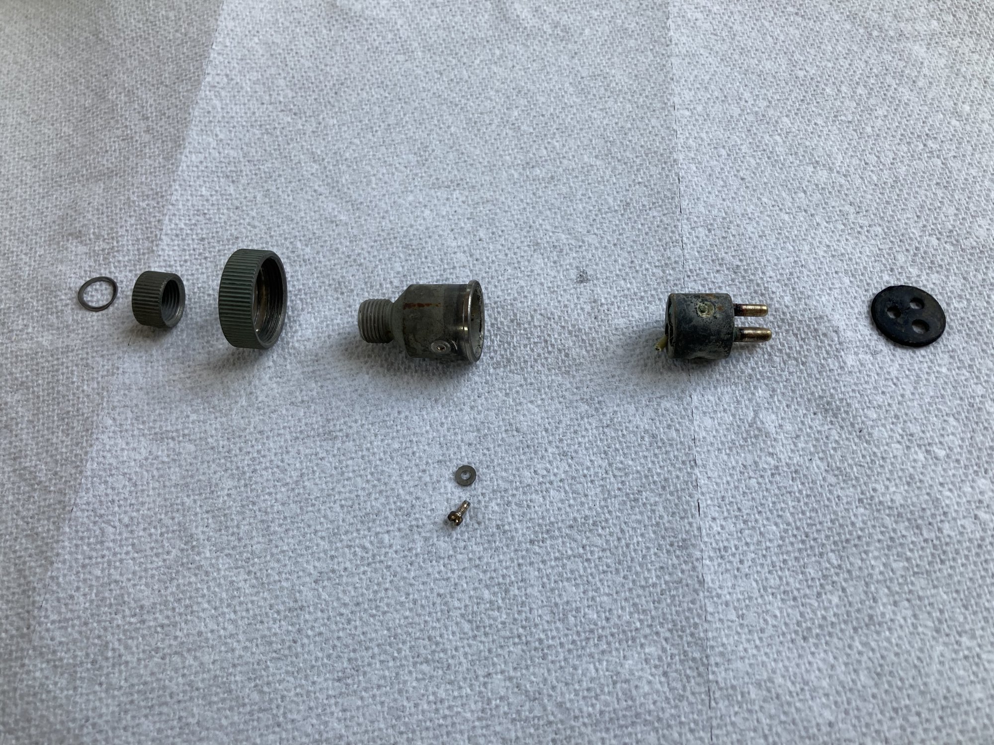

the masthead light didn’t work when tested so I removed it and cleaned it. Then I added a bracket and a pair of red clearance lights (each at a 45 degree for side and rear
Visibility for when we trailer at night). Plan is to connect it to the mast head wiring but - to + so that it won’t light with the mast light but on the trailer I can connect the power in reverse and it’ll light. Of course the masthead light being a standard light would also light. So I add a diode to it’s wiring. Worked great in test and I soldered it all together. A few days later I installed it and it didn’t work. I was getting ground to the light but no power to either the anchor or steam light. A very long story short the deck connector quit working on both power leads at the same time. Unexpected but was good to find the problem. Below is the connector disassembled.
So need a new deck connector. But there was no more time and I used alligator clip leads to connect it to my trailer harness. I think the light looks great. Gets the lighting legal and the more visibility the better

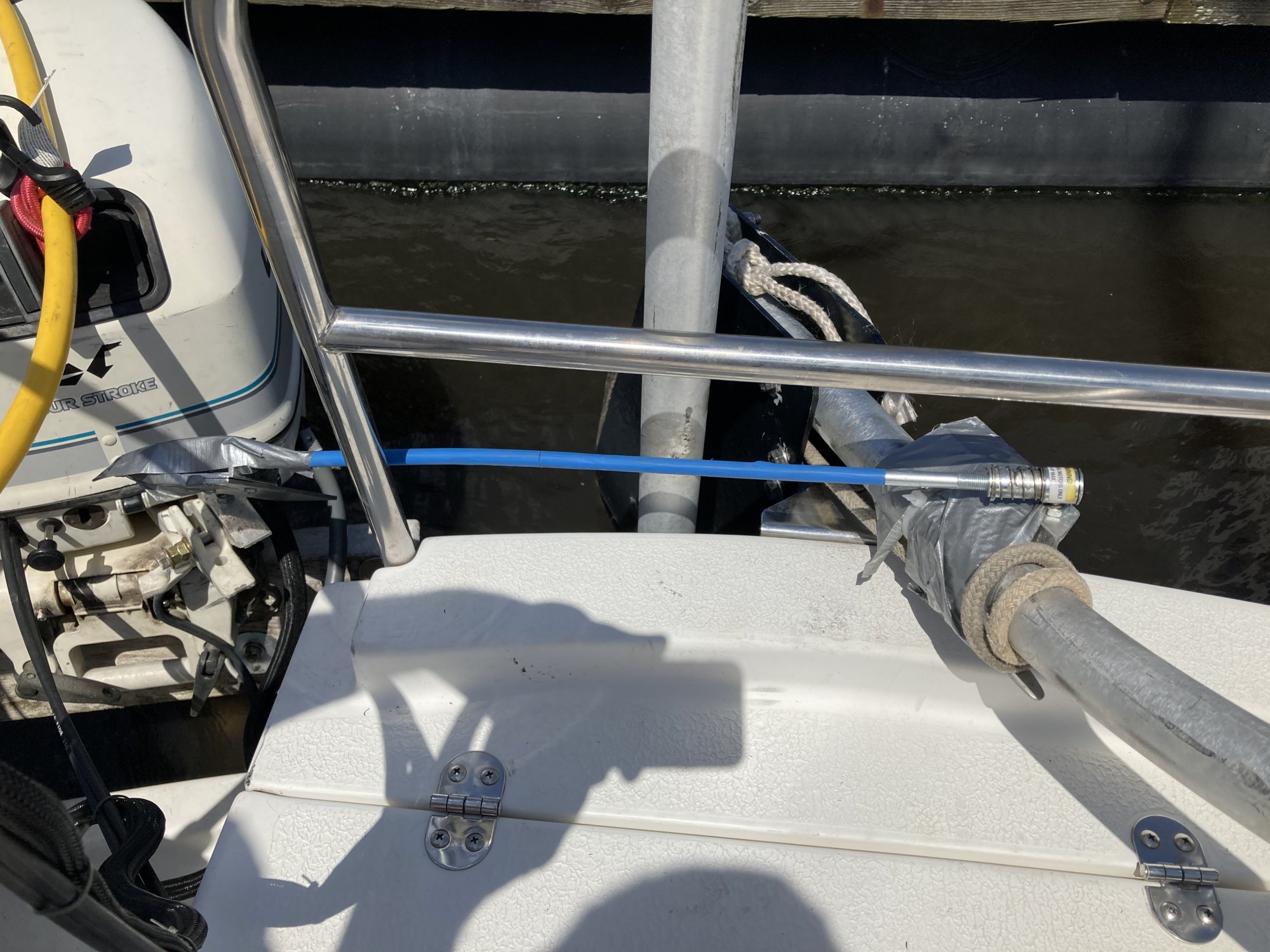

The first day after sailing we went to dock under motor power an just as we were getting to some tight spots the steering stopped responding right. I suspected the motor to tiller link but a quick glance an it looked fine. So we quickly grab the closest t-end dock. Upon inspection we found the bracket that. Clamped to the tiller for the motor link had slid aft. I might mention I tried pulling up the motor under sail and it didn’t clear the water. Laying over it created a bunch of drag causing my helmsman to shout put it back down. So the motor to tiller link got a lot more work out the ever planned. To fix I relocated the bracket back to it’s proper location but found the hose clamp inadequate. Out comes the handyman’s secret weapon duct tape. It only needed to keep it from working its way down so should work. Plan was to buy some ubolts to replace the hose clamps. Tried twice to buy them and keep getting too small of ones. So the duct tape is still there. But on day 2 we motor in and park in a very tight slip beautifully. On day 5 however, after an 8 hour non stop sail we come into the marina and soon I notice the tiller going weird again. Lifting up on the tiller seems to make it worse. I glanced at the duct tape and all looks fine there. So I hold the tiller low and we motor on and park. The next morning I see that the plastic spacer at the top rear bolt is supposed to keep the tiller from dropping too low. But the spacer has totally disintegrated. And also the side plastic plates. They were on my repair list but didn’t get it done. And I left the parts at home (oops). So I wrap the bolt
With rope and wrap the end of the tiller with rope and it looks like that’ll work for the rest of this trip.

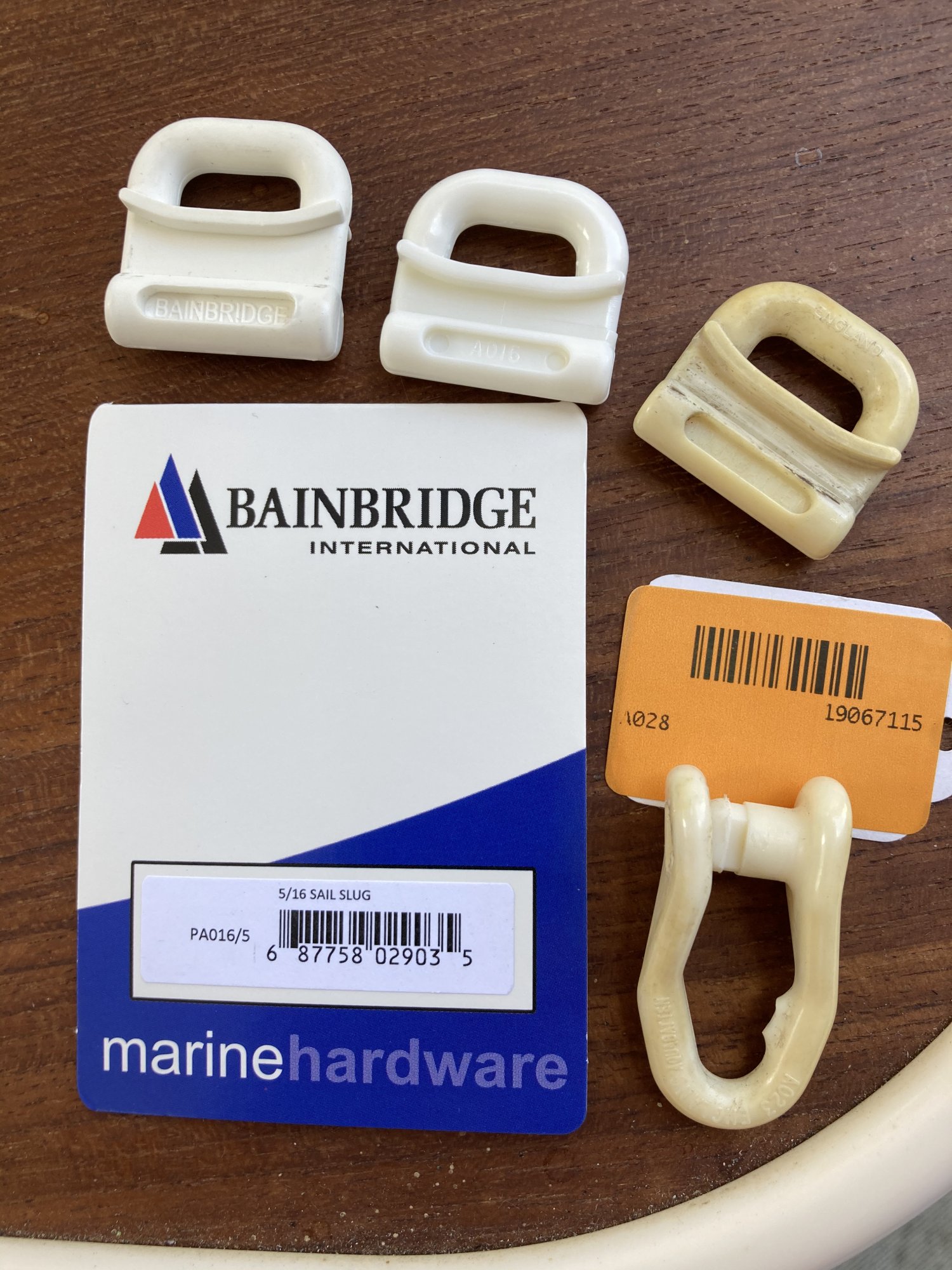

On day one a couple of the sail slugs, which are plastic, had broken. We went out another time and lost another despite being gentle on the sail. So off to the marine store. I brought a slug with me and a Clevis to match up. The slugs were 5/16 but they had 2 styles, Oddly with the same part number, I guess old vs new revision. So I bought both. Turns out my boat had a mix of old and new designs. Weird. All the Same now though.

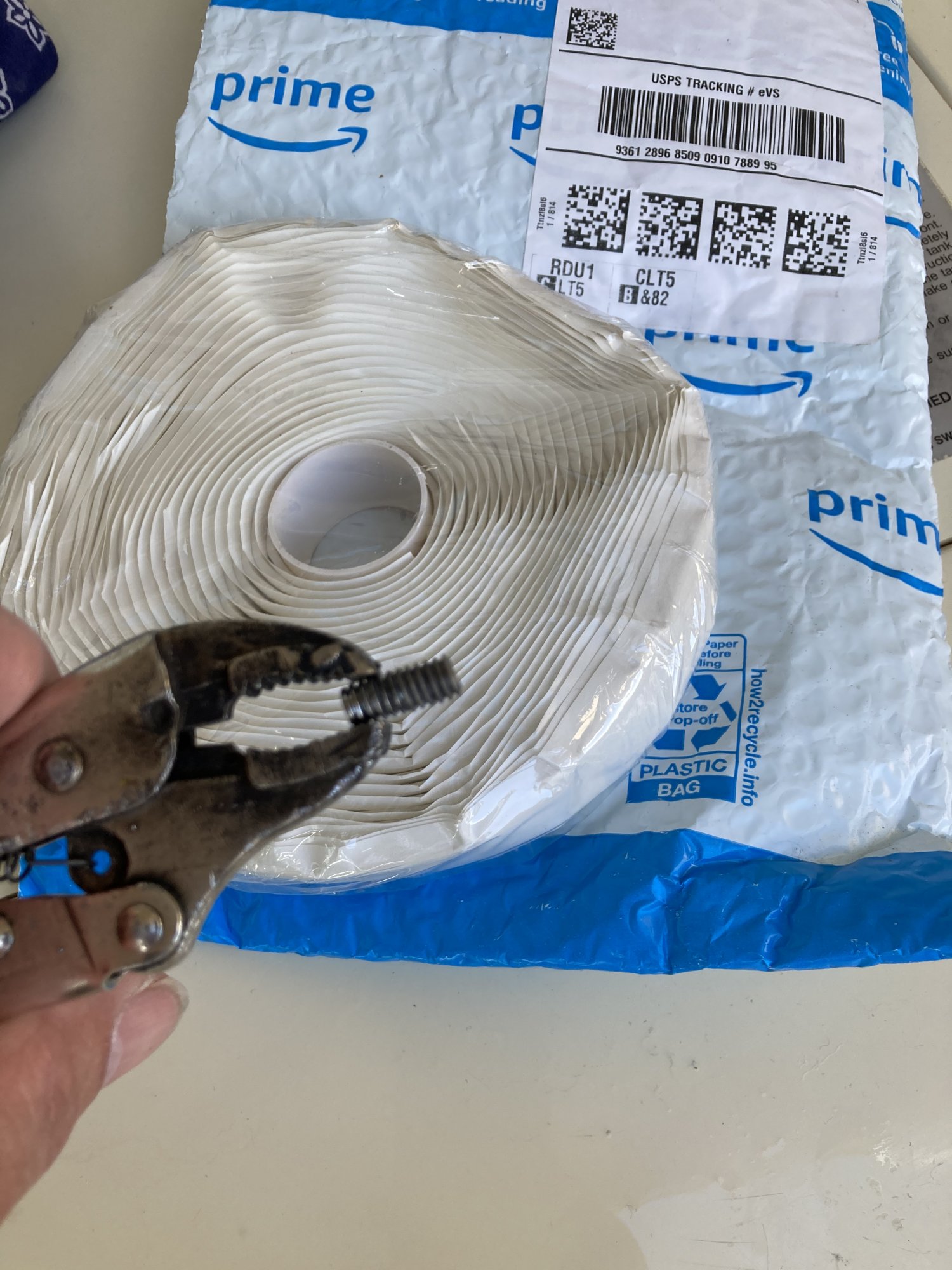

Another repair was fixing the broken bolt on the front cleat. Luckily it wasn’t stuck and only took a little effort to thread out the old bit.
