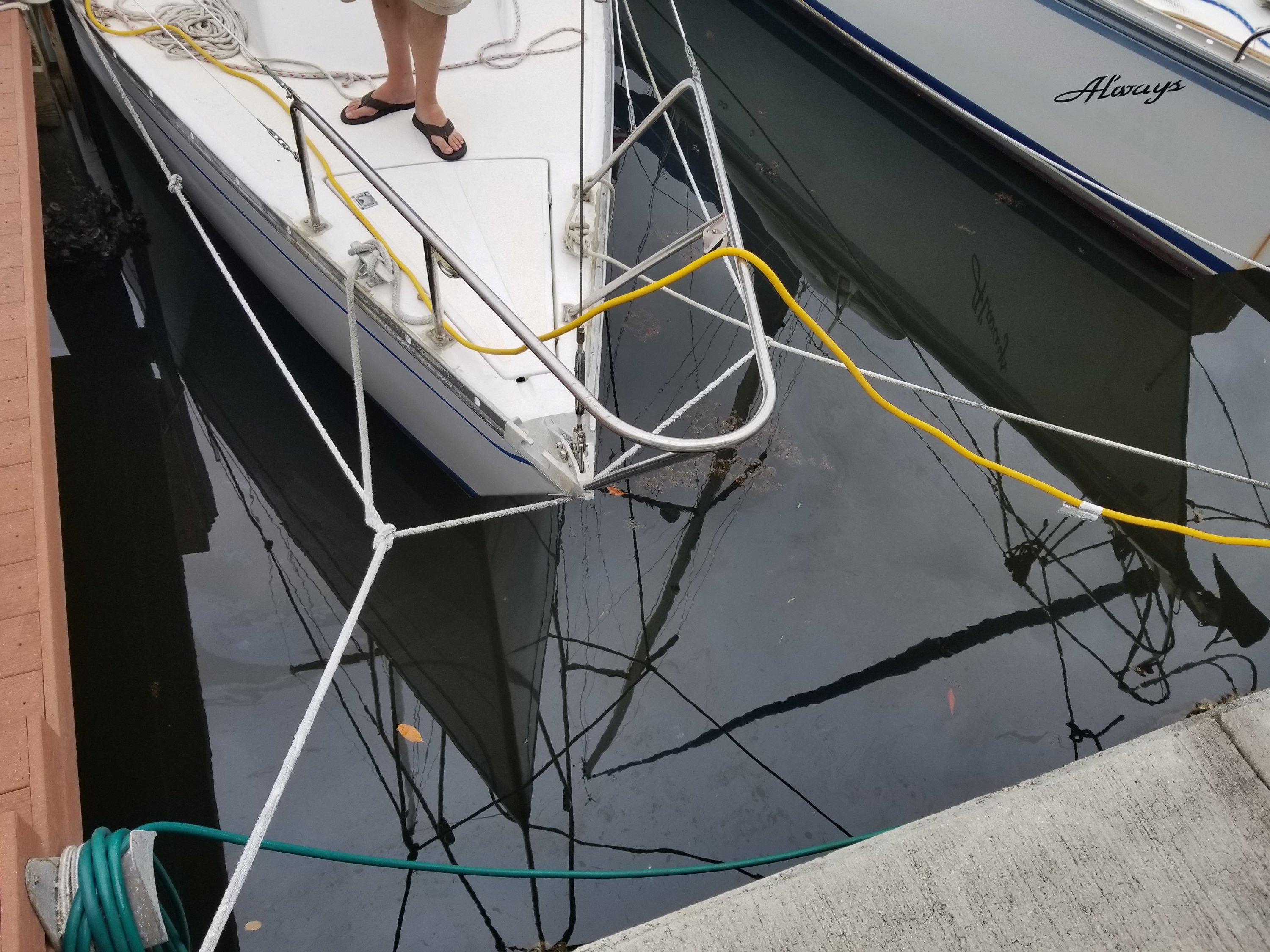

The line that crosses the bow is a large U shape tied two both dolphins and running forward.
That 'U' configuration, you show, is mostly to put the dock lines within easy reach of the bowman when the boat comes in to tie up. There is some stretch added for tidal range, but there are simpler ways to do that. I like the idea of it. Because they are bow-in, the dockside bow lines are a long reach away. Less boathook work and no need for a dockboy.

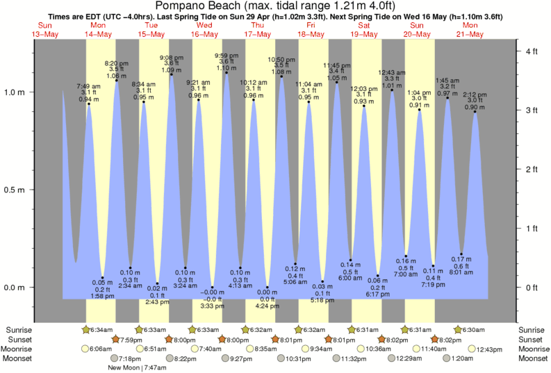

How much tide do you have there? If it's just a foot or two it's probably not worth the extra cost and chafe risk. If many feet then maybe?
My question is also, what are the conditions there? Tidal range, etc. I also recommend lots of bumpers, especially between you and your neighbor.
-Will (Dragonfly)
What have you got for tidal shifts? Whats the difference between high and low tides? What do you get for winds? Currents? Are you fairly well sheltered?dj

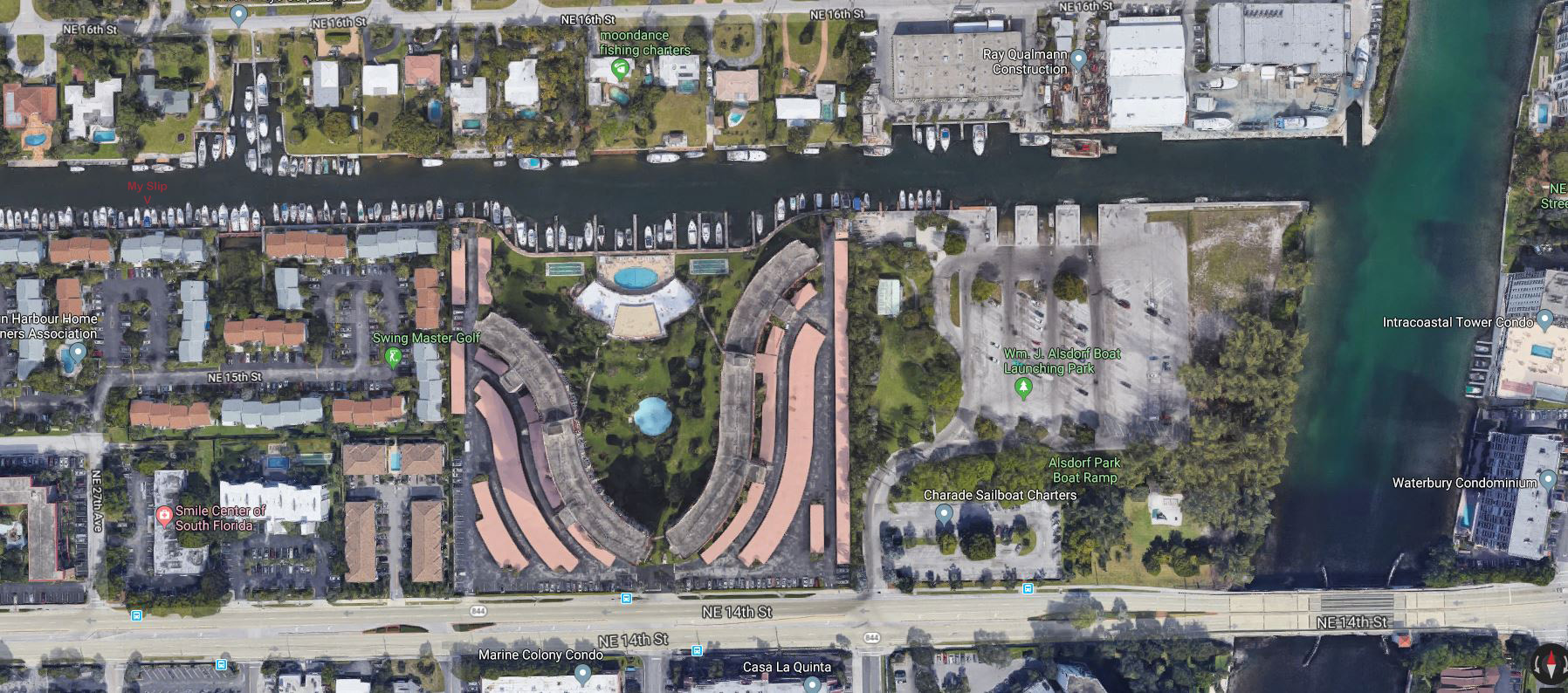

This location is on a dead end canal off of the ICW.

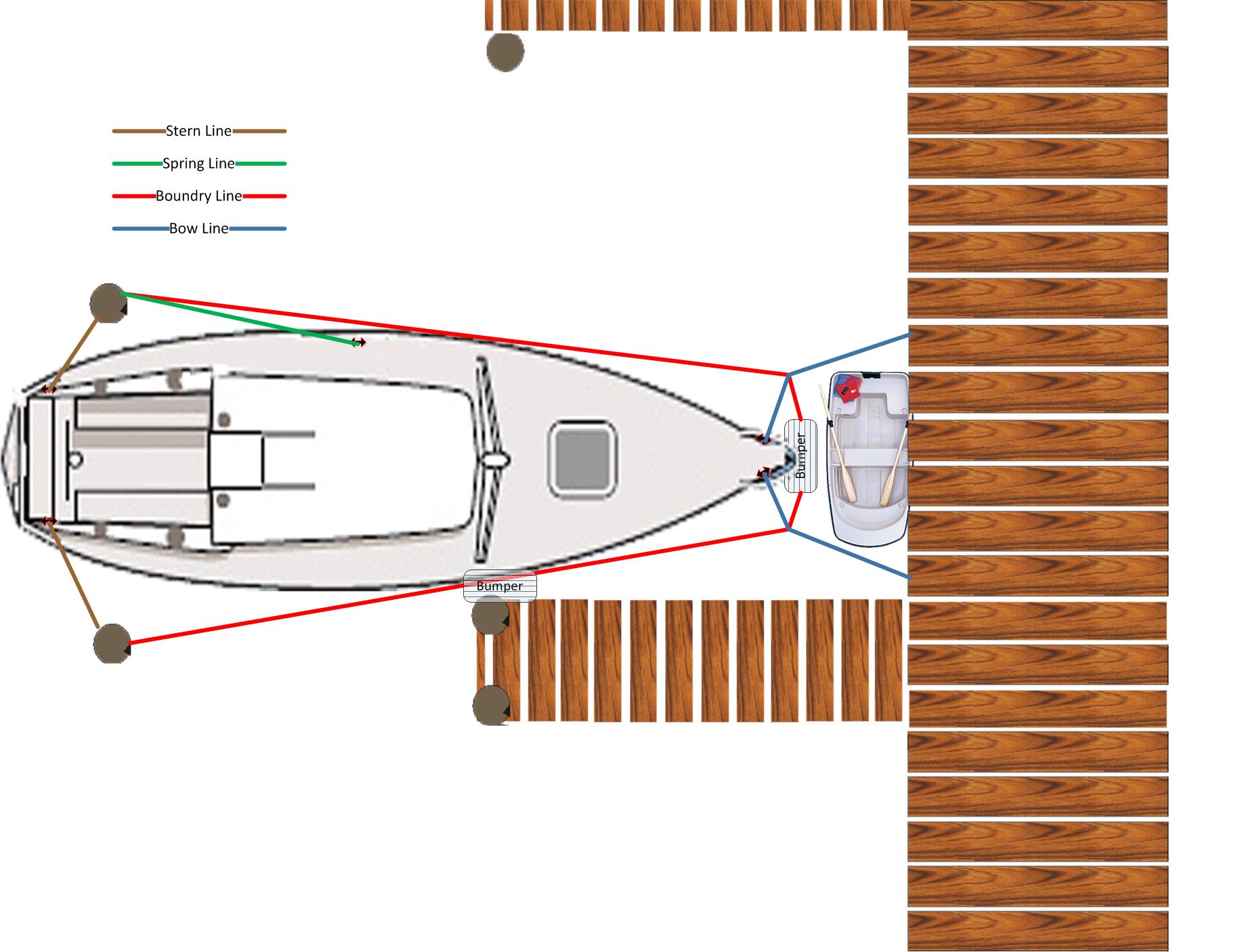

I have revised my thoughts trying to get it a little more to scale, and adding some bumpers and my dink to the drawing.

My shot at your "bow in" view.
1) Finger pier side midships cleat "spring line". This the first docking line connected and last removed. This one line secures your boat and should be length set for tides only.
2) Your post #13 Port side spring line, set to prevent bow/dock collision :plus:
3) Both of your brown stern lines set for tide changes will stabilize your boat Port/Starboard swings.
4) You don't need Red or Blue lines at all.
Last comment is that a 3 foot tide change may cause the port side neighbor a problem if his boat's beam is wide.
Jim...

I would add the dinghy [post #28] at the end of the finger pier using the three bollards to tie it up, independently.
Jim...

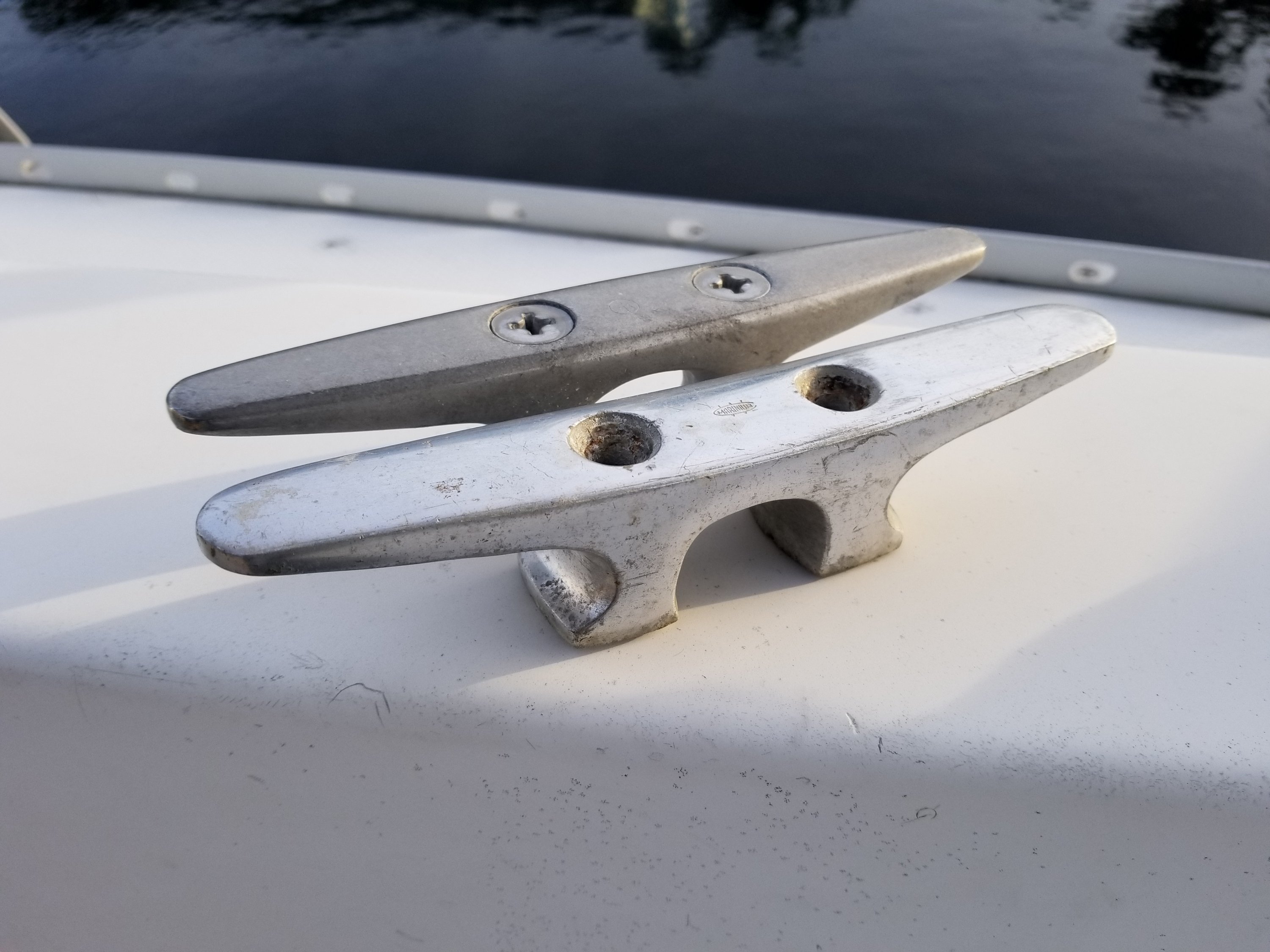

1) Finger pier side midships cleat "spring line". This the first docking line connected and last removed. This one line secures your boat and should be length set for tides only. (I Currently have no Midships cleats at all)
2) Your post #13 Port side spring line, set to prevent bow/dock collision (I was planning on adding at least one Midships Cleat) I found just one almost matching one in a boat part consignment store last year.

4) You don't need Red or Blue lines at all. (If I forgo the boundary lines RED, I think I still need Bow Lines BLUE)
A Big OUCH!
I wonder how you do a quick single side docking for fuel or eats?
My midships cleat is almost a necessity. We do single line berthing with that cleat, but ours are OEM.
Someone used our "boarding line" that is extra line[at midships] to pull the boat to the finger pier. That extra line was left tied up to a Bollard cleat. Tide went out... Guess which cleat gave up?
errr... not the Hunter OEM cleat.
So the backing plates are designed for the weight of your boat on a new cleat.

Without midships spring lines....
1) Brown sterns for sure
2) Blue Bow lines for sure, but I don't think a "spreader" is needed.
3) To board, release Port side Blue and pull with Starboard Side Blue to finger pier
4) To dock, throw Bow Blue to landlubber or kiss dock and grab the Starboard side Blue. Set the Browns, exit boat, set the Blues.
____
The real "kicker" is a bit of Trigonometry, since I don't see the Actual Scale of your boat and the width and length of your berth. That Trig is the High and Low tides and the angle of the Brown and Blues.
For example: At Mid Tides, your boat may hit the finger pier or the neighbors boat, with the slack in the lines.
Jim...
PS: I had to do Trig for Hurricane Nate's expected 10' surge and allow enough line for my boat to rise, without hitting the Bulk heads on either side of the Canal, after the surge passed.

That is the reason for the red lines. they are not tied to the boat but instead to the pilings, and (via the blue bow lines) the seawall cleats. They act to coral the boat at mid tides keeping it in the center of the slip. The below pic is of a friend's boat at a similar slip at low tide. He has let the boat drift over to the pier for boarding by loosening the port bow line.

They[Reds] act to coral the boat at mid tides
Not too bad of an idea, if they are independent, non stretching 3/4 inch lines that are fixed in an Fence type especially on the Port side. In other words, straight and not part of boat lines.
But it may take 2 lines on each side and have anti chaffing on the lines. Think of a boxing ring type ropes.
then Fenders on the port side, since the finger pier is your block.
____
If you get the Bollard to Bollard [berth Width], Port Bollard to Dock, Stbd Bollard to Finger, , length of finger pier, and Finger pier height above water [known tide at the time], measurements, we can do the Trig in a PM if you need help.
But it looks like you won't need the Reds, at first guess.:pimp:
Jim...

Not much tidal change, pretty secure location, not sure about he currents, but sure looks to me like the perfect location to try hanging weights on your springs. Not having center cleats is something I'd address as soon as I could, but heck, it's your boat.
In your diagram, I'd add a second spring on the other side too. With two springs and weights on both, your boat may just sit there very nicely... Takes a bit to get it all adjusted just right but once you do, it's pretty neat how it keeps your boat from moving around... Good luck with the move and take photos once you are set up. It will be interesting to see how you finally get settled.

google “Johnson toe rail folding cleat” for mid center cleat. Have em on my H31
