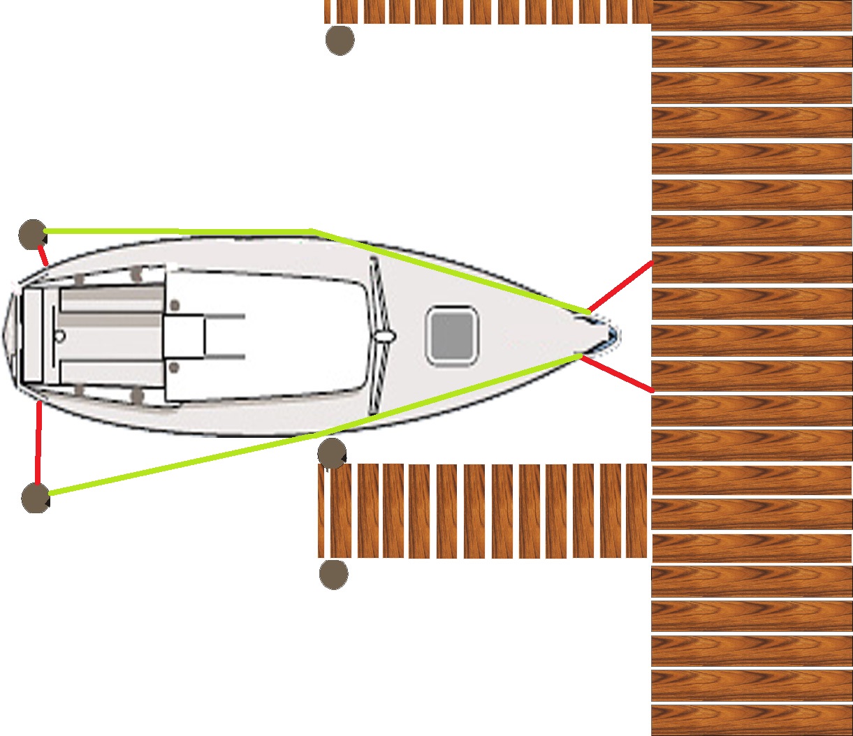

If long spring lines are what you want, then the simple set up below might be worth considering. In the example drawn, your mid-ship cleats get used as chocks for the spring lines. If you have enough clearance around your rigs, or if you install chafing gear near the side stays, you might be able to not use the chock cleats & get a more free floating spring line. In either case, loosening the port bow line brings the boat into the finger dock for easy boarding -
:plus:
But it presents a interesting "tide slack" Trig calculation, without the "chock" bearing weight.:cool:

Yea, the only advantage of using the midship cleat as a chock, instead of cleating the line there, is that the extra length of the line gives you some extra stretch, which gives you a little extra tide room. If it was possible to free float the long spring line rather than chock it, it would probably be better.

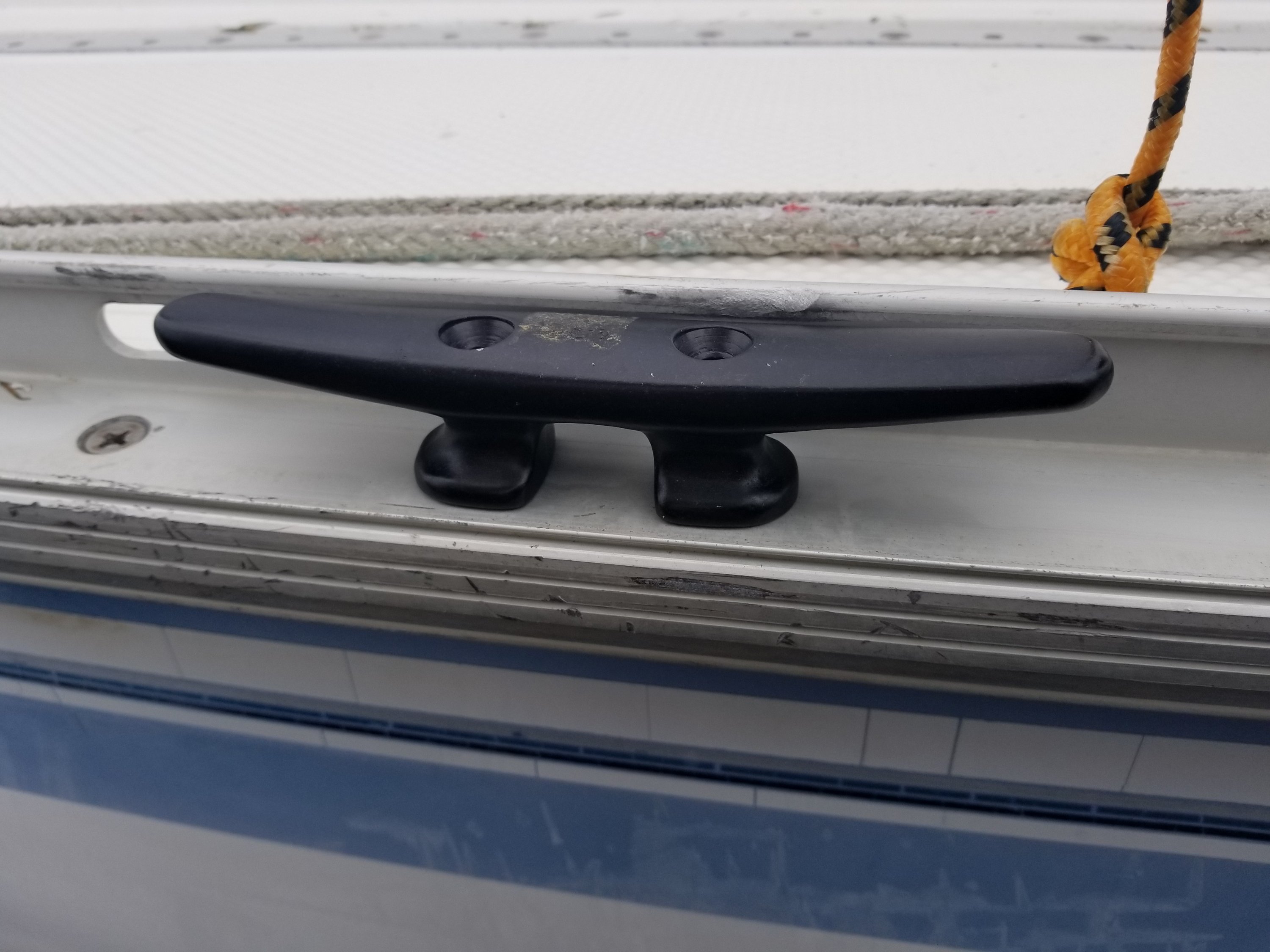

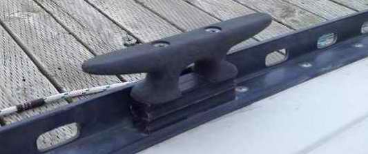

So after a little location testing, I definitely will have to notch the rail.

What about setting it on a base that raises it up an inch?
:plus::plus:
Since that spot doesn't allow for too much of a backer plate, how about what Will suggests a...
Mounting Plate!
You could make a "plate", say 1" King Starboard, that is long and has several screws and even drainage holes.
That could "Spread the load".
Jim...
PS: I was typing at same time.:laugh:
Oct 19, 2017
8,032
Personally, I'd use a solid base of aluminum, but the other choices would work. You would want to cap the tubing. Use the least invasive, simplest plan.
- Will (Dragonfly)
JamesG161
Feb 14, 2014
7,936
Hunter 430 Waveland, MS
The more I think, the more "invasive" I get, especially when it is someone else's work.:cowbell:
Tip: The more a screw threads are engaged, the stronger the holding power.
You can use a very long screw, in the cleat, with a mounting plate.:)
Jim...
PS: Perhaps a cleat mounting Bolt too.

This is what I am thinking so far.
Not really a fan of this set up.... like was said before too many chafe points. I would keep it simple with two bow lines, two stern lines to the pilings and two spring lines from mid fleet to piling aft. And btw bow first is the best for us..... you can always choose when you want to leave but not coming home. It’s much easier to back out into open area almost regardless of wind than to have to back in when wind picks up to 25 from the wrong direction. Momentum is a nice thing when docking a sailboat in my opinion. And also you don’t have everybody looking into your business. Taylor makes great plastic stairs.
Good luck with whatever model tie up you choose!

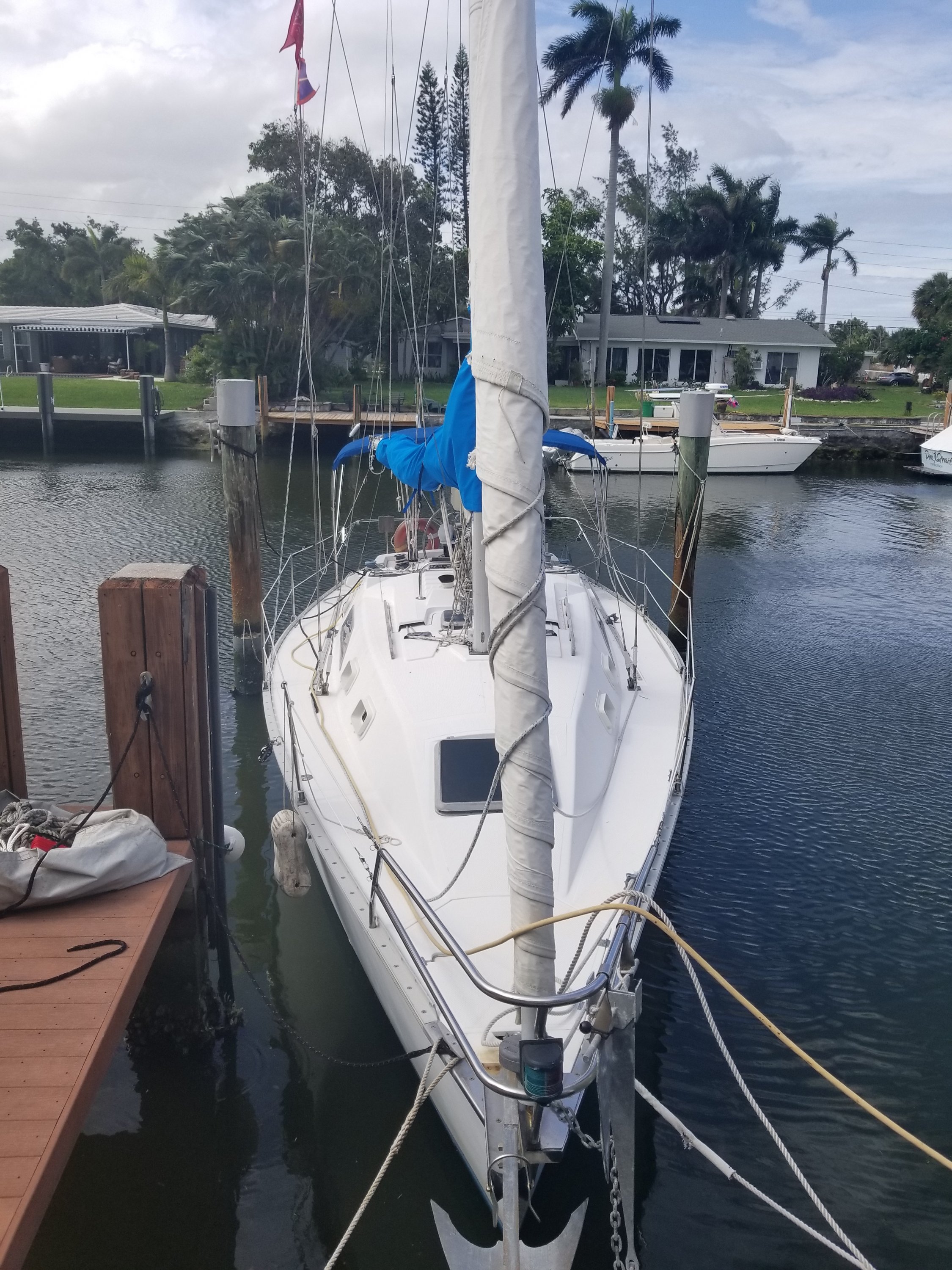

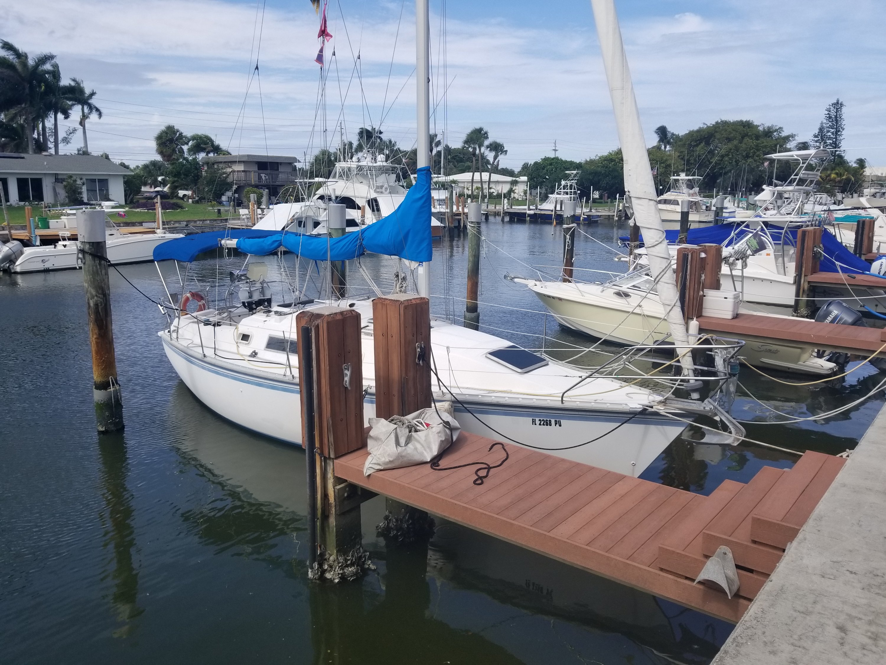

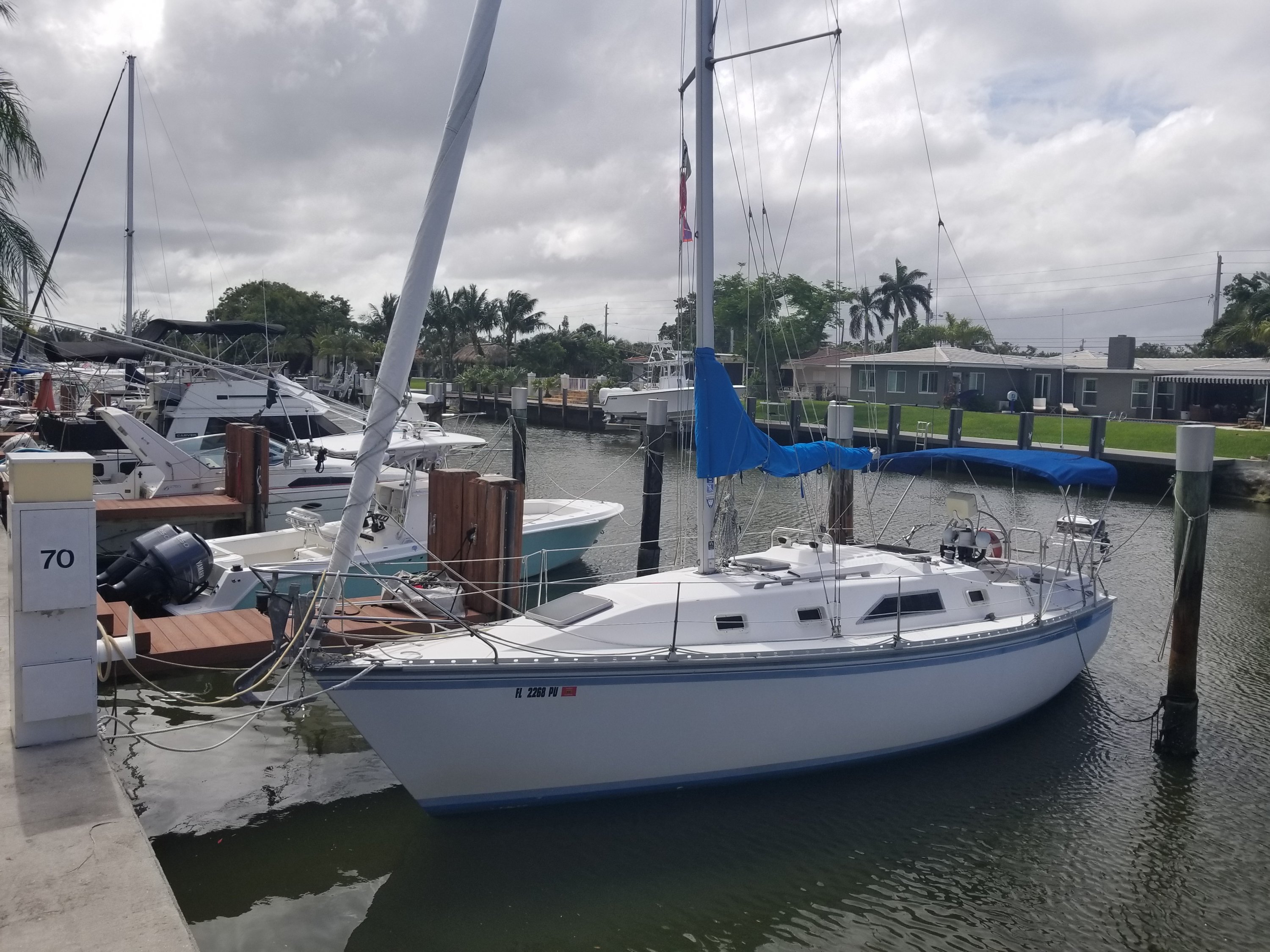

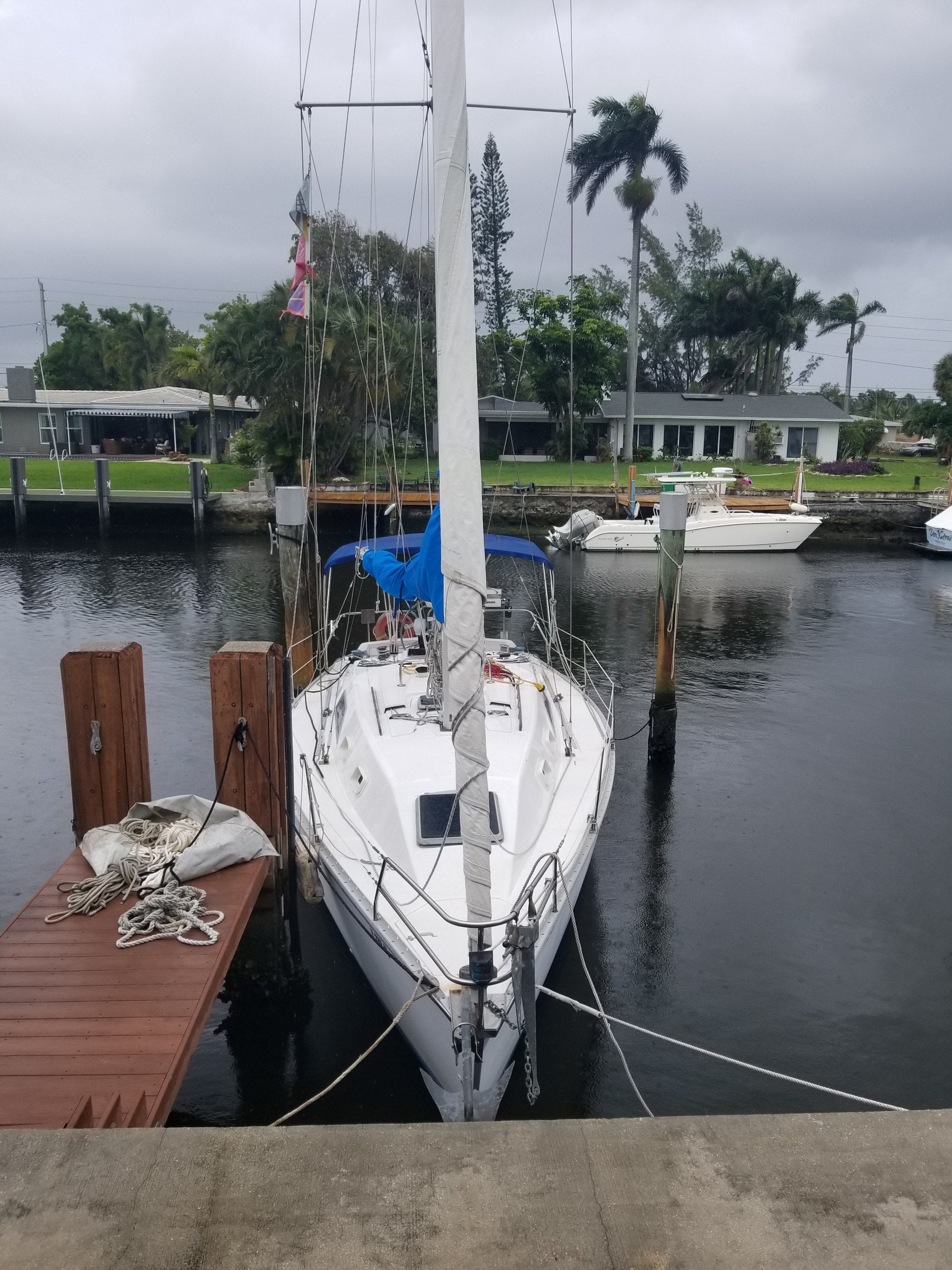

So, since I had to be off my old dock by the 1st, and we had the fringes of TS Alberto forecast to hit us on Sunday and Monday, I bit the bullet, and moved her in the rain on Saturday Morning. She is now at her new dock, with temporary dock lines. Right now I have 2 bow, 2 stern, and 1 starboard side spring line. The stern lines are tied to the cockpit side cleats since the stern cleats are out beyond the dolphin pilings.
It was low tide, and I got her into her slip with just a little bump on the bottom at the entrance.
Since it is a sand bottom, I should be able to remedy that bump with a short dive and a shovel.
I went back on Sunday morning since I had left some tools aboard that I needed for a major project at home, and she was floating well with a slightly higher tide. Weather report calling for heavy thunder storms Sunday that forced the Saturday move in the rain were obviously off. :banghead:

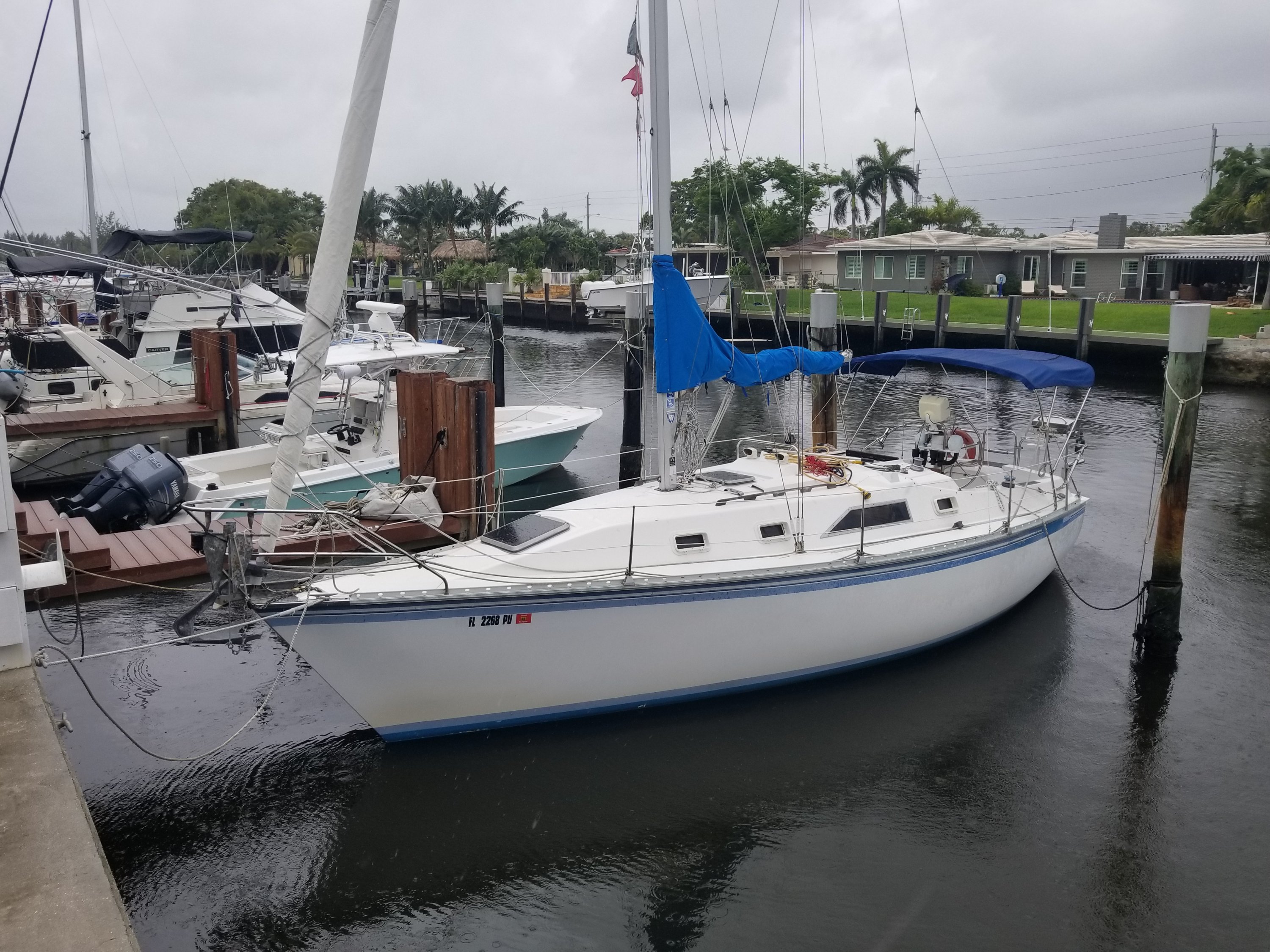

Good luck. Just watch how she rides under different winds and adjust / modify as necessary.
This is why I let my boat move around in an Oval fashion. The winds and tides are my "shovel".
Nice Job!
______
I am now wondering about the need for a Starboard midships spring line, at least for your berth. It looks pretty clear on the beam sides.
For easy boarding, you might think of two different lengths of Port Stern lines. One for normal hold and one longer for boarding, letting the boat to be pulled more forward.
