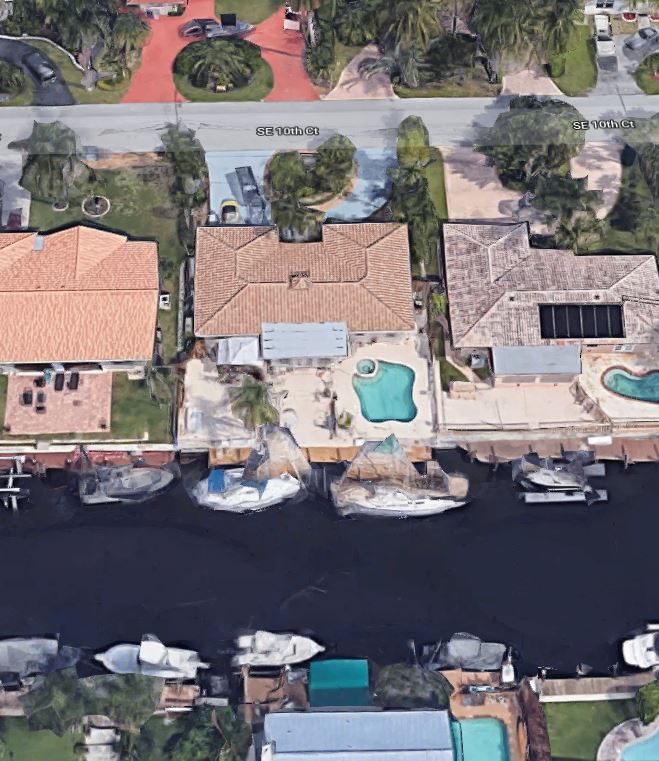

After three years at my current dock, I am moving my boat to a new slip. Currently I am side docking to a dock behind a residence.
The Stargazer is the sailboat on the left with the blue bimini. I have two mooring whips, bow, stern, and two spring lines.

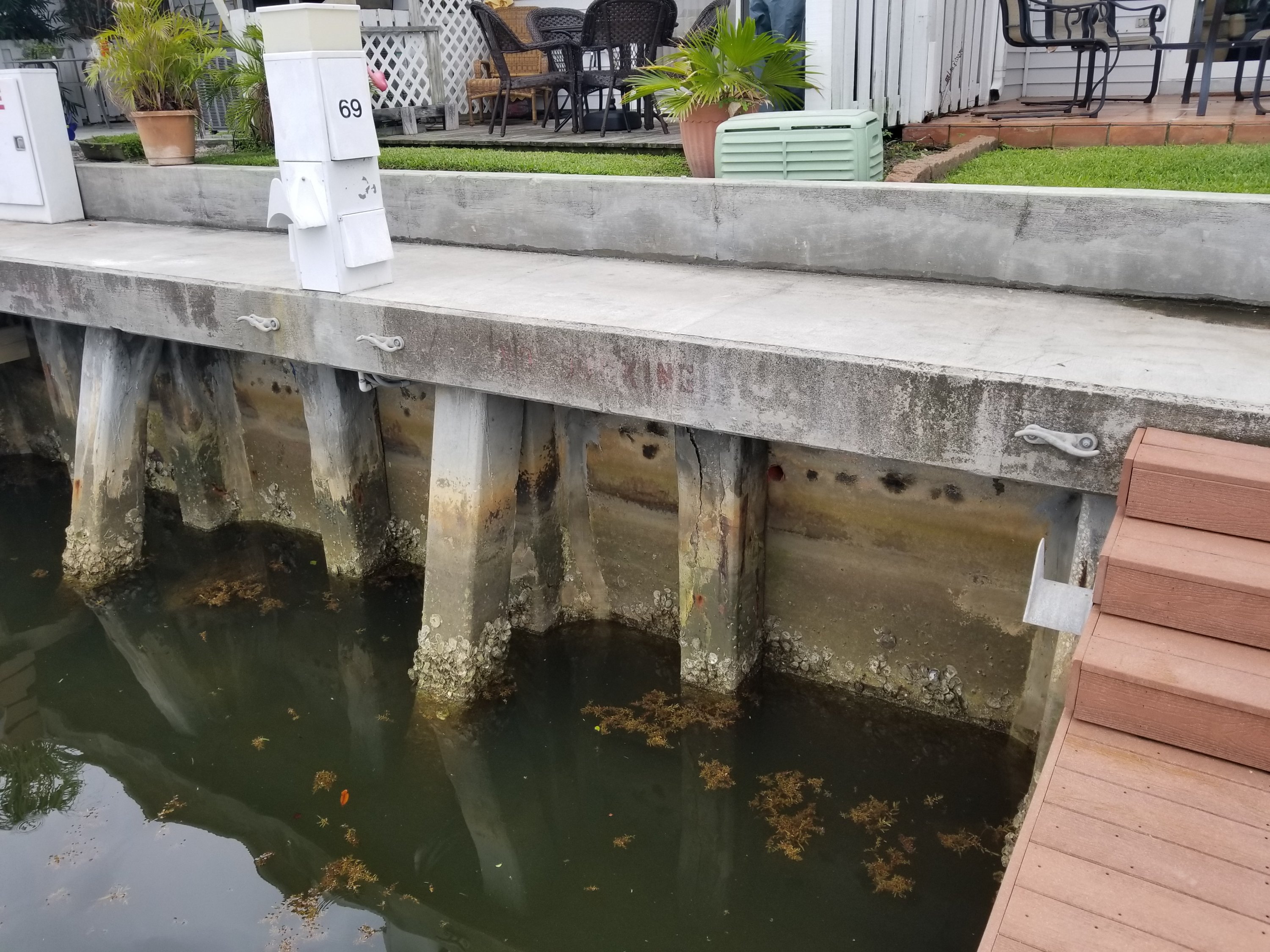

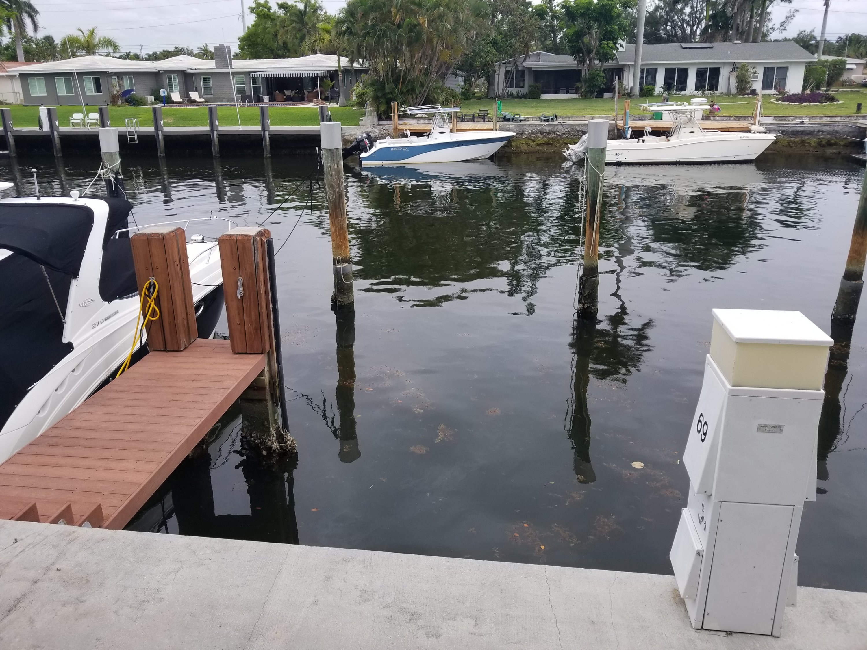

My new dock is a a slip with two dolphins and a half pier. With two cleats on the seawall.
My boat is going where the one with the blue canvas is above. below are a couple of pics of it empty.

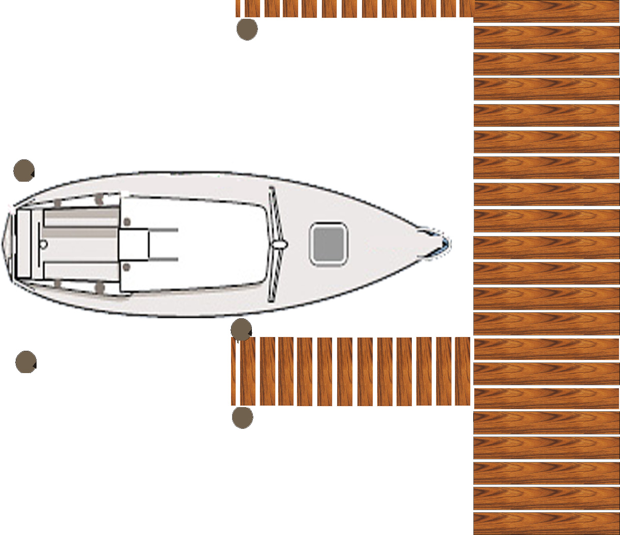

I have drawn up a rough diagram of the slip with a sailboat in it.
I am trying to figure out the best way to tie her in this new slip, and am looking for suggestions.

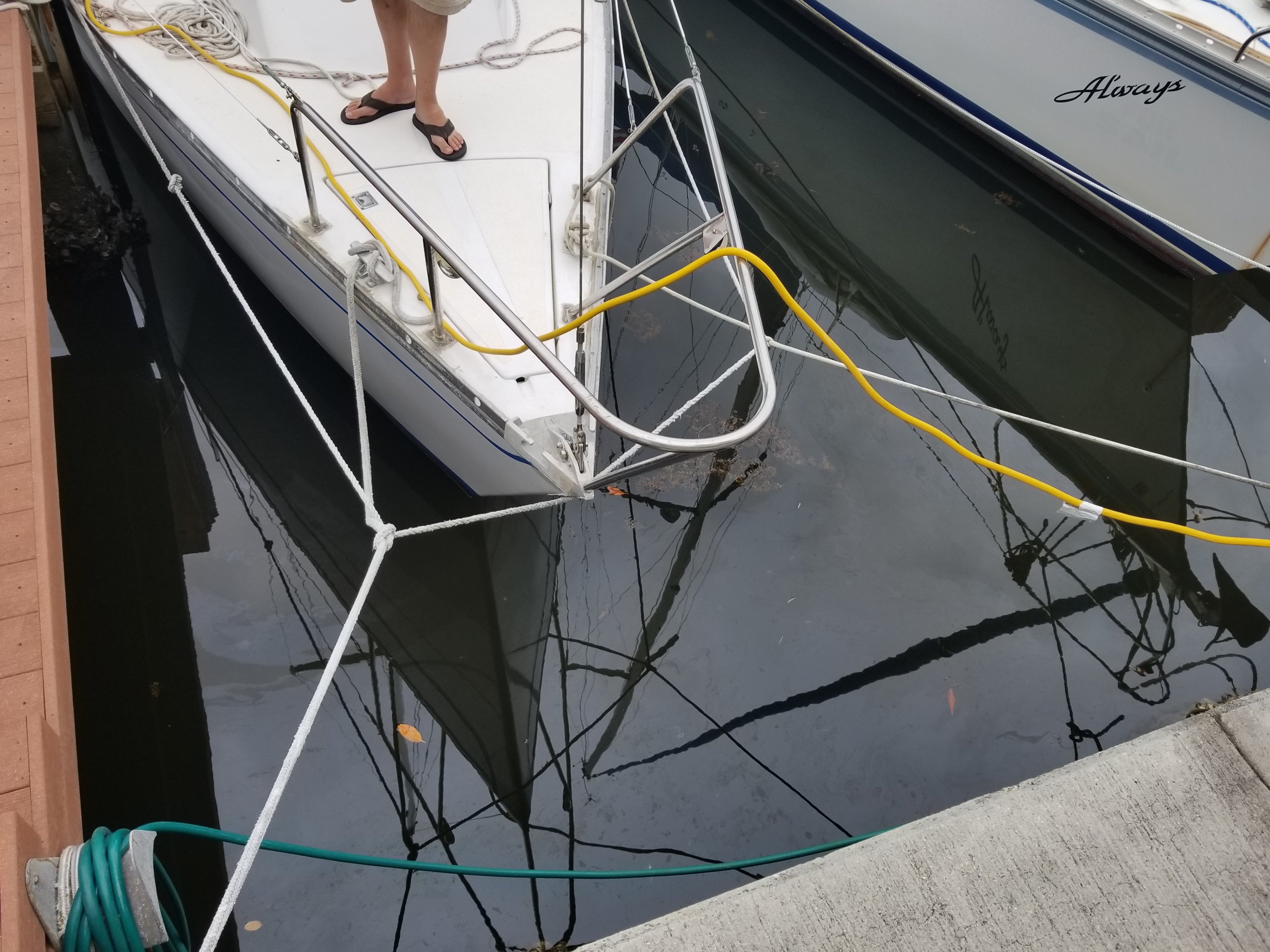

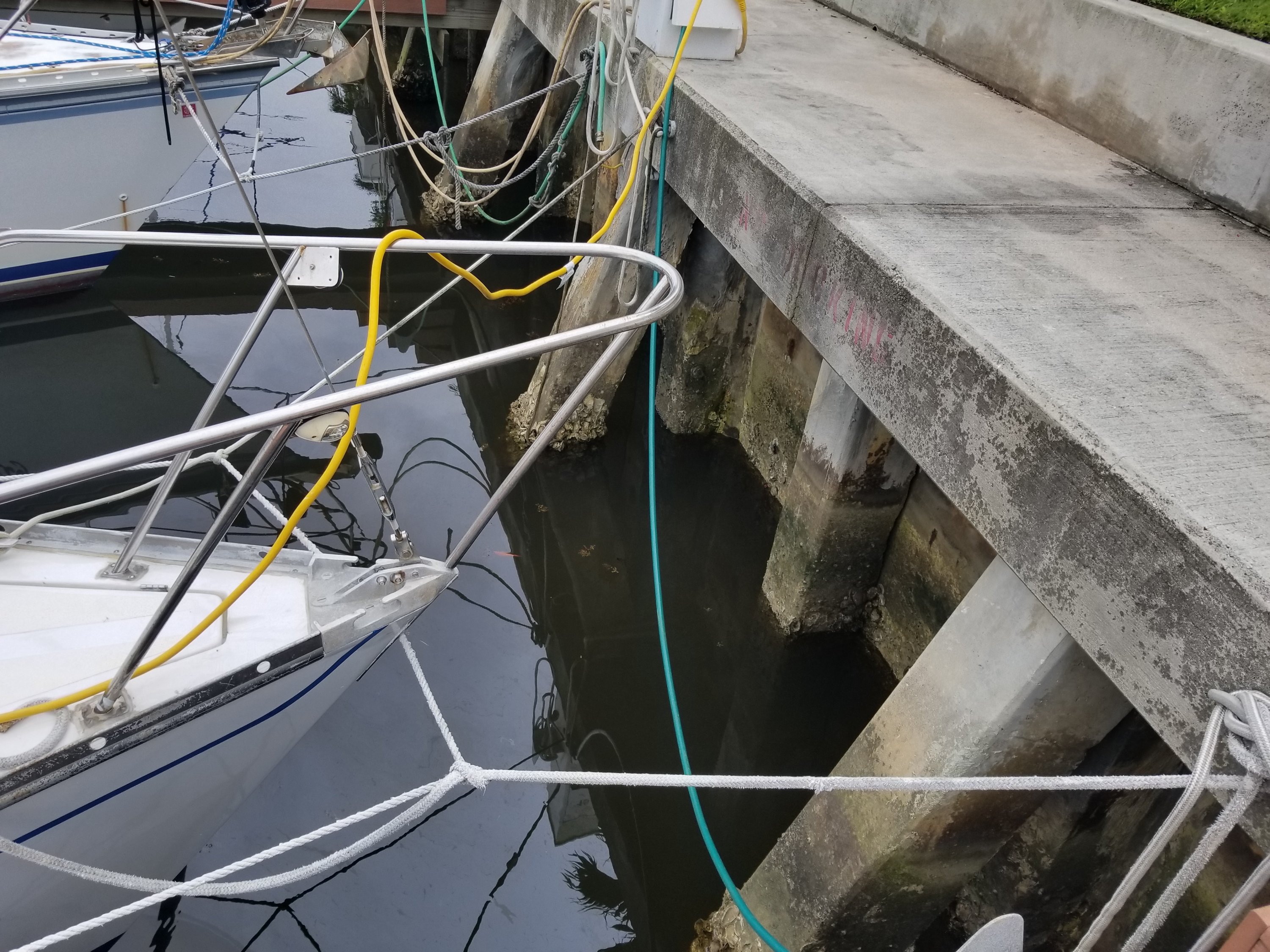

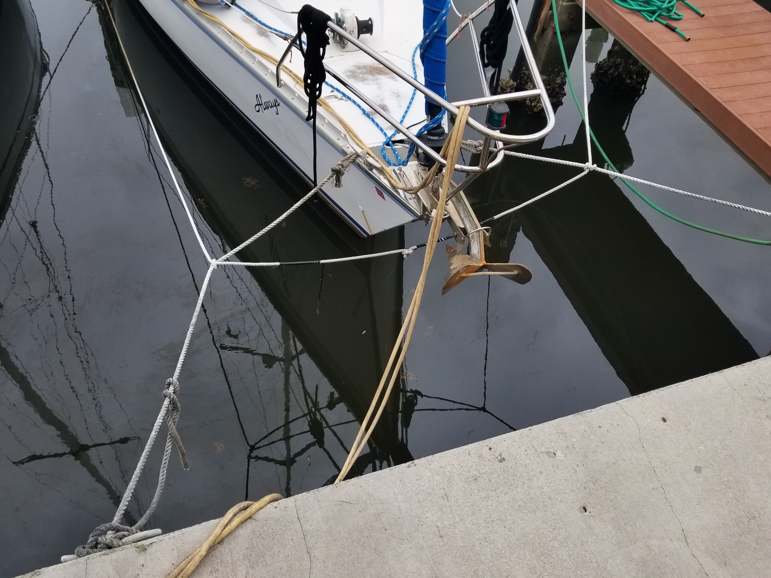

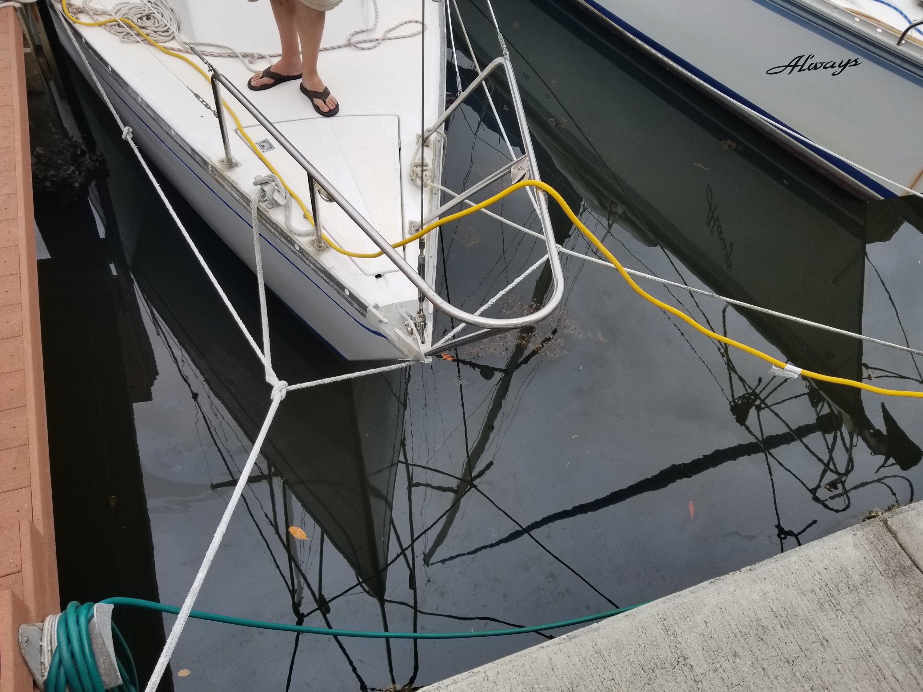

Below are examples of how two of the sailboats belonging to fellow sailing club members have configured their bow lines in this same location.
The line that crosses the bow is a large U shape tied two both dolphins and running forward. it is supported by the two bow lines that are tied to the cleats on the seawall I am considering something similar, but looking for suggestions. When the boat was originally in Baltimore, the PO had a similar configuration except he had a large bumper attached to the line that crosses the bow.

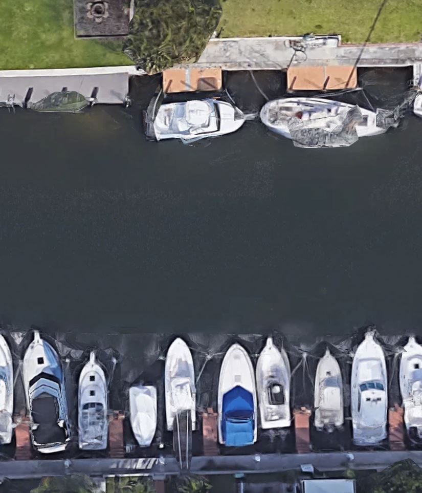

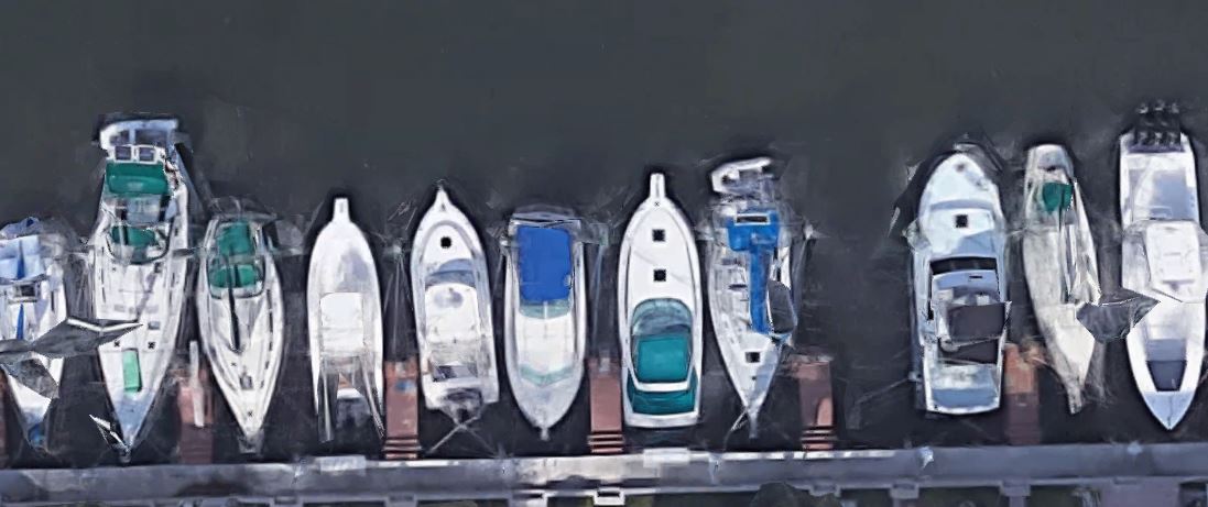

These are the only two sailboats tied this way at this location. Most of the rest have bow line from seawall cleats, stern lines from the dolphins, and one spring line from the dolphin in between the two half piers. Below is a google earth screen capture of a couple of the other sailboats at this location

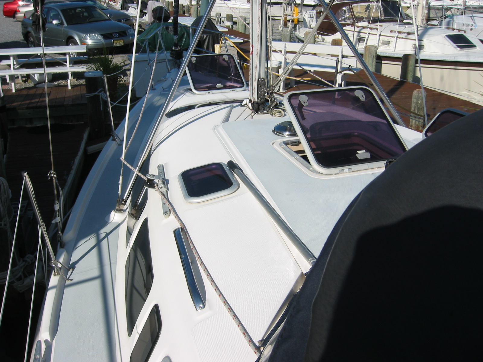

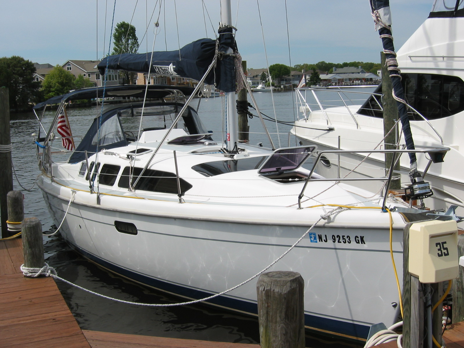

We kept or boat (2000 H340) in an almost identical slip for many years, although our finger pier was on the port side of the boat when bow in. We went bow in because of the water depth near the end of the slip and the ease in docking the boat. We did not use any of the complex bridle slings to keep the boat centered and the bow off the dock. Basically we had one bow line on each side (uncrossed). We used aft spring lines on each side, one secured to the bow cleats and one to the mid-boat cleat. We did not need any forward spring lines because the bow lines kept the boat from moving backward and out of the slip. We had one uncrossed stern line tied from pilings to the stern cleats on each side.
Regarding getting on and off the boat: we had a gate cut into the life-lines on the side facing the finger pier. We just had the lines cut and pelican hooks installed (see photo). We also used a wooden step to board the boat when the tide was at flood.
You may need an additional slip-long line and fender to keep your boat neighbor off your boat.

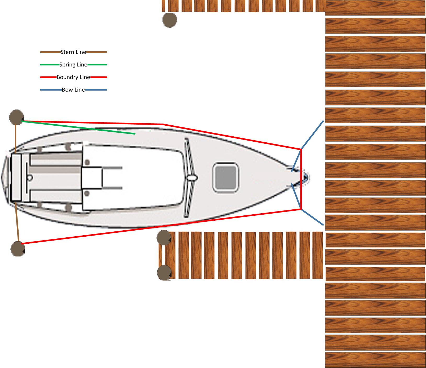

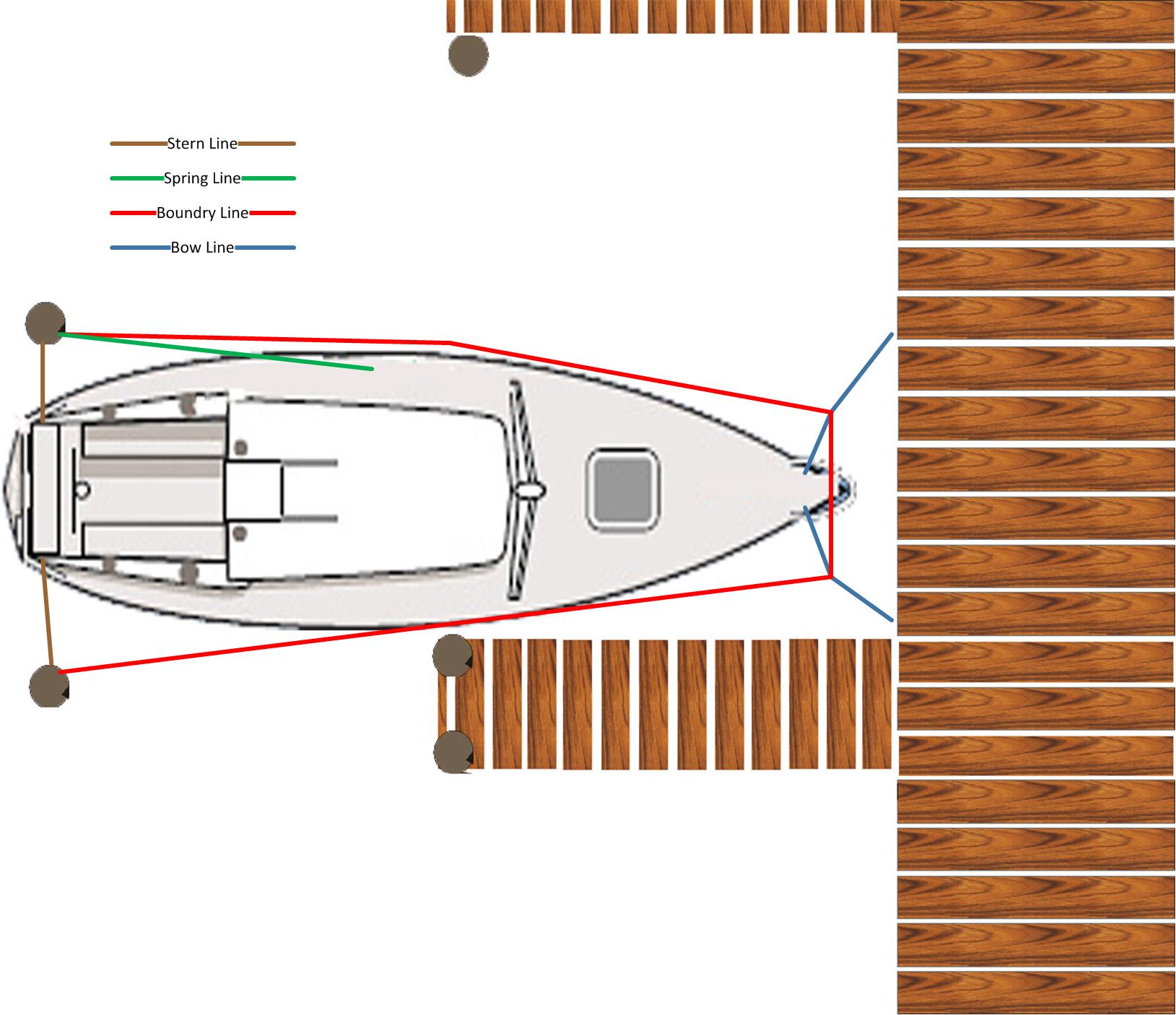

This is what I am thinking so far.
I'd probably do away with the starboard boundary line. It'll be hard to get that one tight enough to do any good, and it might become a trip hazard getting on and off the pier. Personally I'd run the port boundary line straight from the piling to the port dock cleat, but maybe experiment with both and see what works. Also if your boat is really so long that it sticks out past the back pilings then I'd go with two aft springs rather than one, since the aft lines won't do any good keeping the boat back.

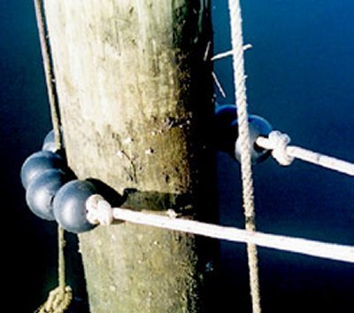

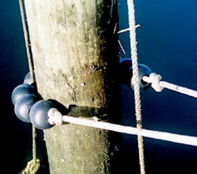

Tide Minders
I added one set recently and love it as I keep it real tight and works real good keeping the boat from moving forward or backward and the fender stays right up against the pole and I use it on midship cleat to pole.
A few months back during Irma pulled all the water out of the canal and my boat was leaning over real bad.
It rolls up and down the pole real good and my dock is shorter than my boat and this one pole is the only pole I can tie real tight.
