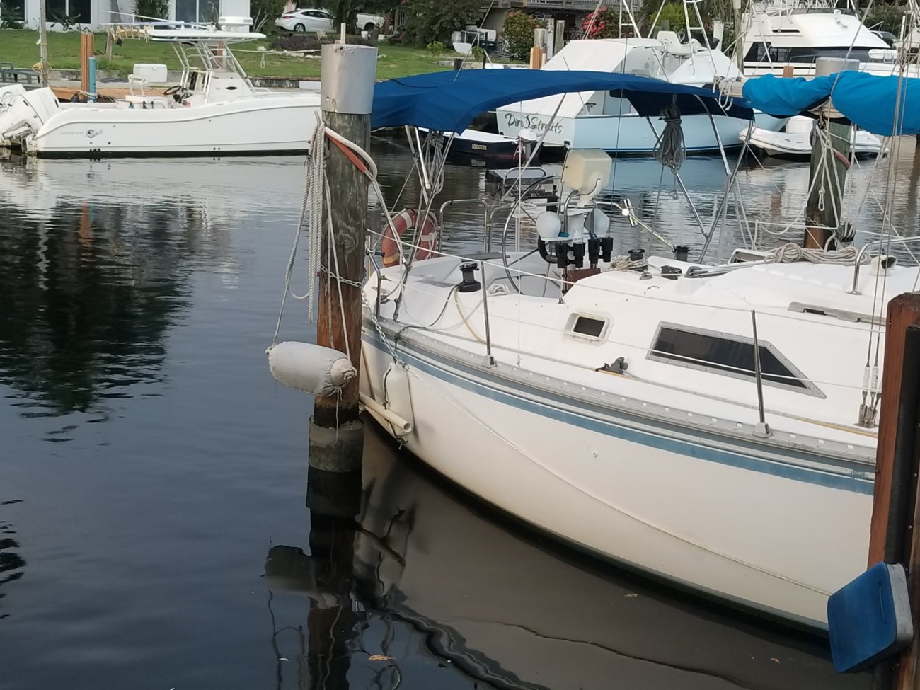

OK, I have been at this new dock for over two months now, and love the location. Motoring time has been cut by at least 75% Now I have to solve a slowly recognized issue.
This is a picture from when we first moved to the new dock (I will try to take a new one this week).
I am trying to figure out a way to keep my boat centered in the slip. The dolphin pilings are so close, that if I leave enough slack to handle the tides, at mid tide I am rubbing one or the other. You can see from the wear, that I am not the first person to have this issue. I can add bumpers to the pilings, but was looking for something easier.

The brown lines in the drawing below are the ones I am having issues with.
They are so close to the pilings, that I need to leave too much slack for the tides to keep the stern centered between them. The tidal slack allows the boat to rub one piling or the other during mid tide.

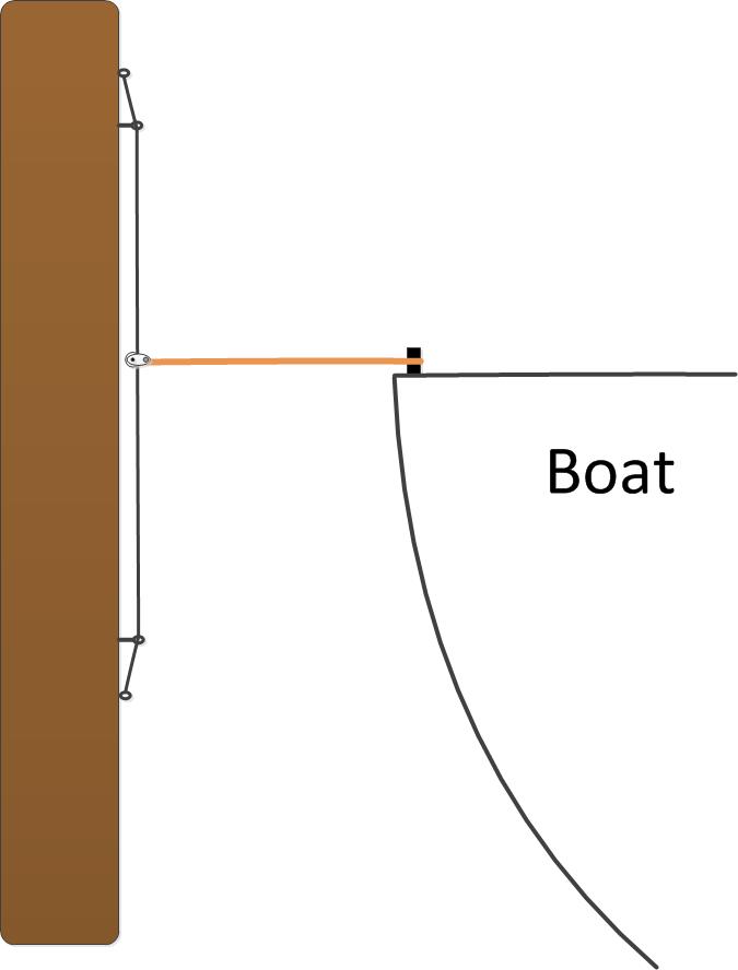

I was thinking of making something like this, but maybe using 1/4" stainless cable with turnbuckle, standoffs, and a stainless pulley instead,
I can't really draw the perspective right, but the cable slides would be on the seawall facing side of the pilings so that they would not interfere with (bump or scratch) the boat.

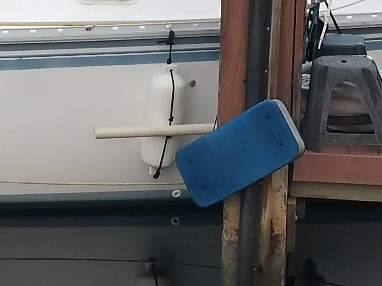

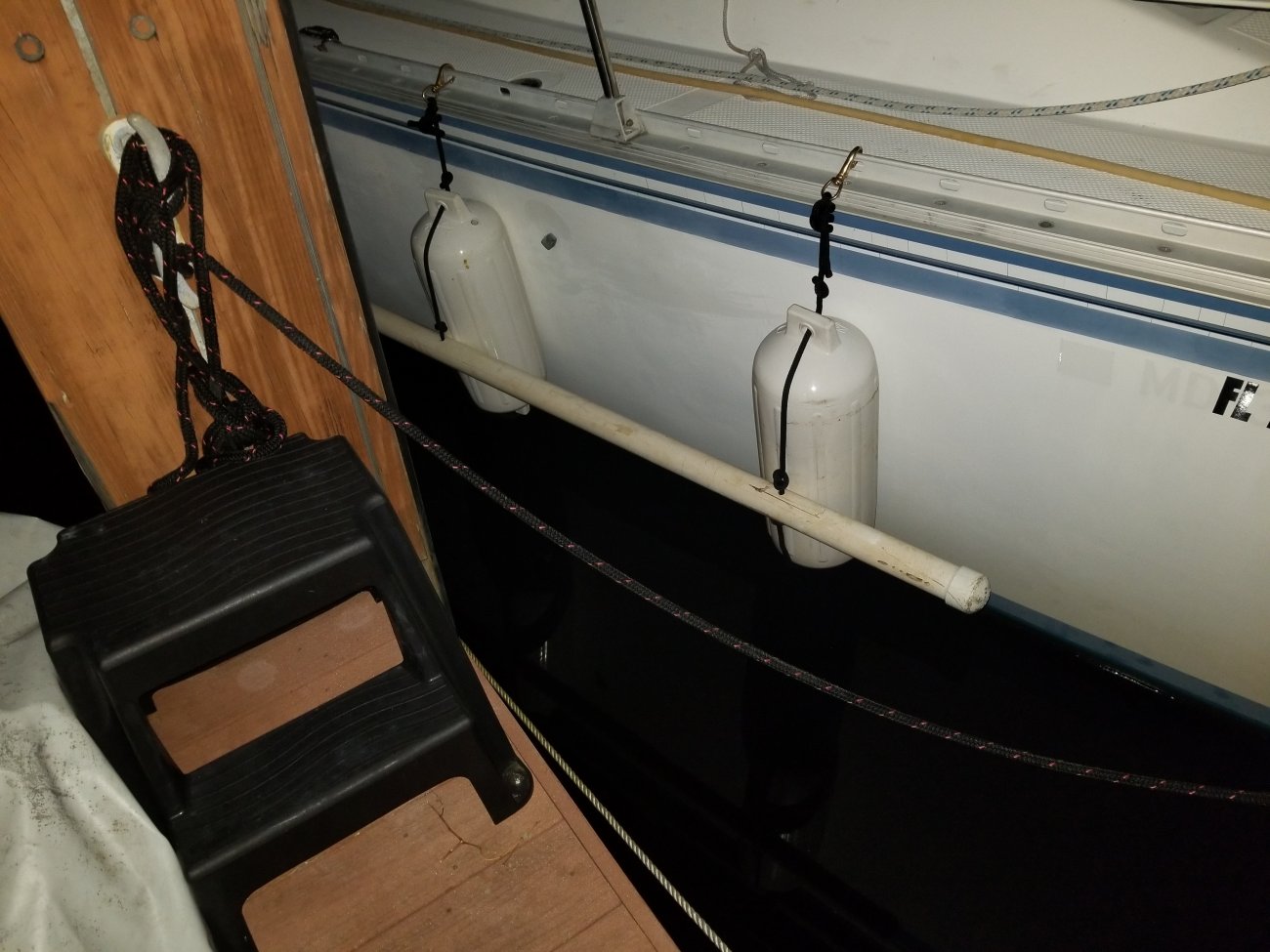

So I finally got around to building and adding the fender boards last night. I shopped arround and found a guy selling used fenders/bumpers for $5 a piece on Craigs List, and the pics showed some nice ones. I picked up 6 nice ones for $30. I think they were salvaged in the Keys after last years storm.
I mounted them to the rail with bronze spring clips, so they are easy to remove and hang from the pilings when taking the boat out.
I am interested in how well the PVC will last. If I find it crack or breaks too quickly, I will probably switch to PT lumber. but the weight of the PVC is easy enough to handle with one hand.

Chip. I like these for a H31 especially for slips with fixed pilings but where are u storing these when underway?

A slip next to mine, the guy used plumbing pipe and fixtures to do the same thing like post #93. It held up through Isabell, but Florence will probably not be a test. /// I doubt those PVC pipes will survive a heavier thunderstorm, so I suggest you put another pipe or wood rod or something to reinforce the PVC pipe.. UV will weaken them and they will fail when you need them most. Goes with the wood cross-pieces. /// On the port-side spring line in post #96, I suggest you make about a 2-foot lung loop of line to put around the righthand stanchion and support the spring. Otherwise, the spring will chaffe the gel coat off the hull from up and down wiping action. Trust me on that one.

I am leaving them at the dock clipped onto the pilings.
