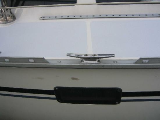

@Terry Cox posted a FAQ on adding Mid Ship Cleats to his H42. I am strongly considering using his method to add them to my H31.This is how his turned out.

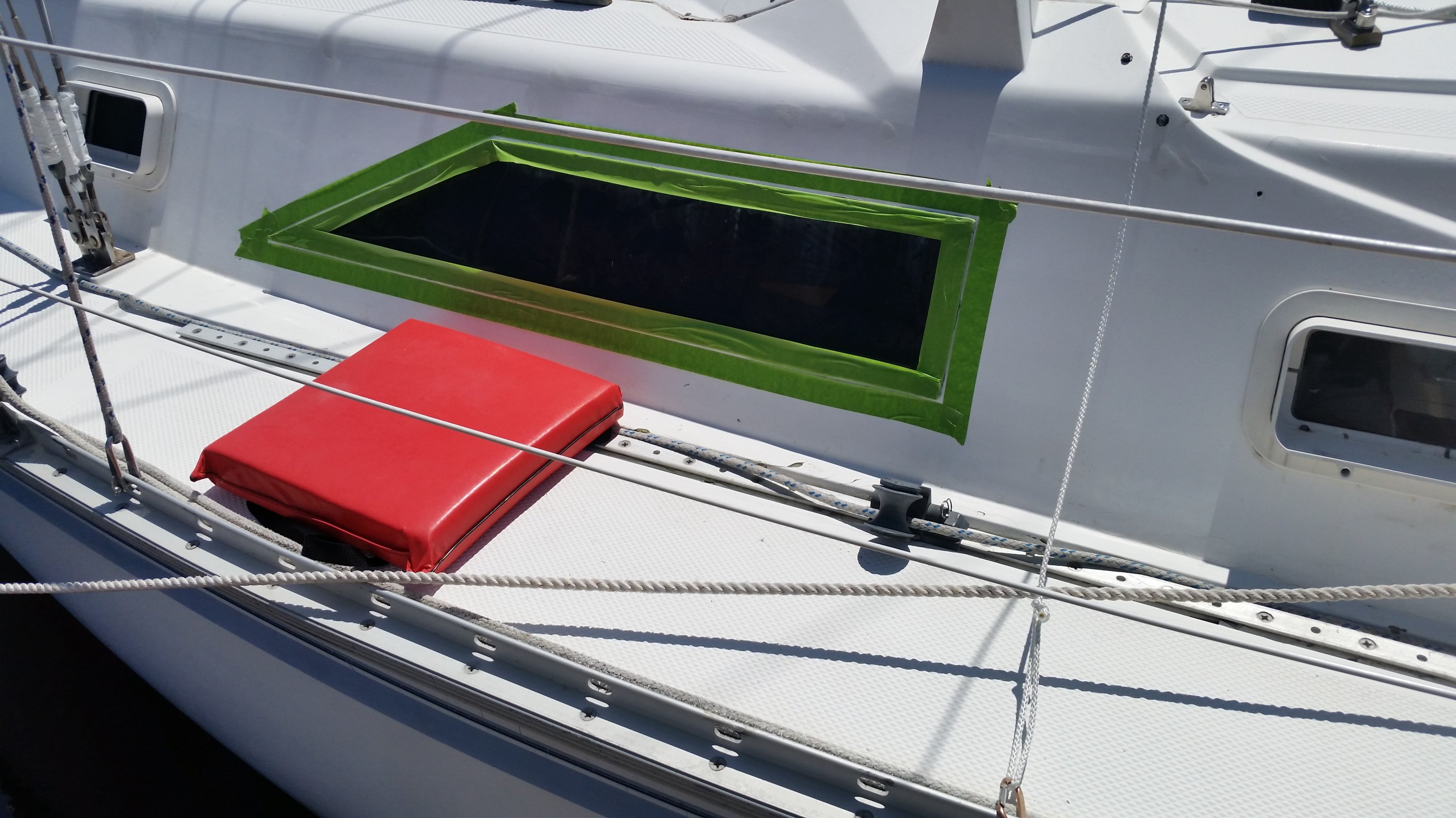

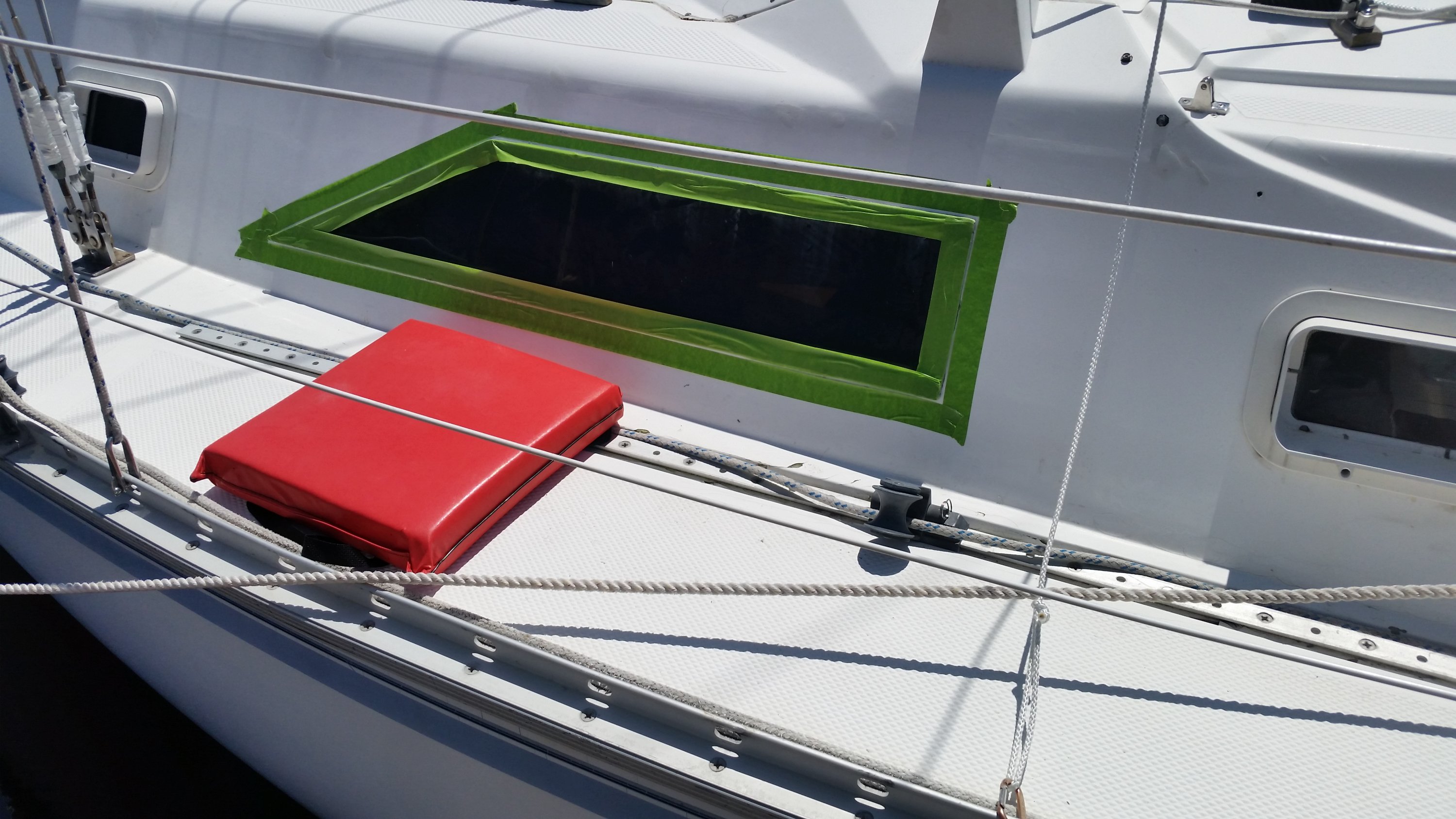

Now on the H31, the vertical portion of the rail is on the inside instead of the outside as on Terry's H42, So I am not certain yet that I will need to make the cutout in the vertical part of the rail as he did. See pictures of my rail below. (ignore the Iguana:biggrin:)

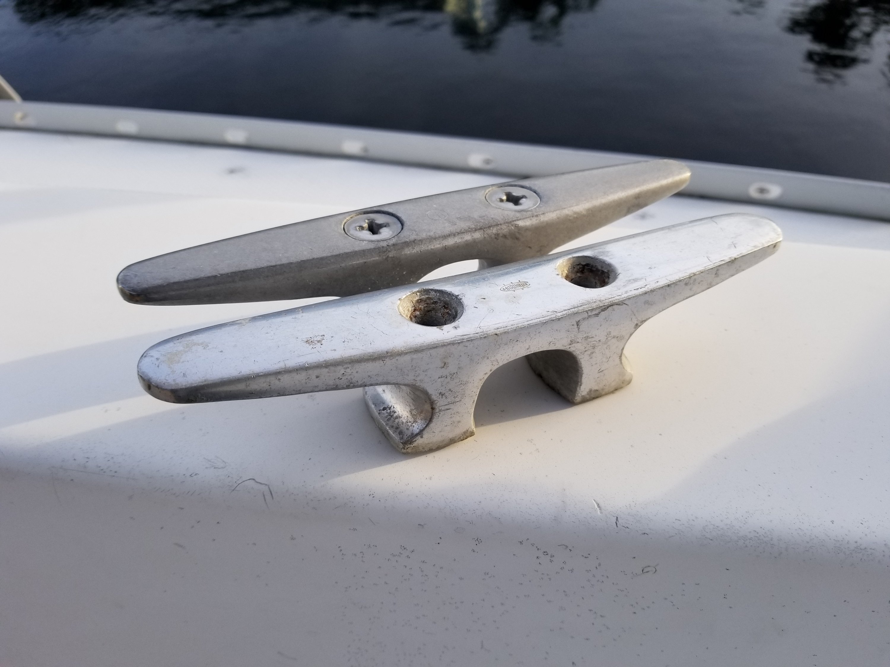

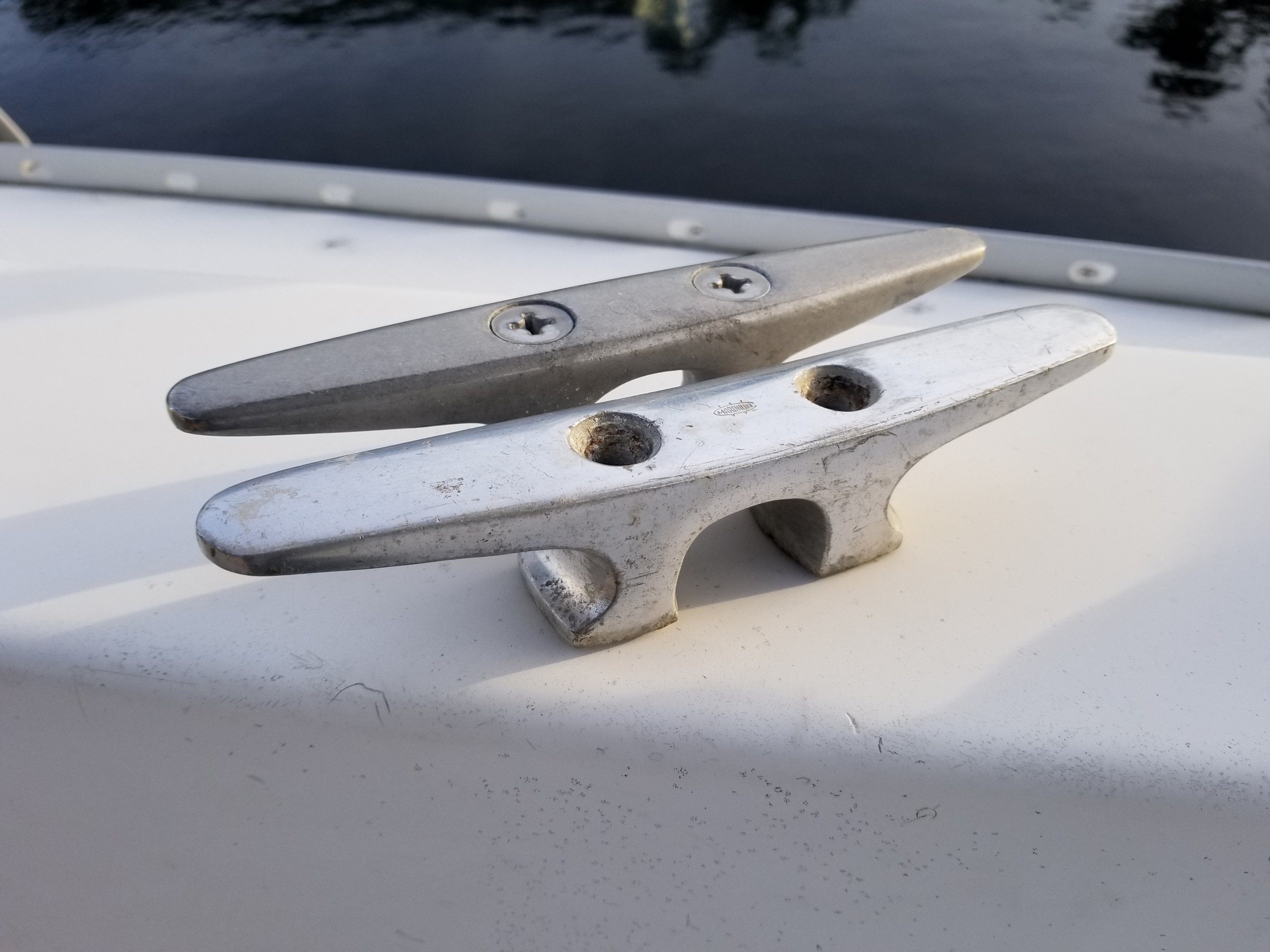

Below is the type of cleat I am considering for my midships cleats.. I already have the one in the picture below, and I just ordered another used one off of E-bay that should be here Monday.
I need to determine how far back along the boat to install them. Should it be at the widest part of the hull?

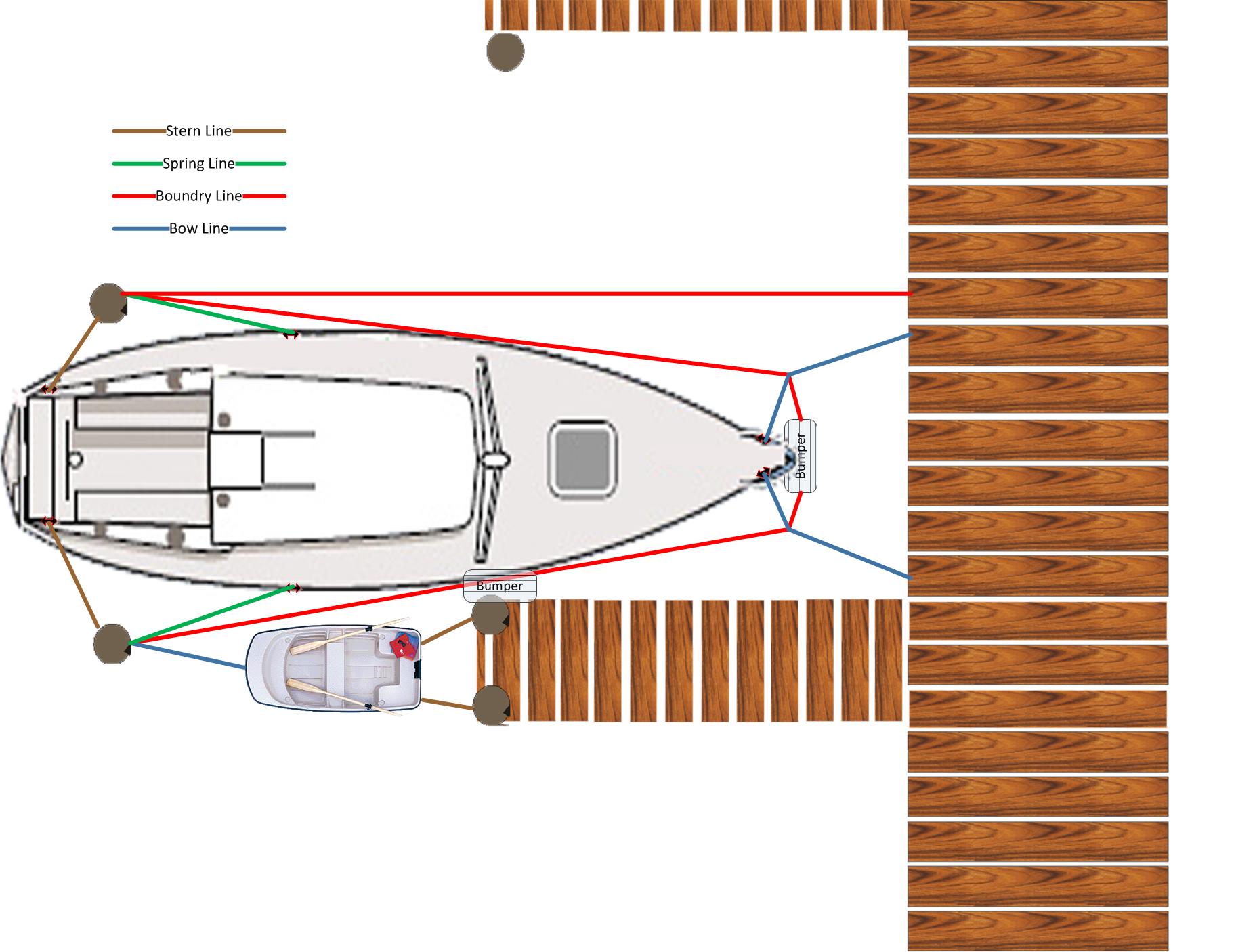

Based upon this slip, how would you want it to pivot?
JamesG161
Feb 14, 2014
7,906
Hunter 430 Waveland, MS
Without the Dingy at the bow...
I would think bow to be slightly in favor, since that will probably be where boarding lines are and easier pull.
I did look at the position of my Midship cleats. They were slightly aft of the widest beam point. Discounting cargo ballast distributions, that would suggest a Bow favored pivot.
Also boarding at Low/High Tides well be easier, since the Aft lines[Browns] will be at their extremes.
I am starting to favor your Corral idea since it doesn't depend on weights or Midship cleat.
And...
It restricts your neighbor's bad tie up from encroaching on your berth too!
If you look back at your aerial view, at the encroachments, wow.:badbad:
Jim...

If u use the Johnson mid ship cleats i referred to earlier there is no reason to cut out toe rail. They affix by lock nut thru the toe rail Also tried track mounted mid ship cleats before and not as useful as the toe rail mounted version because they are mounted too far inboard on the H31. Lots of chafe on the dock lines.

Without the Dingy at the bow...Jim...
I have been convinced, and will most likely tie the dinghy between the end of the pier, and the dolphin. Trying to figure out how I can put a cover on the dinghy so it doesn't fill up while it is in the water? There are factory covers for the Water Tender 9.4 available, but I don't want to have to go for a swim every time I put the cover on?
And...
Jim...
I agree just aft of the widest beam for a little bow favored pivot. I will certainly use barrier lines against encroachment. I am still deciding on the corral concept.

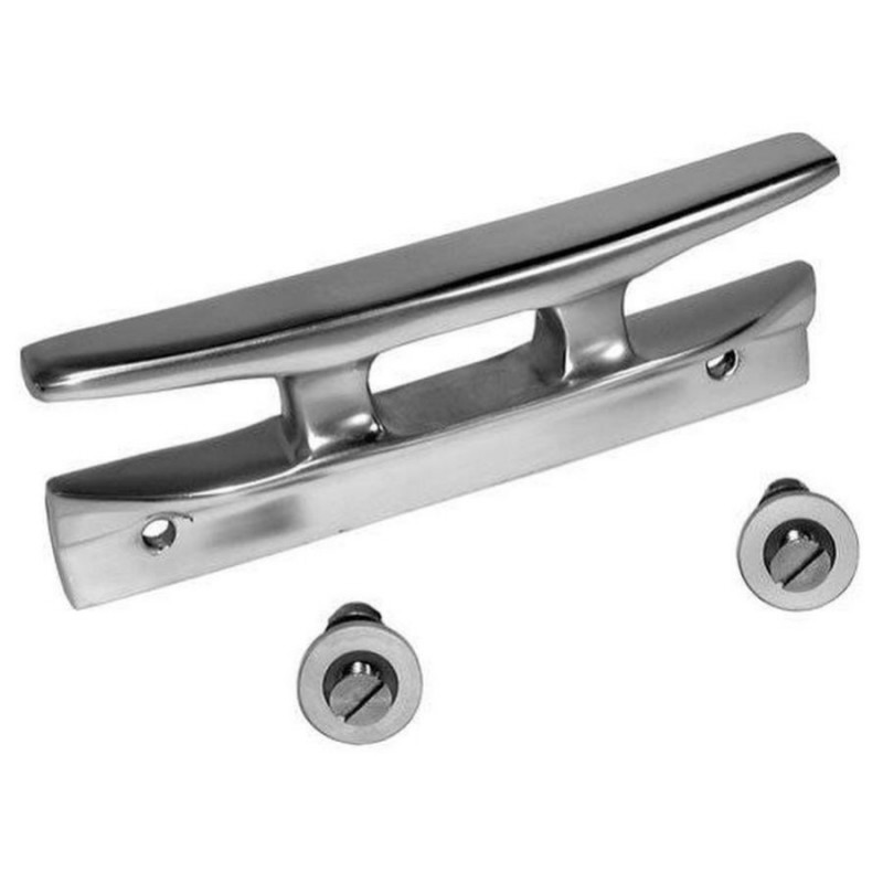

I have heard good things about the Johnson cleats. However the used fixed cleats cost me less than $40 for the pair. Even used, the Johnsons are way more money. If I was going to buy new, I would probably buy these:
YS Alloy Toe Rail Spring Cleat YS-9185

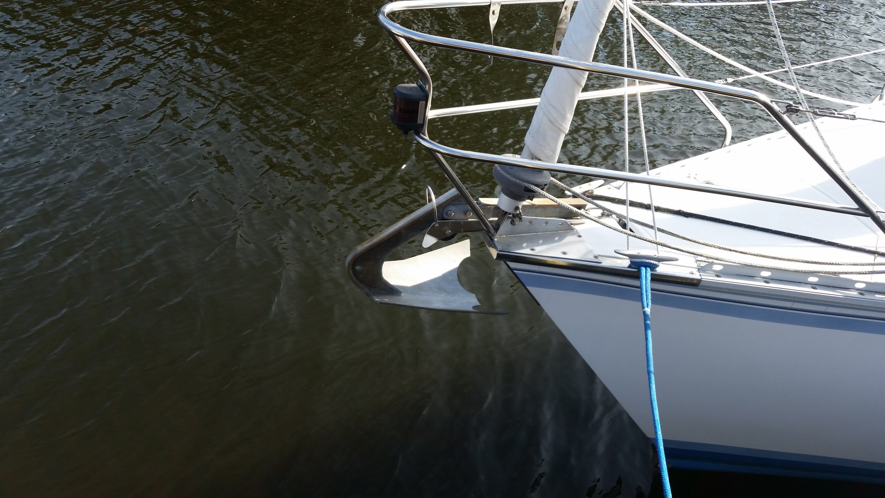

My factory bow cleats are also attached to the rail, using the same method I plan to use for the midships cleats. I will put backing plates behind them under the rail.
