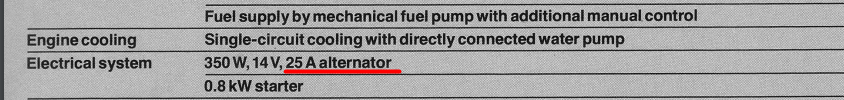

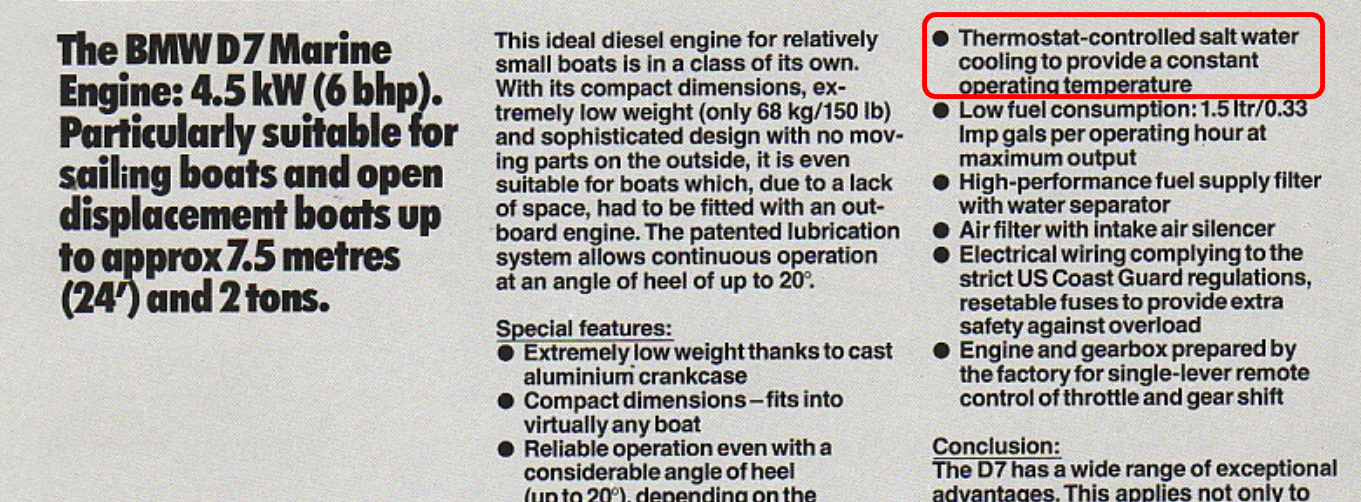

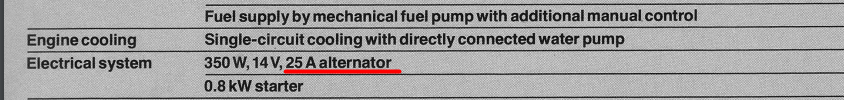

What caught my eye :
Raw water cooled engines have their problems and the 25A alternator will cut down on your luxuries for the usual reasons when you are on the hook for any time. How does the price of the BMW D7 compare to a rebuilt Yanmar 2GM 20F with 2.7 times the HP ?

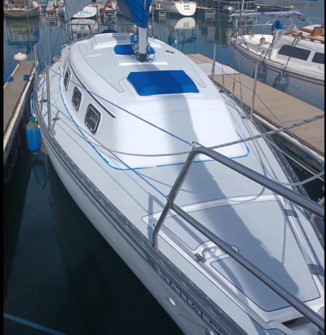

I picked this one up for a song. A neighbor was going to electric. Thinking that the Renault RC8D was R.I.P., I merely was wanting to make this boat move again. On this little lake it is plenty. But, if I decide to haul to the gulf, I'll want to go around 20hp+. I am going to be unable to stay aboard in about three weeks. I've decisions to make. I may keep it here and go to FL and back to my blue water quest. today.... I want to complete the project that I have started. Even though my back say no.

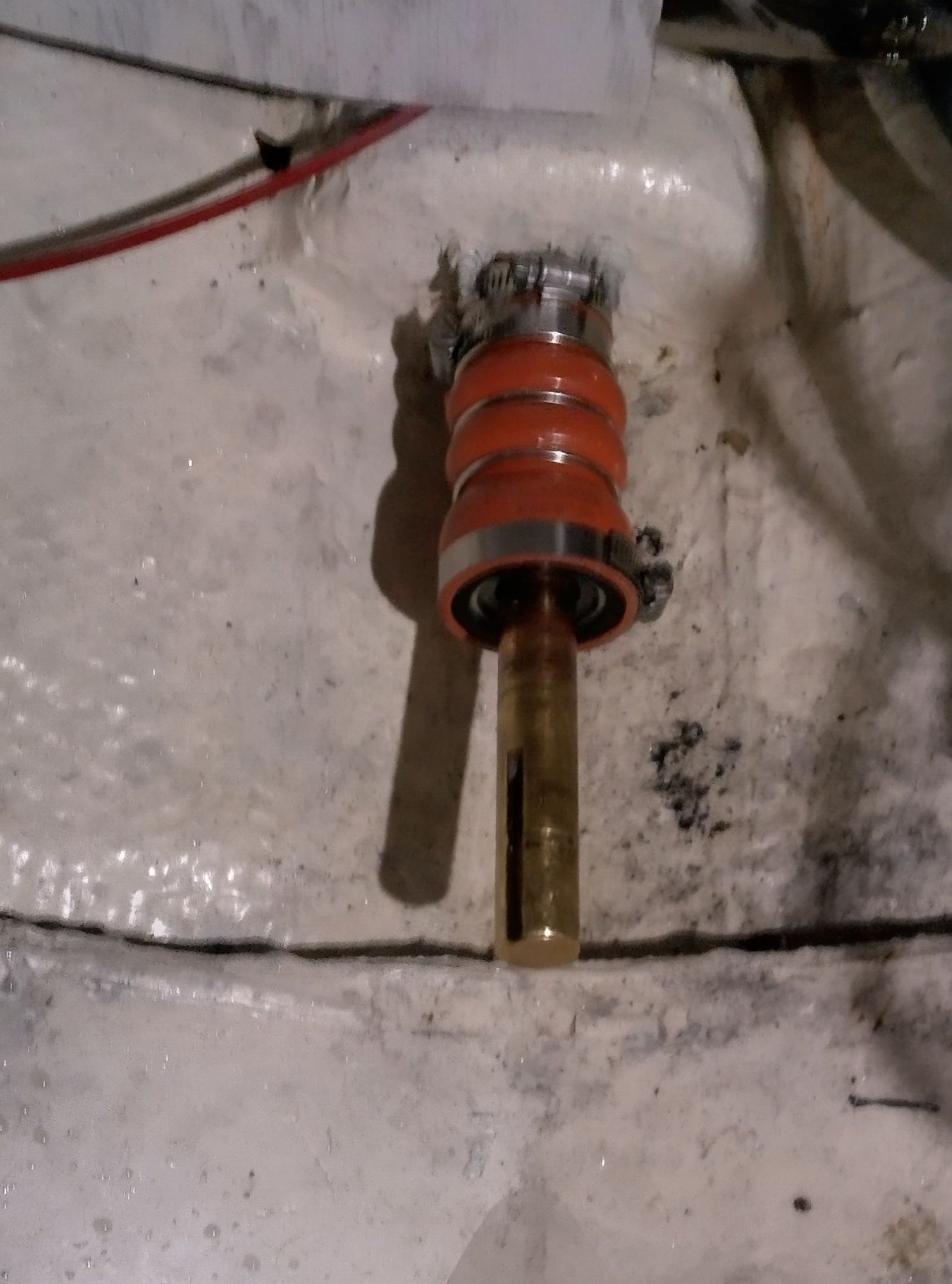

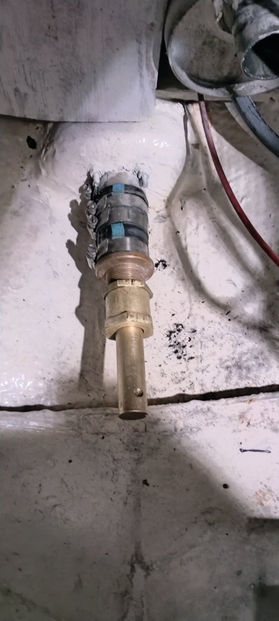

Well I didn't sink my boat. Looks good and I picked up a couple inches. But there was no change in the movement of the shaft. I put on my mask and snorkel went down and wired brushed a bit and yanked on it, it's pretty tight feels loose up at the seal. The Cutlass is froze up... Next...
A before and after.

When you say the cutlass is “froze”, do you mean you can’t get it out of the strut, or the shaft won’t turn in the bearing?
The bearing may be held in the strut by a few (2) set screws. Often, they are painted over and hard to see. You need to get them out before trying to remove the bearing.
If the shaft won’t turn in the bearing, then I suspect you have some other issue (like the strut isn’t aligned). But who knows….we can’t guess without photos or more info.
The Johnson seal looks good.

After installing the new soft seal there's a lot of flexibility in other words I can move the shaft in a circular direction in the engine compartment effortlessly, however it is still almost impossible to spin. In fact with a vise grip it takes considerable effort to even budge it. So it is free in the log however nearly Frozen when I attempt to turn the prop itself and trying to slip the shaft forward or aft is nearly impossible. I cannot see a misalignment of the strut. And as it is free at the log, of course the only place to bind it up aft of the log is the strut.

I see you're between two fingers :
Is there any chance of backing in stern first, loading a bunch of junk on the bow and see how much force would be required to lift the prop out of the water without attracting too much attention ? Use a beam between the fingers and work from there.
Drain every tank on board (unless it's at the bow) and get the loose engine as far forward as possible. Remove everything that isn't attached to the boat.
