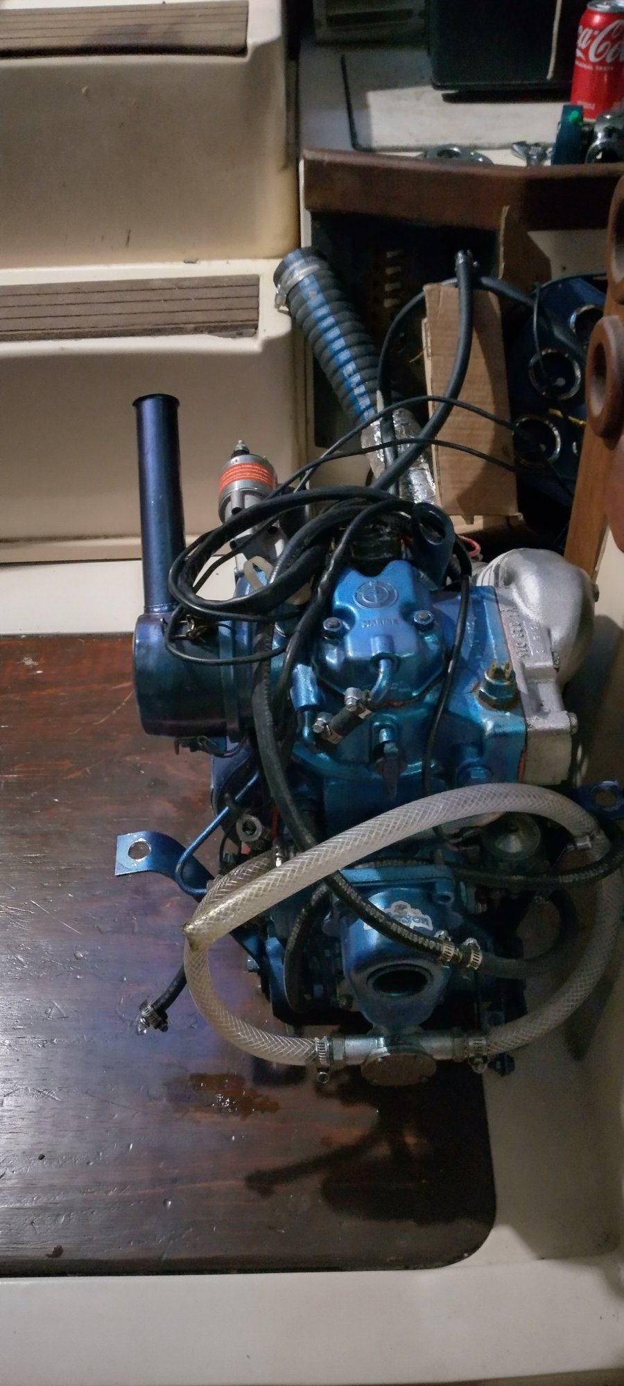

Yes, I had disconnected the coupling first. The shaft is difficult to turn not connected to the gearbox. I have the I now have the motor sitting in my salon.

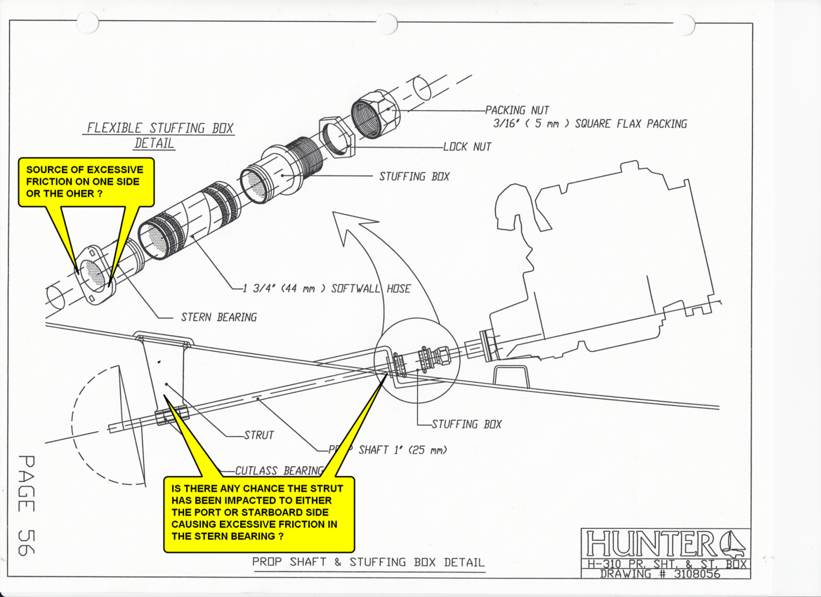

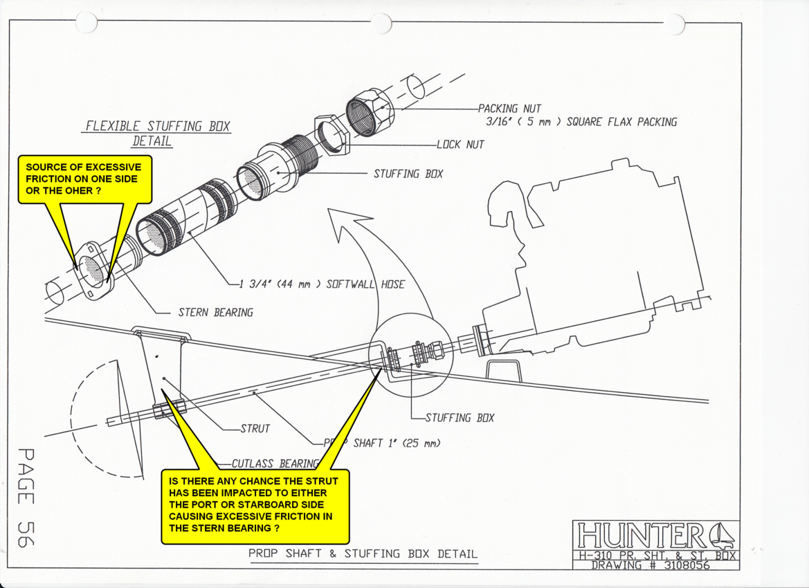

Now that does sound just a little peculiar ! You mean "with all hoses and wires disconnected" sitting in your salon ? Any chance you could supply a picture so we can see HOW MUCH the motor is just sitting in the salon ?
Next item "is the packing gland loose and not your source of friction?"
Lastly, any chance the strut has been struck and bent off to one side causing the shaft to bind in what my manual calls the stern bearing and which the rest of us call part of the shaft log ?

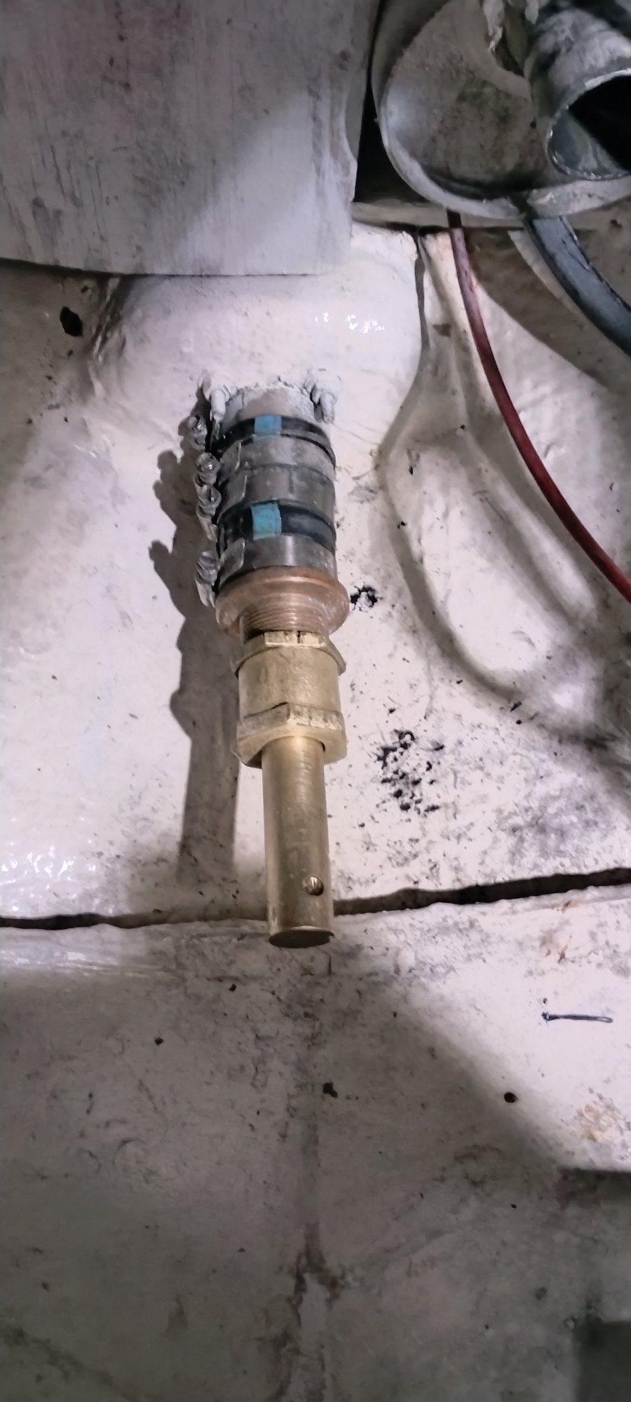

Well yes it's certainly possible that the strut may be off-centered. I repacked the stuffing box and I have turned the shaft with the stuffing box at various degrees of tight, or of loose whichever way you look at it. Only relatively light differences in the degree of stiffness. Yes I can supply pictures and I will. It is the entire motor that has been removed boom pullies. And I will dive and do my measurements. But I wish if someone had the exact measurements, that they would give them so that I can weigh what I measure against what the good book says.

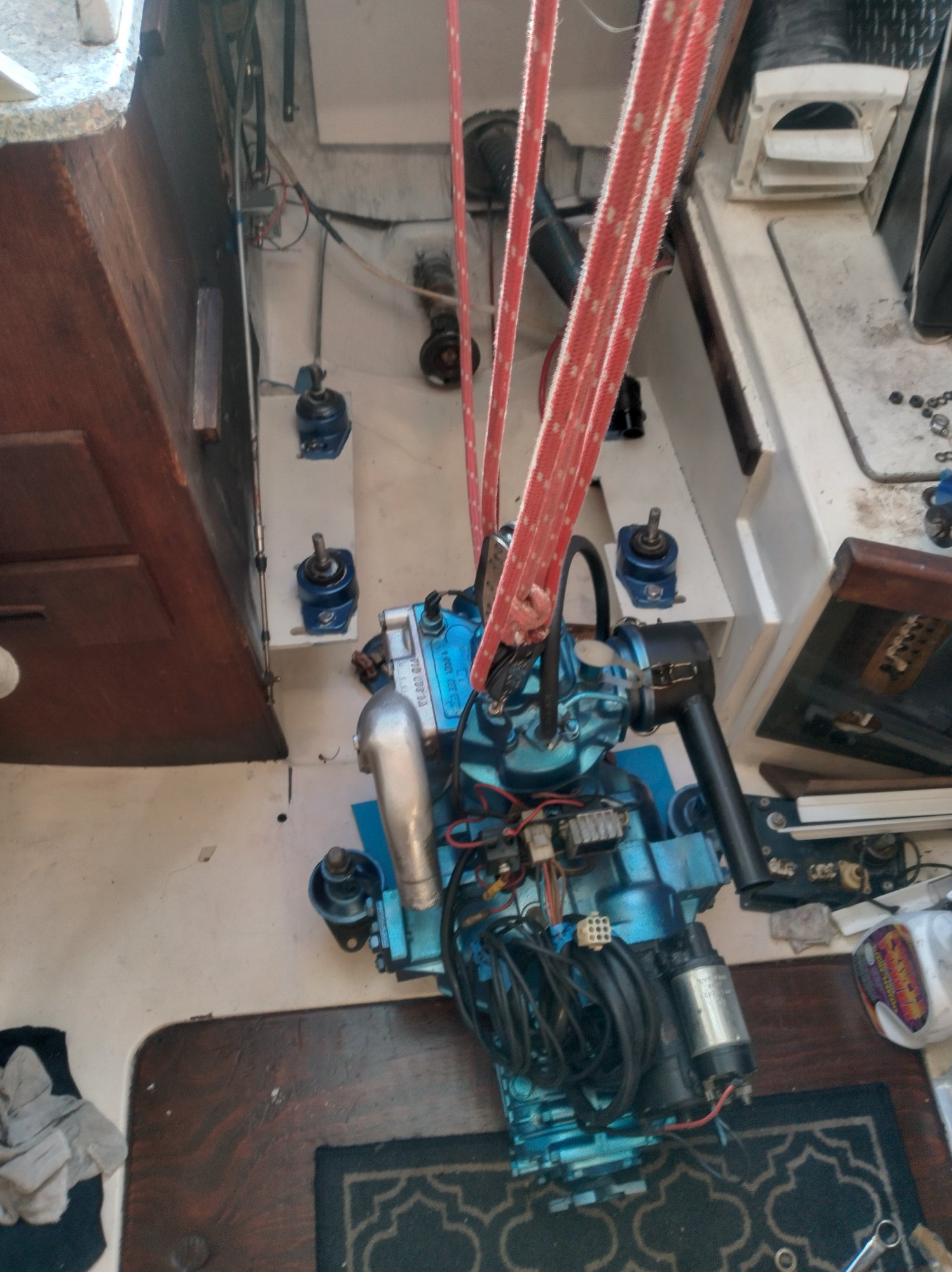

Yes for sure if I could have hauled her out I'm sure I would have been done and back sailing again long by now. What engine? Well that's part of where this all started. Originally I believed that I had an engine/gearbox problem. So I removed the original Renault put in a BMW (pictured in salon). When I fired up the new BMW all good. Shifted into reverse, all good. Shifted into forward and that's when everything hit the proverbial fan. It was exactly what occurred with the Renault. But this time instead of "S" canning the motor right away, I disconnected the gearbox from the shaft and the engine re-fired and when not connected to the shaft was happy in forward and reverse. When I look back at the secrets of events. The the issue likely started long ago and whatever it is, was progressively increasing in its intensity until the shaft has gotten so tight that the engine does not want to push it. Strange is that it doesn't pose an issue in reverse. At least not notable.
