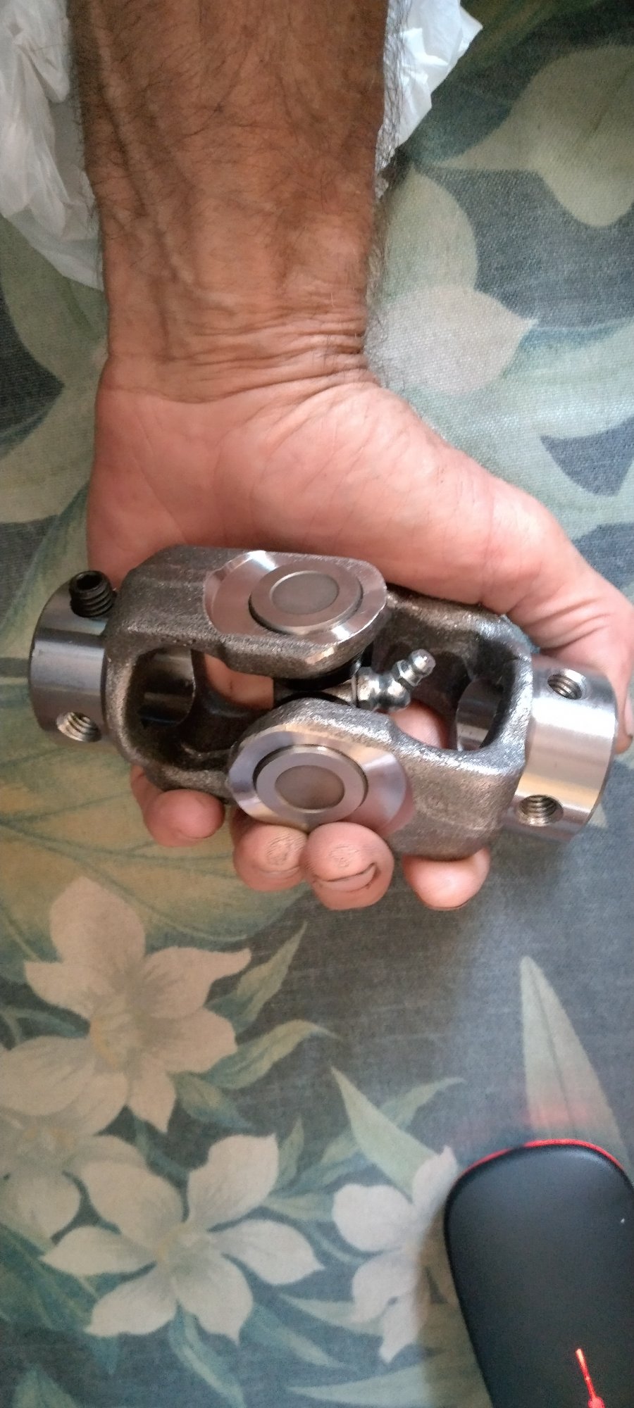

Absolutely! that looks almost identical to what I am doing now other than I am replacing my old stuffing box with the new flex shaft seal boot , ordered that yesterday. Ordered the CV joint yesterday morning. I had already bought a thrust bearing and will be building a very similar barrier and then the propeller will be pushing the boat and not pushing the gearbox. I also purchased a universal joint. I really don't think I'll have room for it. I'll gain about three or four inches by using the new flex shaft seal. But the difference, in my thought process, and what they did was that I was going to add a universal joint ahead of the thrust bearing. By having forgiveness at both ends of the shaft before it enters the thrust bearing and then exiting the boat should provide a Ron Popeil scenario. I.e; set it and forget it. Now as sailboat owners we know we just don't forget to check on anything for very long. But I believe it won't be calling on me requiring attention. I am supplying pictures of complaints that I've got already and I will certainly shoot some shots of the whole finished product when complete.

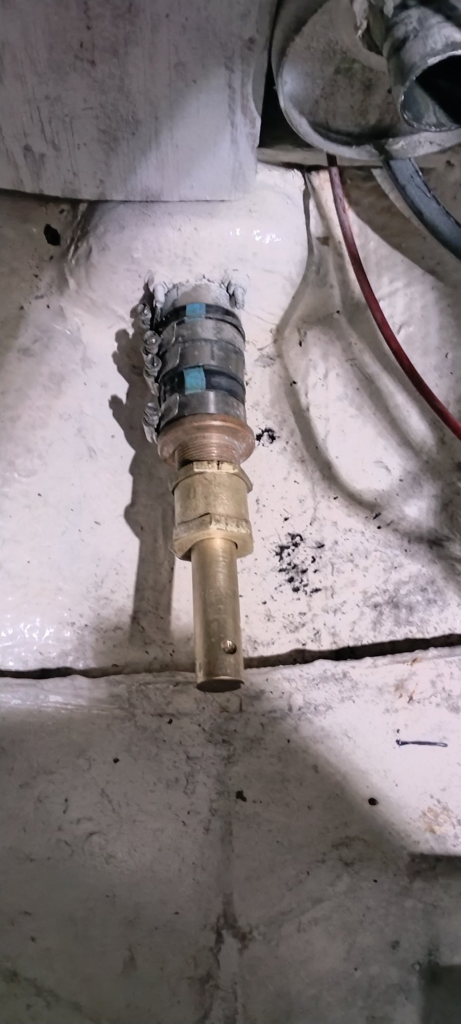

Yes we went down today. It actually looks pretty good. The Cutlass bearing protrudes about an inch out of the strut toward the prop. So as we continue to rule things out, Monday I will receive the new soft shaft seal. It really appears as if the shaft is having its problem within stuffing box. Other than requiring a good bottom cleaning it looks pretty good under there. I ordered an oxygen tank and regulator that should be in within the next he's the professional that I like to do everything that needs being done on my boat at least once myself. Of course I'm an expert at changing out motors by this time. LOL
Jan 4, 2006
7,424
OUCH ! If the grinding has been taking place within the gland, you may have damaged the shaft surface which contacts the packing material. I don't believe you've mentioned anything about excessive gland leakage (not that I remember) so that shaft area may still be good.
IMO changing out the cutlass bearing is still premature as you don't know its condition. Mine is 24 YO and in better that new condition with 0.000" clearance clearance after 2300 operating hours. Why not solve the high friction problem FIRST and avoid any repeat work ? Repeat work like replacing the whole shaft for a high alloy SS shaft which guarantees you can forget it.
I'm still looking forward to seeing the area where the shaft exits the stern bearing.

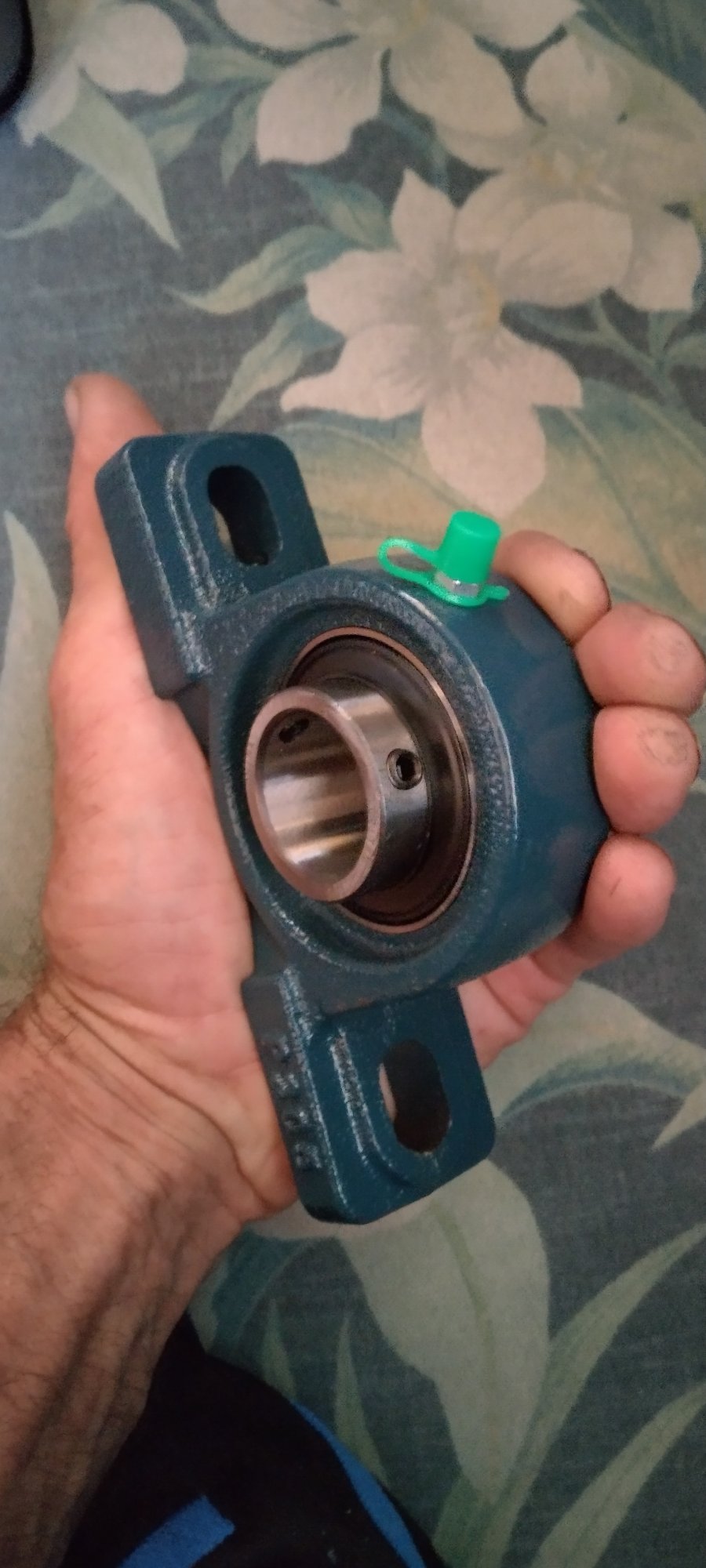

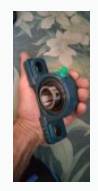

Do I correctly understand you'll be using the shaft bearing shown in your photo #2 :
........... as your thrust bearing ?
Just noticed I didn't reply to this question. Yes I'll be for all intents and purposes building a solid, sturdy retaining wall that that bearing will be attached to. That will stabilize the shaft between that point and the prop and not allow it to shift forward or backward. And then I'll be creating the forgiveness forward of that likely it will be to CV joints. I should be able to mount my engine level, as it was originally designed, before it's marinization. Imagine doing an oil change the good old-fashioned way... with gravity! I'm also expected better performance out of the motor without having to fight itself, pushing thrust out, only to have a major portion return. CV joints are designed to be able to handle as much as 40° of misalignment, using two of them, I am sure that 15 ,16, 17 18° of misalignment, well the affect will be major and the effect will be grand.
Jan 4, 2006
7,424
I've had the usual experience with bearings supporting radial loads but just not familiar with using bearing to withstand axial loads. Do you have any specs for that particular bearing for axial loading. Even worse, any idea what the axial loading on your prop shaft is when running flat out ? I think marine transmissions are designed for that.
Jan 4, 2006
7,424
I have no experience with tapered roller bearings other than what I read but this is what you require to accept axial thrust :
Is this what you have in the bearing casing you show :

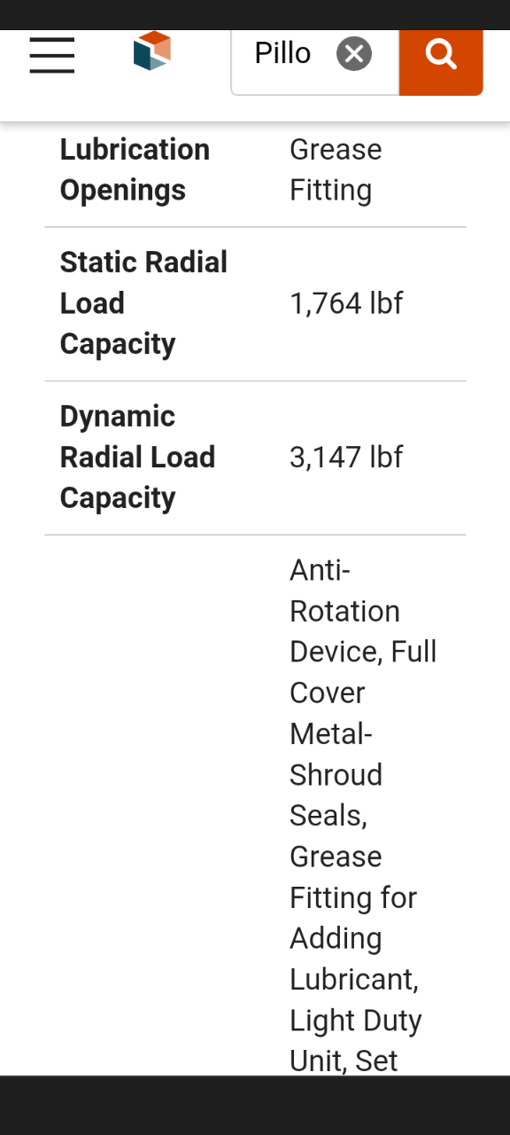

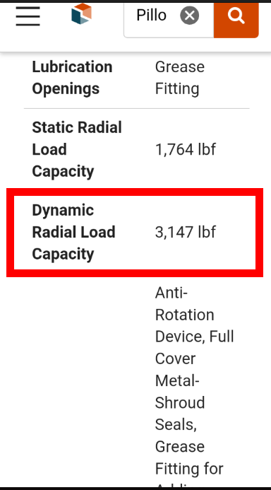

See screenshot
Jan 4, 2006
7,424
Aw crap !
All I see is a statement of radial loading. No mention of axial loading.
Do you have a manufacturer's part number to look up their complete list of specs for that particular bearing ?
