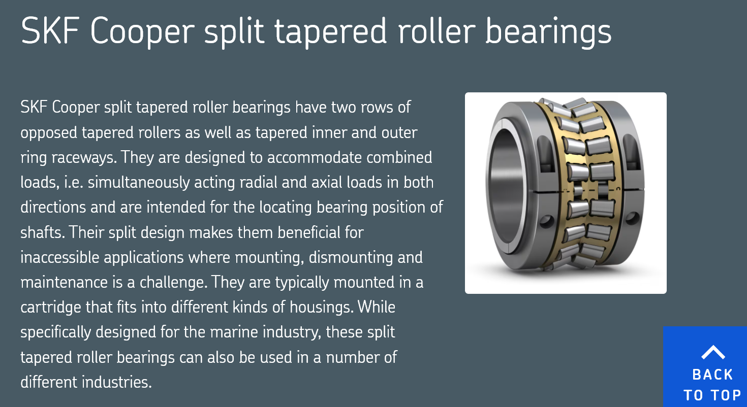

In order to have resistance to the thrust supplied by the shaft, you'll need a double ended, tapered, roller bearing to accommodate both forward and reverse thrust.
If it turns out your newly acquired bearing will not tolerate axial forces, you may find yourself looking at this bearing for the internals of a new pillow block housing should you go for that mounting configuration :

I hate to keep pissing on your corn flakes like this @RSHunter27 , but if you do decide to incorporate the tapered roller bearing as a thrust bearing, you will have to agree never use the engine in reverse. And I don't know if that's really the best idea for your boat.

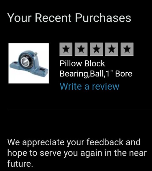

It is a pillow block.

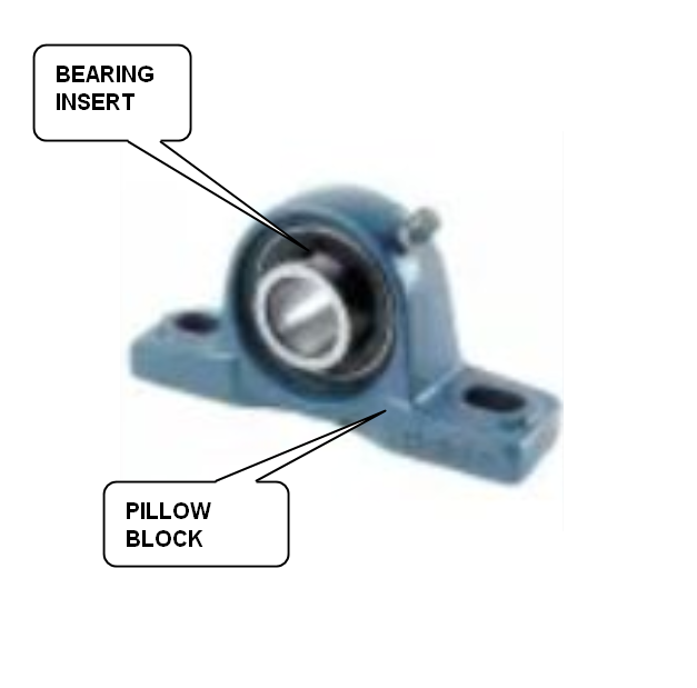

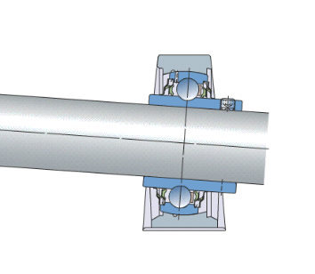

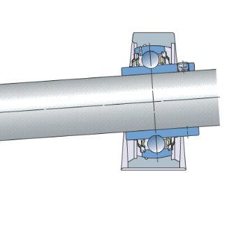

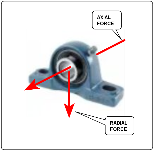

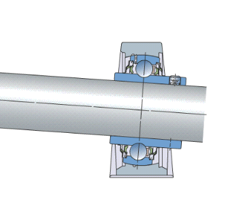

A pillow block is the housing for the bearing "guts" or insert which allows for a few degrees of misalignment by allowing the bearing to rotate a few degrees within the pillow block :
The exterior of the bearing insert and the interior of the pillow block are slightly spherical to allow for this small amount of movement.

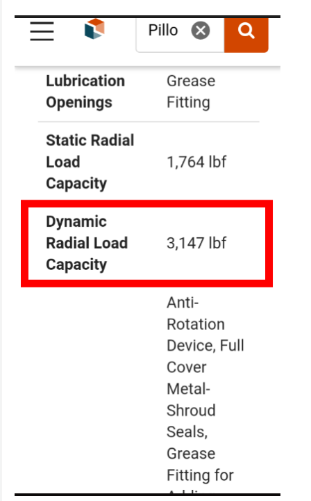

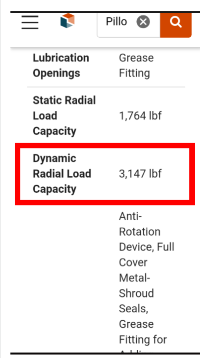

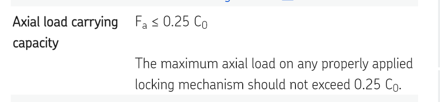

It's the bearing insert which does not appear to be able to withstand any axial thrust as described in the label which you posted in your post #38

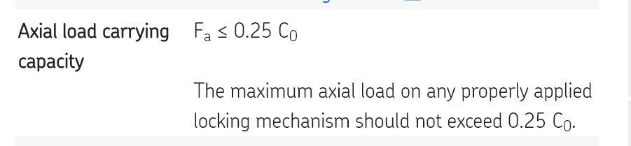

It can only withstand a radial force of 3,147 lbs. when rotating:
Feb 16, 2023
127
Hunter 27 cherubini 832 Lake Travis
View attachment 219040 View attachment 219041

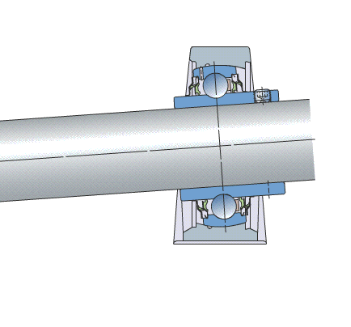

Loads
Equivalent bearing loads, minimum load, axial load carrying capacity
For detailed information, refer to Insert bearings / Loads.

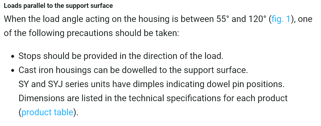

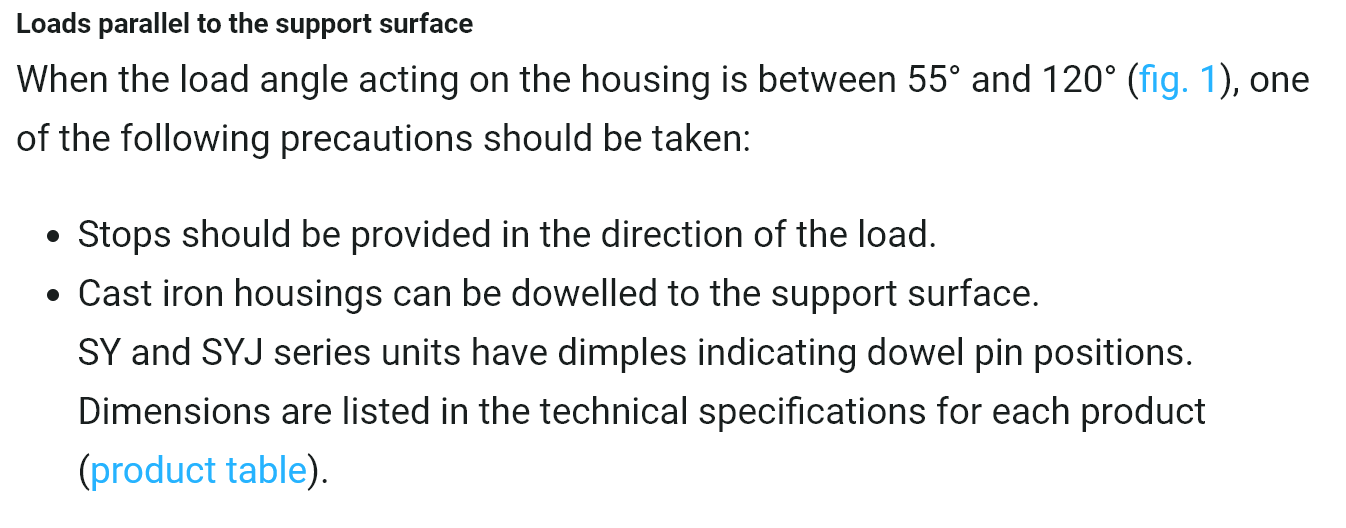

Permissible housing loads
Pillow block housings made of cast iron or stainless steel, accommodate at least the same dynamic and static loads as the incorporated insert bearings. They can also endure peak loads or varying axial loads.
Housings made of composite material (including SKF Food Line units) accommodate at least the same static loads as the incorporated insert bearings.
Pressed steel housings have a lower load carrying capacity than the suitable insert bearings. The permissible radial load for the selected housing is listed in the technical specifications for each product (product table). The axial load should not exceed 20% of the permissible radial load.
Loads parallel to the support surface
When the load angle acting on the housing is between 55° and 120° (fig. 1), one of the following precautions should be taken:
  • Stops should be provided in the direction of the load.
  • Cast iron housings can be dowelled to the support surface.
    SY and SYJ series units have dimples indicating dowel pin positions. Dimensions are listed in the technical specifications for each product (product table).

Interesting reading. So that's the max. axial load for your purchased bearing.
As long as your max. shaft thrust is less than :
3,147 lbs. X 0.25 = 787 lbs.
.......... you're in business. Not too sure what they refer to as the "properly applied locking mechanism" unless that's the two set screws on the bearing collar being installed into heavy dimples on the shaft. Set screws only applied to the shaft do not impress me for being able to resist axial forces. Any idea what your max. shaft thrust is ?
My solution to the above problem would be to use the largest bolts possible the pillow block will accept and then tighten the bejabbers out of them to eliminate the possibility of the block sliding sideways.
Yes I have seen that number somewhere in one of my files for this motor. The one I'm putting back in is a BMW bd7 which is a six to seven max horsepower motor. The transmission is rated to handle 5000 RPM the bd7 only puts out 35. I think it's somewhere around a two to one reduction. The limited spec sheet that I was able to find and send to you on the pillow bearing from the manufacturer stated that there are two dimples in the casing that you would drill through and put a sort of post in that would reduce or disallow the slop or radial agitation. I think I posted about my gearbox and they recommend a soft or flexible prop shaft and or connections. It certainly didn't have any when I bought it. That doesn't mean that the sailboat manufacturer cared to follow those instructions or suggestions. I think there's a lot of we've been doing it this way and been successful so we'll keep on doing it this way. I'm not a mechanical engineer but I did sleep in Holiday inn Express once. Seriously, I hung around with my grandfather a lot when I was a child he was a machinist an inventor, a mechanic and a carpenter. I think that a bit of my grandfather rubbed off on me. He was never afraid to tackle any project. And I had a front row seat for some of it. He used to tell me that problems were just a thing that would wait around for me to show up. Anyway if I mess up I'll learn something. Wasn't it Thomas Edison it said he didn't have failed experiments only that he had figured out hundreds of ways not to make a light bulb. I'll keep you all posted. I'm painting lettering and striping my above the water line.

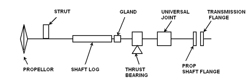

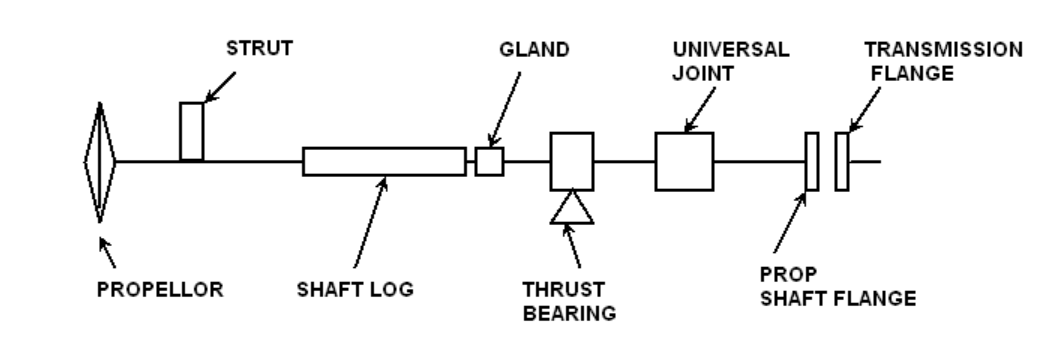

I've got ot make up a sketch of this. I had been concerned about the thrust on the transmission but I forgot that was the purpose of the thrust bearing to keep the transmission free from thrust.
Is this close enough to represent the basic concept ?
Do you have anything picked out for the universal joint and how are you doing for space for all of this equipment ?
Yeah I think you've hit it just about right. Although I'm thinking about using a CV joint instead of a U joint. There's a link to the BMW D7 motor I'm using: The BMW D7 Marine Engine: 4.5 kW (6 bhp). https://www.bmwmarine.com/media/d7_detail_info08.pdf

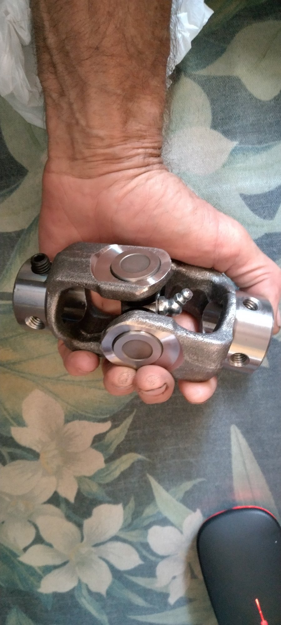

I have purchased a u-joint here's a pic.
